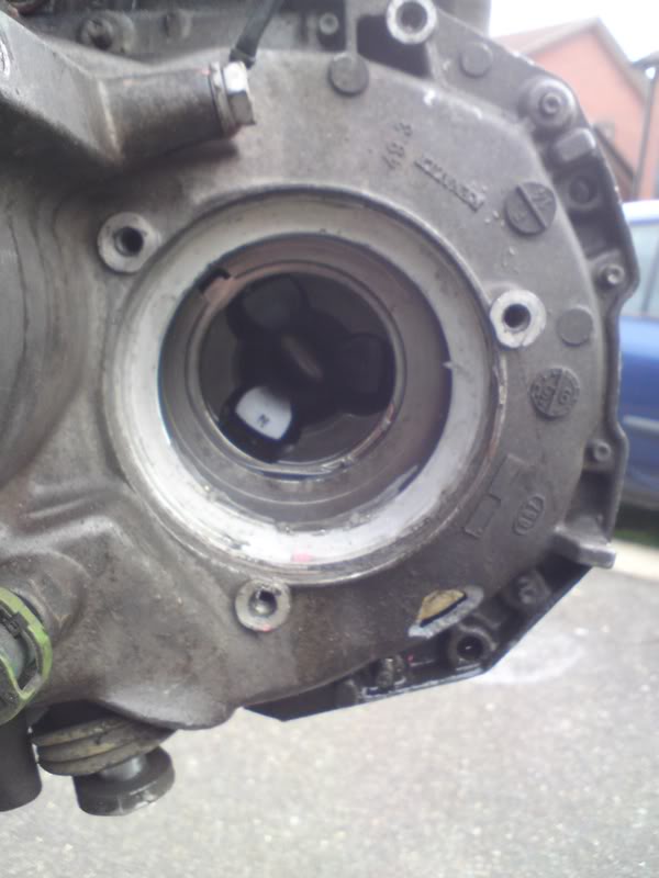

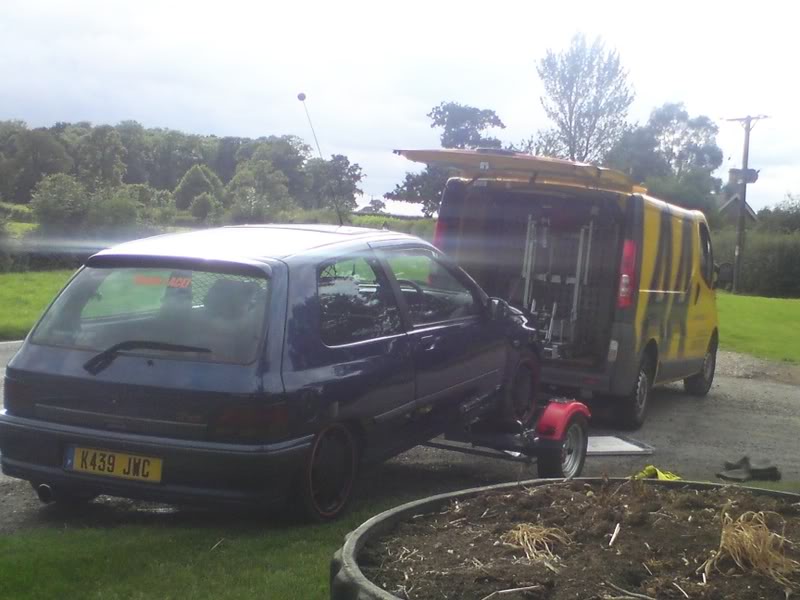

I was driving spiritedly on a nice summers day on a backroad when my gearbox decided to chew the 3rd gear selector and try to fire it out of the Diff casing. £175 and a ride home from the AA man later I was home.
You can just see the brass selector poking out!

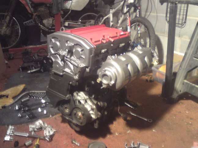

When it was back in and running it didn't make oil pressure and ended up ruining the bores and crank.
I bought a megane B/E to replace my Williams B/E as it was going to cost more than £300 to rebuild my B/E.

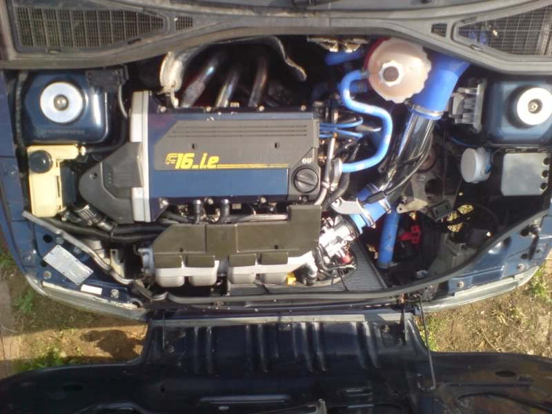

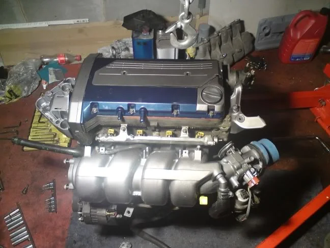

Freshly painted engine with new Megane B/E.

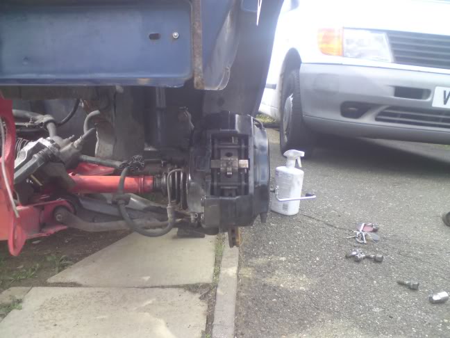

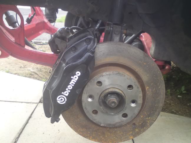

New 406 V6 Brembos

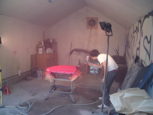

Nathanh spraying front wing.

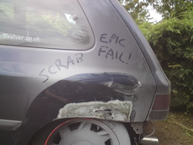

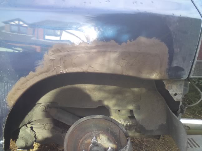

Rear arch....... :shock:

Fit Brembos

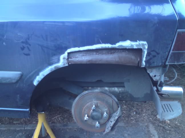

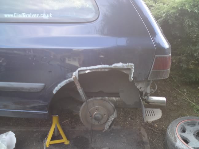

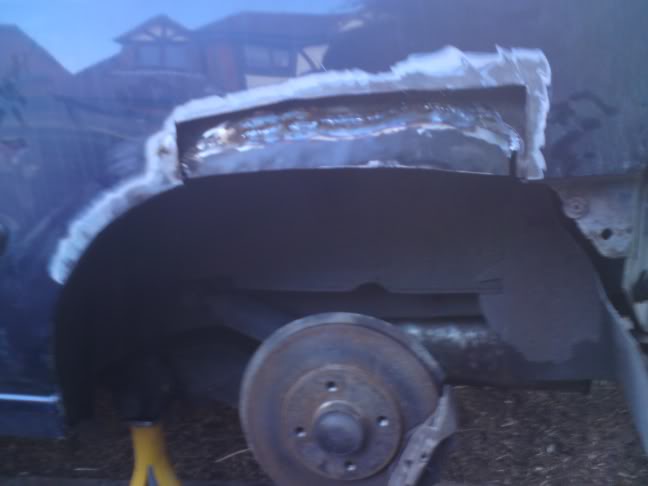

Are you replacing the rear arch or just filling it again?
  SG 200 Cup+F4R'd MK1
Re: Mk1 Hybrid rebuild
Looking good so far, and your plans sound excelent! :D

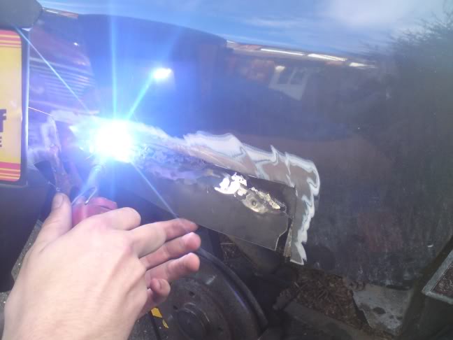

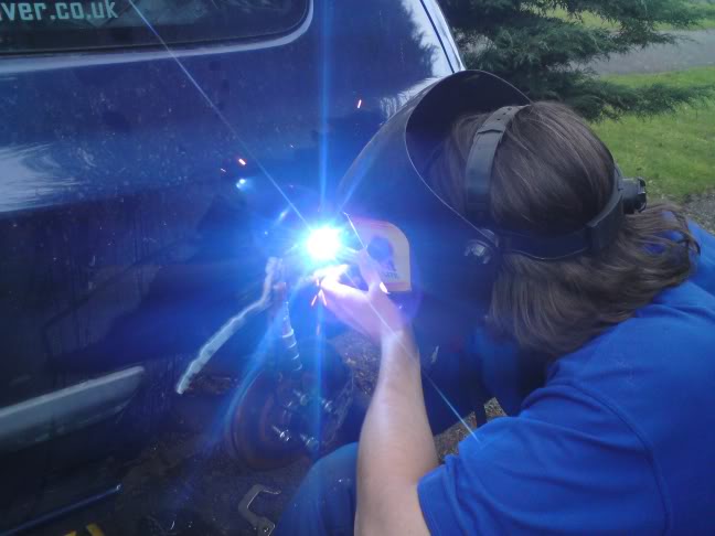

I bought a replacement arch from a 1.2 to cut up and weld into place, so it should be the same if i cut it before the crease and bend the lip on the arch back to the right angle.
Then I would imagine a small amount of filler will be required just to tidy it up!

Just the oil pump drive is internal and the pressure sender is 90 degrees to the Willy one, thats about it.

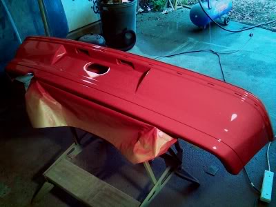

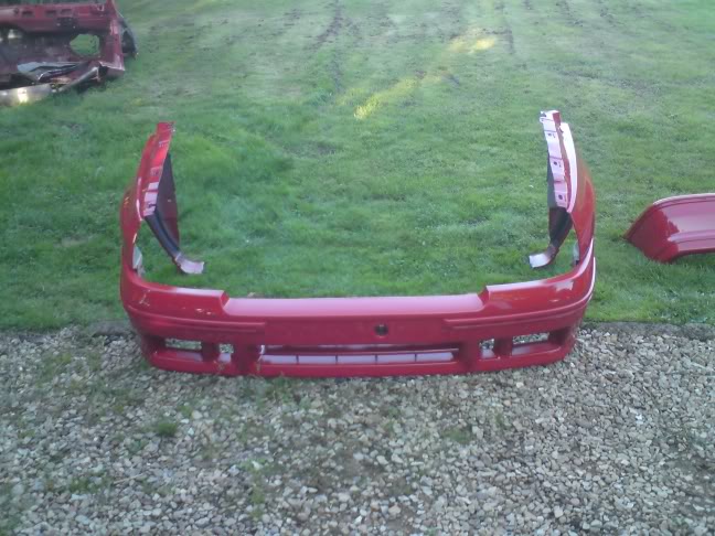

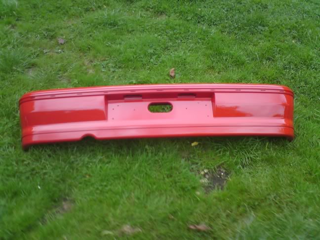

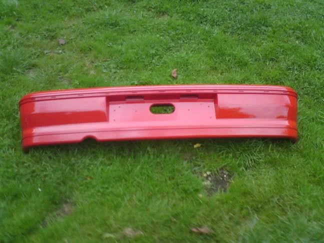

new pic from tonight, rear bumper sprayed.

sorry to tell you this buy you have put those calipers on the wrong way around! The bleed nipple should be at the top! FAIL! :rasp:

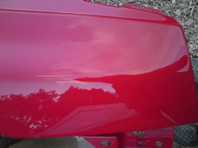

Looks pink Danny and you took the piss out of Naples for being pink!

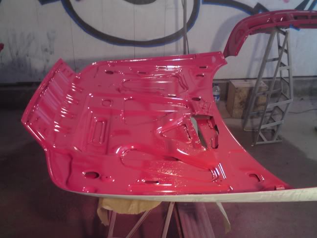

Progress from today.
Rear arch being repaired!
My bumper is not pink Rob, it must have just been a bad picture! :D

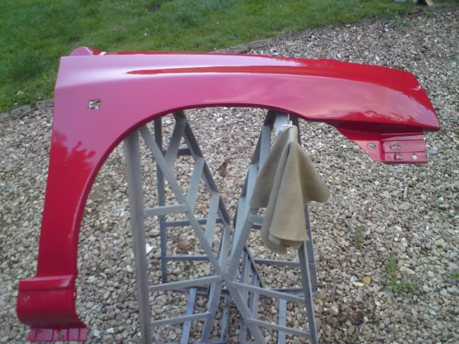

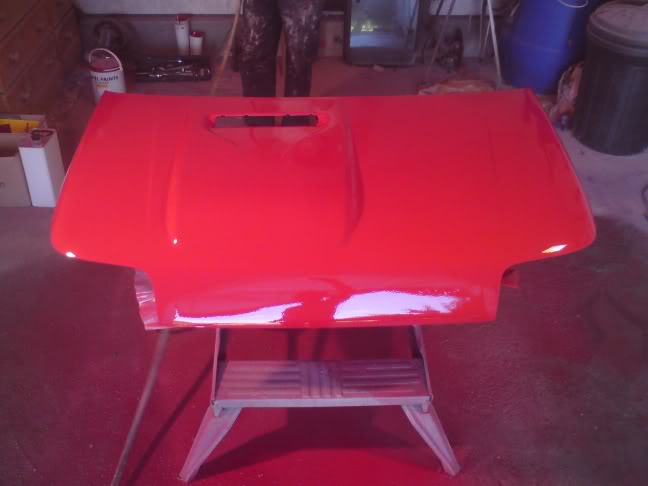

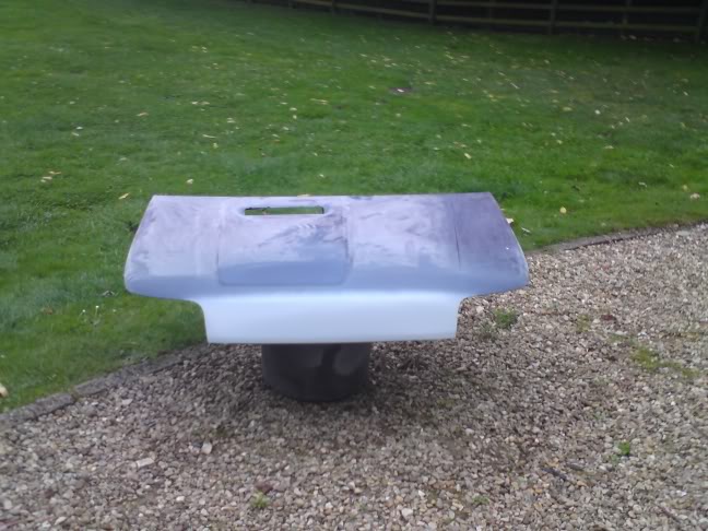

Progress from yesterday.

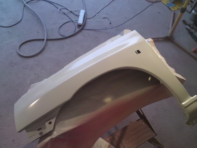

Bonnet being repaired as it has millions of stone chips and the other wing is in Primer ready to paint.

The rear arch is now sorted!
The line is just where there is filler that i havn't sanded. This will be coming off when we prep it.
I covered it in rust nomming paint so all that hard work doesnt go down the pan over the next few days while its on the drive.

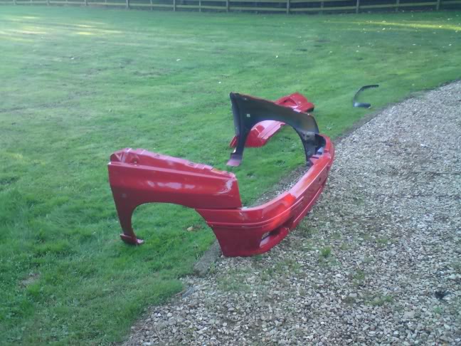

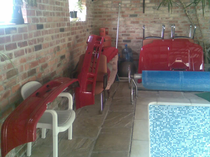

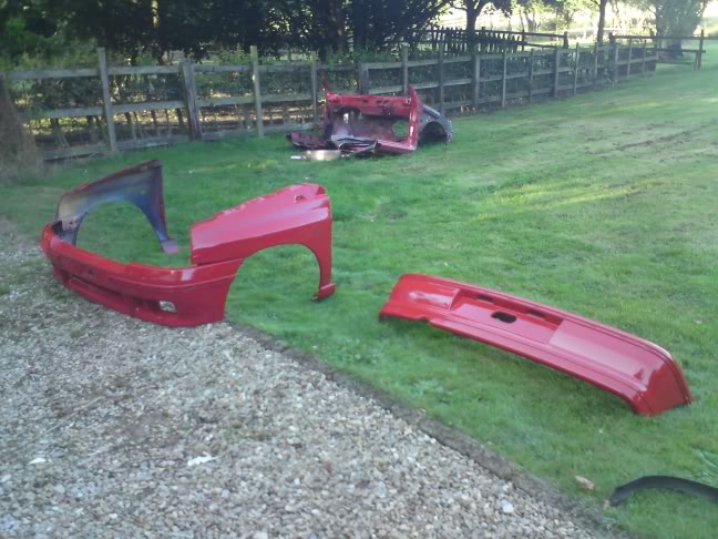

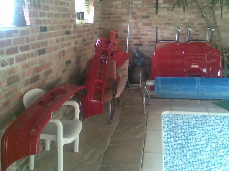

A more recent pic - all the front end is now sprayed (bonnet, bumpers and wings)
