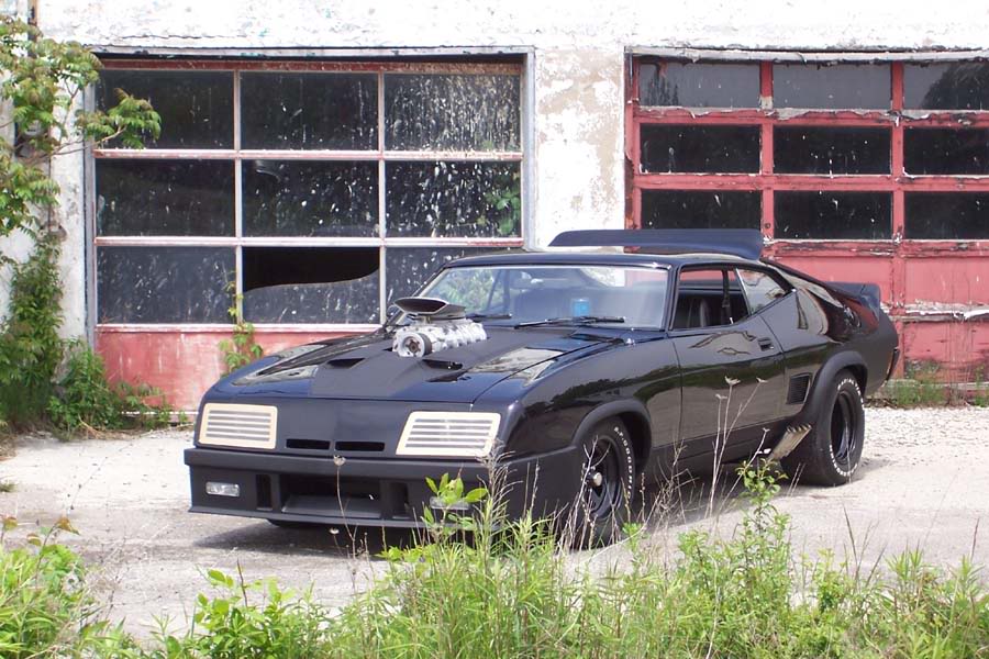

I think you should go Mad Max stylee, a BIG FAT Charger sticking out of your bonnet.... at the push of a button and the charger is activated! :evil: Zoooooooooooooooooooom!!!

and mad max supercharger is fake well kinda in the film it shows him being able to turn it on and off and everyone knows a supercharger runs off the crank so its on all the time jesus
