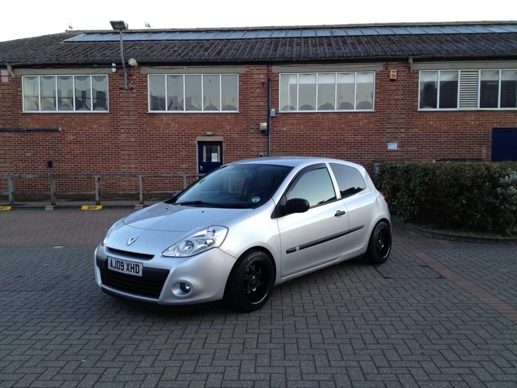

Little bit of an update. Managed to get the positive camber sorted today and now totally love my carfeels completely different! Turns out i had +2.5 degree on both front wheels and 11degree toe out.....no wonder it handled shockingly!!!
also for anyone wanting to know....there is no info on here about camber adjust on mk3 ap coilovers.....they are in fact Camber adjustable to a point. The top bolt hole on the strut is slightly wider so there is room to play. You can also get camber bolts for this car....they are the H&R triple c bolts....just some knowledge to help you out

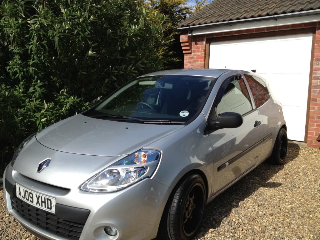

gonna get my mate to clay/polish etc before css so hopefully it should come up a treat. Did a iittle tester on the boot and it was lpvely and shiny![]()
Looks lovely bud! U should get a thread started on here! Also, u going to CSS?
With the camber, yeah the lad that fitted it for me didnt take into account the fact that the hole on the strut is slightly slotted so it was just a case of when i had it tracked the blokes undid the bolt and moved it till i got the right camber![]()

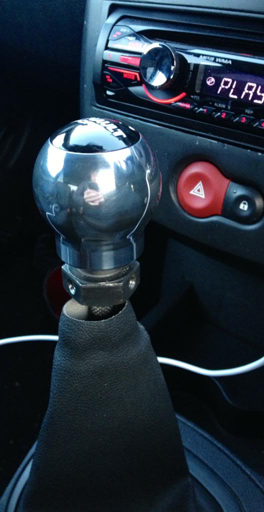

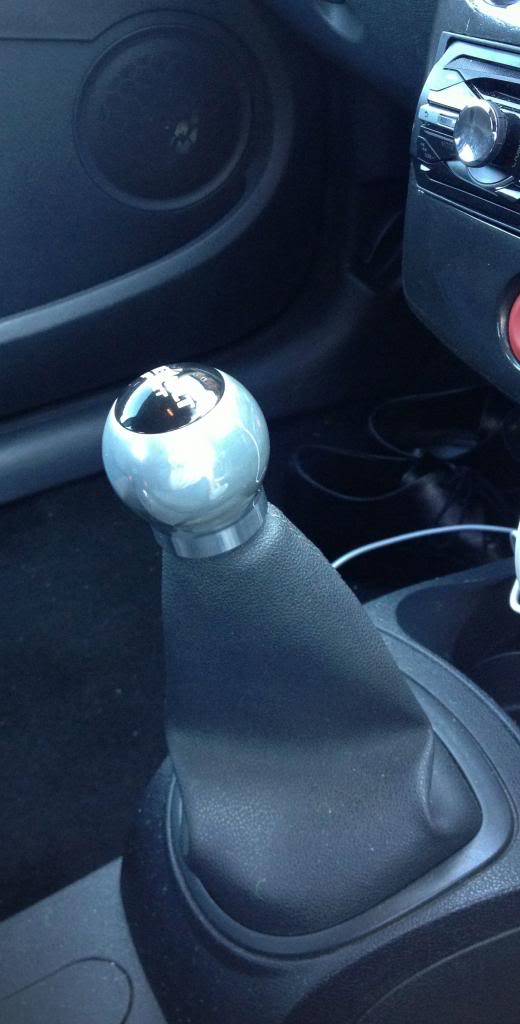

Sweet, what colour you sprayed them? I kinda know what you mean, got a big pay out for this years insurance so it's a little tight.Just bought a new steering wheel mate and painted the interior centre console and vents. Trying to make the interior a bit snazzier. Saving up money for a house so not sure what else i will do. I have two old wheels up for sale atm so whatever money i make off them i have allowed myself to spend on the car![]()

interesting stuff, how did the OEM one come off? I want to replace mine..
Yeah mate, they feel quality! Been looking/wanting a set for ages. Hard to find a set for under £270 quid :/ These needed a little clean but have come out brilliantly. The gearknob was nothing but a pain in the ass lol
