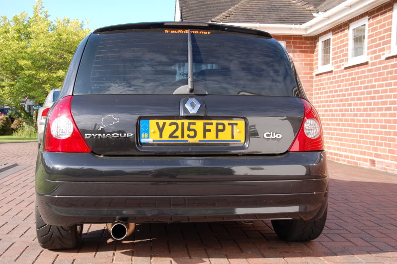

here's my supersprint 63.5 race system on the dynacup
i'll have to find better pics of the YS race, this is the only one i can find
IMO they look epic in the flesh, but i would say that! ;)
