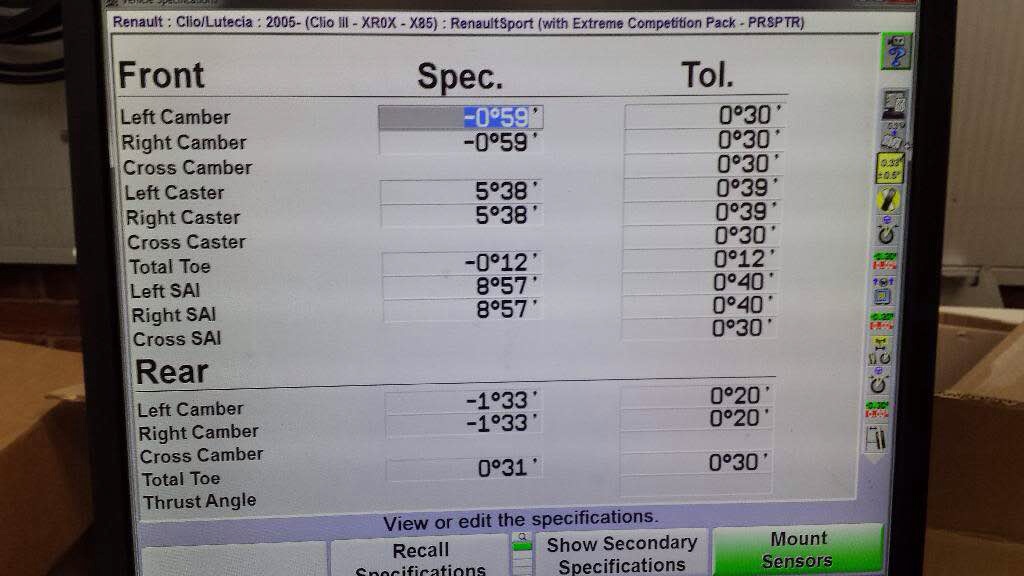

I have a 62 plate Clio RS200 (non-cup) and looking to lower it by no more than 20mm on Eibach springs. I’m completely new to this topic so what else do I need to ensure the garage do to achieve the correct set up? What else needs to be adjusted to take account of the 20mm lowering.
Thanks
To make the most of the springs get the car aligned to Reno spec, they can only adjust the front toe, front camber isn't adjustable. Adjusting the rear (depending on results) would mean adding camber / toes shims between the rear hub and beam.
See attached
