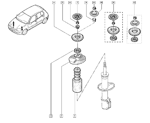

This was also the image I’ve found on the forum yesterday, but I can’t make out the following
- if parts 3, 5 and 6 are washers or nuts
- If part 4 is a rubber bush
My top mount kit looks the same as part 12, however I don’t seem to have part 9

Having a brief search on that parts site listed above, by winging it ??‍♂️, I believe it’s possibly these that haven’t been ordered or have been lost from my old set.

Here`s the page you want.
No 6 is the top mount bearing.
use CB1N for a 172.
https://partsouq.com/en/catalog/gen...AABfGP4k$&vid=1247&cid=2041882922&uid=3260&q=
  PH2 172
You either use the original nut & spacer with an original configuration top mount kit, or use modified kit 543A09780R with No 9.
