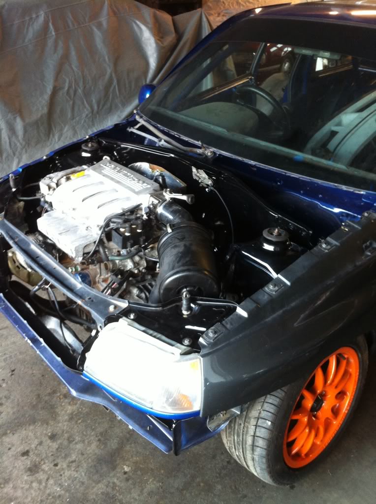

My 1.8 16v uses...
172 Engine, geabrox, driveshafts, hubs, brakes.
1.8 16v Subframe.
Williams Suspension. (You need to take 2mm off the 172 hubs to make the suspension fit)
172 Manifold, custom link pipe, 1.8 16v exhaust system.
