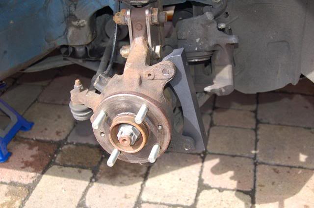

ok, I'll have to check the front hubs for an ABS sensor, could someone post a photo of what they look like please or explain it to me?
Keith185
Sensors with black cable.
Thanks to D4ve for photo ;)

Thanks for the photo Keith - the previous owner switched the hubs out so he could fit coilies, I'm guessing he binned the ABS sensor in the process. What kind of pick-up is there for the ABS sensor on the axle? Is it a ring of teeth like the ones on the rear discs?

Have a look to see if the holes are there, Im sure the cup just has the holes ready for it. The sensor reads the ring on the driveshaft.

Right, took a look at the front hub today and the ABS lead seems to be in place.
Perhaps there's somethnig wrong in the electric system, I'll get Renault to check it out at the next service
