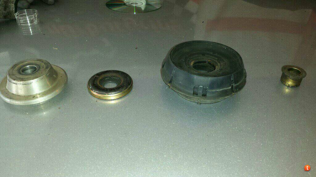

Ta Technic 1.2 16v ph2
These are the bits youll need in order going from left to right
If you've got all these then youll be able to swap straight over
