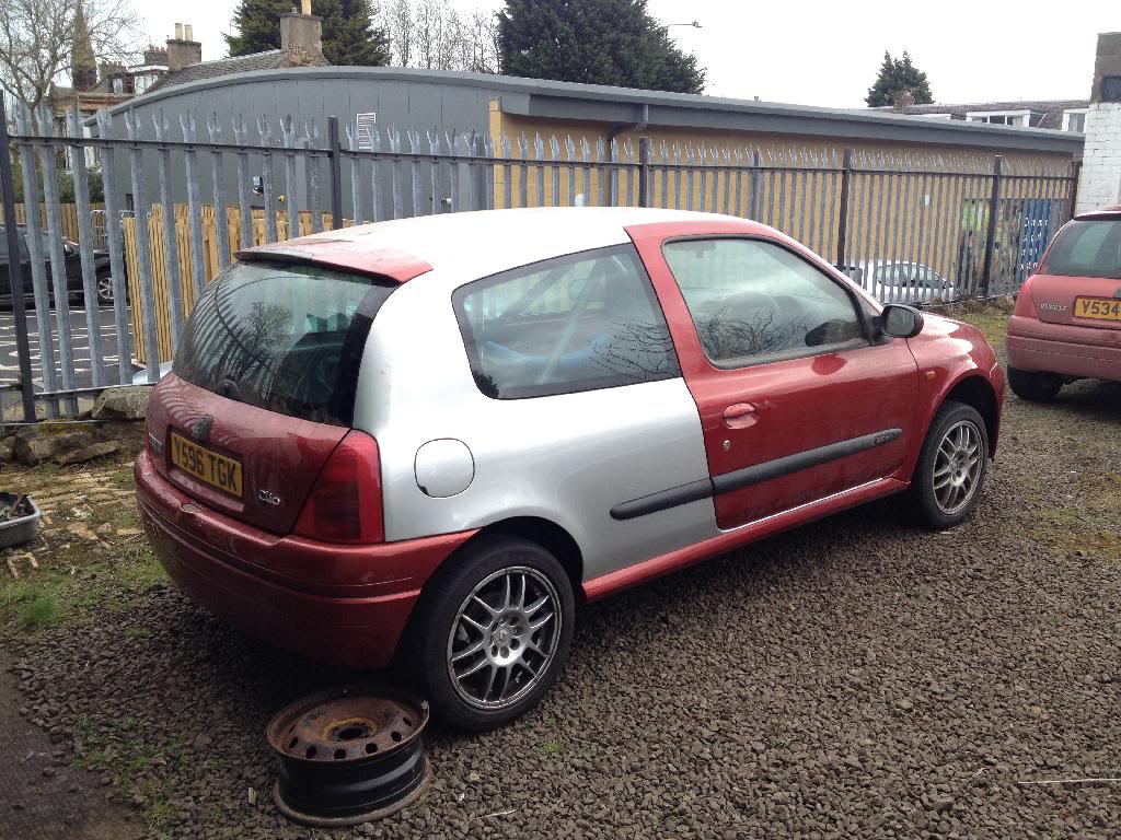

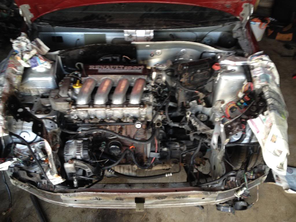

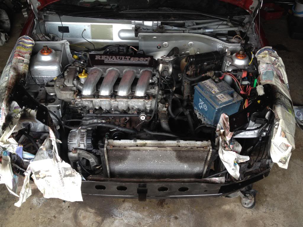

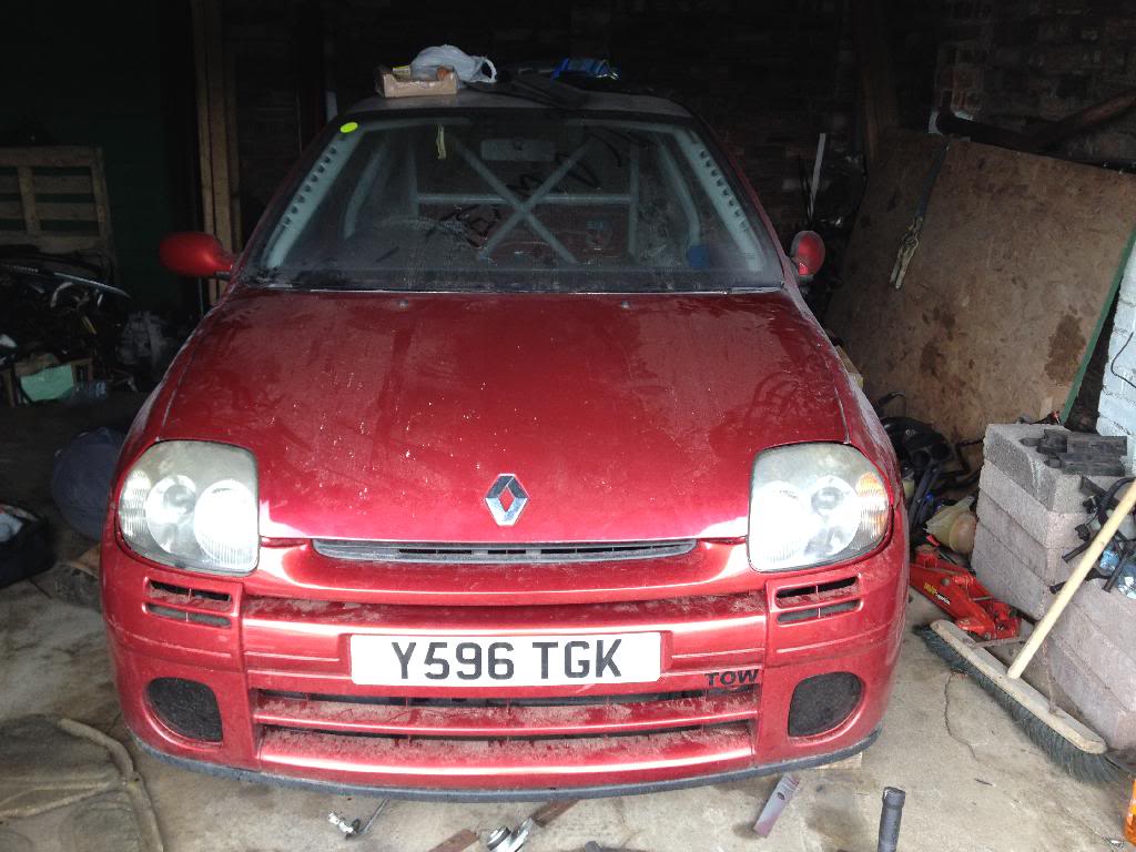

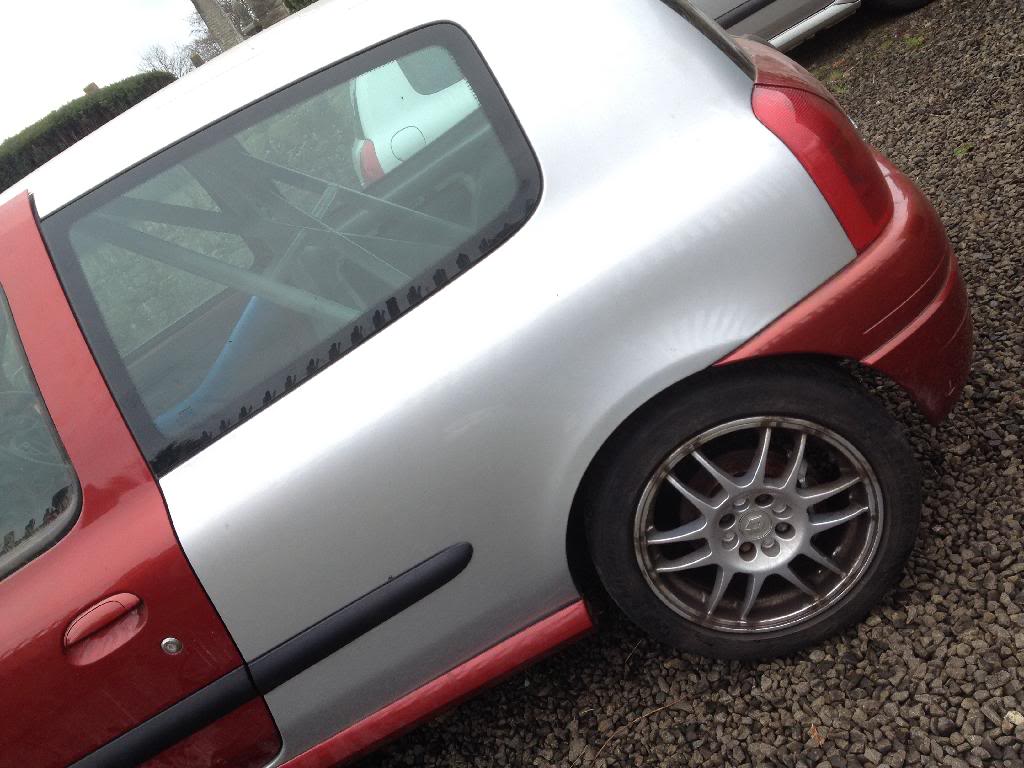

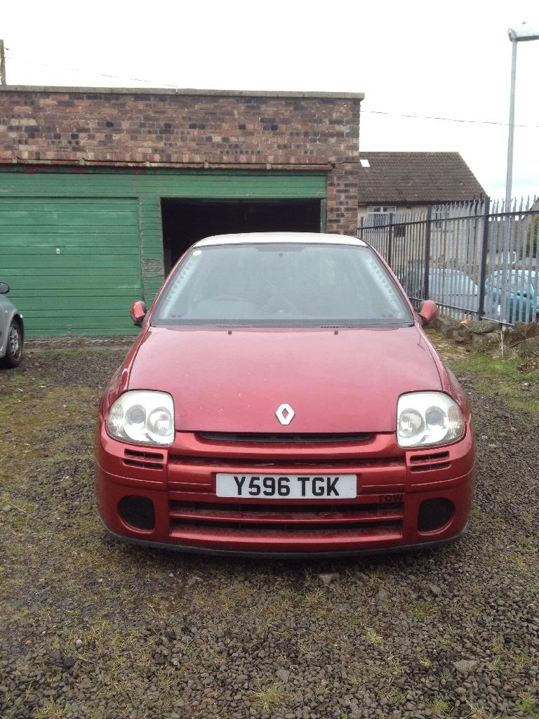

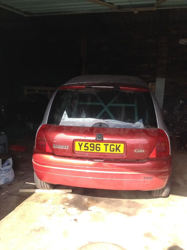

Well I'm sure you all forgot about this or thought we had again but nope, we haven't. We did nowt from the last update at the start of Jan until the 30th of March when we started getting front end sorted properly which was far more involved than we expected. Whilst Dave tinkered with that that I hid the wiring in the back and stripped out all boot wiring except the 3rd brake light.
Then the next Saturday morning it was a bit more of the same, lots of grinding, some drilling and some, er, well you could call it fabrication but it wasn't that. But it now looked complete and the fitment doesn't look too bad at all. For a track car its pretty damn good in our opinion!

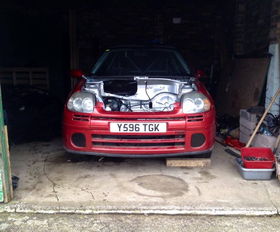

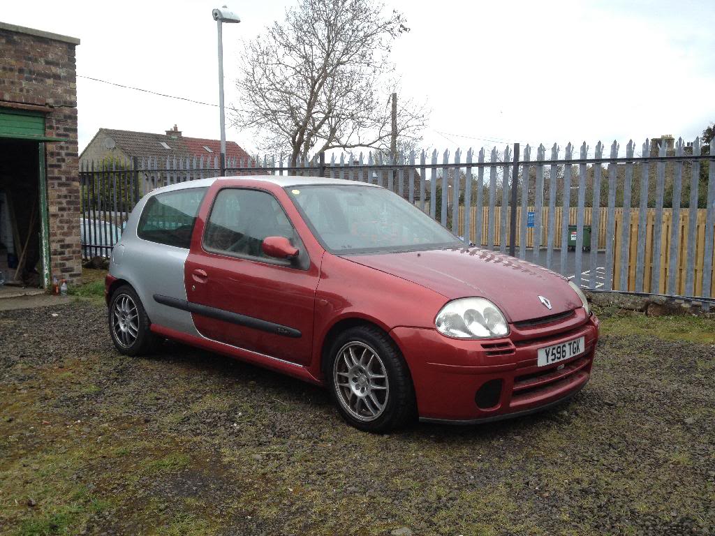

The following Saturday morning (spotting a theme here??) we started off by meeting at the scrappys where we picked up a non abs brake pipe that we were missing and then headed to the garage. There we fitted that, fitted the last couple of brake line bits like the rear compensater and braided rear lines and then filled and bled the whole system. Got a really good pedal on it now.

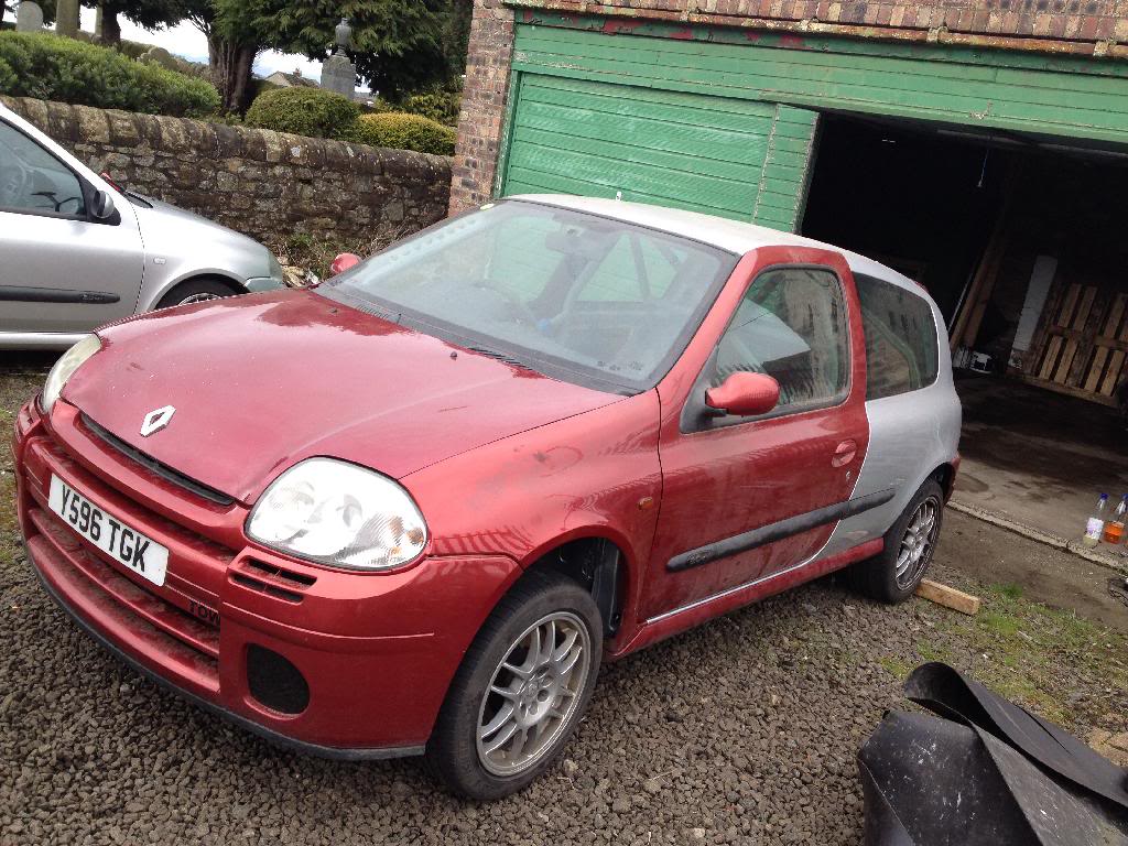

We then chucked on the coilovers front and rear, still set at the same height as before but obviously still no weight in the front end so it now sat like this.

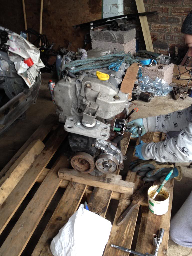

Which now takes us to last Saturday morning, no work on the car as such but we did load up the engine into a van and take it to Rentec Edinburgh (http://www.rentecautocare.co.uk/) who sorted out the rocker gasket, sump gasket and full timing belt kit.
No pics of that but today we got up and got through well before they opened and picked it up, finished, with a couple of extras thrown in and had a good chat with Bryan, we'll defo be using them again, great price as well. So we got it back to the garage, went and picked up the clutch, box fluid, etc etc and came back and got started for a couple of hours this afternoon.

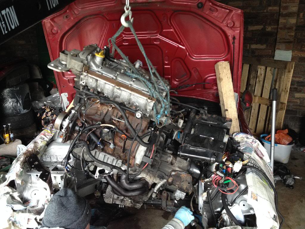

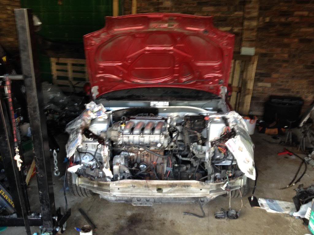

Started with Dave fitting the clutch and me working on the other side we quickly got the box, timing covers, water pump etc on,
And then put the engine in

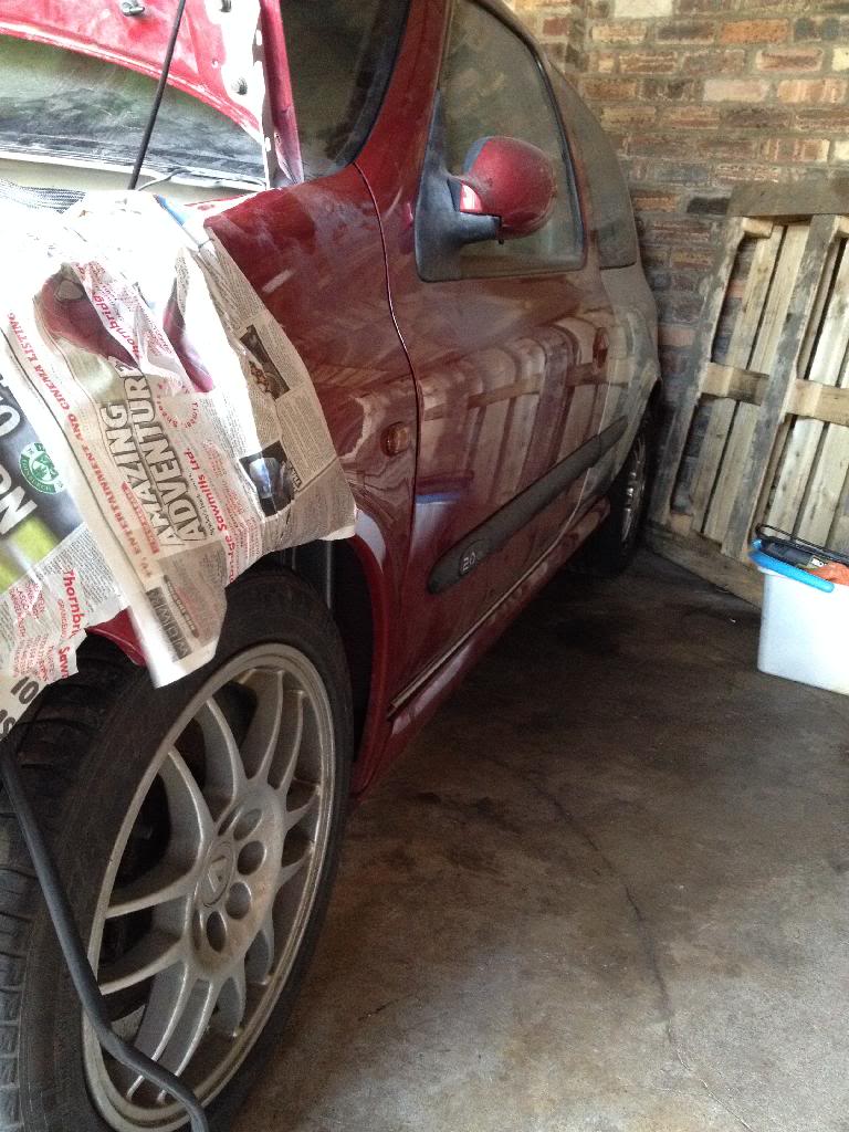

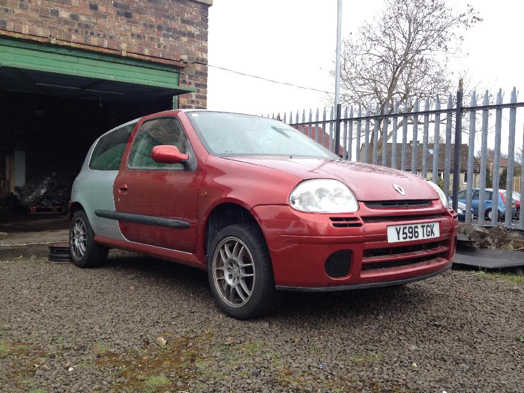

And then just tinkered away with wiring, cup setup, engine mounts, exhaust manifold and decat and all the other jazz. Left it sitting like this now
And it has obviously brought the height down a bit!

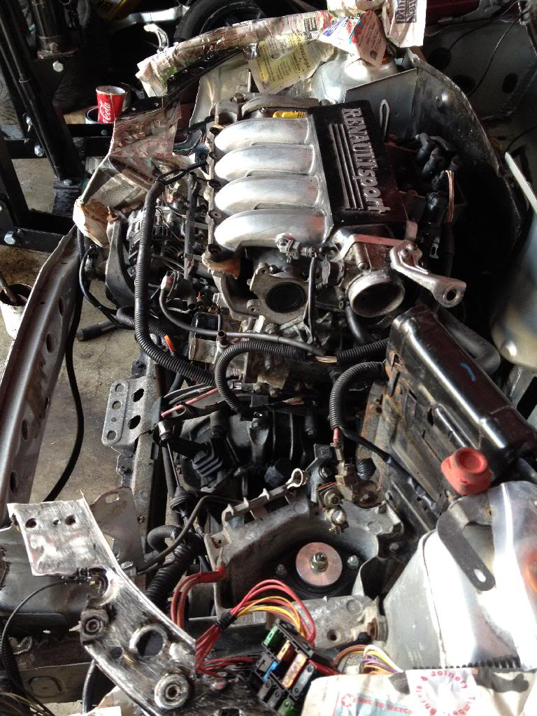

Went down all by myself today :(

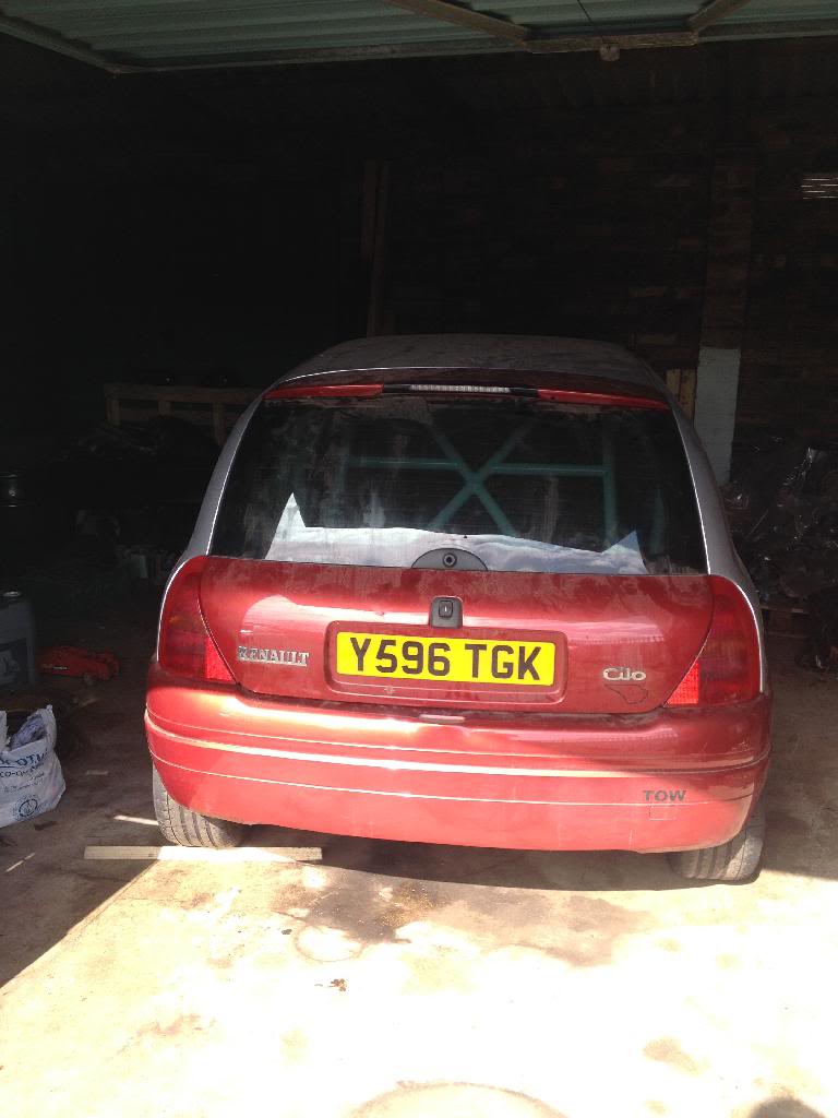

Was a bit faffy and not the most successful of days but its still closer to being finished than it was this morning! So started off with loosening the manifold as we'd forgotten to put the dogbone mount on. So chucked that on and refitted the manifold. So now its running the 2 vibratechnic mounts, purple powerflex dogbone and standard 4th mount. Its f**king solid!
Moved onto to the exhaust, fitted the lambda and then cleaned up the orbisoud joints and fitted the centre section. But the decat must be ph1, 1 lambda length as its about 2" short of the centre section and when you hold the backbox onto it its sits well behind the bumper. At least Dave as a sports cat that will fit so we'll just use that instead and get another decat at a later date. Irritating but not the end of the world.
Every since we refitted the steering column its had a huge amount of play in it so removed that as we've got another one on its way. Then got the drivers wiper off but the passenger one is absolutely solid. My usual tricks didn't work so its now covered in oil and I'll try again. Just wanted to fit the scuttle panel really. Filled the engine with oil and then put the rad and pipes on. Can't find the small one for the top of the coolant bottle and we need to either get a u-piece or fit the heater matrix before thats fully finished.
I did however then connect up the battery and checked that the immobiliser switched off. Which it did :D:D Didn't crank it as Dave wasn't there and there's no fuel anyway.
Just one pic as I'm lucky enough to own an iphone that hates being outside and cold!
