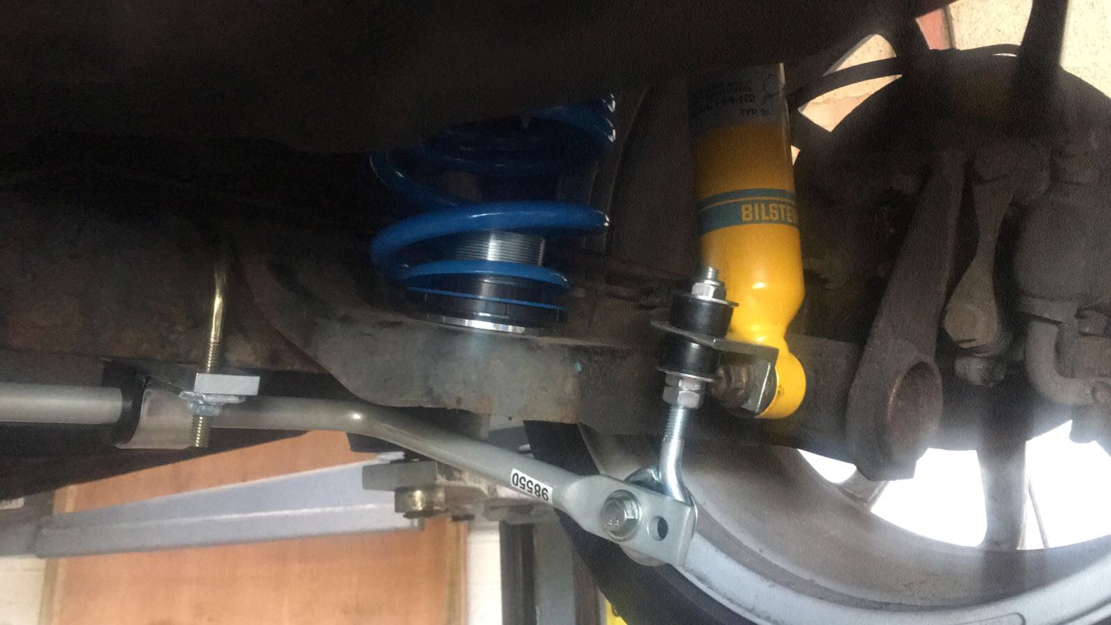

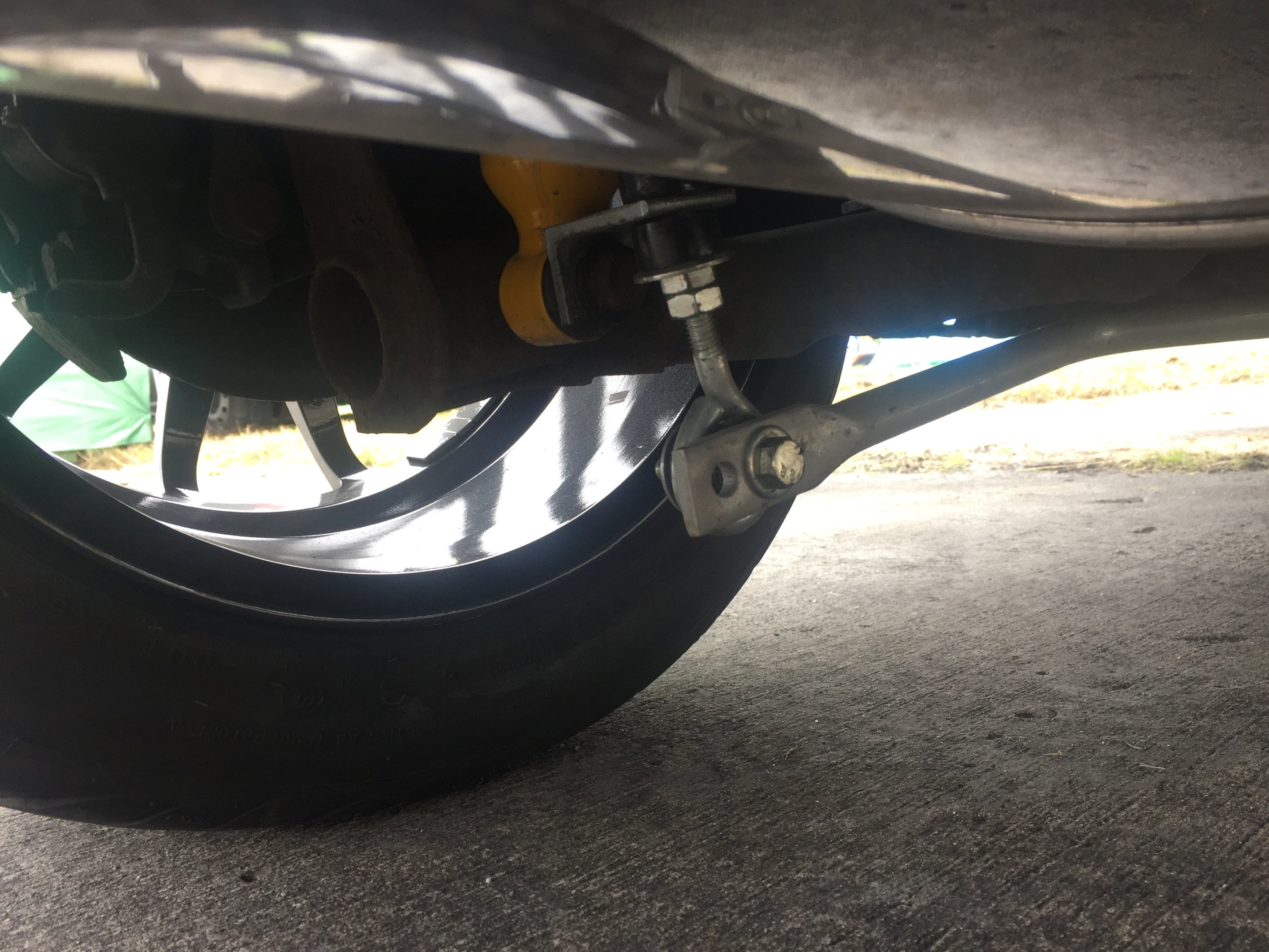

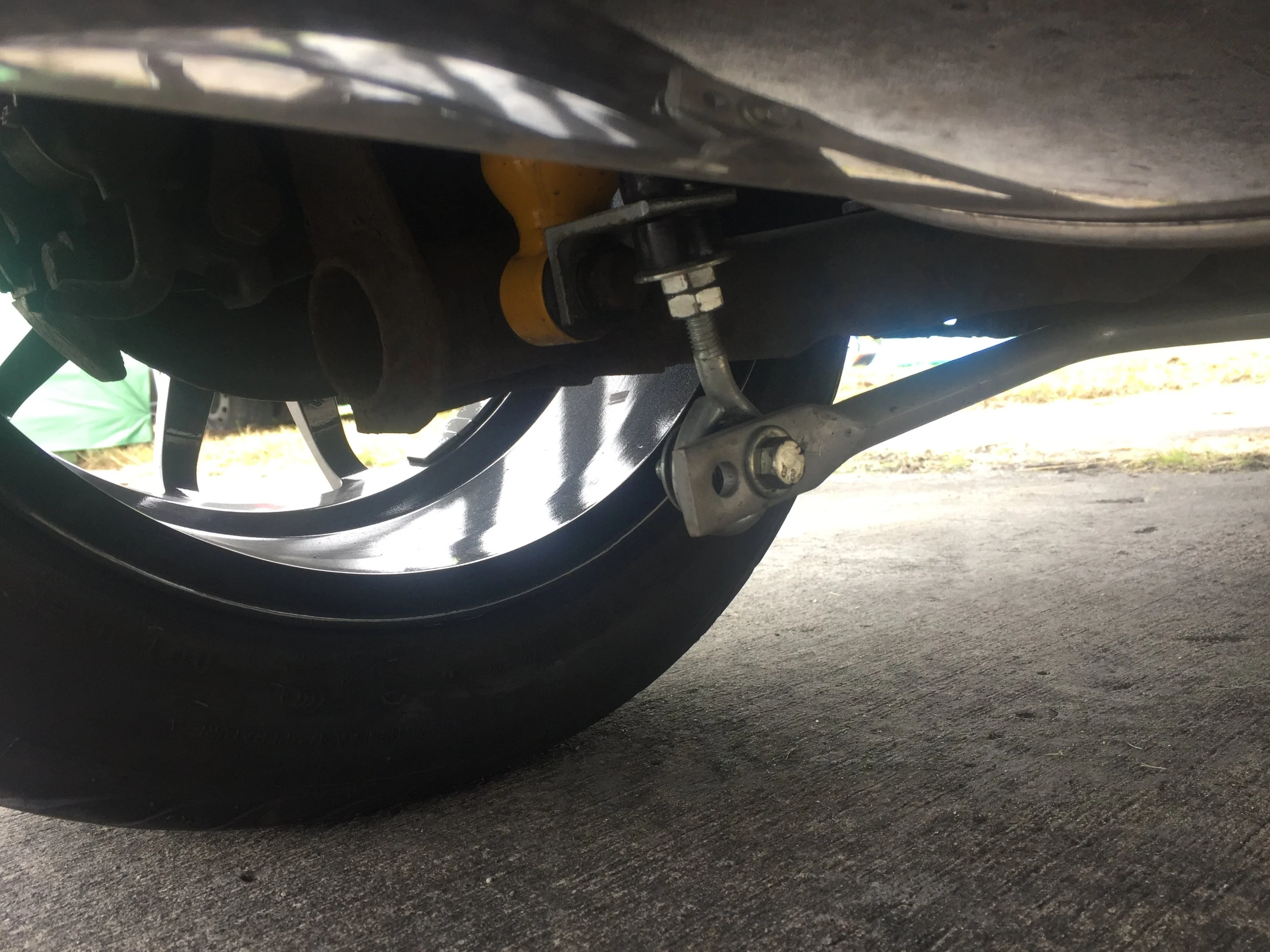

So whiteline supplied a Whiteline arb ,rear beam bushes and camber bolts.

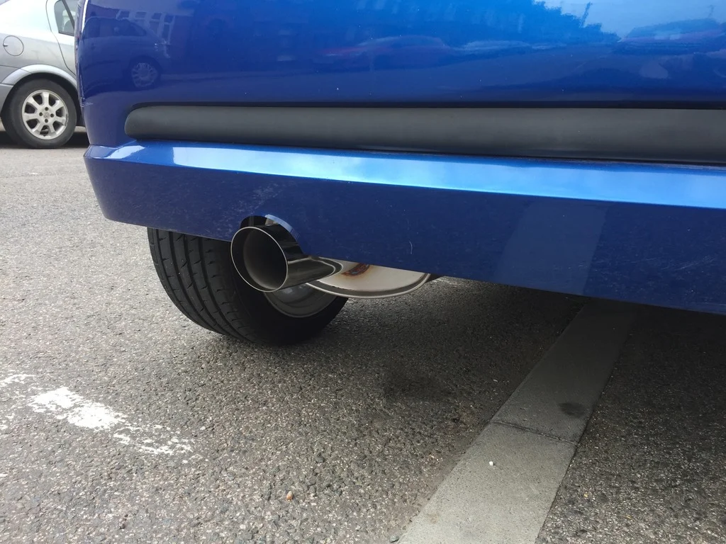

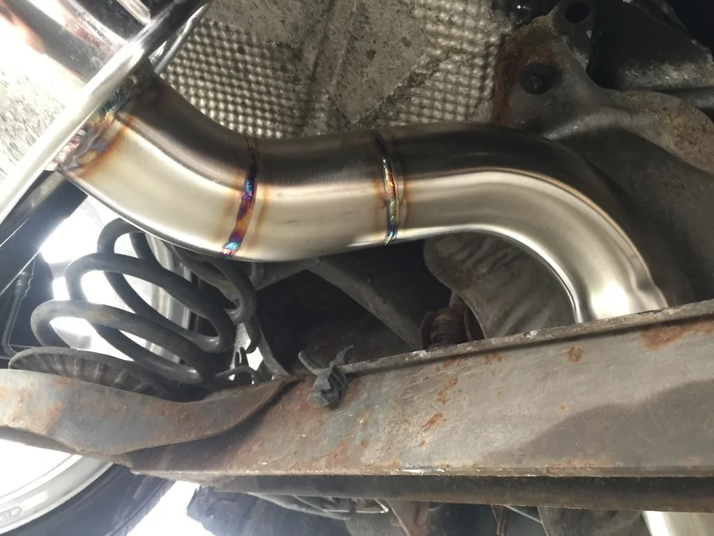

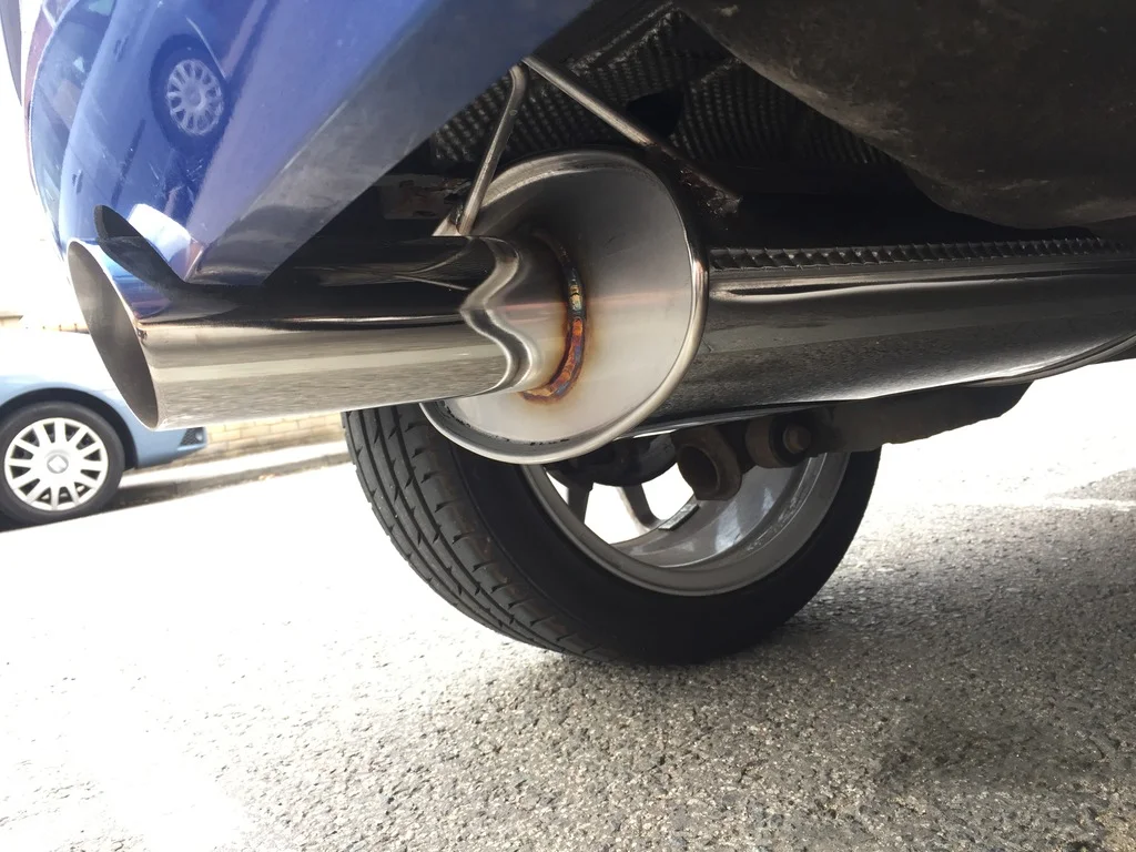

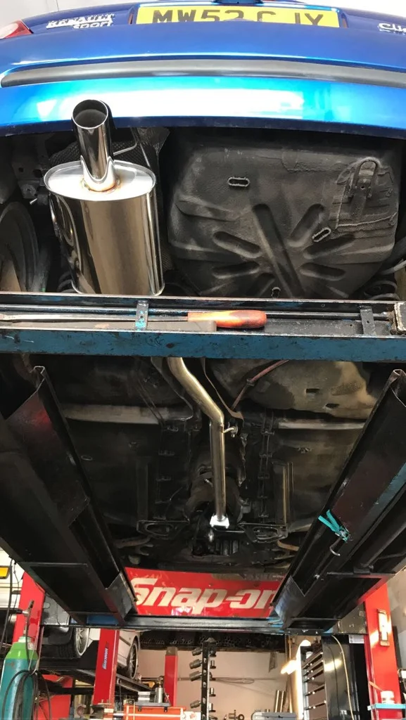

Emp performance built a custom 2.5 exhaust system which would pass sound regs without a problem.

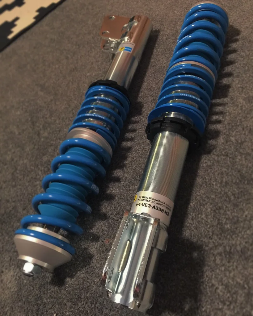

After talking to whiteline about dampers they recommended bilsteins b14 from chevron motorsport next day on door step arrive my dampers.

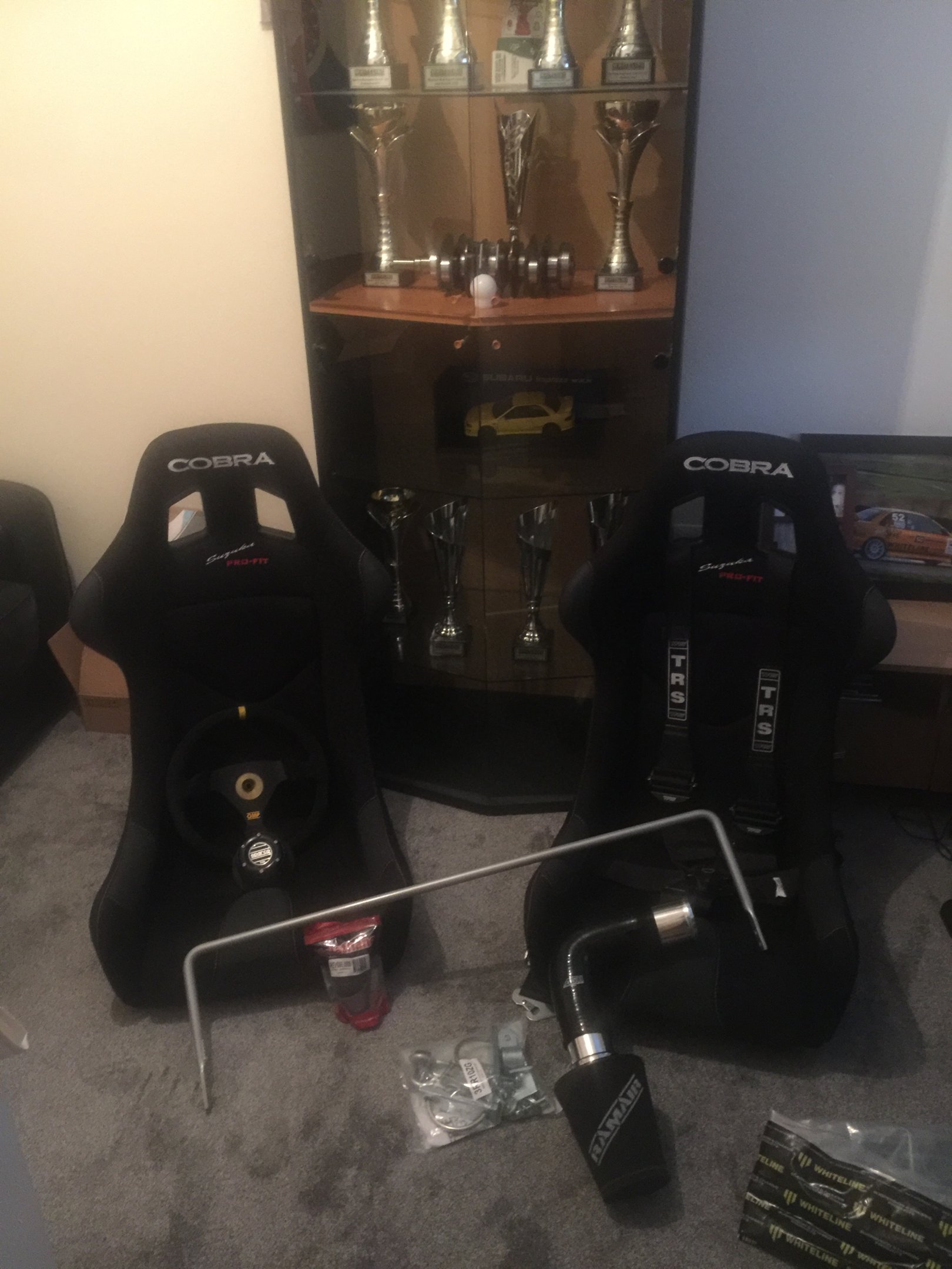

So after talking to a couple of mates they recommended the pms solid top mounts and strut brace we ordered them and wow a good looking but if kit are these.

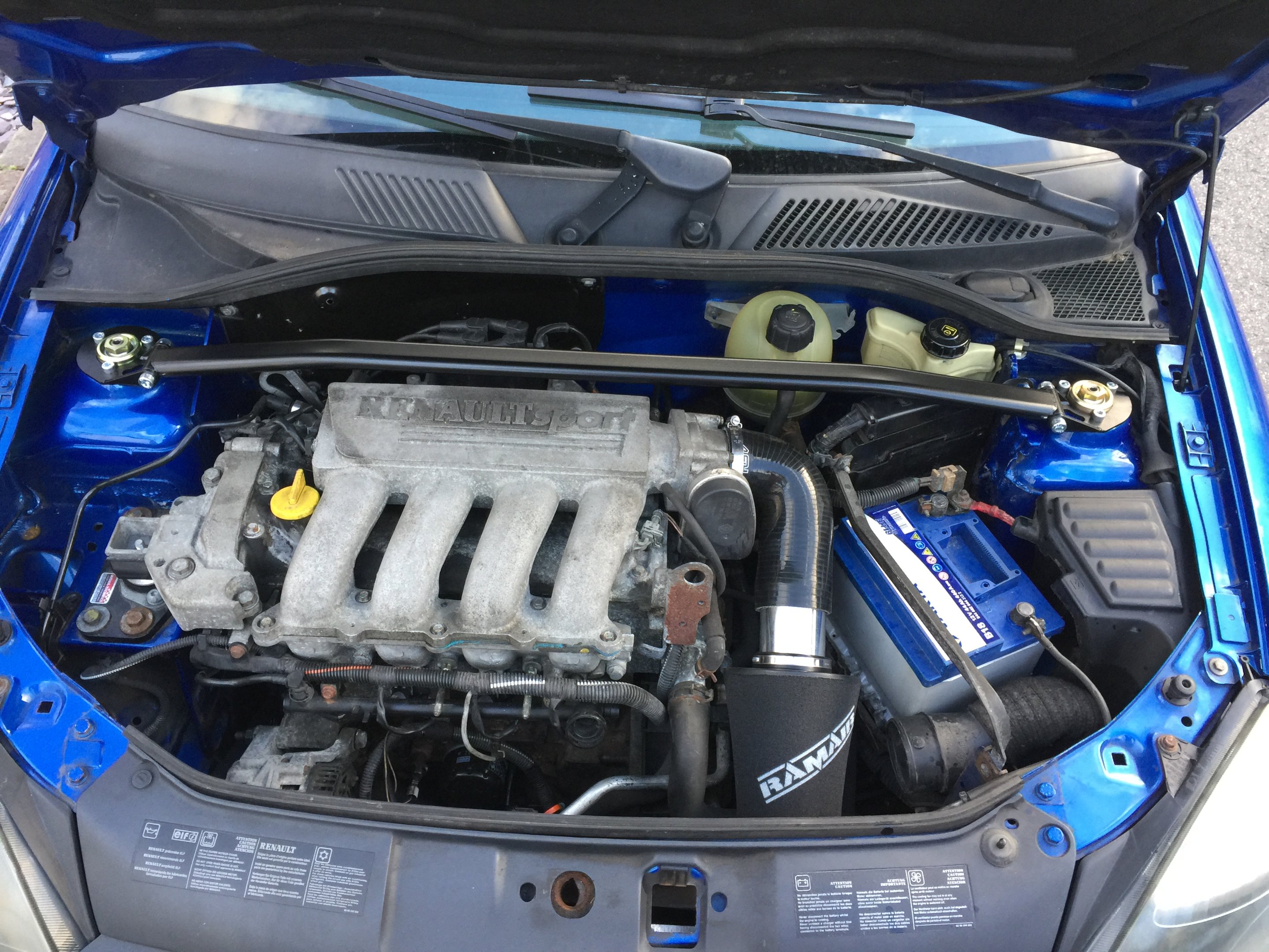

I wanted a cheap induction kit so after having a read up on here I ordered a ram air filter, alloy bends and silicon joiners jobs a gooden for £50.

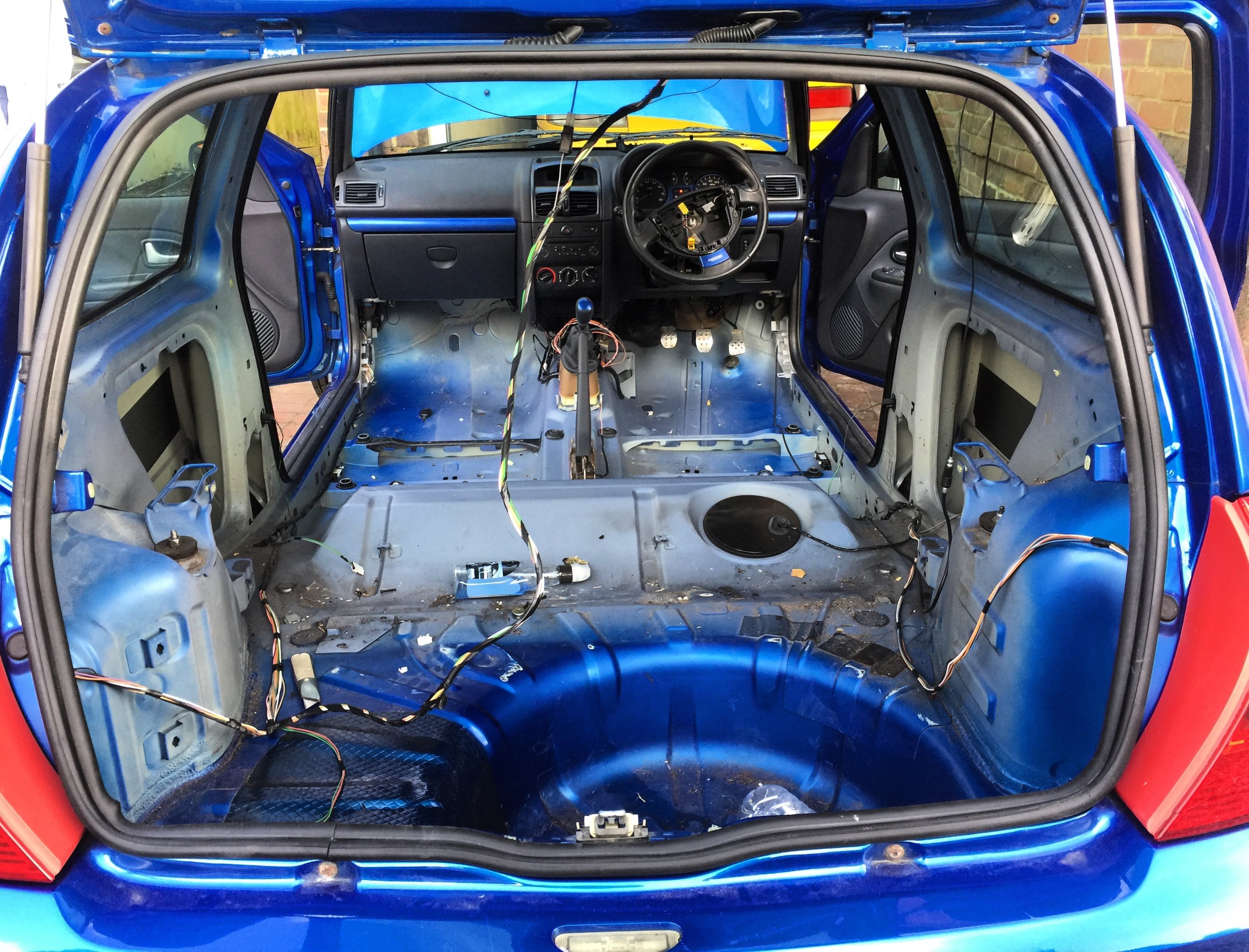

Removed the new cobras and harnesses that were fitted to the race car last year to soon fit into my clio.

Bilsteins, top mounts ,camber bolts ,geo ,engine mounts , arb, rear beam bushes.
I collected car a couple days later and wow what difference best mod I’d say was def engine and box mounts for sure.
