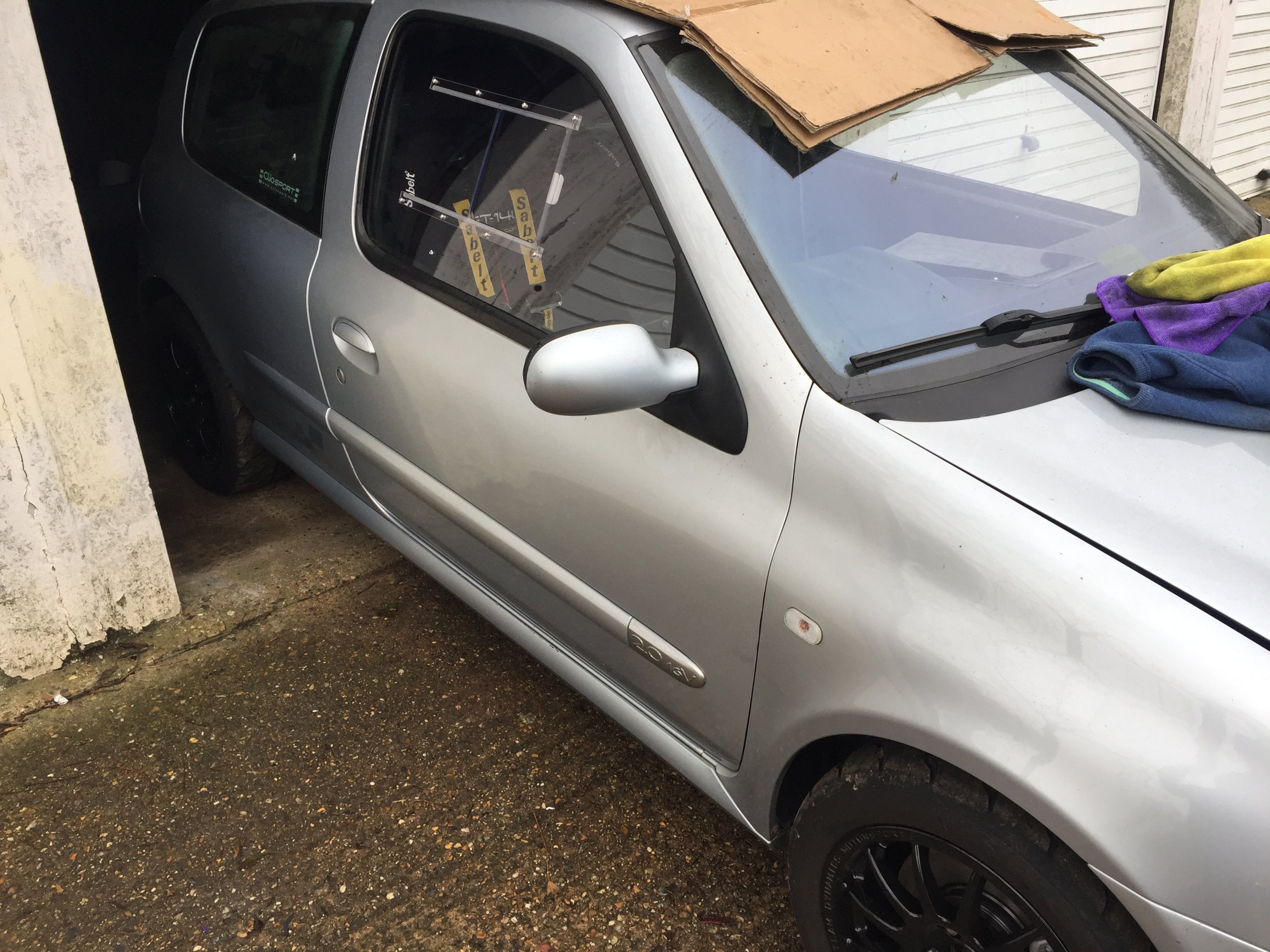

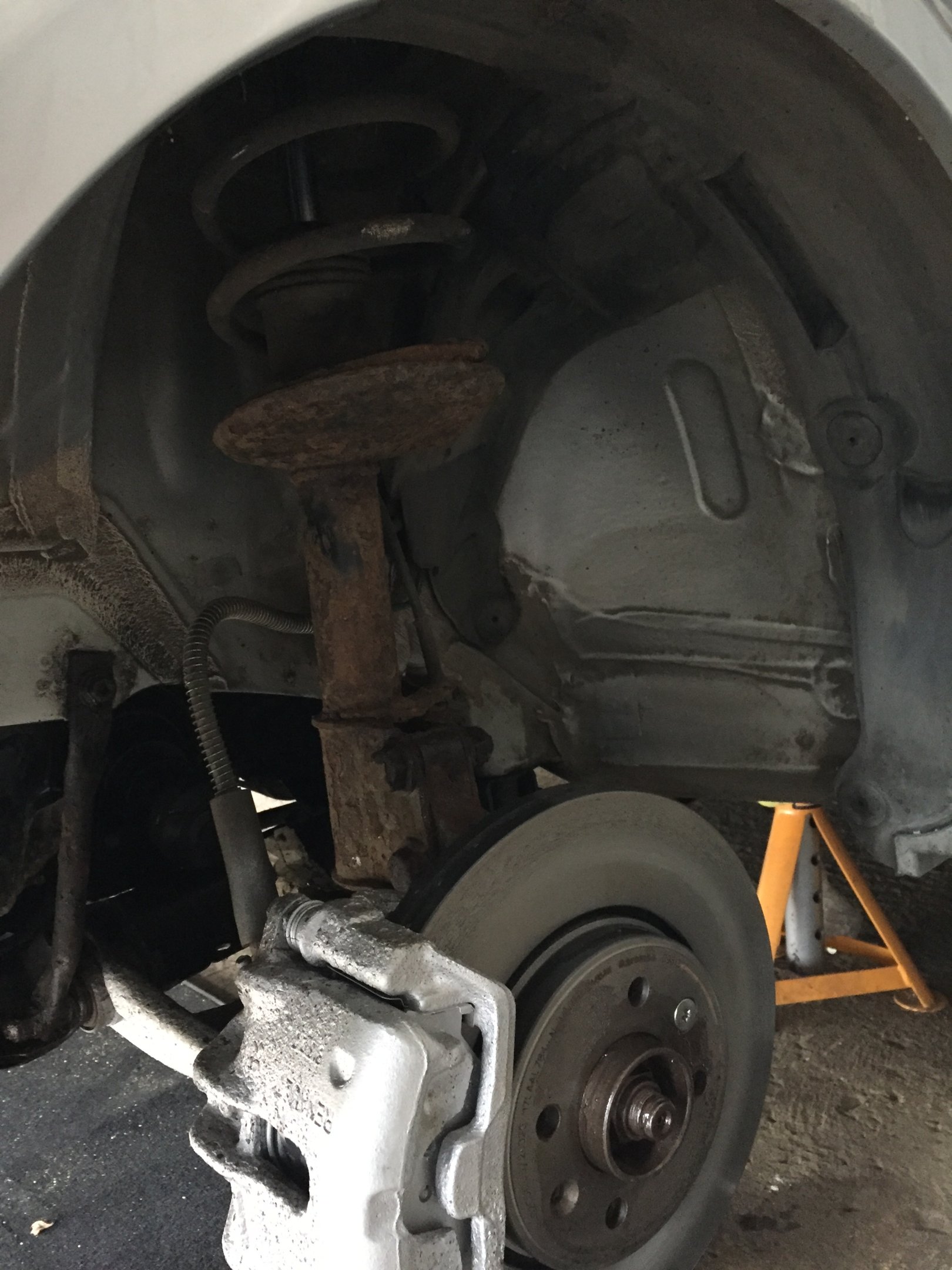

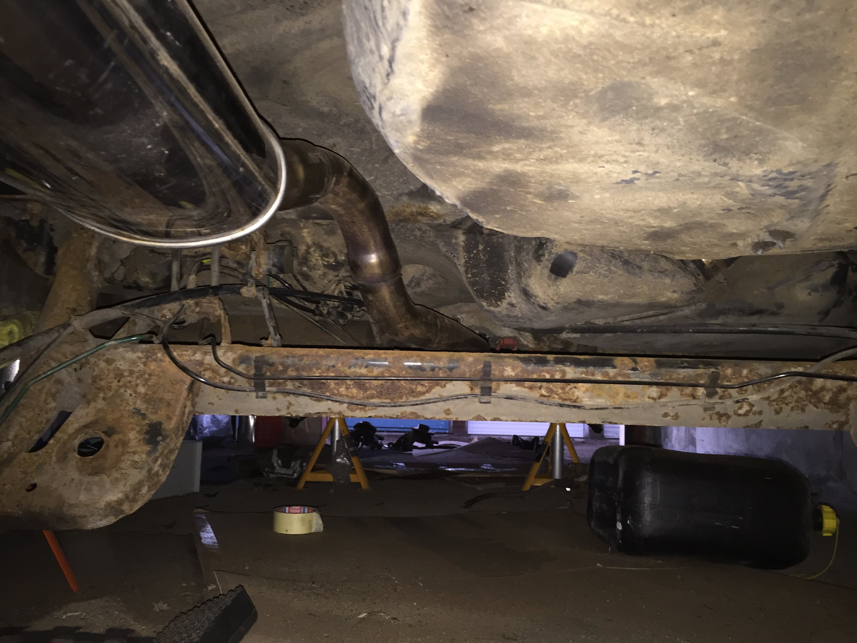

Onto the build before i go on and on. The car is a 2002 Clio 172 in silver brought as the air bags had gone off due to hitting a pop hole, sub-frame, wish bones and front chassis arm are straight.

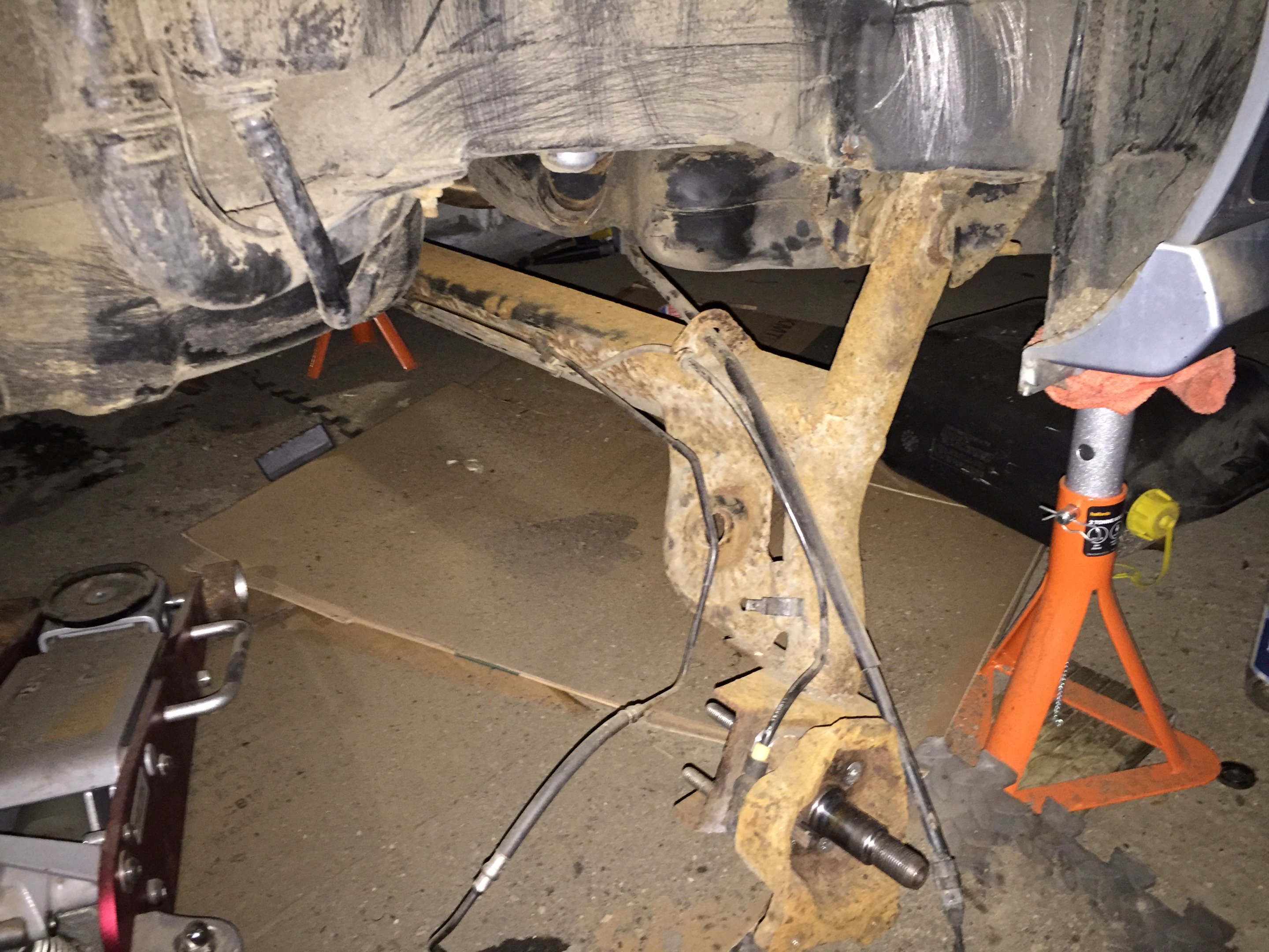

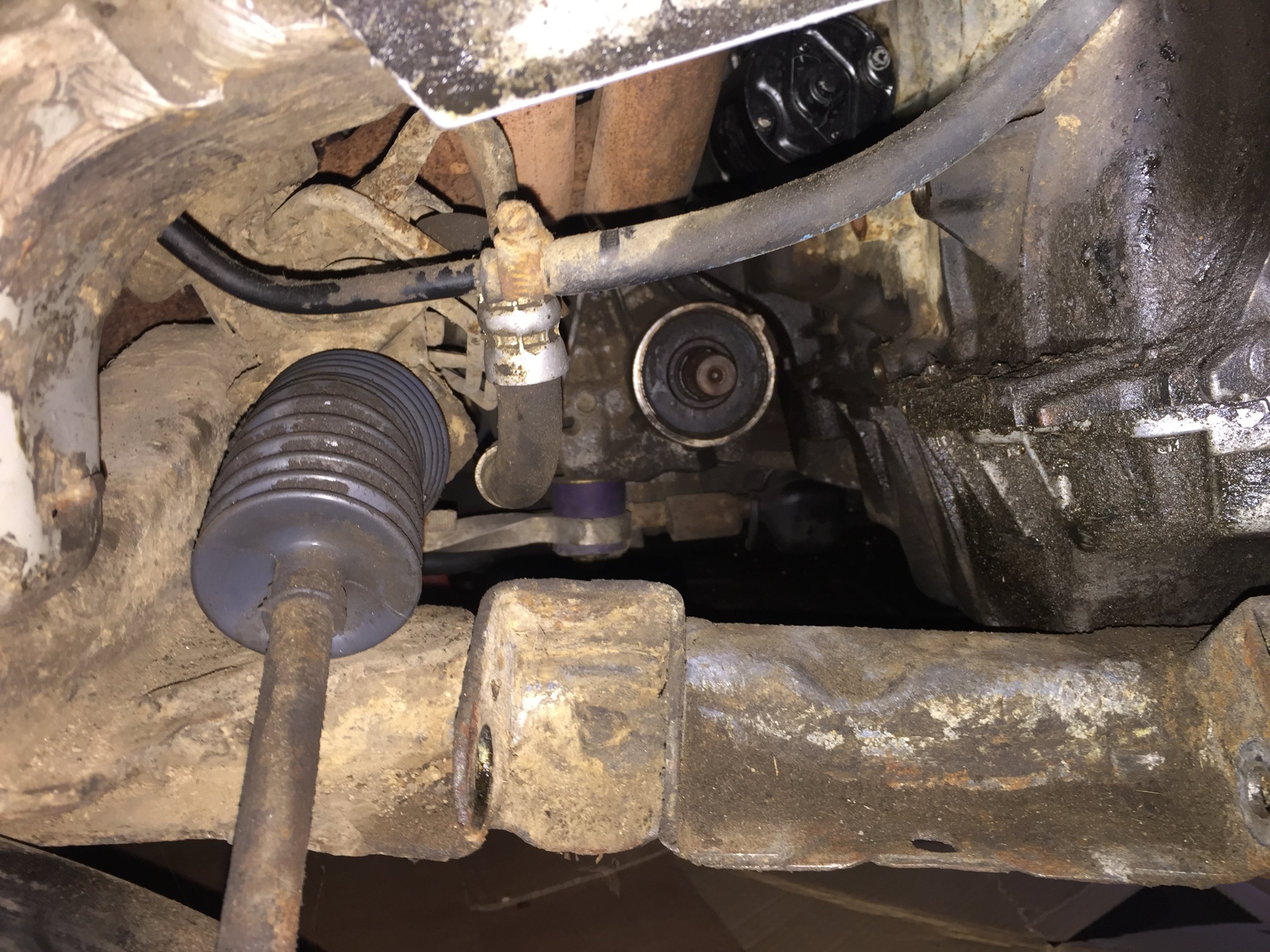

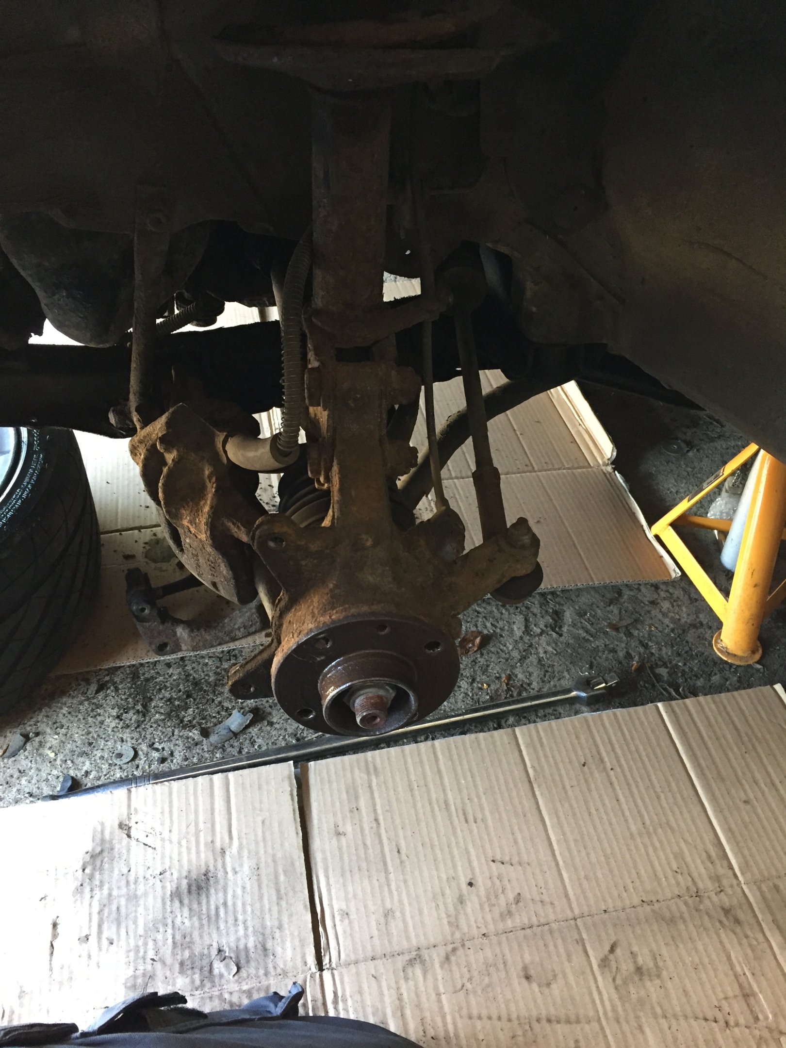

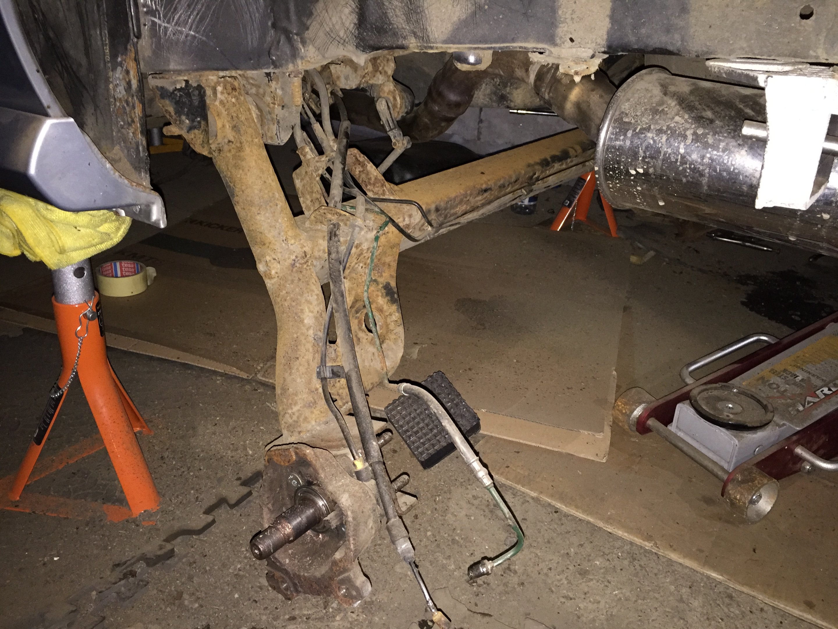

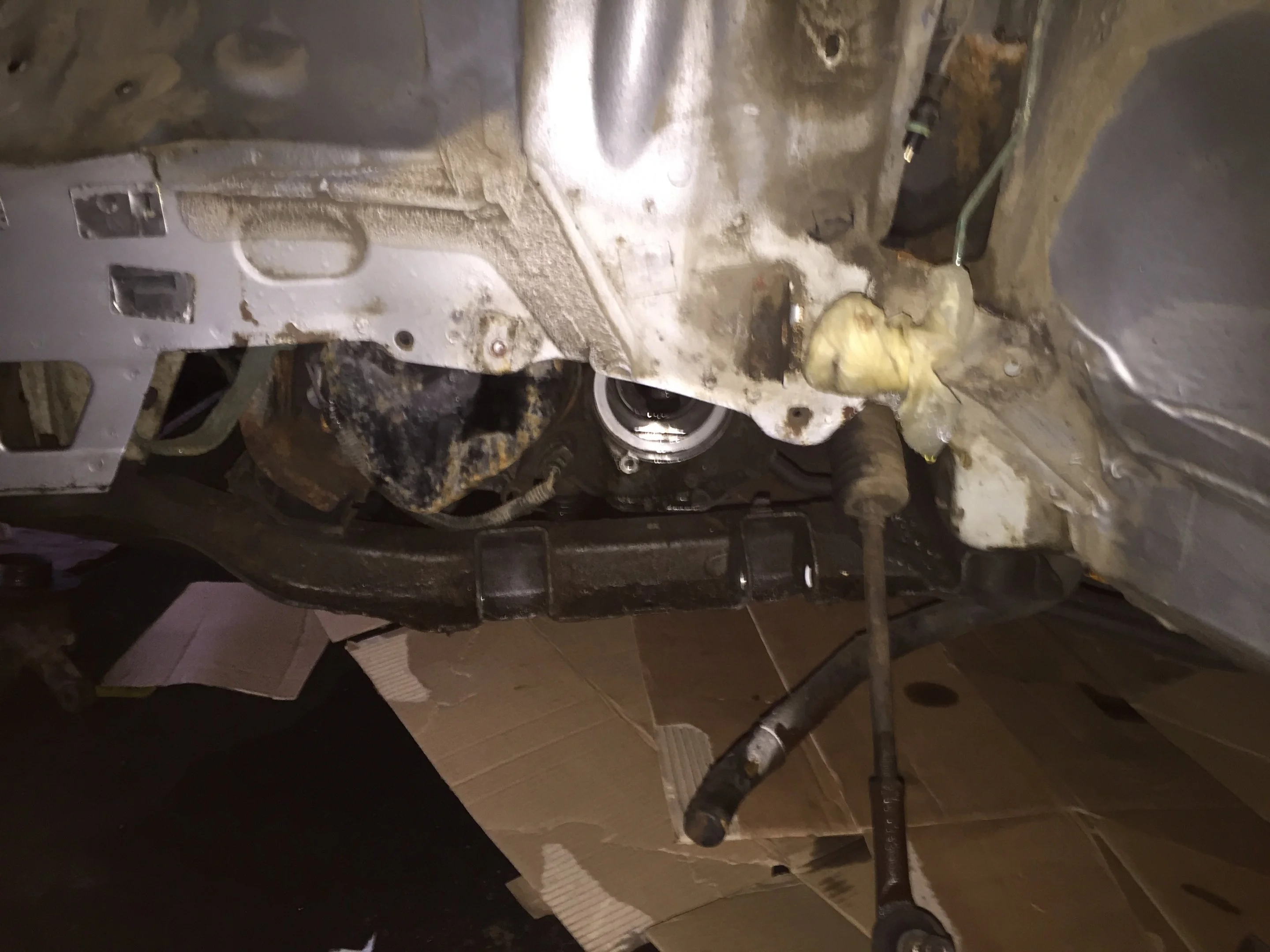

At present the car is up on axle stand with the rear beam, sub-frame, front and rear hubs, calipers and anti roll bar are off and at the powder coater.

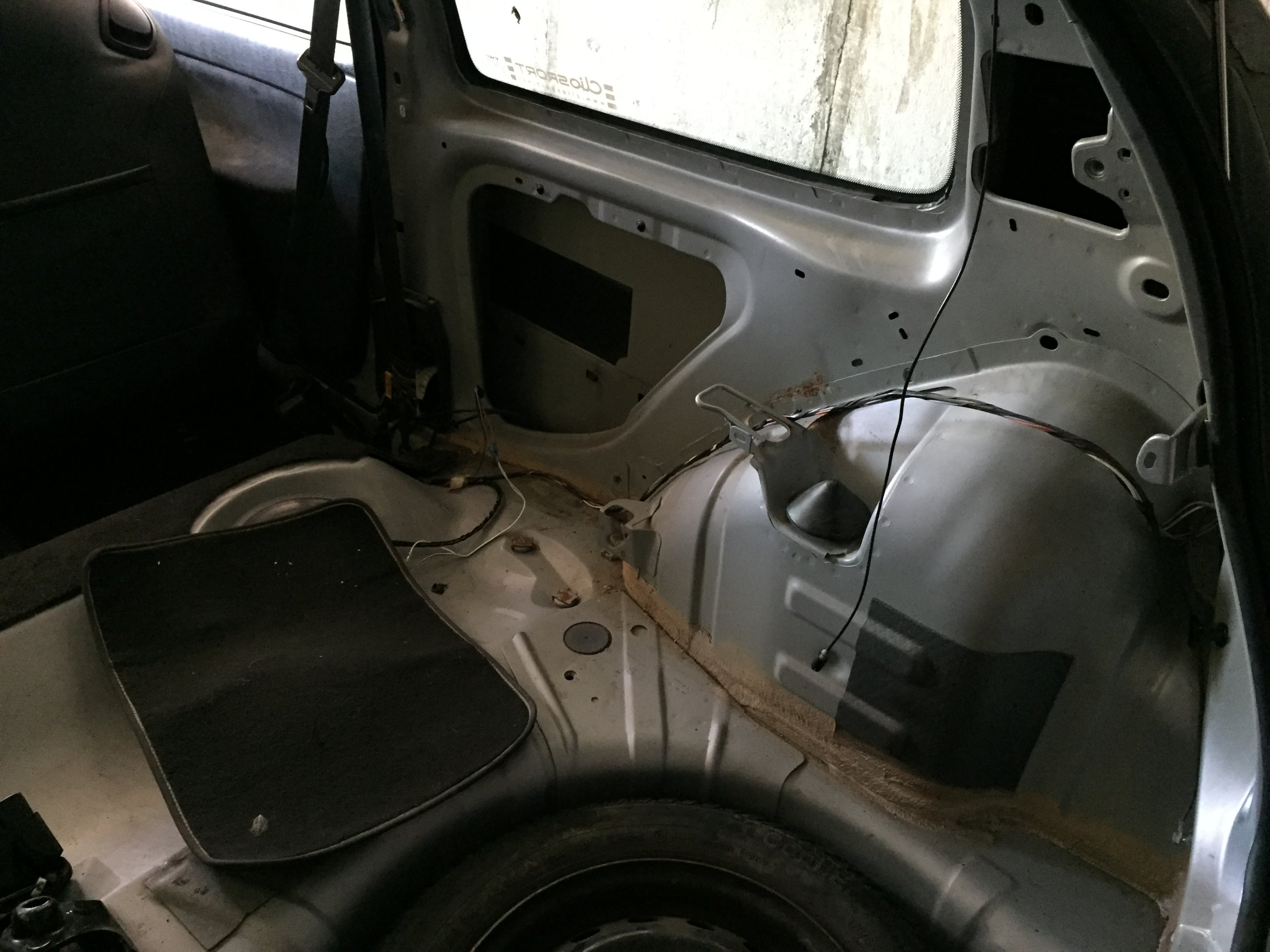

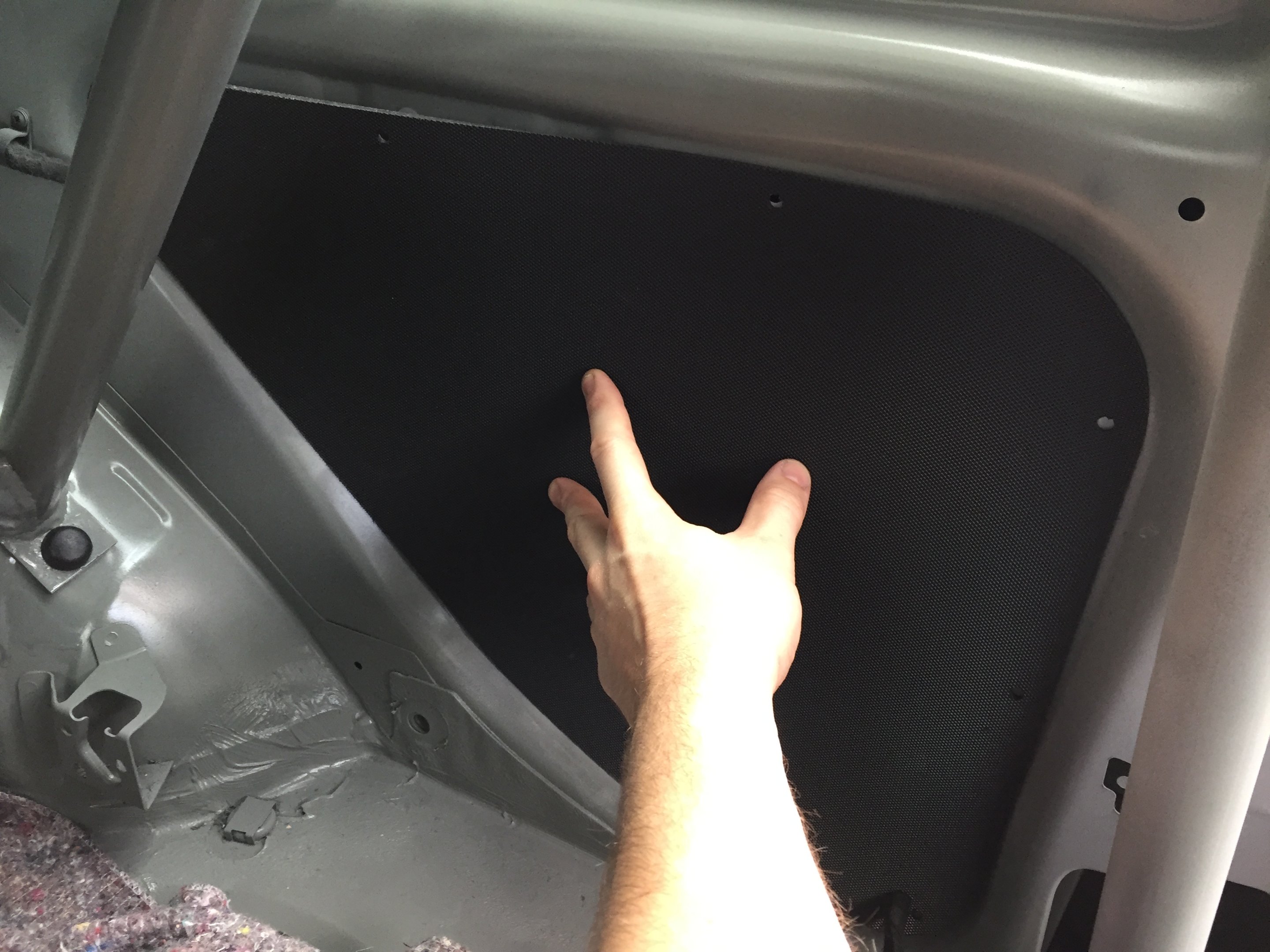

Interior wise has been stripped and painted.

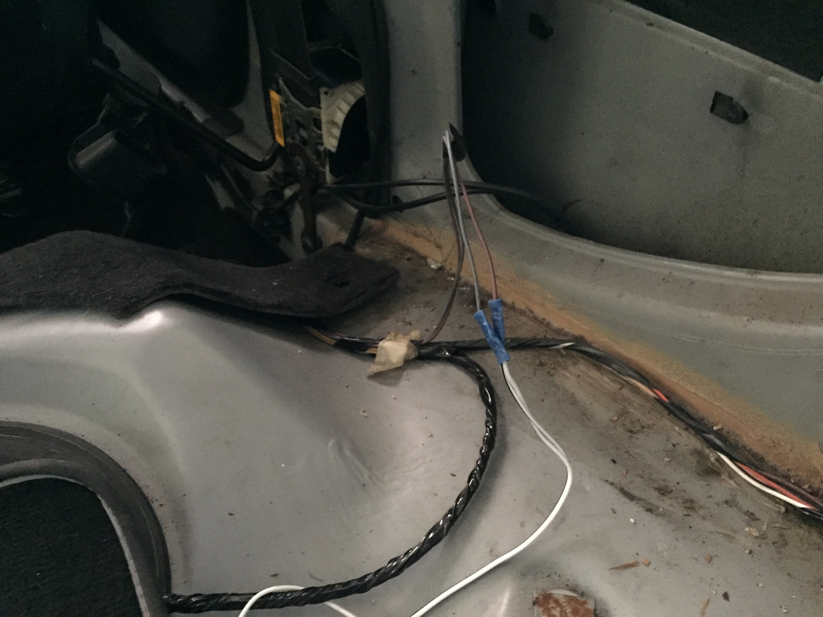

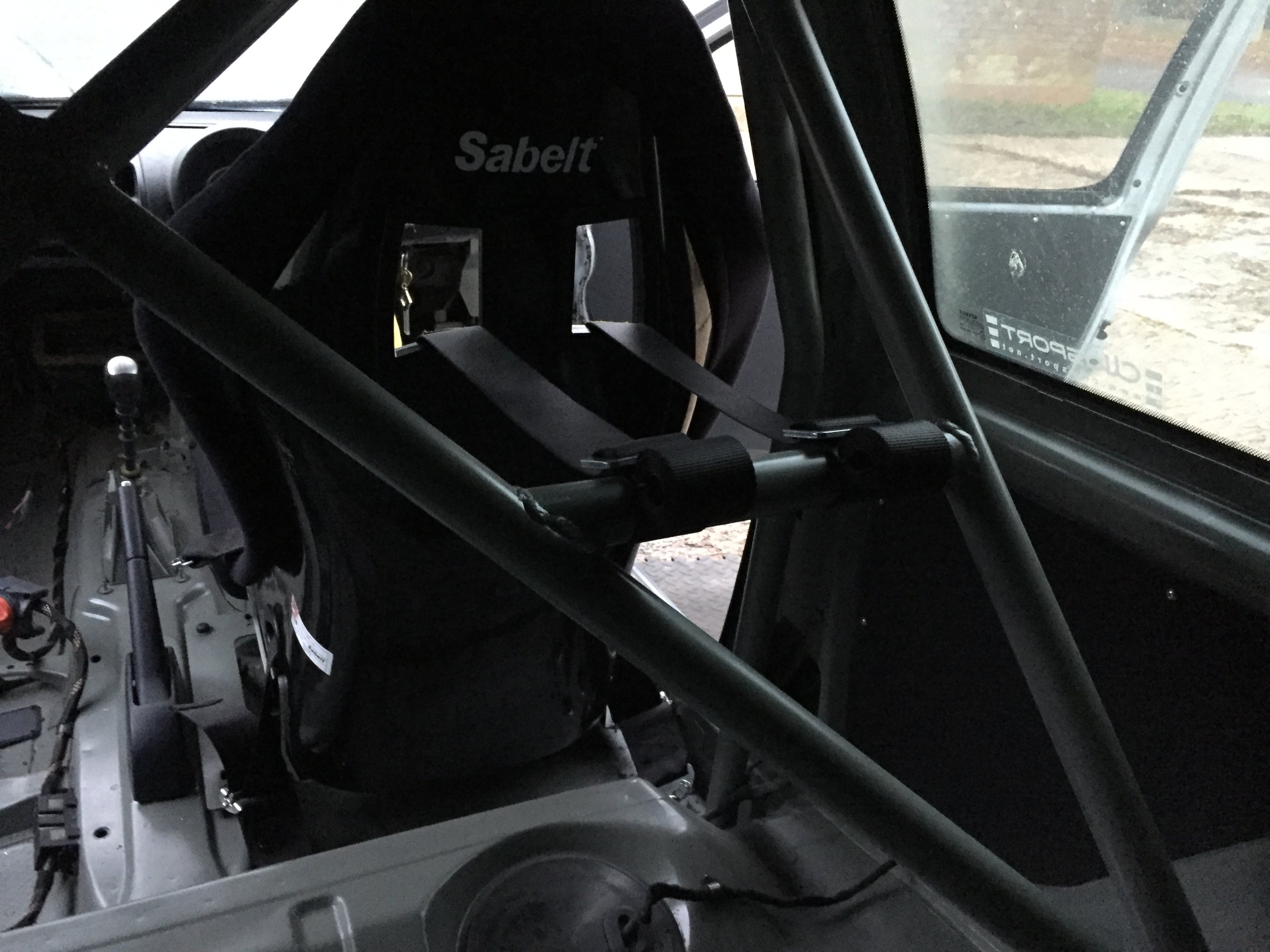

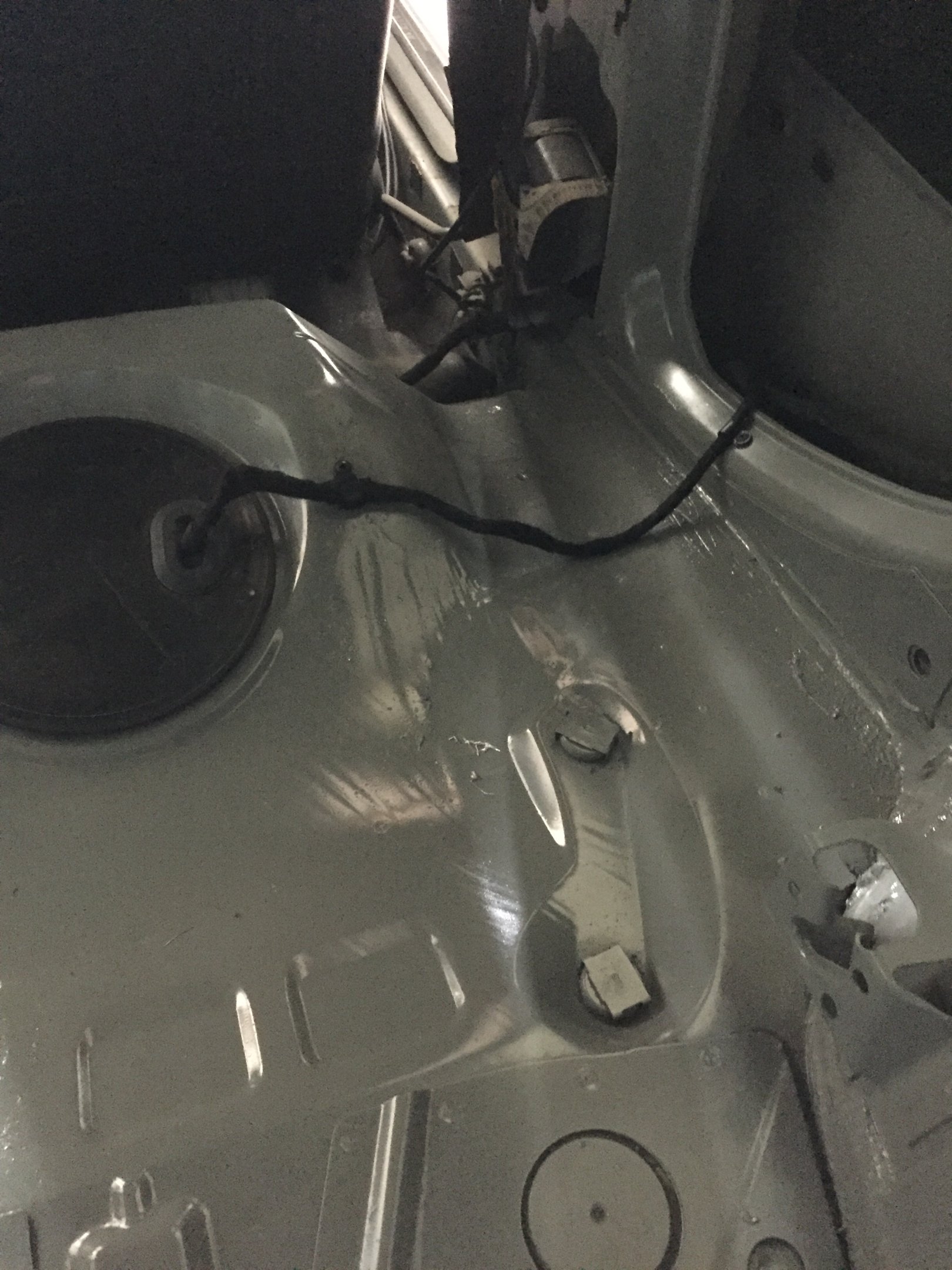

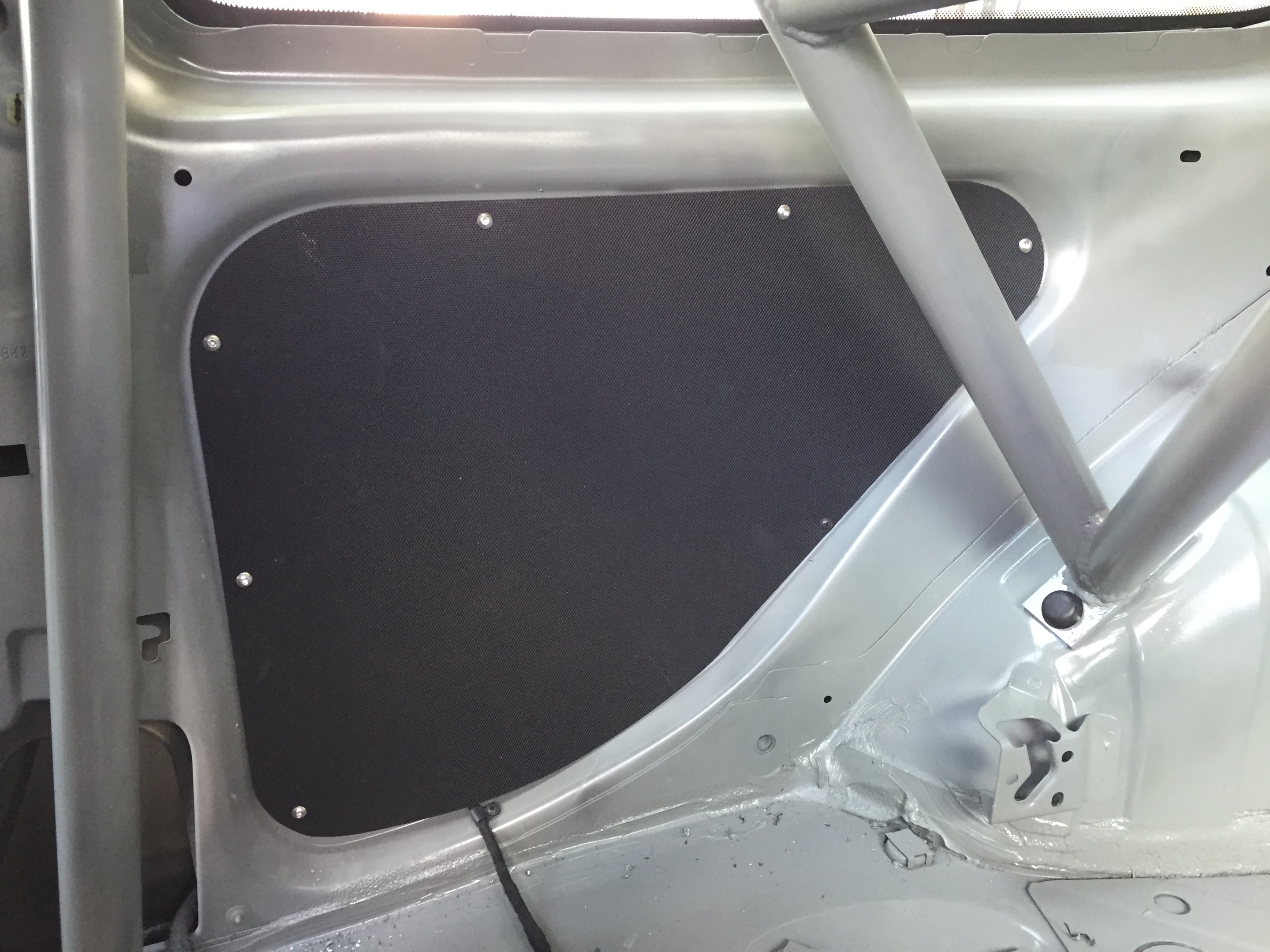

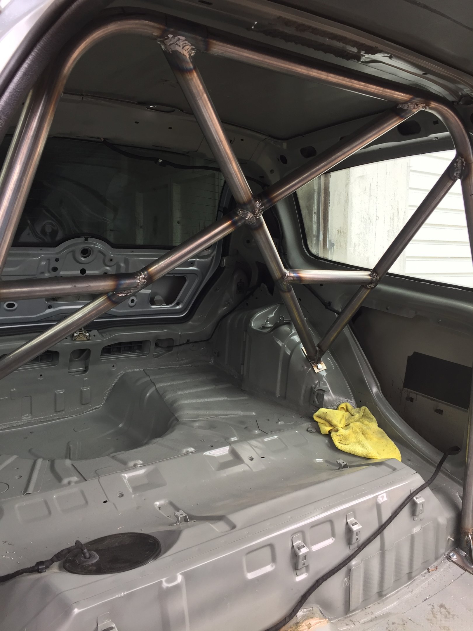

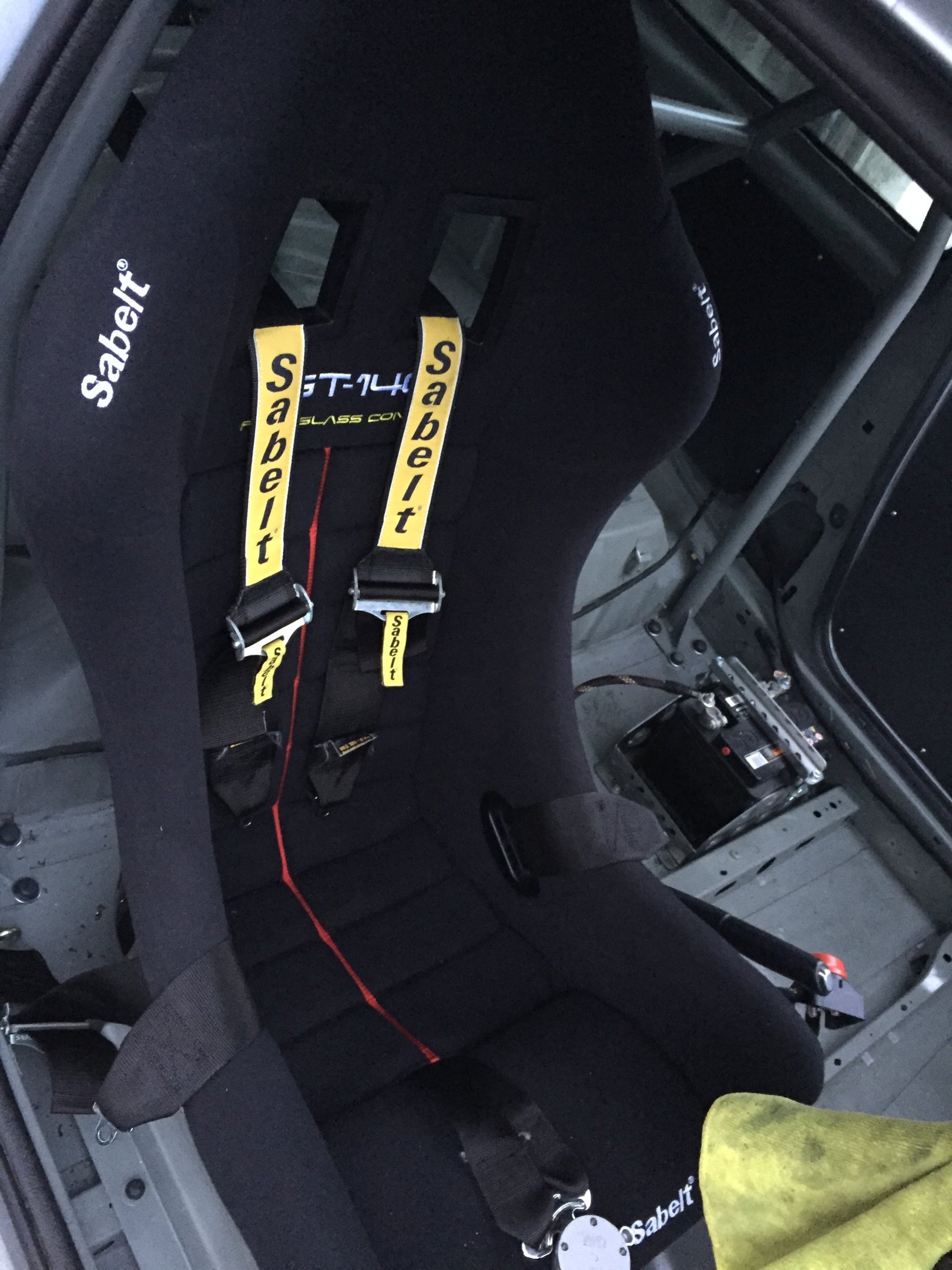

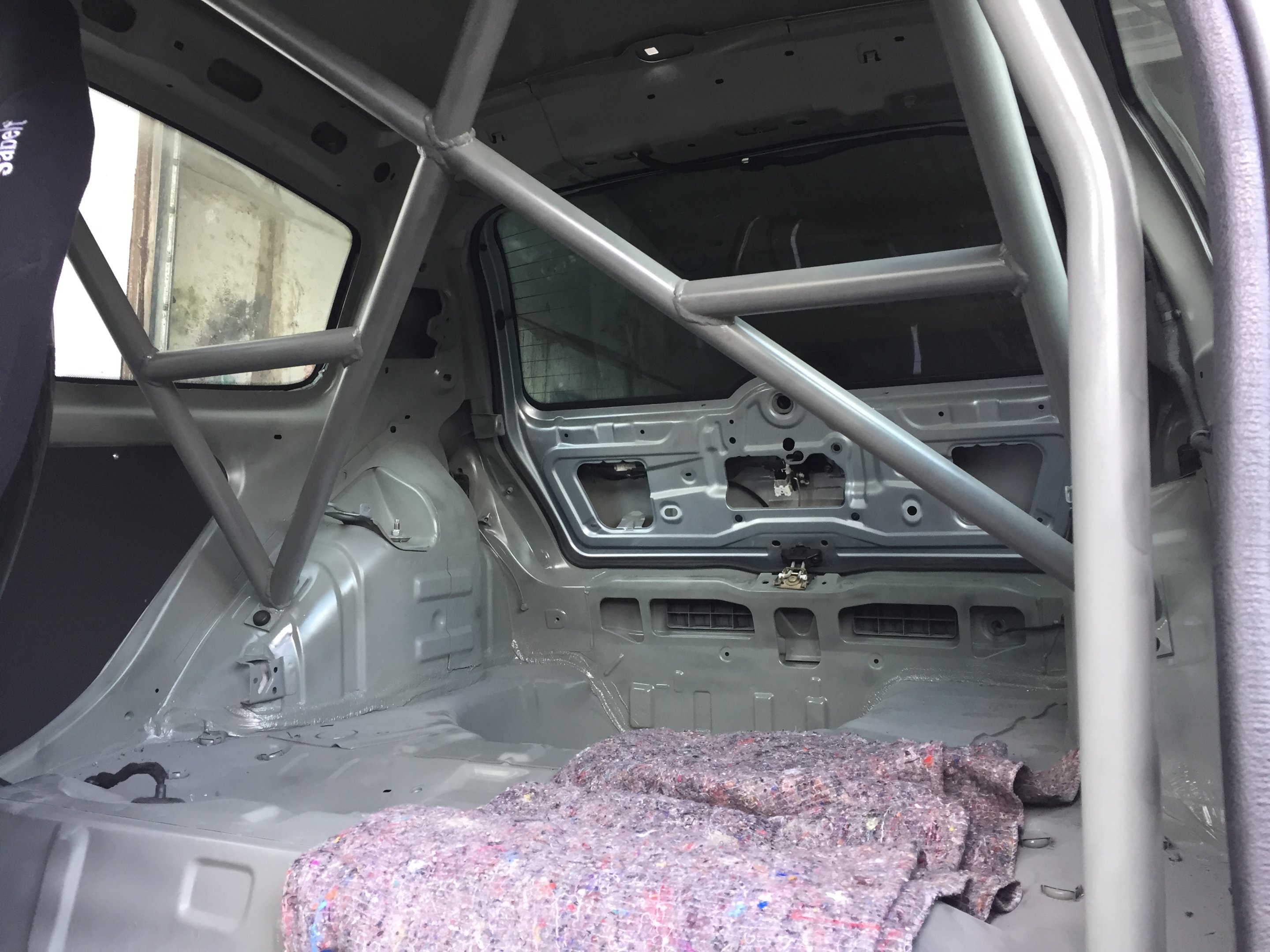

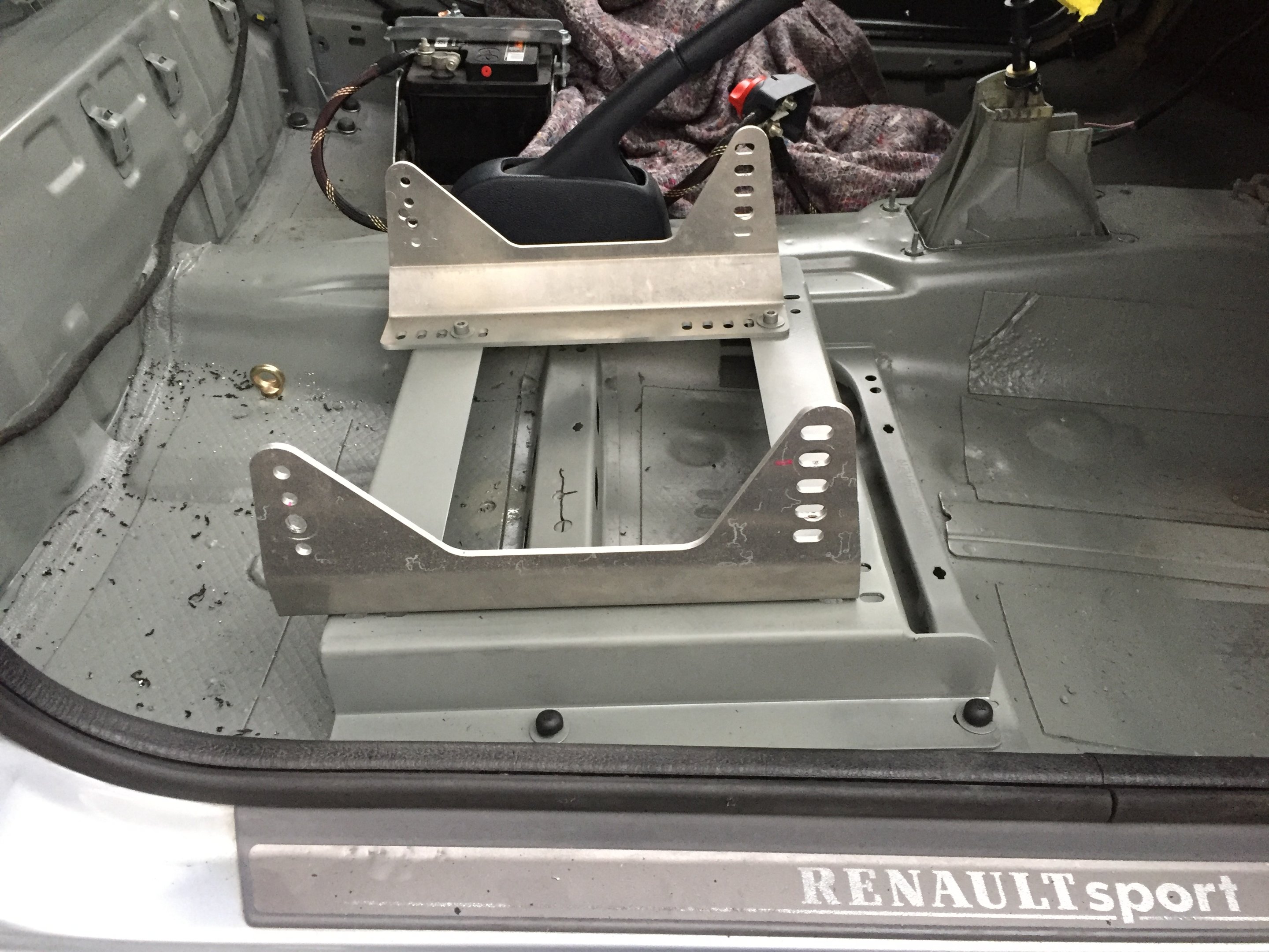

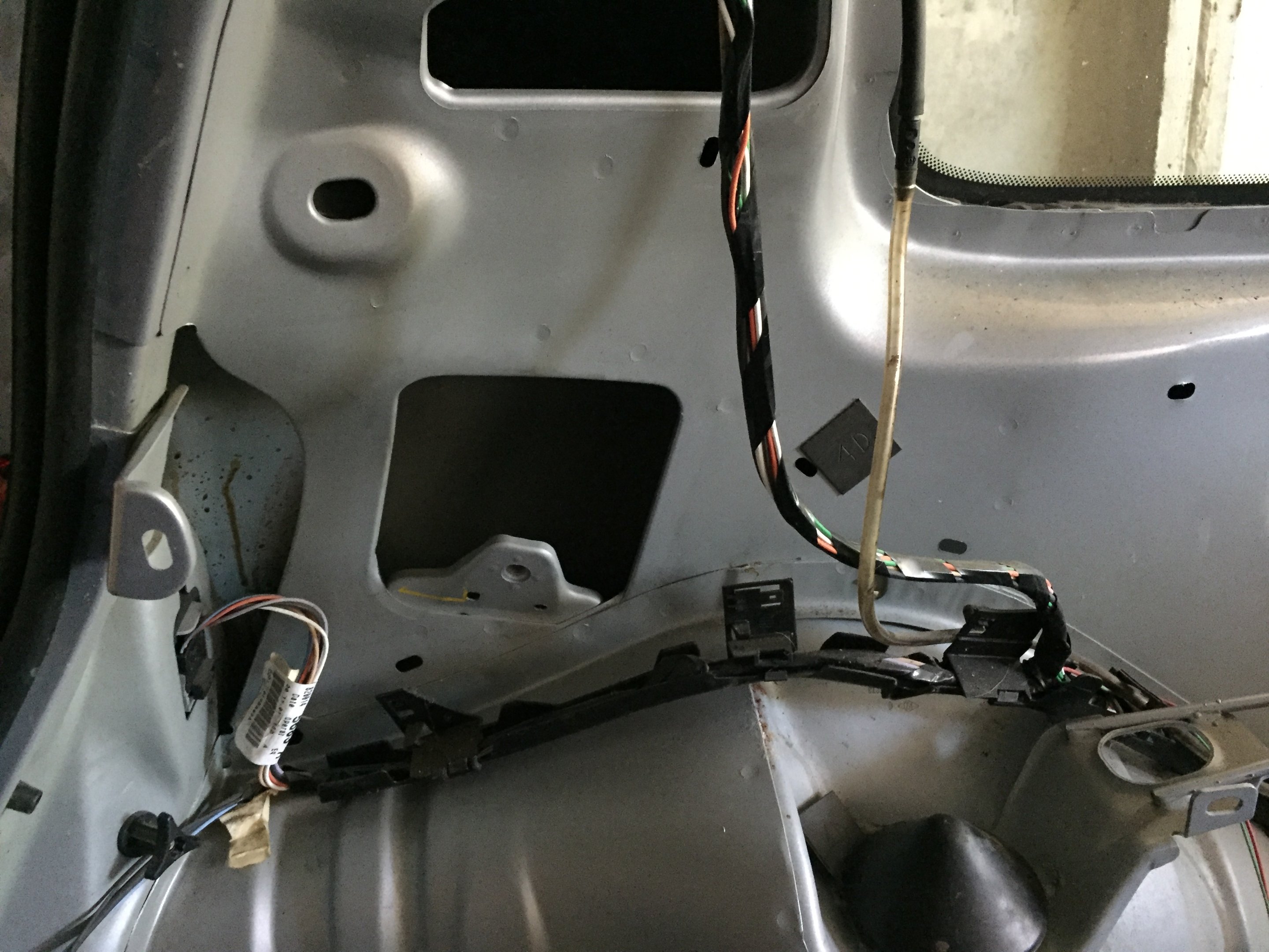

Rear roll cage added. Battery relocated to were the passenger seat would be as not running with a passenger seat. bucket seat for the driver is in, looms relocated inside the rear 1/4 panels.

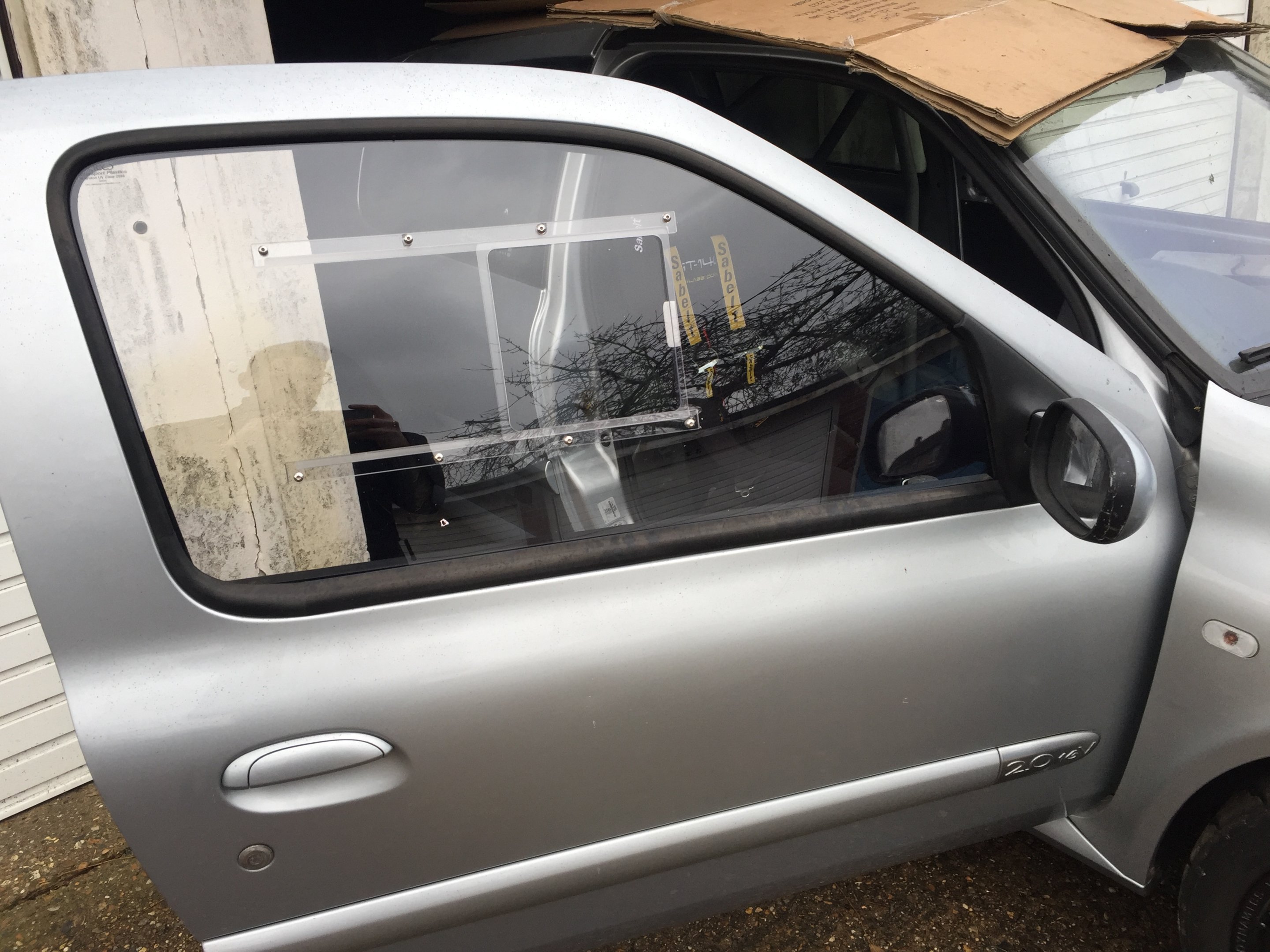

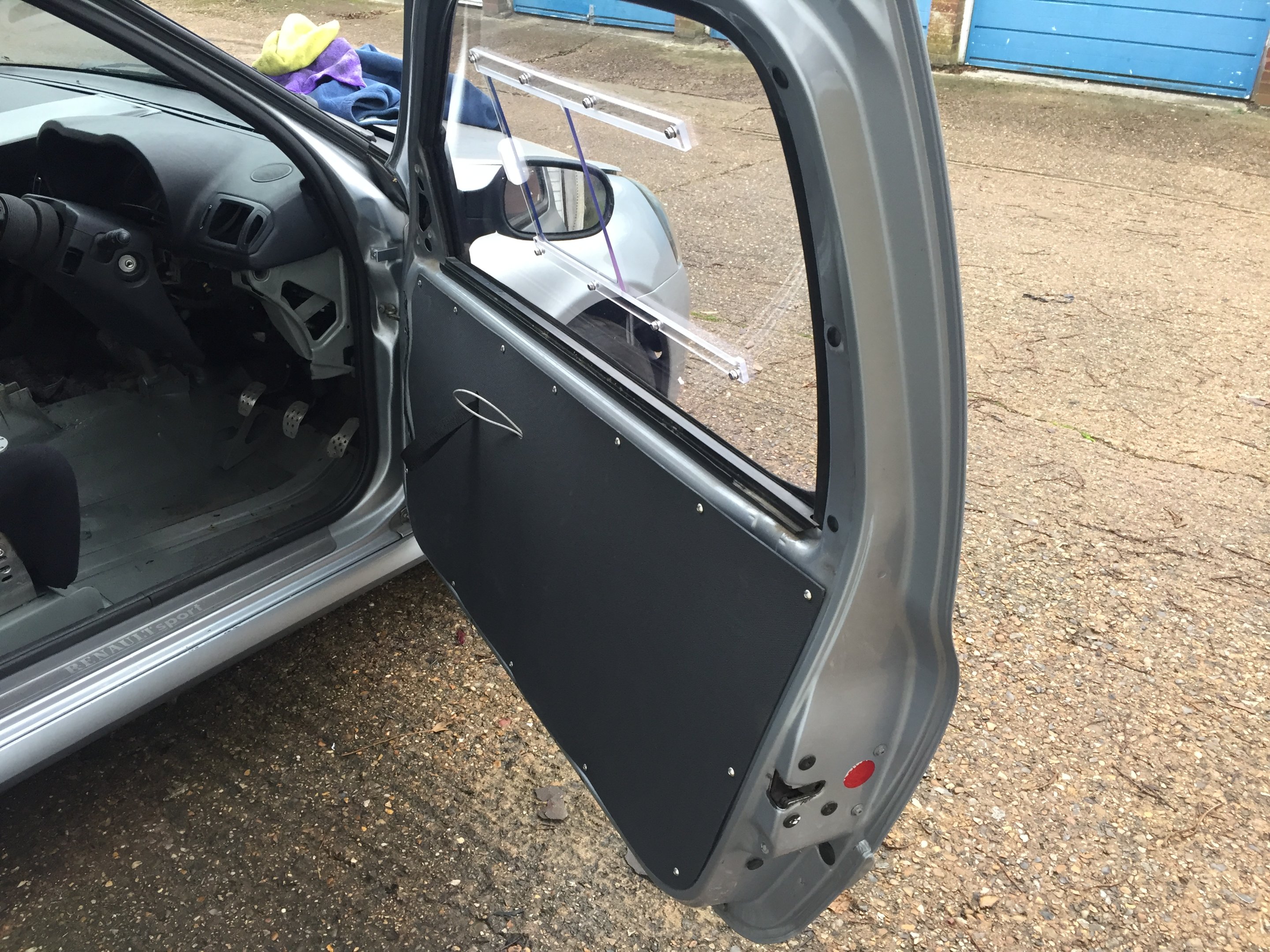

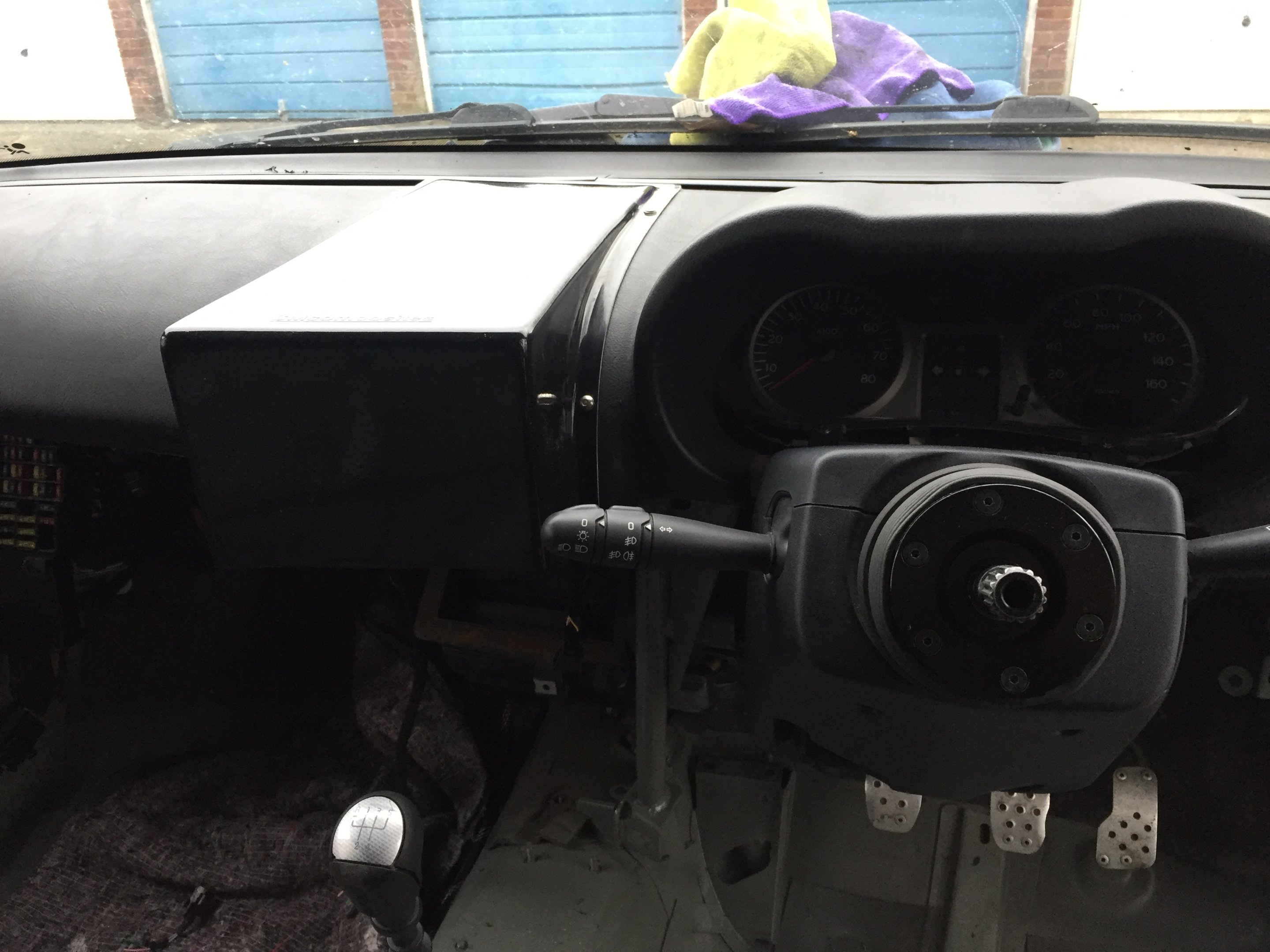

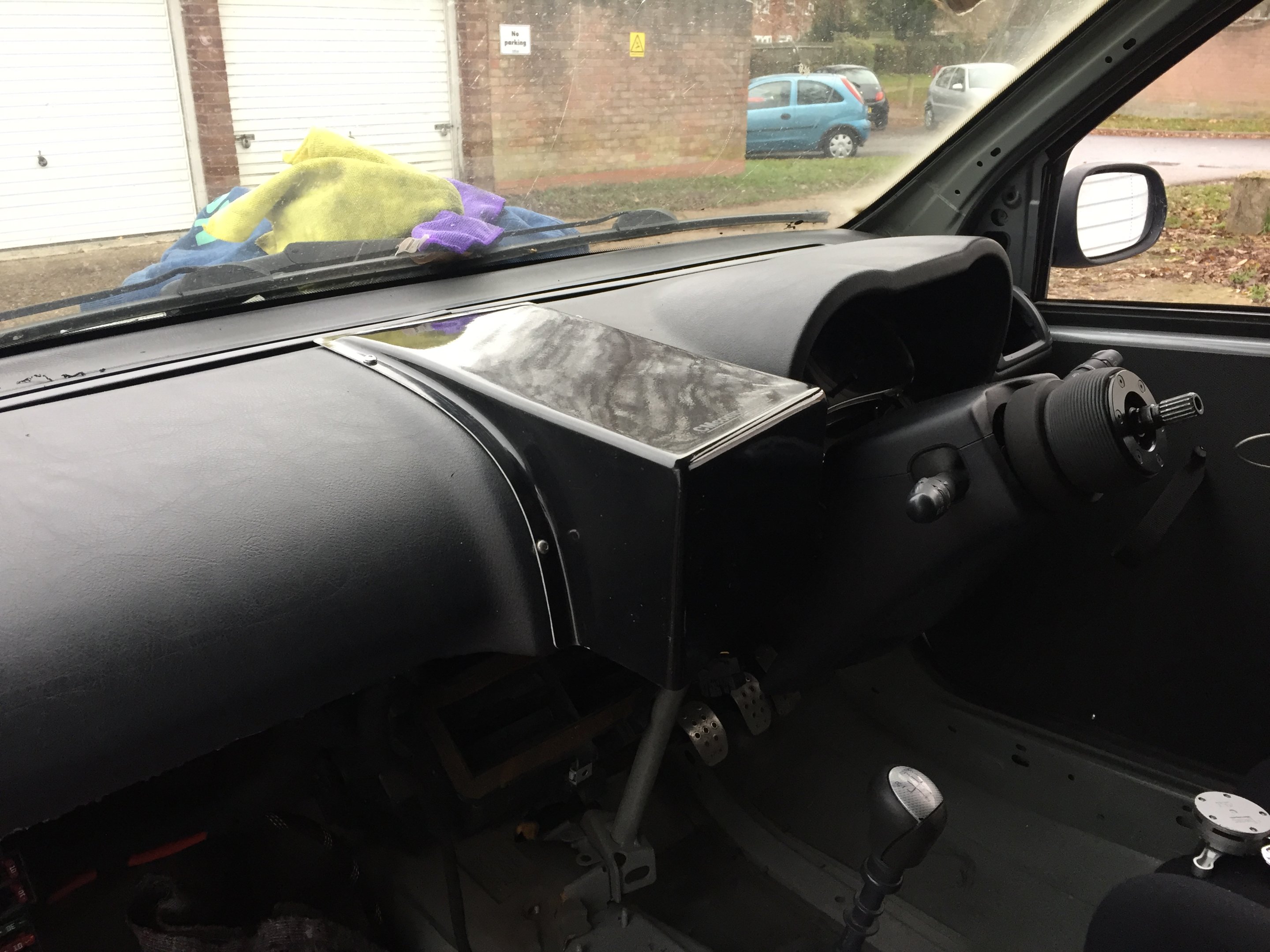

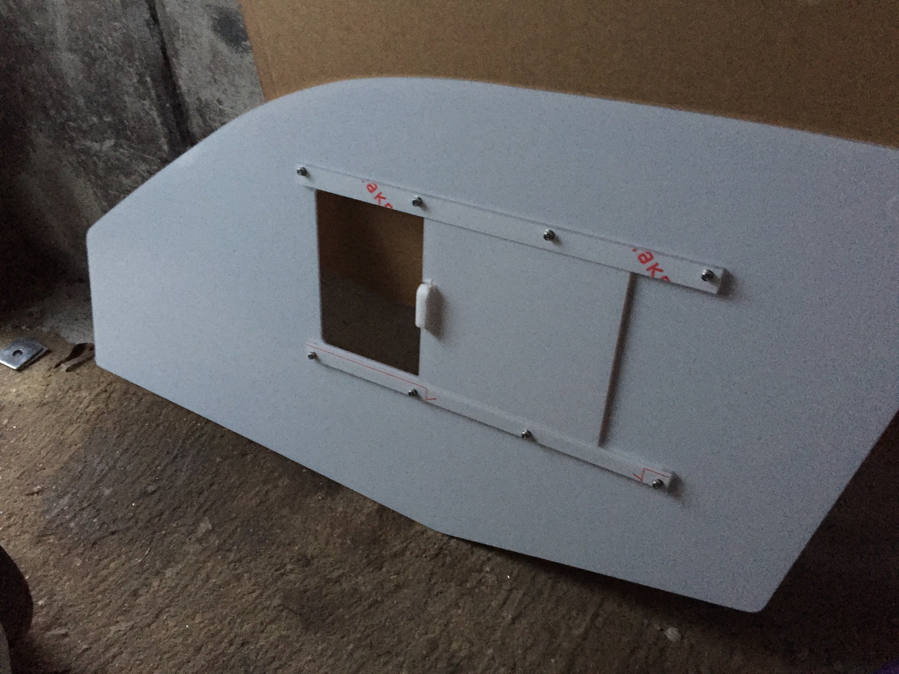

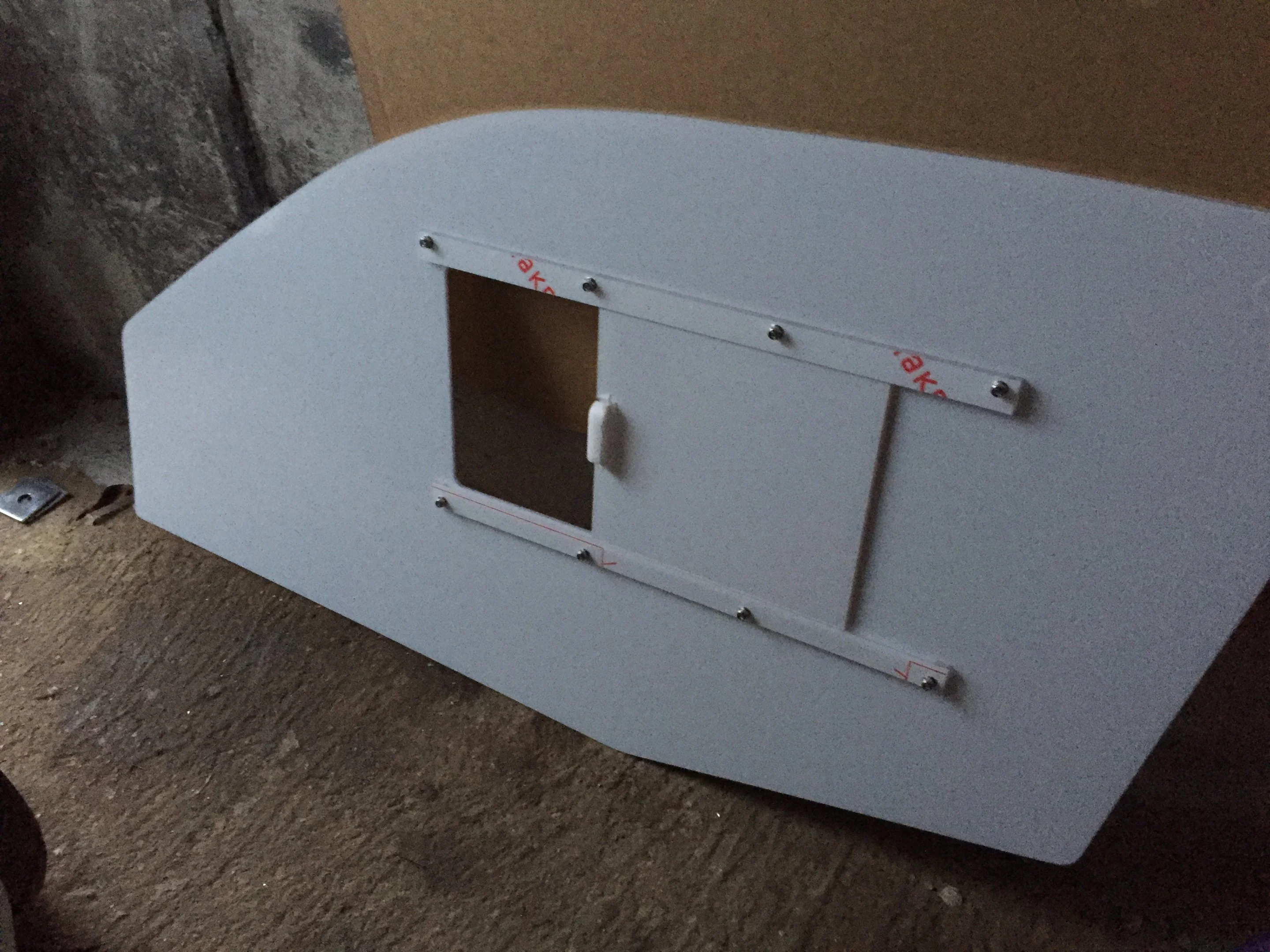

Trackdoor cards fitted, Polly windows fitted, CM composite dash pod fitted but still need to fit switches.

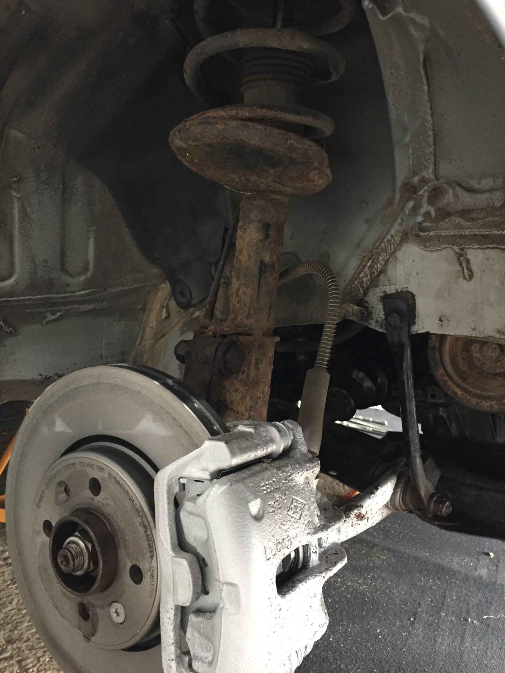

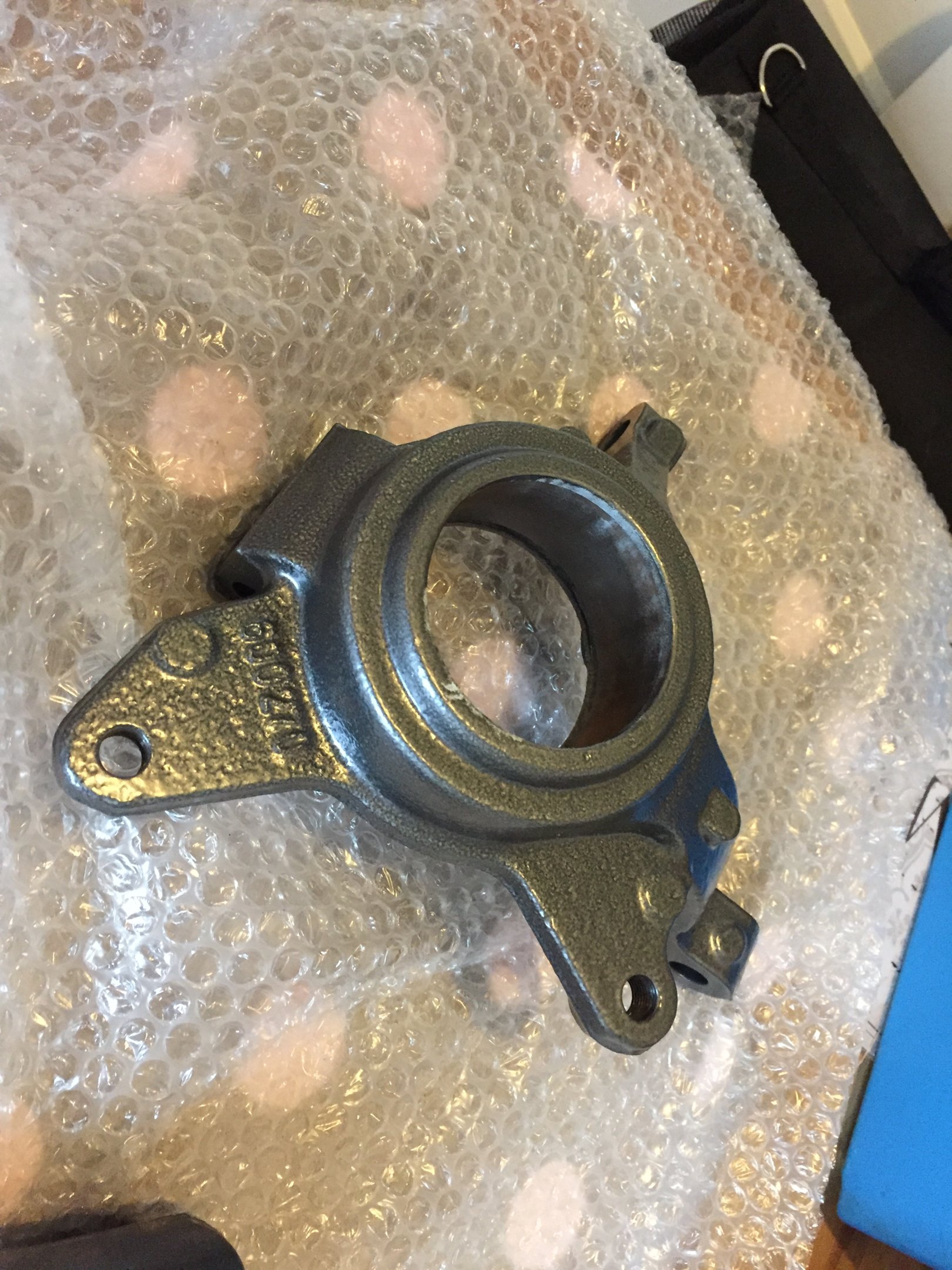

New genuine front hub bearings
10mm and 1degree shims at the rear
Front calipers to be rebulit with all new slider bolts and seals

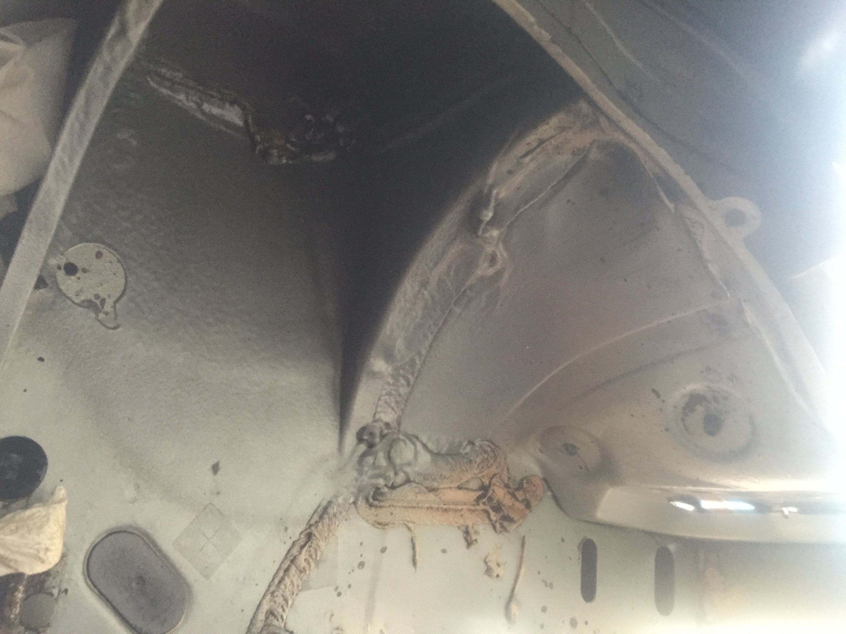

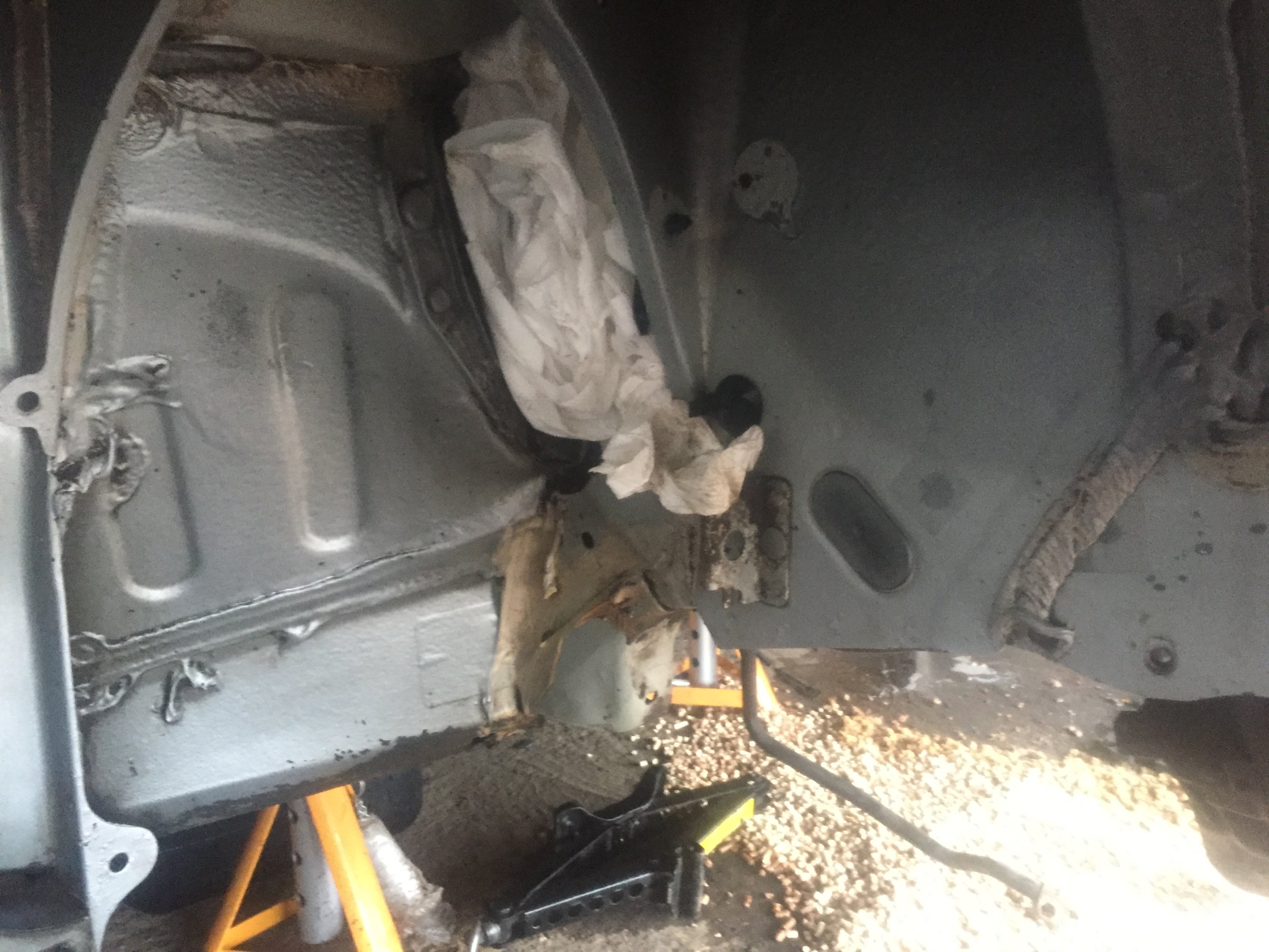

All arches have had liners removed, cleaned and coated in stone chip paint

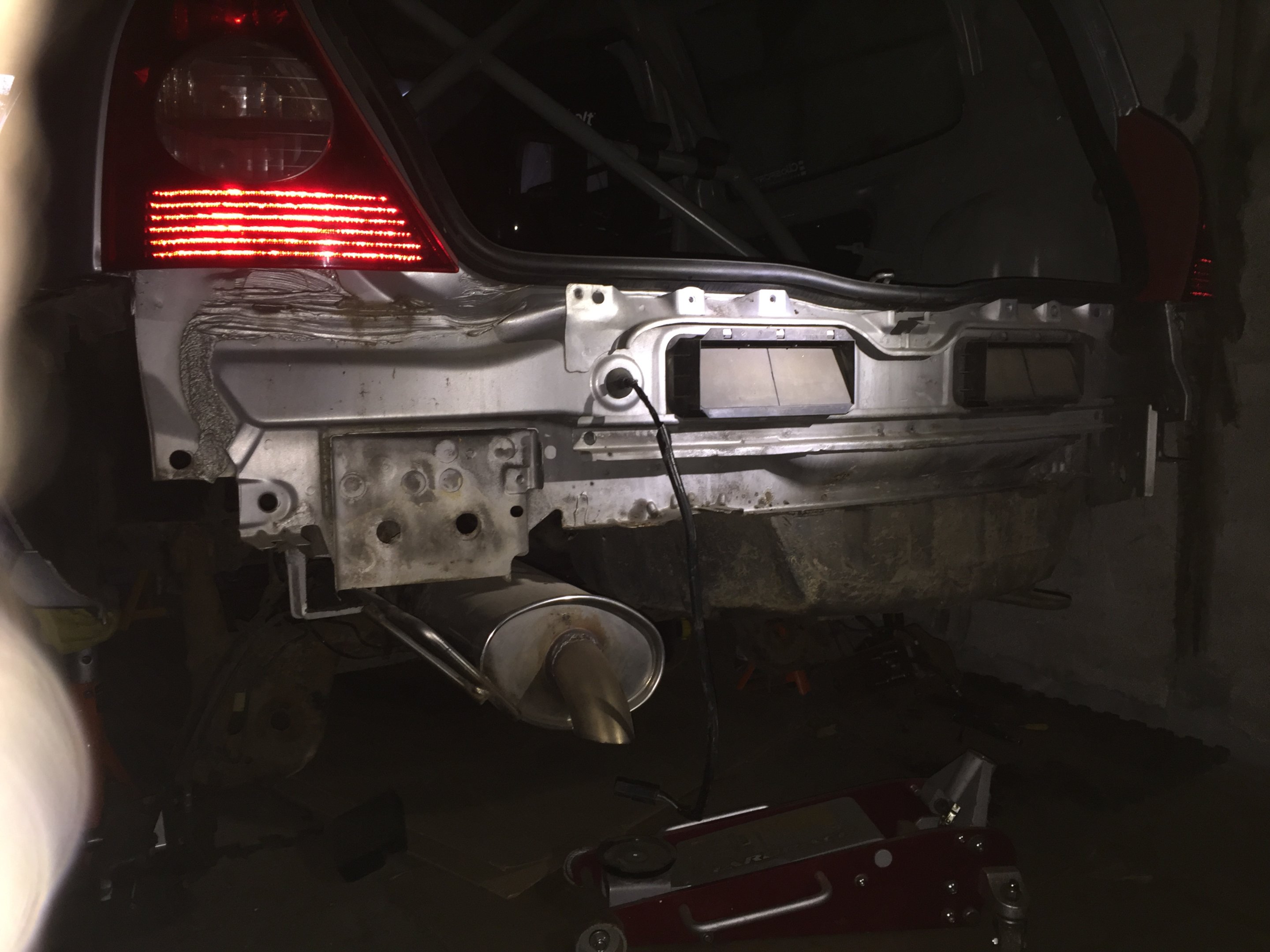

Rear bumper has been off and stone chip paint applied

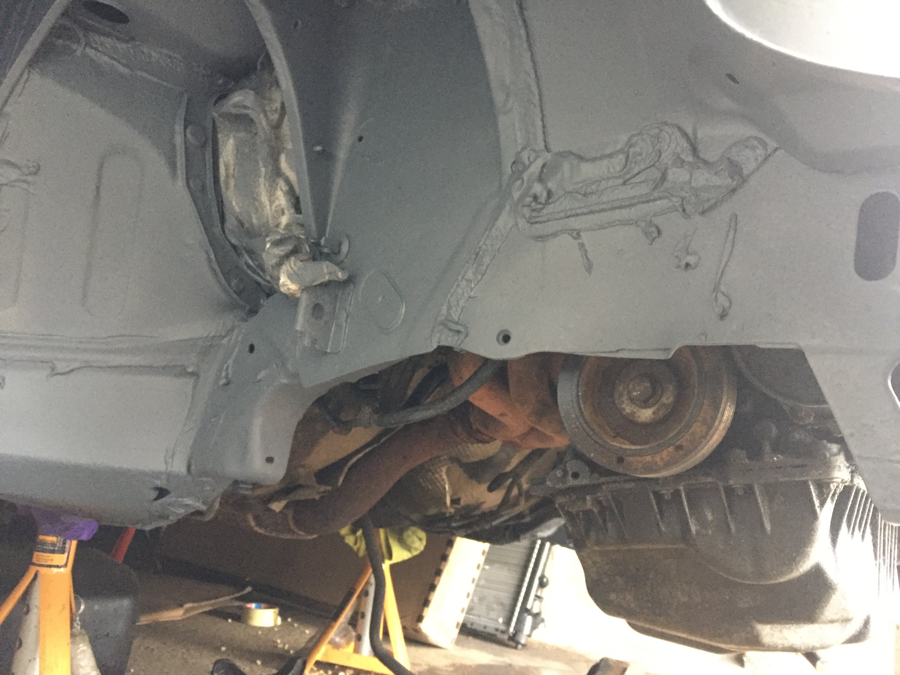

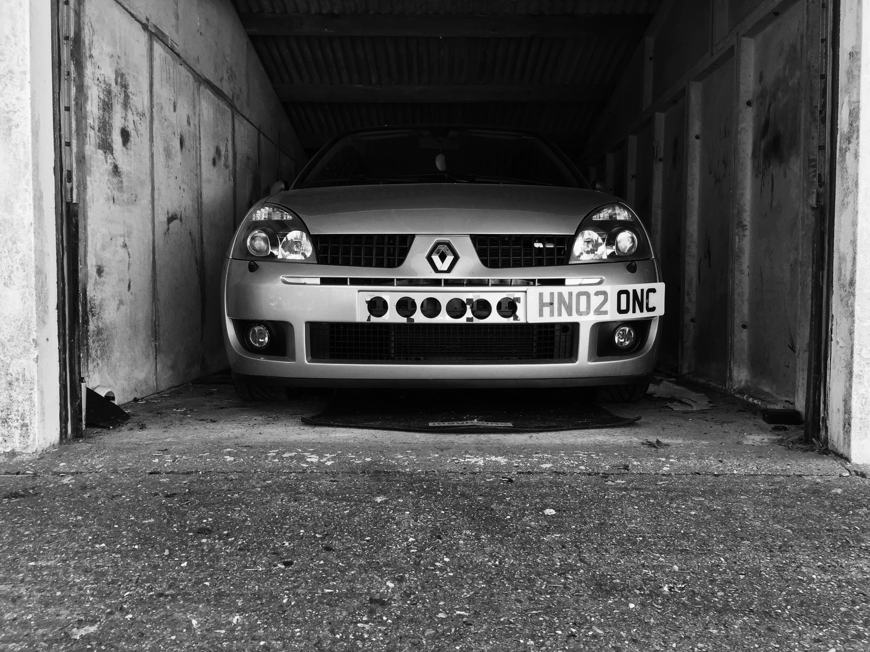

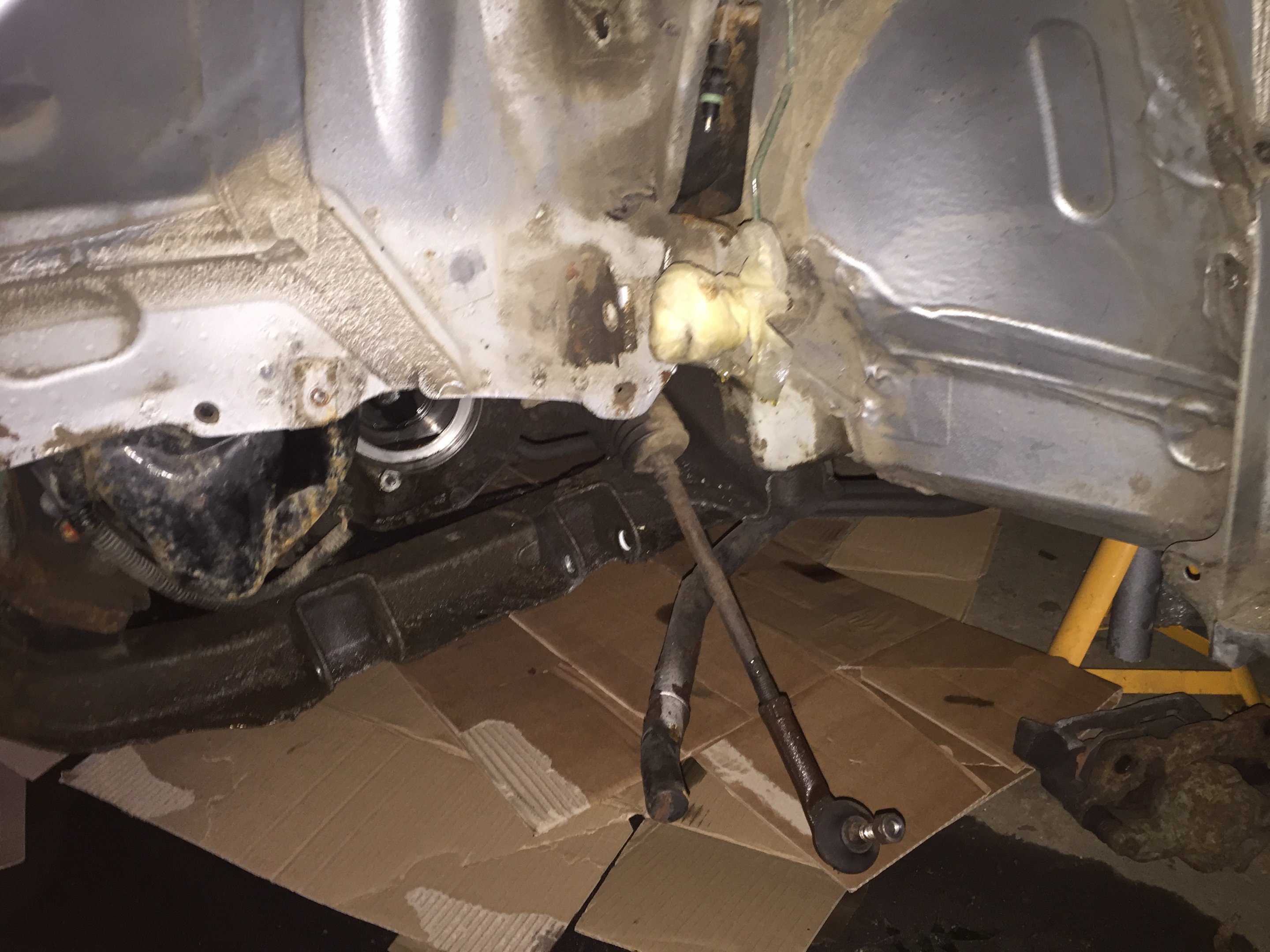

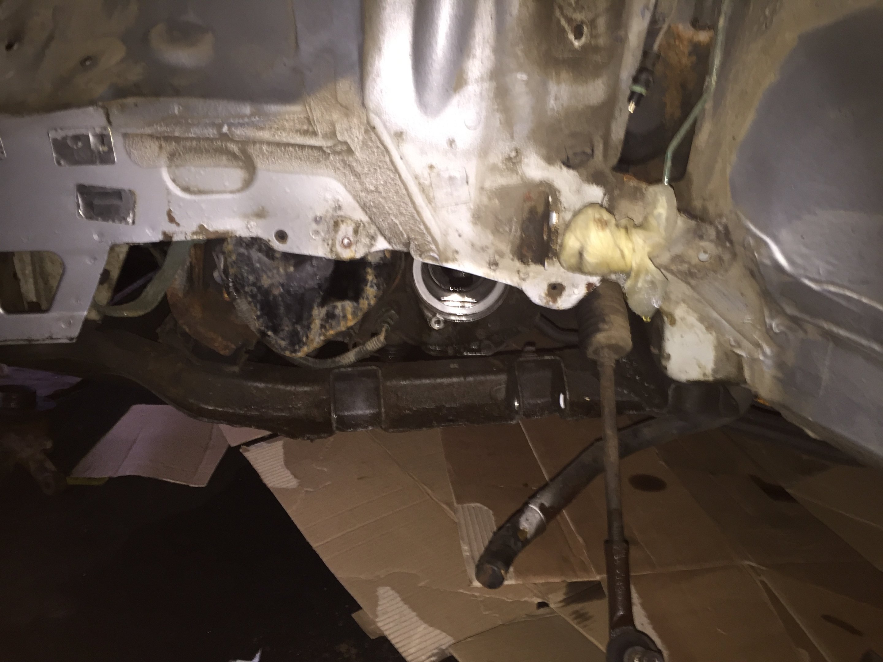

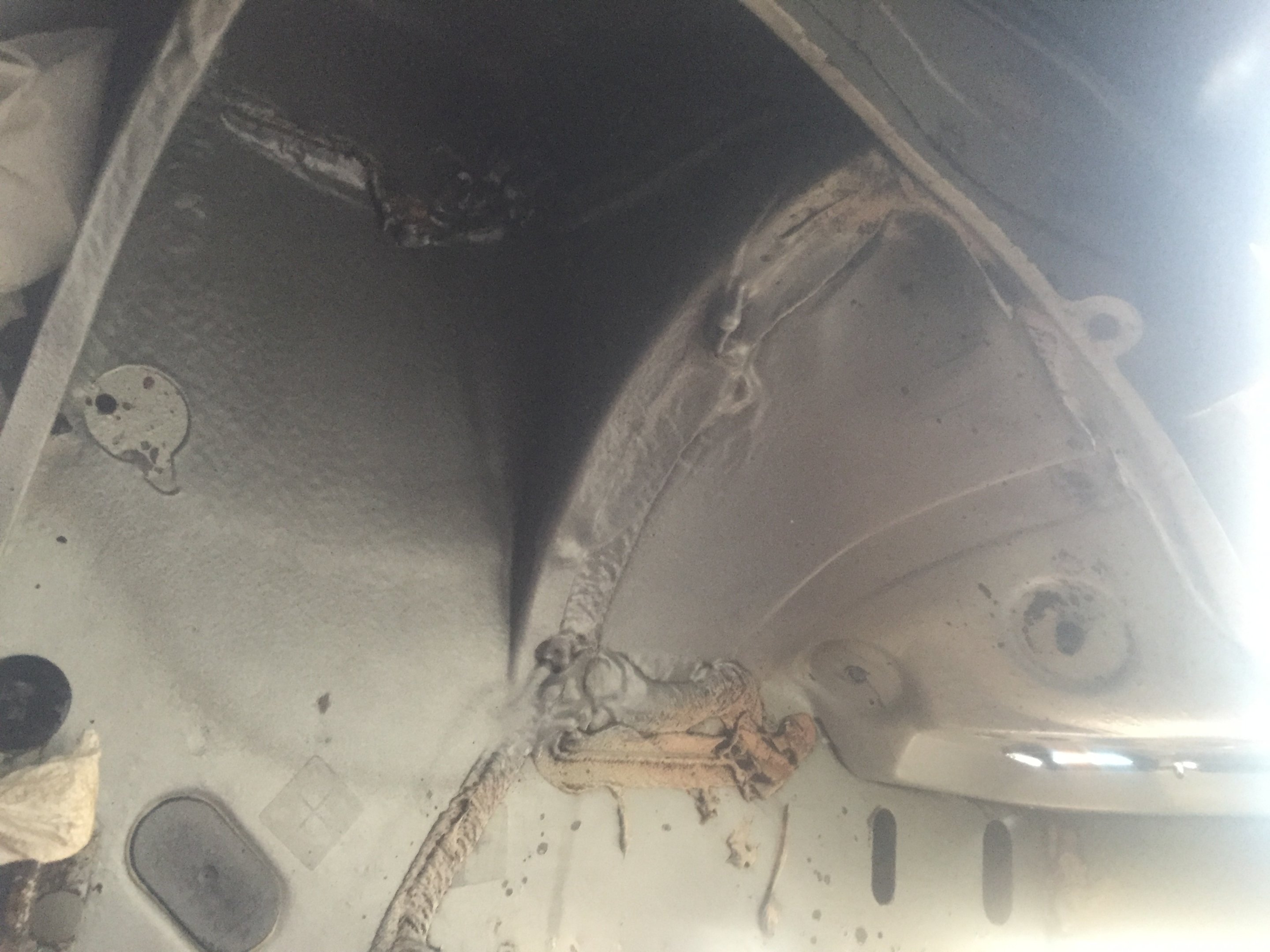

So these are the pictures at the beginning of the strip out and the car it’s self.
Then all of the below is how the car was and sits at present. The above info tell how far I’ve got with it. No such order to the pictures they are just how they have come off my phone to the iPad.

Good start, as you say there is a fair few different style of track cars on here now.
Interior paint looks good, personally i'd have removed all the floor tar to save a few extra Kg.

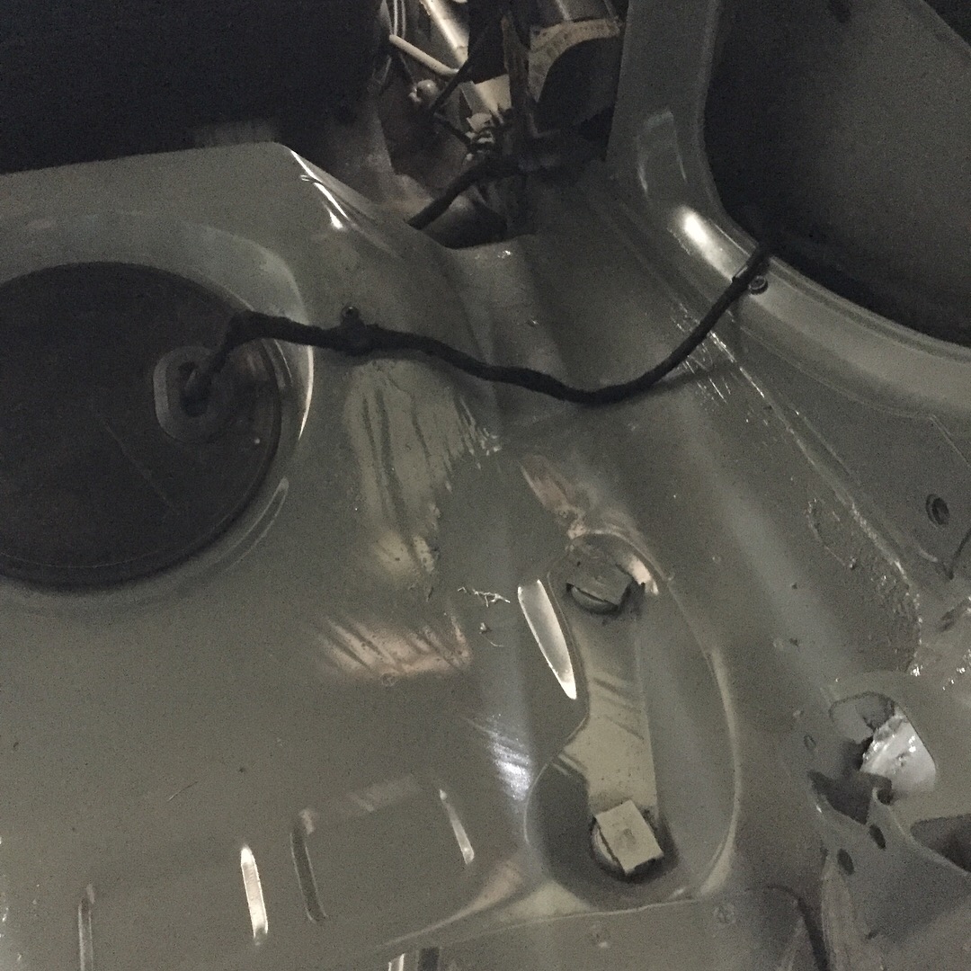

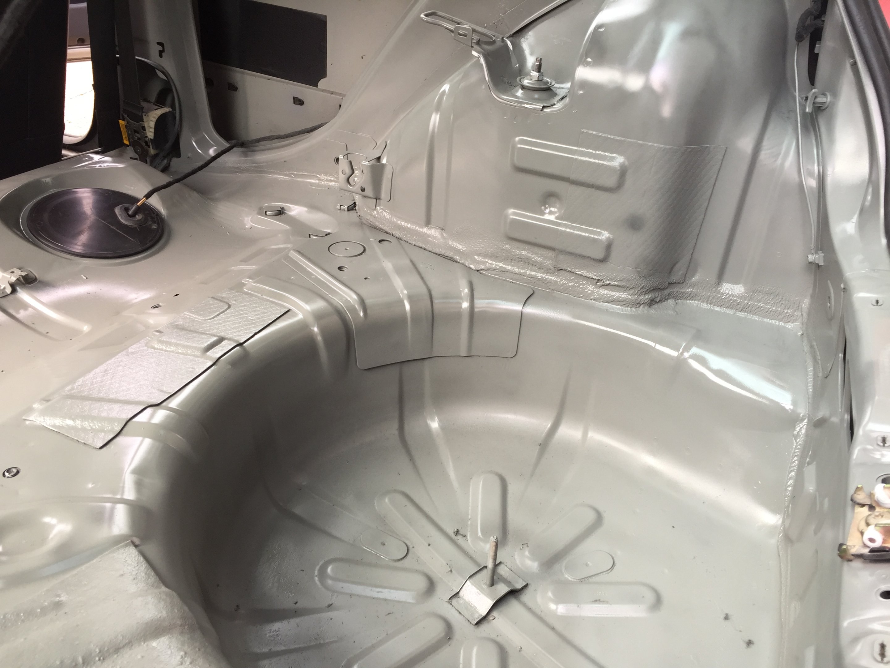

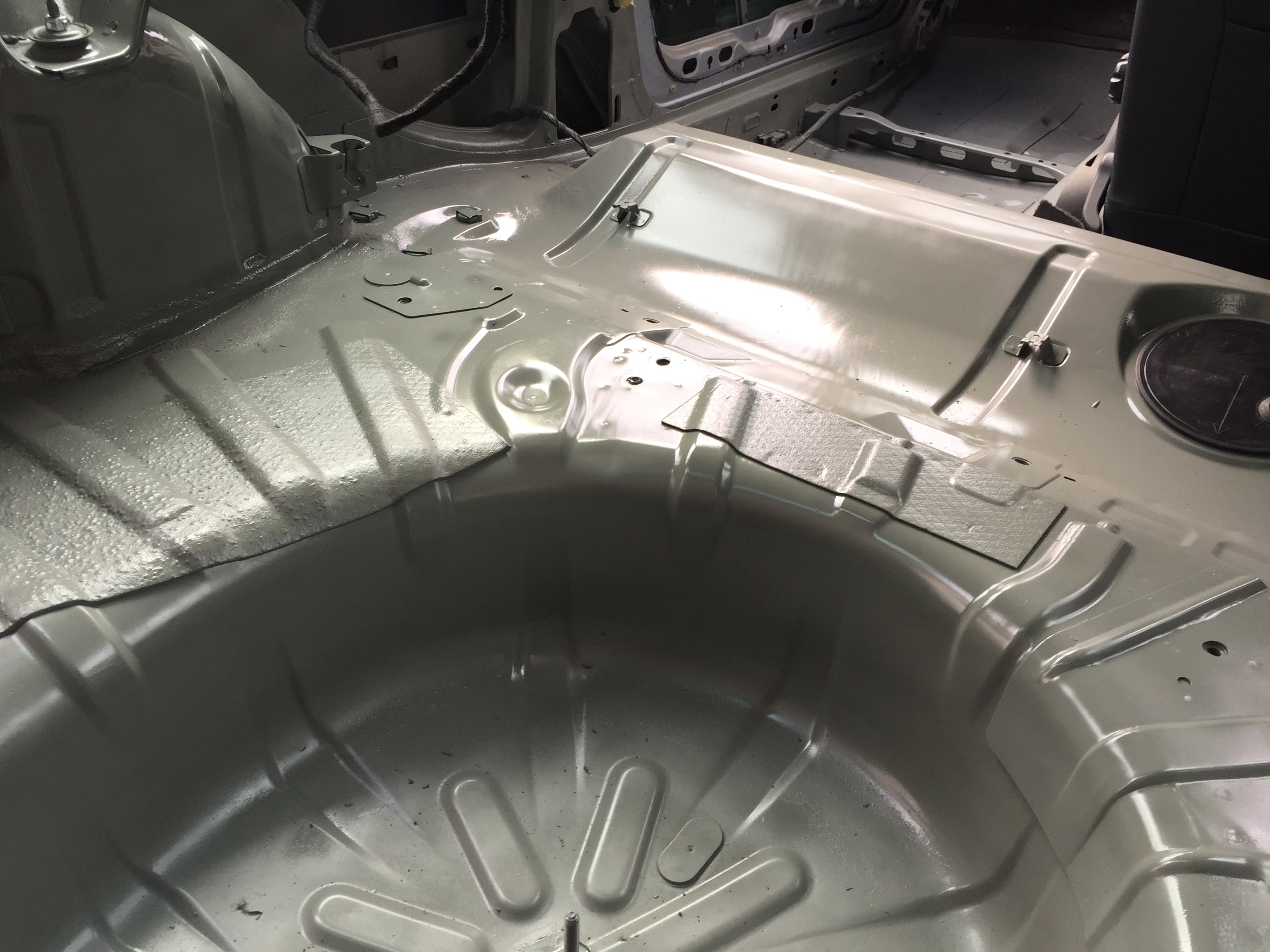

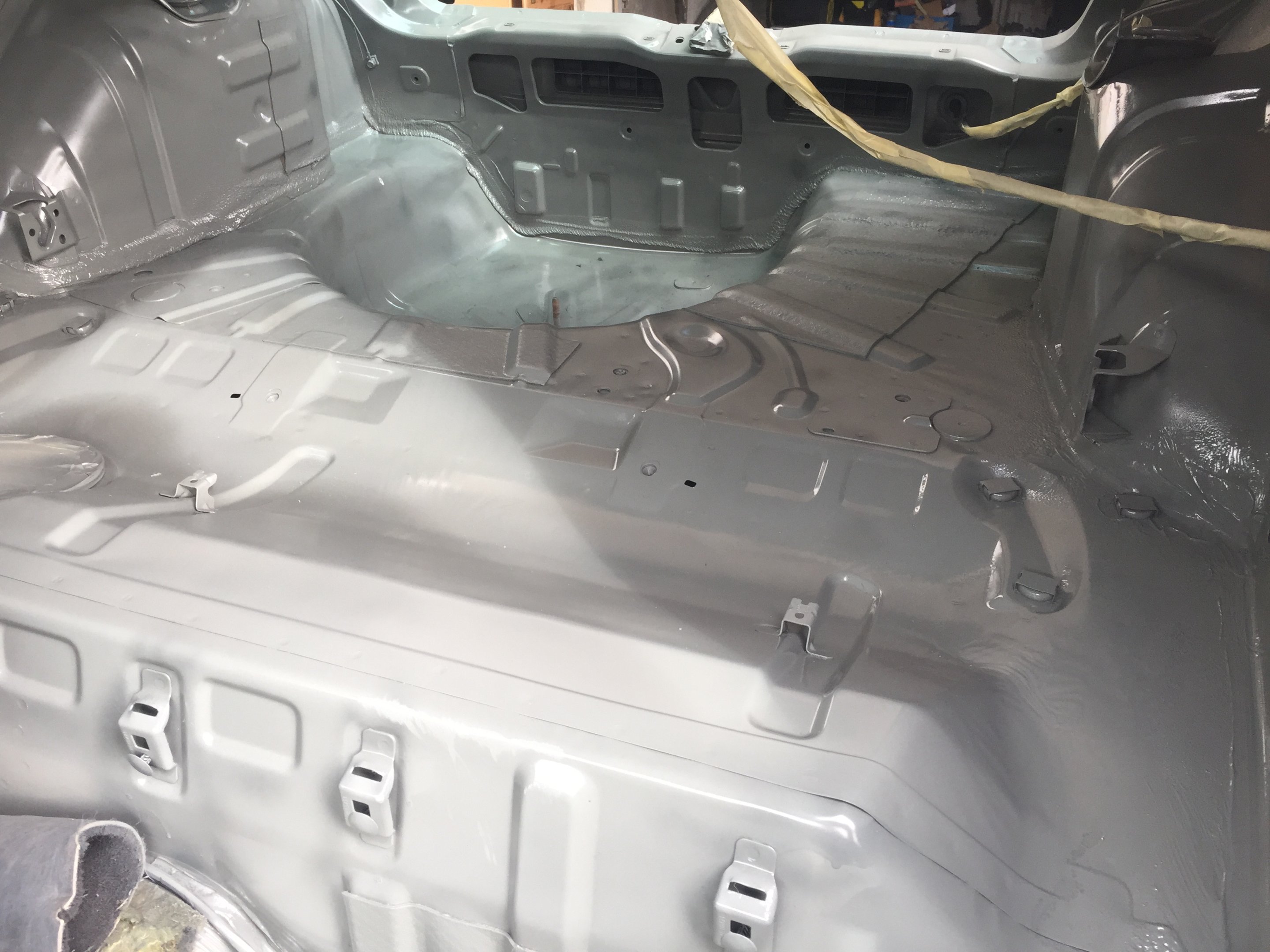

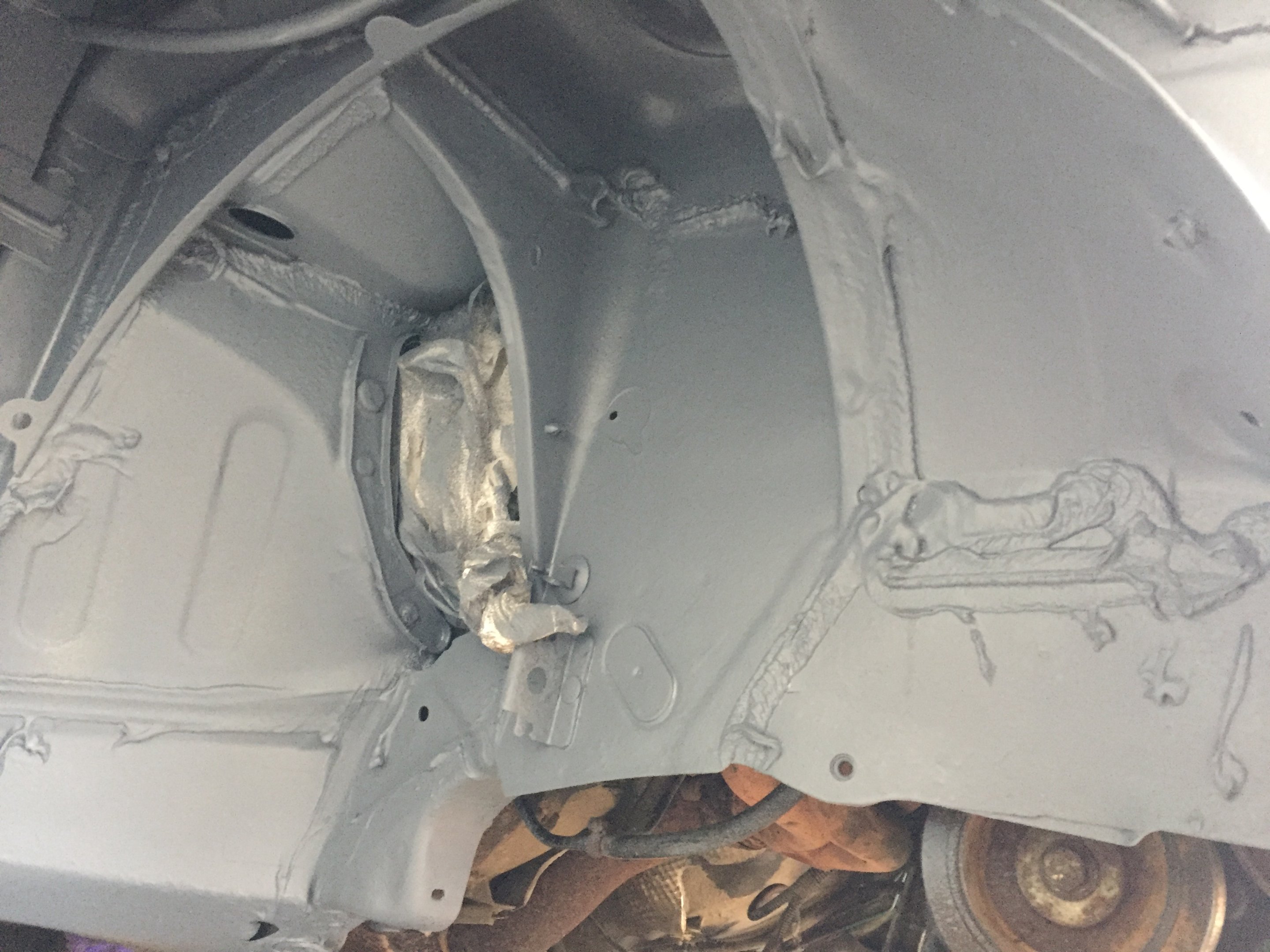

After cleaning and painting.
6B766CC9-B869-4DF2-A6B4-9066142704D5.webpDDC64C30-E229-4234-9D9F-6C395E020C99.webpBD794649-0D7D-4C39-B7AC-075FF242F6D5.webp1CE1520A-1578-4074-B365-2E285C74ECB6.webp
Rear bumper off but was getting dark as you can see in the poor camera phone picture. Not bad for its age I thought.
Checked behind the side skirts and inside the 1/4 panels and found nothing, good coat of anti rust paint to help out just in case.
I know I still have the sound mat panels but I’m not to worried or going for out and out weight reduction this coupled with I don’t have mains power in my lockup.

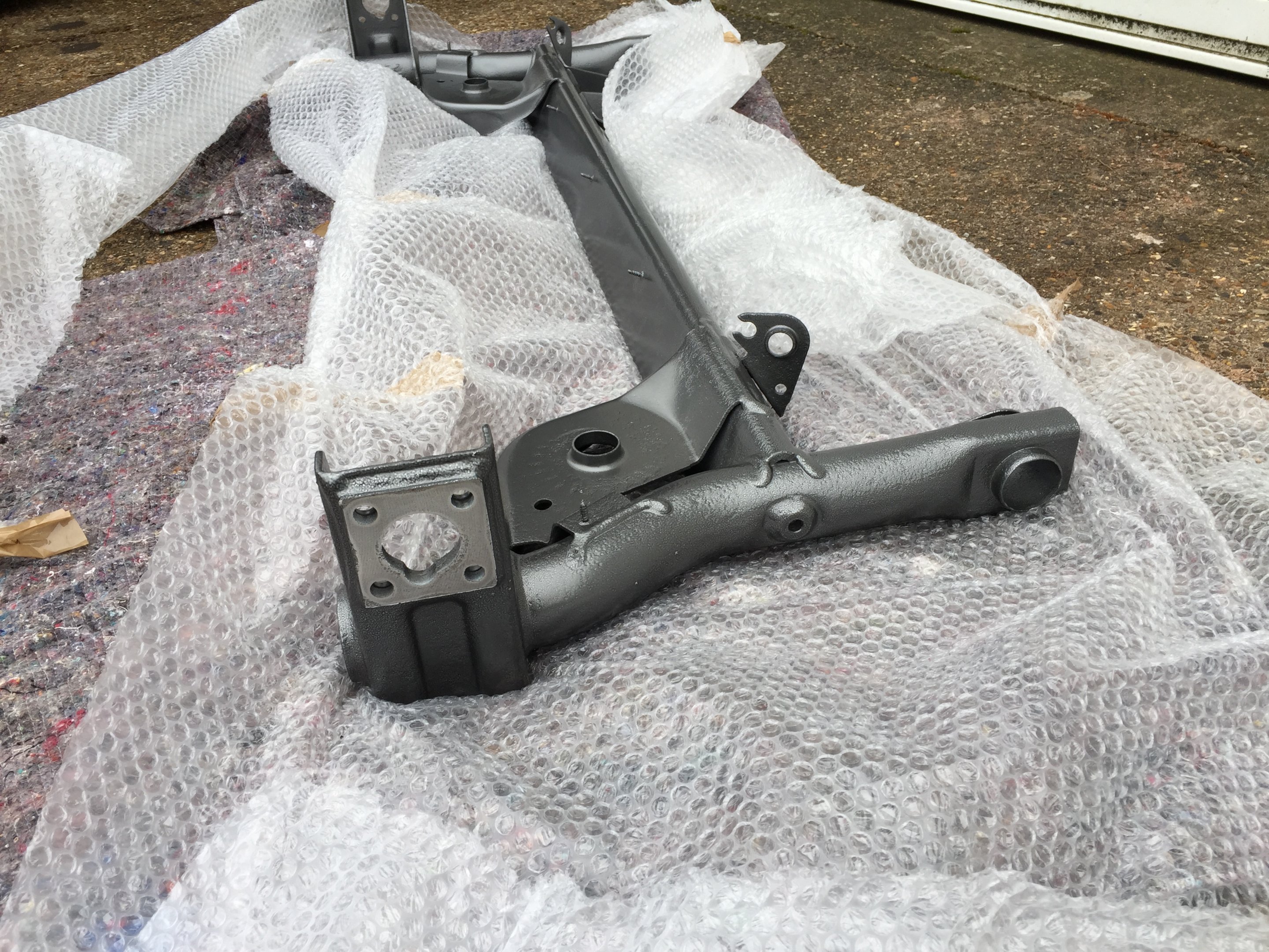

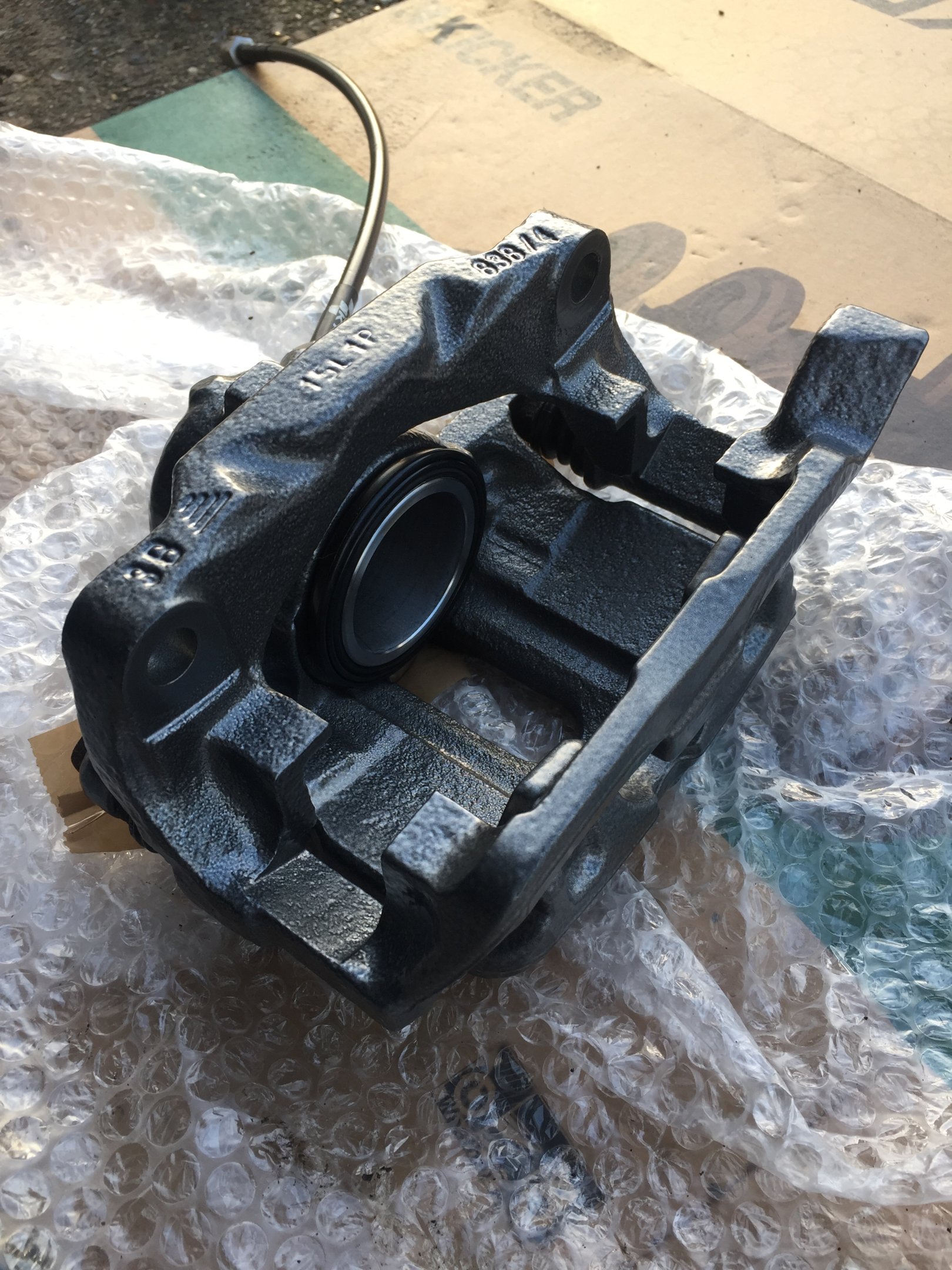

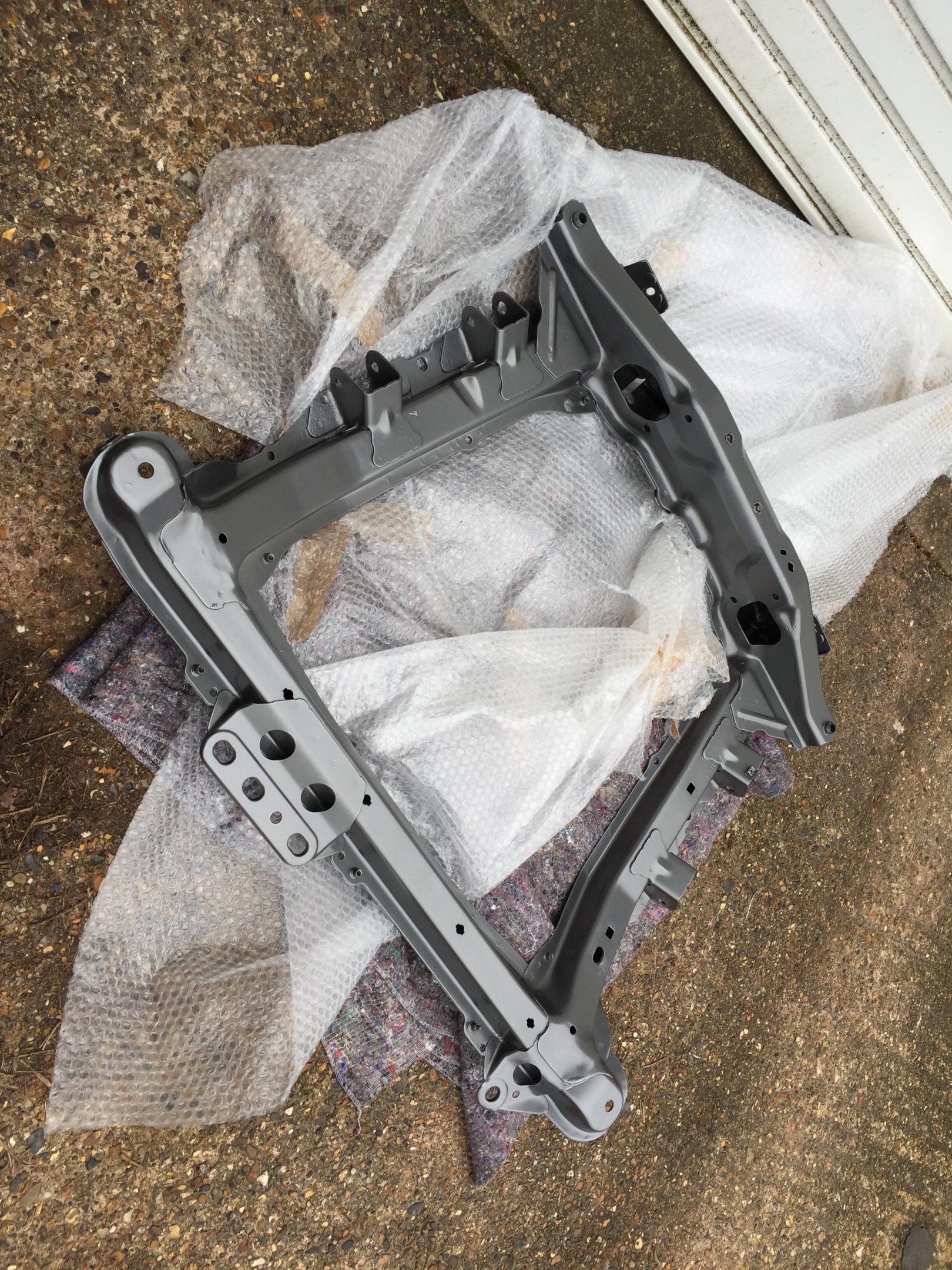

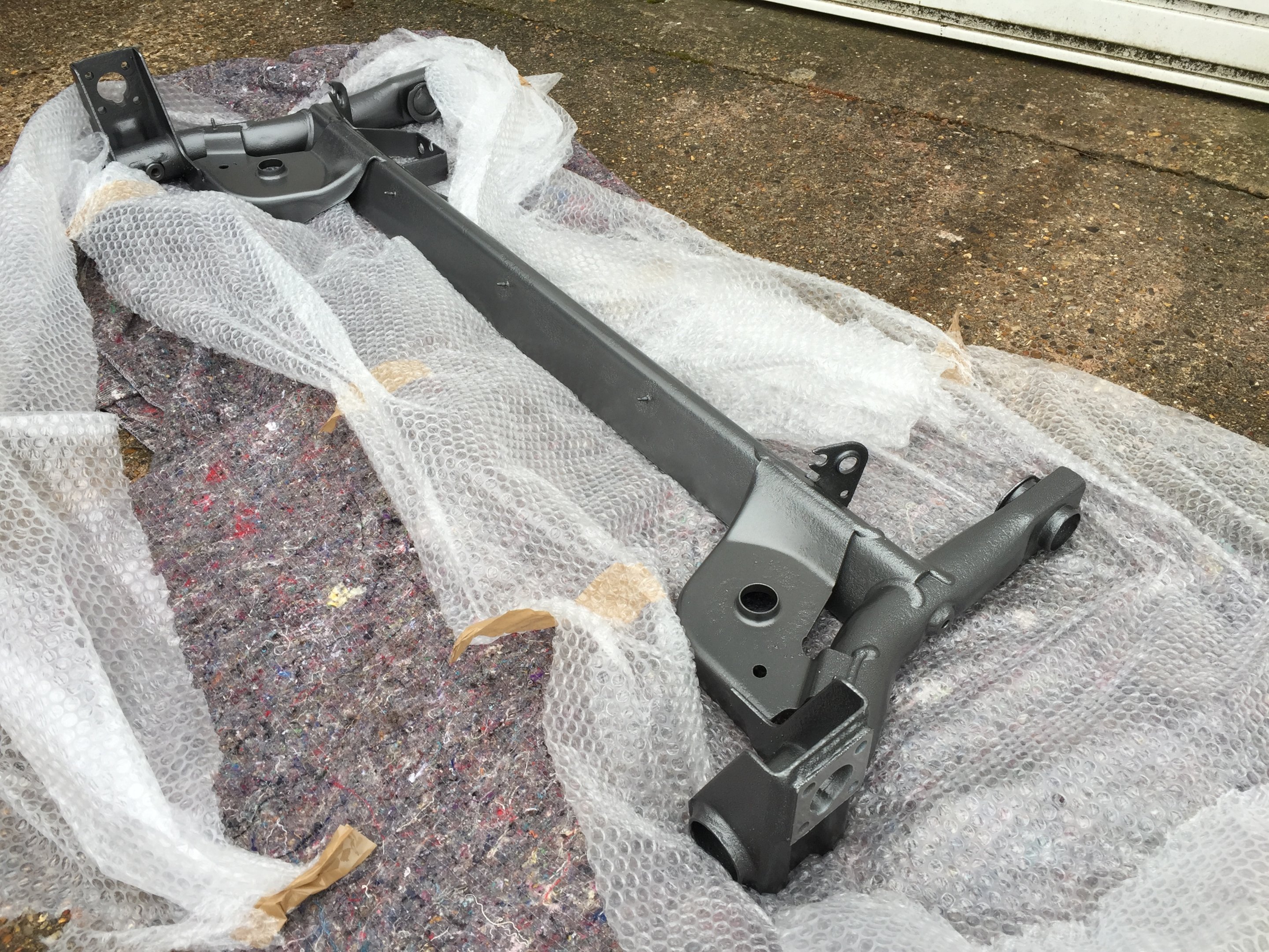

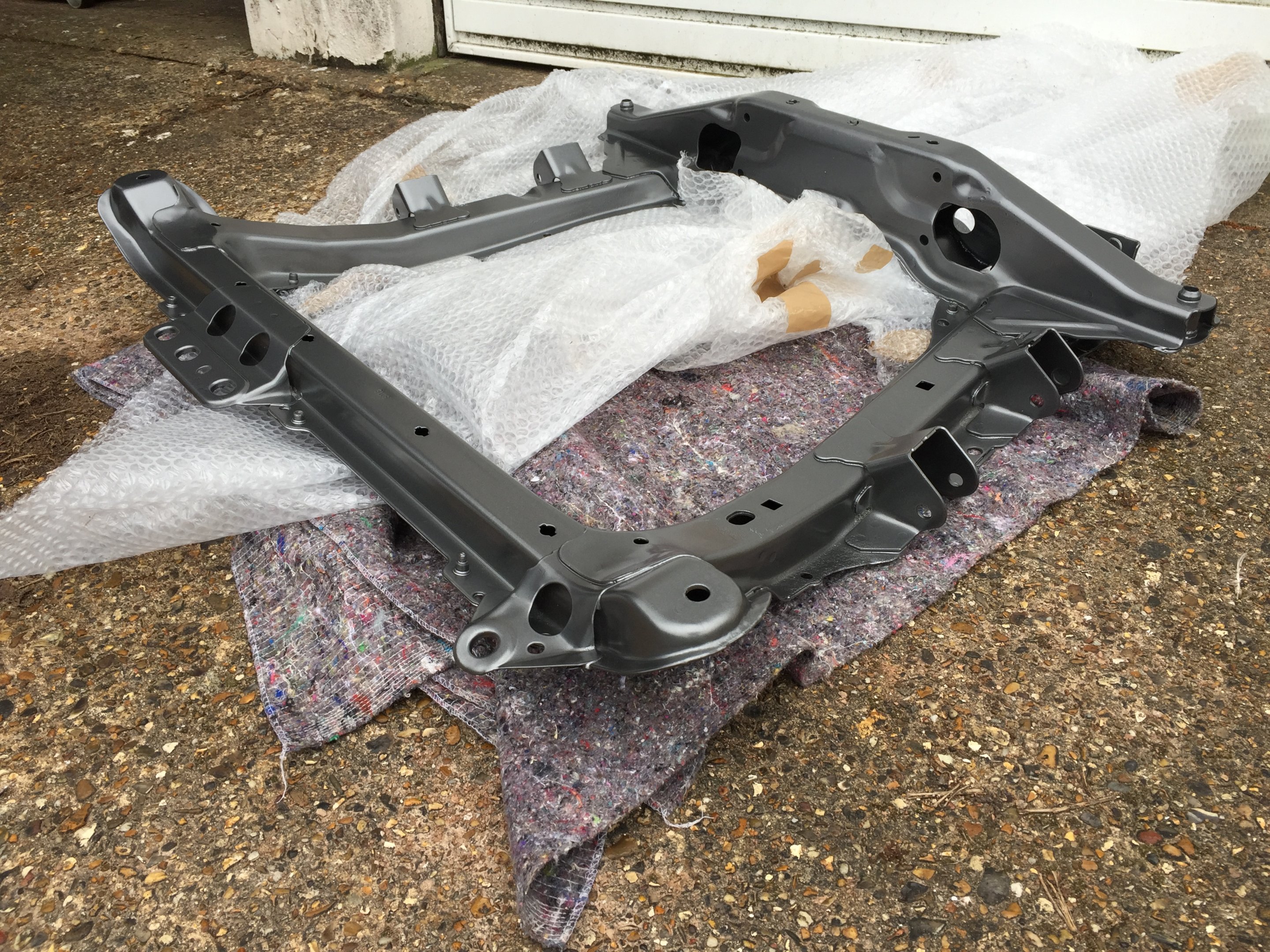

Anyway as I said before waiting on a 2 week lead time for the powder coated items to come back before anything else will be moving forward.

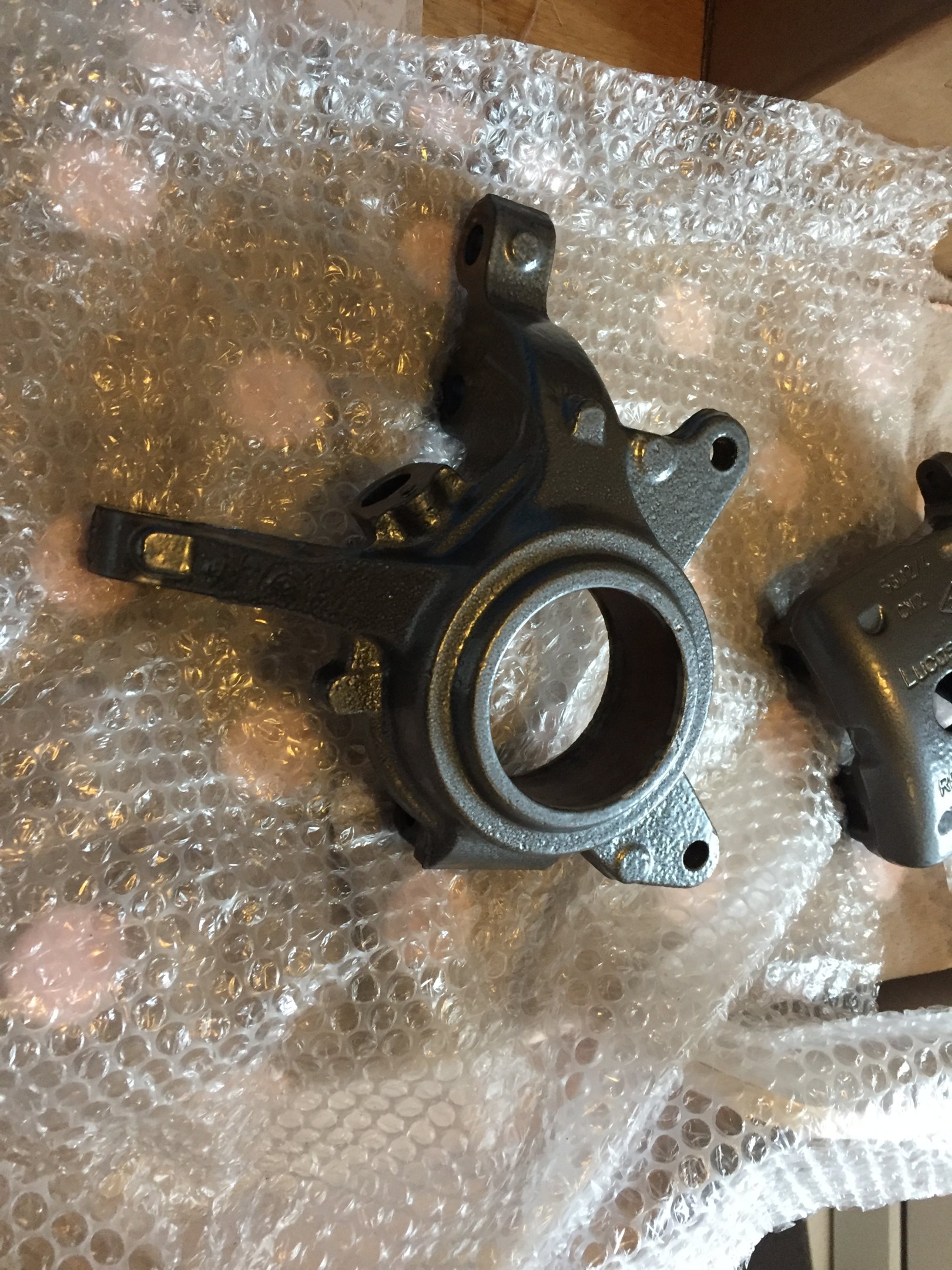

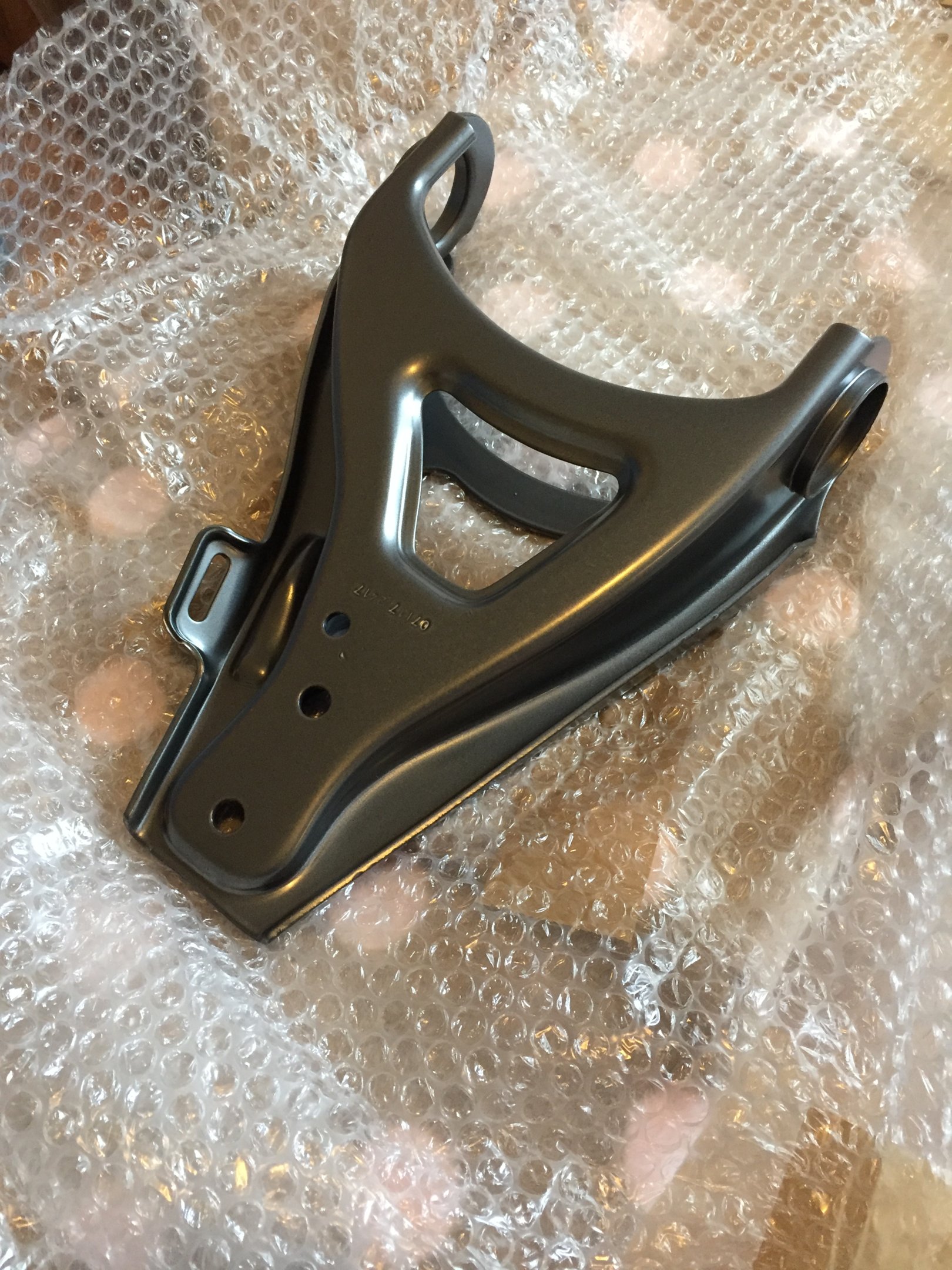

I’ve now had a phone call to say the parts have been powder coated ready for collection. This Saturday I will collect get them back home and start putting it all back together.
I have new seals for the front calipers, they can be built up.

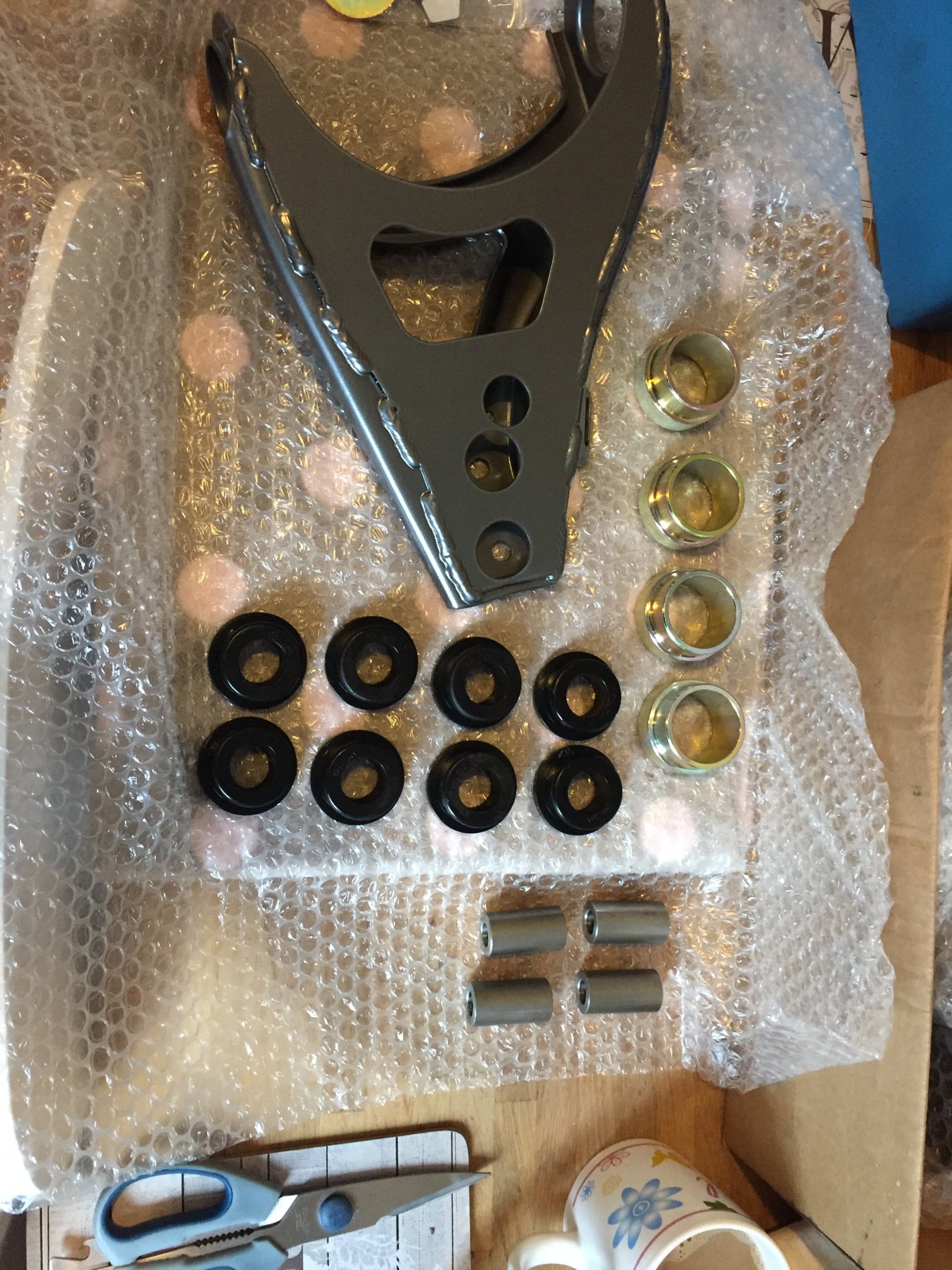

Black polly bushes are on order and should be with me tomorrow.
Front hub bearings are with me ready to be pressed in.

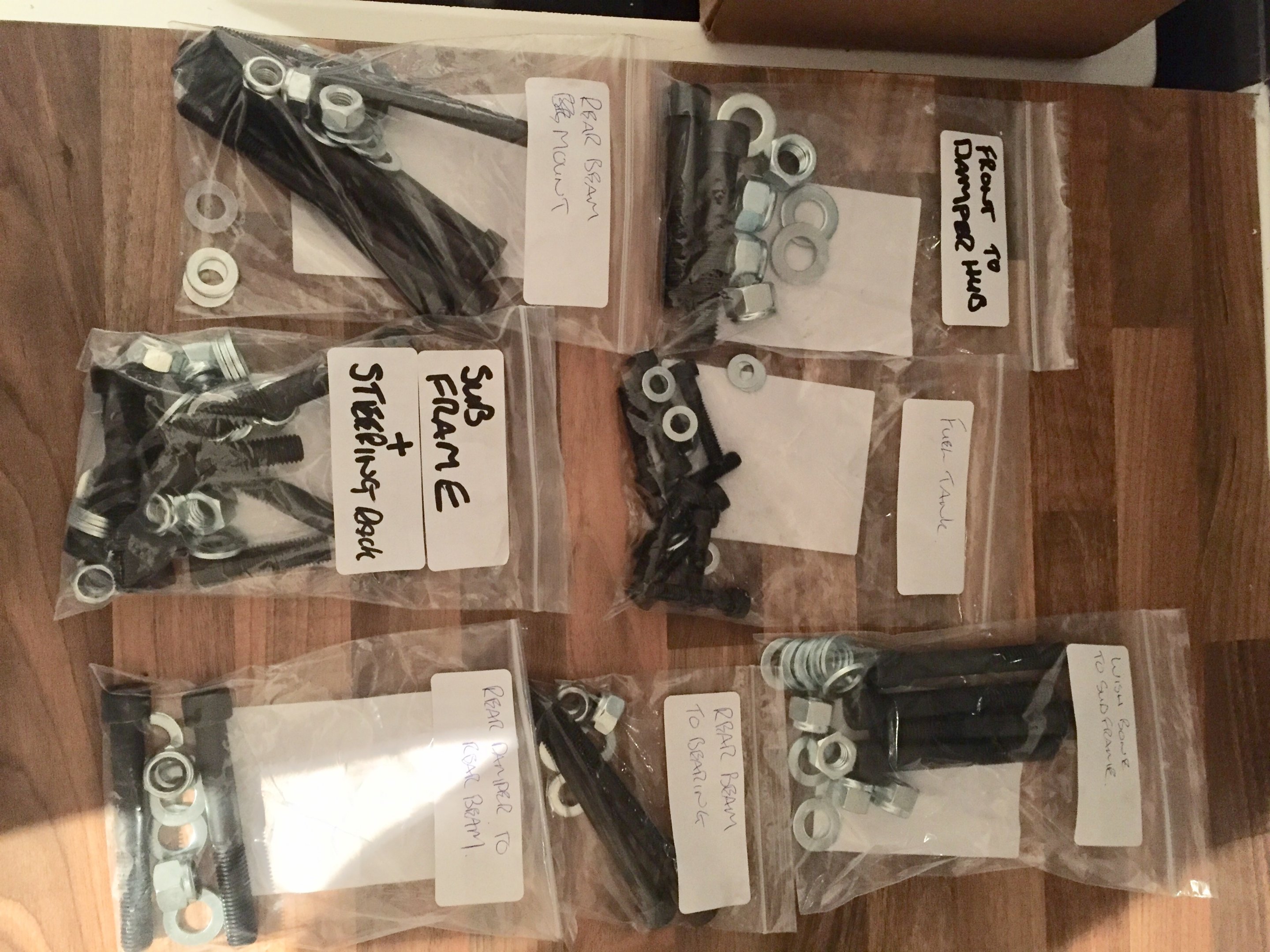

Last night I went through my bolt order and labelled them up with their location.
Don’t panic I have 2 tins of ACF-50 for all bolts, nuts and treads.

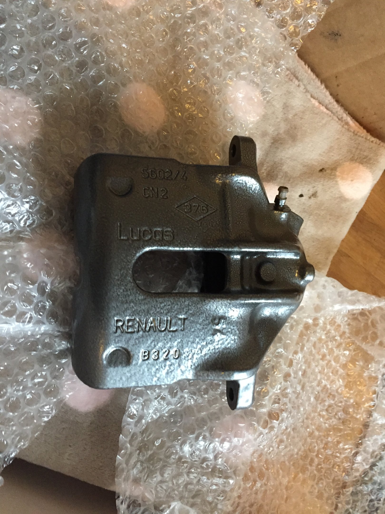

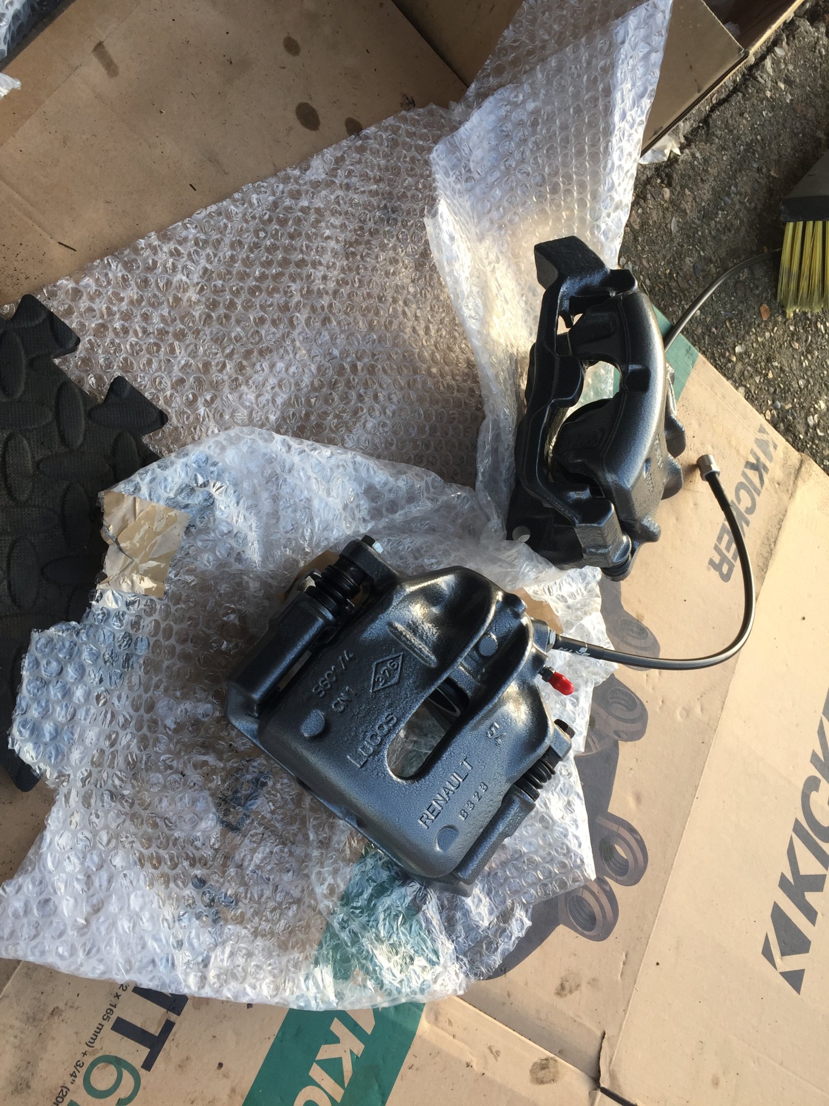

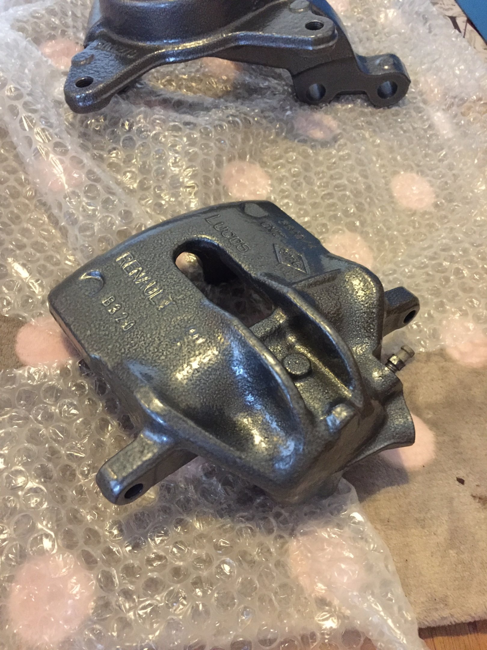

Front callipers all made up with new pistons, inner and out seals with new dust boots for the slider pins.
The lines are on but not tight.
