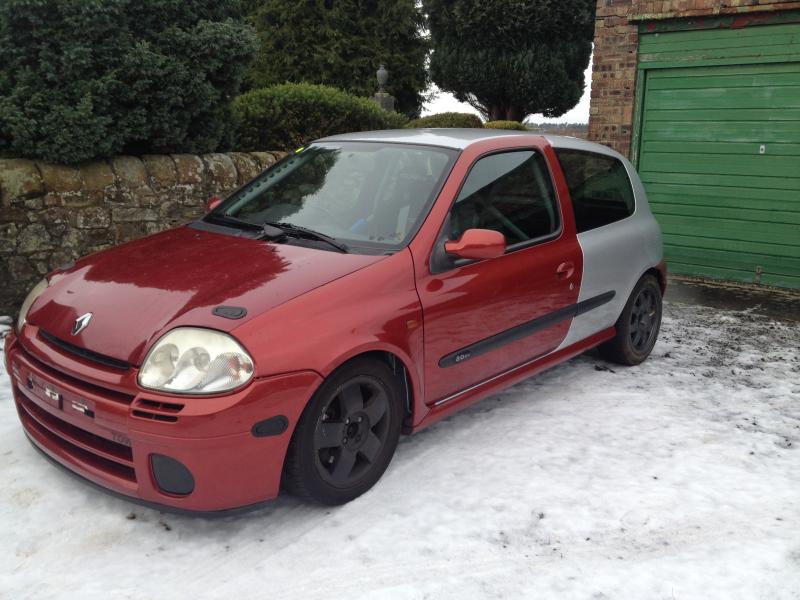

So I picked up this dci 65 from south London.
It's got 107,000 miles with full history, a clutch change around 70,000 and a cambelt at 65,000. Recently had new tyres and brakes all round. Previous work also includes new window regs.

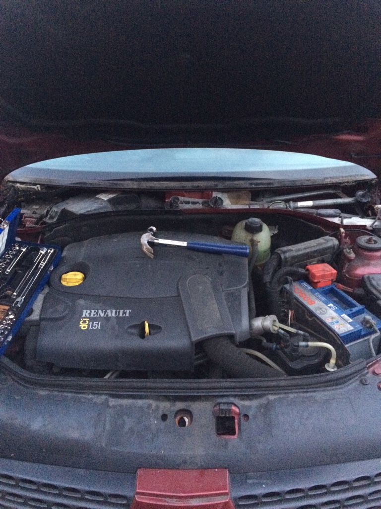

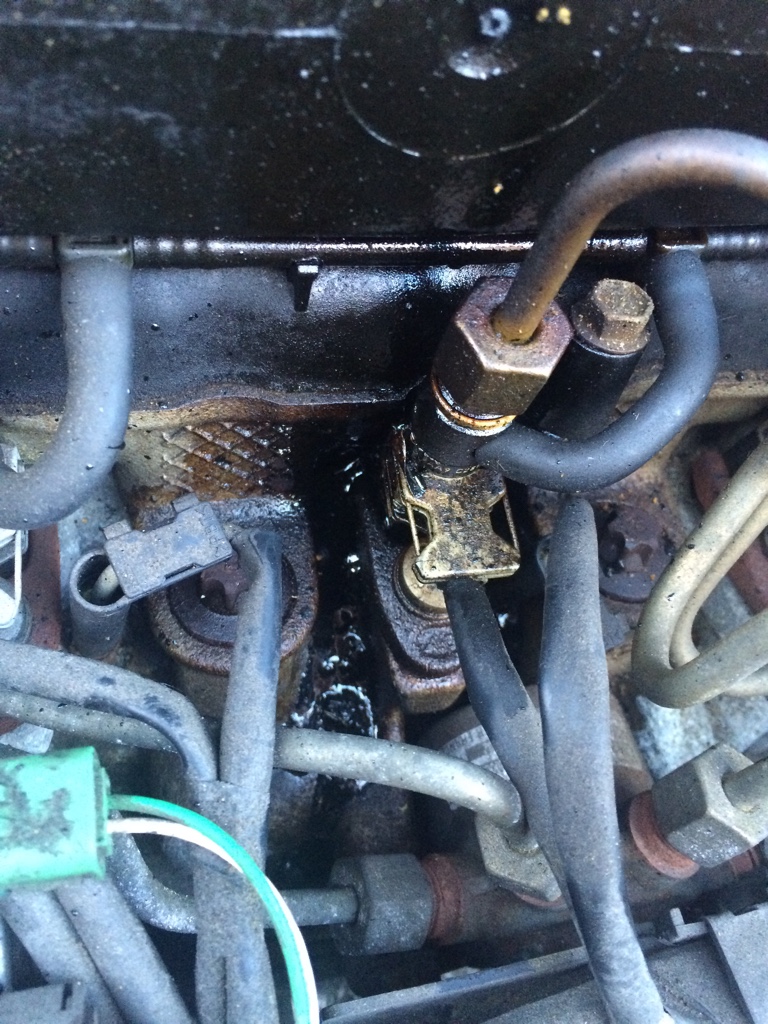

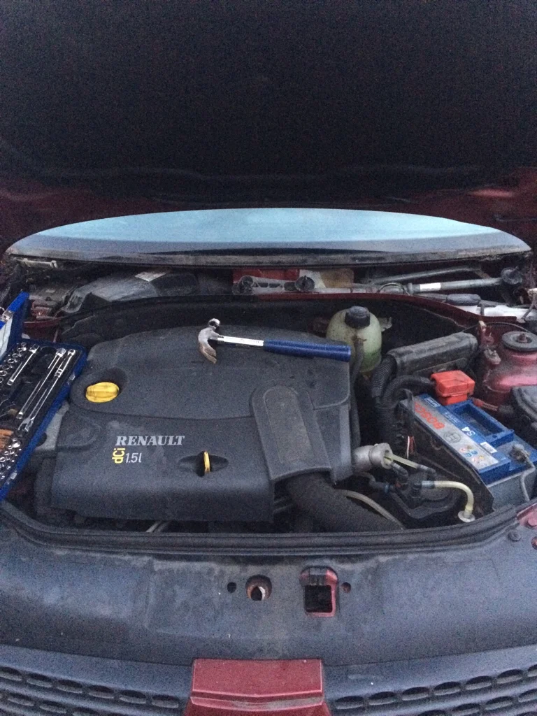

Was up for £500 which was cheap anyway but opened up the bonnet to find this:
I thought it looked like an injector seal needed replacing but am no mechanic. Ended up walking away with the car for £250 after a lot of negotiating.

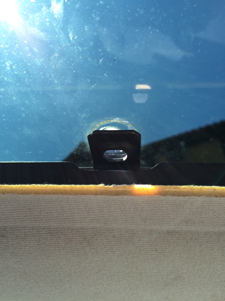

I think they run down into the scuttle panel and drain via the 3 points you've already cleaned up. The Mrs dci has a leaky sunroof that at some point I will remove and replace the seal between the sunroof and boywork
So the sunroof seems to all run away and down the scuttle exits perfectly so that's that done.

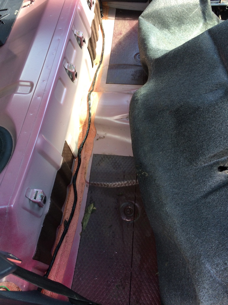

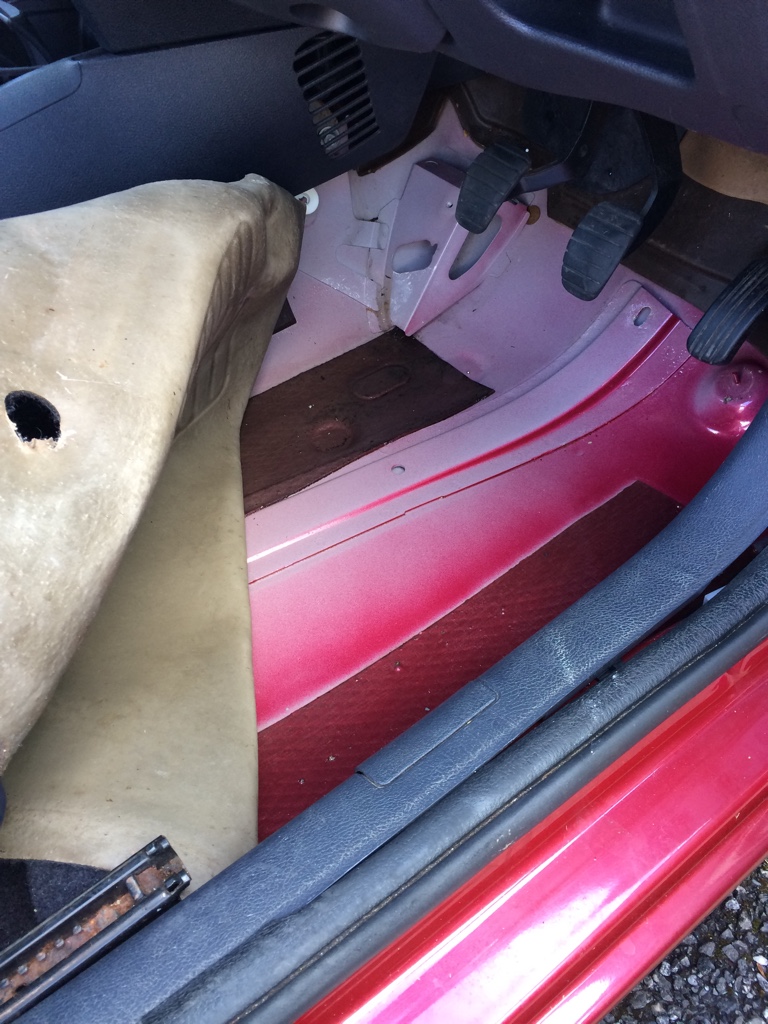

Found a swimming pool under here:
Drying out the foam now and as for the rear...
The sound deadening went in the bin as it smelt horrid.

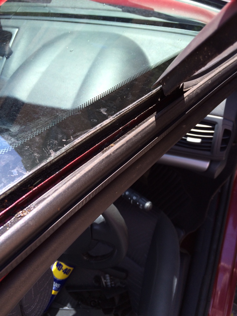

I've found where the leaks coming in from:
Not sure whether I need to get the door seal replaced or windscreen surround or this top of door shut seal replaced...
Will eBay some of the for an idea of cost...
Luckily it's just the drivers side!!
Fixed the leak!!! Lots of sealant around the seals of the door shuts!

Leak was indeed an injector seal but the gent said he couldn't get the injector apart to replace it so it needed a new injector.
Full service is then being done with plugs ect aswell
Then they found that both rear brake cylinders are leaking so that's another chunk on the bill but should have a perfectly sorted car for £800 all in that's serviced, mechanically sound and ready to do 70mpg for me [emoji1303]

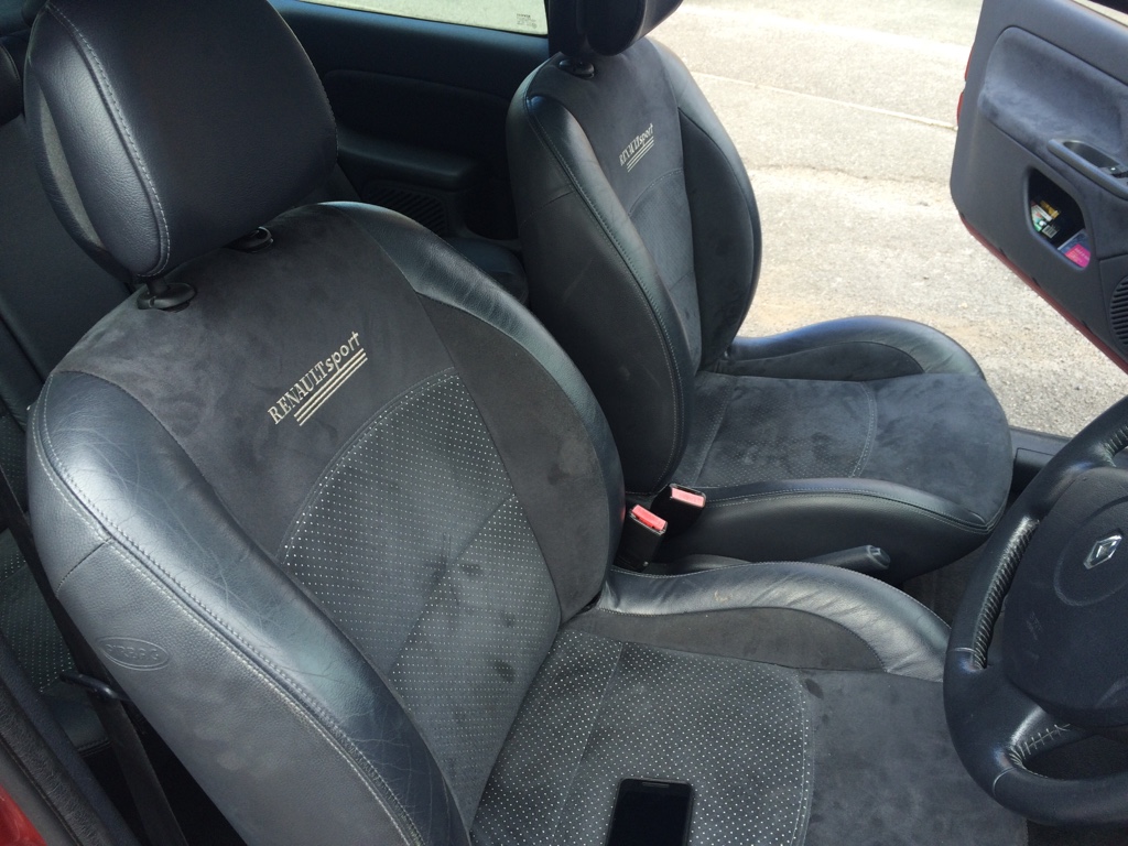

Today I met Graham, who was a top chap, to collect a full white dot 182 interior.

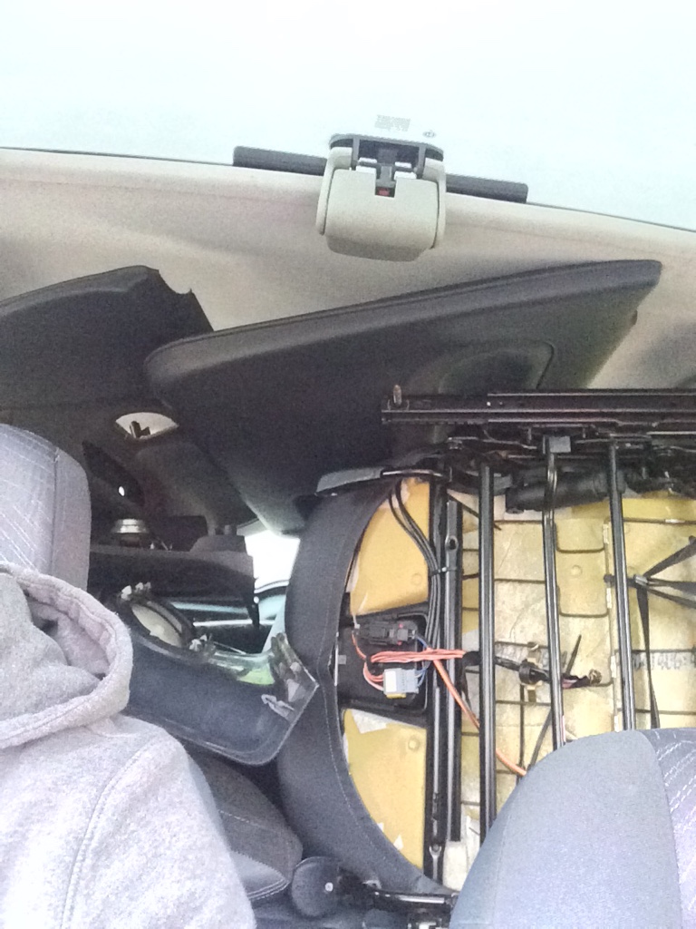

Managed to do all the door cards and trim, rear bench but stalled at the carpet and seats as getting under the car for the rail bolts was all too much after that lot before.
Ramps and axel stands one evening this week will get it done!
Should be a lot nicer inside (and not smell of damp!!)
Finally got round to fitting the rest of my interior with a neighbour's help.
So so much better and doesn't smell of damp.

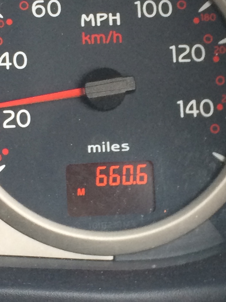

So this was the end of the first tank of fuel:
Mixed driving but makes trundling around more worth it!!
