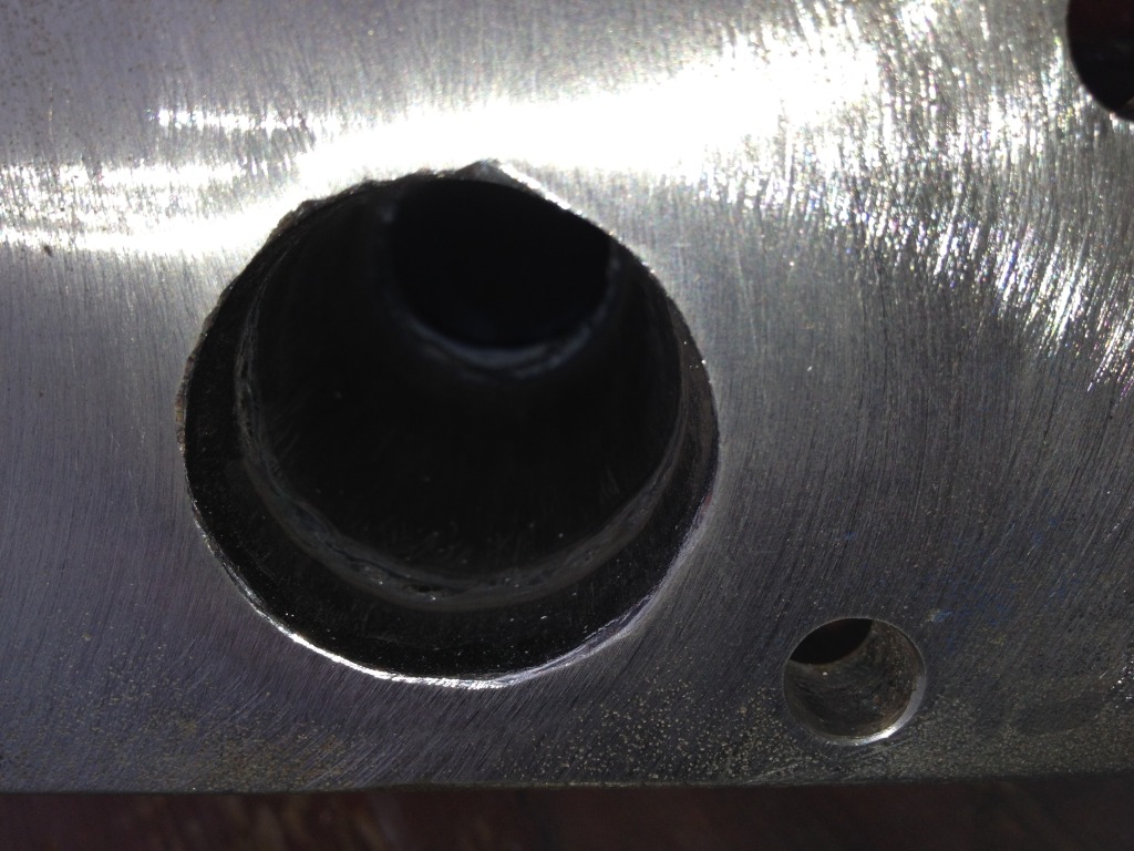

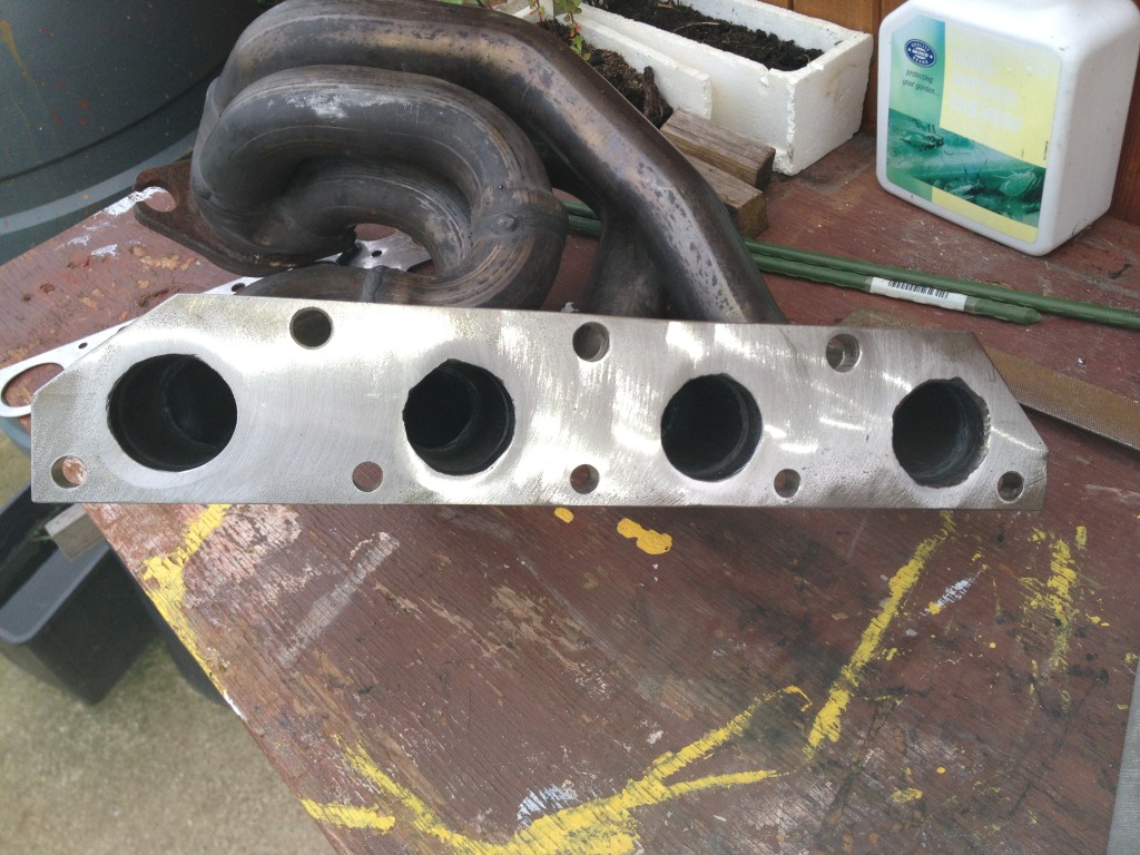

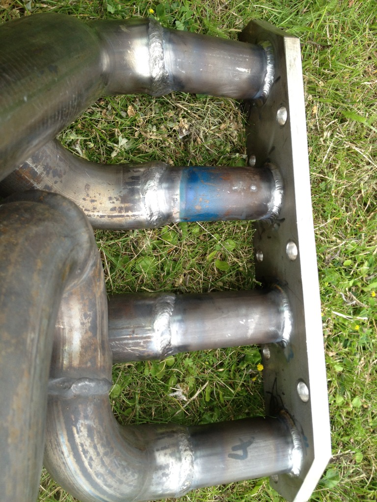

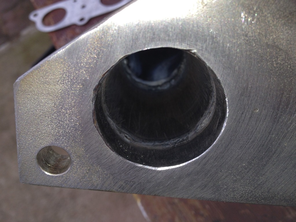

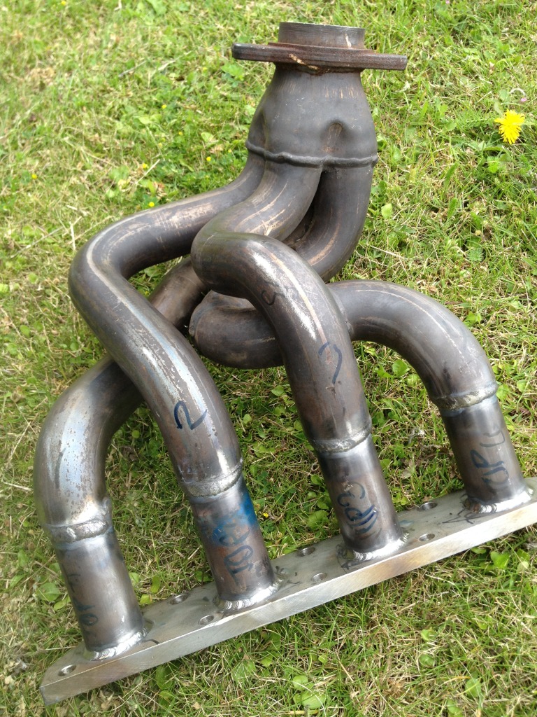

Well i have been a busy bee recently. For those of you that dont read my project thread i have had a little bit of fun fabricating a F4R manifold (from a clio 172) to fit my F7R. I believe that I am the first person to do it. I know a couple of people had started to do it but didn’t follow it through because of the amount of work involved. I hope that this is going to be a decent upgrade to the standard valver manifold and downpipe as well as the Williams item and the aftermarket Supersprint item. Also this hasn’t cost me too much money to make just a lot of my time!
I had the inside face (gasket face) fusion welded to teh flange to allow no leakages so then i had to file the welds flat just to stop the exhaust from having poor flow.
Comments please thanks Dan
looks cool but hopefully you wont get bad pulse effect tuning from the welds intruding the inner side of the pipe!
Looks good needs a bit of finishing off (rounding the holes where it meets the mounting plate. be keen to see what improvements it makes.
I'm hoping the improvements wil be good as the main part of the manifold is a bigger bore. The welds on the inside I'm going to file down a bit. It took me long enough to do the ones near the flange so that's a job for another day lol
Yeah i know exactly what you are saying Danny.
Fromt he look of your picture though the manifold will fail against the starter motor once the bottom end is in place. I dont think your one will fit an F7P/R once the engine is complete.
well it would foul the F7R starter, but not an F4R one.....but i didn't want to pay for one of those ;)
The 172 manifolds are superb bits of kit, and worth pennies because they never crack so no one is ever looking for one, so it makes a lot of sense.
