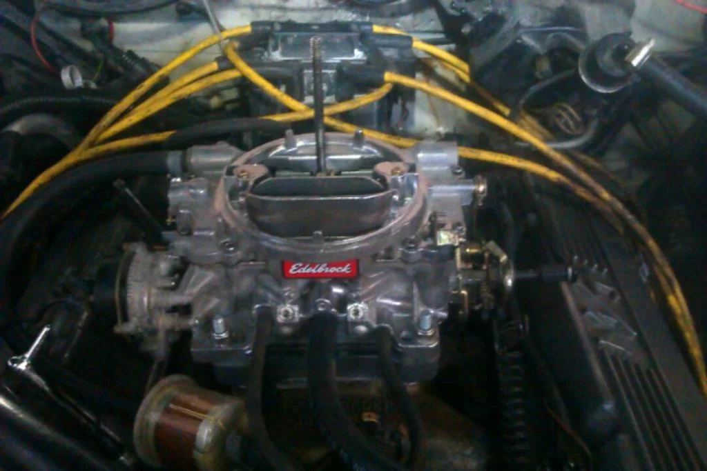

Little bit of an update. Managed to organise a full brake system from my friends car which he sadly plowed into a lorry. They should arrive at the garage this weekend.

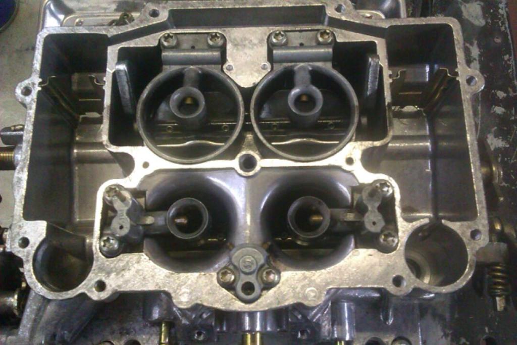

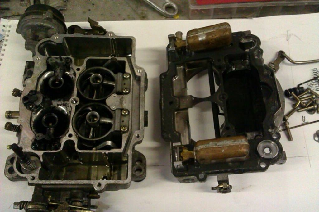

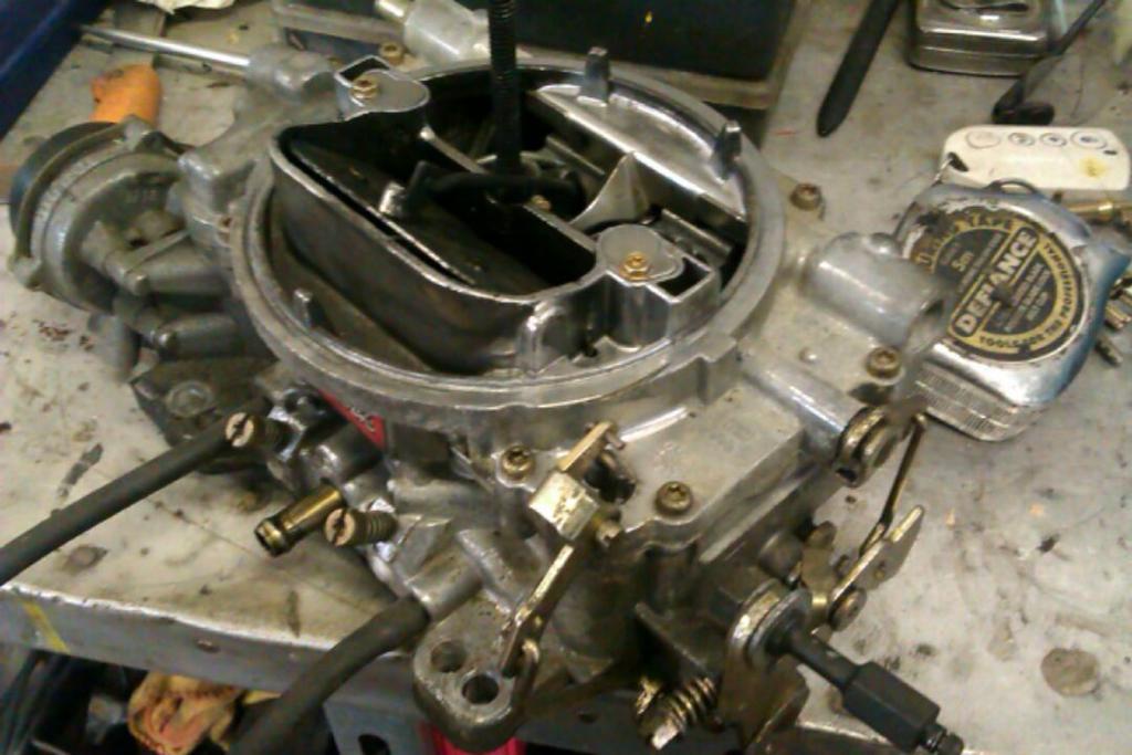

As for KITT.....well when they took the carb off they found some issues. Very sooty for a start, spring broken, etc etc. luckily it's fixable as he had the parts in stock. He's actually dismantled, cleaned, reassembled and repaird the carb today lol
Before:
After:
Still LOADS to do. Valve lash, new dizzy and of course the original list. All steps in the right direction.
