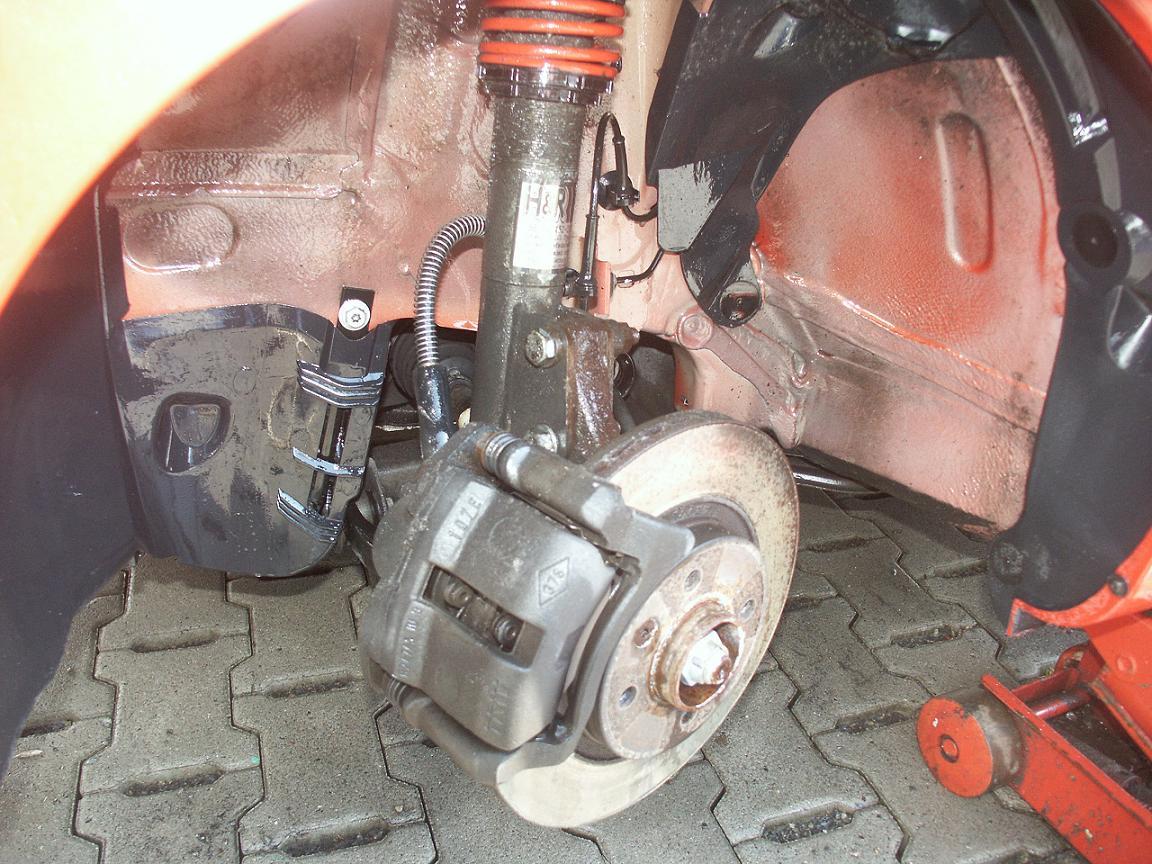

strut bar is also reworked
I want to drive in the circle! (Nürburgring :race:)

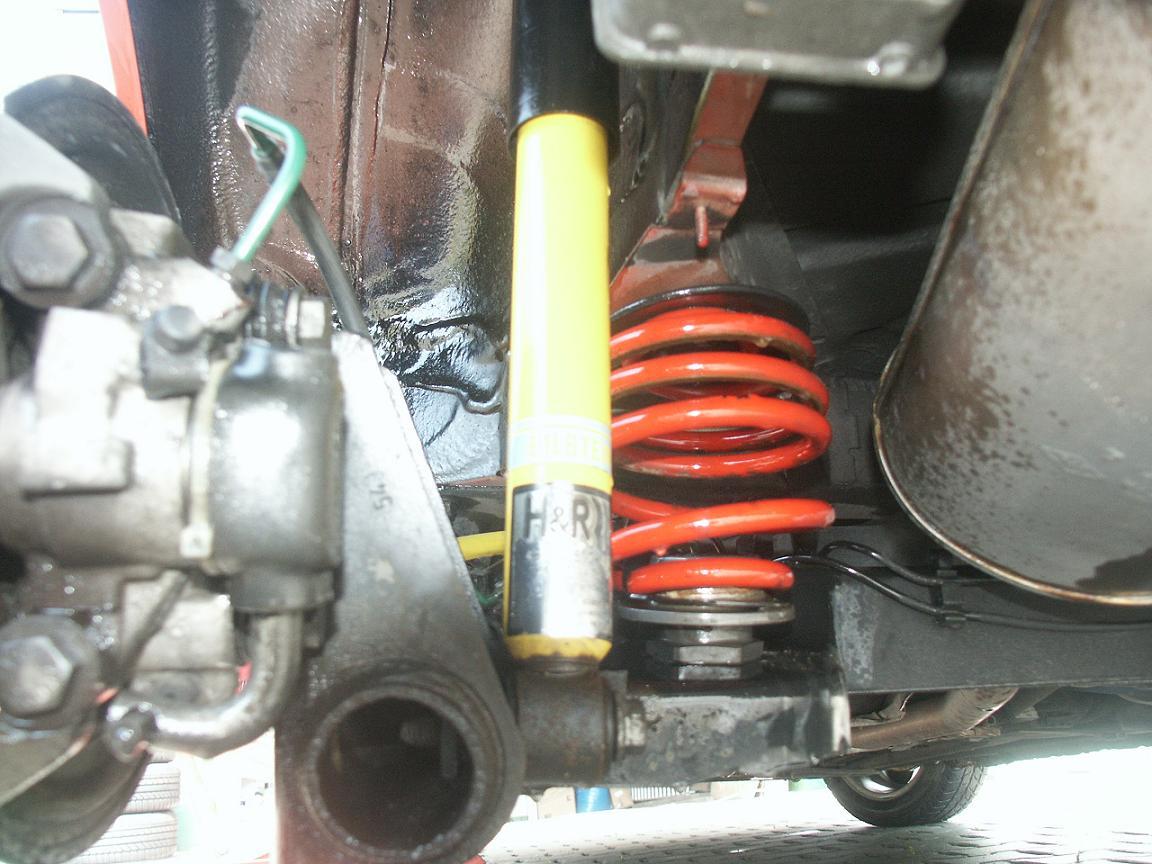

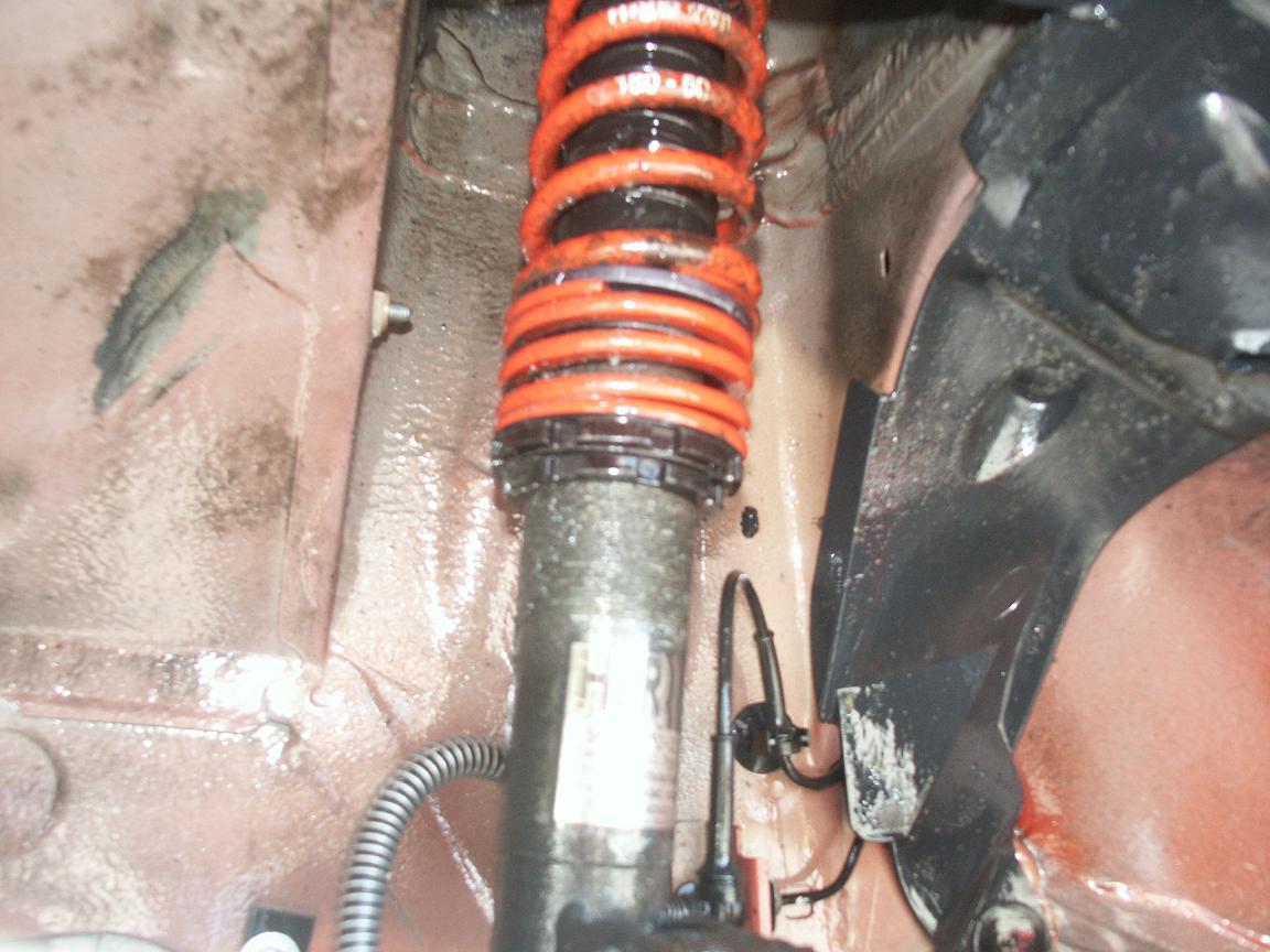

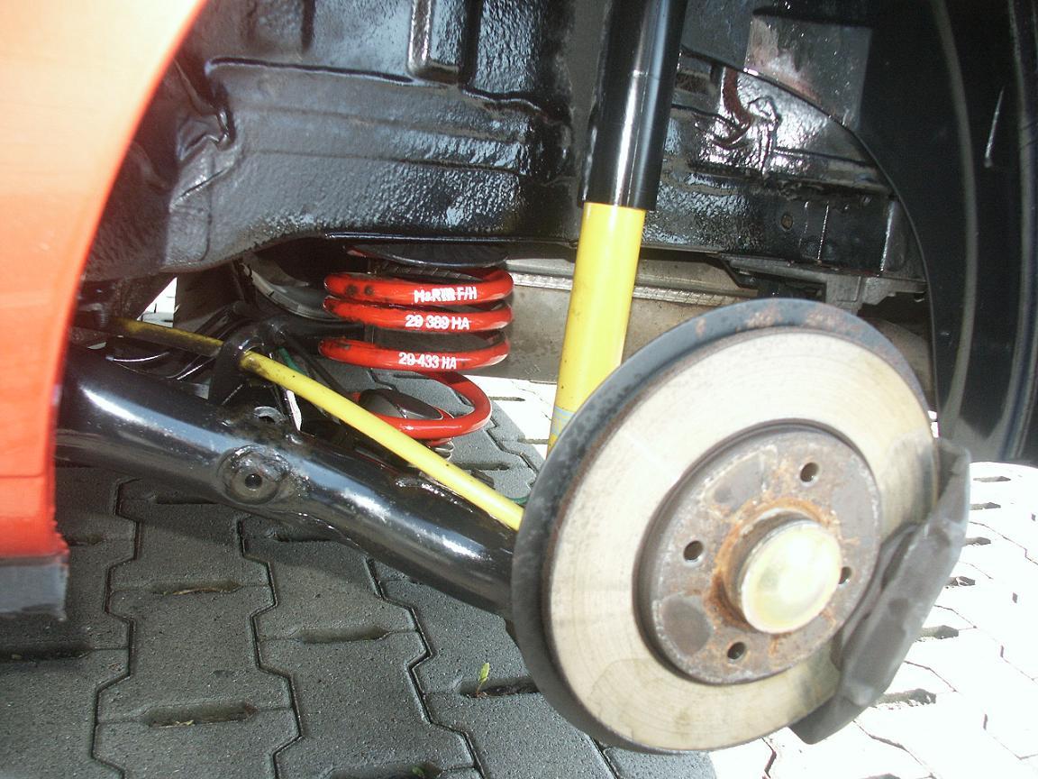

Suspension from H&R

I didn't realise H&R made coilovers fro the non-RS models! Where did you buy them? Also, what gear stick is that? Are you running a short shift?
