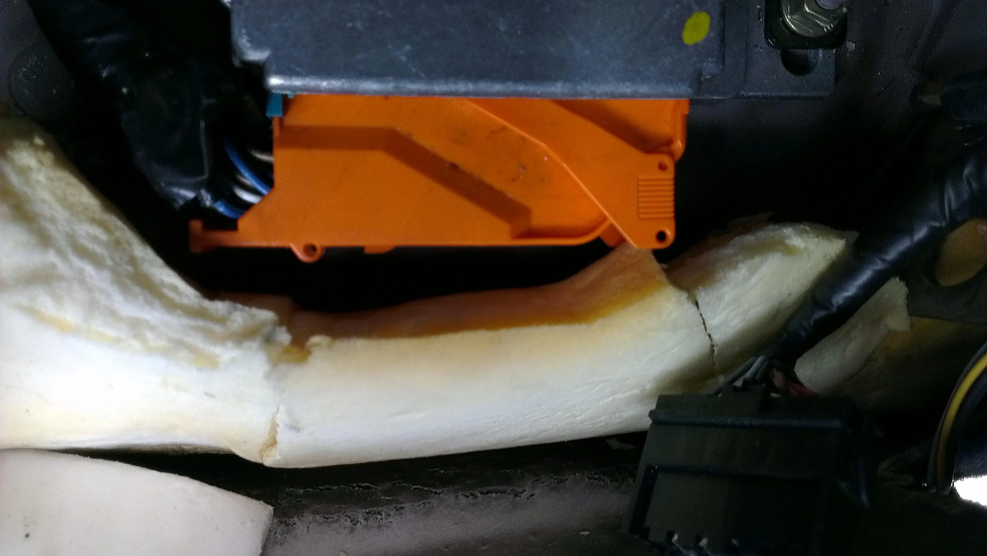

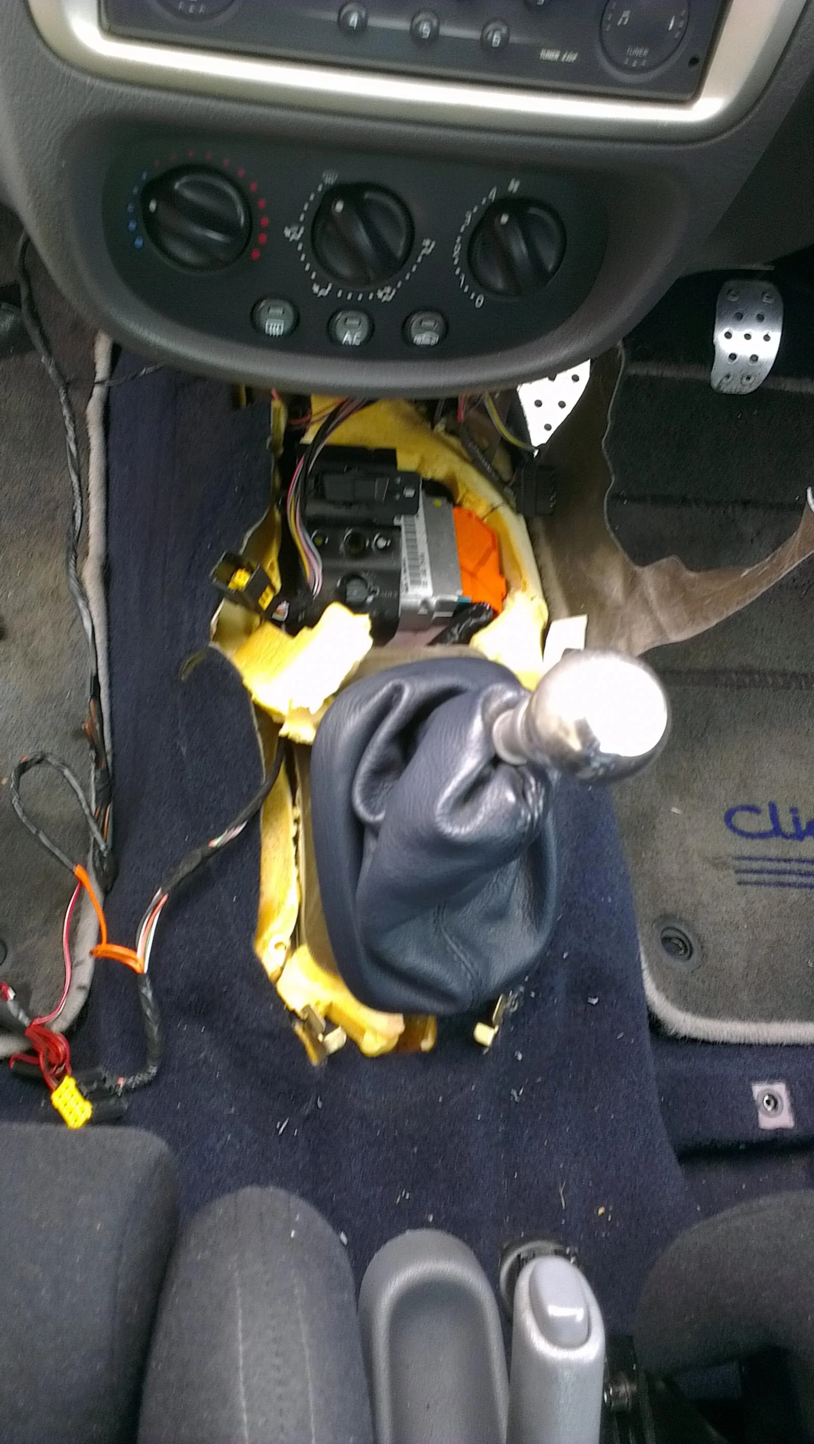

Step 1, remove plastic center console, 3 hex screws to undo, one either side of the gearstick end and one underneath the ashtray. Disconnect all plugs:- Hazard switch, cigarette lighter and locking switch, push led for alarm through console. Pictured here with trim removed and all plugs disconnected.

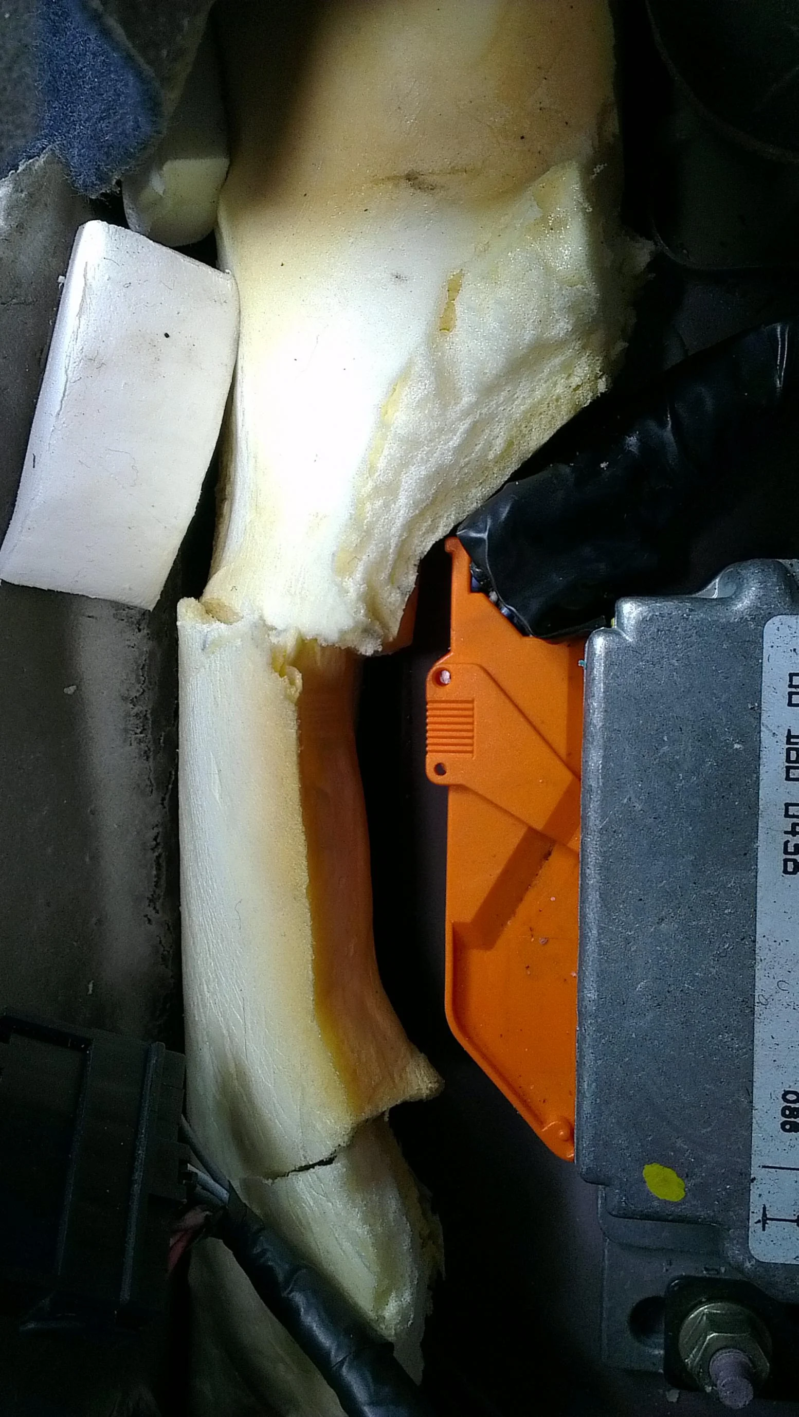

Step 2, This will involve some cuts to the carpet and foam surrounding the gear stick and airbag ecu which is located infront of the gearbox tower, (picture below is reverse angle)
IMAG1028.webp ECU is the shiny thing, plug you are looking for under the orange cover.

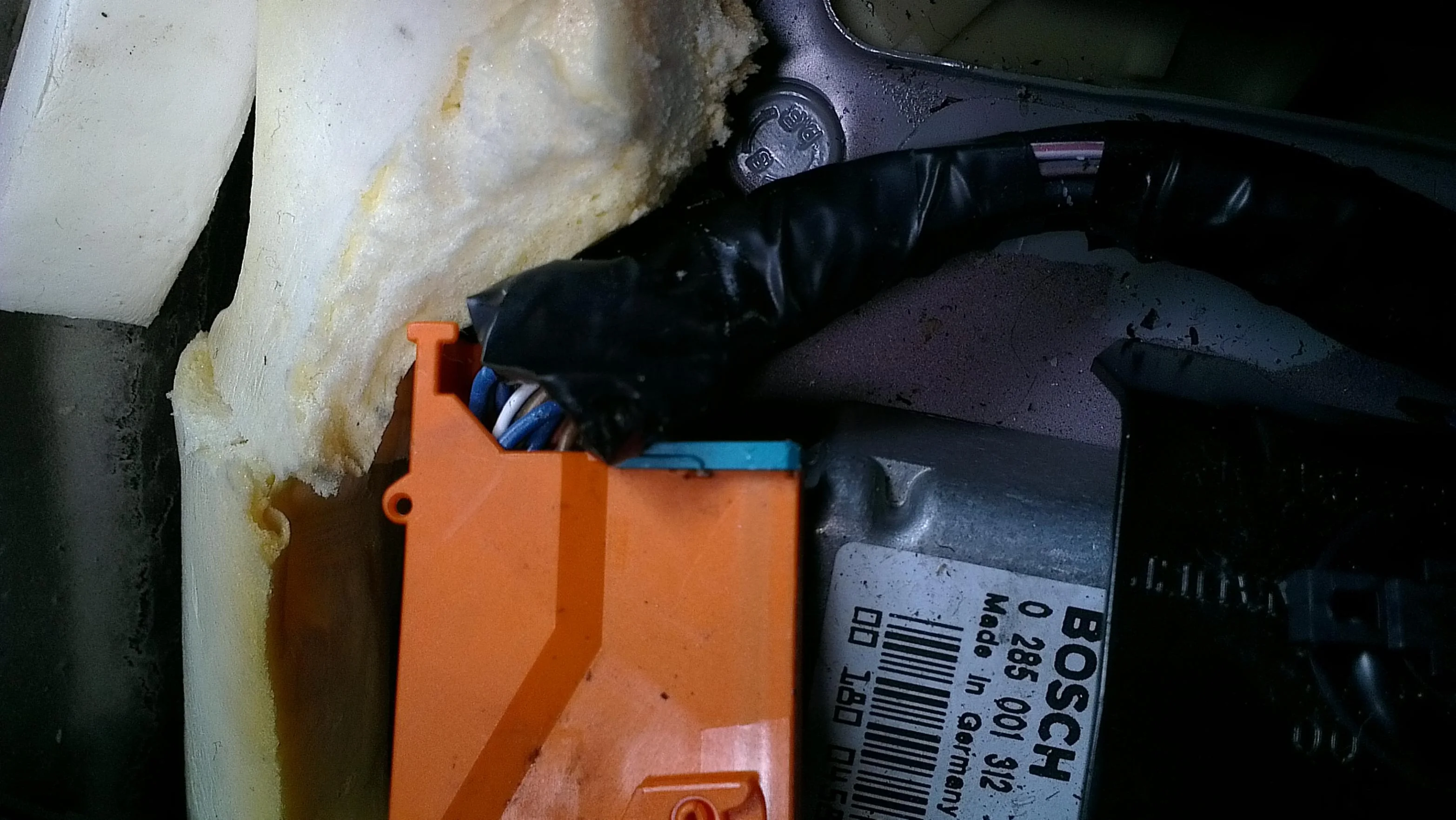

Step 3, Unclip large clip on the cover and slide to the side (picture shows clip open)

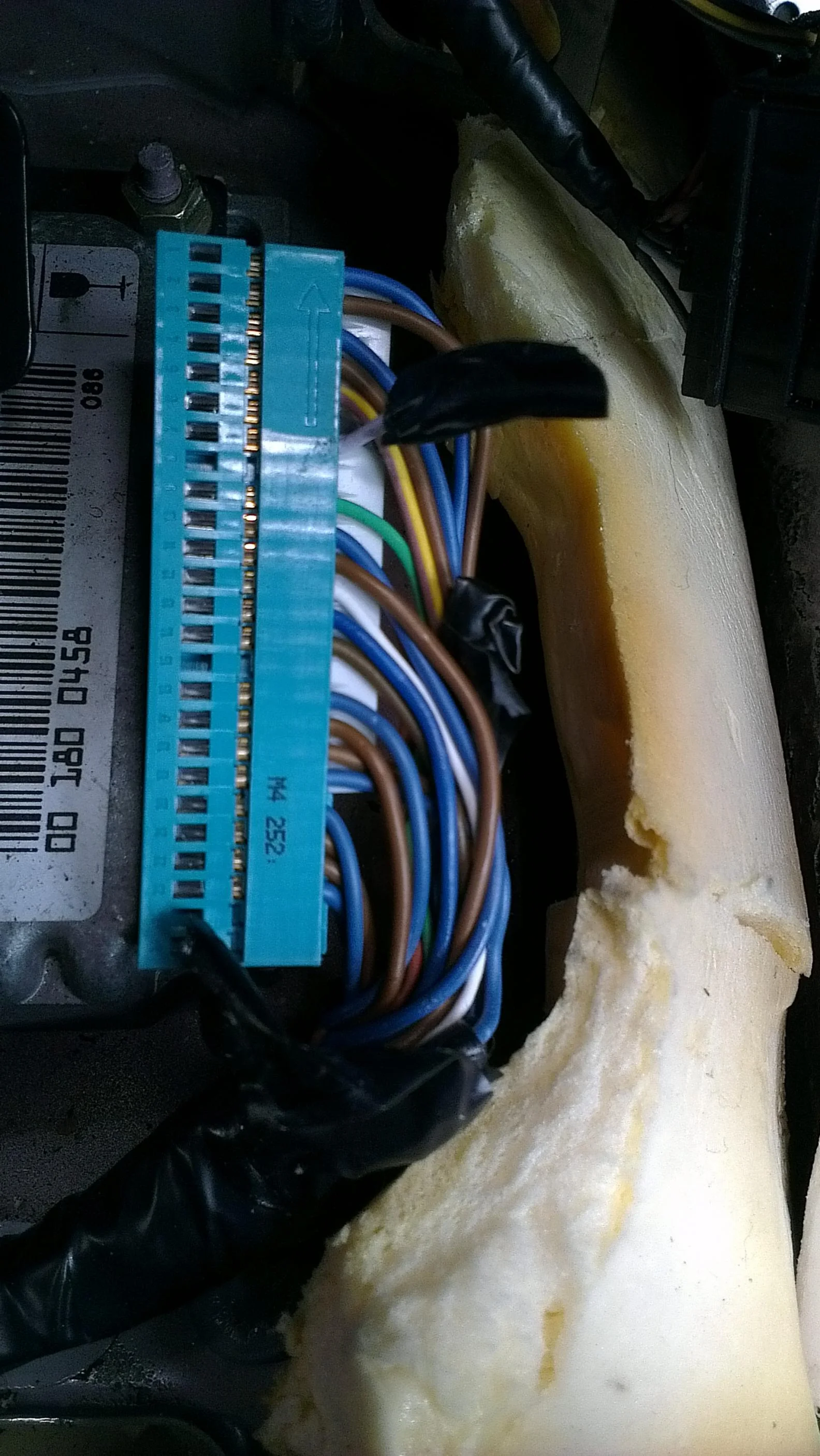

Step 4, Remove plug pull either side of orange clip and the pug will come out. (picture again reverse angle plug will be on the right of the airbag ecu).

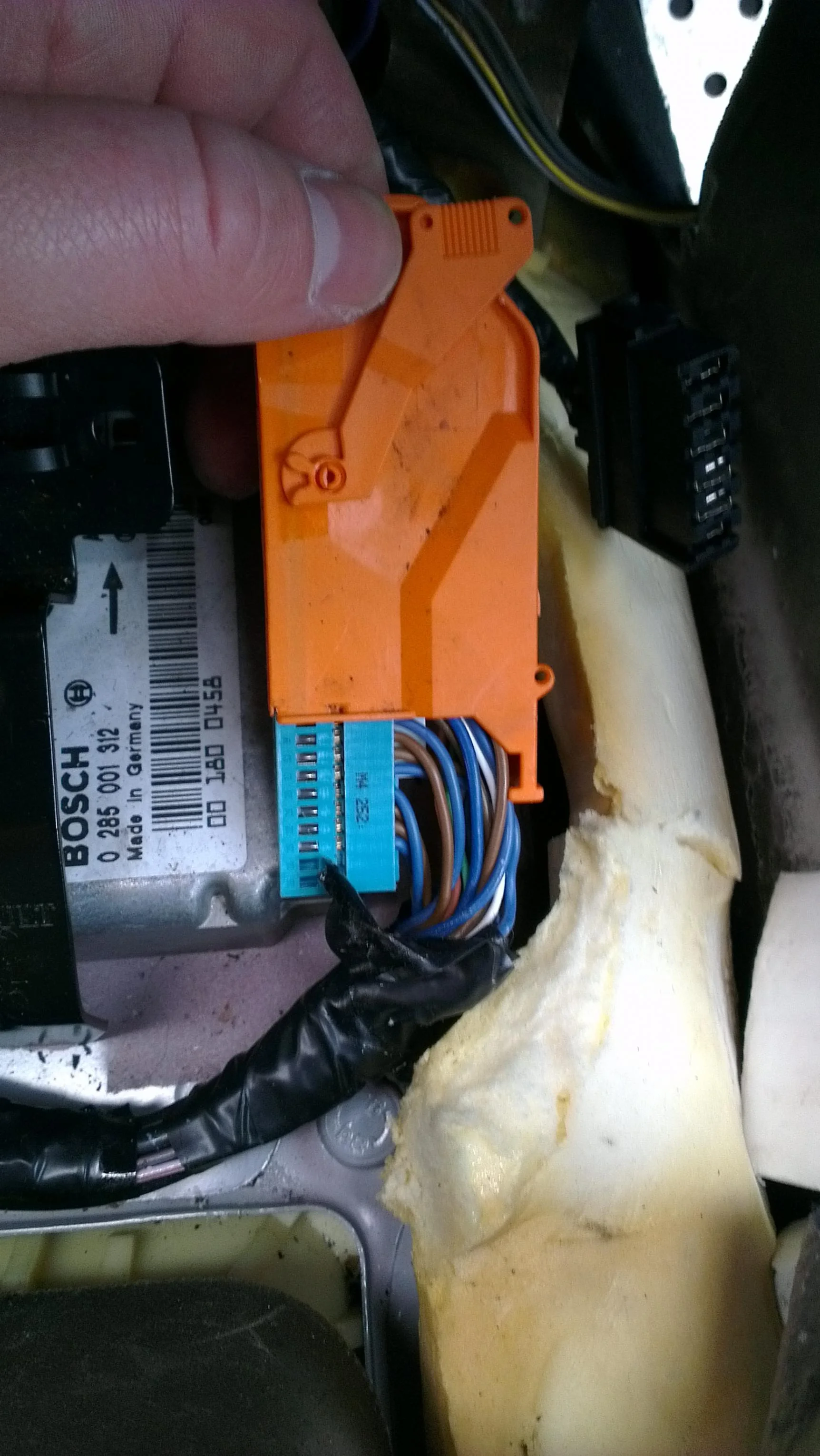

Step 5, Remove grey end plate from orange cover (can be seen top of the orange cover in above picture). Then slide orange cover off the plug.

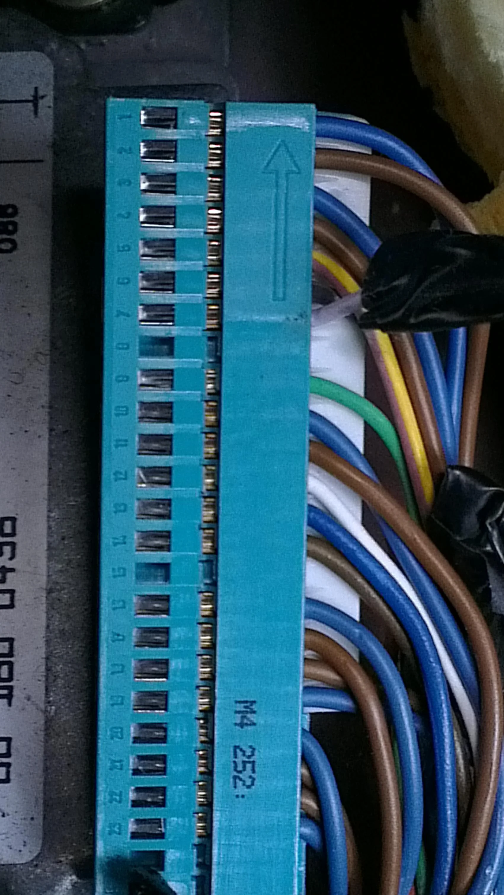

Step 6, Locate wire number 7 (see picture for numbering on the plug) and cut/remove the wire.
Step 7, reassemble everything, turn ignition key and note no warning lights.

Just to add to the above, the cuts made to the carpet and foam cannot be seen once the center console is replaced.
