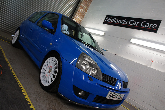

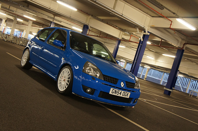

I spent last Saturday working on a Racing Blue 182, then Sunday I had a... Racing Blue 182!! The paint on these little beasts is ROCK HARD, so I had another battle on my hands all over again...

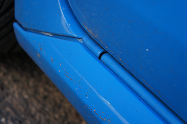

Some befores:
DSC05318 by RussZS, on Flickr
DSC05319 by RussZS, on Flickr
DSC05320 by RussZS, on Flickr
DSC05321 by RussZS, on Flickr

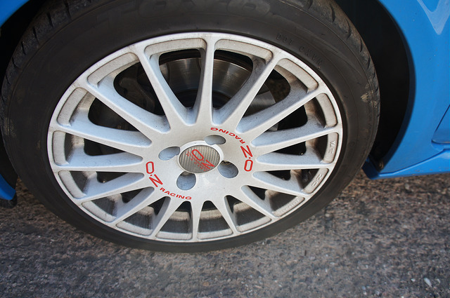

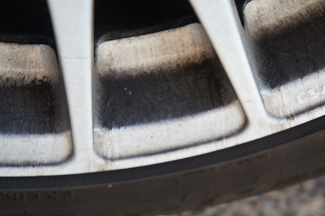

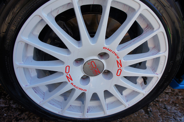

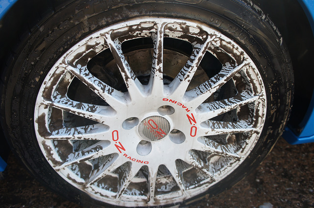

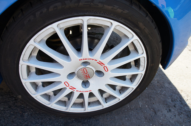

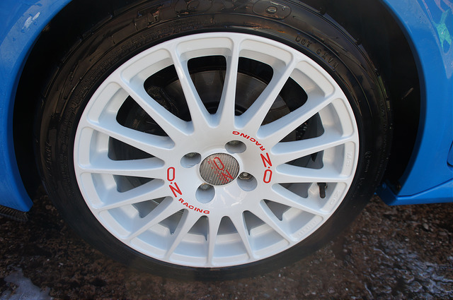

Wheels were up first, and being white, were in a bit of a state...
DSC05316 by RussZS, on Flickr
DSC05317 by RussZS, on Flickr
AB Very Cherry was used at 4:1:
DSC05323 by RussZS, on Flickr
Pressure rinsed first:
DSC05324 by RussZS, on Flickr
Very Cherry:
DSC05325 by RussZS, on Flickr
G101 on tyres:
DSC05326 by RussZS, on Flickr
DSC05327 by RussZS, on Flickr
DSC05328 by RussZS, on Flickr
DSC05329 by RussZS, on Flickr

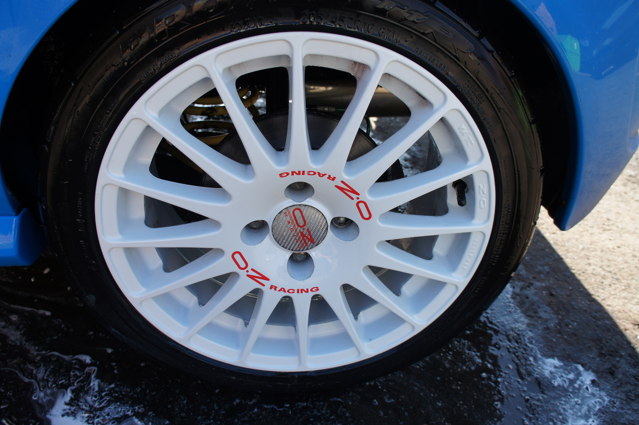

Ready for rinsing...
DSC05330 by RussZS, on Flickr
Taa-daaaa!
DSC05333 by RussZS, on Flickr

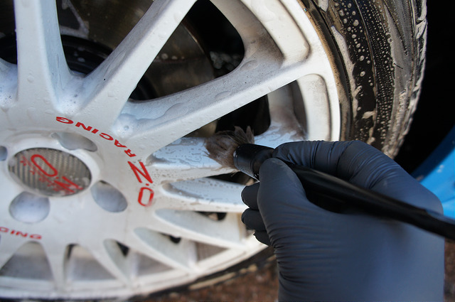

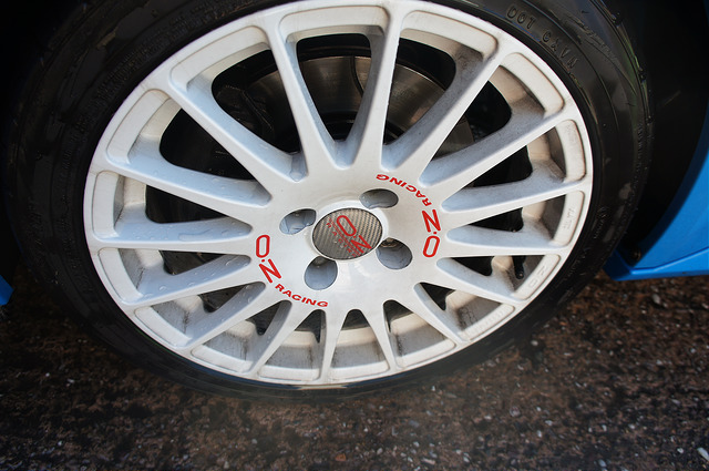

IronX followed:
DSC05331 by RussZS, on Flickr

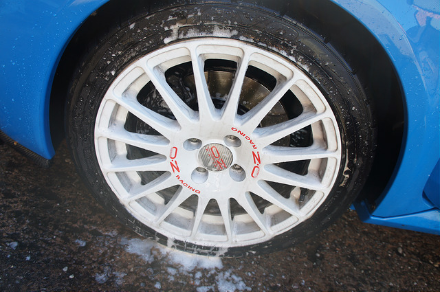

On the rear wheels I decided to test Concours Car Care's Dissolver which aims to address tar, brake dust and also degreases:
Before:
DSC05334 by RussZS, on Flickr
DSC05335 by RussZS, on Flickr
After 1 minute:
DSC05340 by RussZS, on Flickr
DSC05341 by RussZS, on Flickr
and rinsed... no agitation at all...
DSC05344 by RussZS, on Flickr

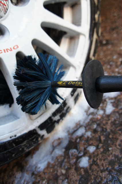

The rear of the wheels was done with Smart Wheels and EZ brush - very impressive for a touchless wash indeed and about 90% of the fallout was addressed which was almost on a par with a single hit of IronX!

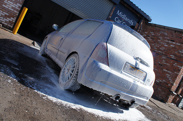

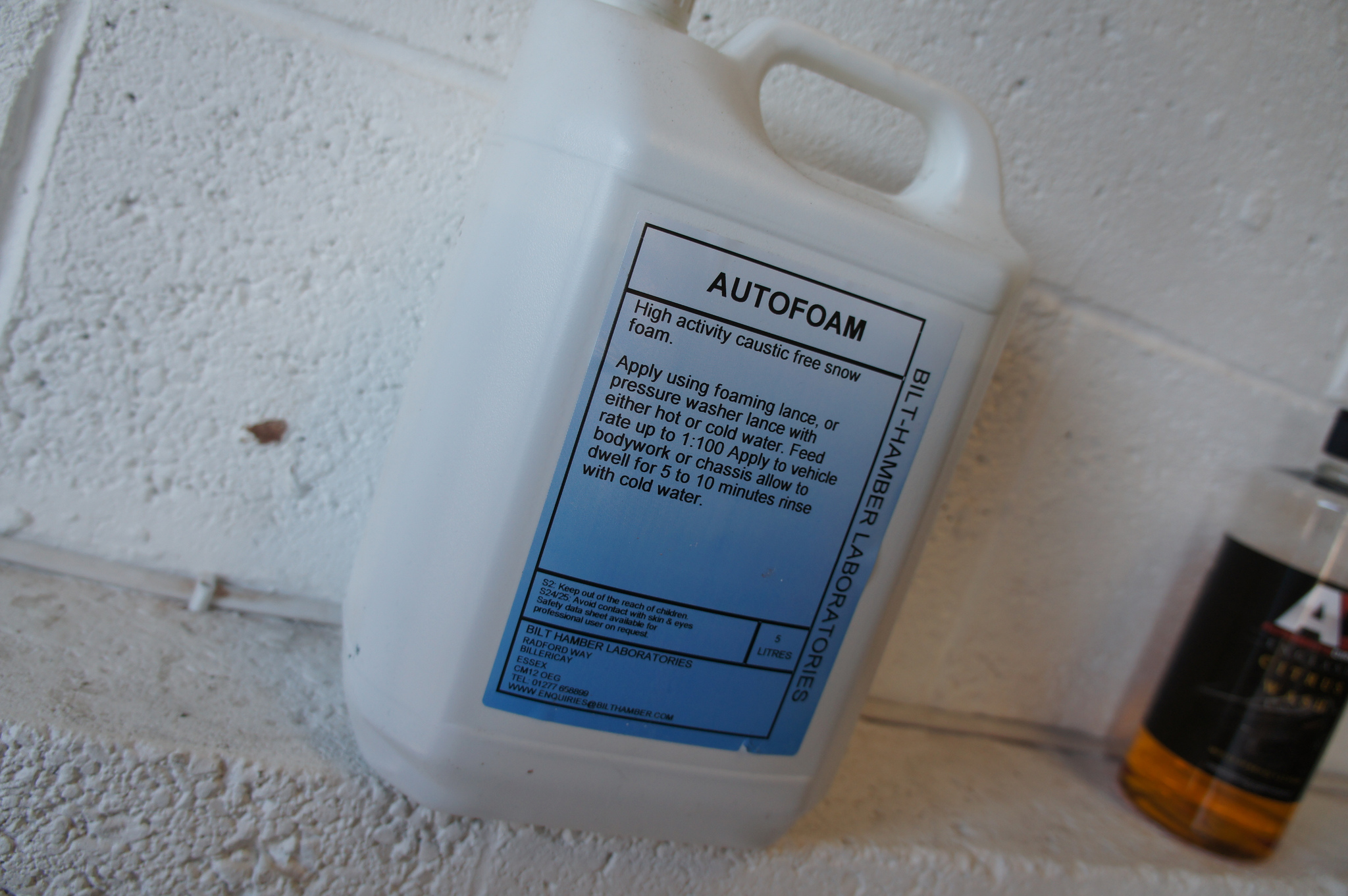

Foamed with BH Auto Foam:
DSC05345 by RussZS, on Flickr
DSC05346 by RussZS, on Flickr

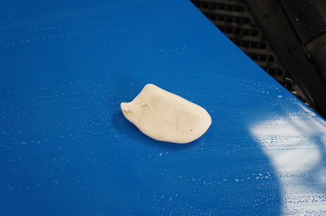

Clayed with:
DSC05353 by RussZS, on Flickr
Not much picked up, as expected!

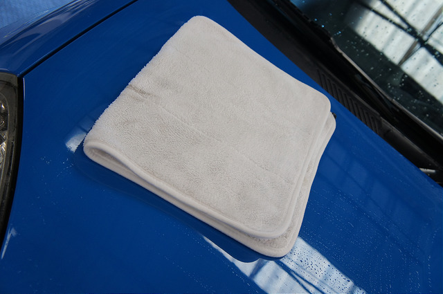

Dried with MF Crazy Drying Towel:
DSC05355 by RussZS, on Flickr

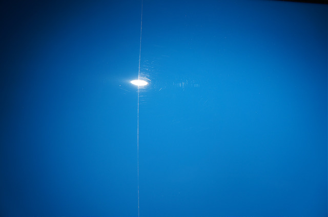

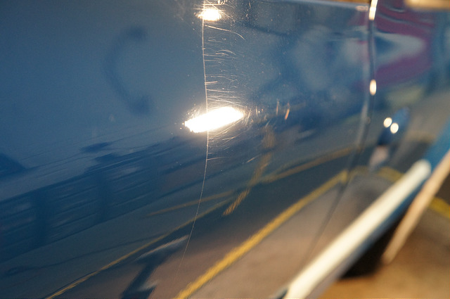

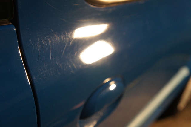

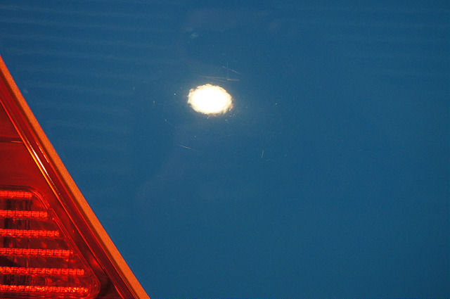

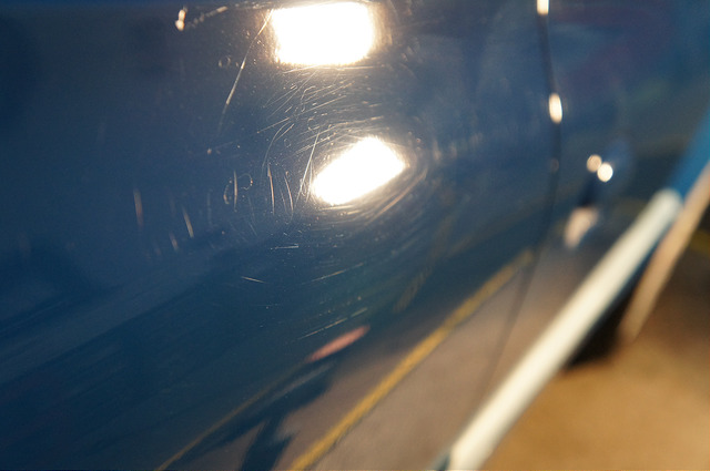

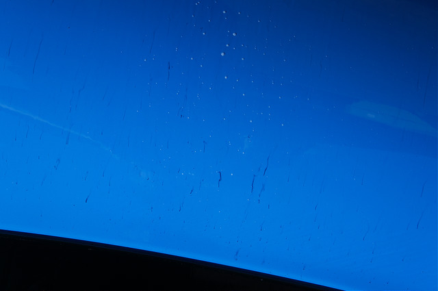

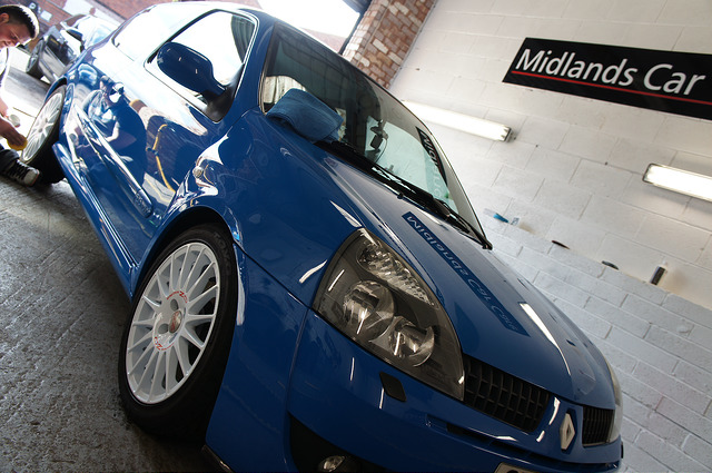

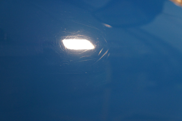

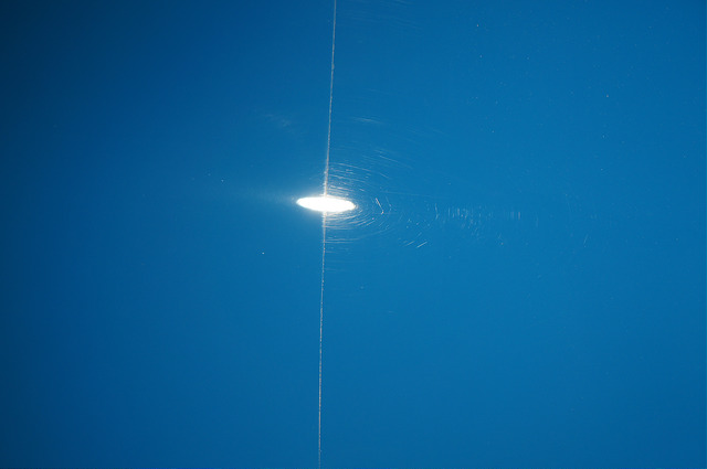

Next I began to assess the paint:
DSC05356 by RussZS, on Flickr
DSC05358 by RussZS, on Flickr

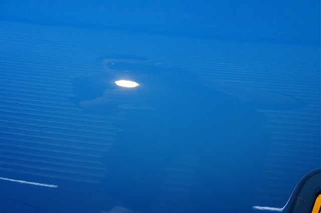

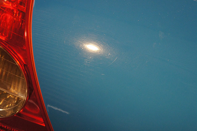

There seemed to be very little light swirling but lots of deeper stuff.
After playing with a few combos I settled on S3 via Wool/MF in parts, then refined with 203S on a 3M Polishing Pad:

50-50:
DSC05368 by RussZS, on Flickr
DSC05369 by RussZS, on Flickr
Not refined yet:
DSC05372 by RussZS, on Flickr
DSC05373 by RussZS, on Flickr
Before:
DSC05382 by RussZS, on Flickr
After:
DSC05385 by RussZS, on Flickr
A few deeper defects remained, but this is only an Enhancement...

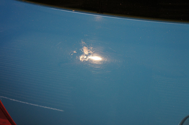

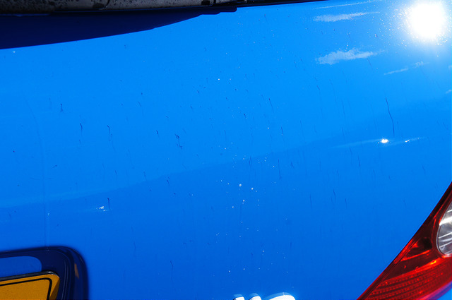

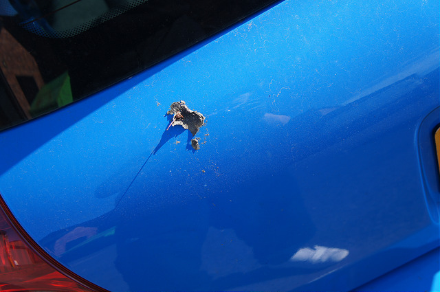

Boot with bird crap damage:
DSC05395 by RussZS, on Flickr
DSC05398 by RussZS, on Flickr
After:
DSC05404 by RussZS, on Flickr
DSC05405 by RussZS, on Flickr

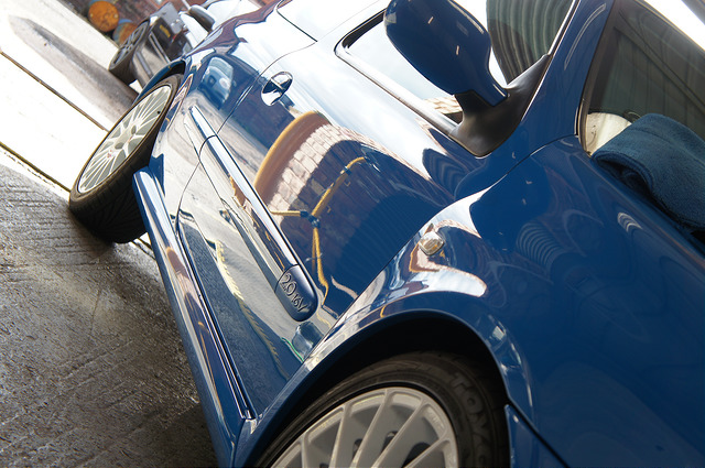

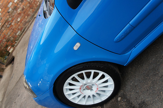

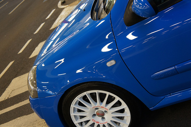

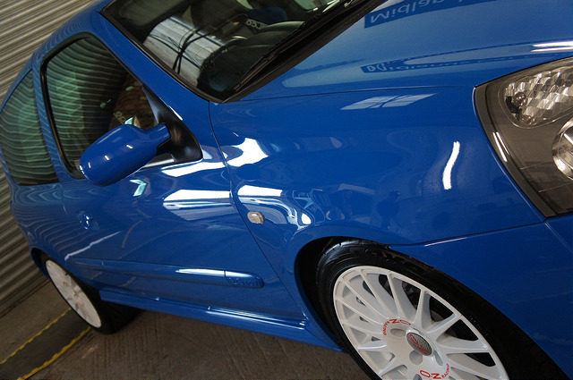

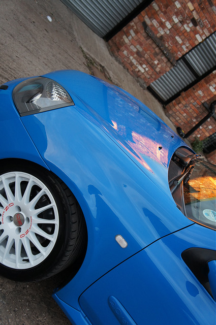

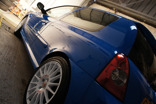

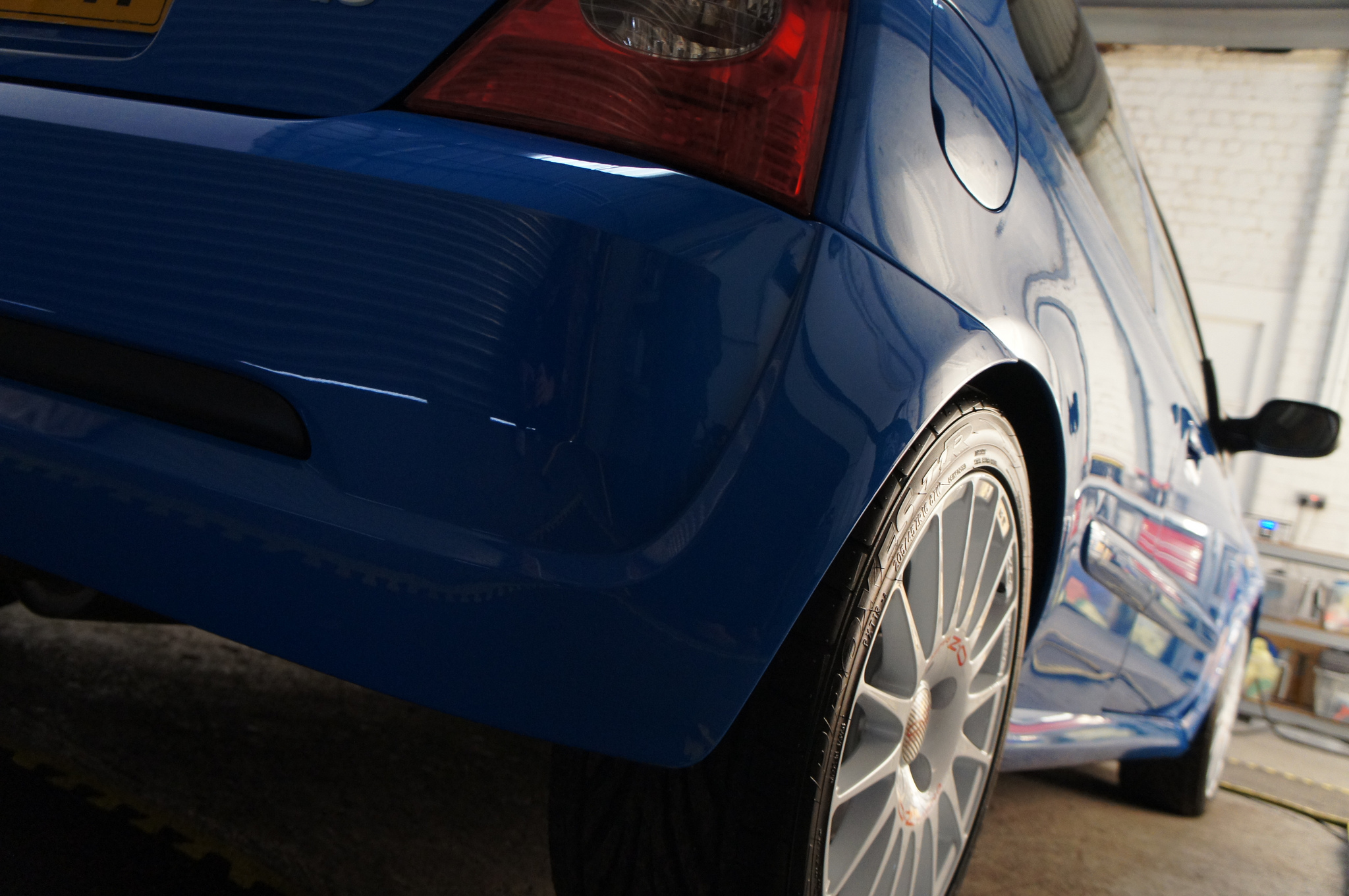

The car was finished with 2x layers of Swissvax Onyx...
DSC05407 by RussZS, on Flickr
DSC05408 by RussZS, on Flickr
DSC05409 by RussZS, on Flickr
DSC05410 by RussZS, on Flickr
DSC05413 by RussZS, on Flickr
DSC05414 by RussZS, on Flickr
DSC05419 by RussZS, on Flickr
DSC05421 by RussZS, on Flickr
DSC05422 by RussZS, on Flickr
DSC05424 by RussZS, on Flickr
DSC05426 by RussZS, on Flickr
DSC05429 by RussZS, on Flickr
DSC05430 by RussZS, on Flickr
DSC05431 by RussZS, on Flickr
DSC05436 by RussZS, on Flickr
DSC05437 by RussZS, on Flickr
DSC05441 by RussZS, on Flickr
DSC05444 by RussZS, on Flickr
DSC05445 by RussZS, on Flickr
DSC05446 by RussZS, on Flickr
DSC05447 by RussZS, on Flickr
DSC05456 by RussZS, on Flickr
DSC05455 by RussZS, on Flickr
