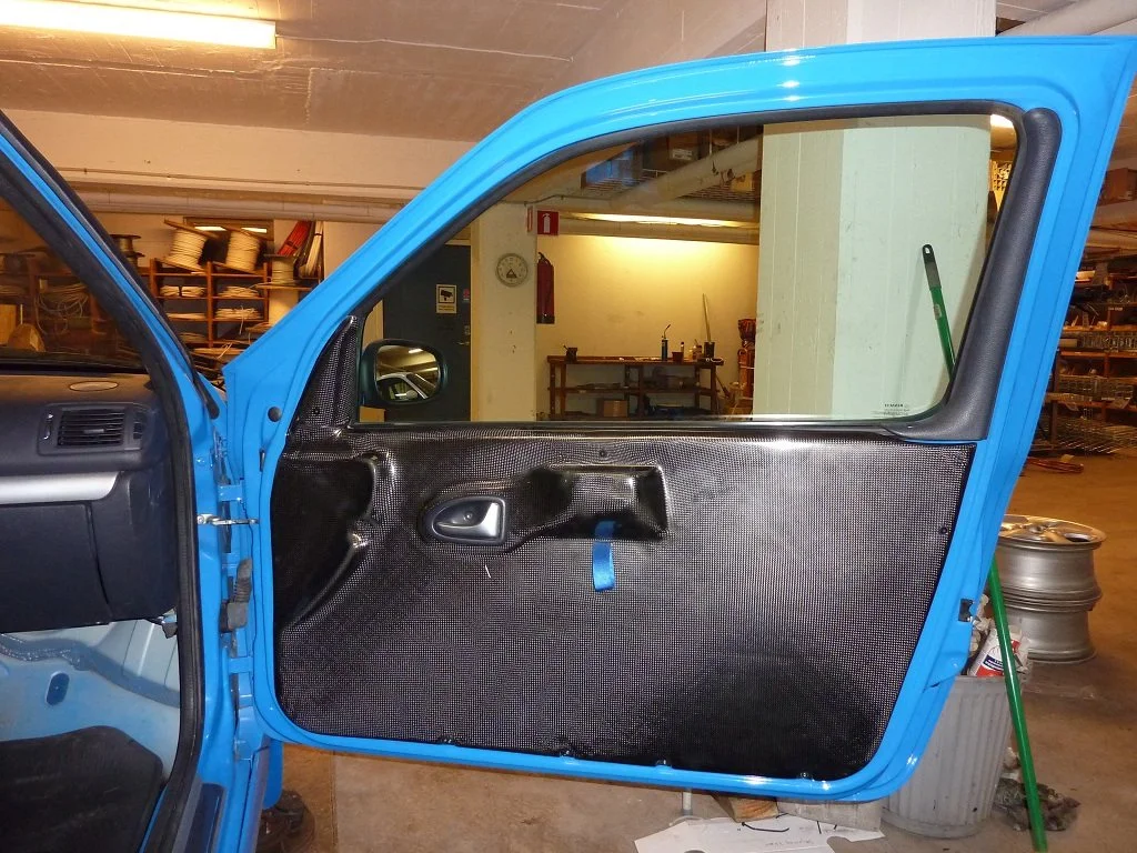

some very nice bits in that link, bet thats some monies worth too, the main reason i would n't be ordering them, did you get them all made up custom?
Yes they are very nice, race stuff but still good finish and quality. Not custom made for my car. Full carbon/kevlar hood with cell core = stiff, less than 2,8kg and 400Euros. One door = 450Euros 3,4kg each including kevlar reinforcements and the lot. Thats a bargain really

Yes I can sort some contact info, just send me a PM with your contact info and Ill pass it on. Parts are made in Poland and distributed through my contact in Sweden = no customs since its within EU.
Also take a look at some of the other items he has made like for the Coupra Supercopa you will see he knows what he's doing. Have bought doorcards there my self and they look great. Very light to, you can actually see through them holding them up to the sun.

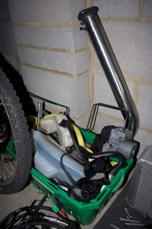

and today i spent more time out in the garage working on the engine, the clean-up / overhaul is coming along well and as you can see my fully cleaned parts bin is stacking up,
everything from the fuel rail, to samco hoses, brake lines, spark plugs, most fluid bottles etc etc etc are in there all fully cleaned and ready to go once the car is done, you can also see the first piece of the last ever yozzasport exhaust stuck in behind it.... nom nom nom,

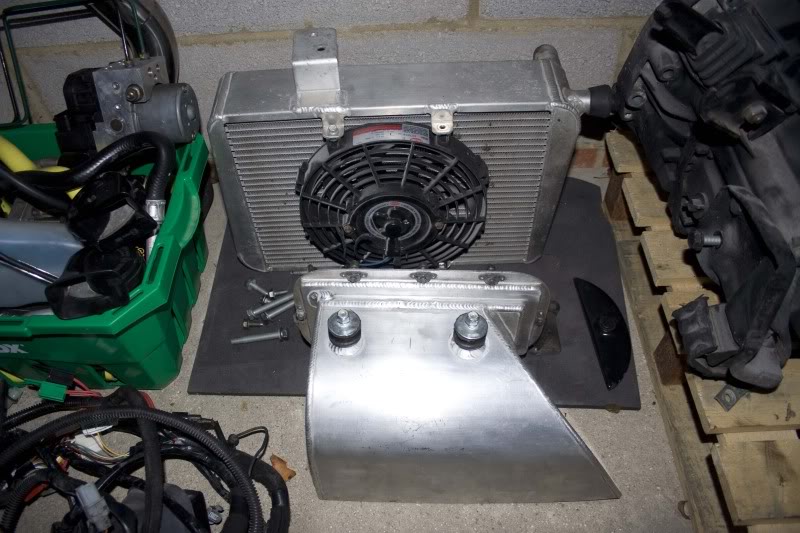

and my custom radiator and the bottom piece to my custom airbox (these both still need a bit of a clean)

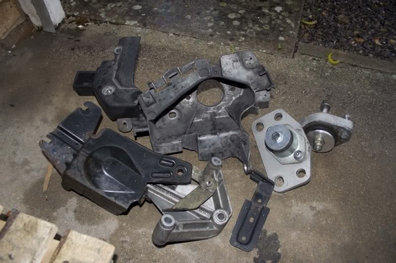

I have another pile for the pieces i have removed that will be getting painted up separately, gearbox mounts, engine mounts etc etc. I am not totally sure on my colour scheme yet but they all need painting anyways.

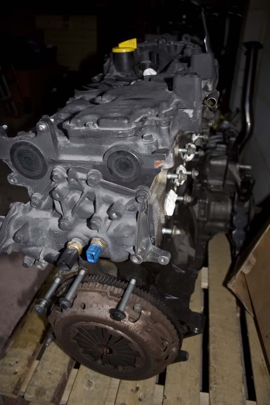

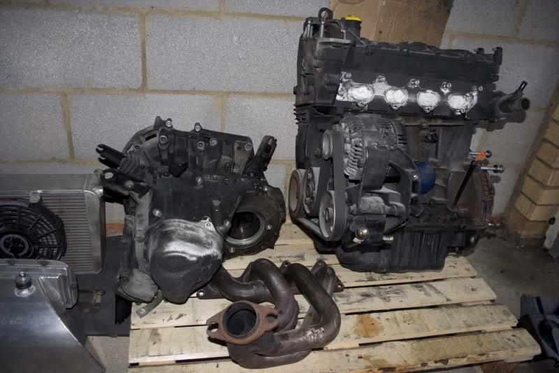

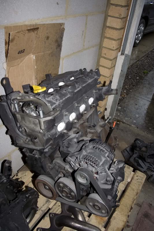

Which leaves the block and gearbox, i removed the exhaust manifold today which will get a bit of a clean up but then its just the block and box to clean, again i will be treating the block to a good fresh coat of paint and again i am unsure on the colour scheme,
however can anybody tell me how much more i can take the block down without having to re-time stuff etc etc?
