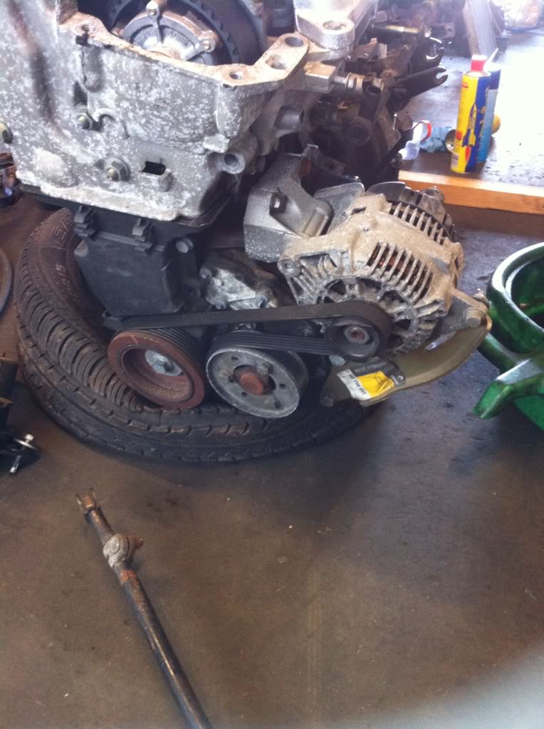

should be able to give it a good clean up with that all removed, the gearbox also. then we can whack it back into the car in an afternoon again :)
Good to see your still making progress mate :) Glad to hear your sorted with the job also! MK to TDF is nice and close ;) I drove from Matt's on Friday night that way and think it was only about 30 mins form leaving Matt's until I was at the MK junction of the M1!
Nafoff

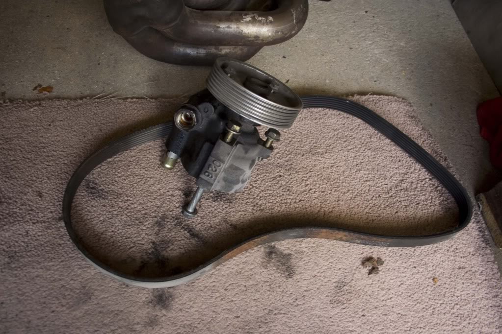

You can remove the alternator, top bracket, lower bracket, PAS pump... And that's about it.
what he says ^^^
leaving the belt loose then i guess?
will be working on it again tomorrow i think, gearbox is already removed remember.....
  M3 Touring
You'll need to undo the rear alternator bolt, slide it out, undo the front alternator tensionser, remove side bolt, remove the tensioner, then the alternator can lift out.
Then it's just a case of removing the brackets, only a couple of bolts.
Sounds complicated but it's literally 10mins work.

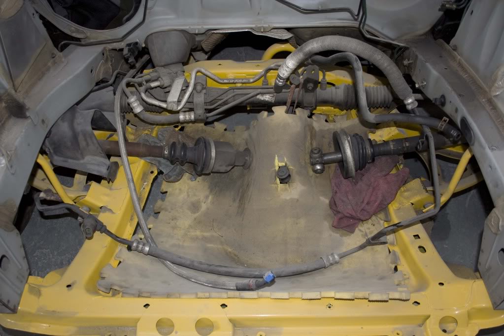

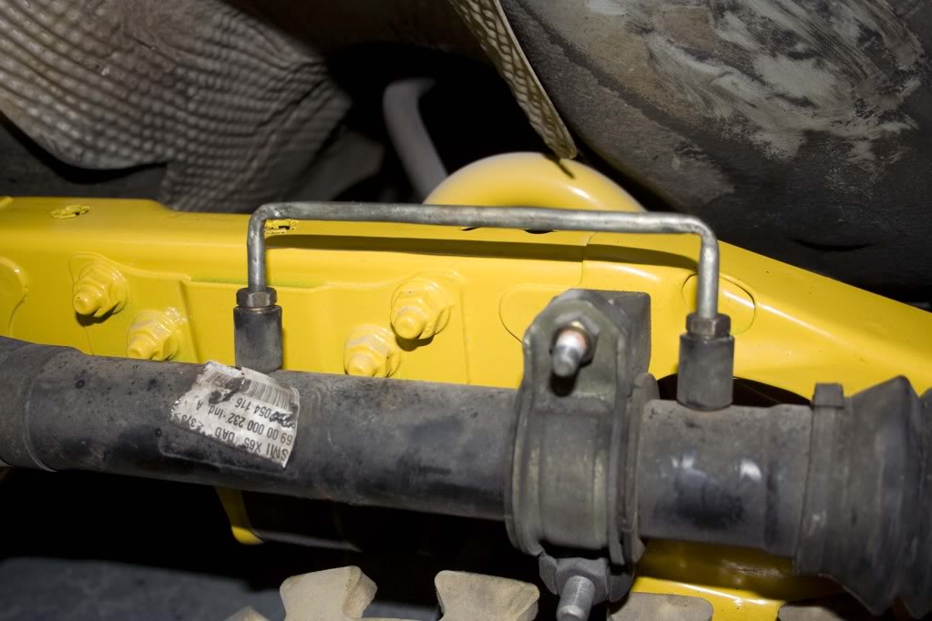

Lose it you don't need it on a race car, trust me. Cut the pipe down and flare the end again on one side and you have your loop system, will post a pic of mine.
Nafoff
Mae you know there's pics in my thread if you need any visual help.
just found this, nice one chrispy...

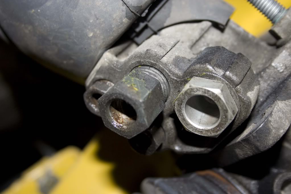

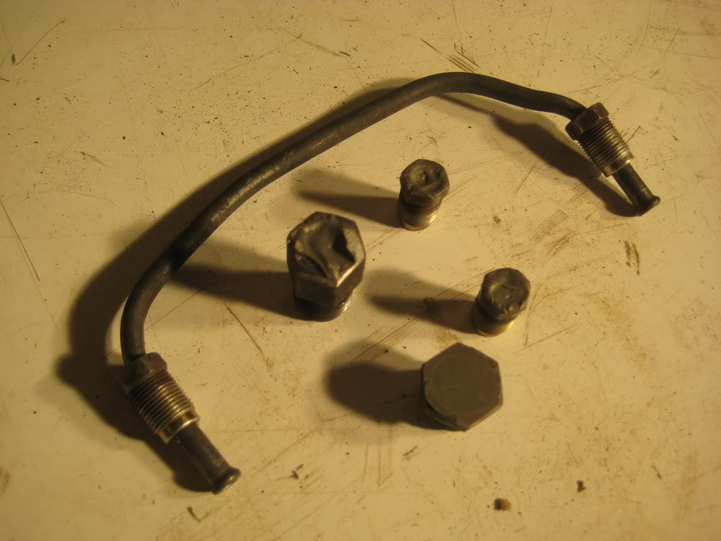

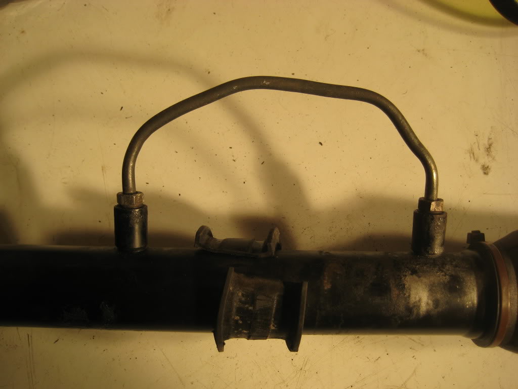

Next thing to do was to get the piece of copper pipe flared to go onto the steering rack. So went round to my mates place and he flared the ends :)
So i now had the 4 orginal pipe nuts (not sure what they are called) filled with chemical metal, and the piece of pipe.
So i screwed the bolts into place to block off the holes
And screwed in the pipe
So it's gone from this
To this
So i gave it a degrease and dryed it off
And then sprayed it black

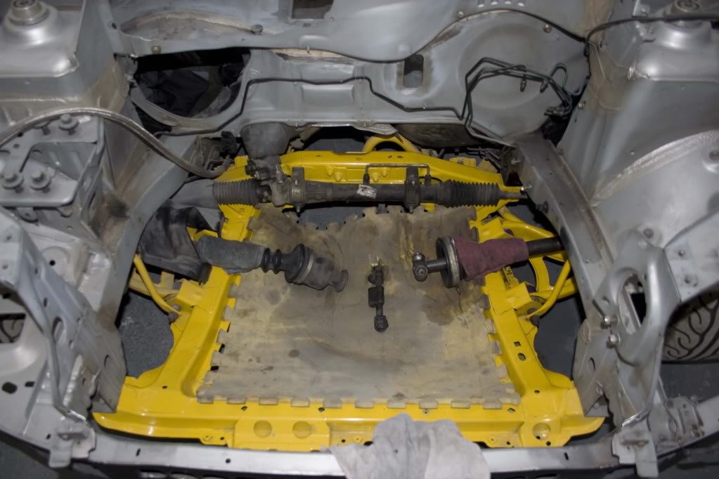

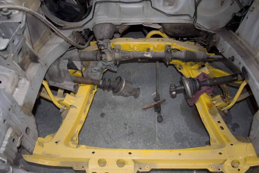

do we think i can do this with the rack still on the car?
  TrackCar & F30 330d
Ball ache Neil!
I would say it would be quicker to wipp the subframe off, remove the pipes do what you need to do and put everything back together.

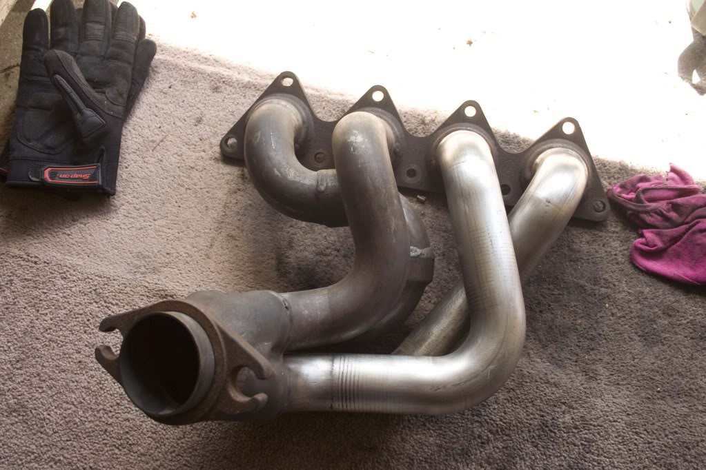

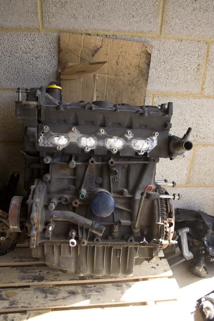

UPDATE: managed to go out and do some more work on the engine today, first up was to remove the aux bits (as discussed), all stripped off pretty quickly and sorted as to what needs painting, whats disappearing and whats staying, my "TO PAINT" pile is growing

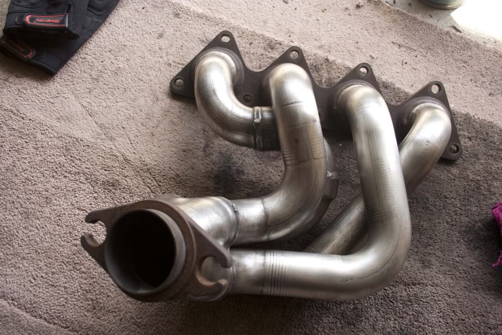

so then back to cleaning, i wasn't quite ready to attack the block or gearbox so i grabbed the exhaust manifold, i have no intention of polishing it up or anything but just wanted to tidy it up just a little bit, so an hour later, and a fair bit of sand paper.....
half done...
and sorted

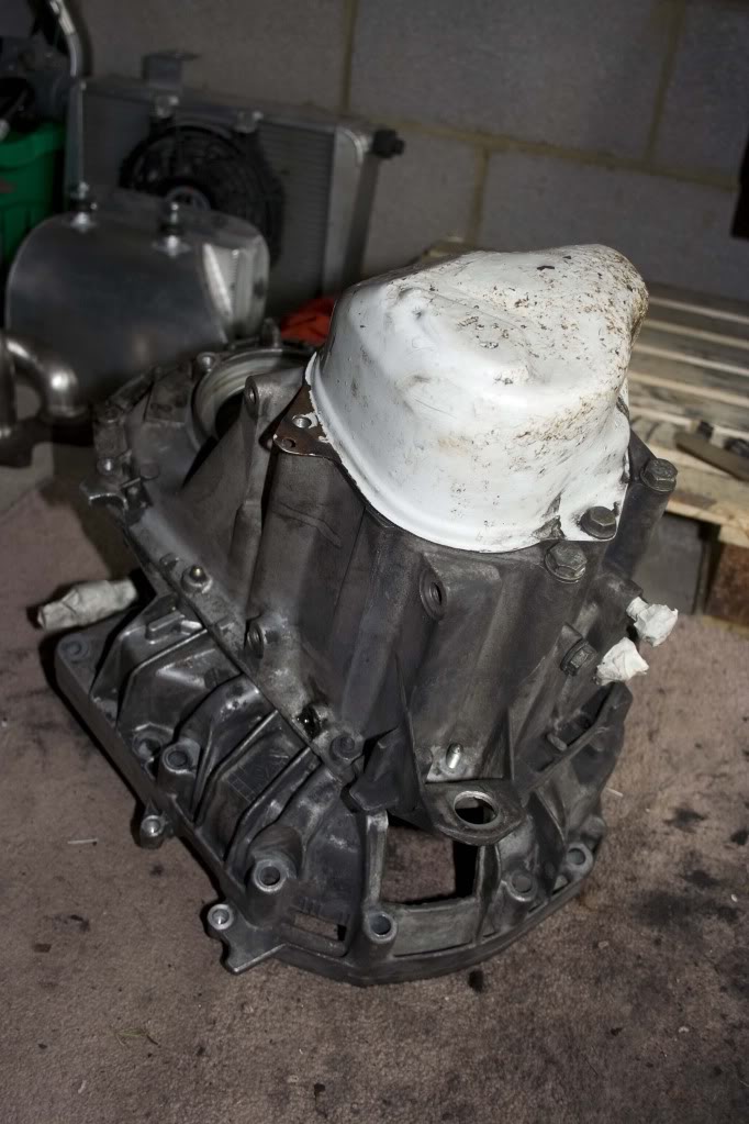

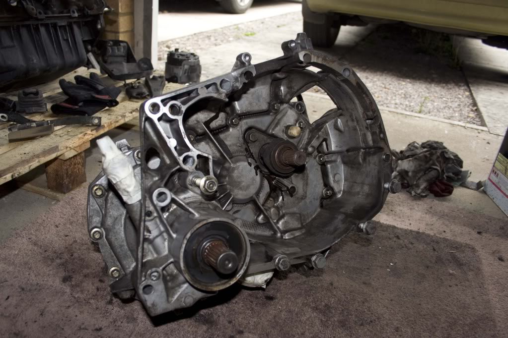

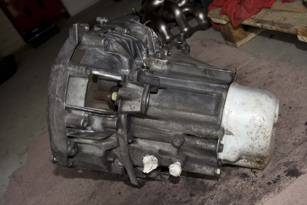

so now i was ready to attack the gearbox, bloody hell did it take some time, went over it all round twice, got alot of it off, also stripped it down a bit more (ie. mounts and selector fork, these will also be painted too), pretty much ready for paint now though.... and only the block left too clean...
  TrackCar & F30 330d
This thread is bringing back fond memories! The manifold has come up well. Do you not fancy ceramic coating the mani?
  M3 Touring
Looking good Nelly.... We'll be dropping the engine back in soon ;)
Have you degreased the gearbox?
You can take off the white gearbox end cover / cap to paint as well, if you wanted.
lol...how long does it bloody take?...lol
i mentioned wrapping or coating it in another thread, but was told it really isn't worth it as the temps these get up too won't cause any problems / therefore there are no benefits
Have you degreased the gearbox? You can take off the white gearbox end cover / cap to paint as well, if you wanted.
thats fully worked over with brake cleaner twice....
end cover was going to be painted also....

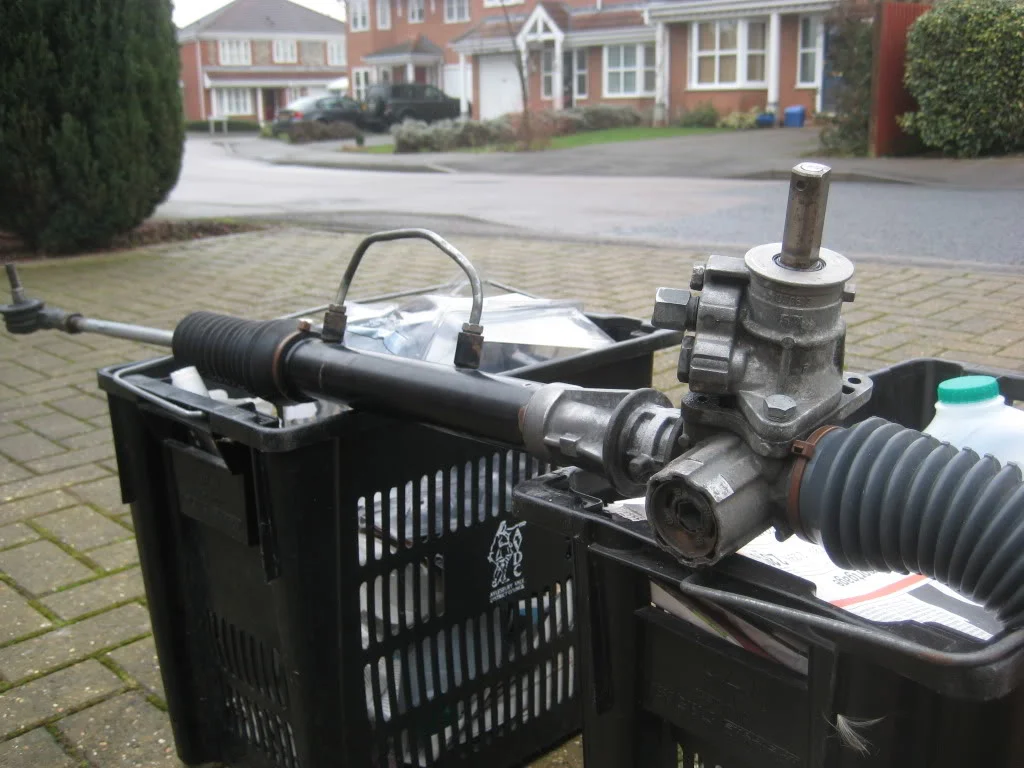

i visited the car today with a very small list of "to do jobs"
- strip the steering rack down, bend and flare the pipes and bung the other holes
- check fitment of my new air intakes in the foglight holes
- drill more holes on the interior
- chat over the project with my painter/sprayer friend and how it will progress as i am now moving away....
the morning started poorly when i got 5 mins away from the car and realised i had forgotten the air intakes, (job 2 out the window then)

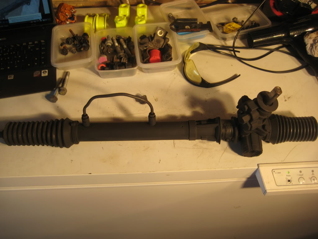

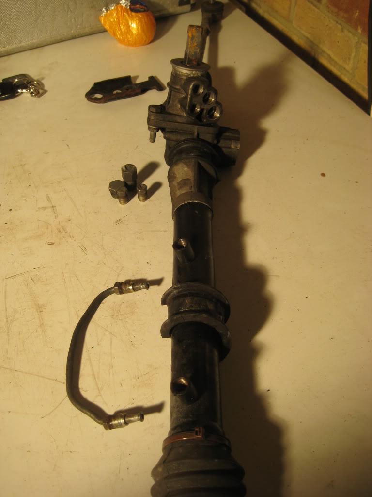

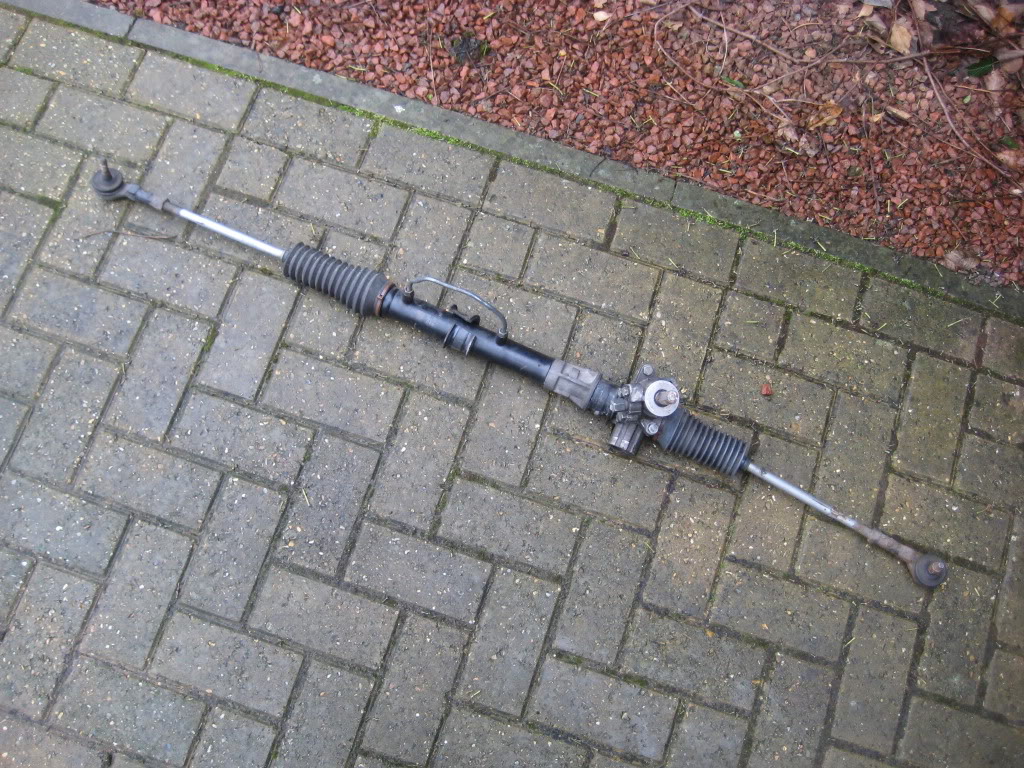

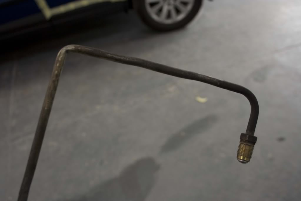

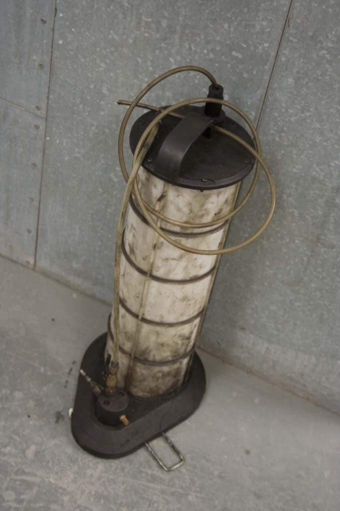

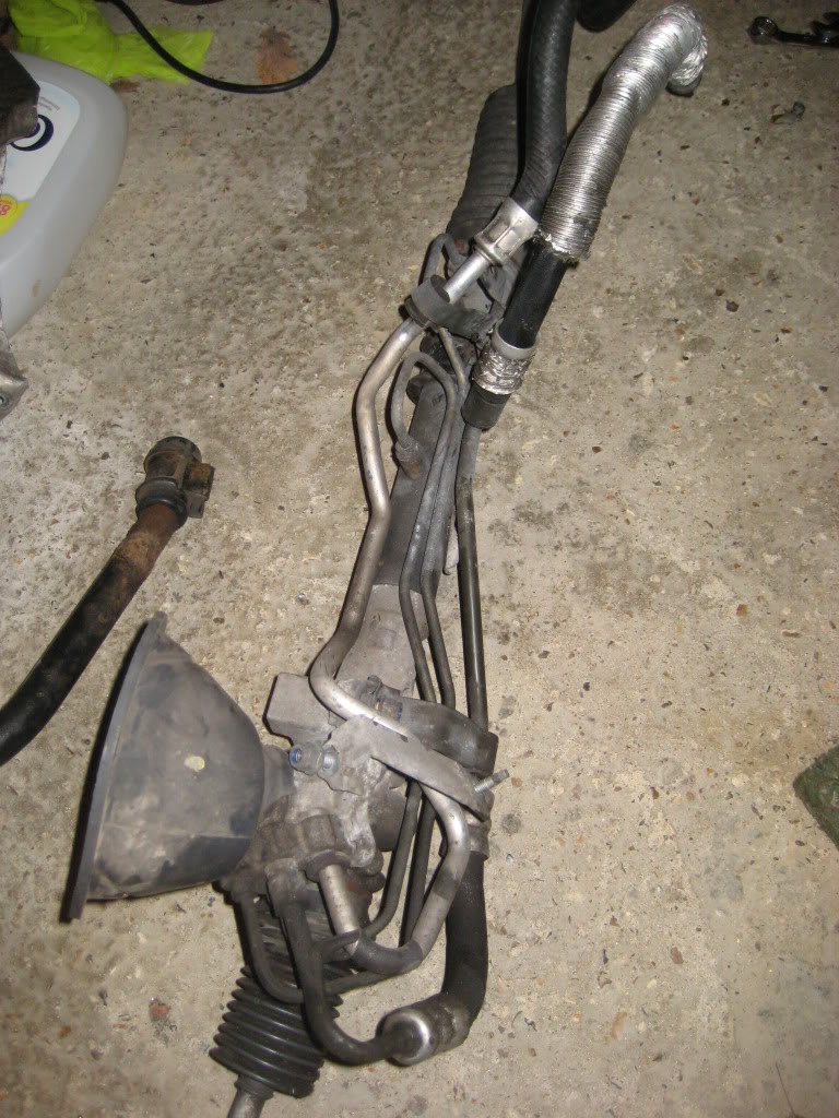

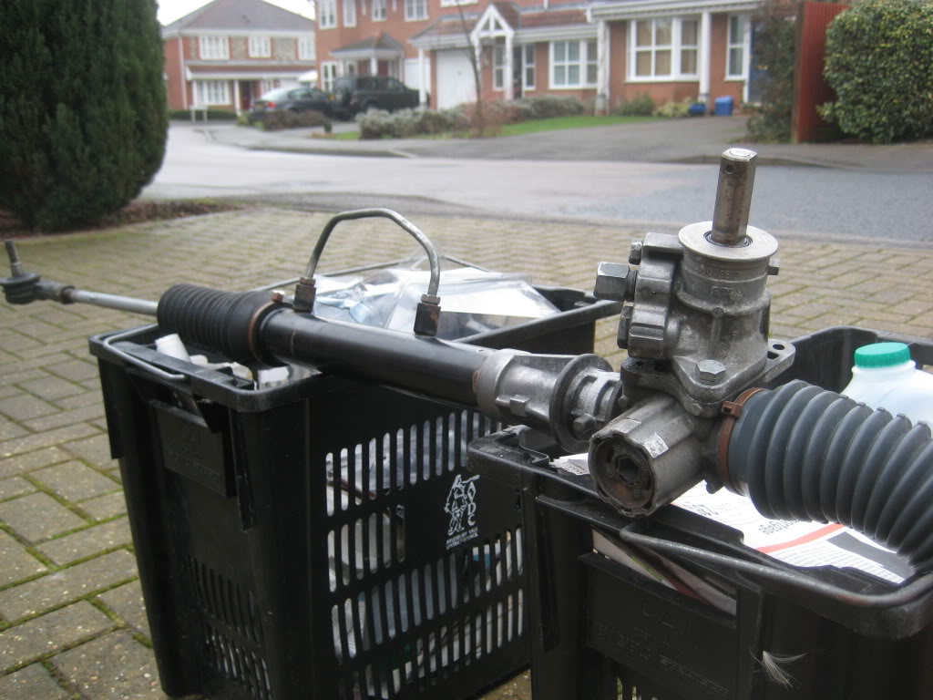

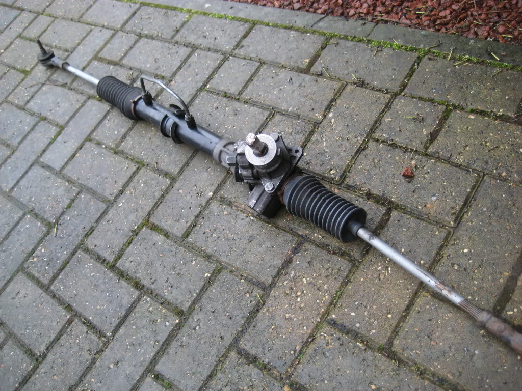

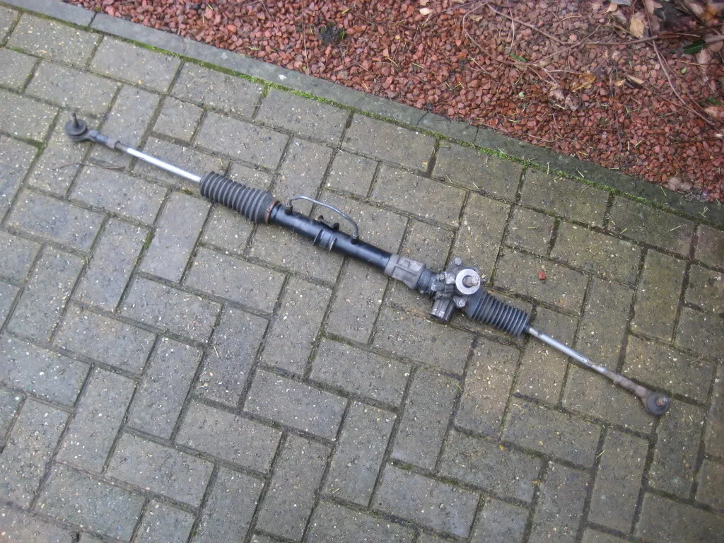

i got to the car and immediately set about stripping down the steering rack, this was super easy as there is nowt else in the engine bay, within 20 mins its was fully stripped down.
good times, so following on from crispys thread and Daniels advice i then set about making a loop system from one of the old pipes,
however being a bodyshop my friend didn't have the tool to flare the pipe, i got on the phone to another friend about 10 mins away who thought he could help, it took a bit of work but sure enough i managed to get the pipe chopped and flared and made my way back to the car, along with a suction tank thingy that i would use to suck the rest of the PAS fluid out of the system.

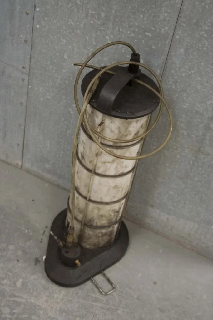

once back at the car, with the final lot of fluid sucked out, i made final measurements and bent the pipe to suit, i also put the other union bolts in the holes in question (this will need liquid metalling at a later date to seal the system), i am happy with my work and the neatness of the outcome, see below for before and after pictures.
before
after
This took me up to lunchtime, and time for a chat with my painter sprayer friend with regards to what to do about the project, and this is when i lost steam... a lot. Its not that he shot me down, or can't be bothered to do the work, tbh i think he is just trying to be a mate and advise, best off seeing this link for details - http://www.cliosport.net/forum/showthread.php?641774-my-ph1-TO-BUILD-or-BREAK&p=8696688#post8696688
with that i lost all steam and didn't feel like pushing on at all, so no holes where drilled, so my success rate today, well 50%, although that could be the last of it,
properly unsure what to do now and tbh its getting me down a bit.... opinions in here or on the other thread welcome
before
after
