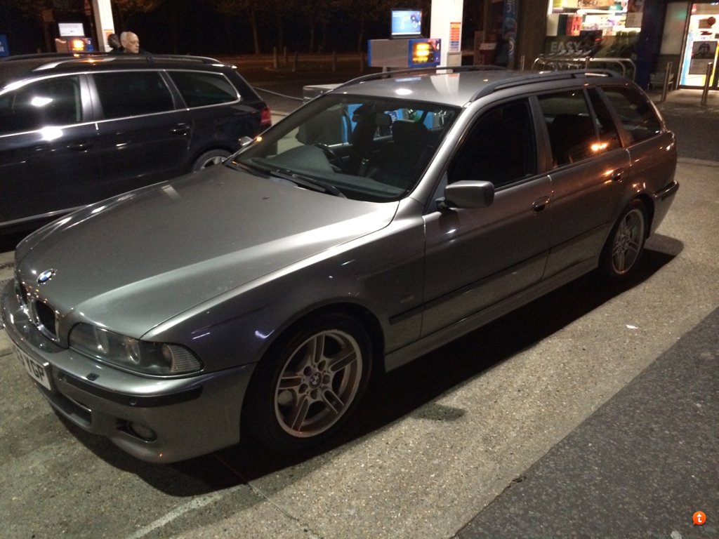

I needed a bigger motor to replace the DCi but still needed to be suitable for moving engines and other car related rubbish round the country.
A 530d seemed to be the only sensible option really as I can't stand anything made by VAG.
Here she is.
2003 E39 530d Msport Touring.
I have to say, I love it. It's 1 owner from new with full BMW service history, just clicked over 120k
Has all the options (sat nav, leather, front and rear park sensors)

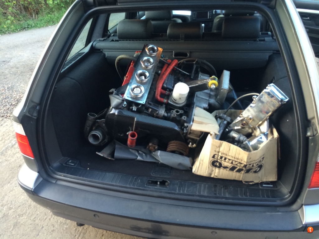

She drives like a total dream although I'd only owned it a day before my YB cosworth engine leaked oil all over the boot. Although even with a cosworth YB in the boot, there was still plenty of space for more stuff.

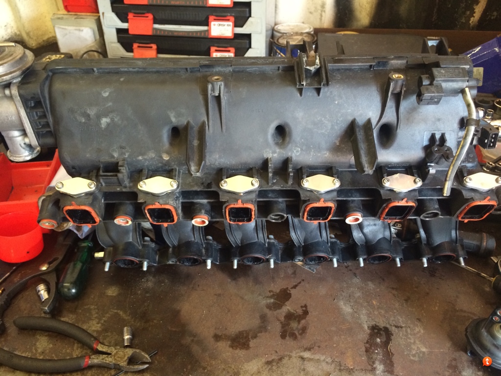

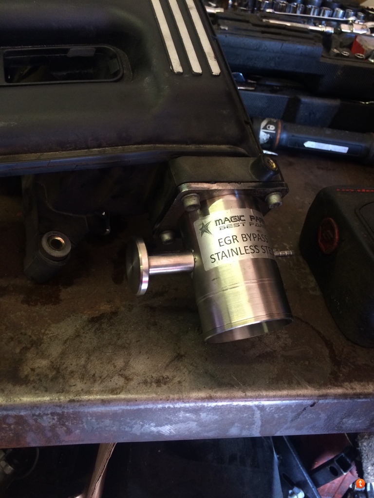

EGR power pipe delete kit.
Swirl flap delete kit

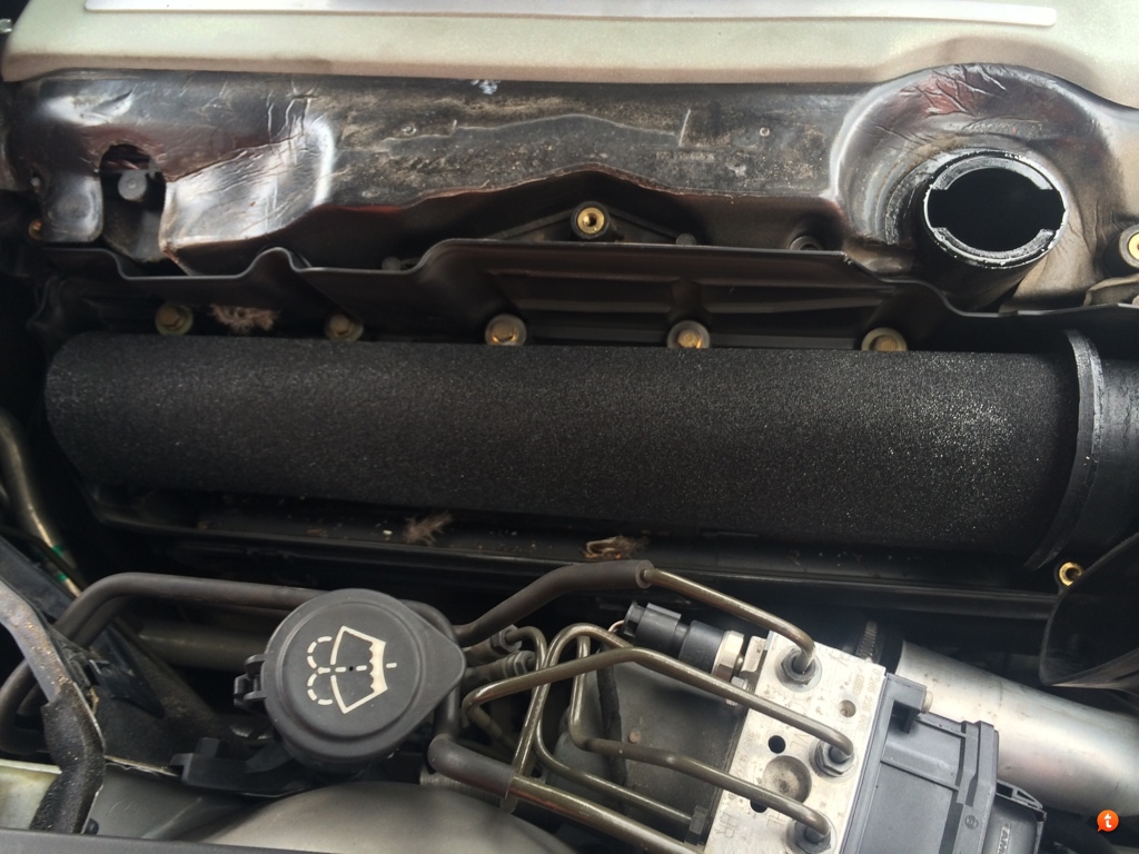

Pipercross panel filter

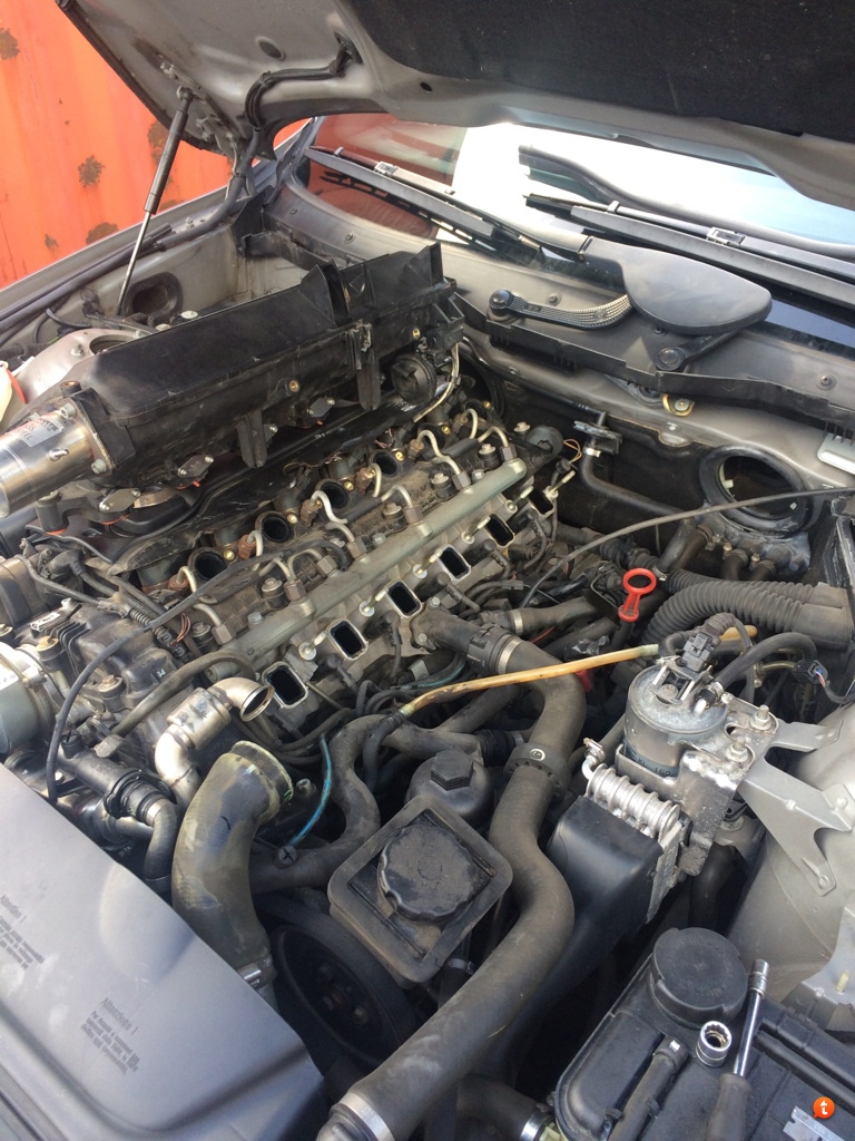

Fitting the EGR delete and swirl flap delete was really easy. 4 out of the 6 were loose so well worth the time to get them out the engine.

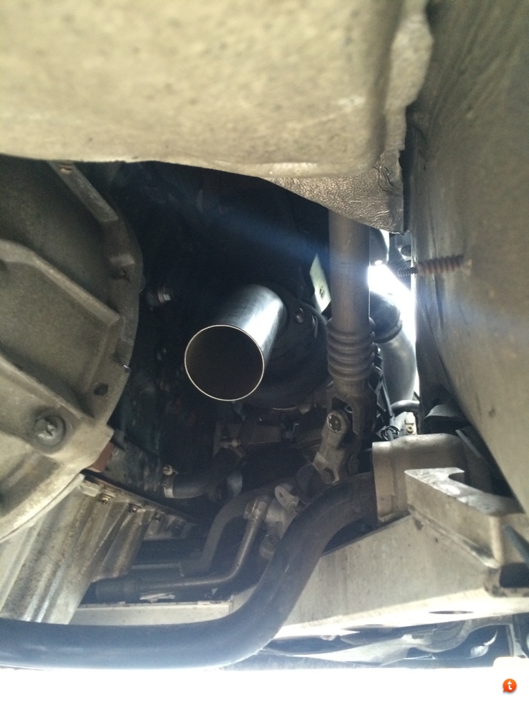

Next week it's going to the fabricators to get a proper decat made. All off the shelf decats come out the turbo, spilt into 2 and then go back down to 1 in the mid section. I'm getting the mid section modified so the decat can be 1 single 3inch pipe instead of this 1-2-1 rubbish.

Swirl flaps need deleting, there are no tell rail signs but they can just fall off inside the cyclinder and total the engine and a smooth change on the auto box. That's about it tbh.
Any one you buy, budget a swirl flap delete and an auto box fluid change.

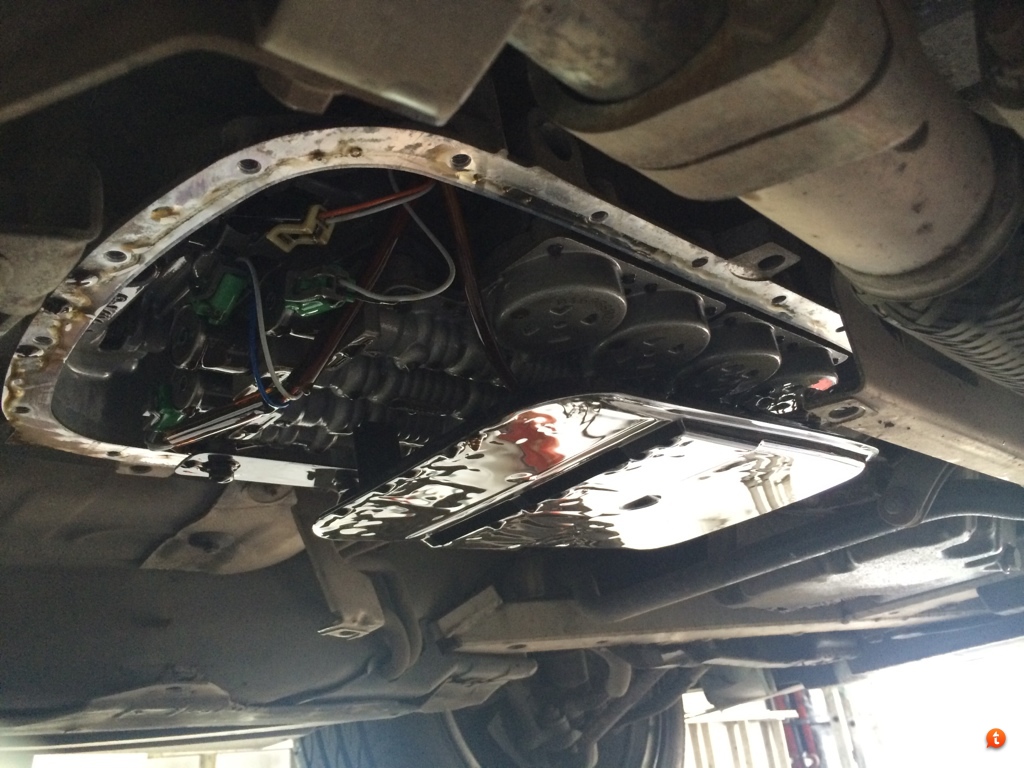

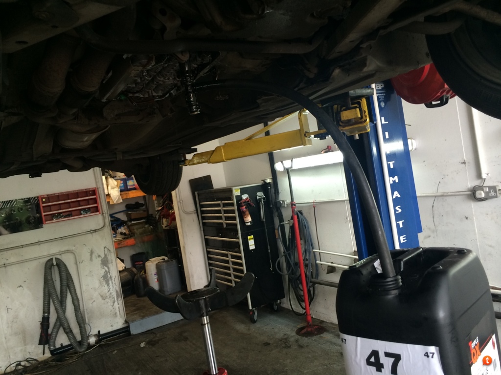

Did a gearbox oil change today to help keep her in tip top condition.
Had to remove the sump to get to the gearbox filter too.
The gearbox holds a further 10l in the torque converter and valve pack so I had to make a feed into the new fluid to flush all old fluid out.
After 20seconds of cycling from D to R the fluid started to come through clean.
I fitted a new filter and topped the gear oil up and put all the covers back on.
The difference is amazing. So much smoother that what I thought was an already very smooth car.

Also fitted a Pipercross panel filter today

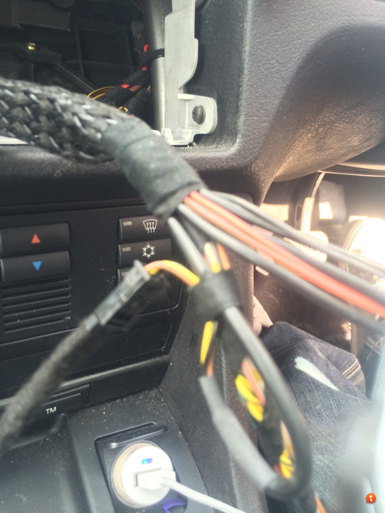

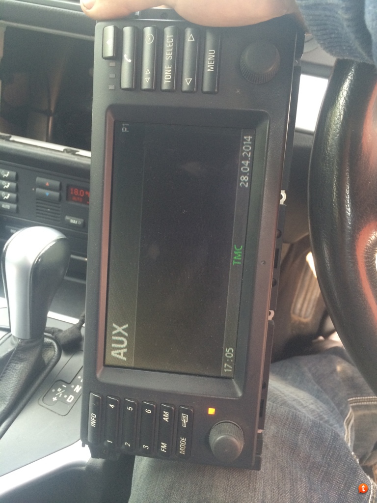

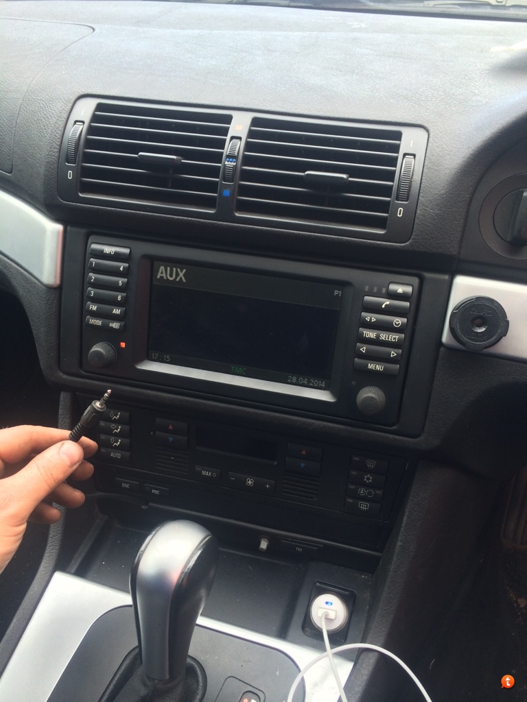

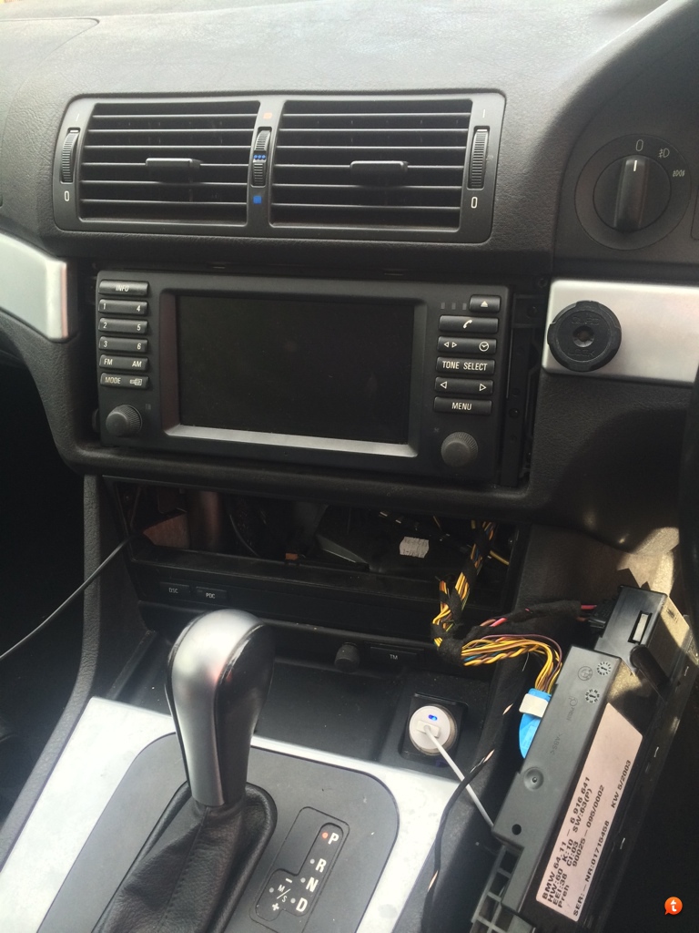

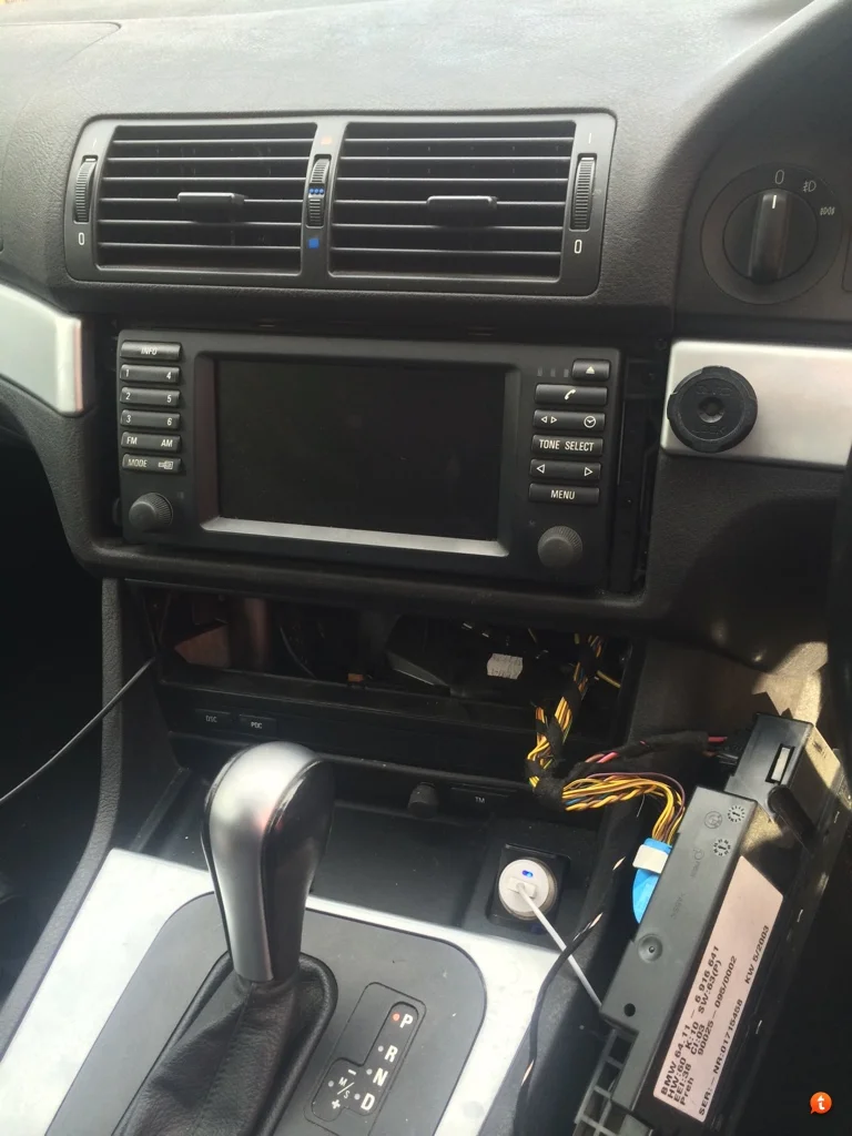

And my aux lead came for the radio. It was really easy to fit as BMW pre wired my car to have one so it was just a case of plug and play :)

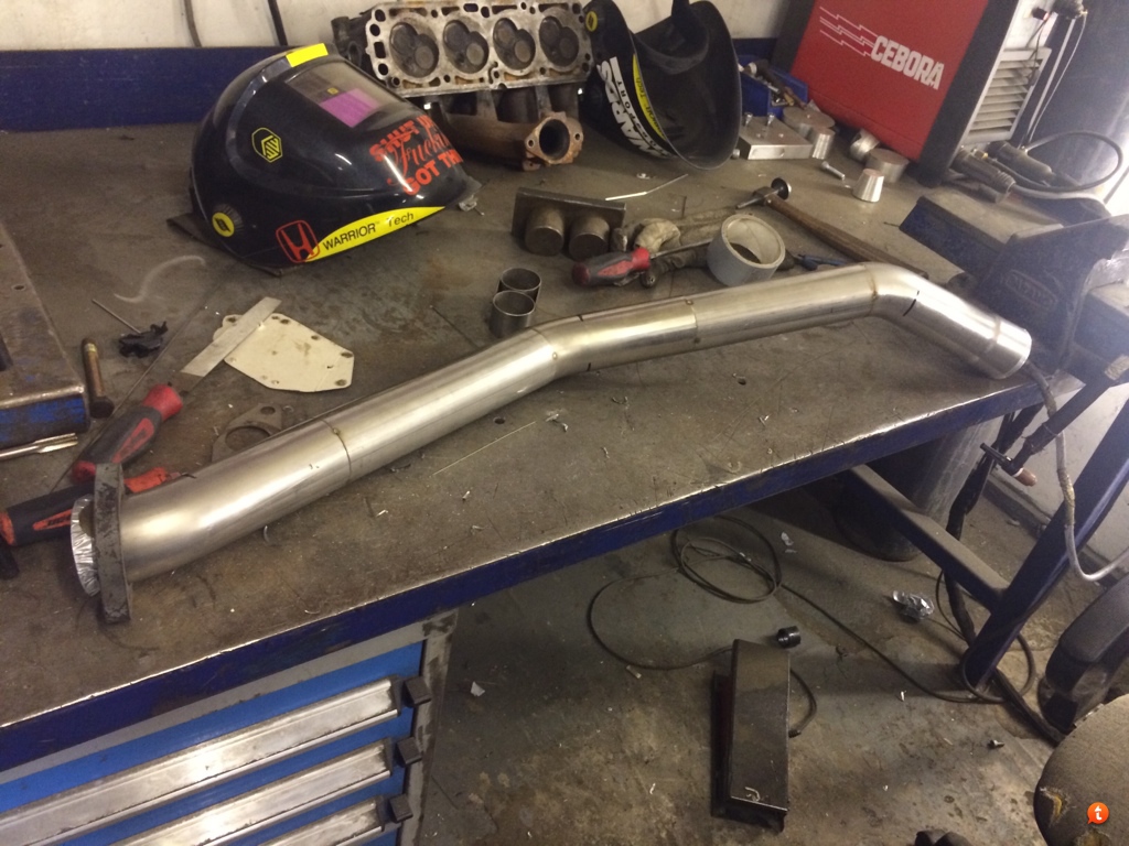

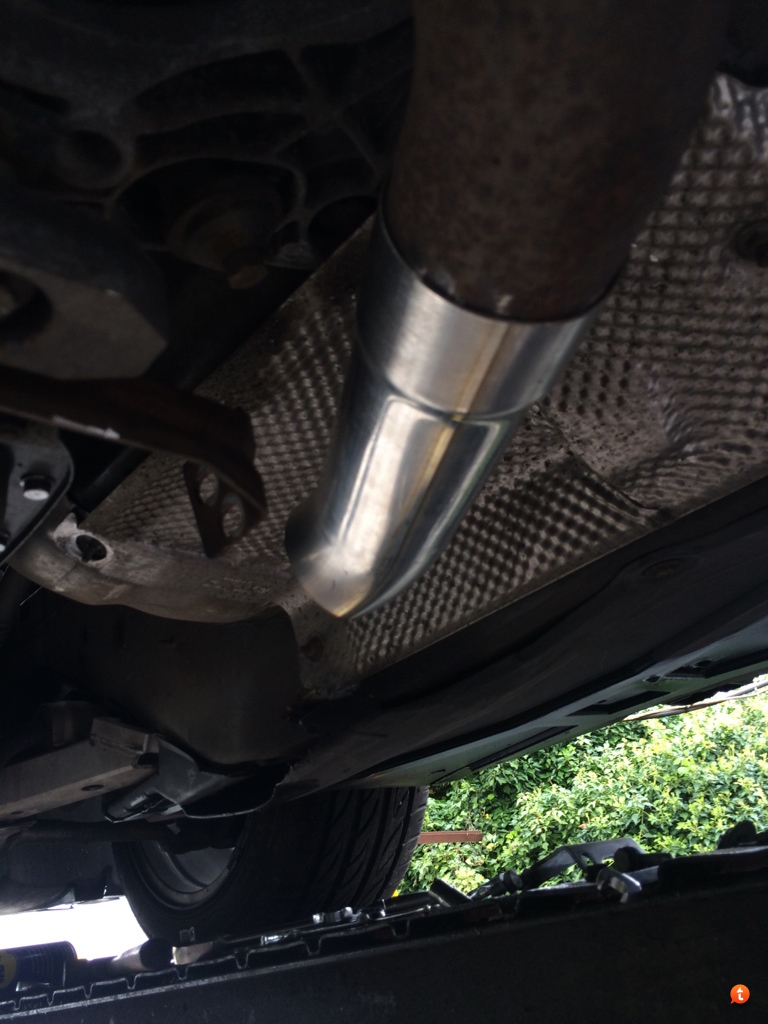

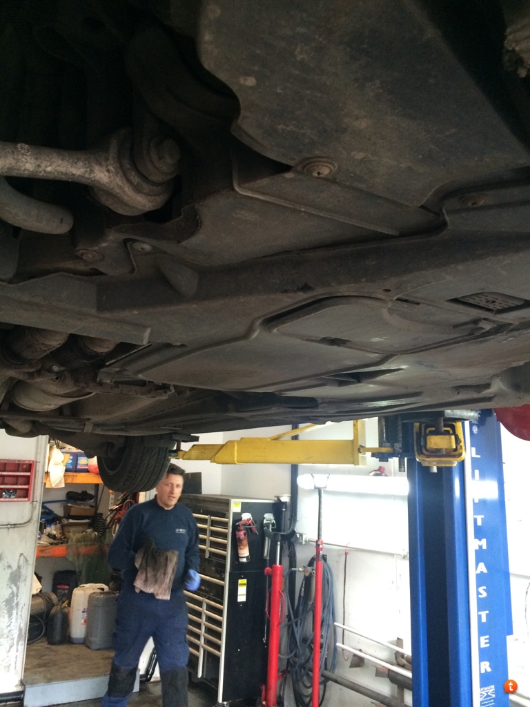

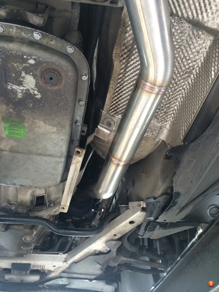

Today was decat day.

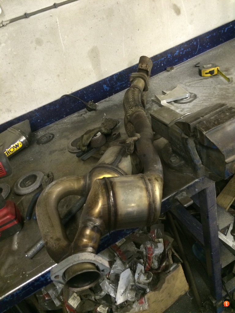

I took the car over to a very good friend of mine Mike Edwards Motorsport who built a custom decat for the car.
The aftermarket ones are really annoying as they are made as a bolt on bolt off replacement and because of the nature of the standard cats it means it comes out the turbo, splits into 2 and the. Back to 1 in the mid section.
I wanted a decat that was 1 pipe the whole way.
First the old cats were removed.

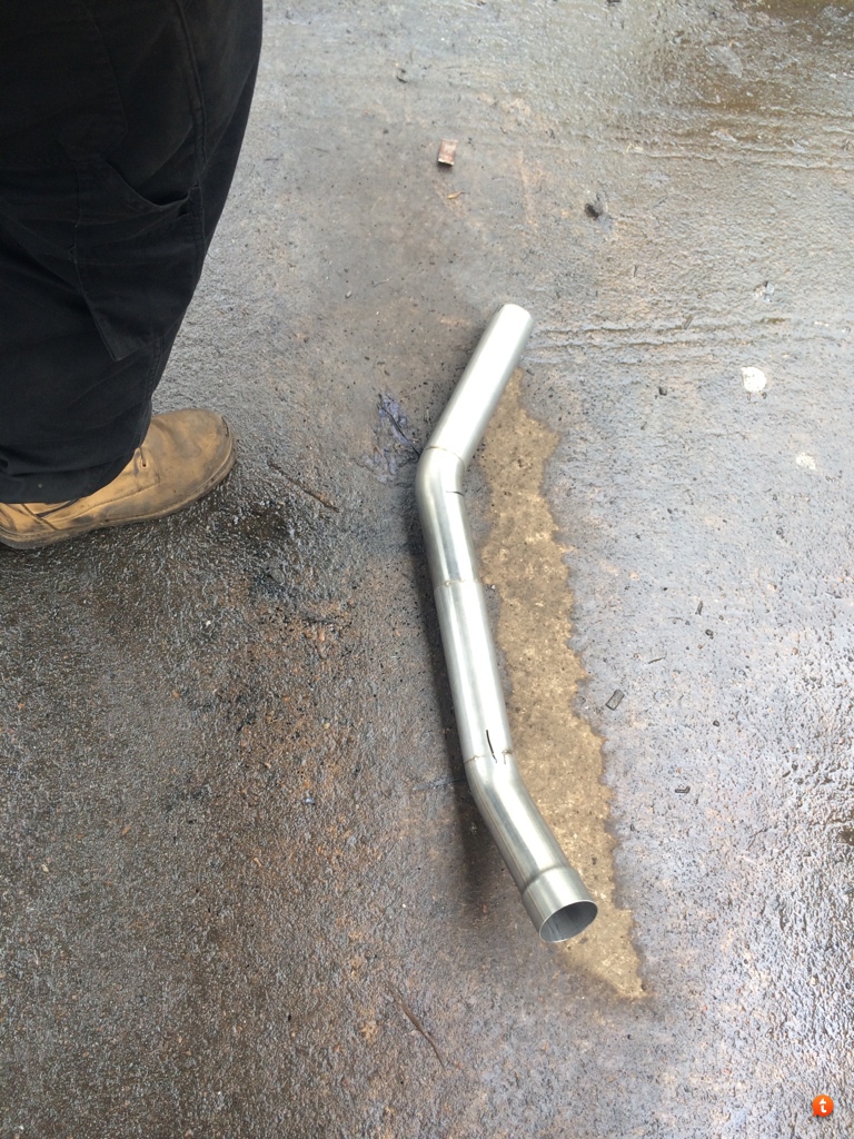

Then he set about making 2 end parts.
Then he decided the best way to run the pipe work so not to interfere with any covers or existing parts of the car.

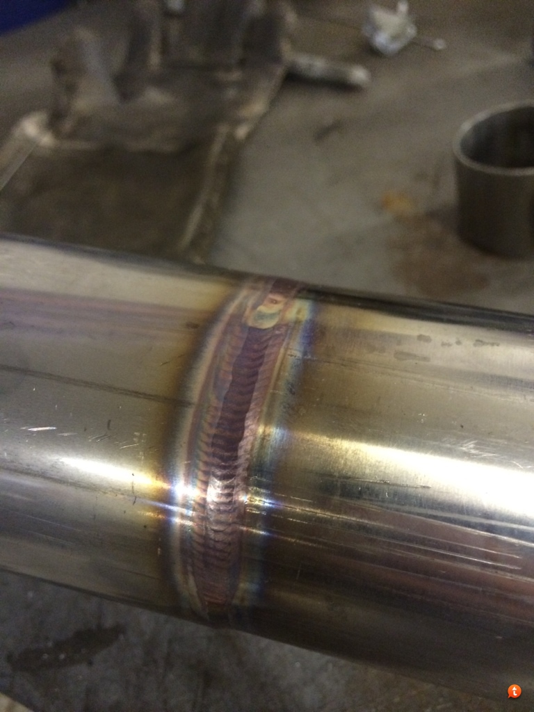

Then he welded it all up. His welding is absolutely stunning.

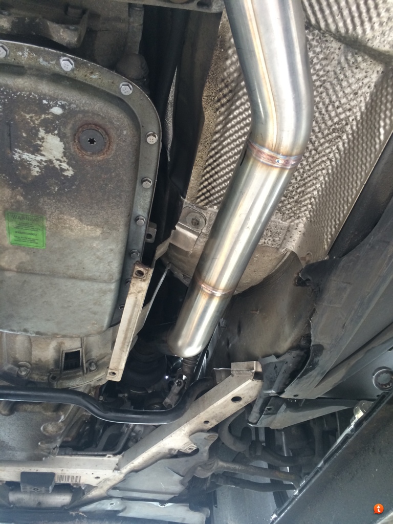

Then mounted it back on the car
The difference is really impressive. The engine is much smoother and the power delivery is much better over 3000rpm.
The engine pulls hard and has much cleaner power delivery. I'm really impressed.
