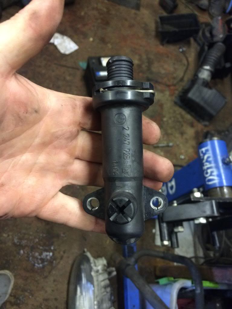

Today's job was a simple one.
The car took an age to warm up effecting the MPG. After talking to a couple of other owners apparently they should warm up really quickly. After some googling the fault was traced to this.....
Took less than 20mins to swap over.
I'm amazed just how quickly the car warms up now.

Think mine has the same issue mate. Thermostat gauge never actually reaches the 12 o'clock position, makes it to about 10 o'clock after a long while. You got a link to the part? Any guides out there to change it?

Epic car, the EGR thermostat went on my 320d too. Always the cheapest to replace out of the 2/3 so worth doing first Cribert

Mines a 530i, think it could be the thermostat. I'll have that replaced first off

530i is just one stat.. They're prone to failure, mine needed doing. Mpg jumped up by 2/3. Auto box performs better too because the car knows it's warmed up so it's not in slip mode to heat the oil sooner!

Cheers mate! Is it an easy job? Do I need to bleed the system?
  Leon Cupra 300
I had the garage do mine with a few other bits. it didn't take them that long 20mins or so.
Its in-line with a coolant pipe so it needs draining down, not completely as it's at the top of the engine. Swap over and fill back up, bleed as necessary.
if yours is an auto it'll have a dramatic affect on how it performs, it's lots keener to lock in gear, and generally more efficient.
