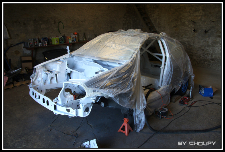

The French 172 "Monster'One"...
  Clio 182 White CUP

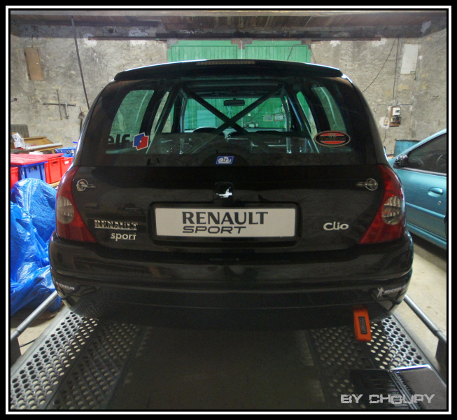

  182 trackday racer

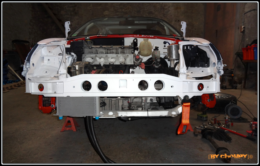

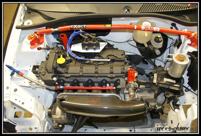

Nice project,

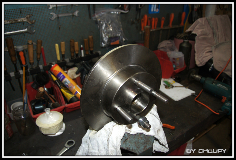

Have a few questions for you.

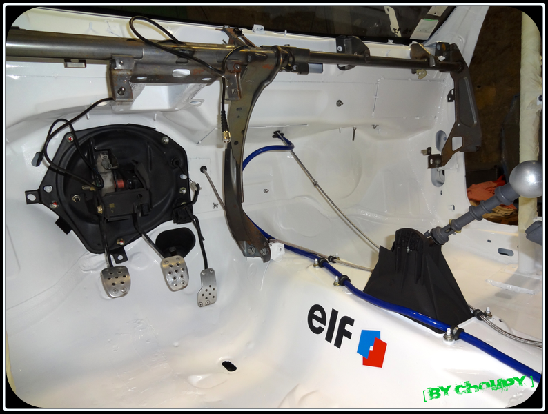

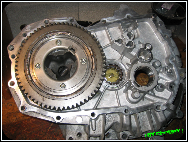

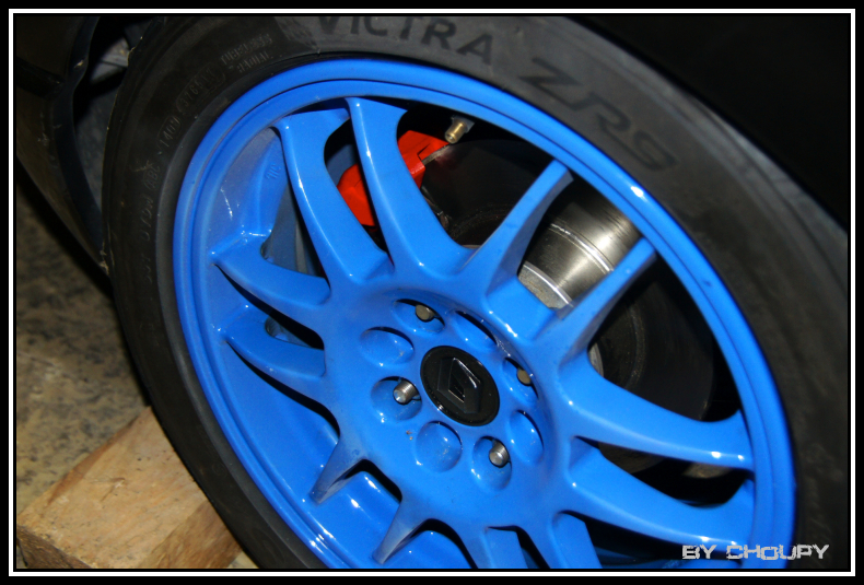

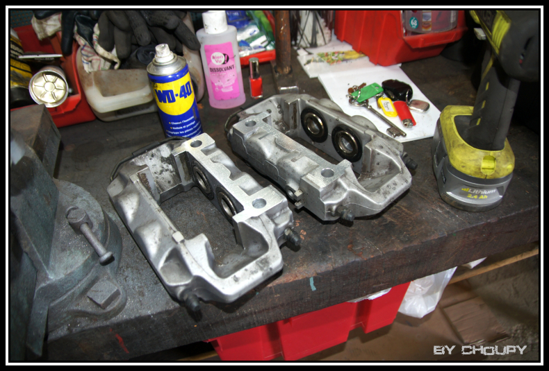

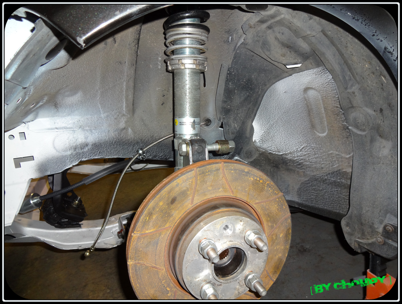

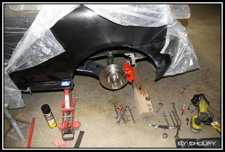

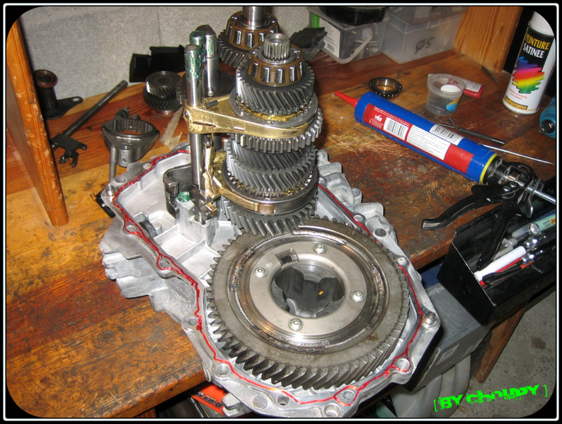

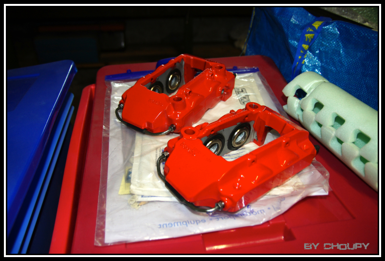

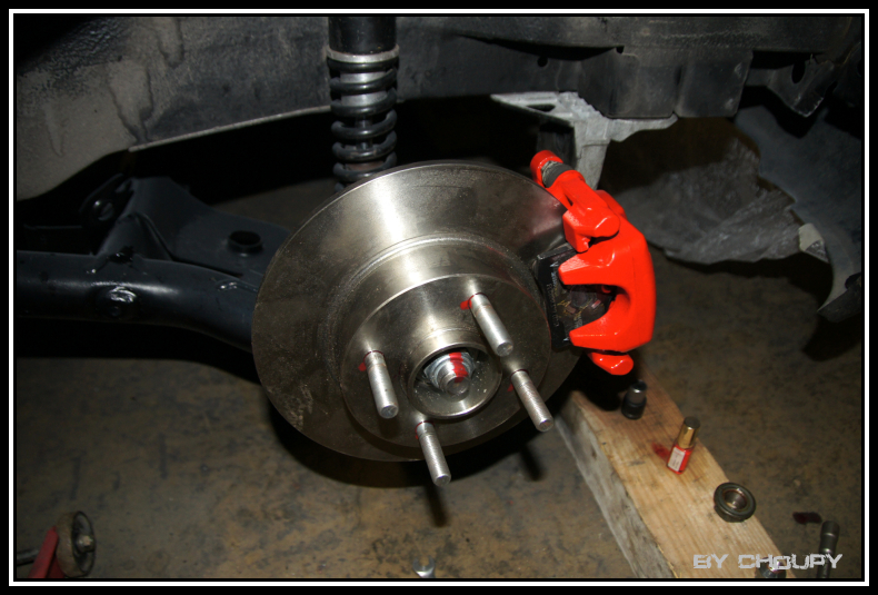

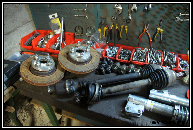

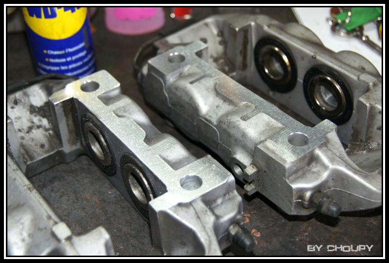

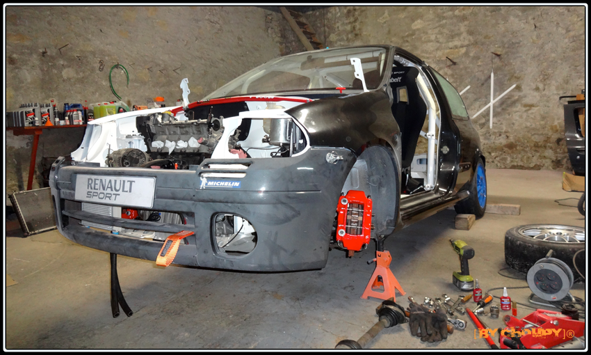

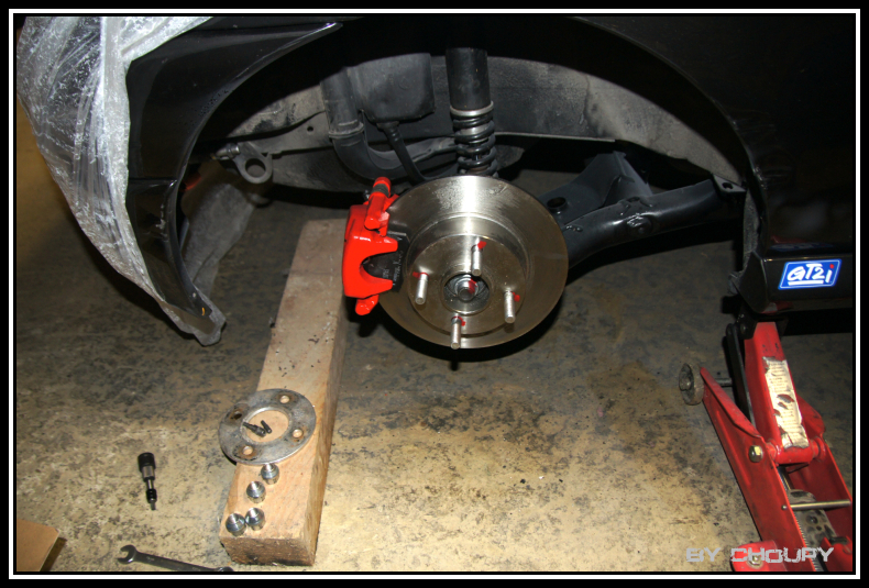

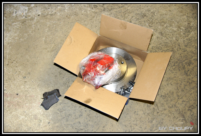

Rear brakes look like 197calipers? But what discs did you use?

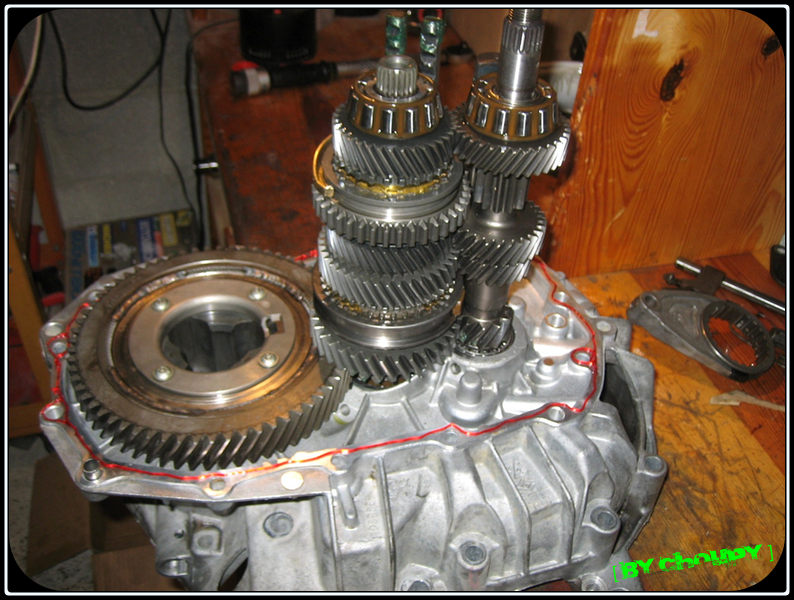

I assume the new final gear for the box lower than stock but from what gearbox/car?
thanks in advance

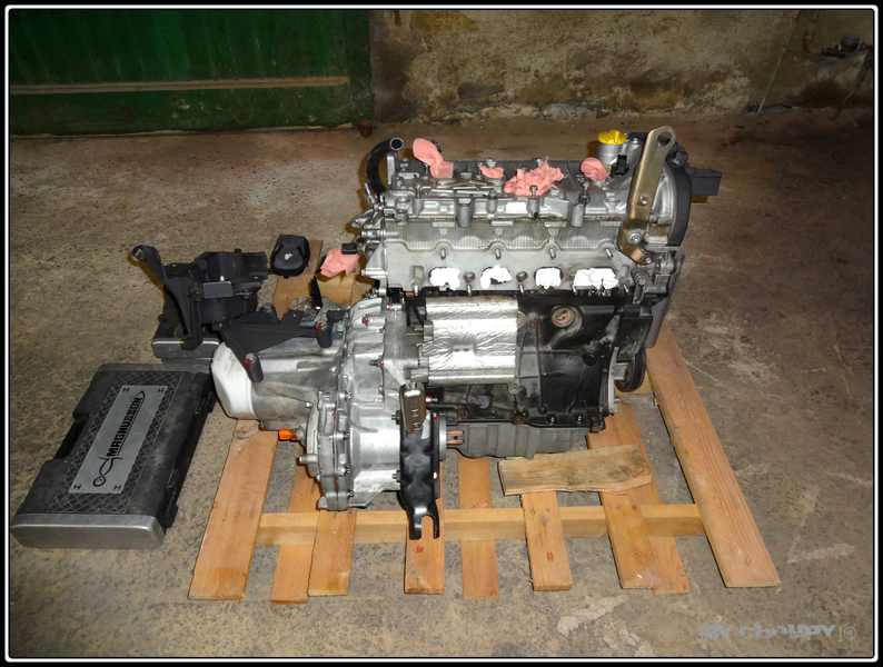

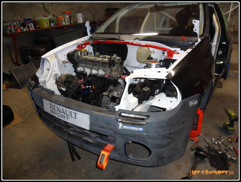

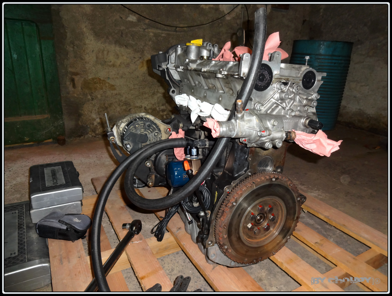

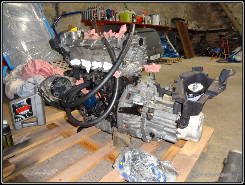

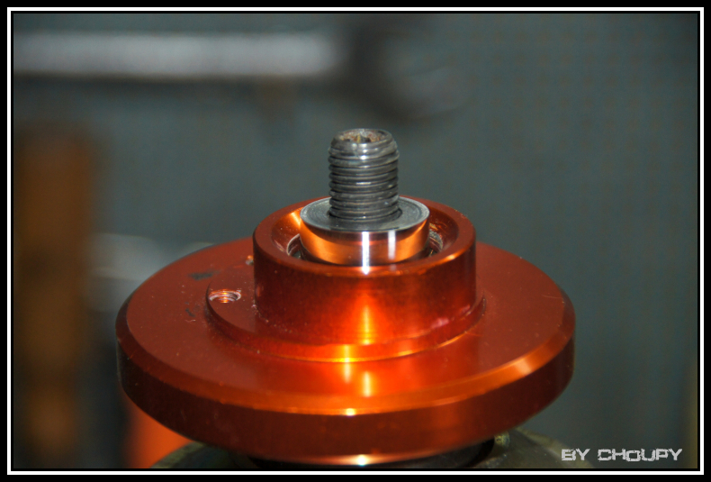

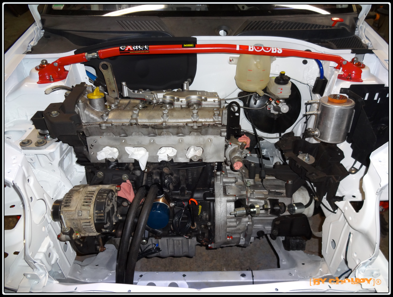

  Cup In bits

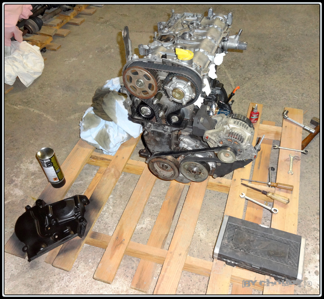

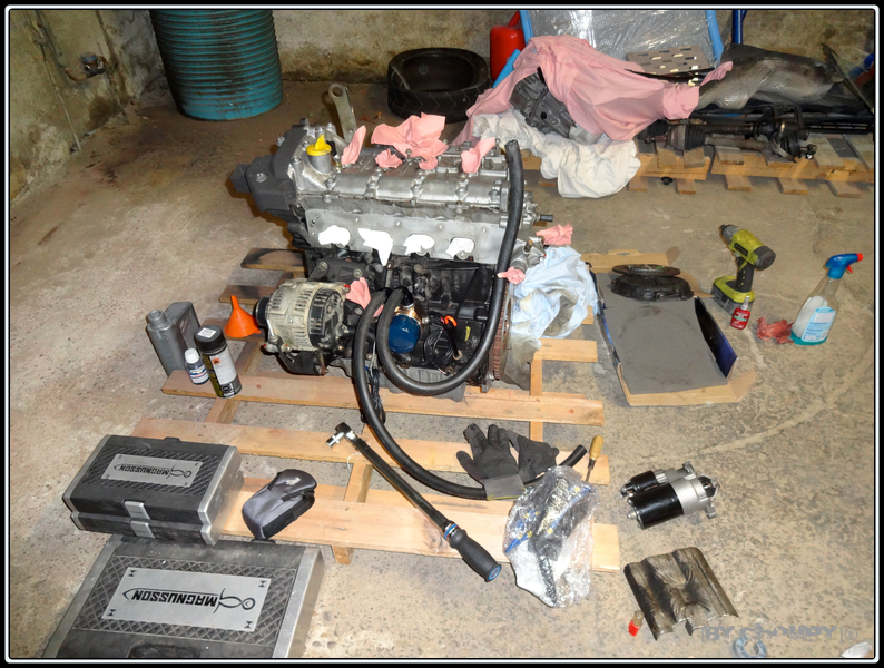

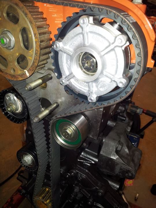

Explain please Fred? He has what look's like the only way to tension the belt with the ecentric part facing to the right of the picture giving tension. Are you saying he has tensioned it anti clockwise when he should have done it clockwise?
  Lionel Richie
the hex bit should be at the top at 12 o'clock, on that its at about 3 or 4 o'clock!
you can just about see it here (ignore the upper idler, that's our special one ;))
  DON'T SEND ME PM'S!!
same as this one I took of a week or so ago
it can't be tensioned right......you can't see the marks as they're obscured
  Cup In bits
Had me worried, common sense really, get the two mark's lined up and your good, same as any old ecentric tensioner...phew.
Is that an upper pulley to suit a skimmed head Fred?
