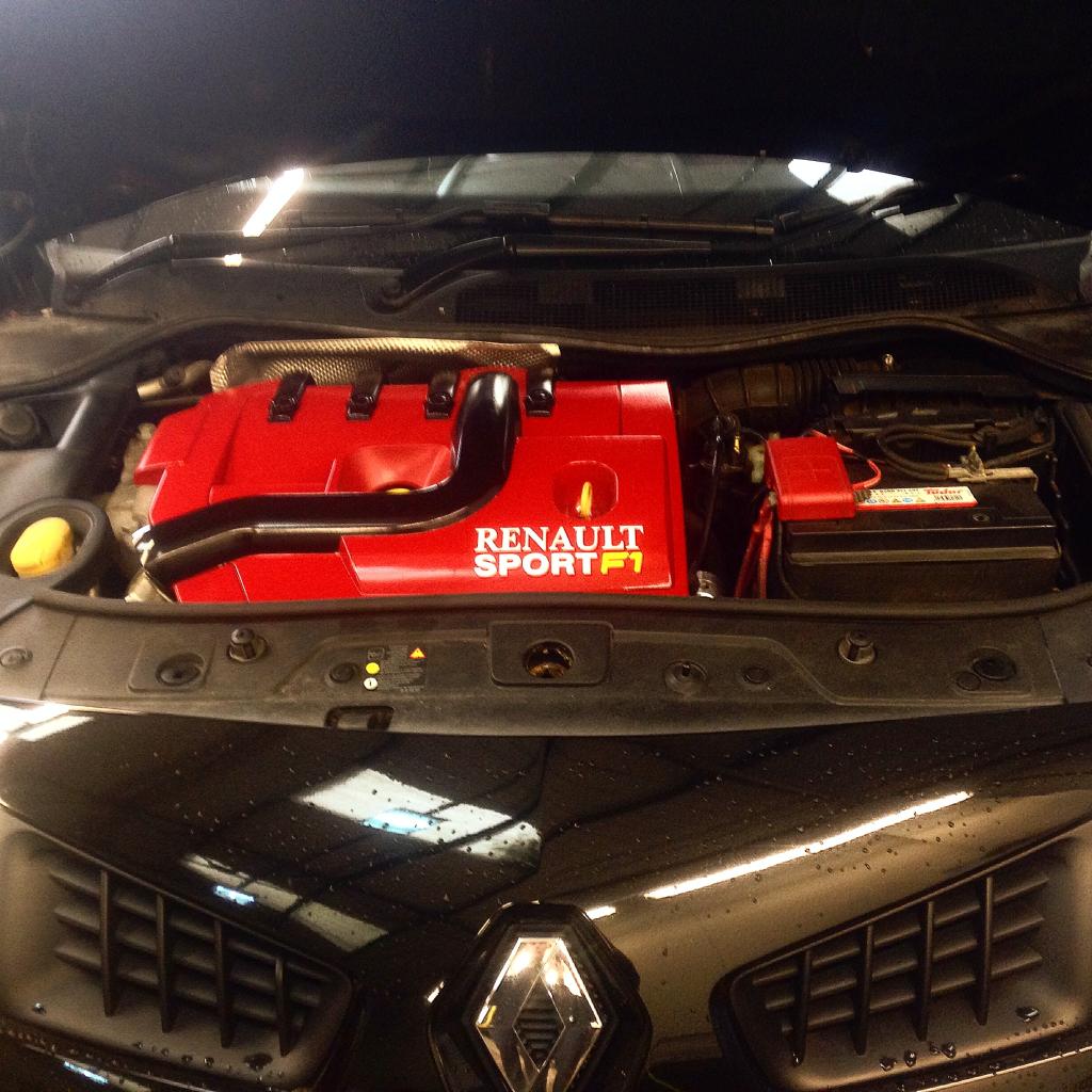

also so finally finished the engine bay cover !
Now please don't laugh at my awful painting skills
its by no means professional , and I think it'll do for now see how it pans out !

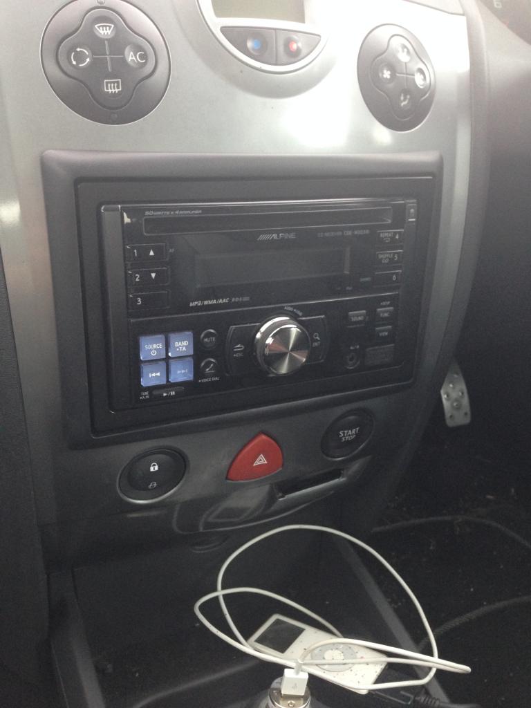

I Have fitted the new CD player which helps alot driving around , its nice to have my own music rather than the sh!tty radio with terrible reception ! Had to buy a fascia plate and get slightly creative with a hacksaw, but its all in flush :)

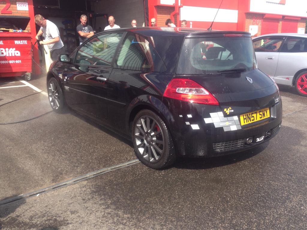

Well long story short they decided to use my R26 a demo car along with my friends type R , so my car got cleaned well without me having to bother :D lol
Had kittens when they were showing / practising Rotary polishing on the bonnet
Came out well the car did however because there was a lot of 50/50s to see the difference half the car was cleaner than the other half lol ! so a couple of days later i had to attack it again myself !

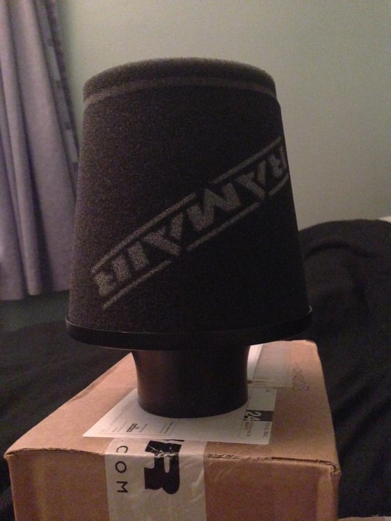

Ive just bought a Ram Air cone filter as well with a 70mm inlet so will fit straight into the pipe !

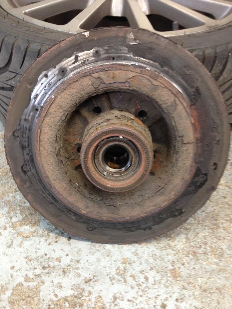

Well eventful few days with the megane !
A friend asked me to take him out in the car which after a bit of reluctance I agreed , we had a bit of a drive and Sod's law I noticed a catching noise from the rear when braking.

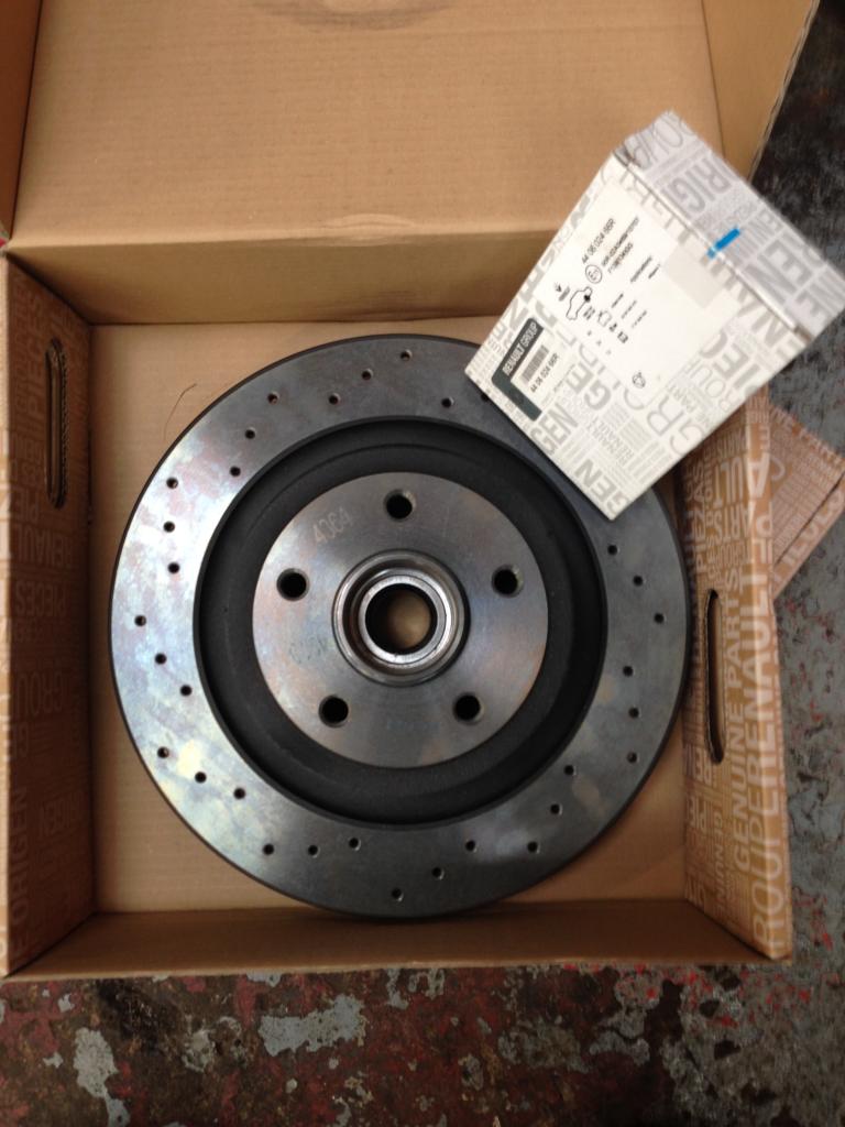

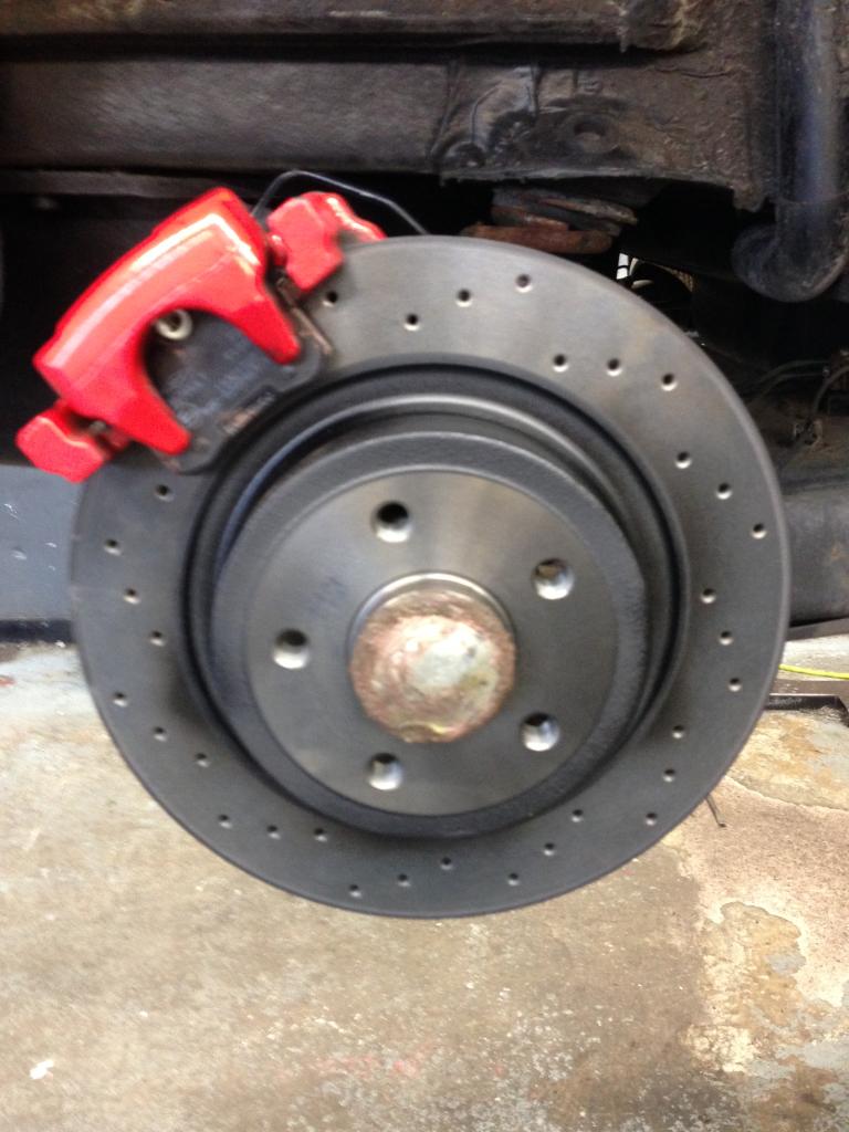

Had a good feeling it was the rear brakes finally , as I knew they've been shot for ages , but due to the cost of them I was running them to the death lol
Luckily this was Thursday night and I'd ordered the discs and pads on the Wednesday (Pure luck) so they were delivered Friday morning and I stayed behind after work to get them on for trax !
I knew the outer face of the disc was completely battered , but I didn't bother looking at the inner edge , prob best really after removing them I saw just how bad they were :O brace yourselves .....
new ones were fitted and the passenger side was a little tight going back but it went in the end :D alls happy there !!
all fitted job done :)
also so set about changing the air filter , when I bought it I had a modified airbox , I've seen a few people running a ram air cone filter on the standard pipe so I decided to get one
was a 70mm filter and with a littler persuasion it was fitted !
I don't have any of it in at the moment will get a few , noise is great adds a lot over the modified air box , sounds great maybe me thinking but it felt a little better on the uptake , and gives some good suck and chatter :) over all very happy !

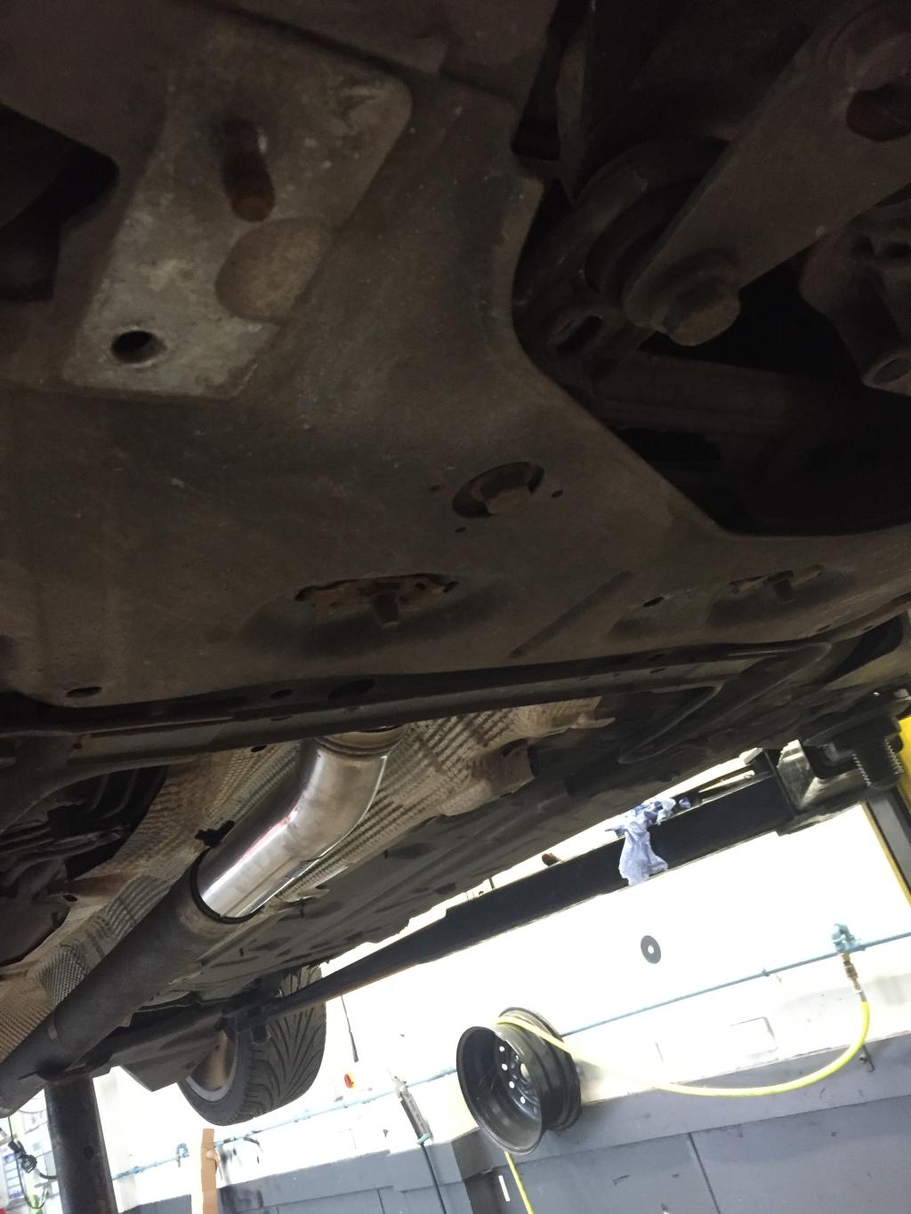

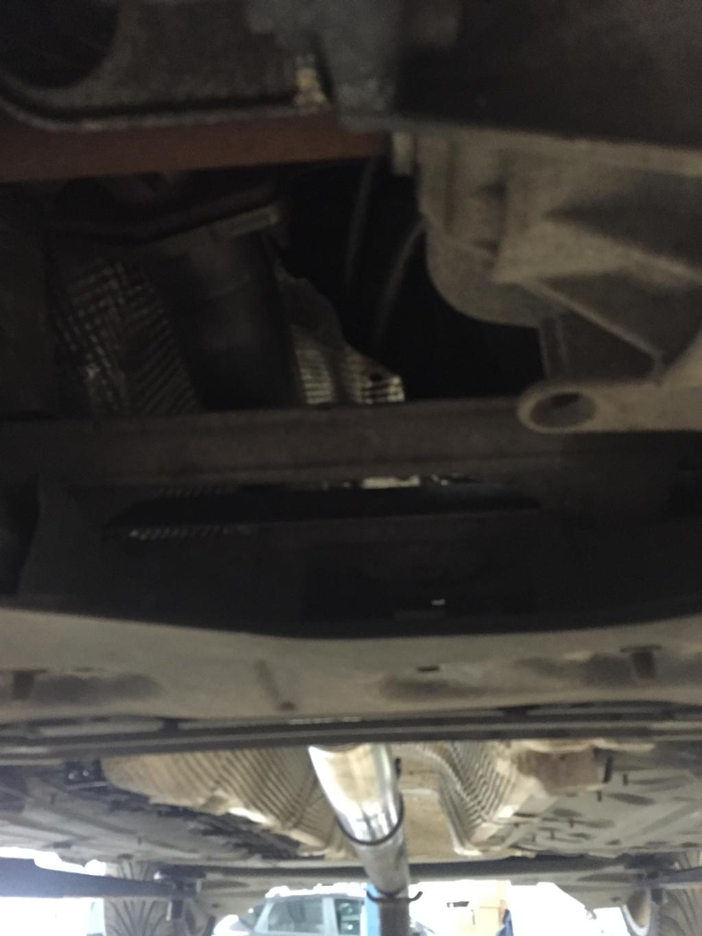

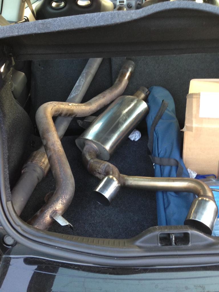

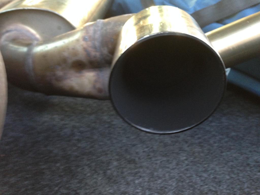

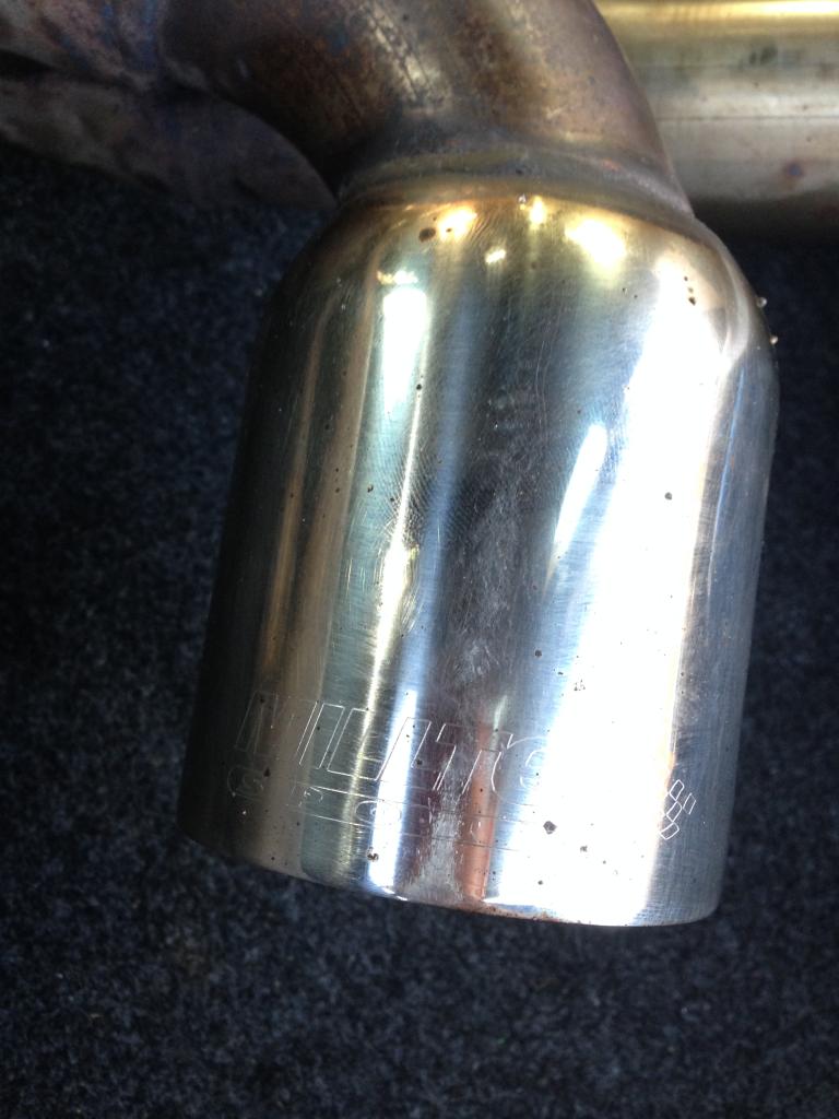

Good news after a lot of messing about , I fitted the Milltek system ! What a PITA ! Bumper off all sorts was hoping for a quick job lol
Then when fitted I realised it was supposed to have a Milltek rear exhaust mount that I didn't get hold off , so it's ok the normal mount with a cable tie modification to stop it rattling haha
I was over the moon with the system , until I ran it for 5 mins and thought, this is blowing somewhere , back up on the ramp and found the front flexi pipe although no signs of damage , it's blowing ! Gutted :(
I rang Milltek the next day to try arrange a mount and front flexi , as per there customer service was crap ! Messed me about through email for a while then never got back to me , so I rang again , and they do the flexi sperate , but it's about £150+vat ! But no price on the rear mount and I got annoyed chasing them so I gave up !
Fast forward to now , and some how luckily I've dropped on, after a random chat on Facebook I managed to find a bloke selling a BNIB , Milltek front flexi , 2.75 inch make him a offer , so after a chat , he was happy with £70+ postage , deal done and it landed yesterday, looks spot on never been fitted as it wasn't what he needed !
So that will be getting chucked on ASAP!

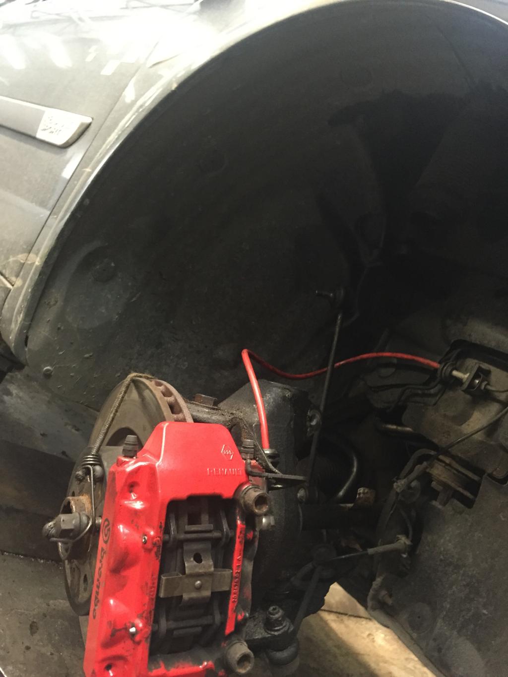

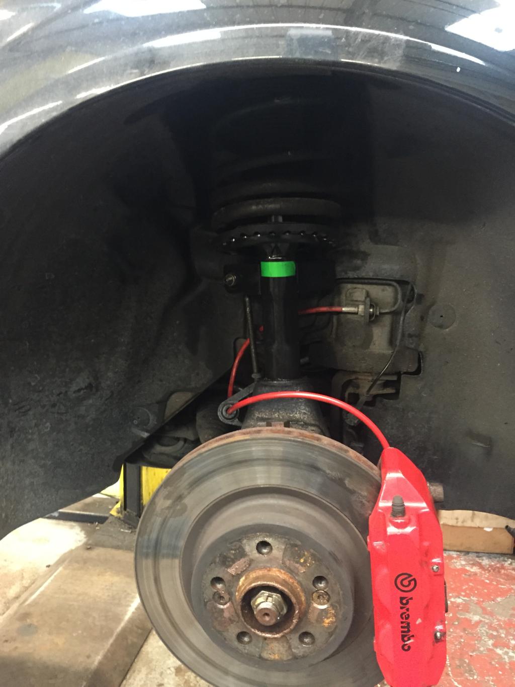

Also when it was up, I fitted a brand new Renault Nearside Track rod end as the old one was cream crackered! Could really benefit from a inner track rod as well which I shall get sorted in due course along with a OSF shocker !
While it was it bits I tried stop the brake squeal , so ripped out all the pads and chamfered all the edges and gave them a clean a some fresh grease , worked for a little bit but still have a little noise , which I'm sure is just pad noise now !

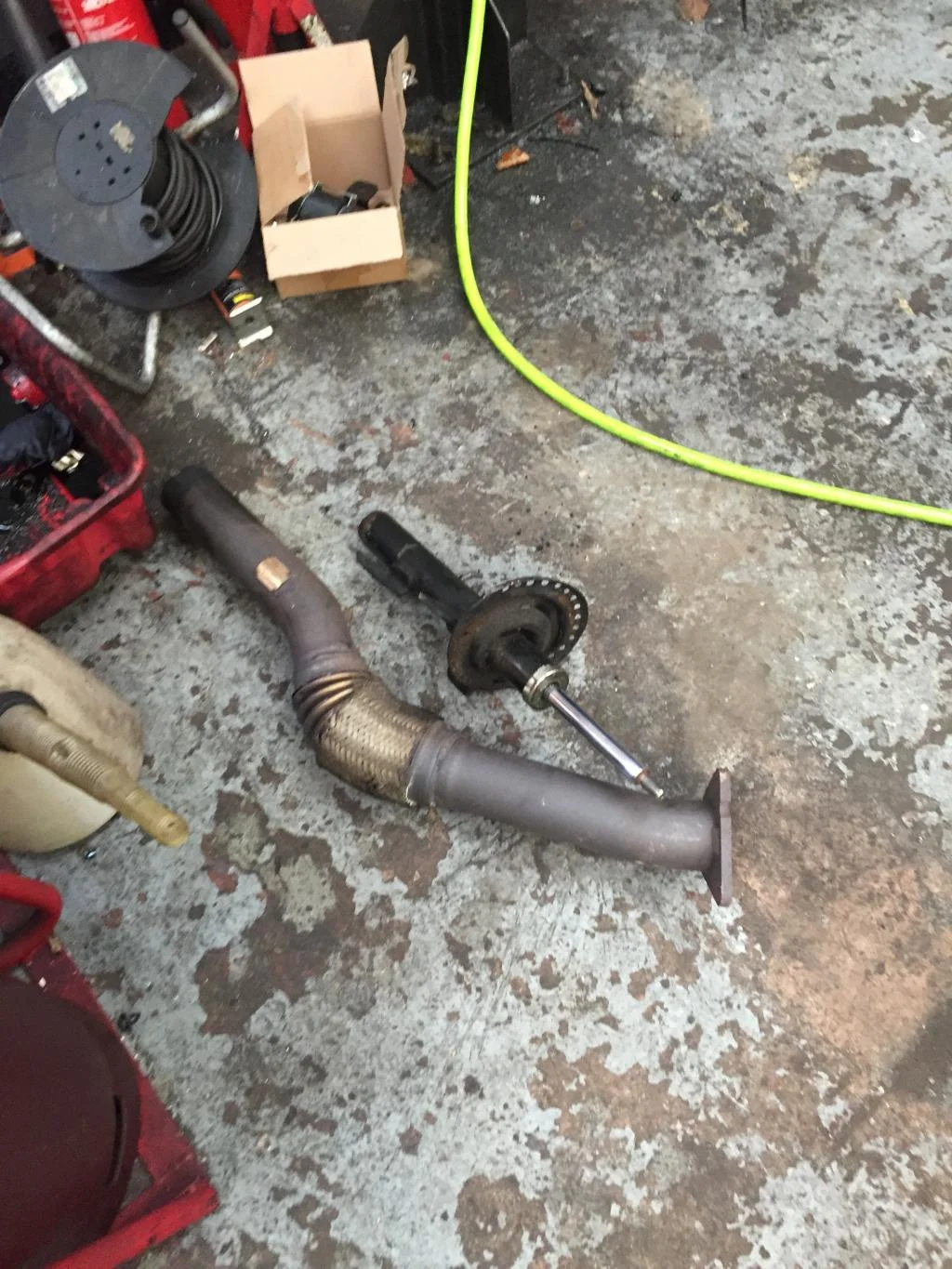

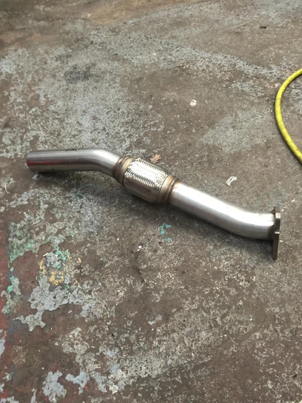

I also have a brand new in box Milltek flexible pipe to replace the one on the car as it's blowing 😧

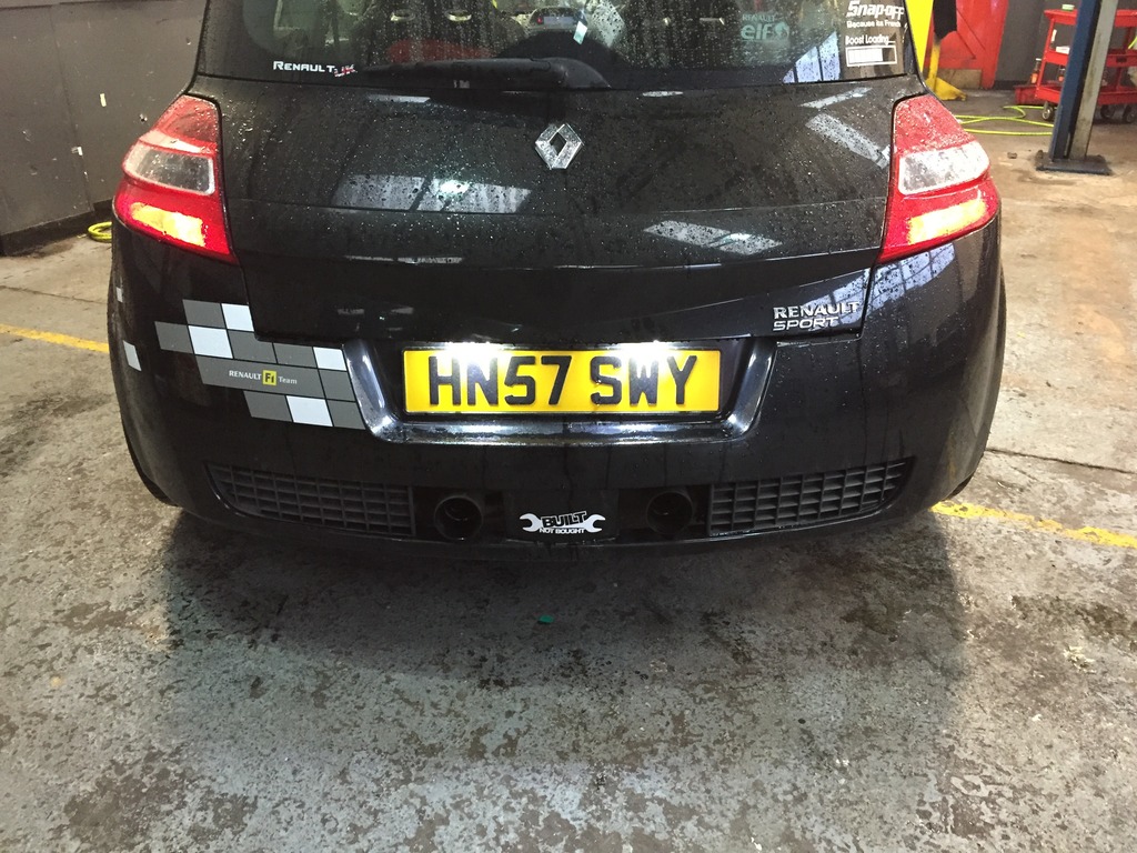

Also as a present to myself , I had a chat with Adam at Renault Wolverhampton, and ended up ordering a new R26R spoiler lol £110+vat iirc !
The car was sent last Friday to a local Bodyshop (owner is a friend who owed me a favour)
And £50 later it's been painted and fitted ! I don't have any good photos of it yet , It really needs a clean but some till I get a good photo

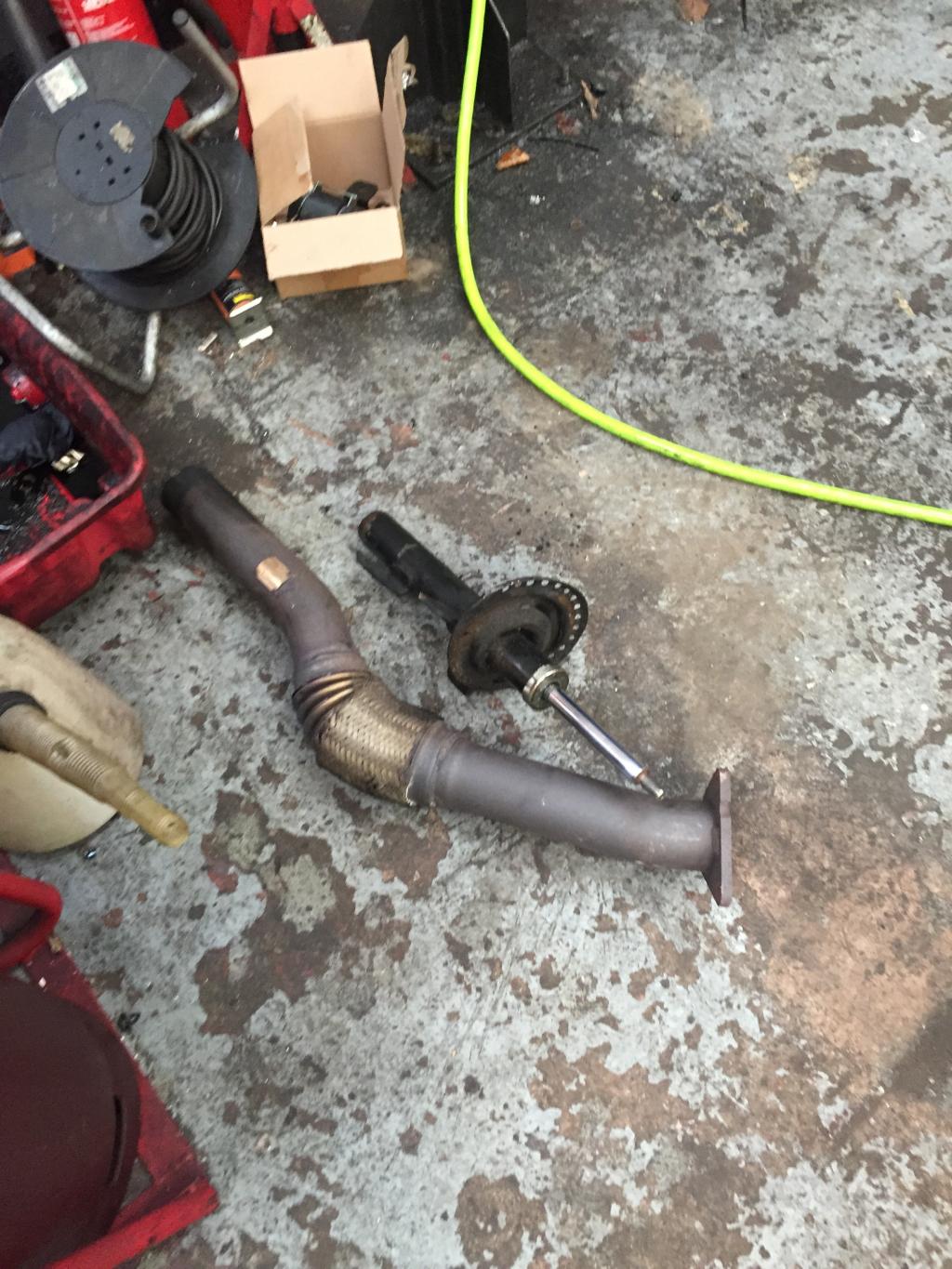

Well the times hs finally come around that I actually need to do some work on the megane !
To be fair ive been rather lazy and stock piling bits together , but between work and other jobs ive had no time to even look at the megane !
Ive booked two days off work start of March, and cleared it with work to use my ramp, and the megane is having everything thrown at it , all the bits I have including some new stuff too !
List as it stands ,
New milltek front exhaust flexi

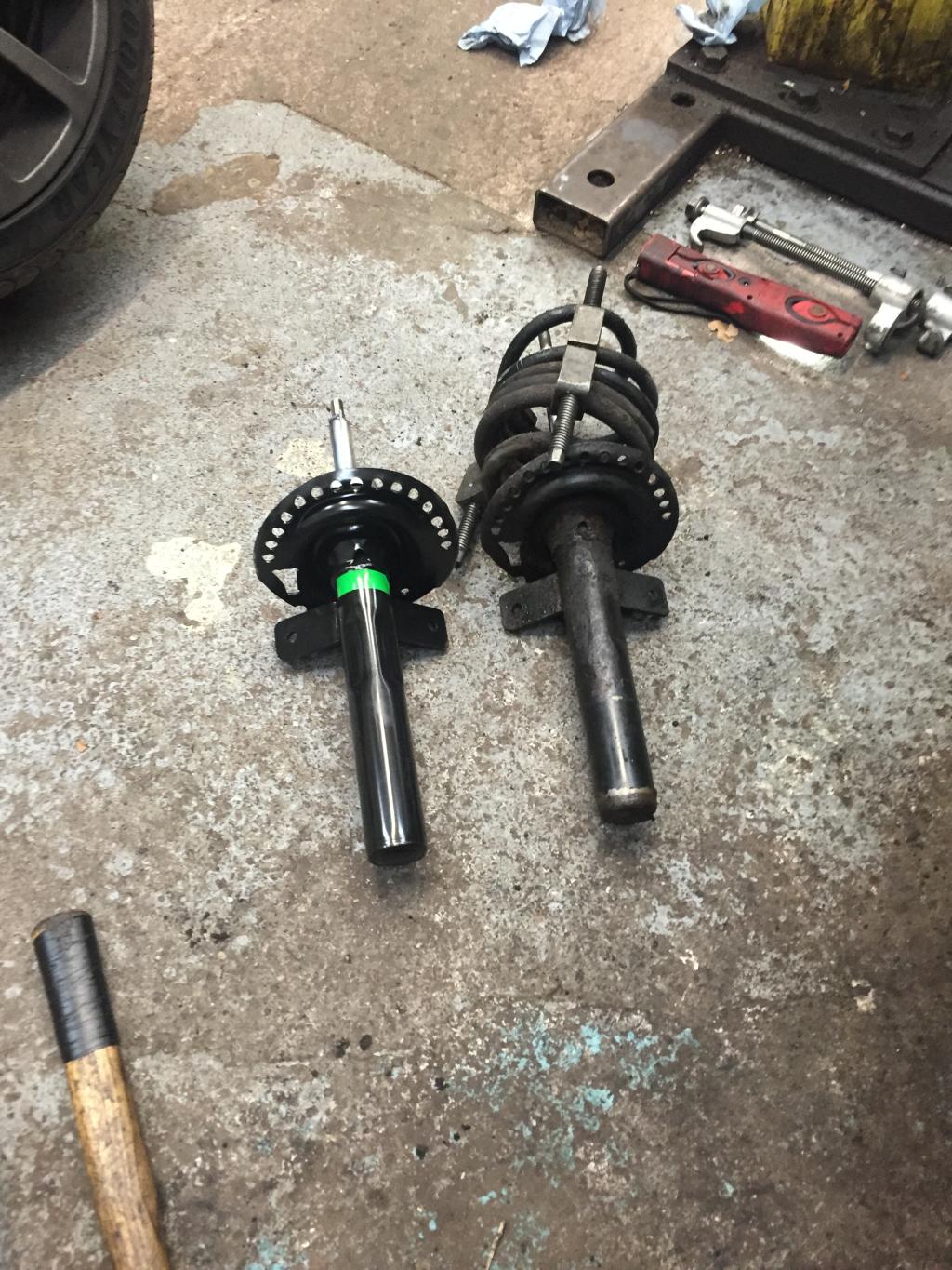

Offside front shock absorber
Nearside front track rod end
Clear indicators bulbs all round
New LED front sidelights

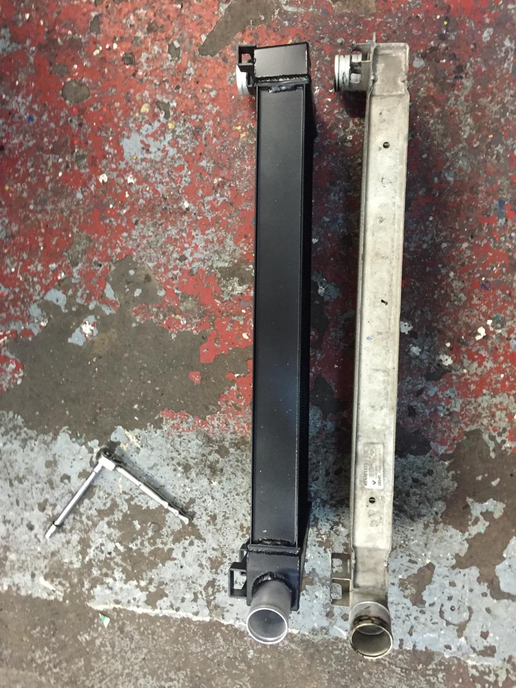

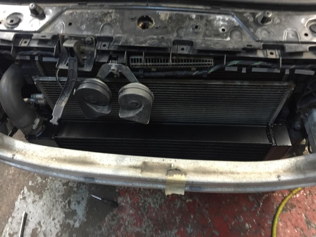

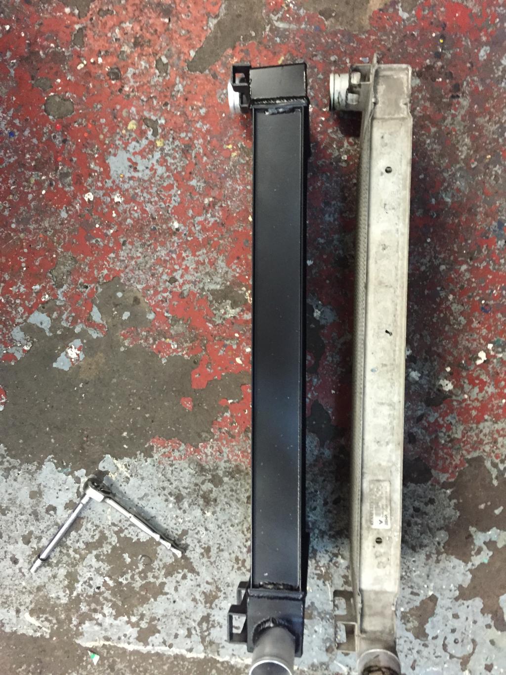

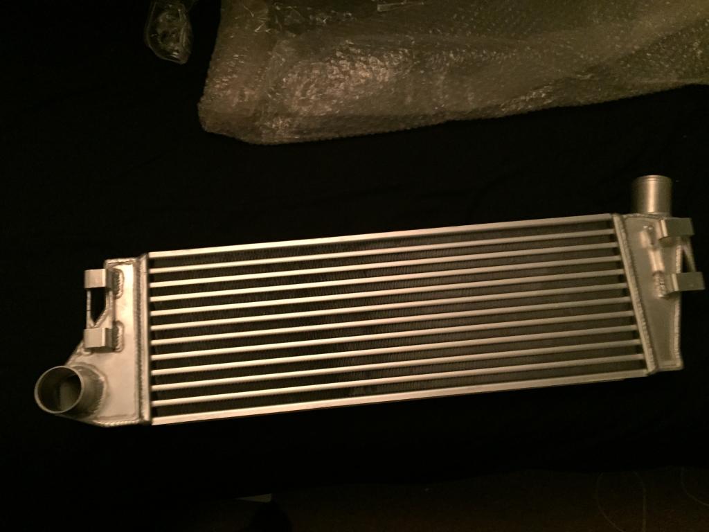

Also , I got a bit cheeky on eBay the other night
Got this new intercooler for a bargain
Ive seen some debates on these , and as much as I'd love a forge or airtec I just can't justify the cost :(
I know a lad who has this exact intercooler running a steady 270 bhp 290ft ( which is my aim) He's done a few runs and inlet temps were great , so I'm hoping this works well, after all the proof is in the pudding , I don't want to go big power , my aim is 270bhp I'll be happy at that so this should be plenty !
And bet thing is , £76 delivered ! So even if it isn't the best , you can't argue with that when its new !

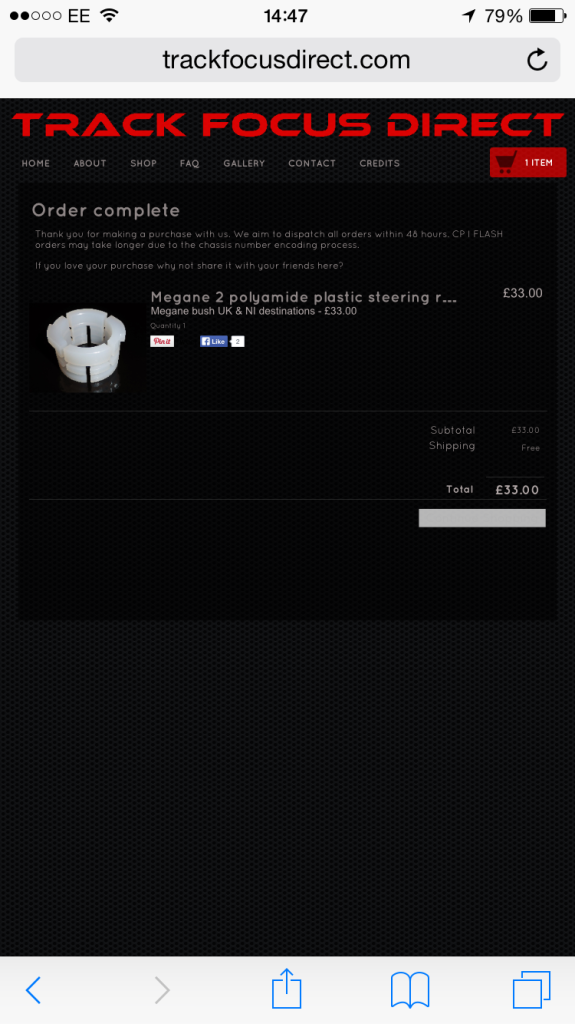

Also after a chatter on the Facebook group , I got chatting about this Nearside track rod play , turns out it's quite common on these (I never knew) so I have a new track rod , under the apprehension that would cure the play, but apparently not , there's a nylon bush that sits inside the steering rack, which fails , and causes the play!
Now I'm yet to rip the car apart , but in the interest of speed , I decided to track down the bush , which can be bought seperatly from a company called track focus direct ! (Thanks Adam greenhouse ;) )
The bush is £33 a lot cheaper than a new rack , and it's on its way, I will be fitting this along with the new track rod end so that will hopefully eliminate any play at all !

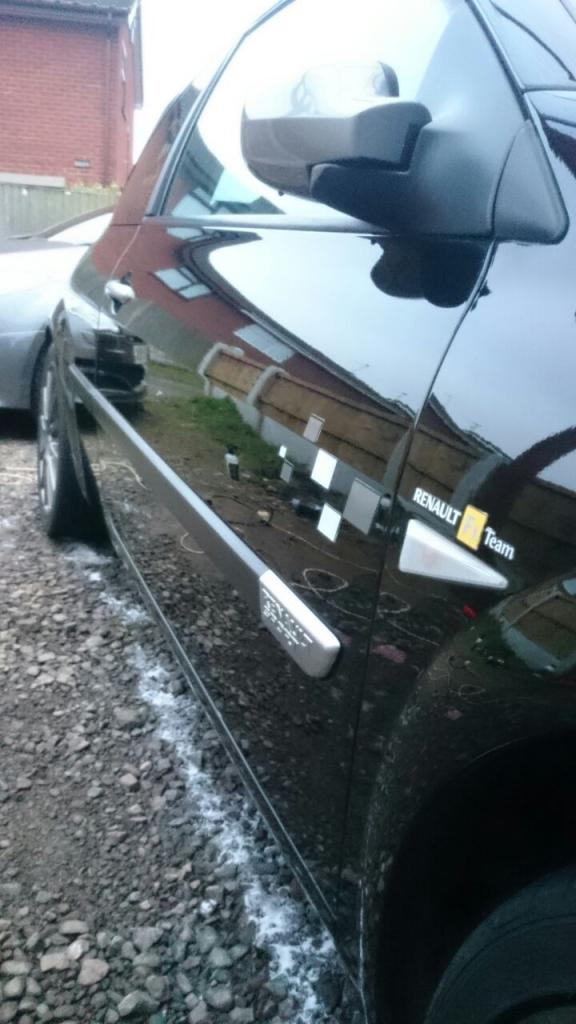

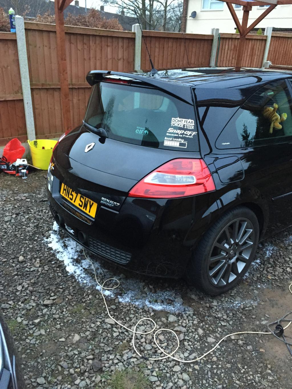

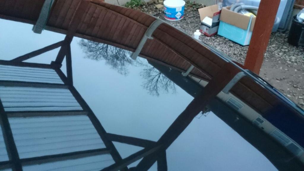

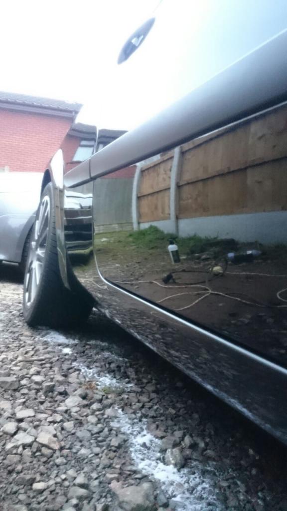

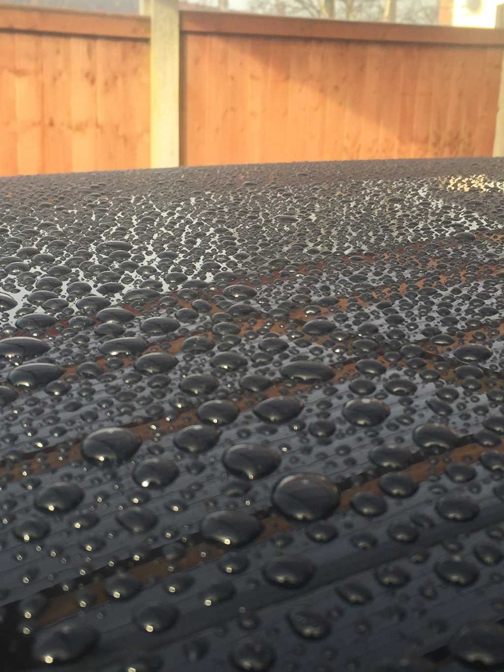

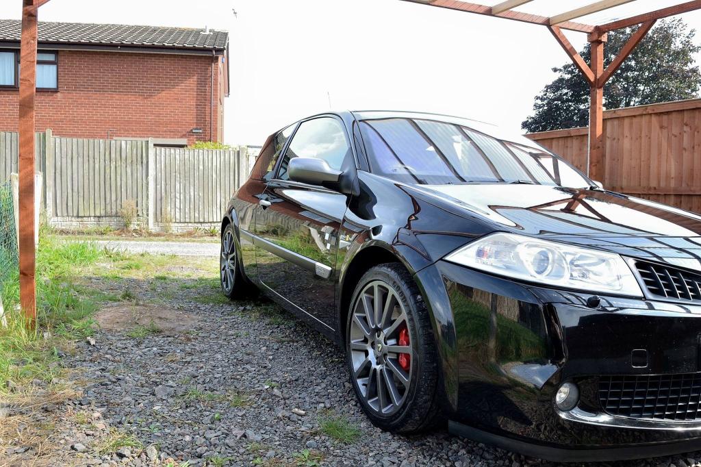

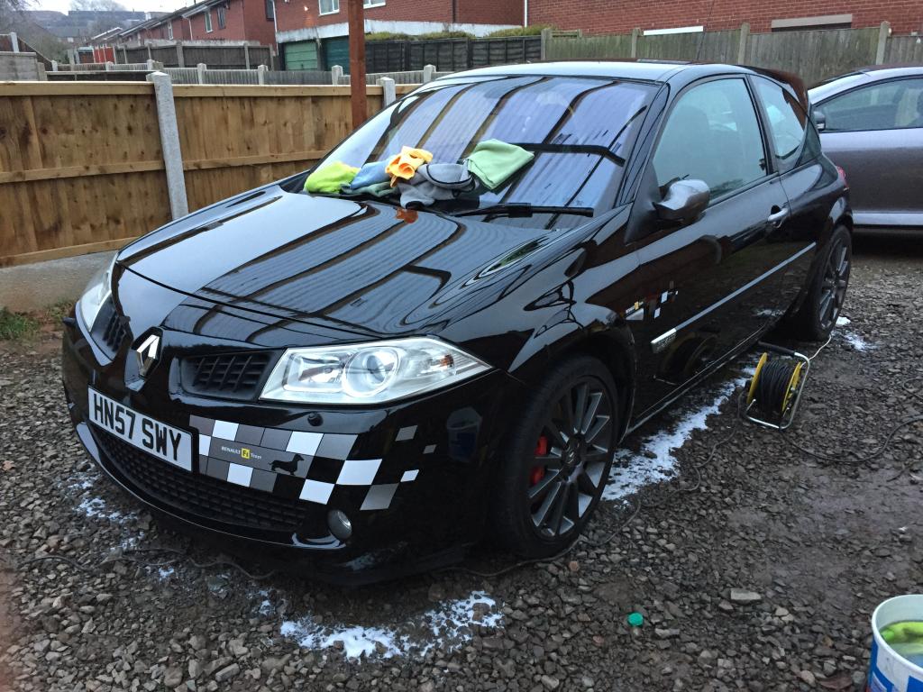

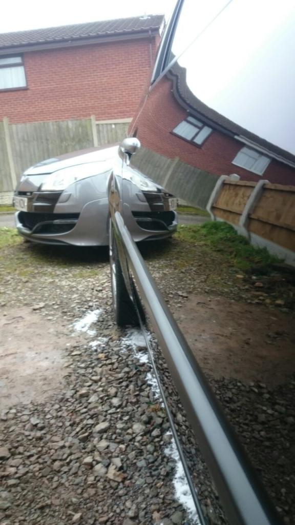

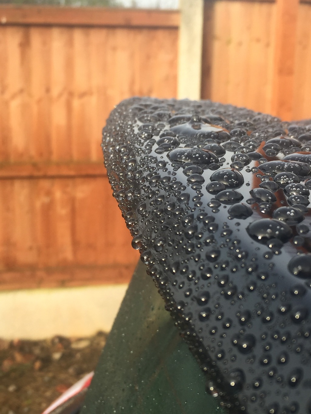

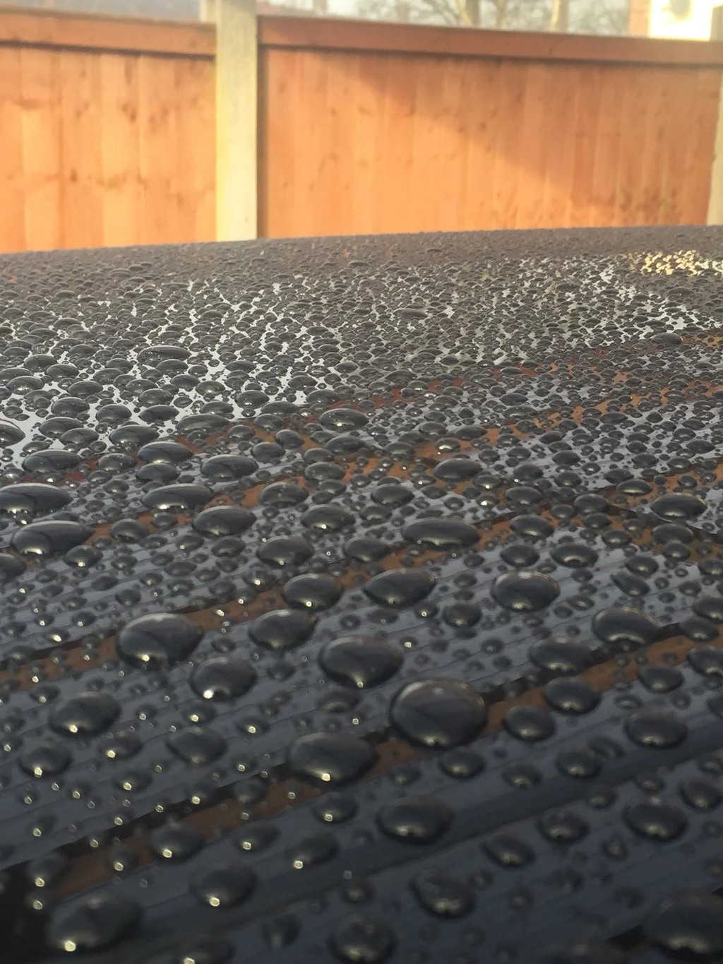

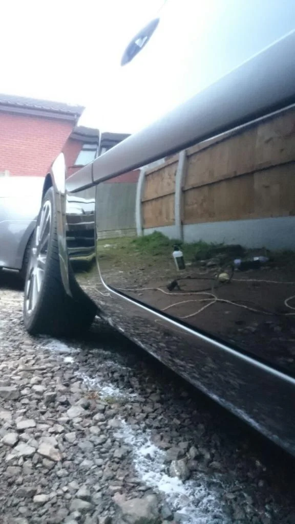

Well ive been saying for a while that I need to get the paintwork tidied up a bit on the megane , but inbetween sorting other people's car ive not even looked at mine !
Finally got a free weekend last weekend and decided the megane was in for it , started nice and early and a mate popped around to give me a hand !
It's been washed snowfoams , clayed and washed again , dried and then we started with the machine polishing !
We used a combo of many things, DAS-6 Pro , DA-21 and used multiple foam pads , for cutting we used AB enrich , as I find this a great product, and not too much cut, and finished with AB final finish , I gave it a very quick layer of Definitive wax show edition , but didn't quite manage to finish the full car before it went dark!
It's going to be washed again soon and a layer of wax ! Quite keen to try a new product called Sonax net shield so I may try that !
While it was there I thought I'll get some photos with the new spoiler on as well !
Came out pretty well just need some finishing touches !

Ive finally replaced the OSF shocker , it's been on its way for a while and it's been driving me up the wall!
All its fluid had come out now so it was about due to say the least ! Took a bit of fettling and a convo with mark black (top guy) on the best ways of removing it !
While I was there I decided to replace the Milltek front exhaust flexi that's been driving me nuts as well , it's always blown from when I fitted it but the last couple of weeks it's started to get worse , unfortunately with the system it was siezed solid in the Center section so I ended up removing the full system and bumper and starting again which most likely helped as I tweeked a few things (rear mount was modified so no rattle) and the position was slightly altered , but over all happy days , it sounds a million times better , a lot more poppy which it's never sounded like!

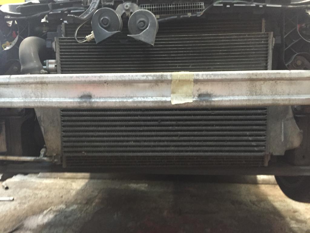

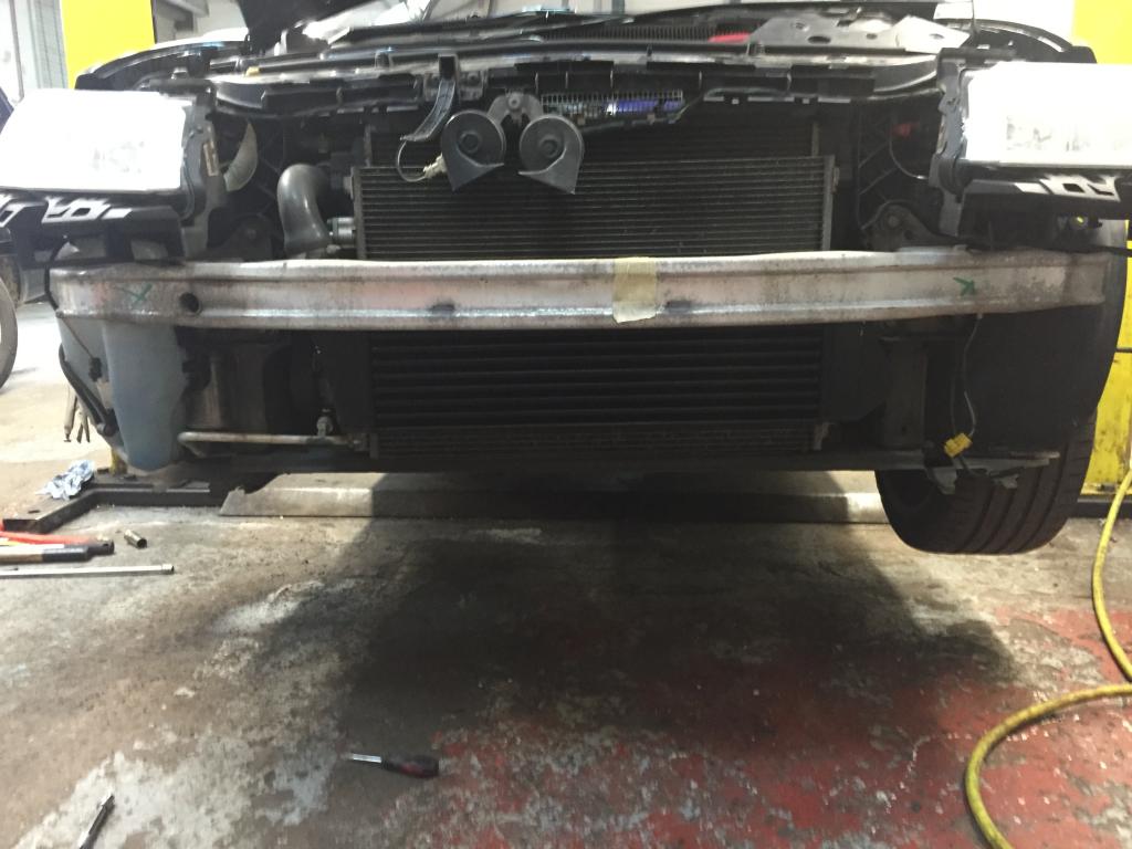

I also set about fitting this new intercooler , which ive sprayed black , because I prefer the stealth look to be honest , Now I knew from day 1 it's only small compared to the forge or airtec, however a friend has this excat one and sees a good 270 bhp without any rise in inlet temps so that's plenty for me !
Here's a few photos before and after

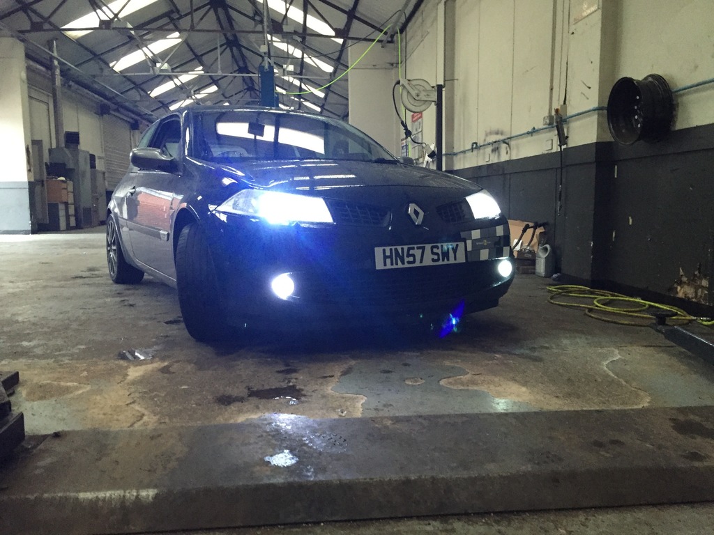

I also took this time while the bumpers etc were off to sort a few bulbs lol , ive replaced the two front side light bulbs with new LED 501s as one was flickering , ive replaced the indicator bulbs with silverline bulbs that are visually silver but flash orange , same at the rear , and I replaced my front fog lamps with new led bulbs , makes the world of difference !
Few things left to do but getting there finally !

Progress has been somewhat slower on this Meg than I wanted !
It's hard at the moment juggling work and all sorts but I had the chance do a few bits and bobs on the car on Easter Friday at work , gave it a once over and noticed there's some slight play in offside front track rod / end , no I already have replaced the NS track rod end , but I need to fit the NS track rod and the nylon bush within the rack , so this has kind of spurred me on , so ive ordered now a OSF rack end and track rod so I can do it all once and then track it up once !
It'll have new track rod ends and rods Both sides and a nylon bush replaced !
Also found 5 mins to replace the drivers brake light that was out , and swap the numberplate lamps to some LED lamps, I had LED bulbs in before but the chance came up for some lamps , a lad had bought them and they didn't fit his phase 1 , price agreed and they were on the way to mine ! They were a little tight to fit and took some jiggery pokerey to get the plugs onto the lamps but once on they have been great :) really bright !
Here's some photos of the number plate lamps and front fogs and clear indicator bulbs , they don't do them justice as it was daylight, but at night they really really stand out

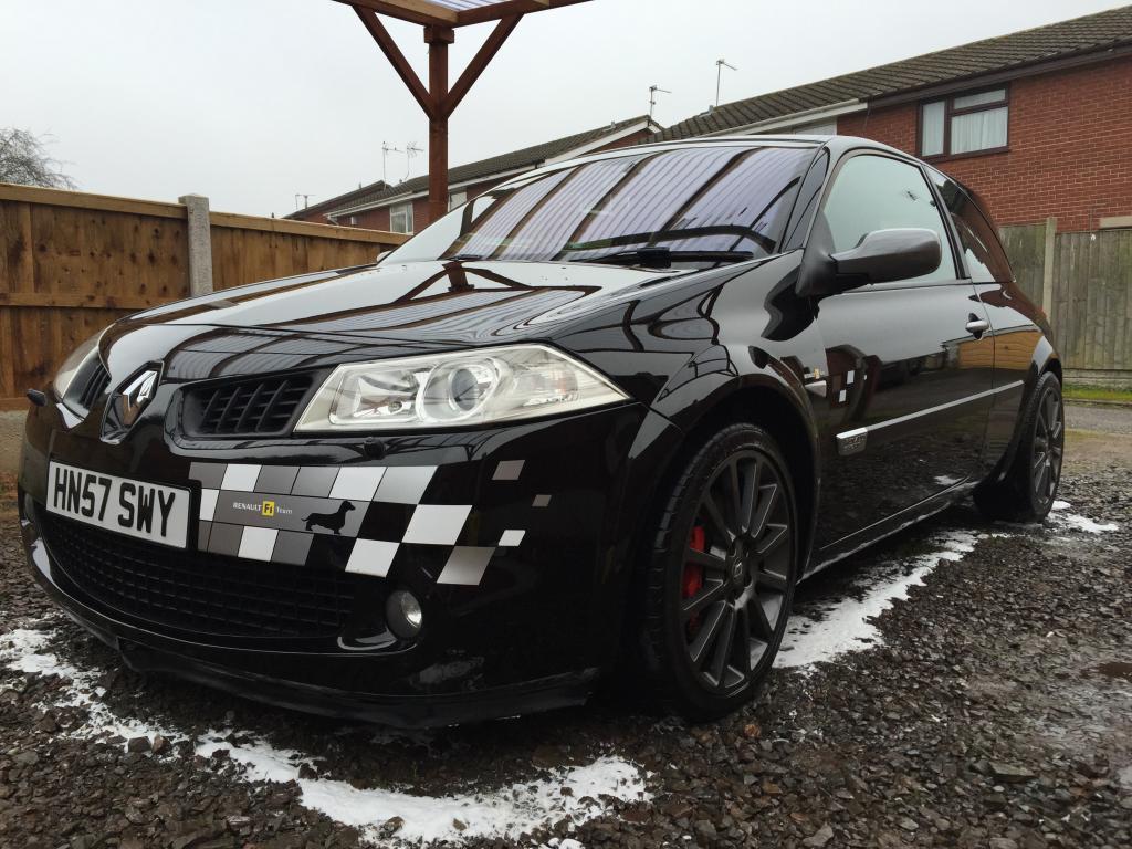

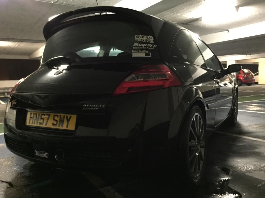

Oh and I gave it a good going over washed , and finally did what I was thinking of
It's now window sticker less hahaha

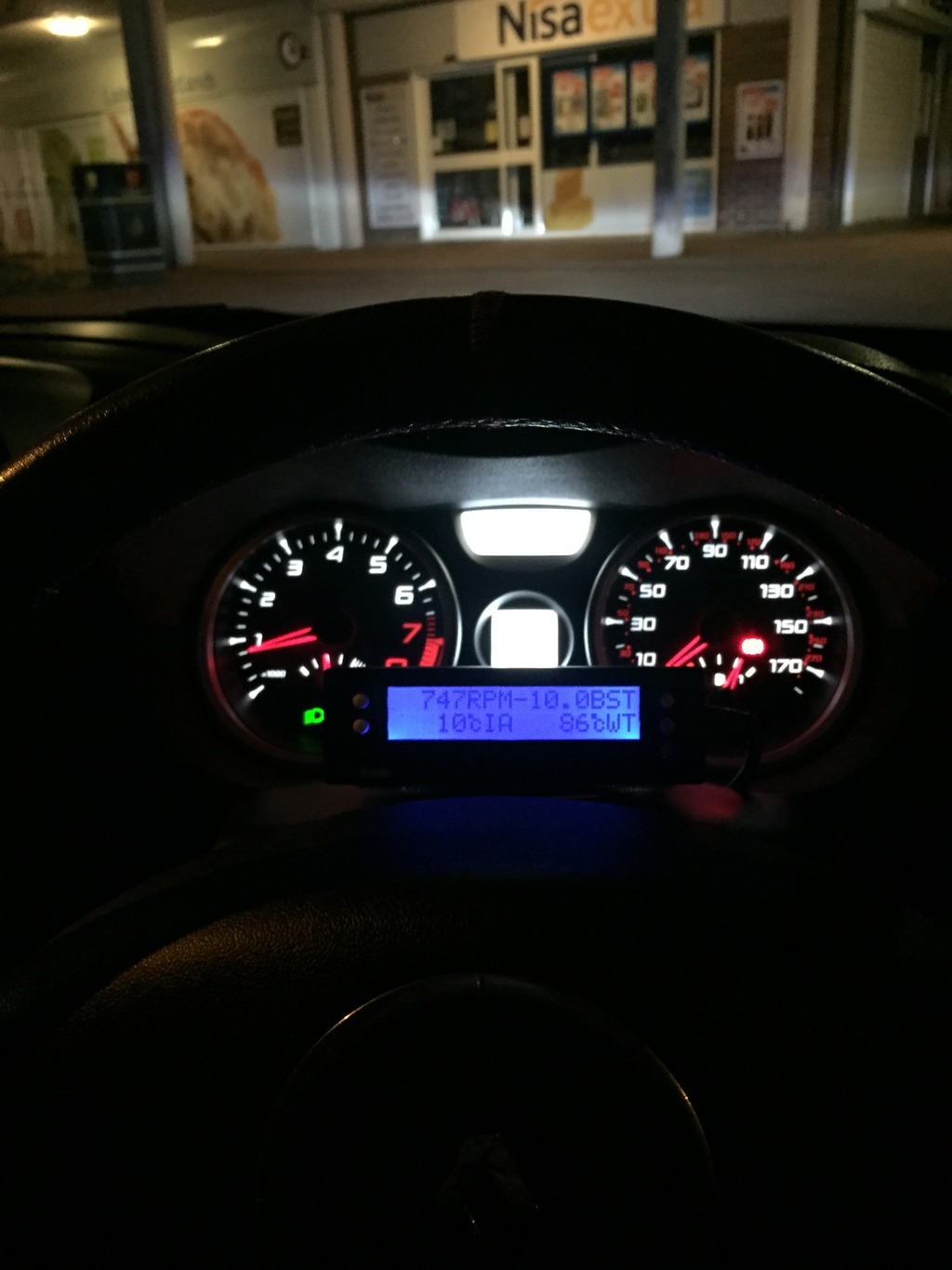

Also dropped on a new gadget which I've been keeping my eyes out for !
A scan gauge 2 , I like to monitor things so it comes in useful , I've set it up to give boost pressure , RPM, air inlet temp and Coolant temp , as yet , everything is looking bang on what it should be , running around 13-14psi (which needs fine tuning has to be set off atmospheric pressure ) coolant sits at 88degrees and the air inlet is keeping nice and cold , around a degree or two above outside temp so I'm happy !

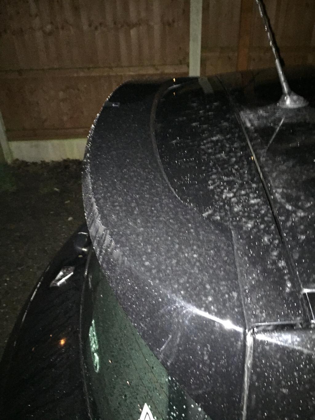

And some nice beading after being left out of the car port the other day, currently has 50 cal Penta wax , but I regularly change it due to the passion of cleaning them, just Had another definitive wax land and I've been using Sonax Polymor net shield as the beading is amazing !

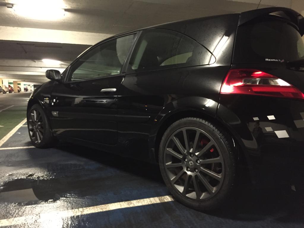

Getting there with it , needs a set of front tyres next month so I'll be ordering them soon as well!
Fancying some Michelin Super sports see what happens though !
