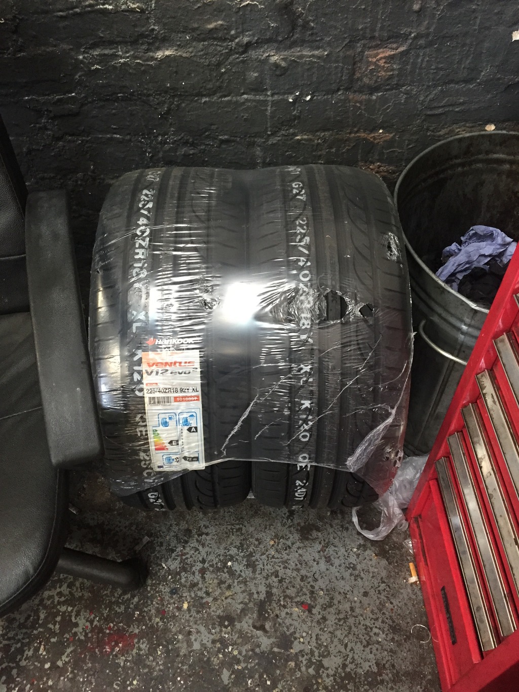

Also after much debate I've finally bought some new front tyres ,
decided to stick with what I know , has these Hankook Ventus V12s on the clio, great tyres , wet grip rating of A so need throw these on and do the track rods and ends soon!

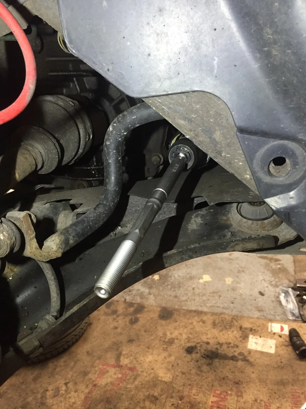

I I now have a 2x new track rod ends and 2x track rods to go on along with the nylon bush for the rack so it should feel pretty damn tight when I'm done !
holding out replacing the tyres until track rods are some and I've set the tracking right!

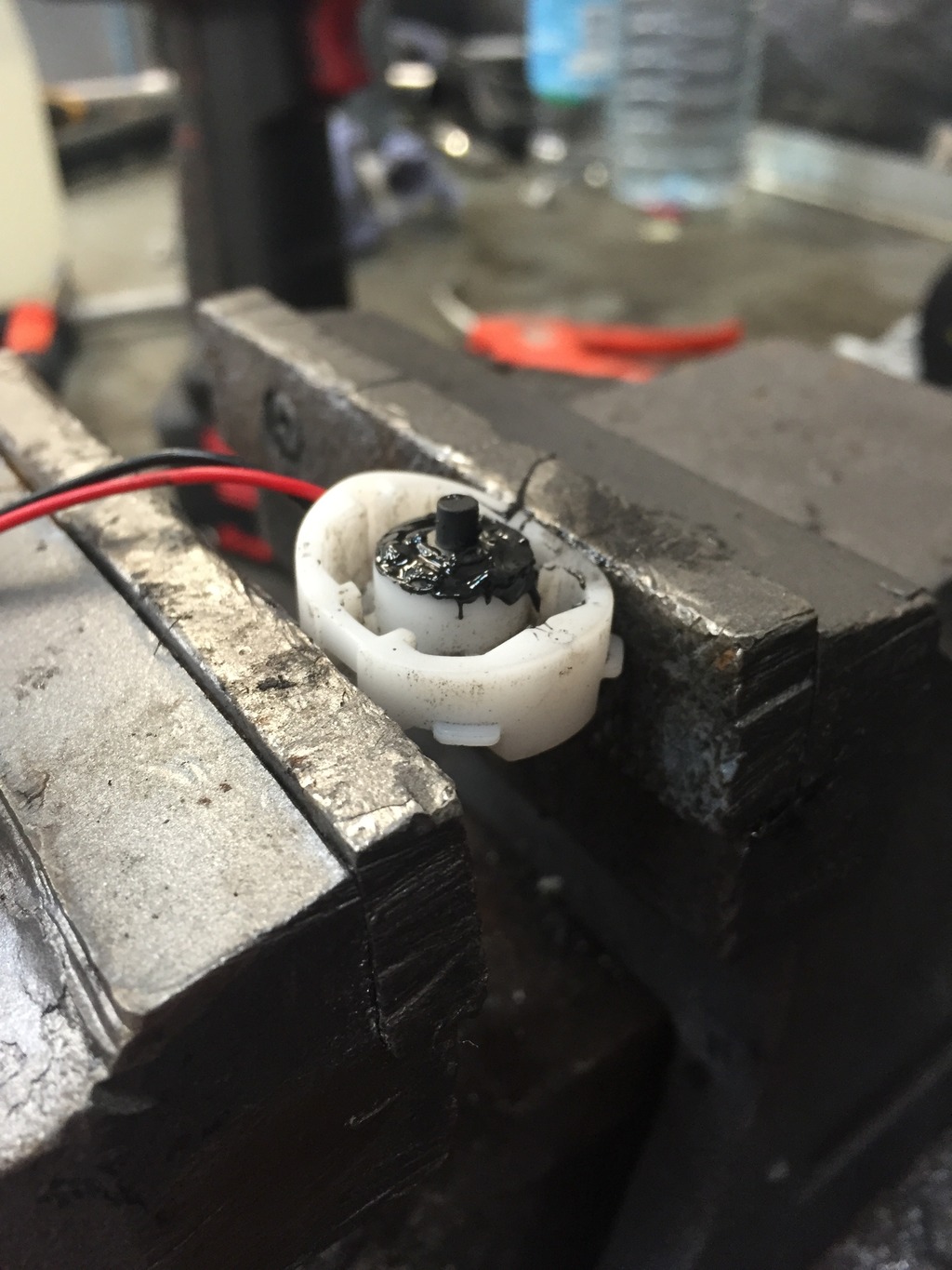

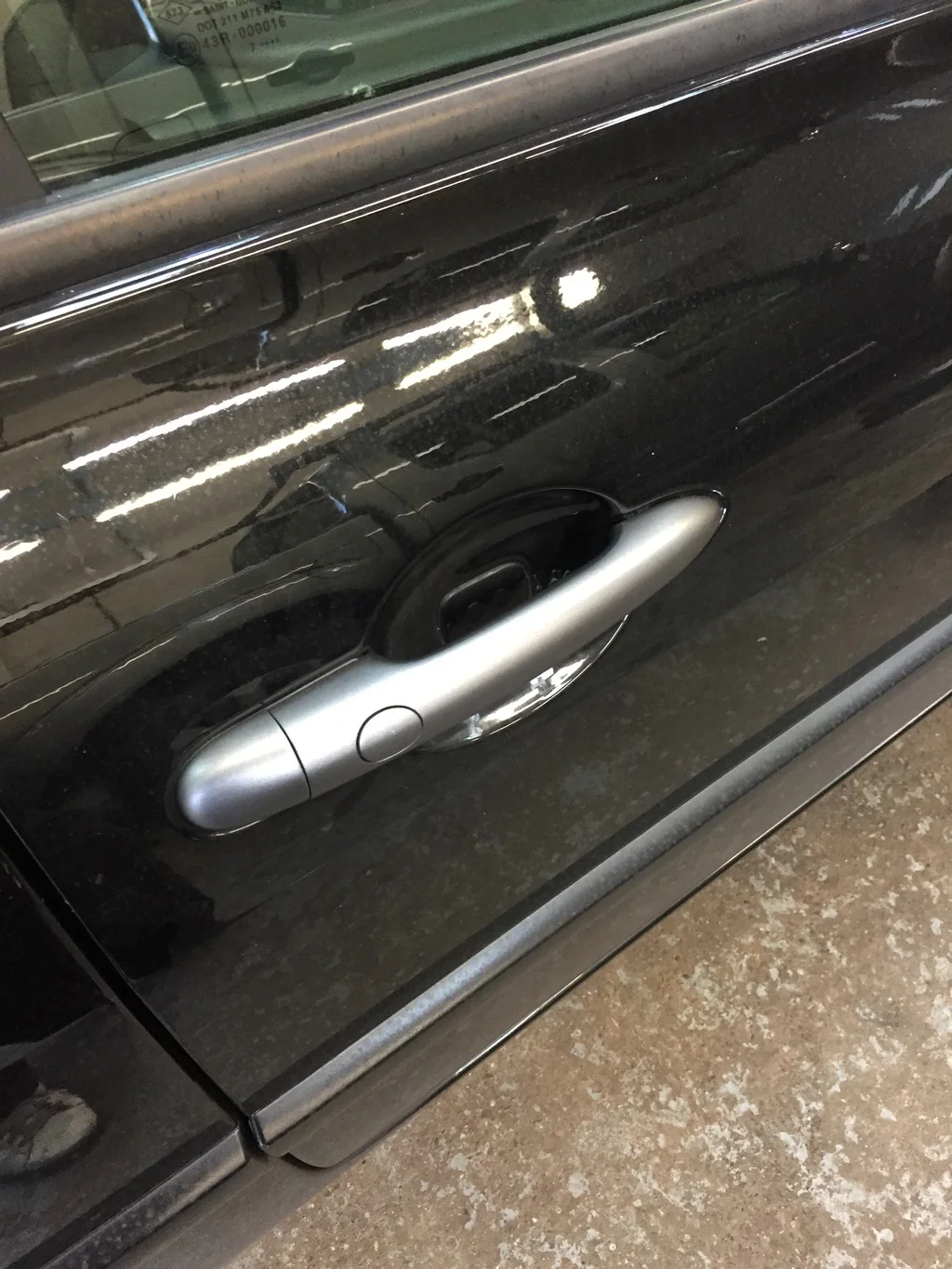

Also after much moaning I'm finally sorting the keyless entry door handles , I managed to find a set of new handles , near side and offside and I'm in the process of refurbishing them , well that's a lie , they are already done but I only have the photos from half way through haha
Ive got new switches inside which I fitted , bit of a pig to solder in , but I've never been the best at soldering lol , I've checked them all over and there's continuity across the loom so they are only to go on, I've re sealed them up, and I've painted them in primer and the other week I went to fetch some paint , I've decided to paint them the same colour as the wheels and mirrors which was a stupid idea apparently because the colour is a ixcell paint colour I've no idea either lol but it's paint code 205-272
which in itself is a pig to get hold of , but after a trip to Santa pod to watch classic ford show I struck up a deal and collected some off a lad who had a can !
Ill get the photos soon, lovely colour and should look ace when they all match up , but here's the replacement switches in
And the handles in primer , ignore the button it wasn't in as I was sorting the switch it's been primed and painted with the handle now lol

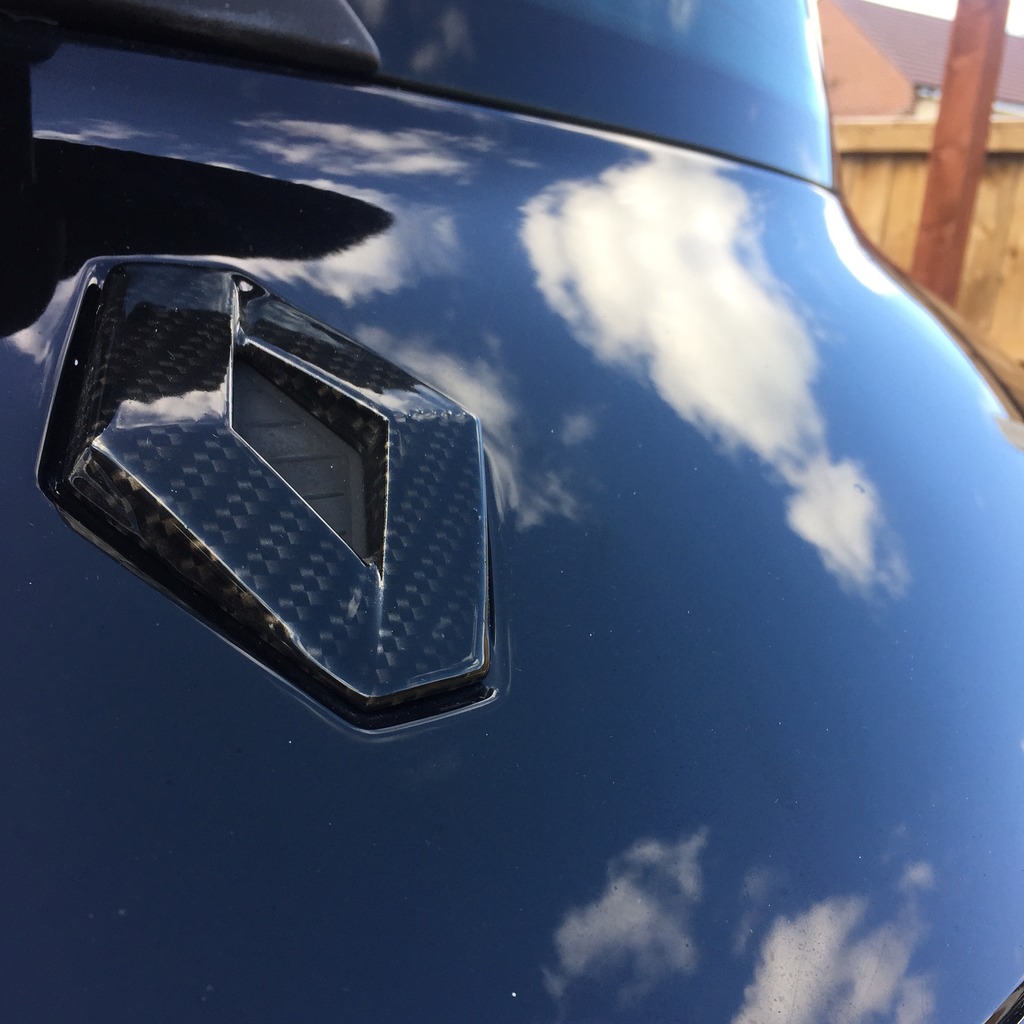

Also won a Hydro dipped Carbon effect badge for the rear on eBay , cost £7 lol so I thought I'd try it see how I feel
not sure if it's staying yet we shall see how I feel ! Lol

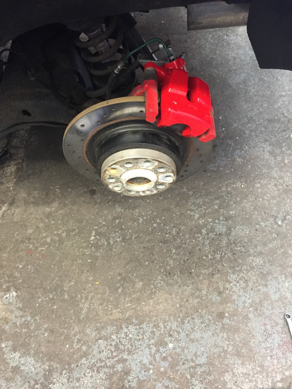

had a slight issue with the handbrake on the megane which caused it to roll off down the road and into a pole !! Wasn't even slightly amused , it's scuffed the paint but the bumper is okay, Which is a good thing I suppose!
This did somewhat cause me to loose quite a bit of interest haha but after a few weeks of moping about I finally got busy , I looked at the car the next day to determine why the hand brake gave up , and traced it to the passenger side rear brake caliper , the handbrake arm was literally doing nothing , you pulled it and the wheel span free still, I did contemplate stripping the caliper but a phone call to Renault , and the Caliper was £70 , service exchange unit , so I had to send the old one back, but they come power coated red , so I didn't bother stripped as a rebuild kit would have been expensive and then I'd want to paint it again lol !
new caliper on and I've got a mint handbrake and everything's working great, the foot pedal has improved as well, I'm thinking with the lever sticking it was causing a lack of fluid through the caliper !

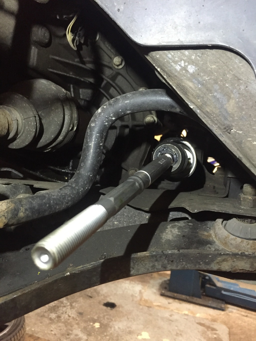

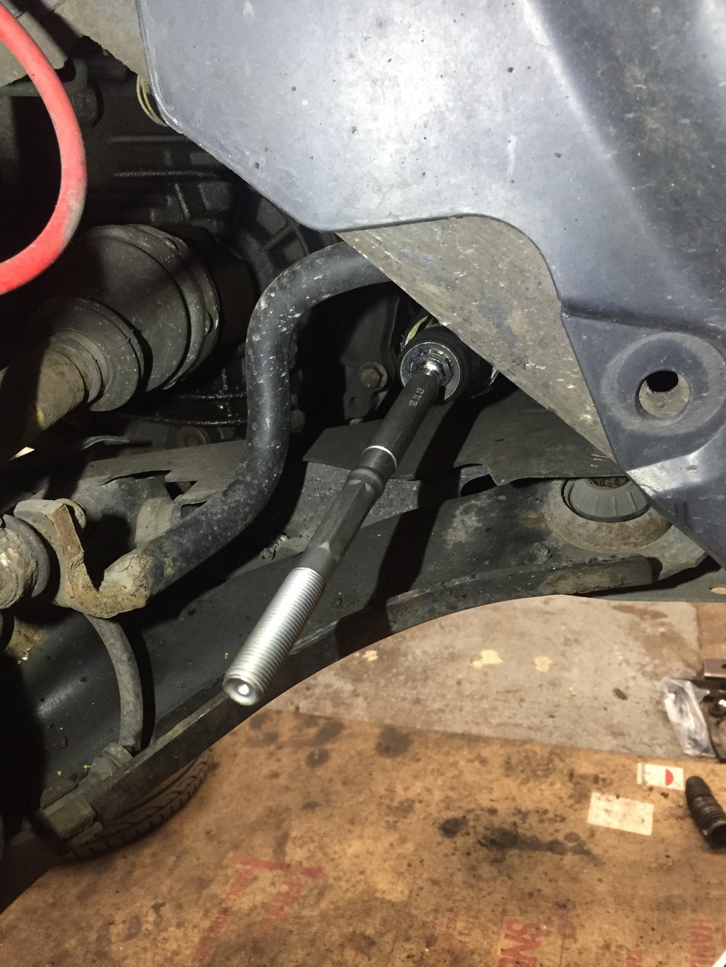

That gave me a bit more interest , so next thing on my list was the Track rods finally , they've been needed doing its just been time so I ripped it all apart , I also had the nylon bush for the inner track rod on the passenger side , but that was like brand new still so I left that out , I replaced both NS and OS track rods and again even though it had a new track rod end on the NS last year, I did both the track rod ends again! I like to know everything is done right and correct so I replaced the lot , both side rods and ends
I got the car tracked up and it drives great, steering wheel is slightly down to the left but it's going back to have that sorted again!
All is looking and driving 100x better , while I was there I also did the couple of month regular strip and clean of the front discs and pads to make sure everything's going well! Loads left on both of the discs and pads still :)

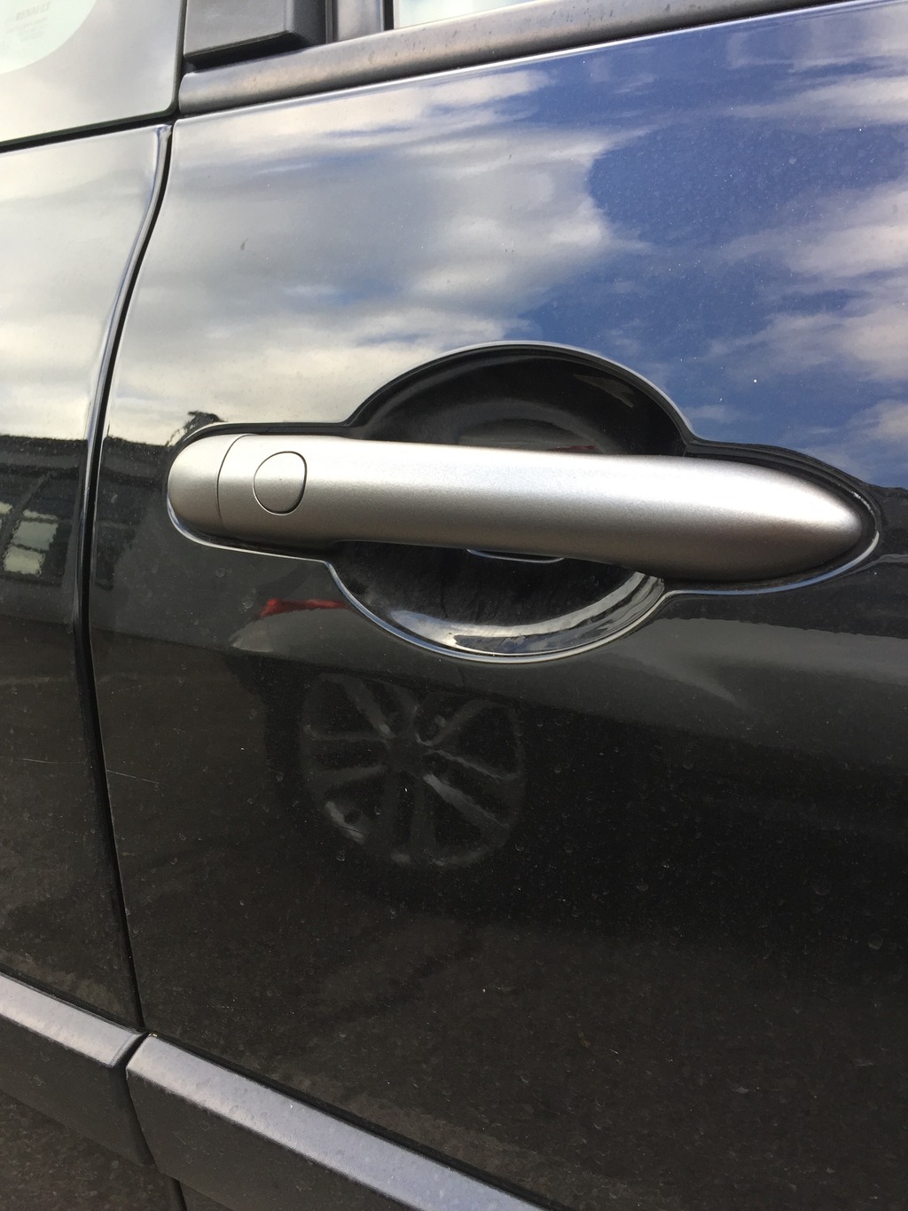

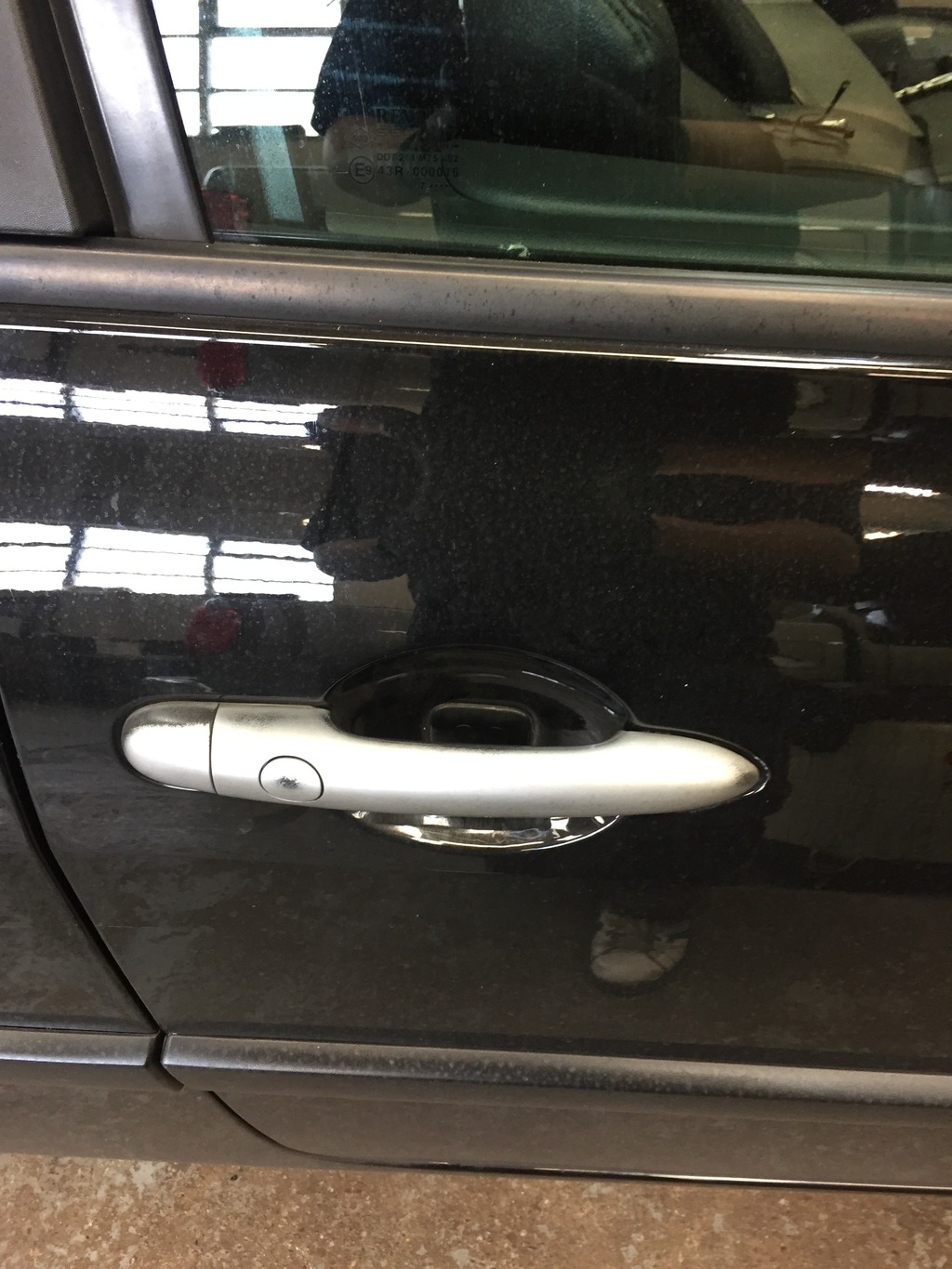

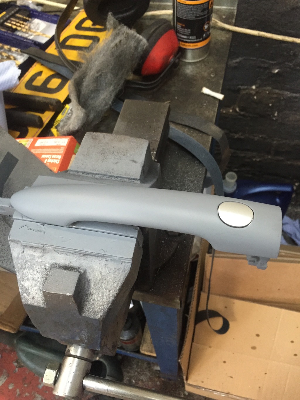

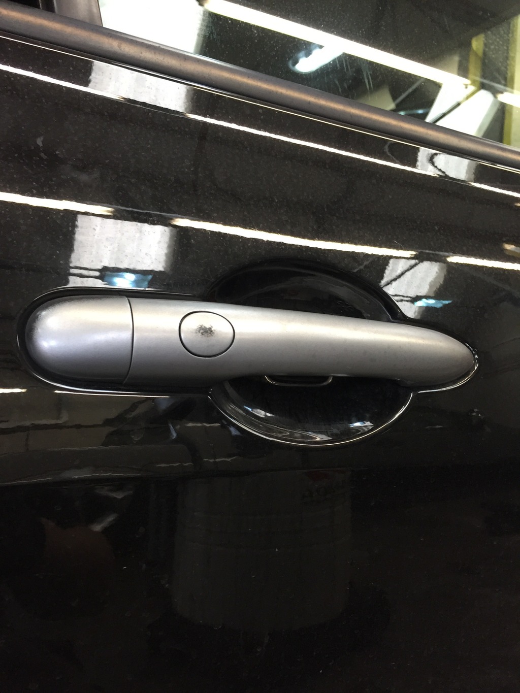

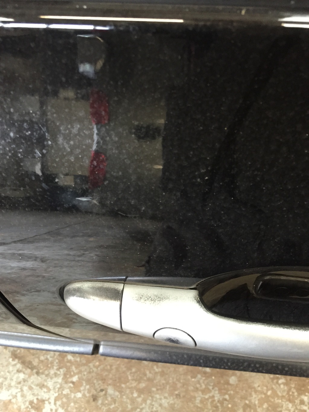

Next on the list , the stupid bloody door handles , it seams as though the plastic coating is thin as p*ss, because you can see the black coming through where there's wear on the handles ! Also when the car was last paint corrected , someone got a little too close around the handle
oh well , they were ripped off and re painted in the colour of the mirrors and wheels , I have don't a set previously but when I stripped them down I found the handles have different plugs ! Doh
Some before and after lol
after
loads better !

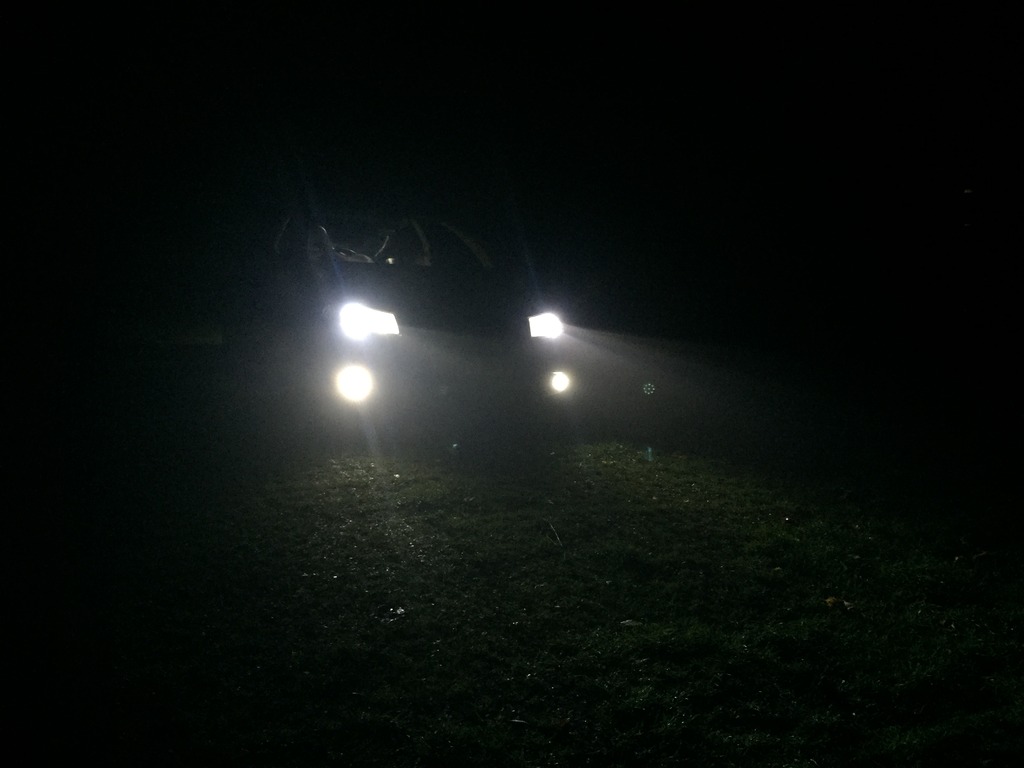

Also has some LED front fog lamps as mine have started with some water ingress , so may aswell upgrade haha

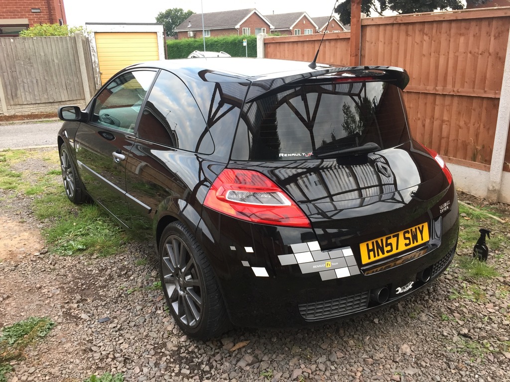

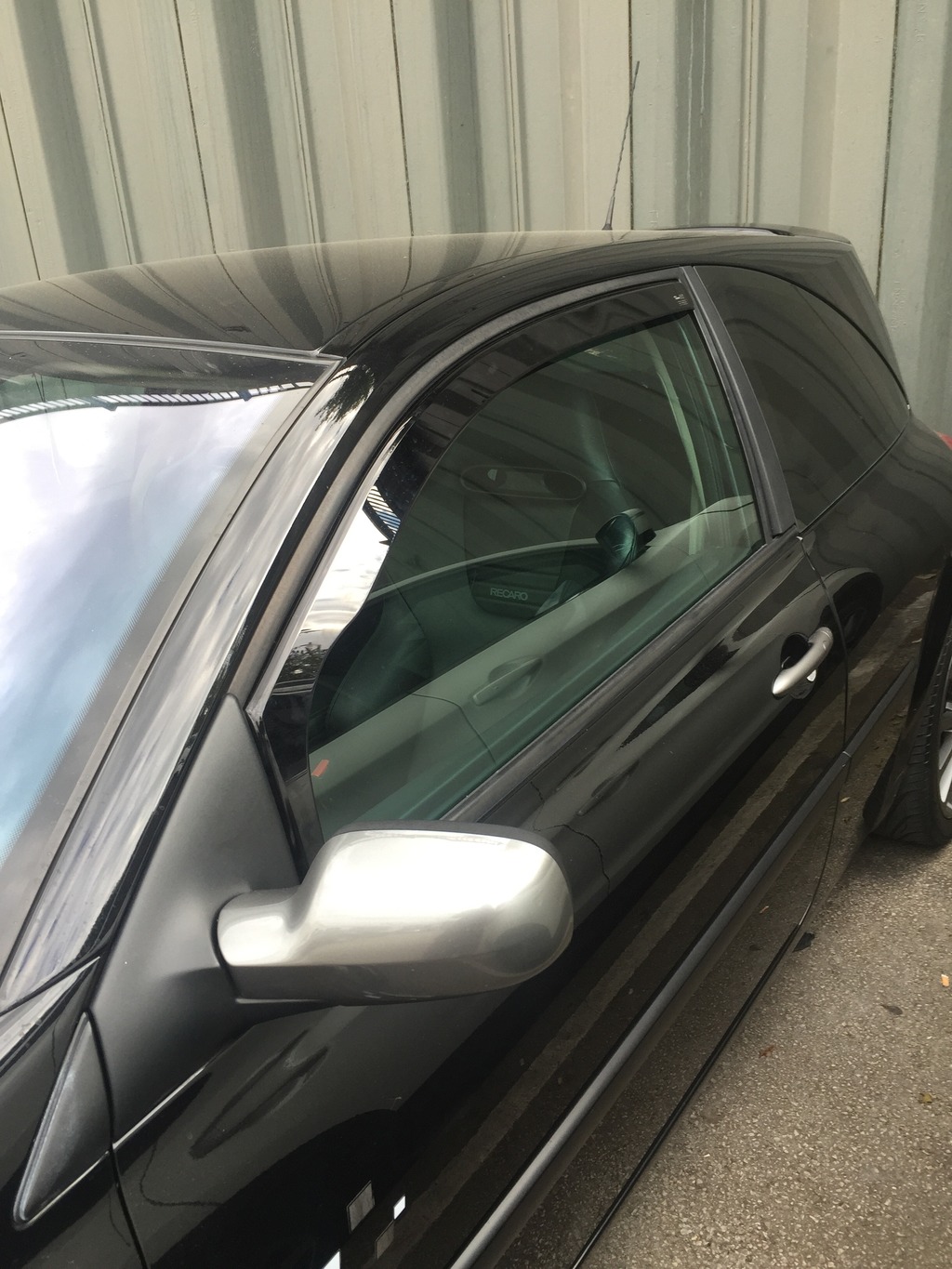

A local lad has also been out and tinted the back 3 windows in dark smoke for me last week , he's done a decent job and I'm happy looks loads better really glad I had it done !
Heres more photos lol

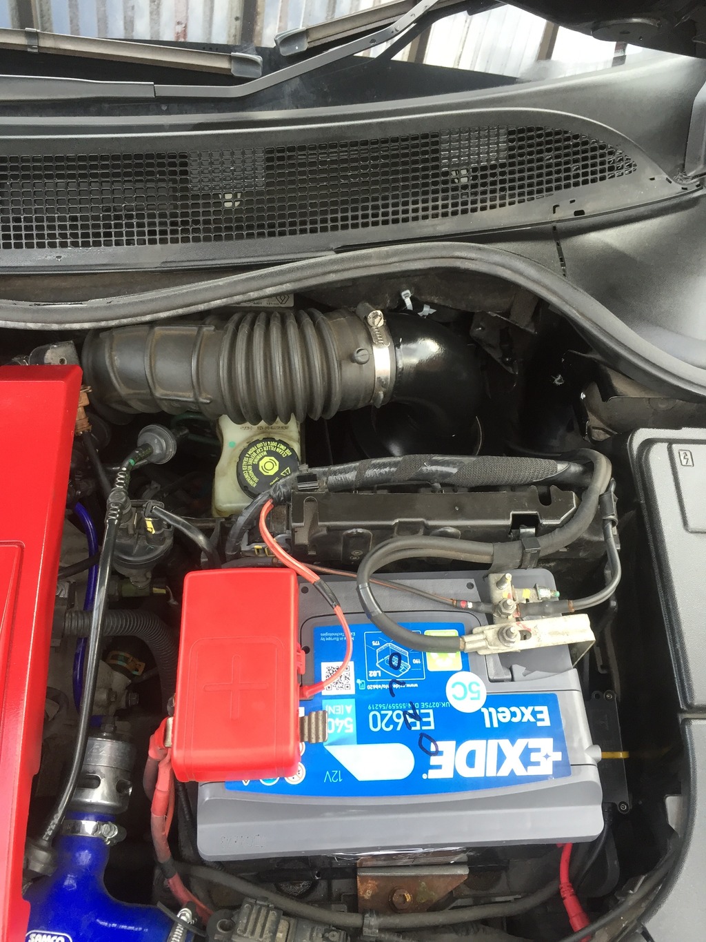

The first time in two years , it's let me down ! Luckily it was only the battery haha, I started it in the morning and thought it started turning over a little slow, so I priced up a battery and by the day's end it was completely dead , managed to jump the car and get it over to work, took a company car home , and then got the battery the next day, to be fair to it , the battery was still the original 8 year old one, so it doesn't really owe me a thing haha!
New excide one came, laughing as the parts supplier said he wouldn't bother pricing a cheap one because he knows what I'm like , I want quality not cheap lol , so £48 later it came 3 years warranty too

Also one thing I has noticed is since I had the rear windows tinted it has made it a lot harder to reverse the car , which was already very hard , it's not easy to park the car as the bumper sits out so far you can never tell how close you are to anything !

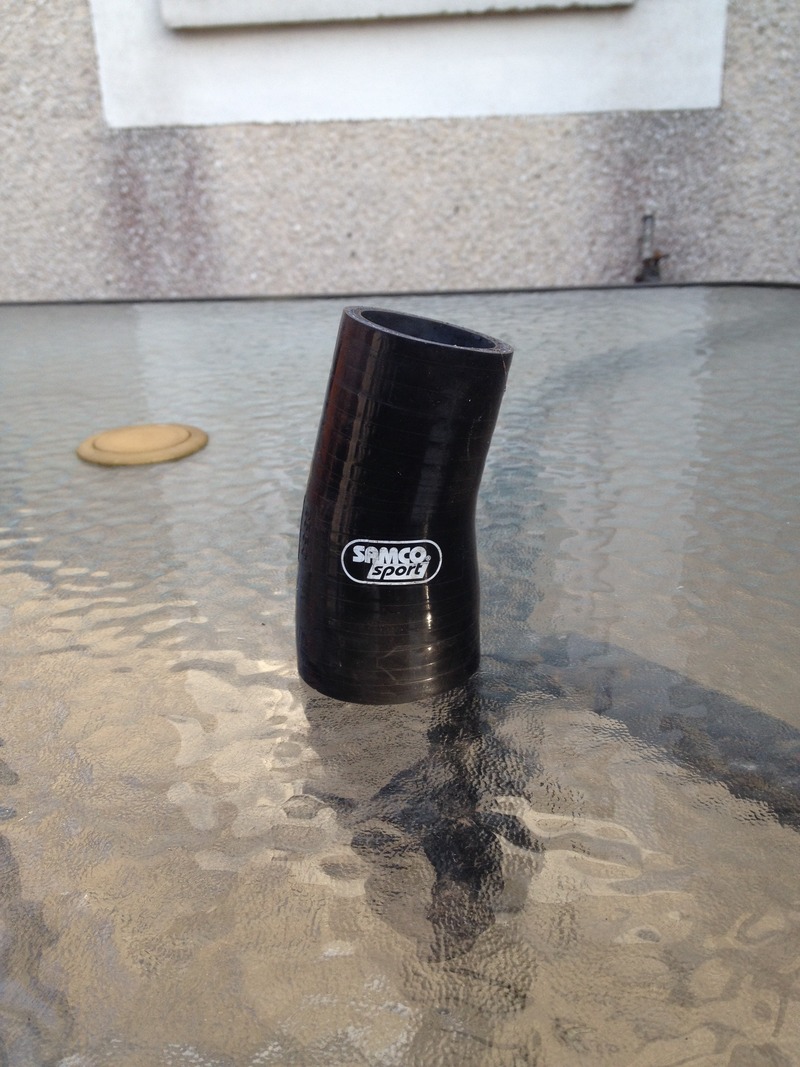

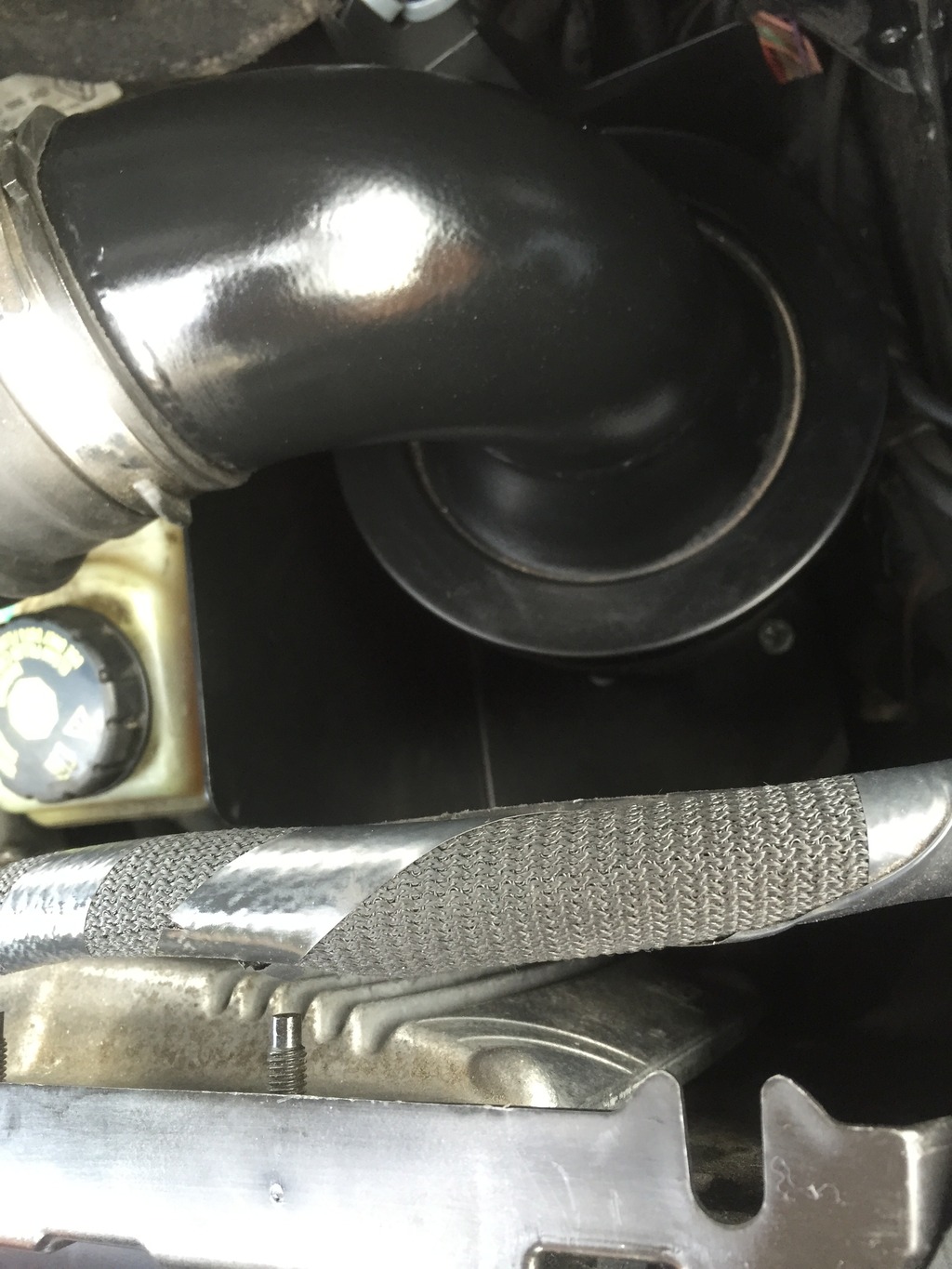

I've got a black samco pipe to replace the wee one on top of the engine, I kept it for the Laguna, saw it didn't fit and forgot about it! If you fancy it I'll take a pic and do it for a tenner posted.

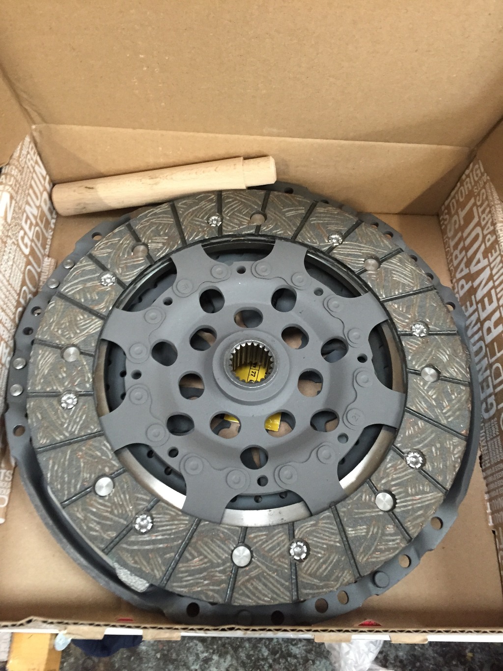

Luckily my R26R clutch has landed finally ,

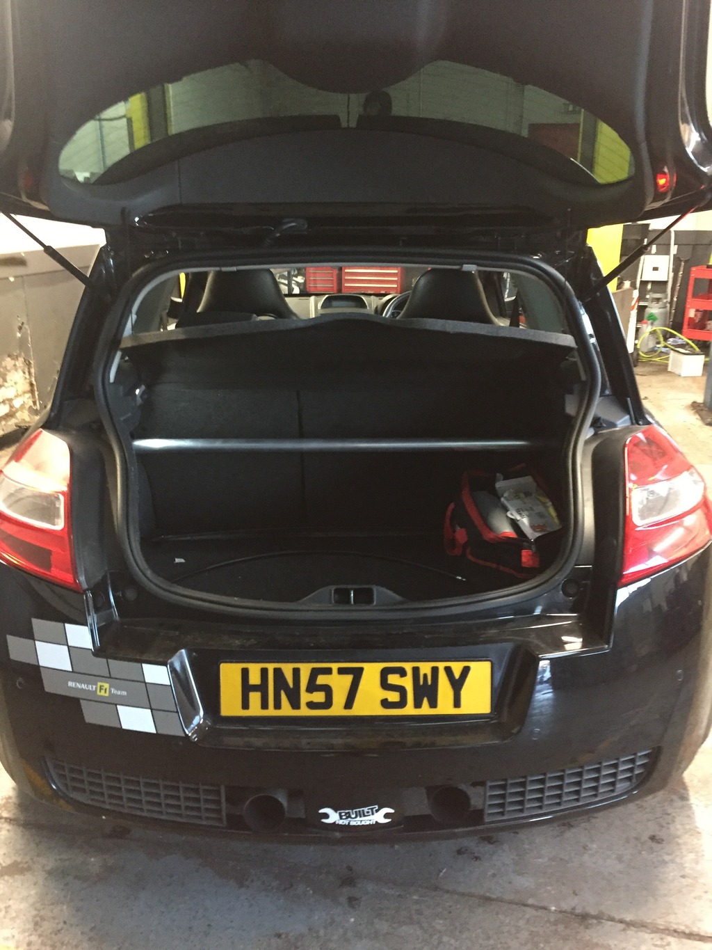

Also had a strut bar made for me by a good mate , great bit of kit !

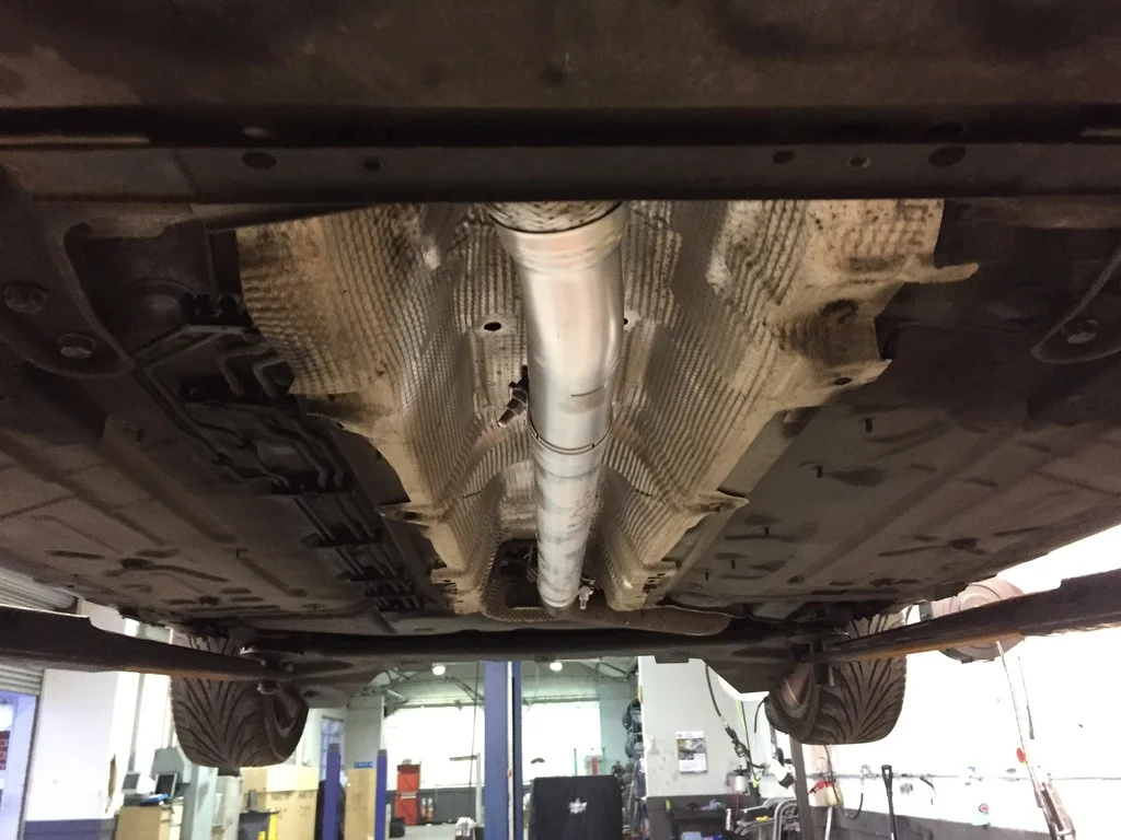

So far I've done the back box chop which sounds good. Not too loud.

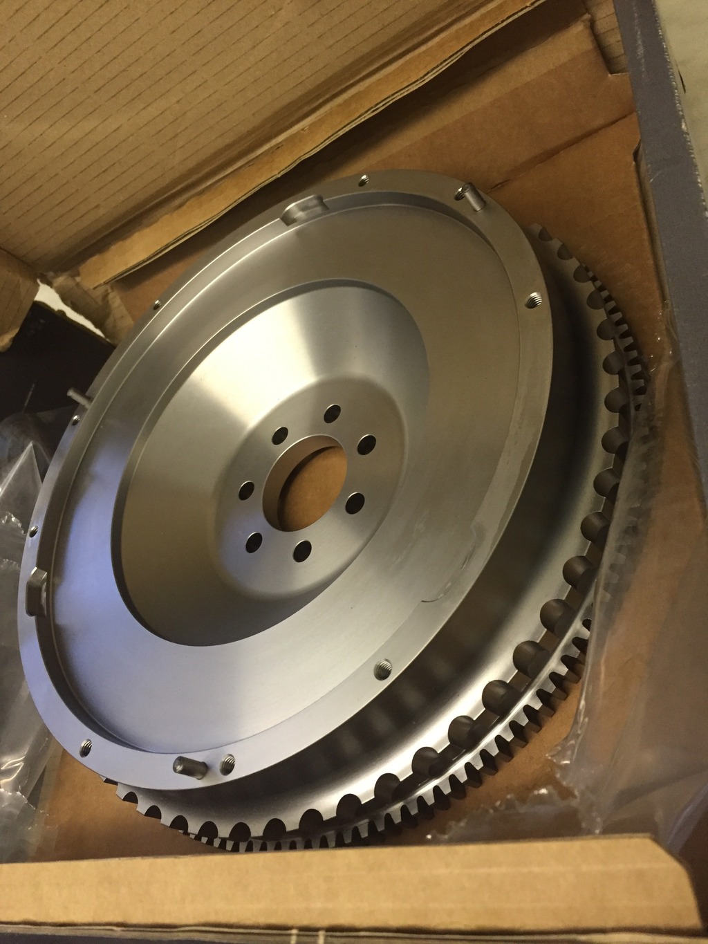

although one special delivery of pure engineering pornography has landed
My TTV Single mass R26R Clutch conversion flywheel :) just need decide if I'm stripping the box or letting someone else !!

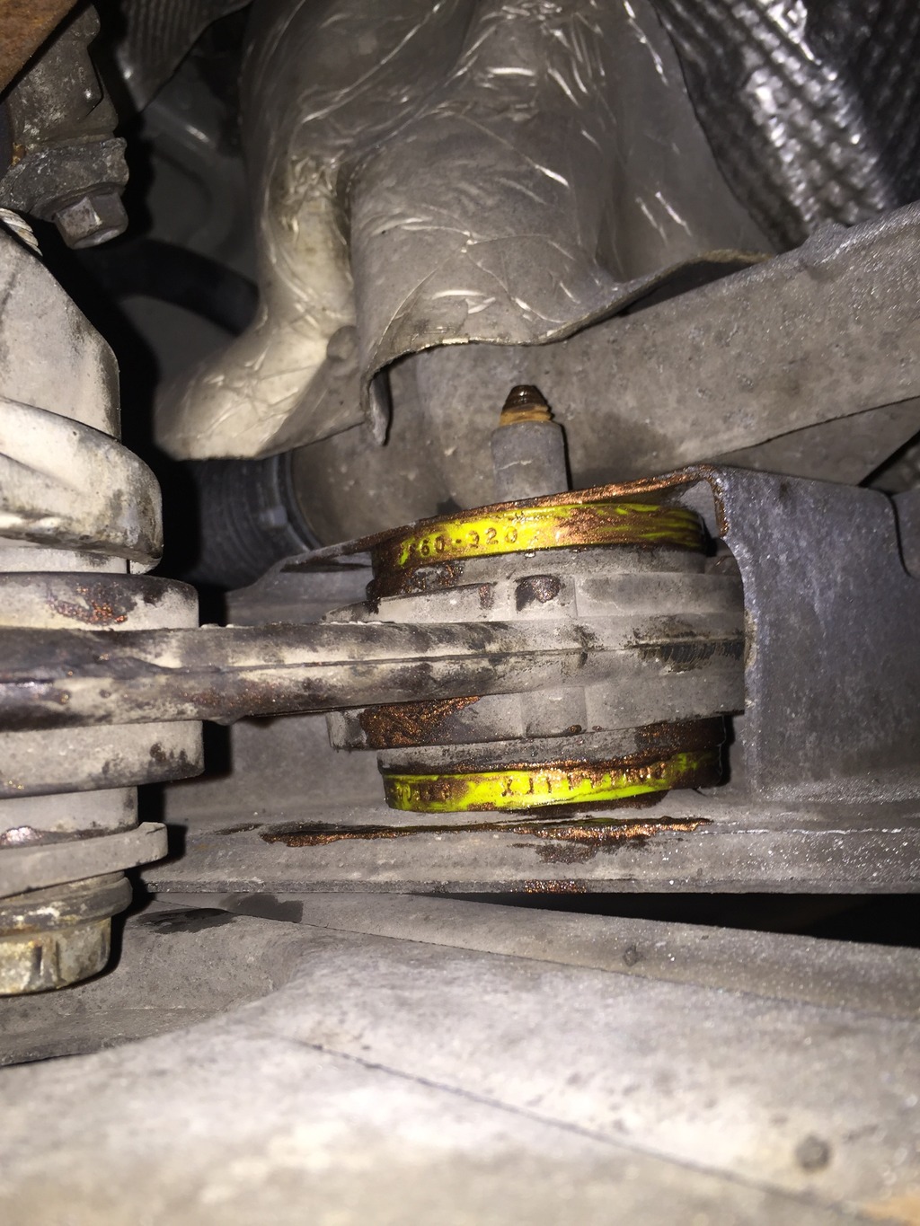

also bought a new set of rear exhaust mounts, and a NSF lower arm because the bush is starting to split slightly ! Can't wait to get this done now !!

Finally fitted the LED Front fog lights I've had about for a while

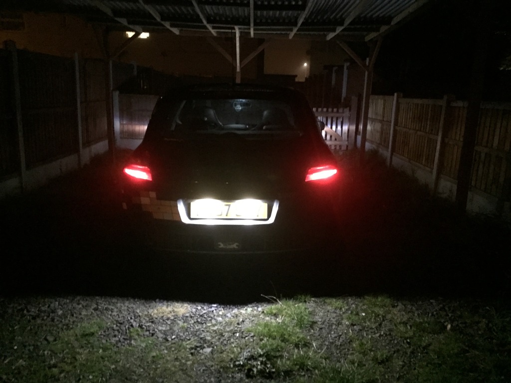

And while I was there I got a photo of the numberplate lamps haha

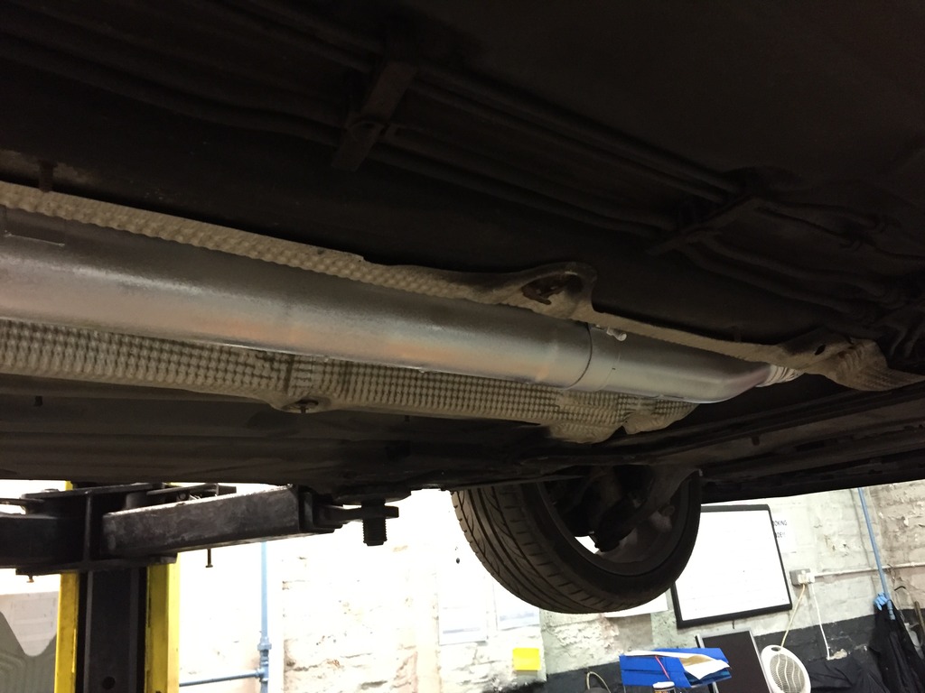

And while I was at it and the box is coming out I thought I may aswell

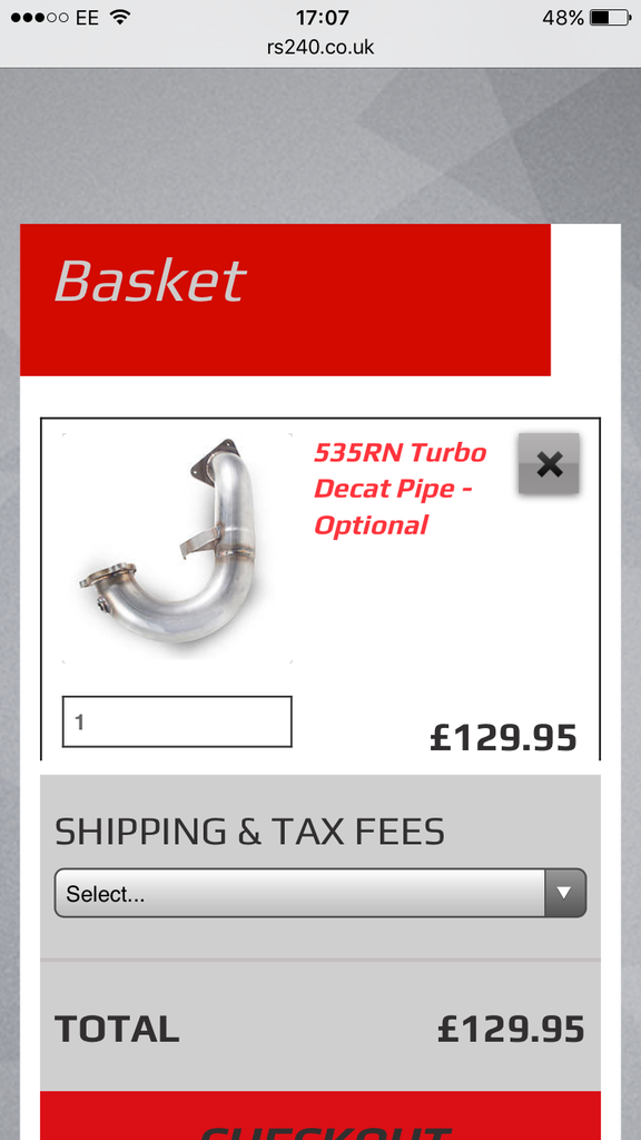

I've bought some Red heat wrap to wrap the decat before fitting
Once it's all done , it'll go for mapping in the new year ! Wooooo

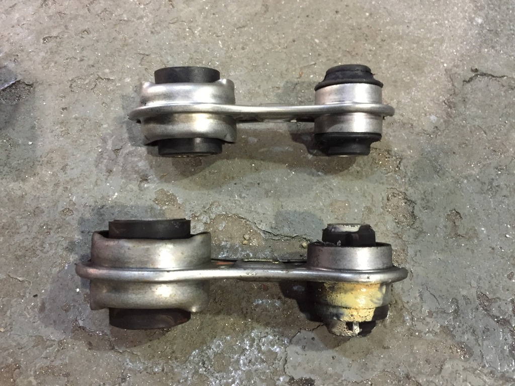

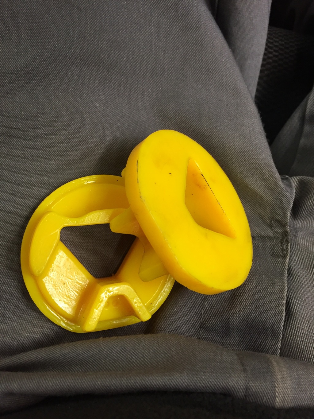

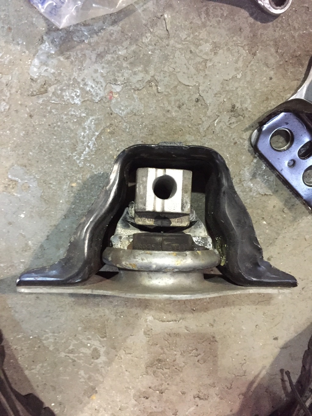

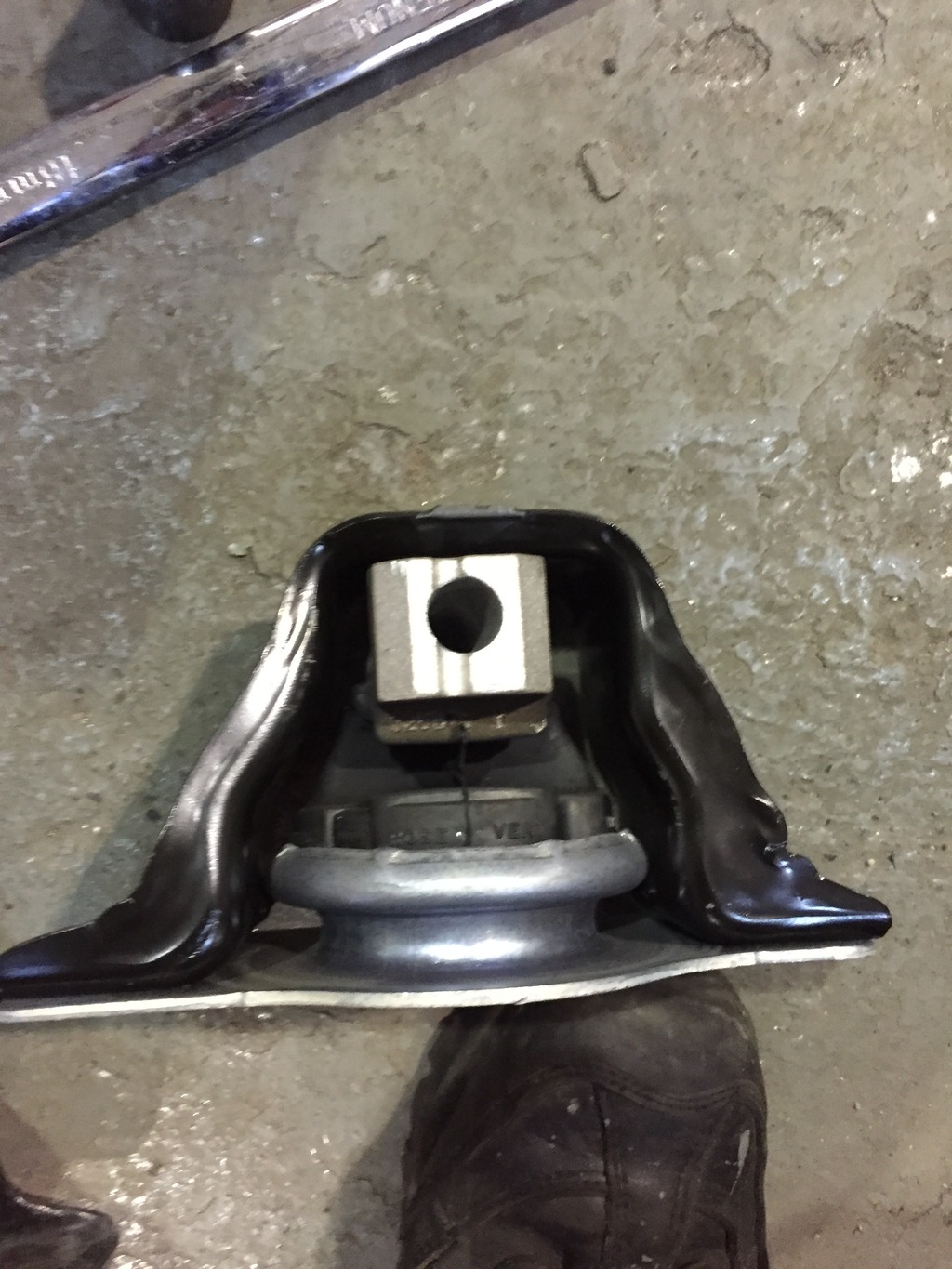

Meg has had some loving as per usual , had a new poly bushed rear swing mount insert to stop the knocking on the decat ! That seams to have cured the noise , which is a winner
Helped no end with the rocking of engine !

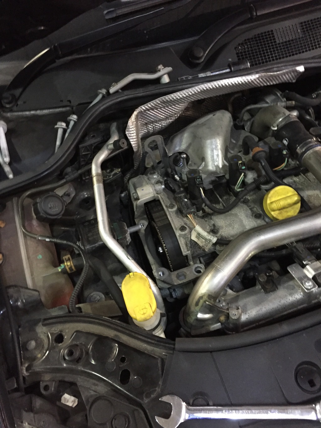

Also so had a slight noise on pull off which I just put down to being a characteristic of the vehicle , however as a matter of course I was replacing the engine mounts on the car and it turns out it was the top swing mount !
Also had a good check of the cambelt , not that it's due , but thought I might as well
all looks good and okay the car drives 10x better than before

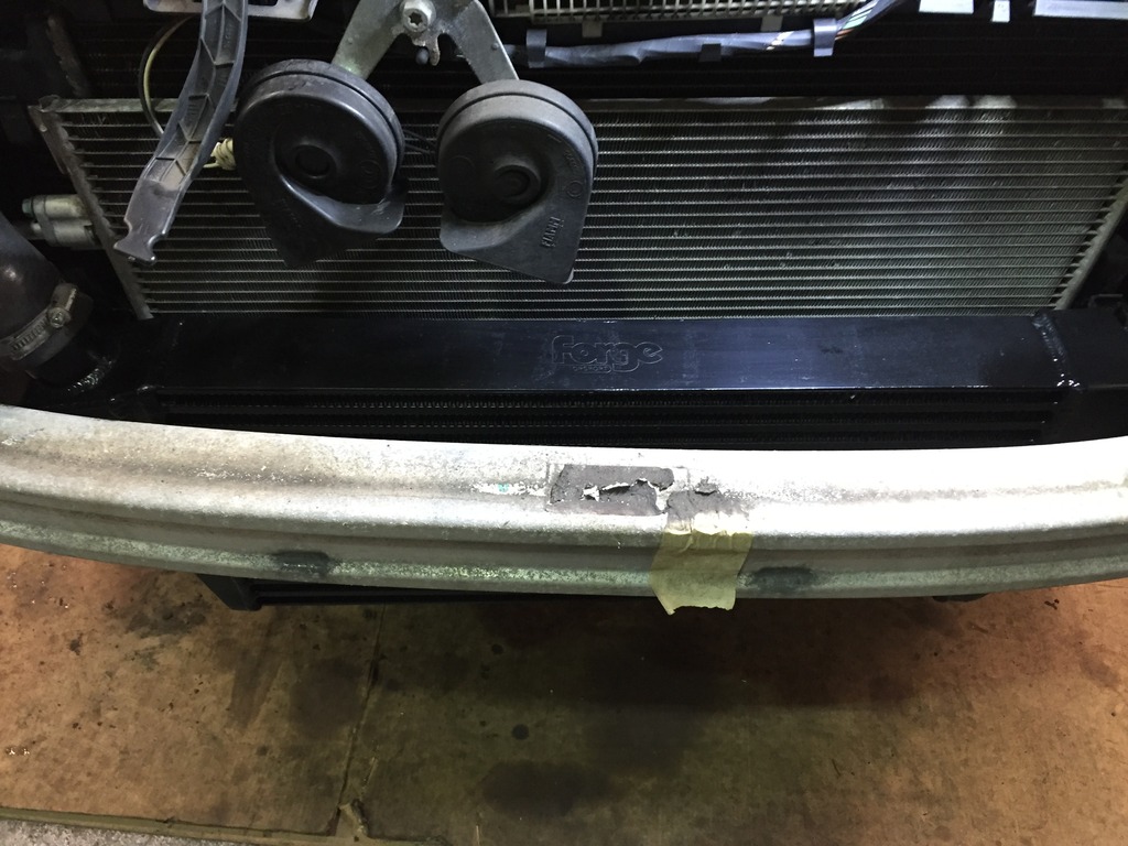

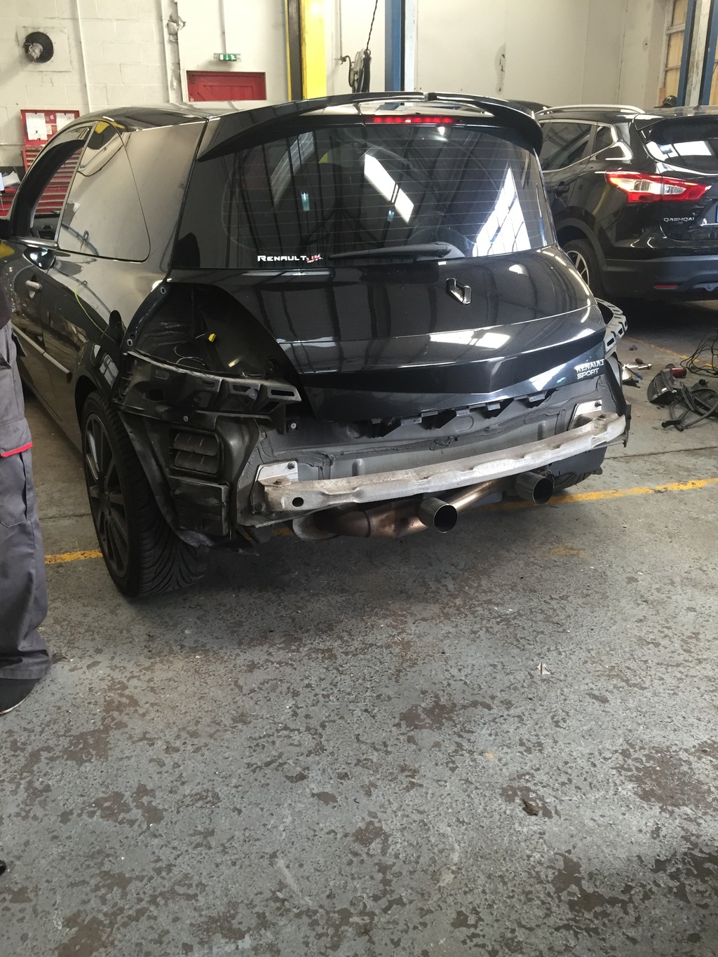

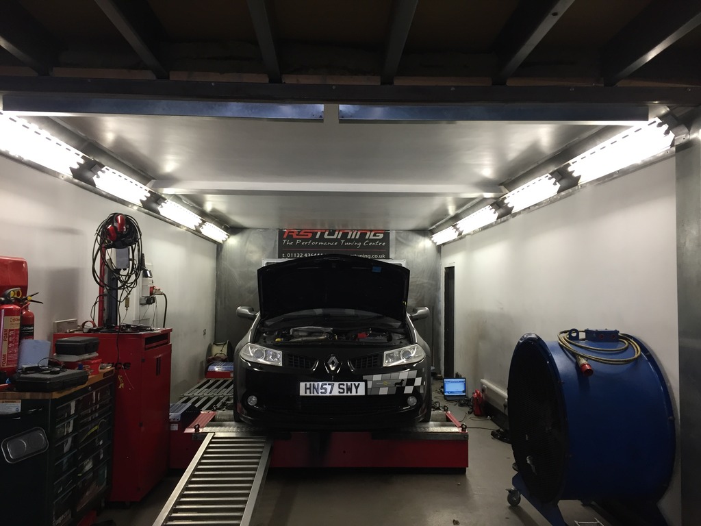

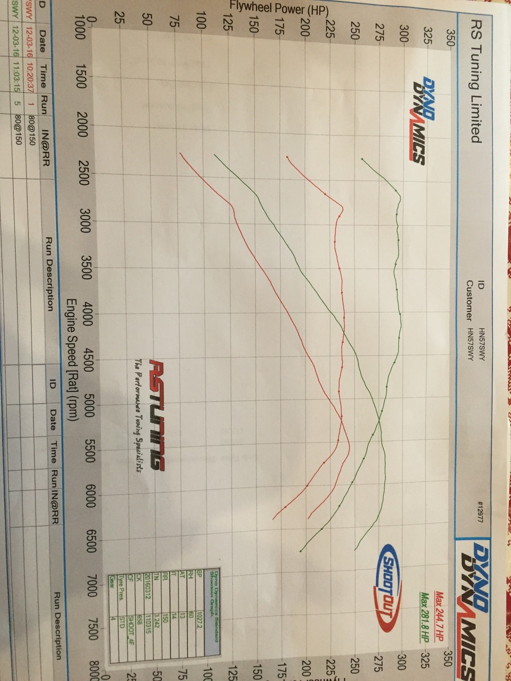

Decided to be a rebel and finally get the car booked into RStuning for a map , had a good chat with Paul over the phone , really nice and helpful bloke , advised me to remove the intercooler I had fitted, as it would restrict my power with my mods , and luckily I had a friend selling a damaged Forge intercooler , purchased that, sent it up to another mate who is an amazing alloy welder , couple of days later it was back and fitted , the thing is huge haha

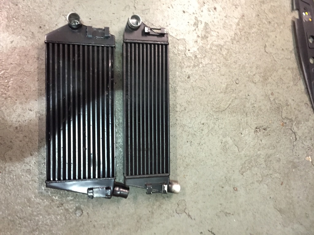

thats a comparison to my old Diranza intercooler which was slightly bigger than standard haha
on fitted and road tested all seamed great, also had some left over heat resistant paint from the decat and wrap so decided to paint the centre section , keeps the heat in and gives a fair few pops and burbles and the odd flame now
Then a trip to Leeds to see Paul !
Made a really good base figure of 244bhp ,
Set of 630cc injectors that were flow matched fitted and a map on , car made 282bhp and a good capped 300ft of torque
Cant say how much difference there has been it's like an animal , pulls so hard so much better , genuinely over the moon with the car !

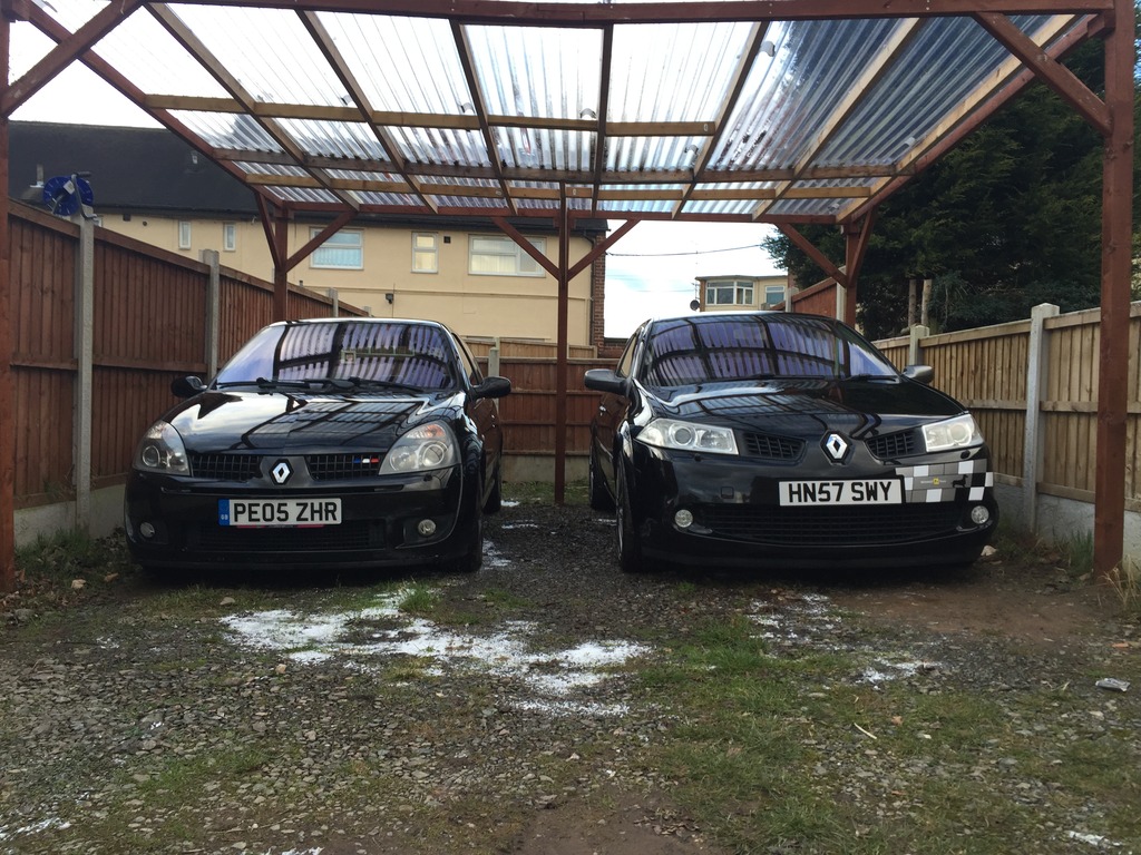

Really happy with the megane now , going to get the bumpers repainted , and I've got a set of new bumper decals front and rear to go on , then I'll hopefully be done haha
And I can start enjoying it and plying with the Clio , until something else comes up with the megane I want haha

Knew the intercooler you had wasnt the right size.
Forge one is great.
You had r26r clutch done aswell so no worries there.
Absolute beast now mate enjoy hehe
Cheers mate ! It's really starting to get there haha, I knew the intercooler would hold it up slightly but when I bought it, 270bhp was plenty haha got a little carried away in the end !
