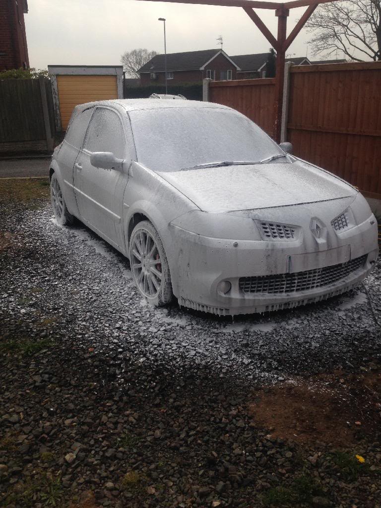

Bored waiting for it so I took a photo of the megane snowfoamed , hopefully by the end of today it'll be nice and clean :)

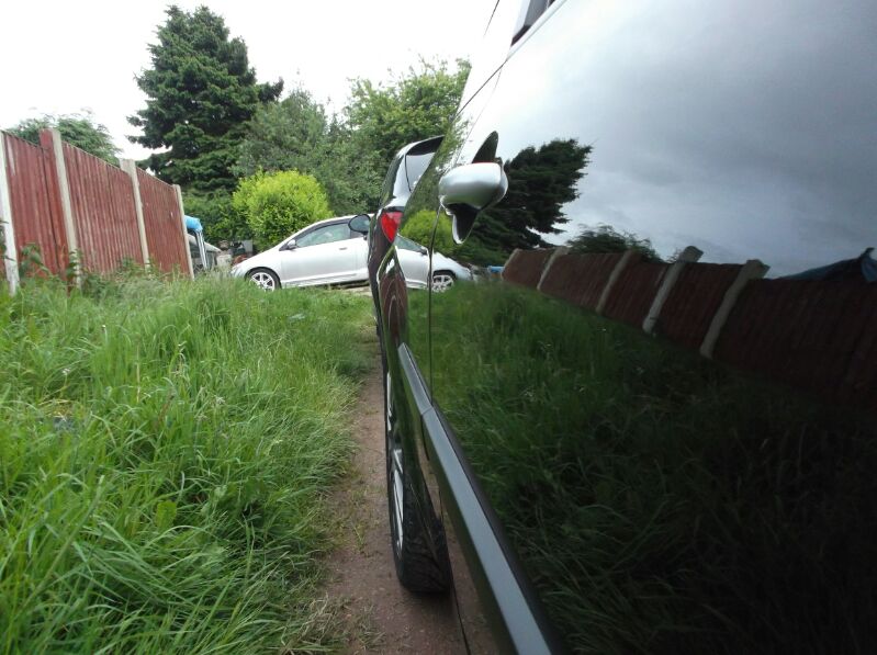

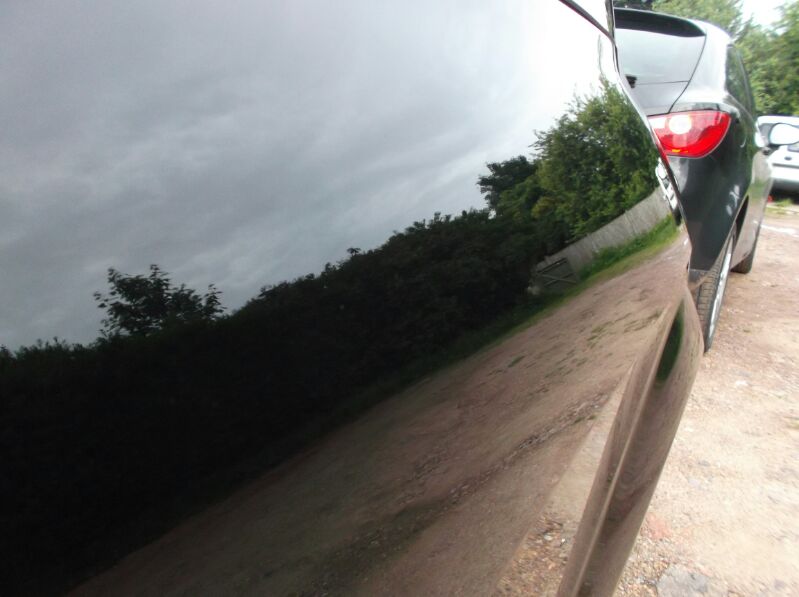

Well i finally got round to cleaning the megane , its been minging for a while
I snow foamed as seen before, Clay barred the car never had one so bad as this lol , and then used the Autobrite Hellshine Abyss paste sealant
Ive had the Abyss for a while i was going to use it on the clio but when i decided to sell it i thought i will wait, very keen to use it after seeing the results, and i have to admit , its awesome , applied very thin , but after its cured , and buffed off the shine it leaves is amazing , and the water will only bead or sheet off !
Also spent some time conditioning the leather and door cars as they werent very clean !
Happy with the results heres some photos

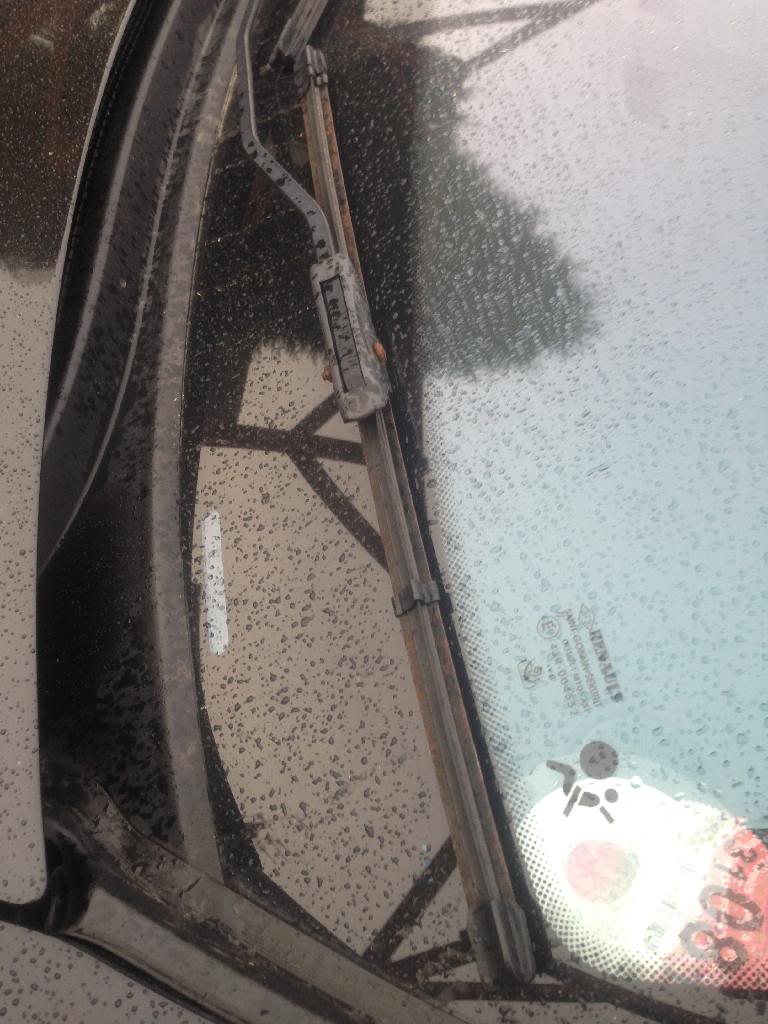

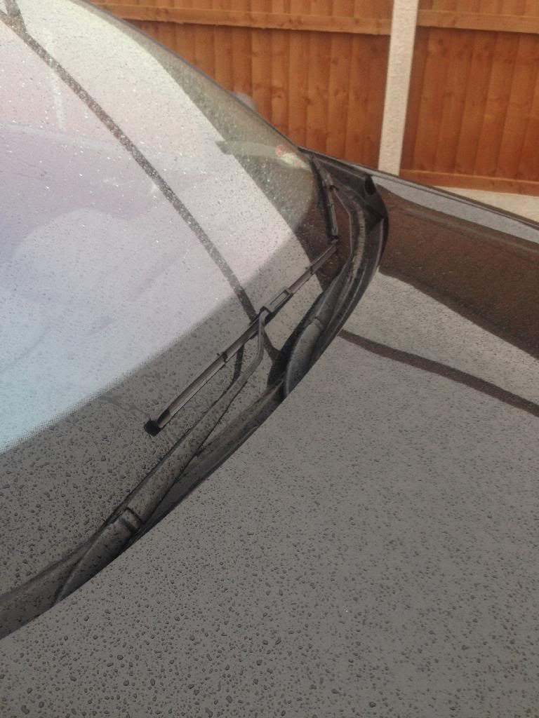

Another item turned up today, the wiperblades have been driving me mental, they have gone dry and hard, everytime they were on they screeched and drove me mental!
Also the paint had come off the the mental was rotten simple things but needed doing
Before
After
little things make the driving experience better :)

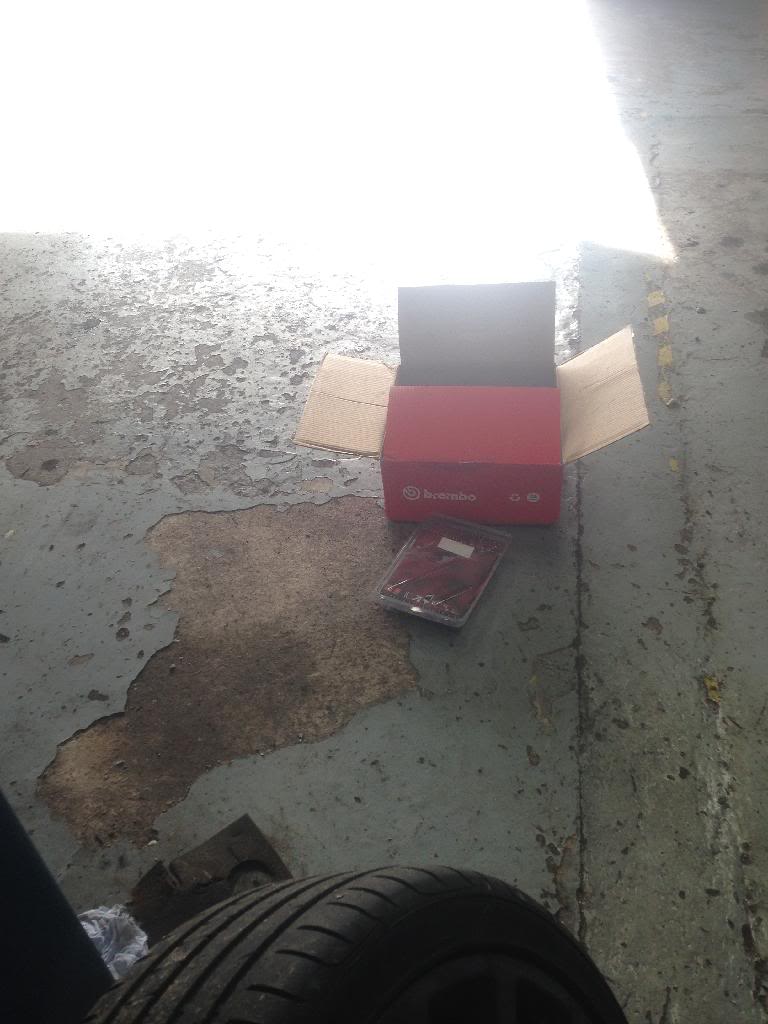

Another thing on the list of to do , front brakes , quite desperately as well, spoke to G172 and after much deliberation, think im going to order a set of Brembo High Carbon Discs and a set of Mintex M1144 Pads
Also spoke to the bloke who made the braided lines for the clio , hes going to try get a set made for the Megane too so i can fit all that lot in one go ! fun fun :D

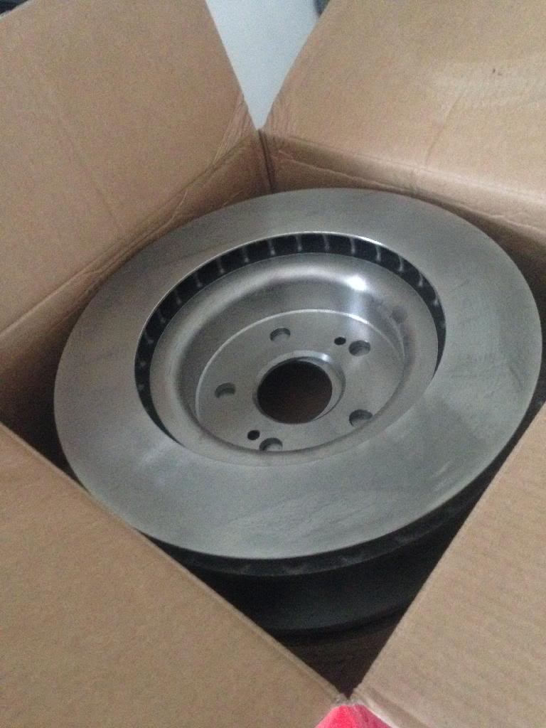

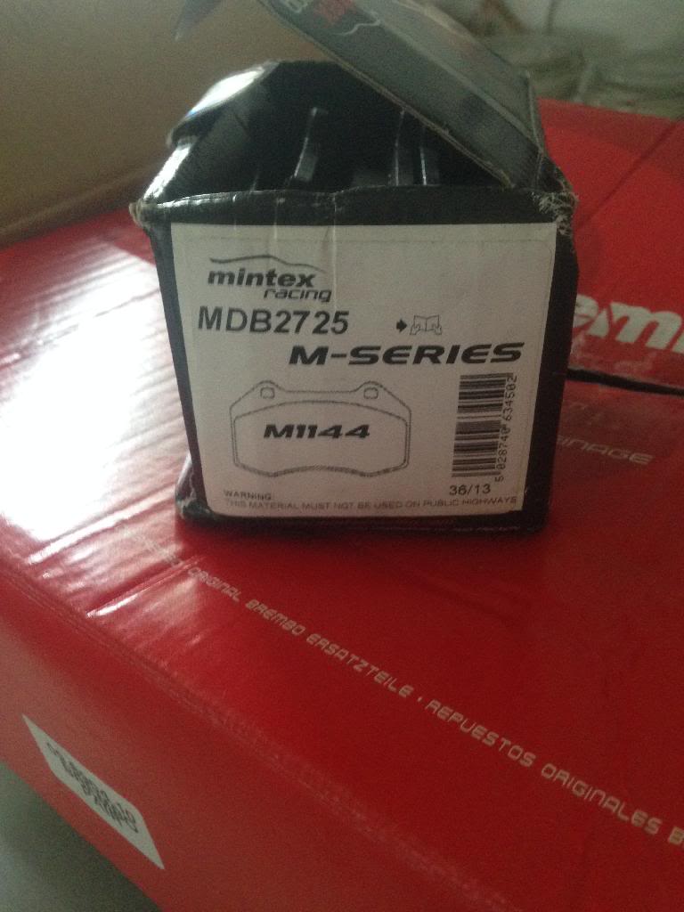

Spoken to G172 , have managed to get a set of Brembo HC discs and Mintex M1144 brake pads ordered this afternoon !
Also spoke to my friend who has confirmed he can make me a set of Braided brake hoses, I had my last set of him and they were awesome, he's also managed to make them in red to match the Brembos :)
All landing soon so will take photos as and when :)

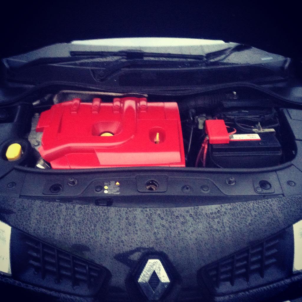

Yesterday was spent advising my friend on spraying bits on his type R, he had some extra milano Red , so I thought I'd do the meganes engine cover,
i arent finished yet, in going to spray the raised up bits gloss black and get some decals but this was it placed on yesterday !

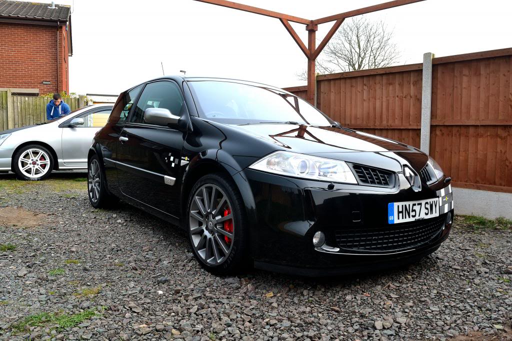

Nice car this, I want one next for sure. I was actually thinking of R26.R or a Clio V6 as they are a little bit special and loose no money!
P.s - Whilst the brakes are off, clean them thoroughly and then paint the centre bits and the edges (where the pad won't touch) neatly with some gloss black Hammerite. Allow plenty of days (plus oven) to let it go hard, and when fitting apply some Pagid Cera tec (or copper slip, I just hate the colour lol) onto the wheel spigots and the part on your painted surface to ensure the wheel won't stick!
Anal I know, but for me there is nothing worse than looking through the spokes of a wheel to see corroded brake hubs - drives me nuts!
Haha no anal at all mate , if you have chance have a look through my previous 182 build , I'm pretty similar , mechanic by trade too, so I am pretty similar ;)
both V6 and R26R are great rare cars ! Don't think you'll go wrong with either 2bh !
Car looks superb. I've had the 172 3 weeks and I already know I'm going to have to have a black R26 next. FML.
Thank you mate ! How you finding the 172? I miss my Clio badly , it was so much fun to drive ! Megane is still pretty awesome though , the grip baffles me !

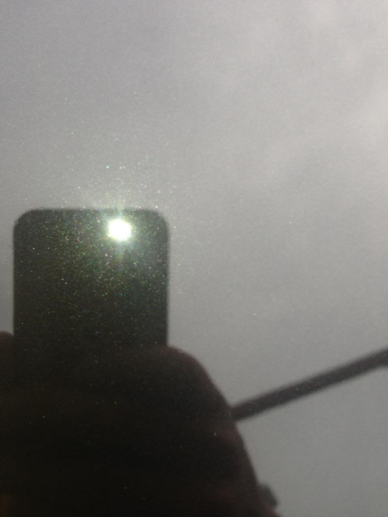

Few things have happened with the car :) I've finally bought a DA polisher so had a little play with that but between family's cars needing repairs etc I've not had much time for the megane :(
few photos , had a play on the bonnet, came up really well !
great machine and great products , I've only used the enrich, as the restore compounds a little corse on renaults soft paint, and I haven't had time use the final but looking forward to having some time and nice weather :D

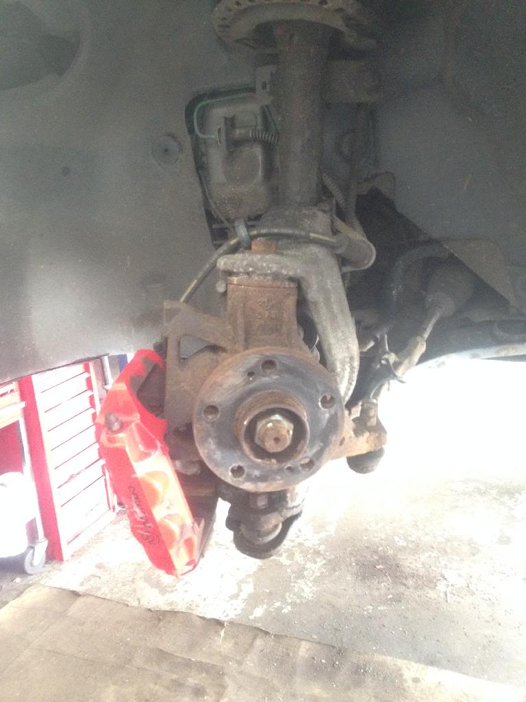

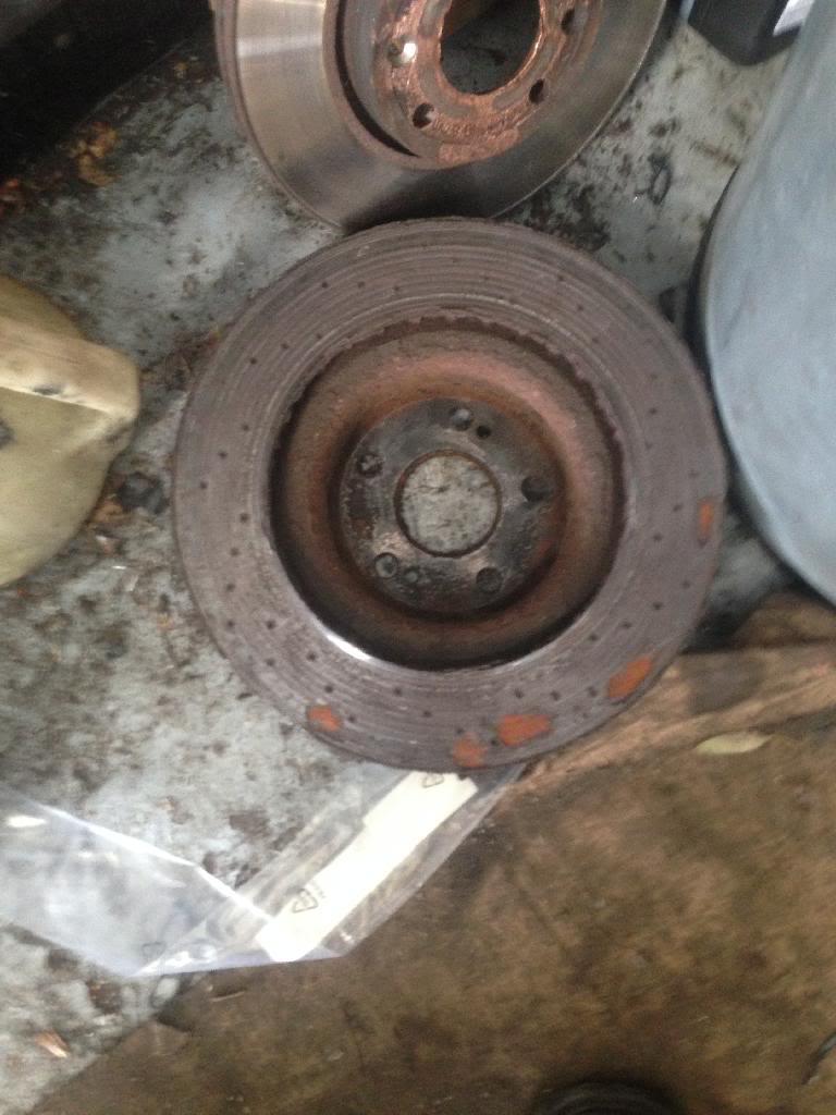

Also finally fitted the front discs and pads , loads happier with it although came across quite a few complications
As you can see they were very due lol, but when replacing the NS disc, I noticed that the lower hub bearing bolt was loose , this concerned me a lot, and I tightened it up, and found that the steering became very heavy , the lower bearing is fooked :@ another thing to fix :@
At this point teddys came out the pram a lot , but have since spoke to a bloke over on megane sport , he's going to replace the bearing for me rather than replacement hubs as everyone says it needs , (£230+ vat) he's going to do them for £80 a side , he's going check the drivers side and if it needs that, then he will do that too! Top bloke :)

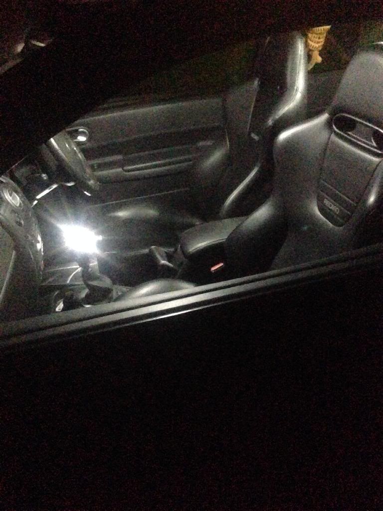

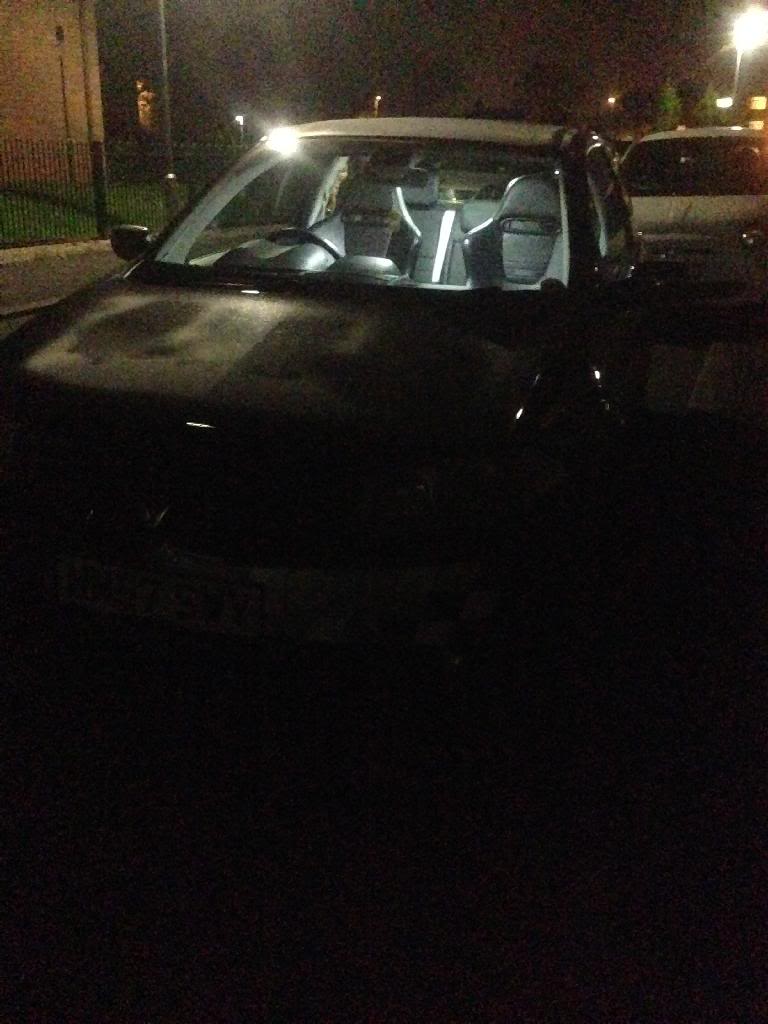

Also did a full LED upgrade on the interior , 13 501 bulbs later :O
Not the greatest pictures but gives you a idea, they are awesome, did both upper lights , did the puddle lamps , number plate bulbs (and lamps replaced with new lamps) boot and glove box

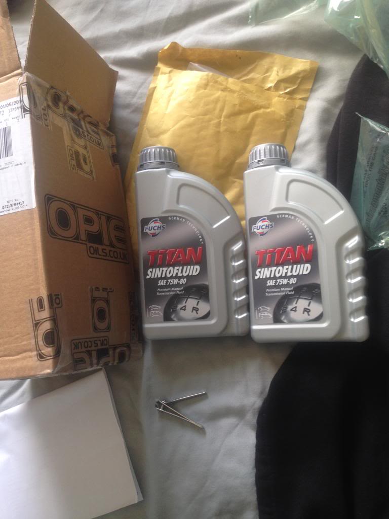

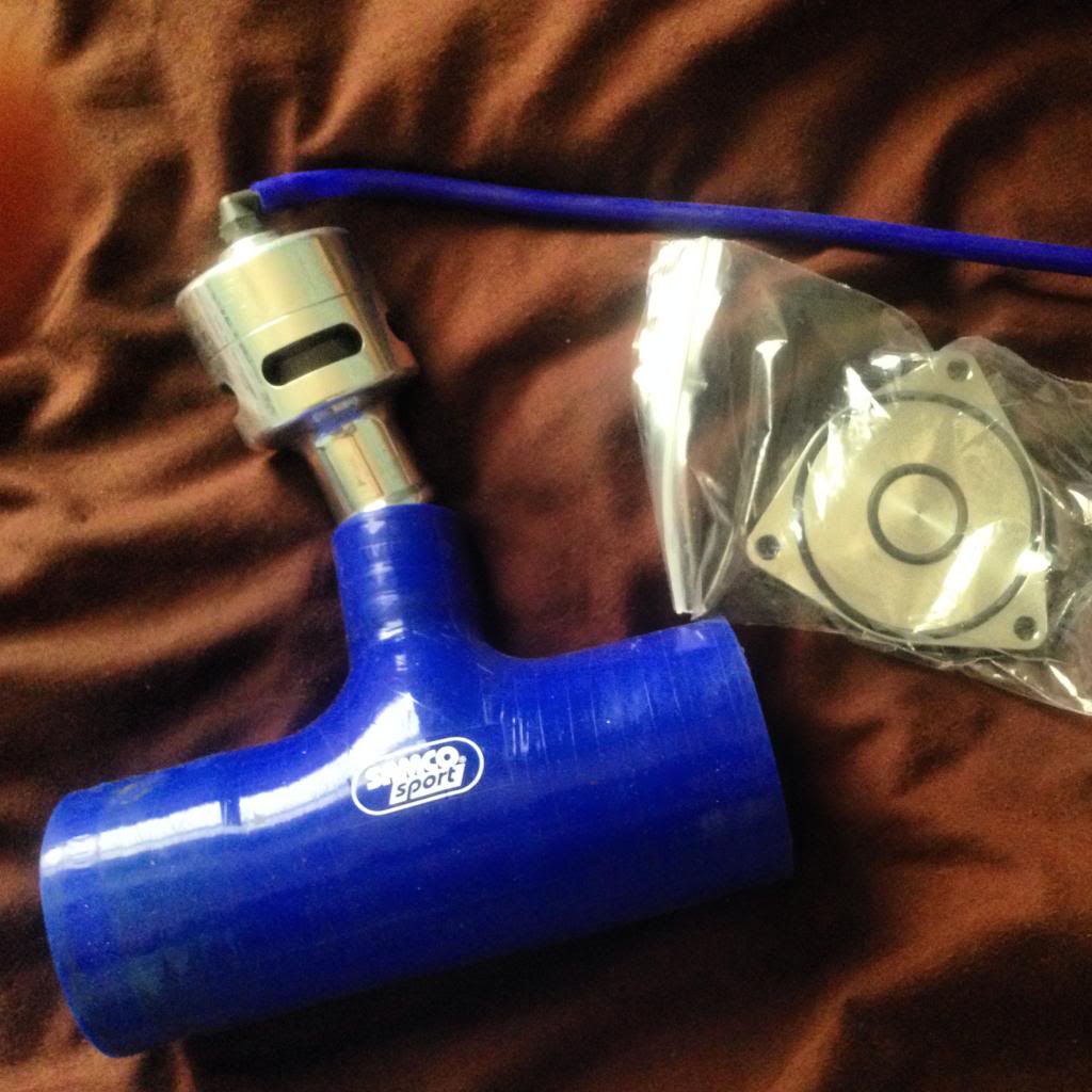

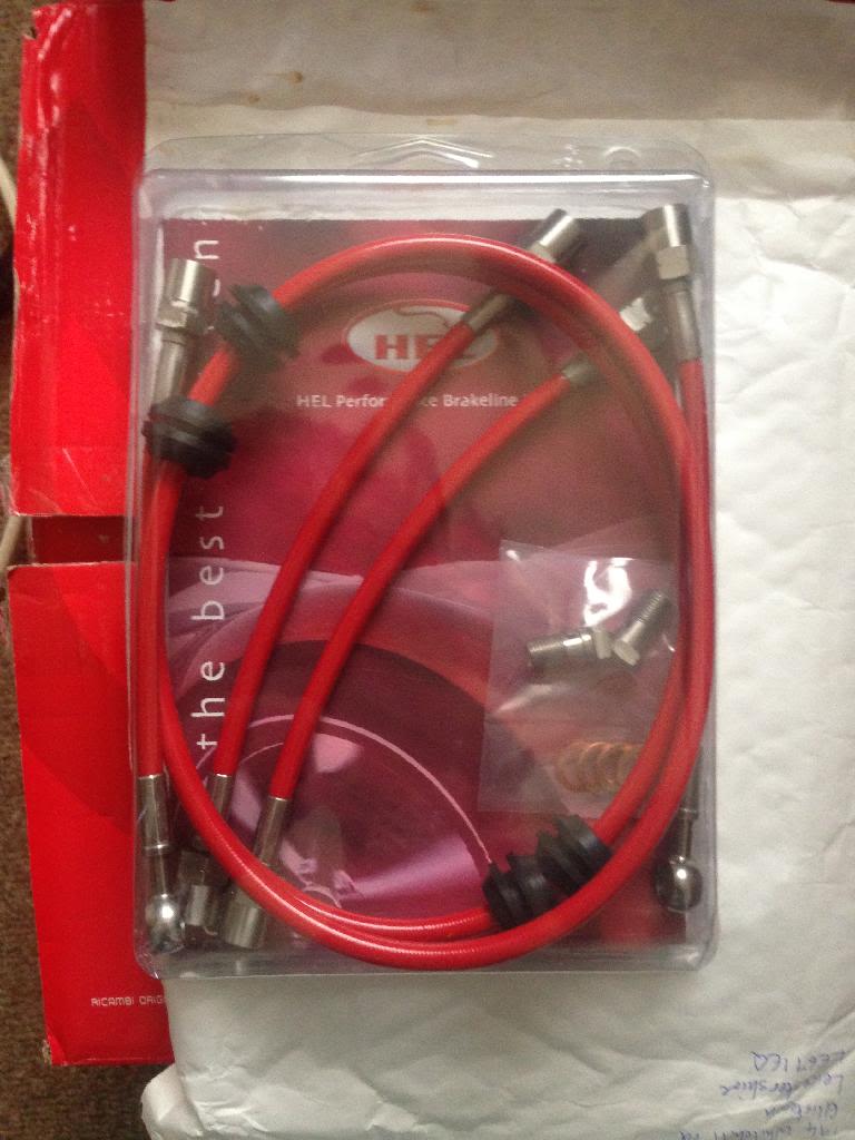

I've not got around to fitting the braided lines , and I've ordered some Titan sintofluid oil for the box

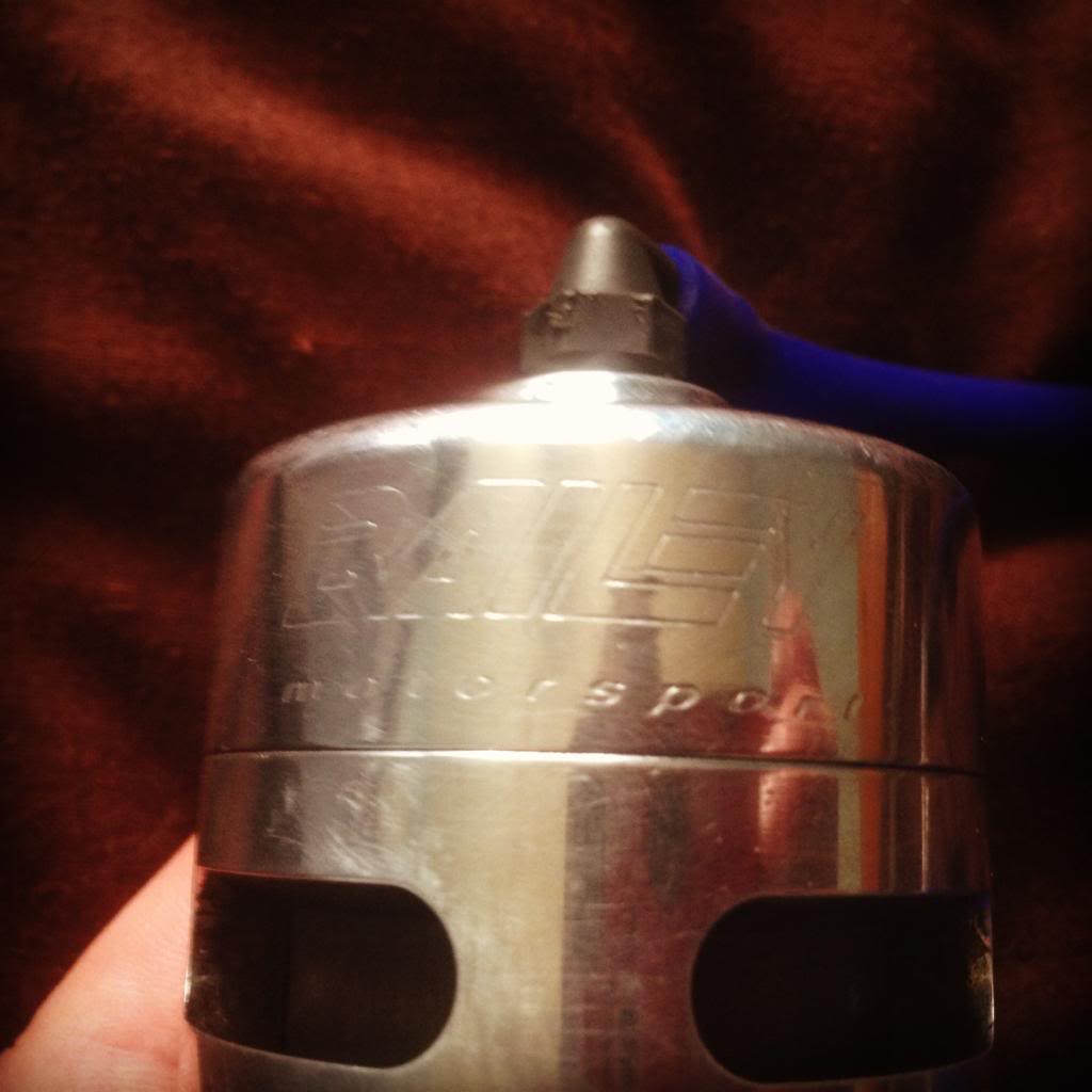

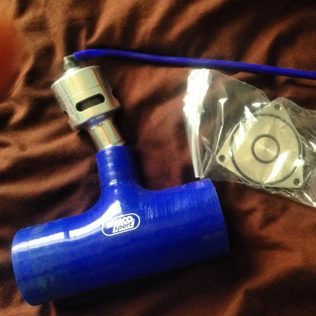

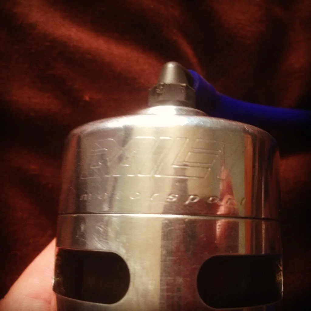

So need to get the lines on , oil in, and I've also dropped on a Baileys recirc dump valve :) full kit inc blanking plate etc £40! Over the moon so that'll be here this week :)

I've had my new package delivered big thanks to Eggcakes, my dump valve has come :)
Cant wait to get it on now :)

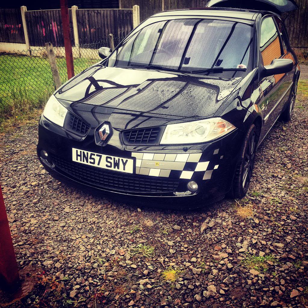

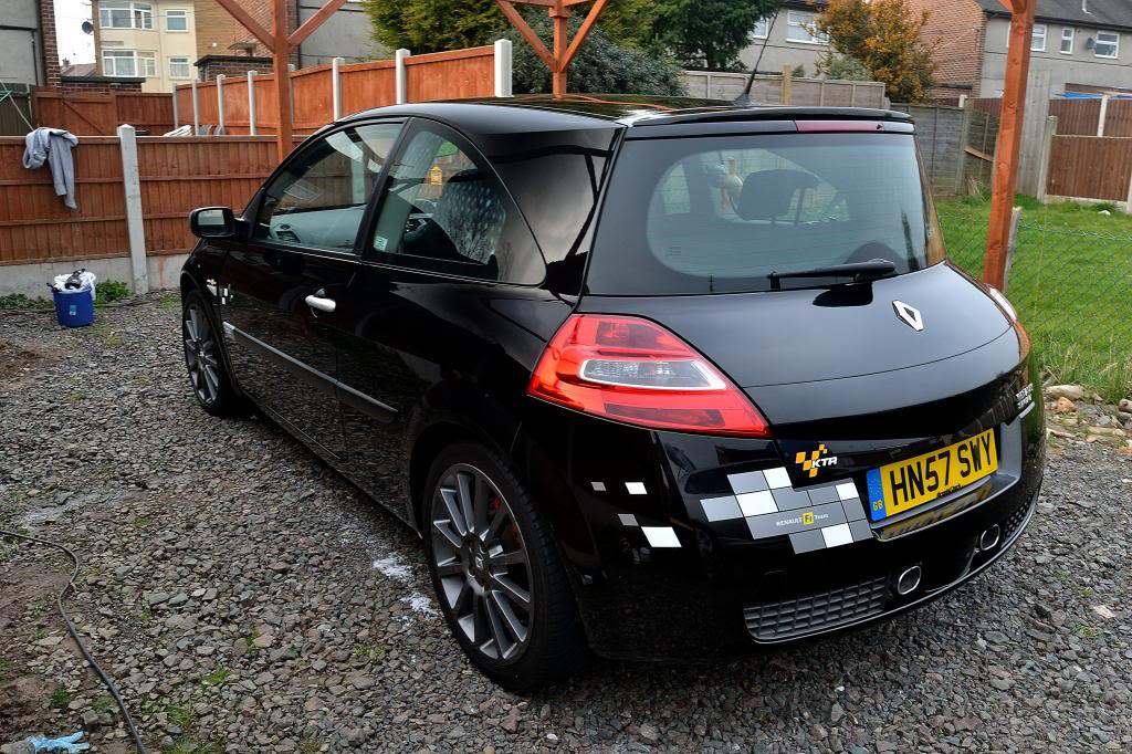

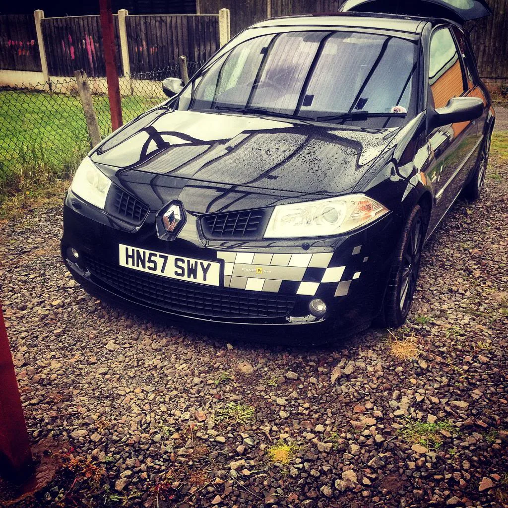

although I have been doing some small alterations , now I know it's not to everyone's taste but it's my car and I like them lol

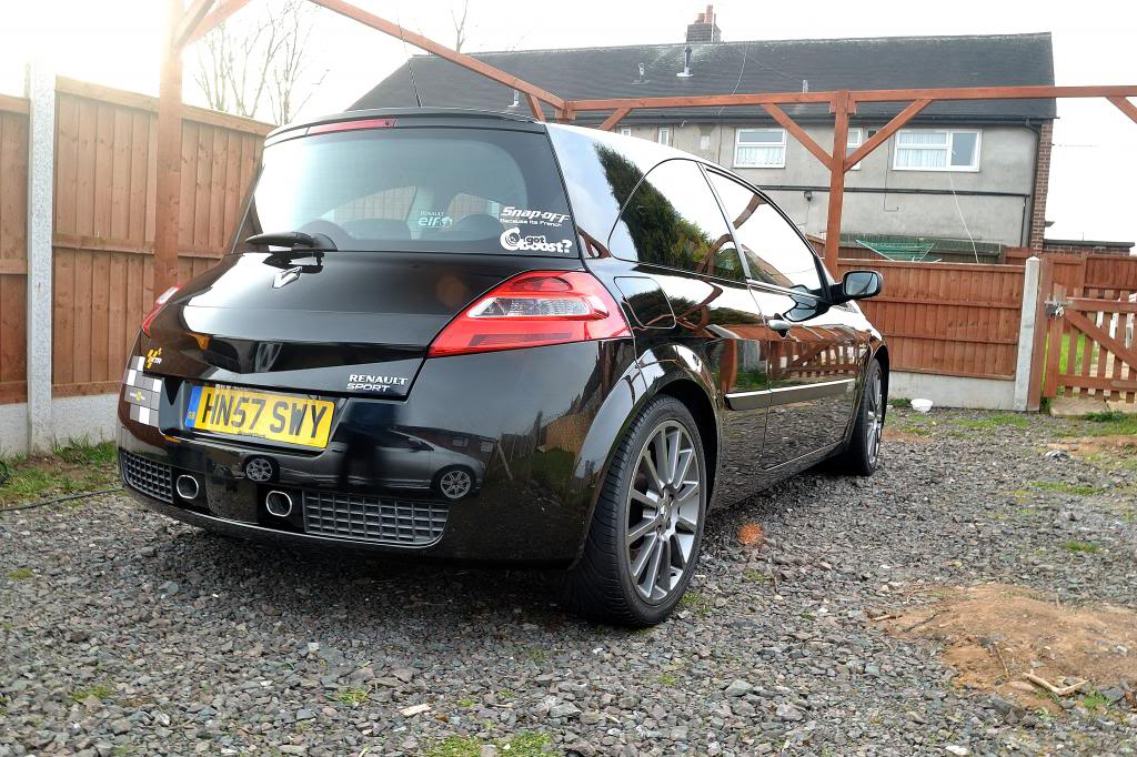

First off some pressed plates , I had horrible Arnold Clark plates on mine and I sure as hell ain't advertising them haha
before
and after
lookes a lot cleaner in my opinion !
Also took off a few stickers and added a few again not to everyone's taste I know
Getting there with it now, unfortunately a lot of my time has been dedicated to my missus' new Mini Cooper S so this hasn't been spoilt! Starting to get better with the paint , the reflection is getting better , I have to redo the boot and bumper as they are the worst , once they are done I'll be happier haha
some of the sides now I've attacked them
itll get there in the end :)

the dump valve and blanking plate are on , braided lines on , brakes stripped and cleaned , front disc hubs painted black and fitted my new injectors !
Have to say , the injectors have made a huge difference, runs 100x better and cured my misfire that I got every once in a while ! Also i seam to be averaging 25mpg instead of 19! Although this could be the long trip I did I'll keep my eyes on that
Had a few issues with the lines , they fitted fine but just struggling get all the air out , bled it for the third time today and it's loads better , but I'm going to use a pressure bleeder Saturday try push the last bits if air out !
Dump valve is obviously noticeable but not over the top which is nice :)
