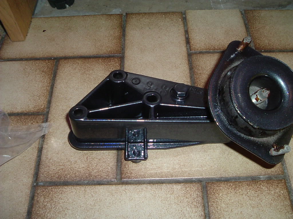

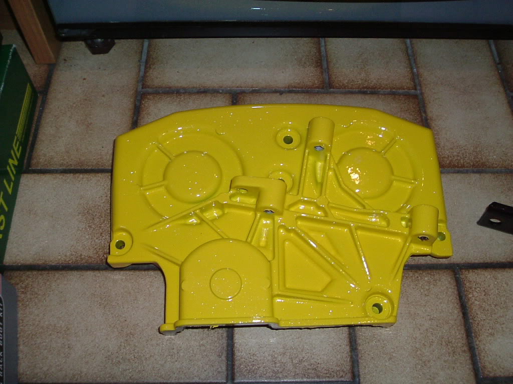

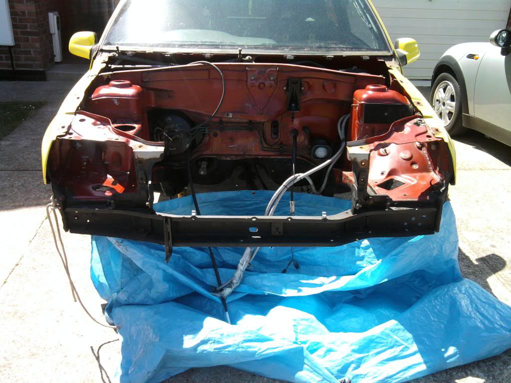

hi all im new to this forum, been on williamsclio for years. i decided to start a project blog on here as well, right i picked up the shell of the nana hybrid from warrington back in june 2010, since then it has undergone further fettling, tinkering and plenty of money thrown at it. The plan is to get it to a similar spec to what it was and then improve on it from there. so far ive managed to do the following:-

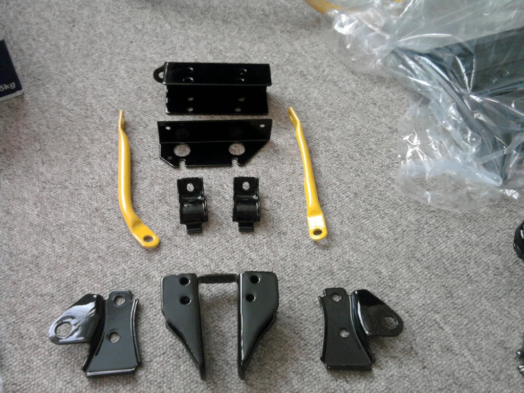

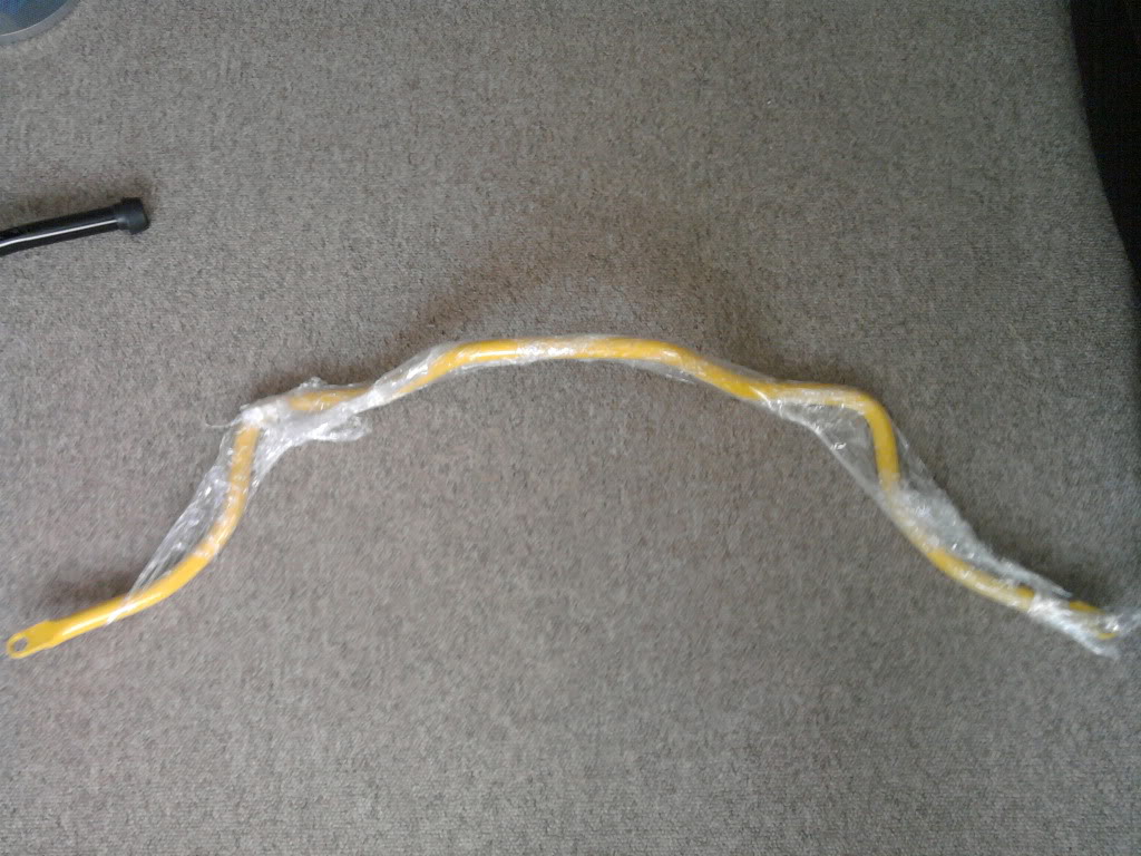

Powdercoat all subframe, anti roll bar, wishbones, cam cover, thermostat housing, rocker cover, sub frame support bars.

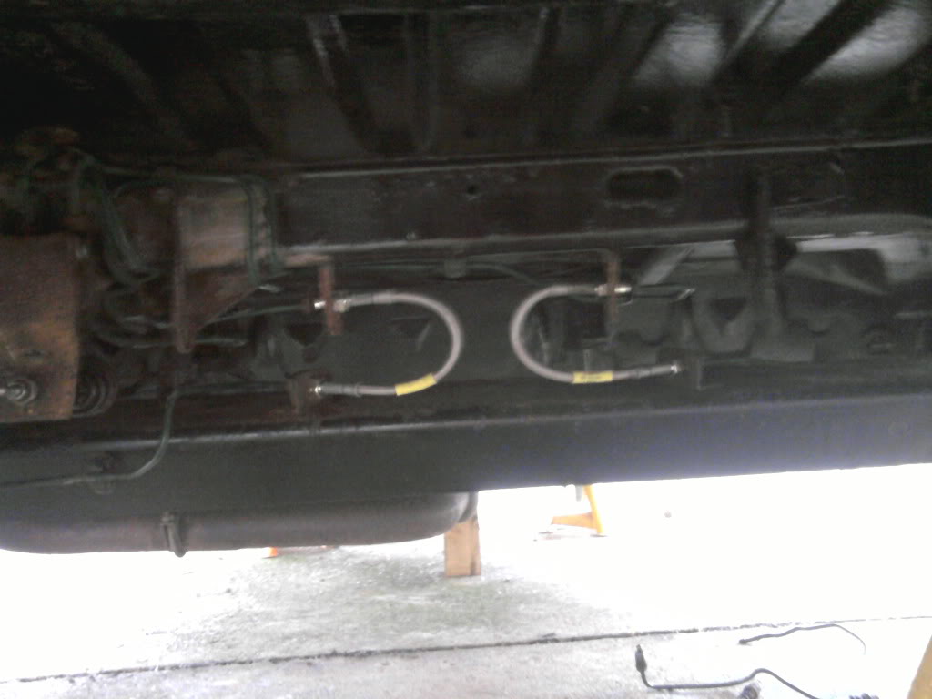

Goodridge braided brake lines and refurbish calipers,

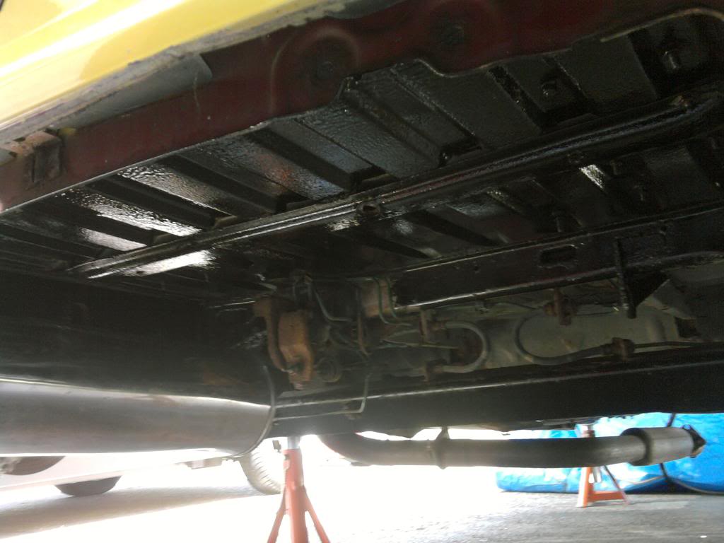

Undercoat the rest of the underside of the shell,

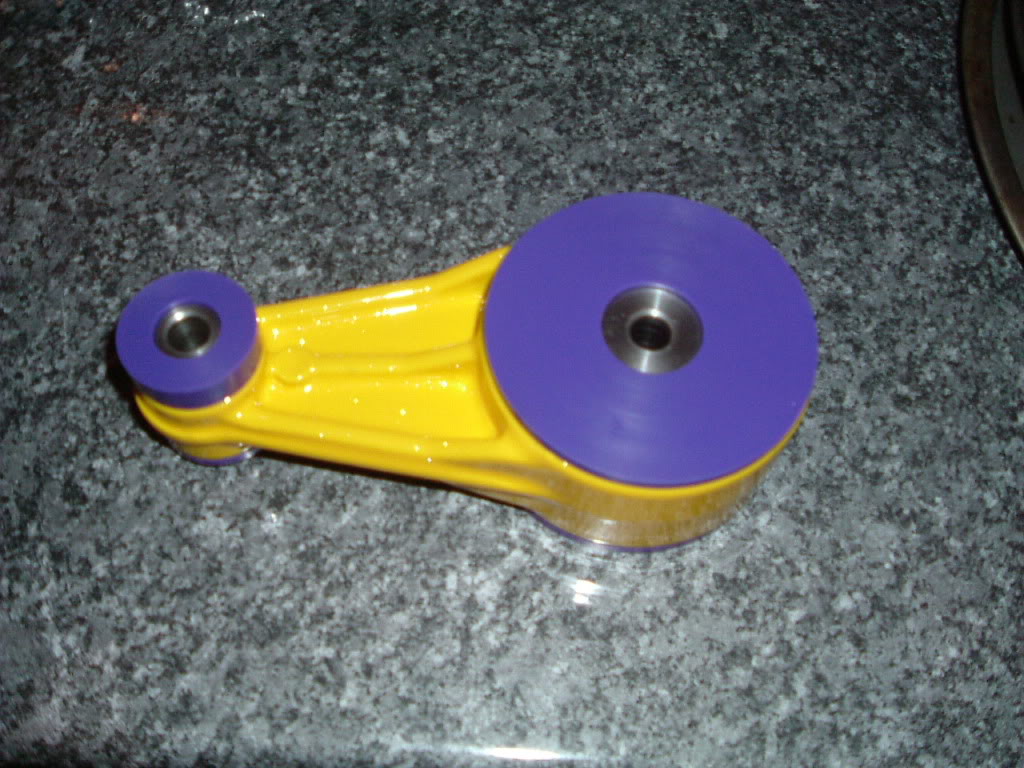

Polybushed the complete from end inc rear dogbone mount,
Manual steering rack and column,
Tidied up wiring to fuel pumps,
Relocated boot release solinoid.
Will post pics up later

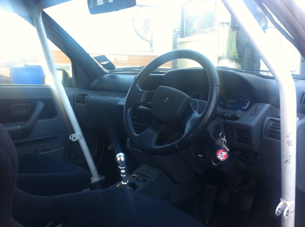

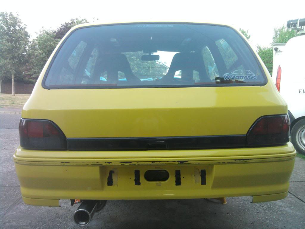

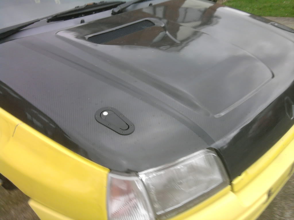

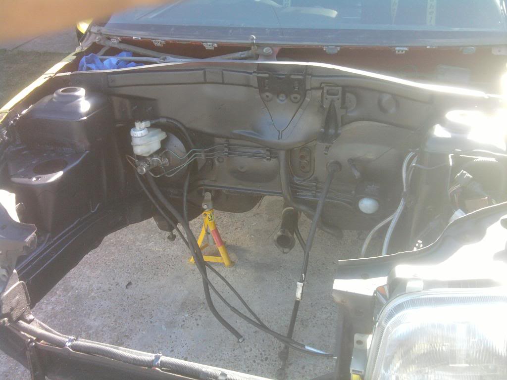

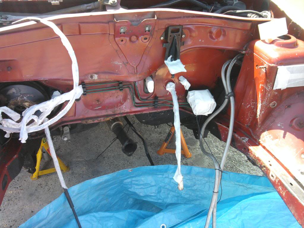

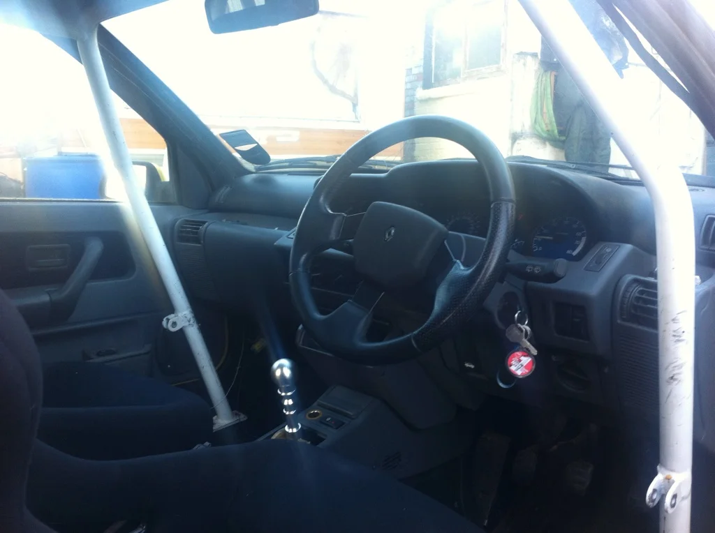

yes its been passed about abit buddy. V5C is still one page lol but folder of receipts is an A4 ringbinder. here are some pics of the current progress.
new carbon lid with aero catch pins, loads more to come

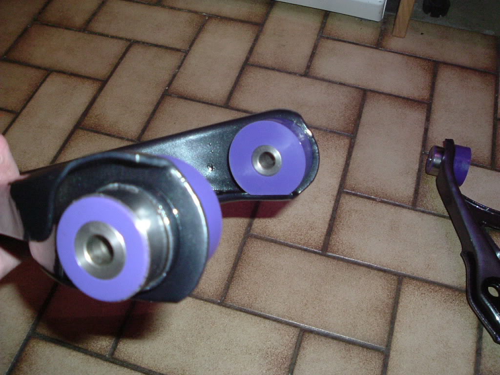

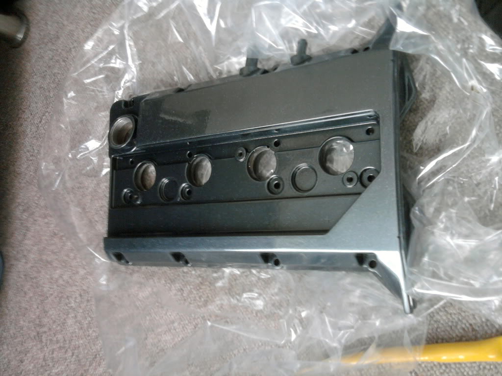

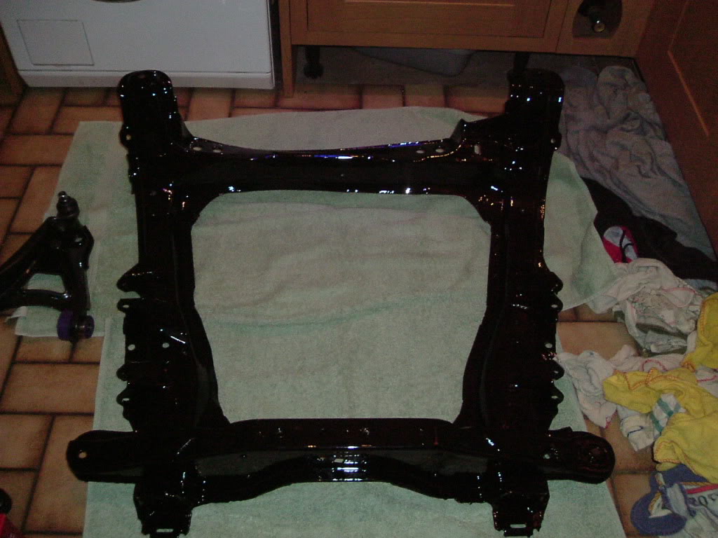

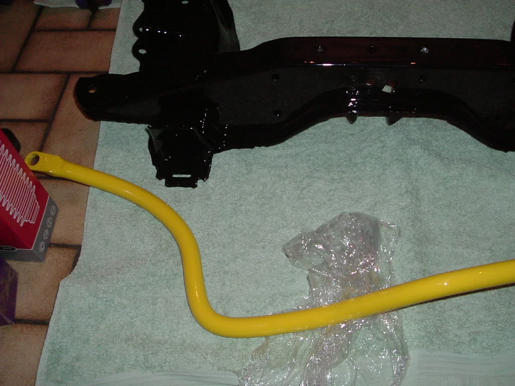

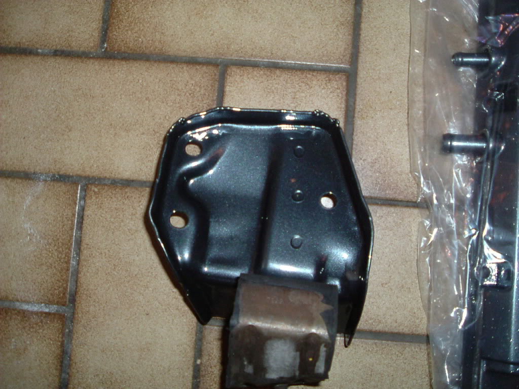

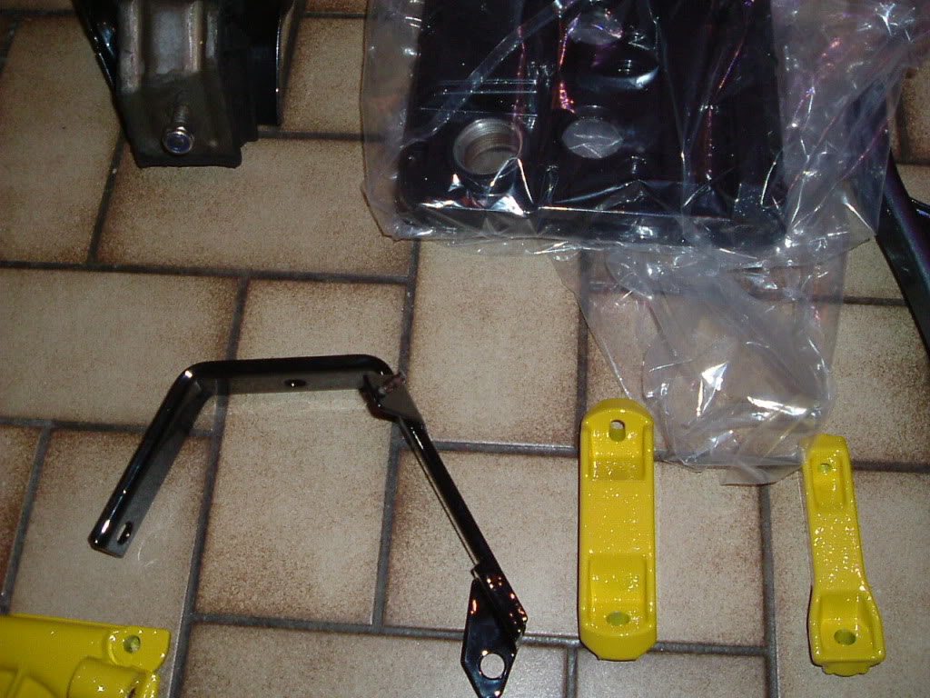

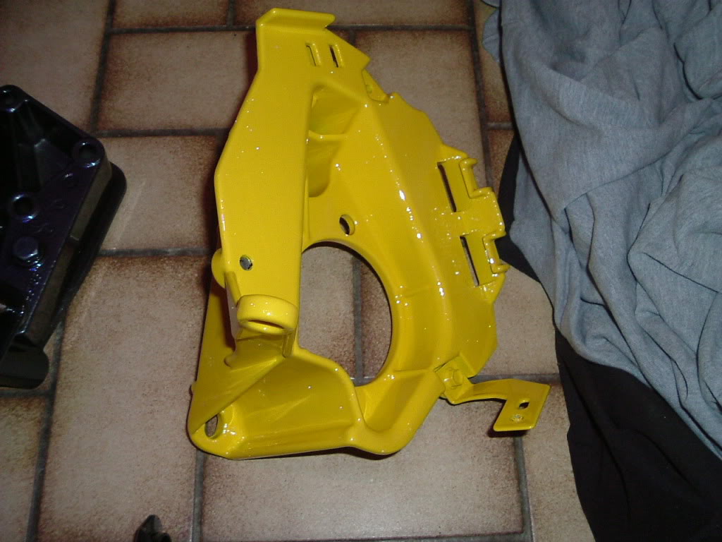

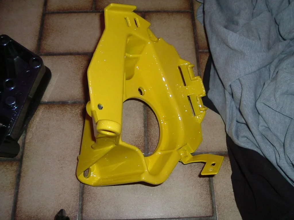

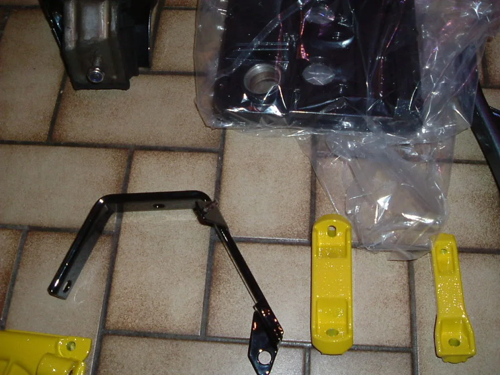

hell that was along time ago it was red lol, yeah think the car has quite an influence on everyone. will have an update this weekend. but bay was laquered fter being sprayed black. Avo's off for re-furb, springs being powdercoated. need to paint front calipers black. got subframe built up this week aln with all the polybushes fitted what a chore that was since subframe arb and brackets hae been coated.
  Phase 1 172

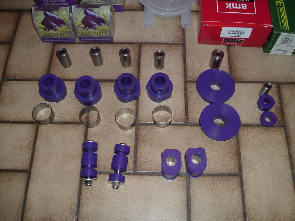

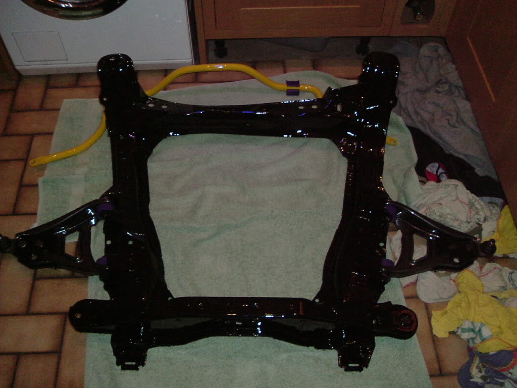

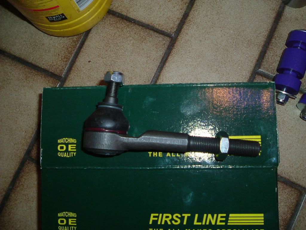

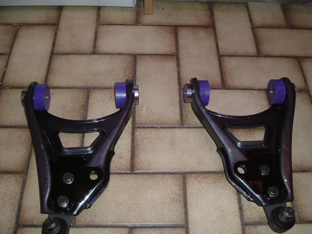

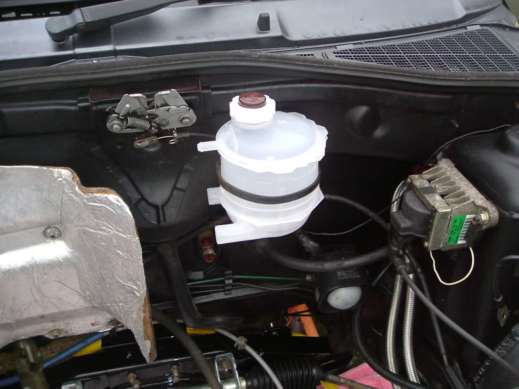

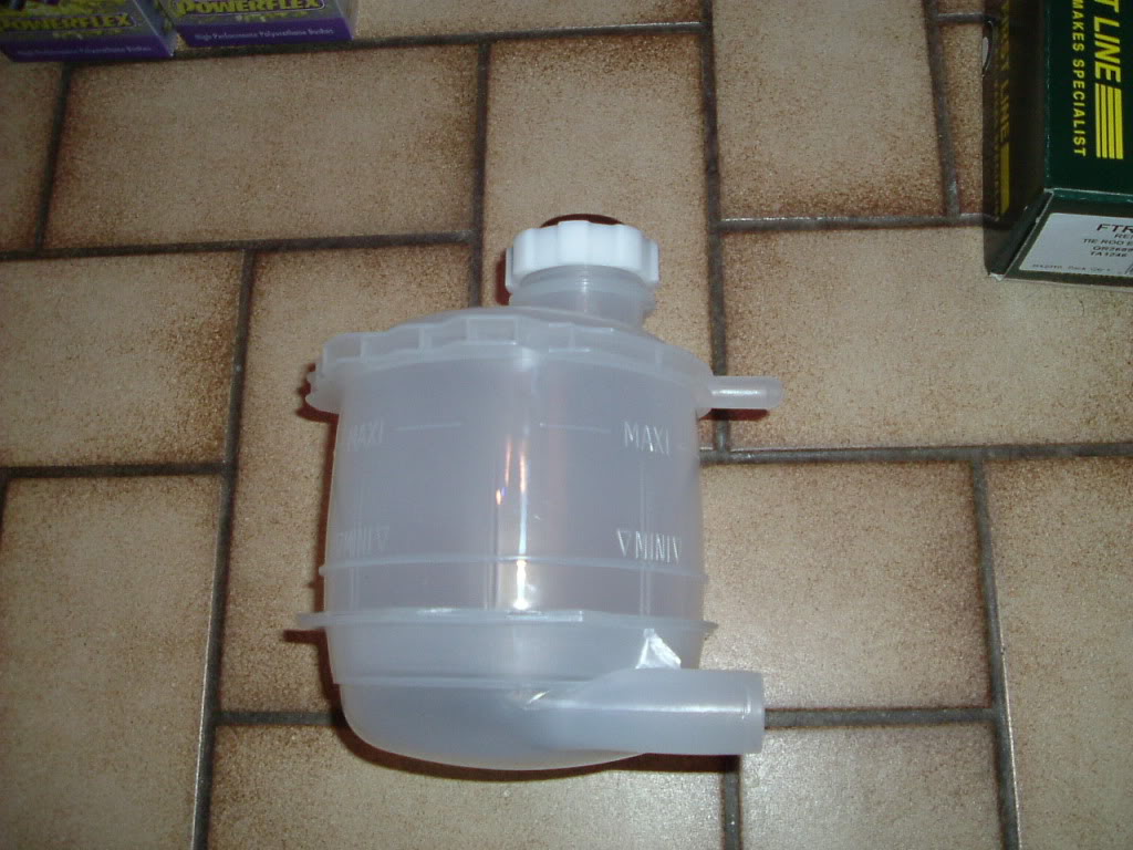

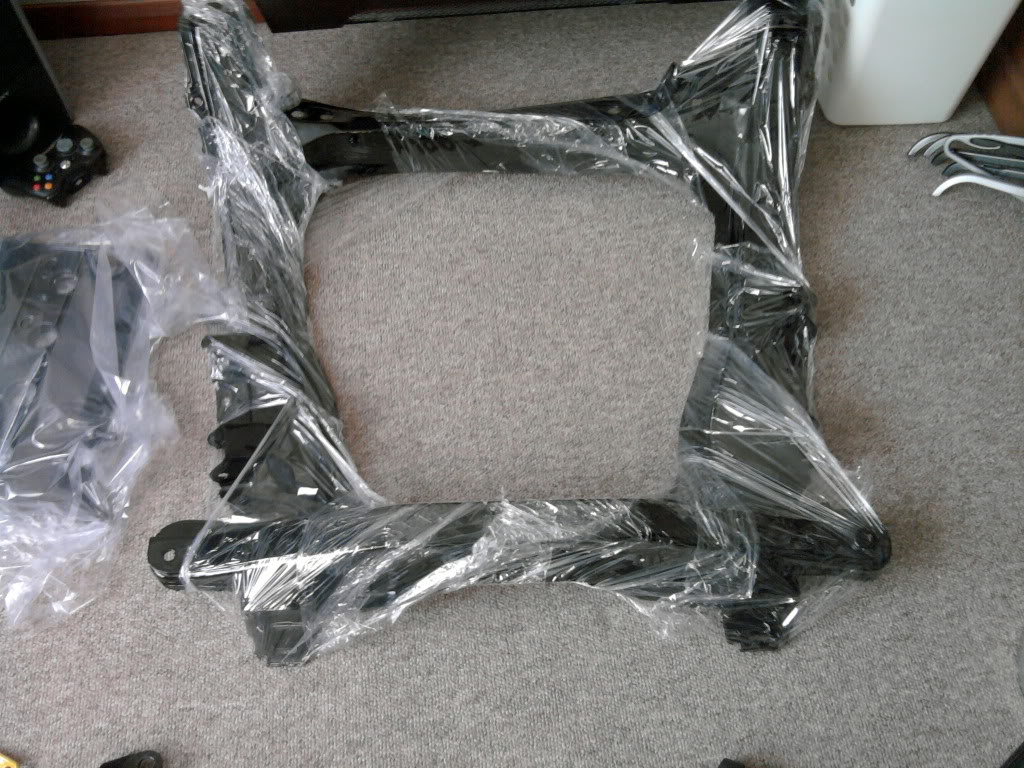

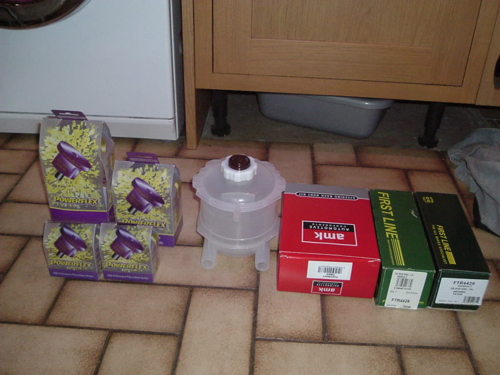

Right time for an overdue update, the postey has been very busy recently delivering packages. got my header tank from schakal. polybushes from k-tec and ball joints rack gaitors and track rod ends from rapid car parts.

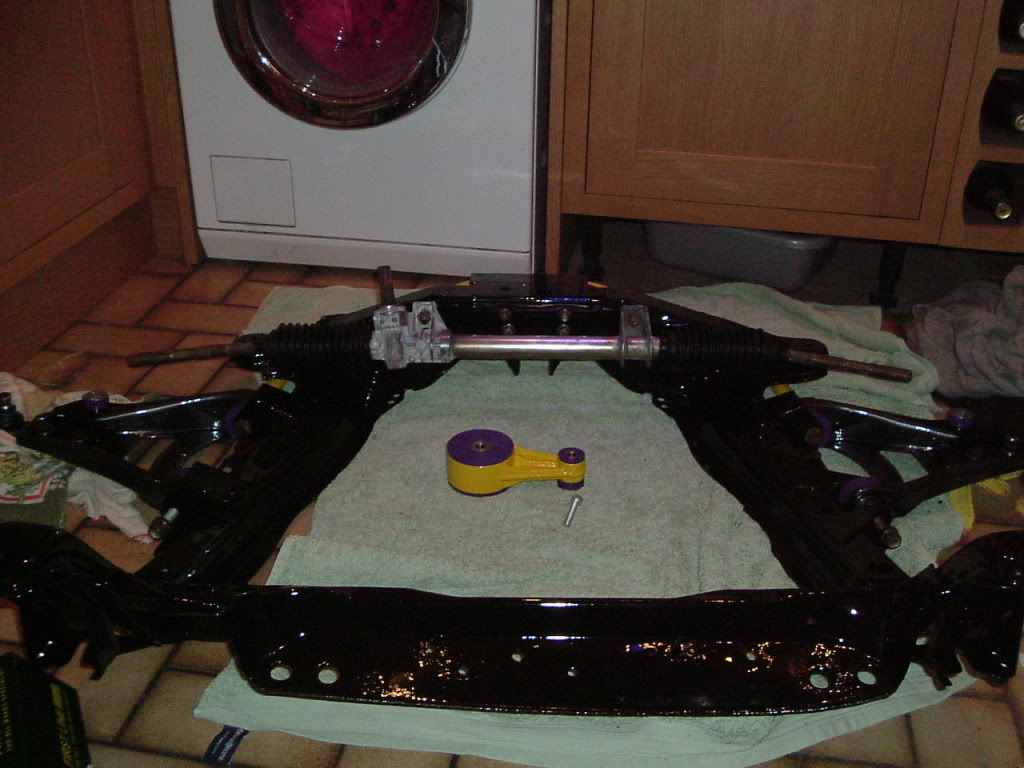

right since lil one crahed out at 6 and the missus and the old dear where engrosed in the soaps. i then set about assembling my subframe in the kitchen. my admit it was quite a chore to get the rear arb bushes in and clamped up on my tod. found myself chasing it aroundte kitchen floor.

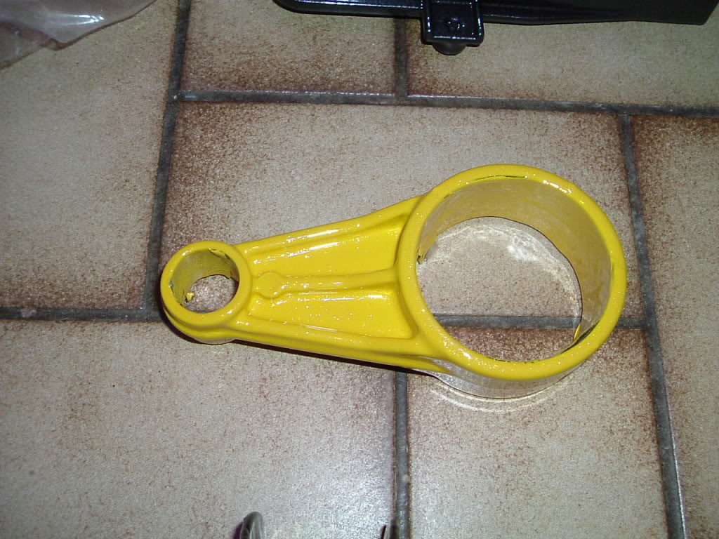

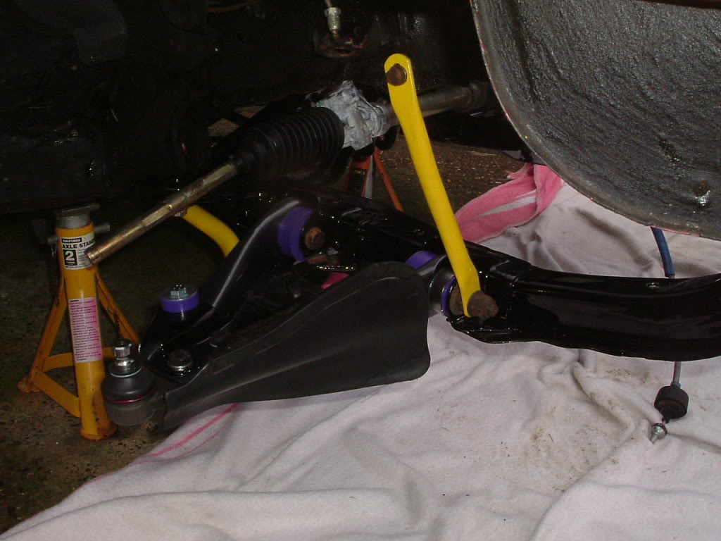

woke up bright and early this morning whilst the rest of the house was still asleep i was outside assembling the nana and getting subframe mounted so that when the avo springs come back from aerocoat (powdercoaters local to me) the car can sit back on the deck since june 2010.
goodies
polybushes
trackrods
header tank
next on the agenda is to get the brakes fitted and bled then car is ready for the engine, all for now

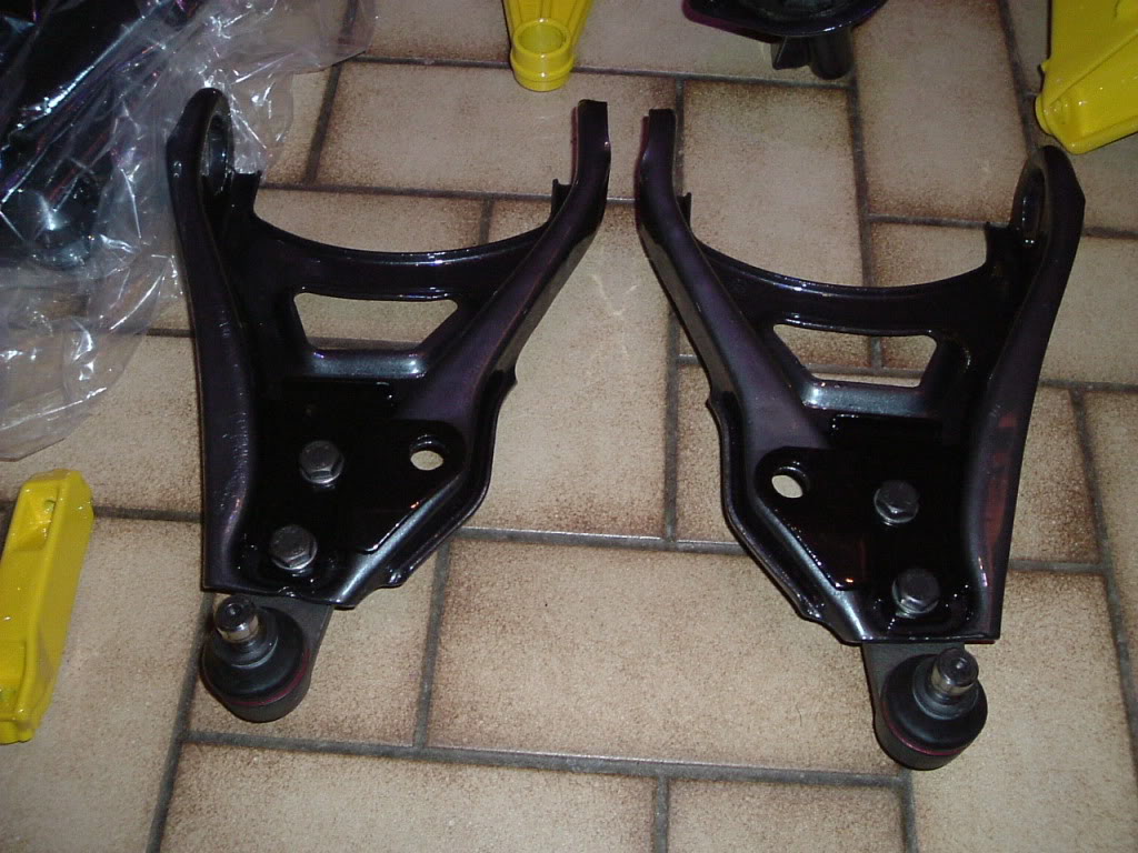

  ITB'd MK1
Those lower arm bush sleeves dont look like you've welded them in. Very important that you do or they'll move and eat into the subframe. Lovely build so far :)
  Phase 1 172
someone did warn me about that, had them on my old hybrid. but they never moved but since loads of people seem to be doing it and the car will be mainleytrack based i better do it :approve:
  340i
Why does nobody ever tac weld the wishbone sleeves in?!?! It tells you to in the instructions LOL!!
If you dont the bushes / sleeves will be mangled and chew into the subframe after a few 1000 miles!
  Phase 1 172
think everyone get a bit too keen. will be tacking mine this week. :approve:

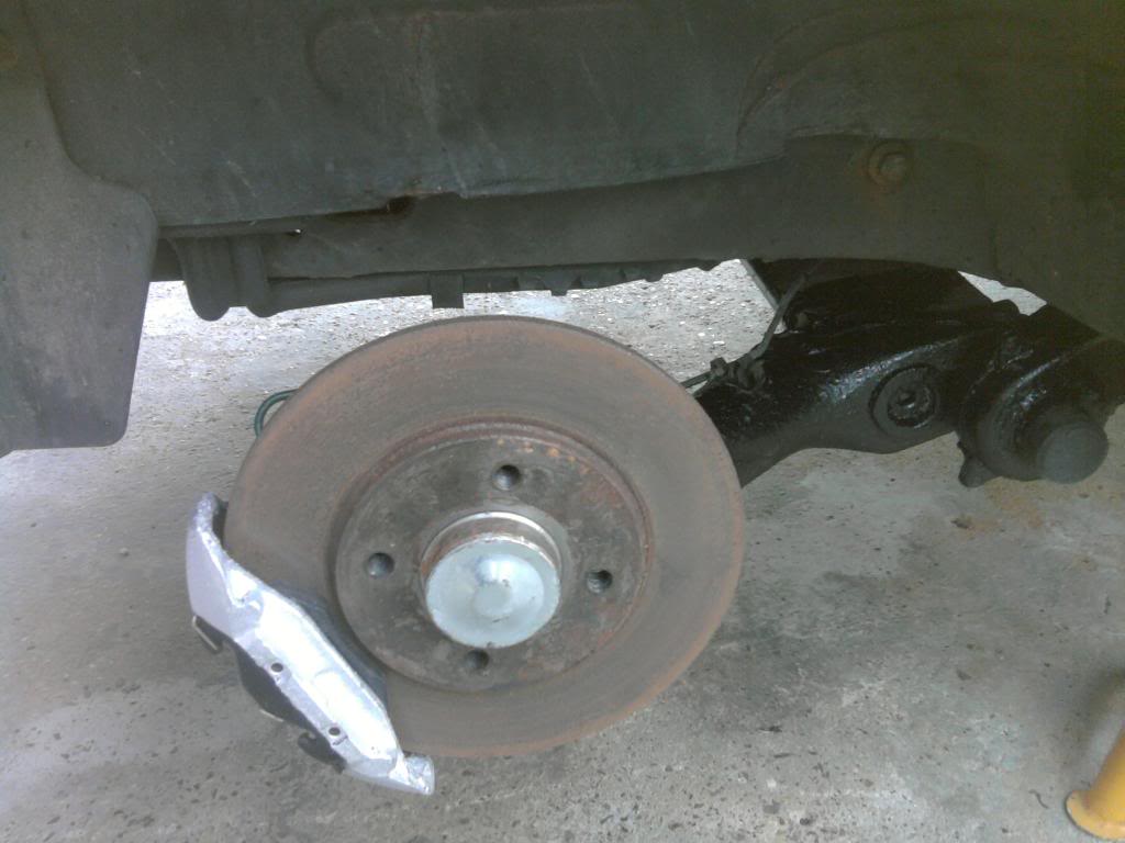

Right mini update, windscreen replaced for measly sum of £40 :approve: and just waiting for brakes to arrive. will be running oe setup for now with brembo discs with carbon lorraine pads. also welded sleives on wishbones :D will be more next week

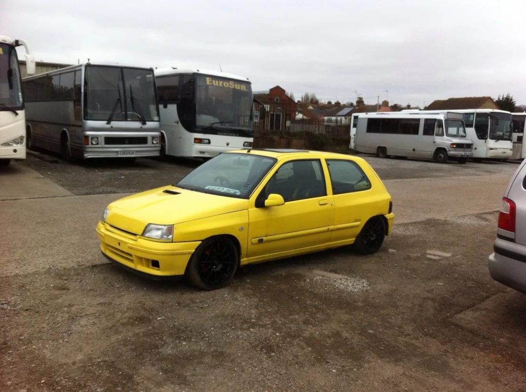

Right nice update

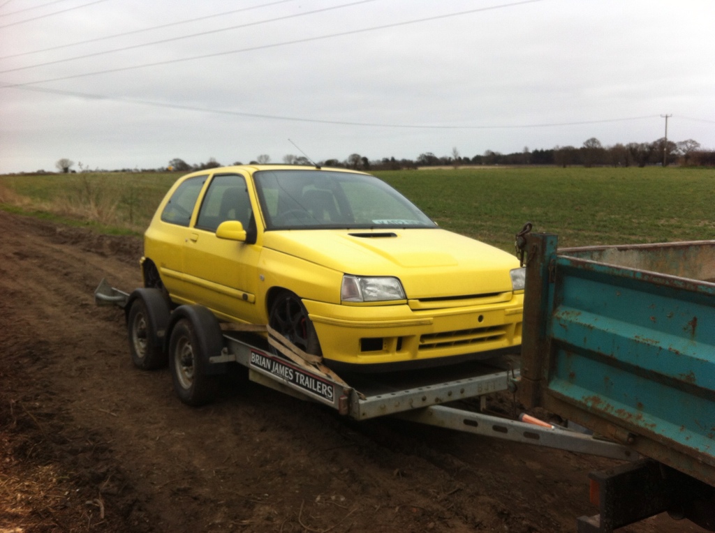

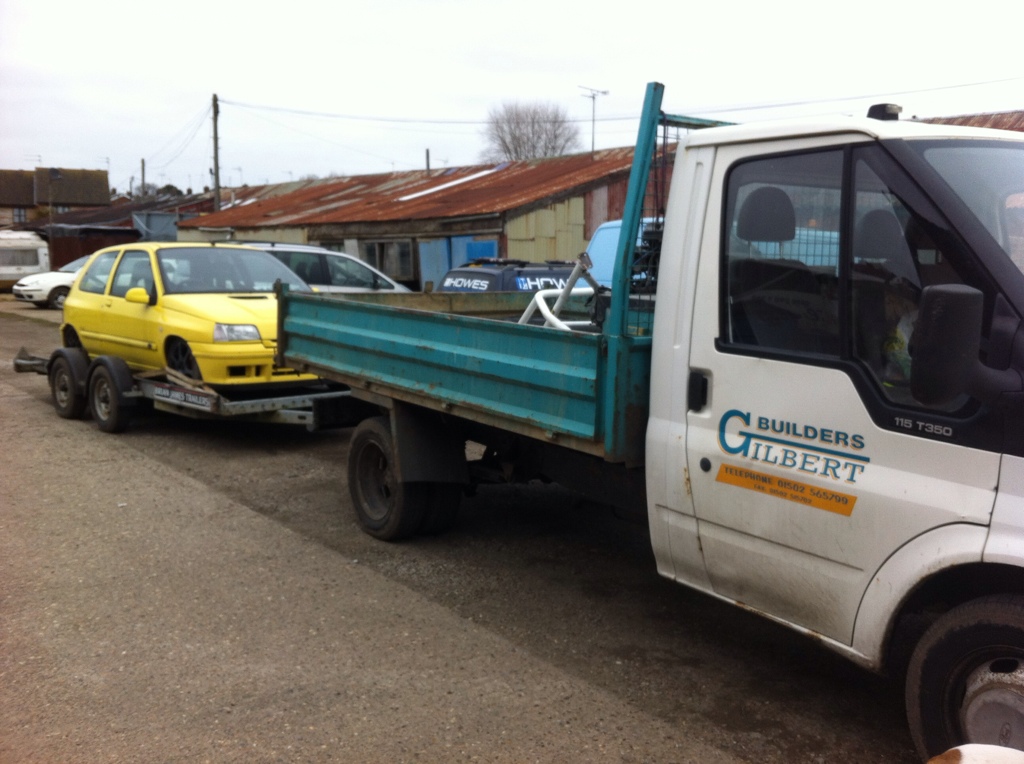

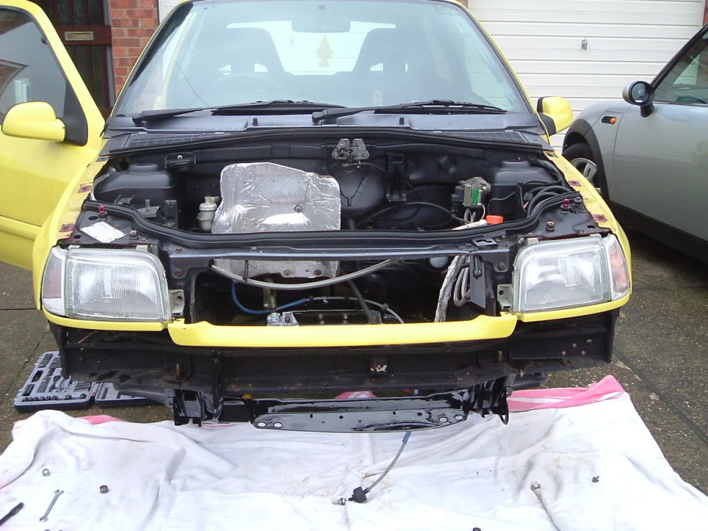

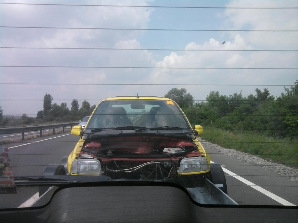

been cracking on the car, had a delivery of some very shiney go faster bits couple of weeks ago. so i got the nana moved to a friends unit to start work.
got the nana all loaded up
got the truck all loaded up as well
then we arrived at the unit
unloaded the car

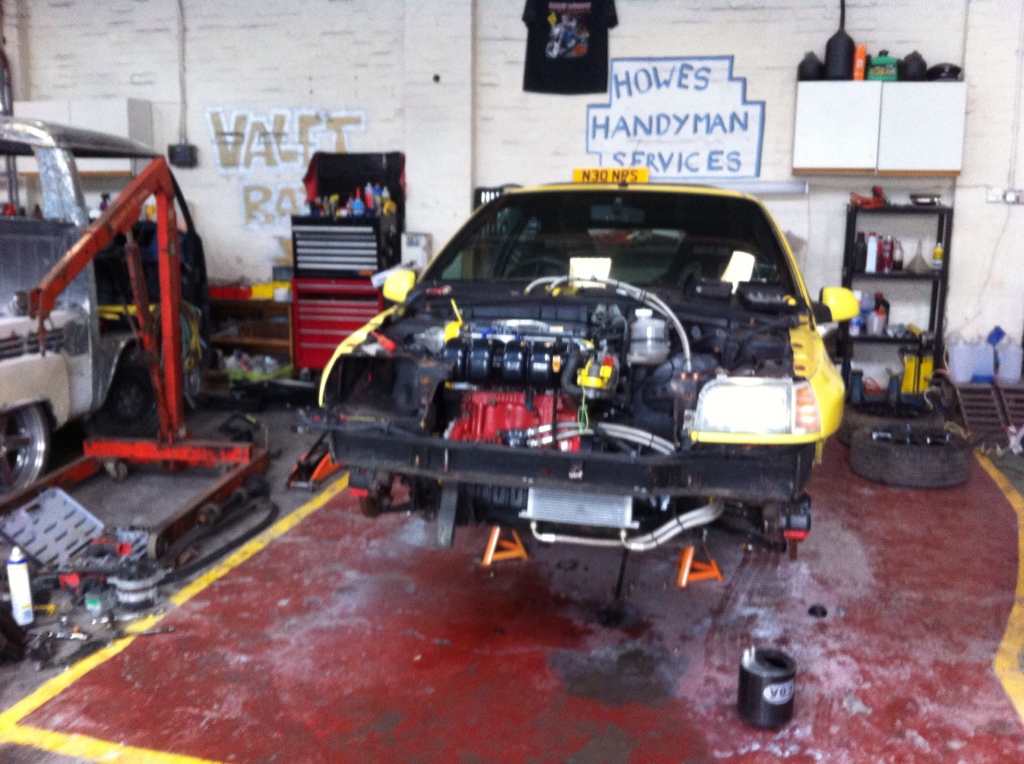

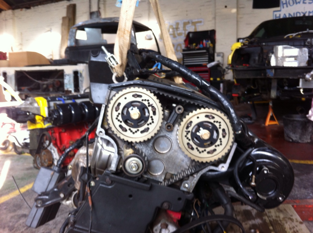

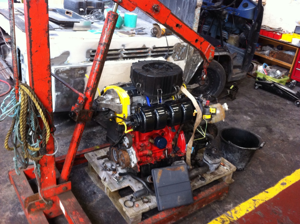

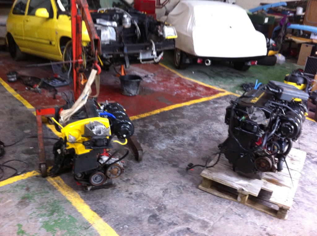

then set about removing the F7P (which is for sale on here
and its out

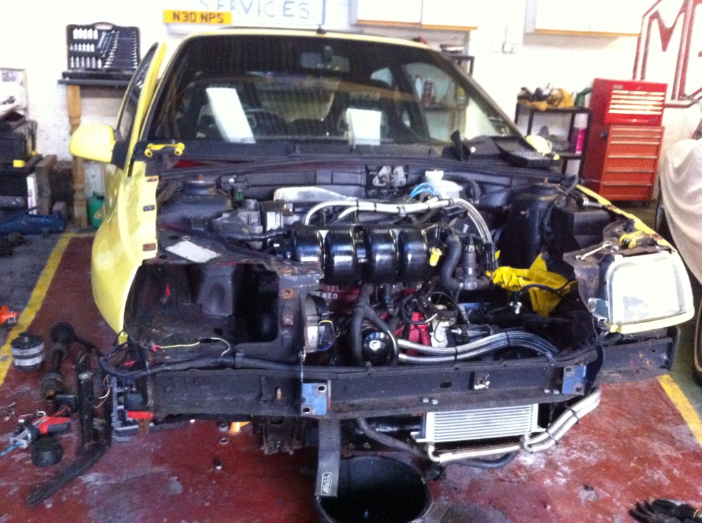

then setabout getting new one ready, new water pump new cambelt

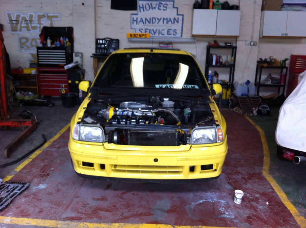

then the nice new 10k F7R engine was in

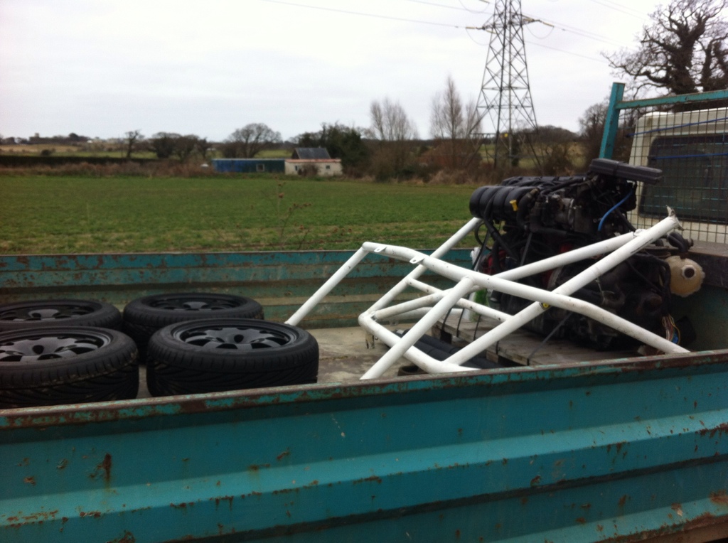

old F7P on pallet ready for sale

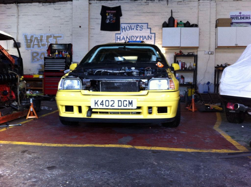

then dropped back on the deck for fluids
oh look what else landed in there
now we have an engine spec of
F7R 2.0 16V
catcams 5222025
catcams pulleys
AWT headwork
fully rebuilt std b/e
ITG panel filter
De-cat
Mongoose S/S System
Supersprint manifold
Remapped ecu
mocal oil cooler kit
Transmission
JC5 williams Gearbox
R5GTT uprated clutch

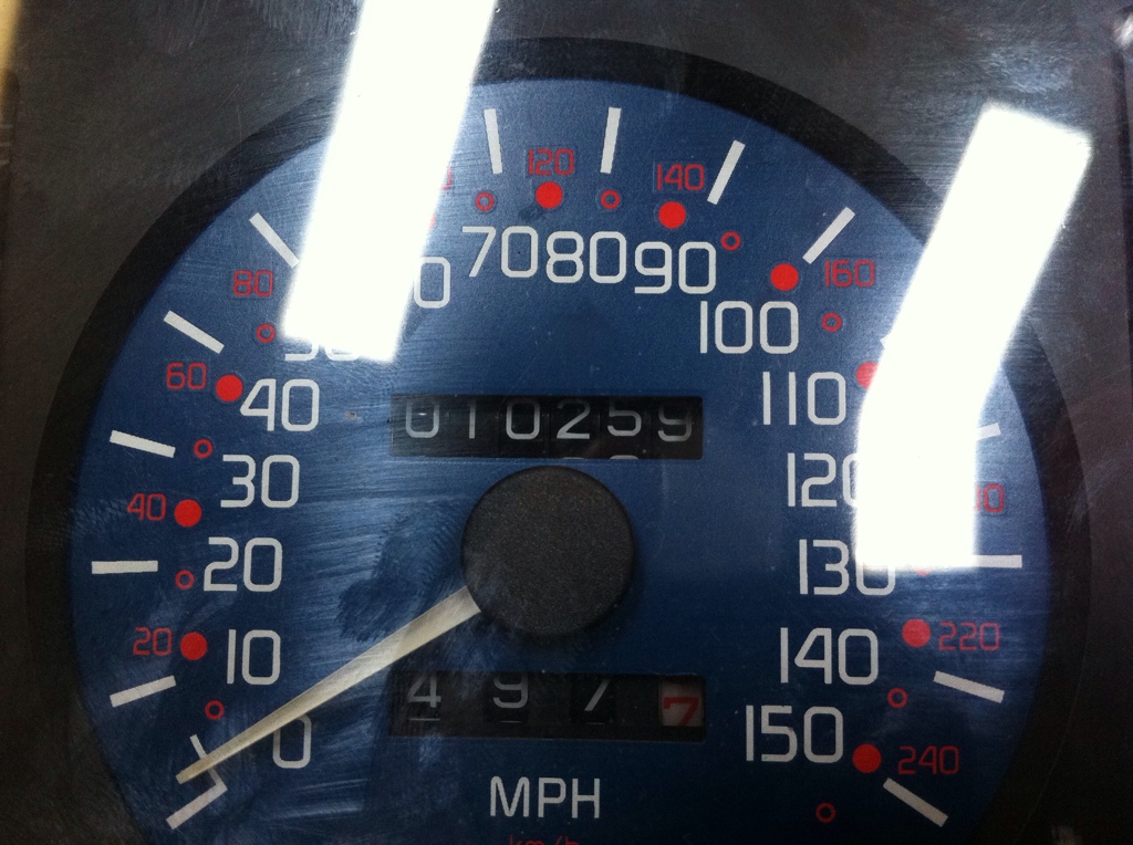

current mileage is 10.259
little more tittyvating and its done
