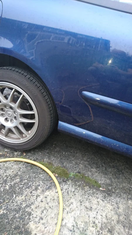

then removed stickers from windows and rear quarters again not for me and as said, project standard for this one!!

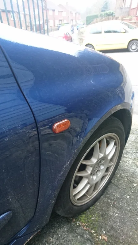

Side repeaters replaced for original orange

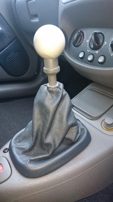

Gear gaitor repaired as it was attached incorrectly, although is it now too low on the lever?

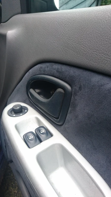

Door opening handles replaced as they were the phase 2 shiny silver items, again not what I want in this

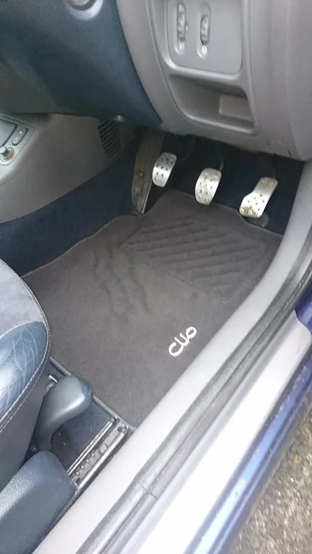

Then a Vac, fitted new mats

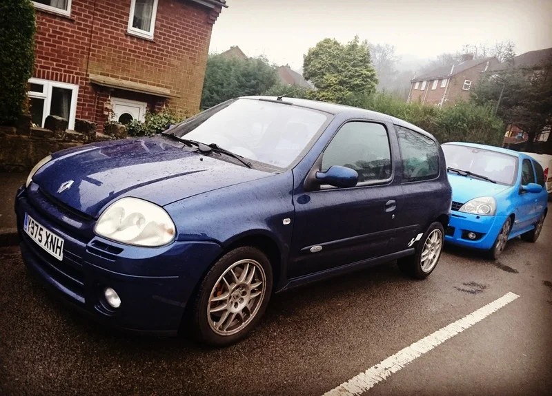

And a quick bath, scrubbed up okay!

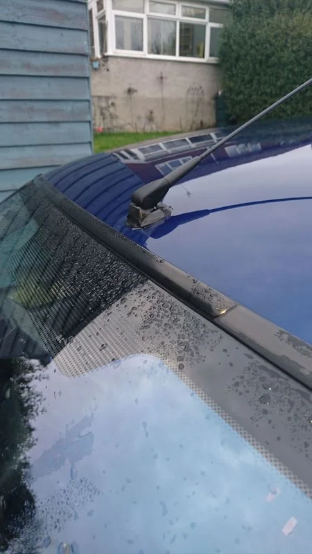

And finally, what's this little spoiler thing in the windscreen seal? never seen it before?

That's the windscreen seal for cars with sunroofs, acts as a little wind deflector, so it's the wrong one for the car, not that it matters really, still does the job.
ah right, I've never owned a none sport mk2 so never had one with a sunroof! must of had a screen replacement at some point and had the wrong screen seal fitted! every day is a school day!

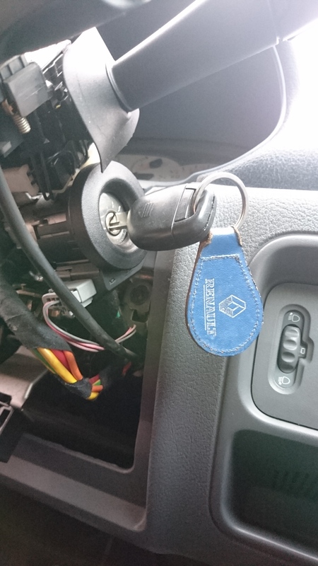

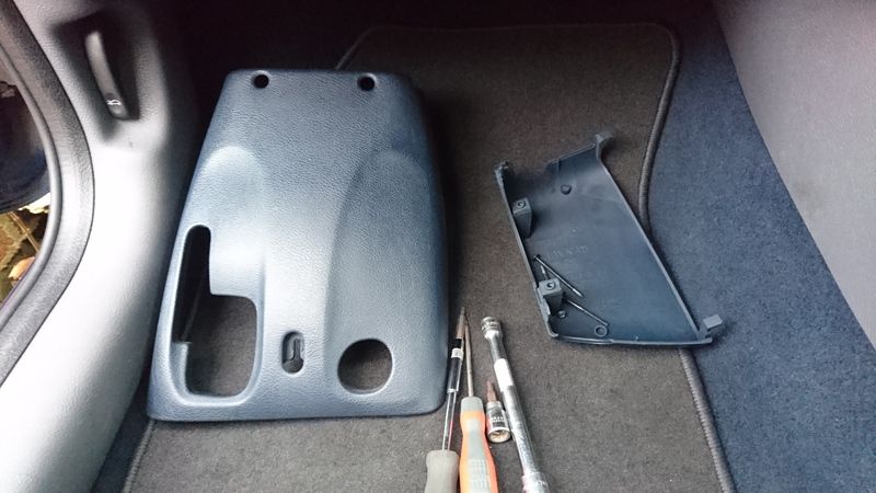

It's had an intermittent starting fault, so today I stripped down the steering wheel cowling to have a look as it's an immobiliser fault
All the wiring looked fine so no concerns, and the key sensor for the immobiliser looked in good condition and orientated correctly etc. But I stripped it all off and cleaned it with a damp cloth anyway.
Put it all back together and it started first time.... And restarted it few more times and hasn't missed once. Also locked unlocked a few times and started in-between, seems fine. Not wholly convinced though as seems too easy and didn't really do anything unless wiring connector was slightly loose maybe. Either way time will tell!

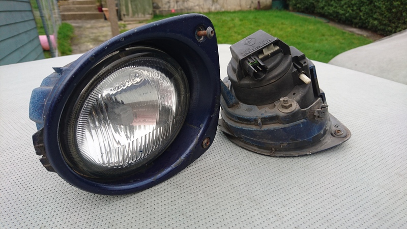

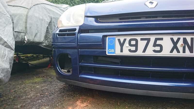

Removed the front fogs next to replace the surroundings for none sprayed ones, which I need to buy

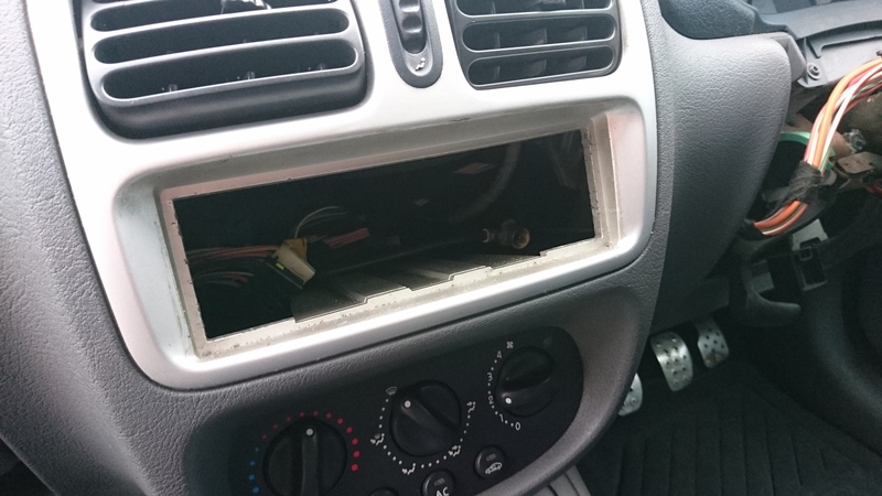

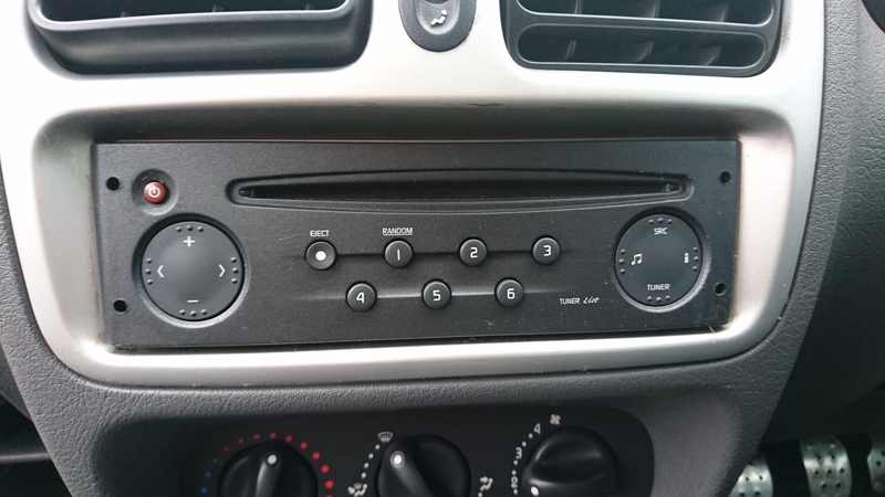

Next job was remove the later model stereo as I'll be sourcing an original tape deck one

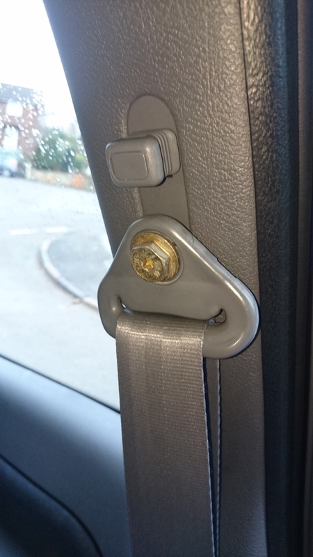

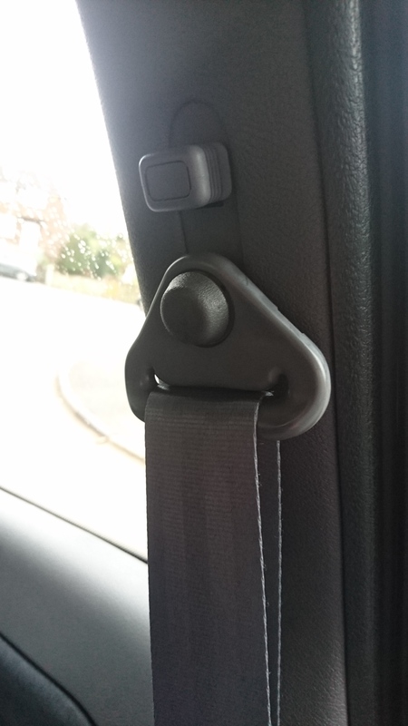

And had a nosey round the interior and spotted few flaws, rear seat belt holder guide thing on one side is snapped, not sure what I'll do with that as it's part of the seat. Didn't get a pic!

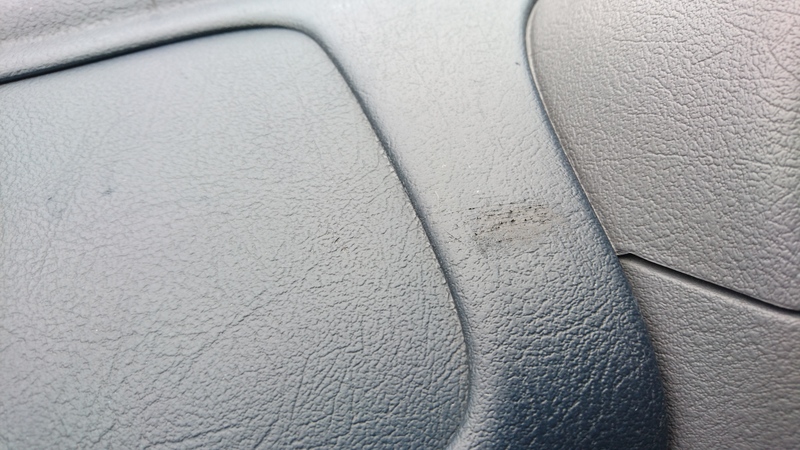

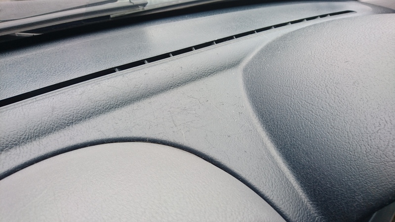

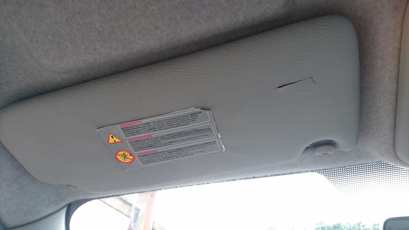

Also the top dash is covered in scratches and passenger side sun visor has a rip so they'll get replaced also!

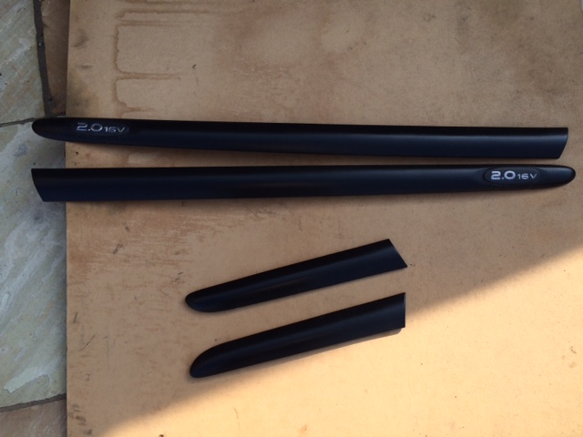

Just thought I'd say I have original side strips if you want them. I have sprayed these in gloss black and they look better than the faded look they were before. I think a clip is broken but otherwise pretty good condition
£10 posted?

Tiny update, thought I'd treat her to a magic tree and try starting her again, first turn. So came back inside, watched telly and did my ironing, went back out,tried her again... First time again.
Seems a magic tree fixes immobiliser issues in old Renaults :p

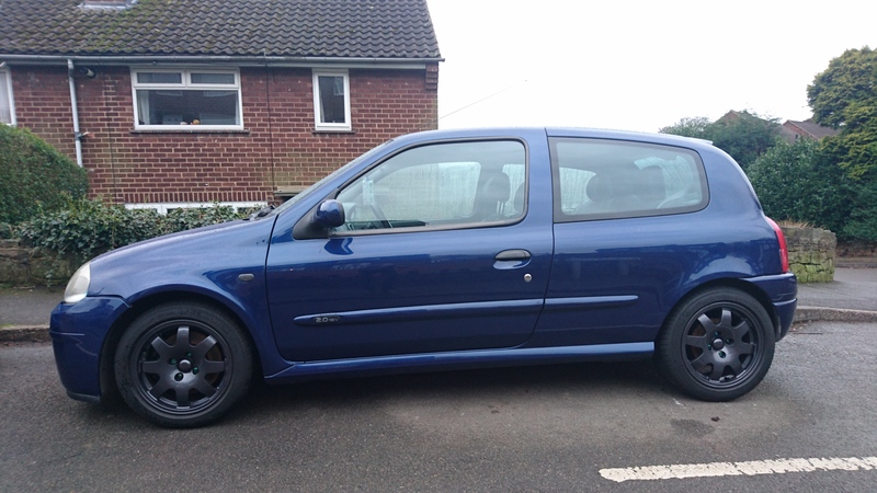

Well did a load at the car today!
Original plan was to put it all back to completely standard. However I want to powdercoat the OZ F1's and i'm also still collecting bits.
As such decided I would pop a few cheeky mods on the car for a bit, mainly just to see what it looked like!

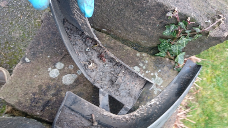

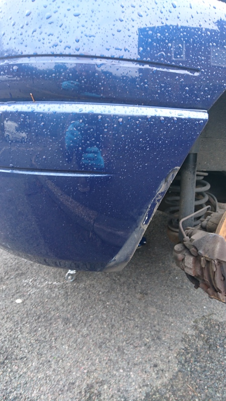

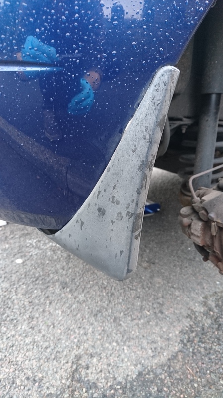

So first job was to remove the gen ren mug guards from the rear bumper..
much better, I will remove the gunk from what looks like some double sided foam tape when I next wash the car as I also need to remove the residue from the rear quarter stickers I also removed
about 20kg of mud in them too!flol!

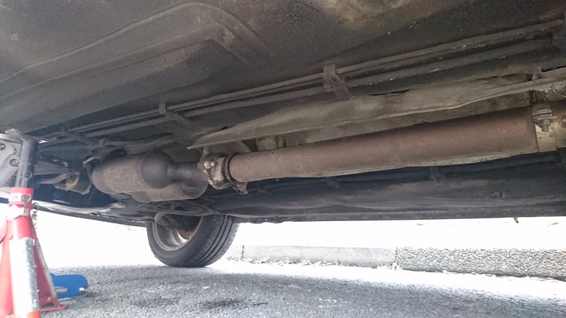

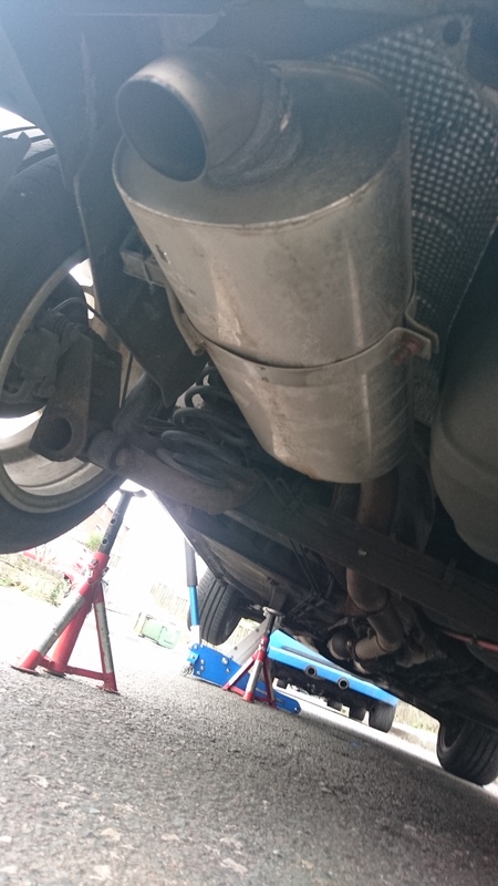

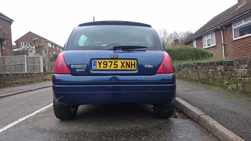

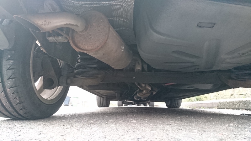

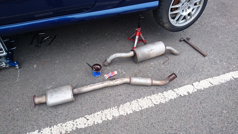

I then jacked the car up to complete the next task, removing the ktec stealth non-res exhaust and fitting a standard pattern exhaust I bought
ooplah!
ktec on the car
new one to go on
fitted
back on the deck and much better, can't see it from the rear of the car!

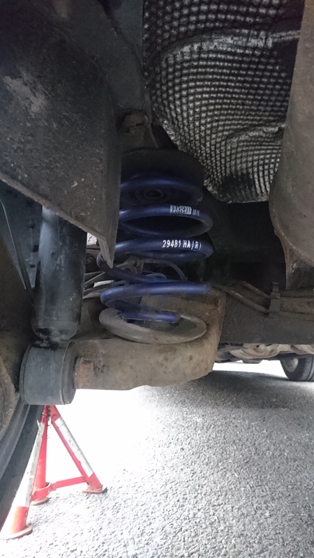

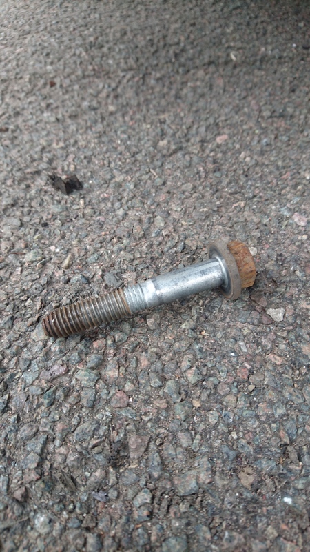

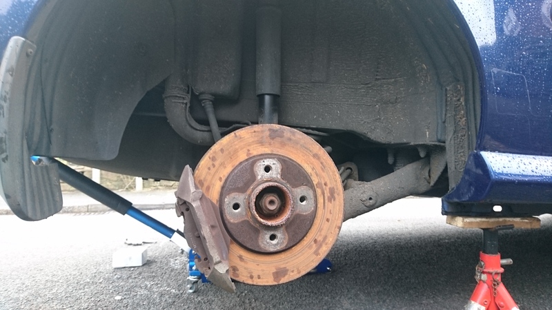

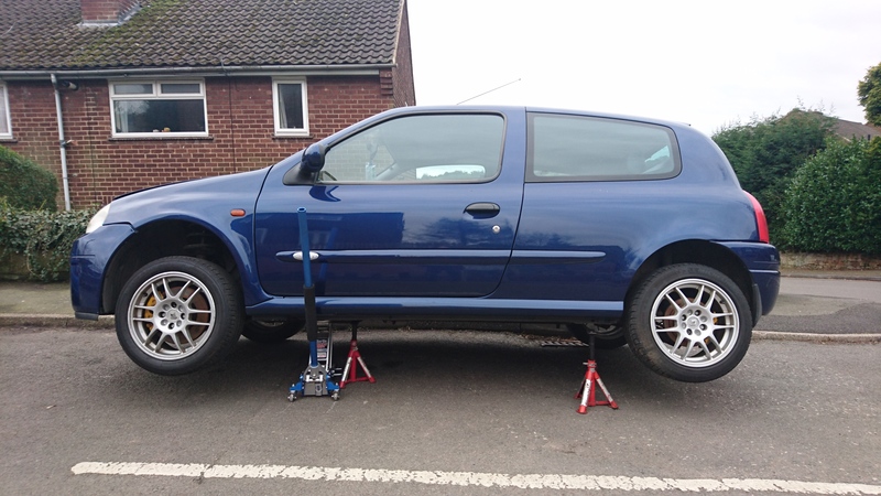

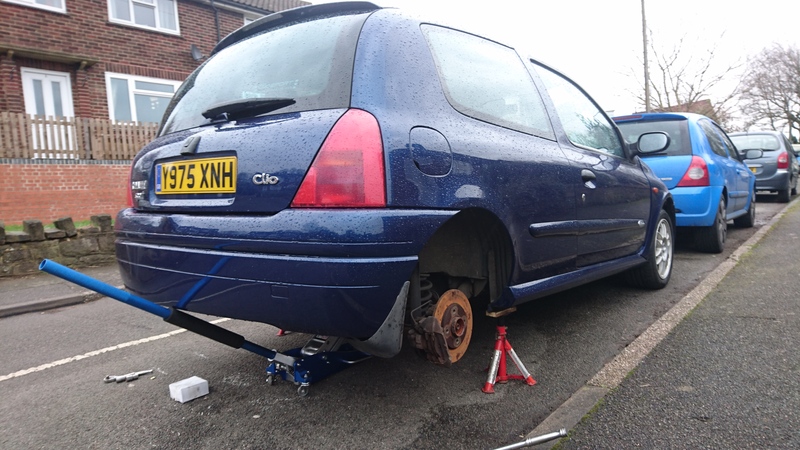

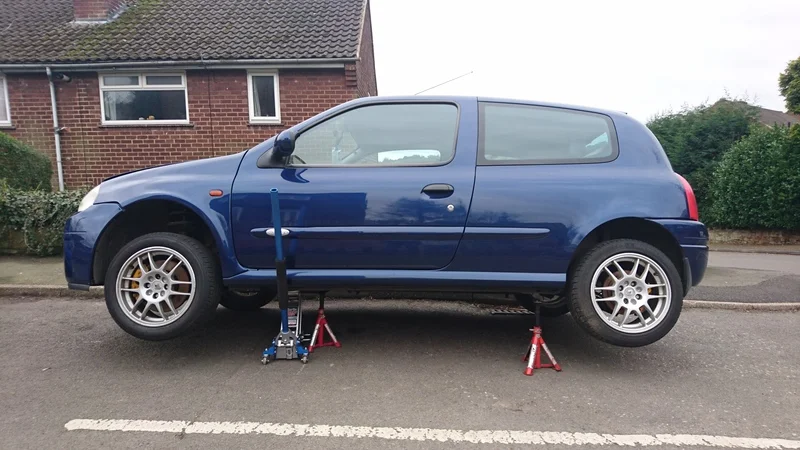

Then jacked up again from the rear, wheels removed which was a pain as they were stuck on the hubs! no nasty surprises though, all bolts undid fine. This is to fit the H&R springs I removed from the RB earlier in the day

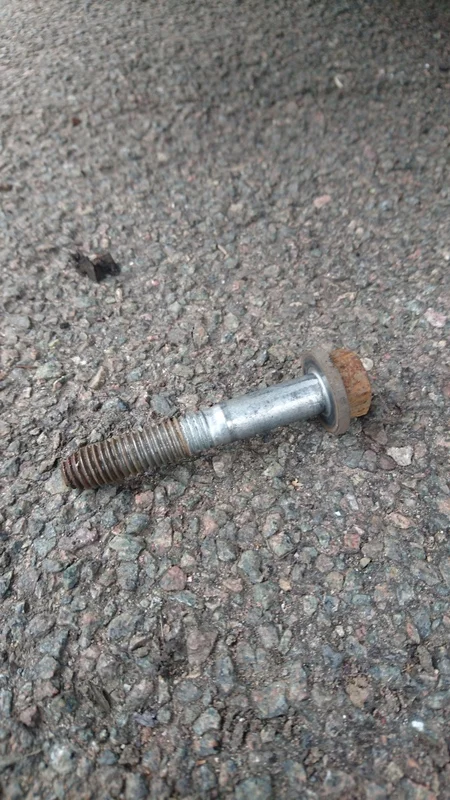

Theme continued throughout this job, most of the bolts I removed looked in mint nick really!
rear springs fitted

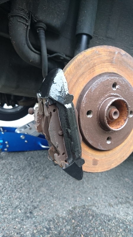

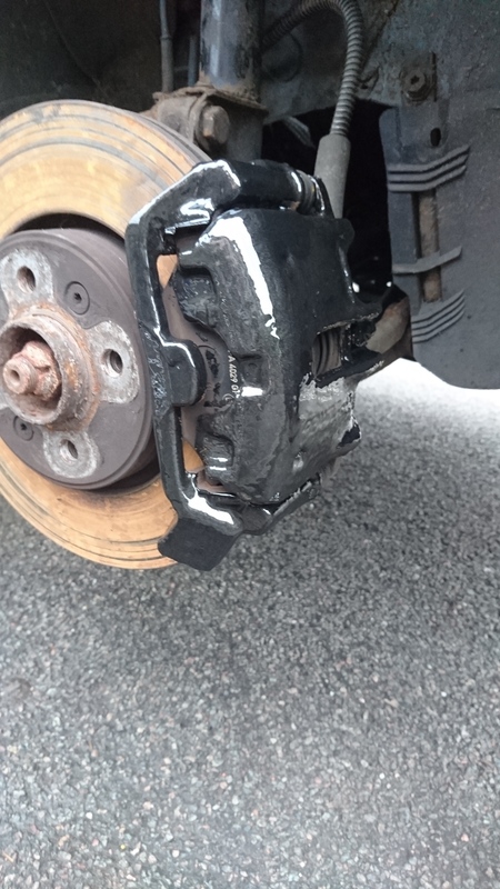

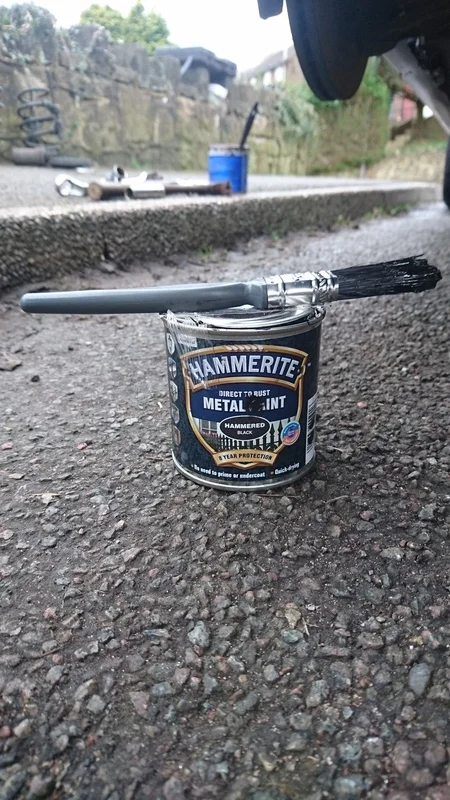

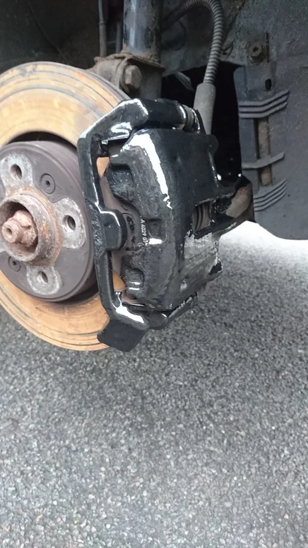

the calipers had been painted yellow at some point in the past, not to my taste so quick lick of hammerite hammered black and looks much better, very quick job with naff all prep but it'll do and at least no more yellow behind the wheels!

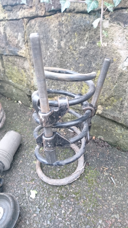

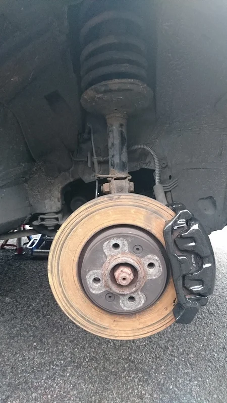

Moved on to the fronts next, which did require a quick nip on the spring compressors to pop the old springs off, RB doesn't need this so guessing its the cup suspension on that making the difference!

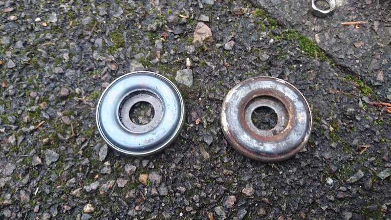

replaced a knackered top mount bearing on one side, other side was mint so can't of been changed together. I've got loads in the shed so no drama!
and fitted to the car, again hammered the front calipers too to cover the yellow, and again a crappy job but not aiming for perfection here!

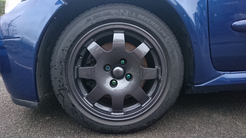

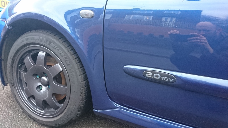

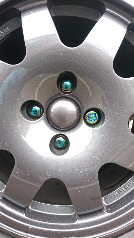

Then fitted my BMW sparking graphite grey Williams speedline wheels which I've had for years, wanted to see how the looked on the odyssey. Also fitted with TPi bolts
Also swapped to the silver on black original side strip badges, but decided to leave the body coloured strips on for now. Also decided to swap to some smoked side repeaters, again just whilst its in 'modded' mode!lol!
And done

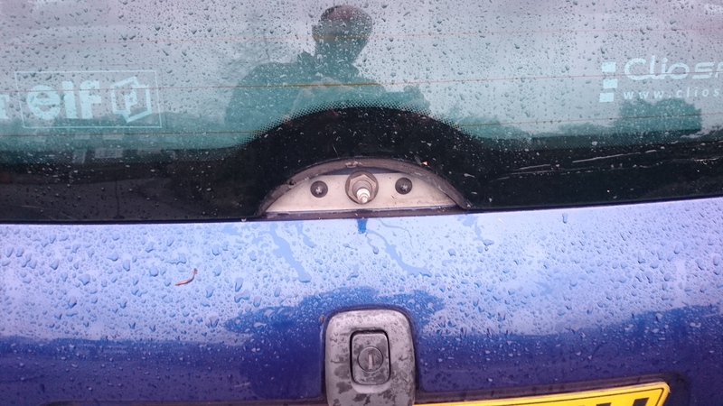

Next removed the rear wiper trim as that's going to get sprayed satin black like the fog surrounds

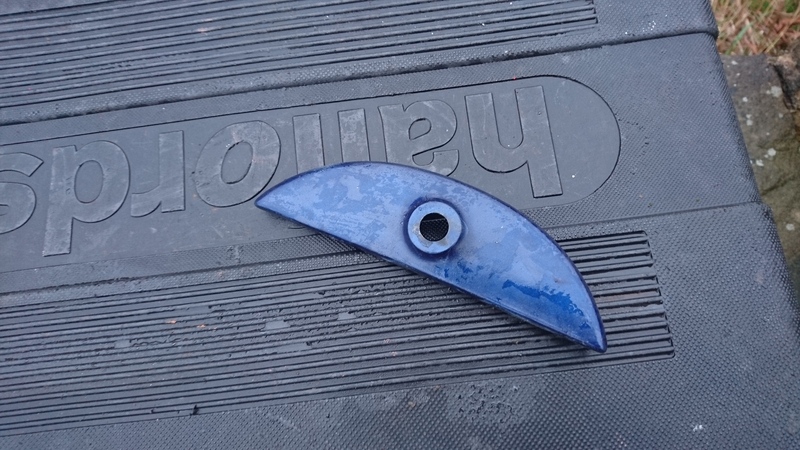

And one last little job, randomly noticed this bit of trim missing other day, again got loads in the shed from previous cars I've killed
much better

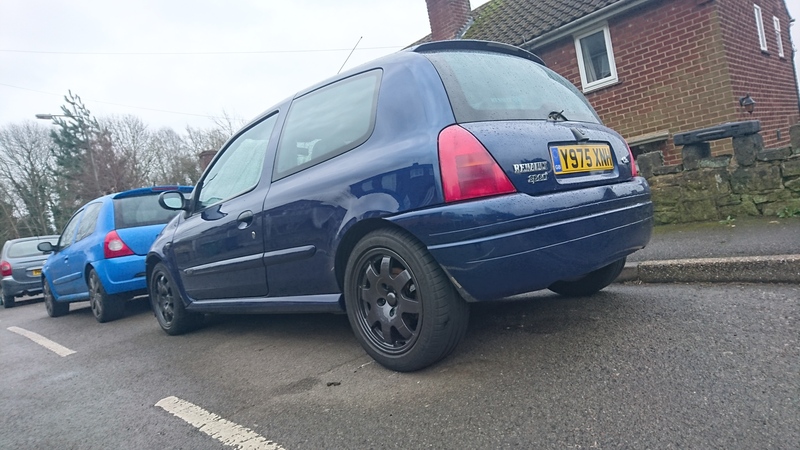

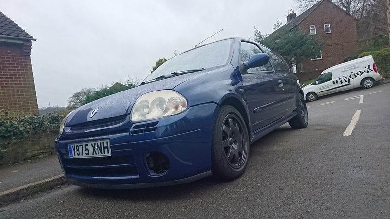

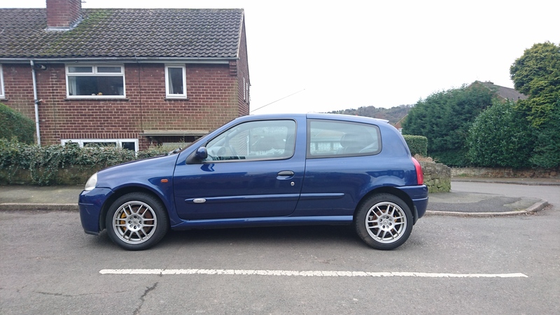

And to finish off, side shot before and after todays work!

Wheels look spot on.

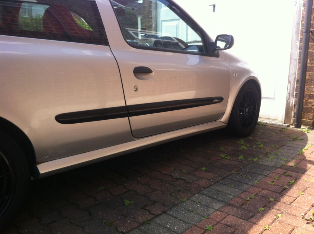

Your door strips, have the standard "textured" ones been painted or are they smooth? The standard logo badge in them is a nice touch actually, breaks the colour up.
