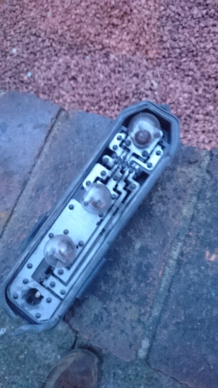

Couple more niggles sorted tonight, when indicating right the fog light light on the dash kept coming on, i'd already cleaned up the earths so it was the cluster itself on the rear of the car
so fitted new light panels I had in shed to it from phase 1 I broke years ago, sorted!

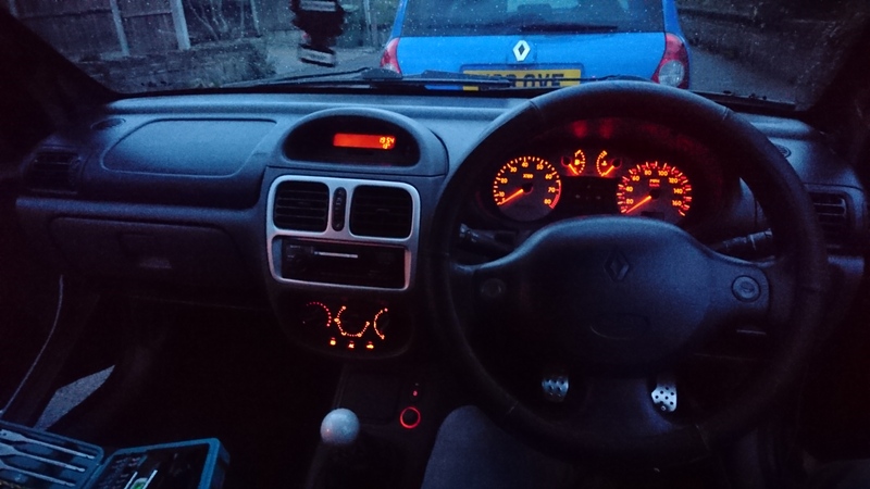

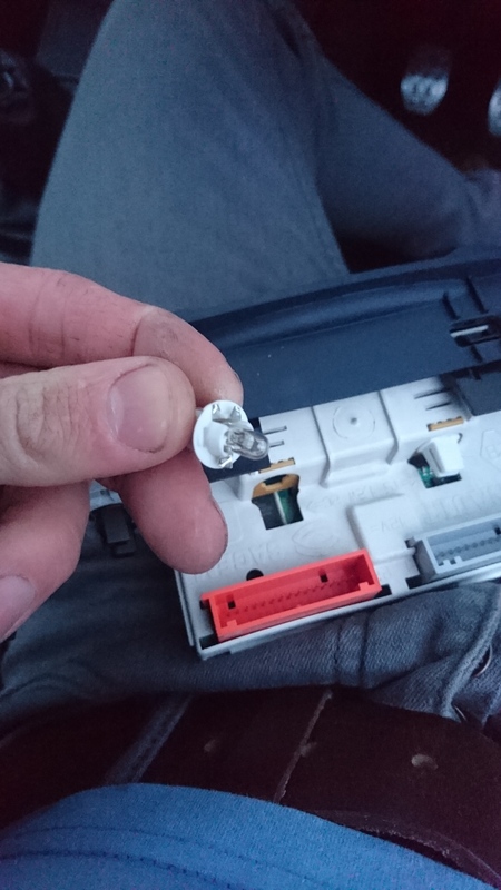

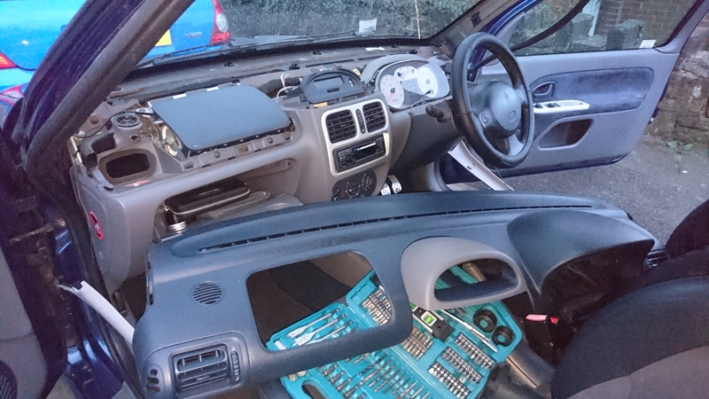

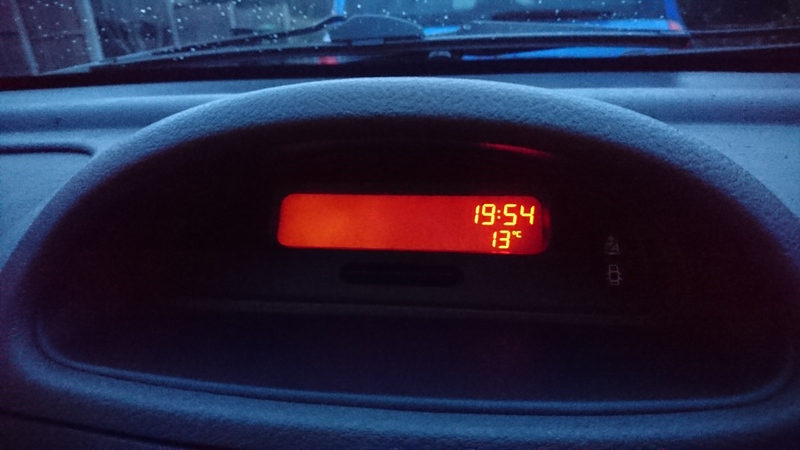

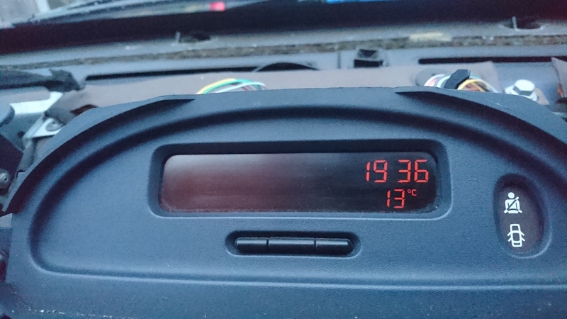

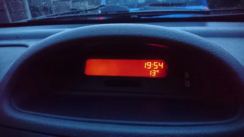

and then sorted the blown bulb in the clock display in the top dash which had been annoying me, again from stock in the shed, same as the old valver ones so nicked from a mk1 Clio clock!
Have to take a large amount of top dahs apart though, just for one measly little bulb!!!lol!!
before
in bits
kippered little bugger, all that for just this!!
and done! much better!

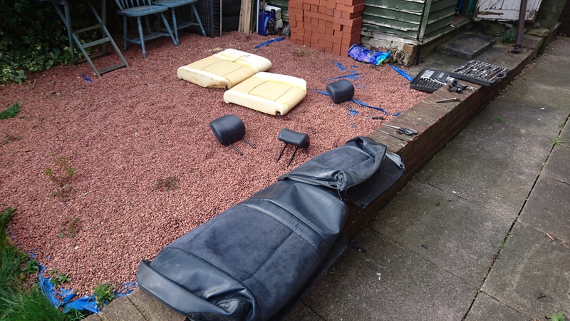

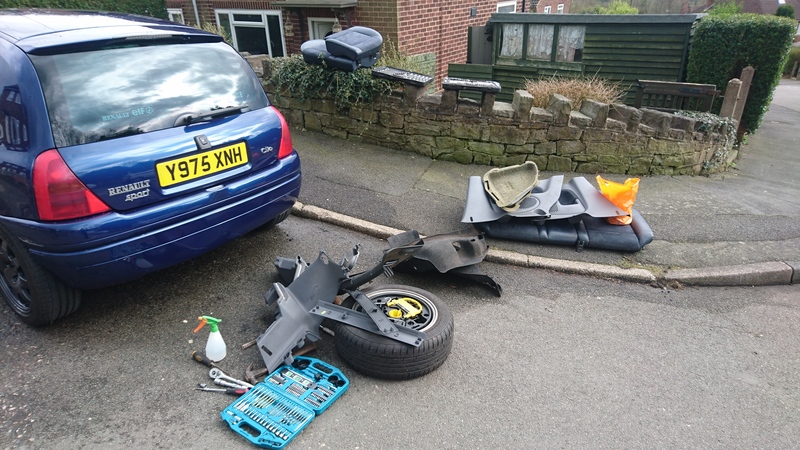

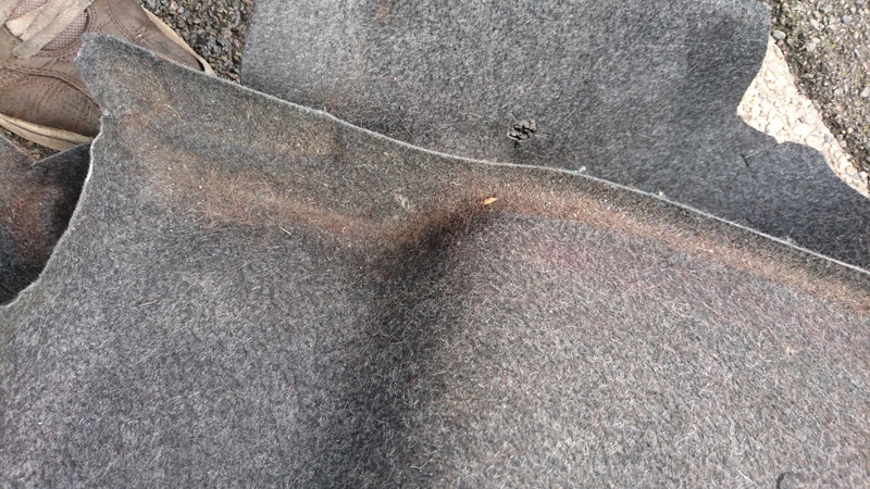

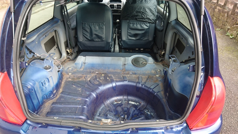

Decided to have a crack at cleaning the rear of the car fully to remove the dog hair today...... things escalated quickly!!! lol!
bit of muck here and there to clean up but nothing terrible for a 16 year old car that's done her time as a daily! and done it well!

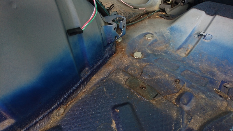

Had a small argument with the rear seat retaining bolt too, me and mr angle grinder won the battle......but the wars not over, stud extractor or similar going to be required me feels!

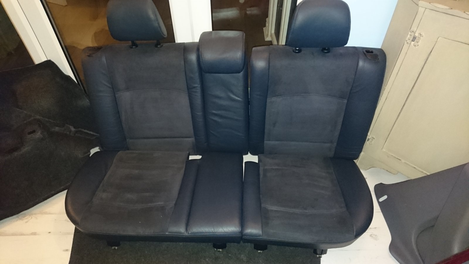

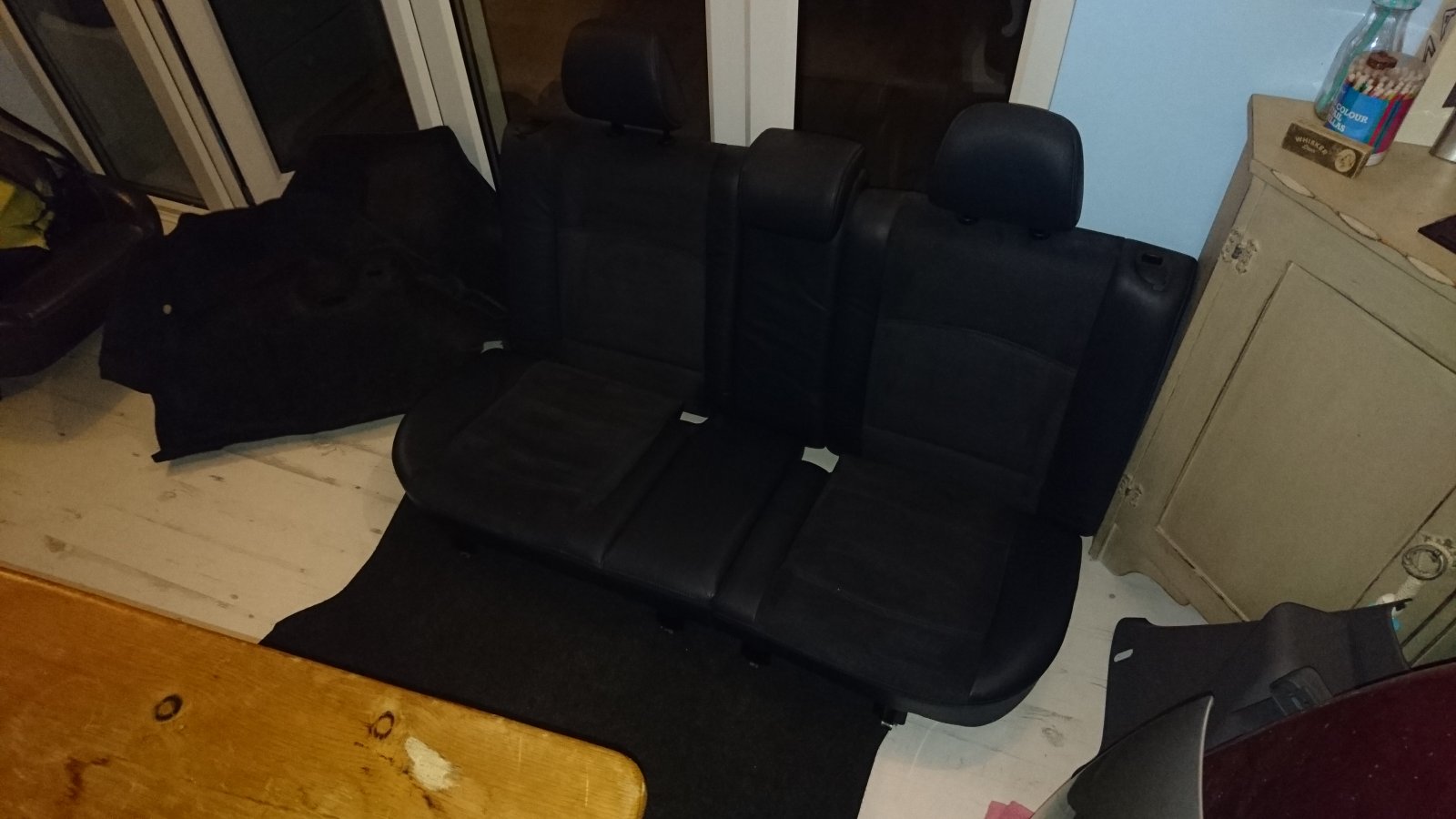

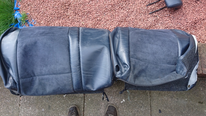

@mintno1 is providing me with a new rear bench over Easter with any luck as the plastic seatbelt retaining guides were snapped on mine, as such, I have stripped them down to get the material off them for a snappy refurb of the steering wheel at some point.

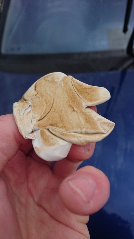

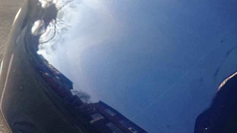

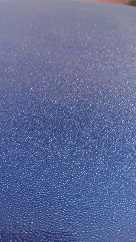

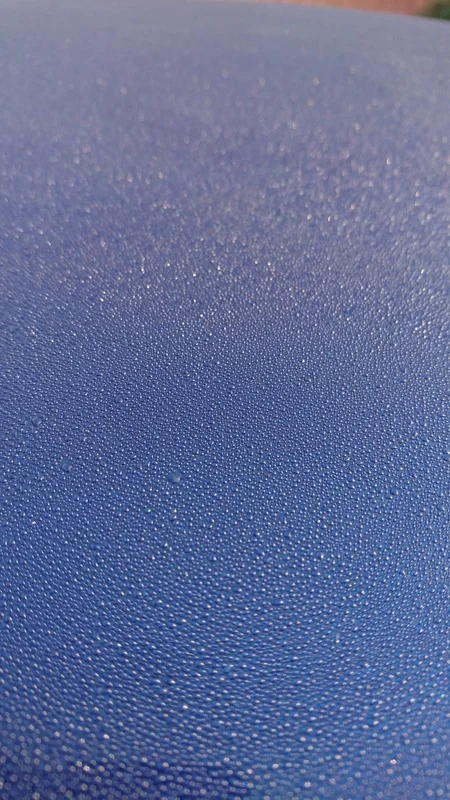

I clay bar'd the car too and happily very little contamination on the paint, apart from the bonnet randomly which was ditched! only pic I took was of the bar from this panel
got a good polish in and one layer of wax too, enjoyed pottering tbh for couple of hours!

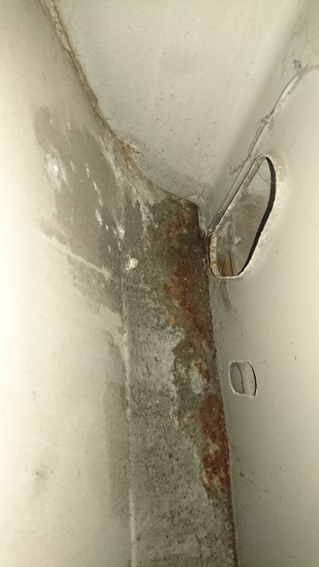

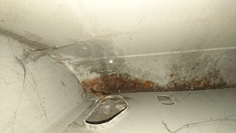

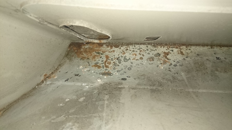

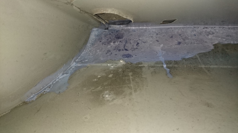

oh and here is my phase 1 rust candid snaps, not rotten, in fact not bad at all really. I'll be scrubbing the worst off, giving it a good fettle with a prodding stick to test structural integrity and then coating in the fabled hammerite kurust.
KitsonRis
Exactly how my inner sills look. I had a poke down mine the other day while I was in the back, and was plesantly surprised. I Kurusted them the other year but wouldn't mind doing it again.

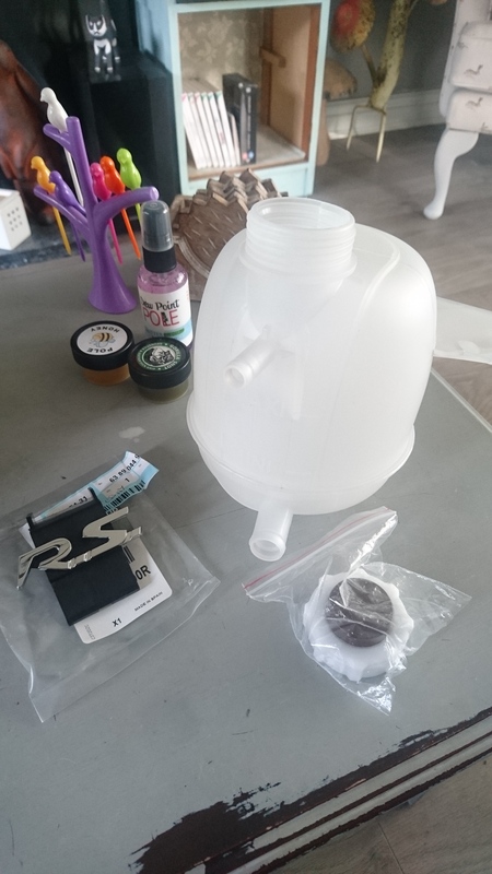

Love a little parts delivery on a Monday to cheer me up :)
The rs badge is a marmite thing on a phase 1 but personally since seeing @Phase1sr car I knew I had to do it.
And new header trank and type D coolant to go in too after a good system flush!

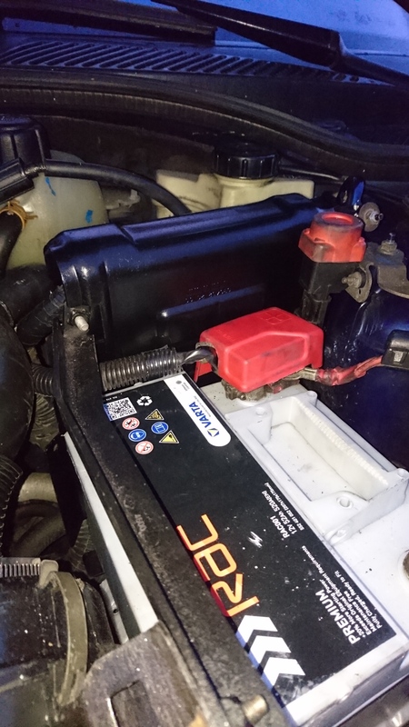

Refitted my ECU brackets after spraying them satin black, I'm going to replace the battery positive terminal too I think as the cover has broken loose and looks a mess!

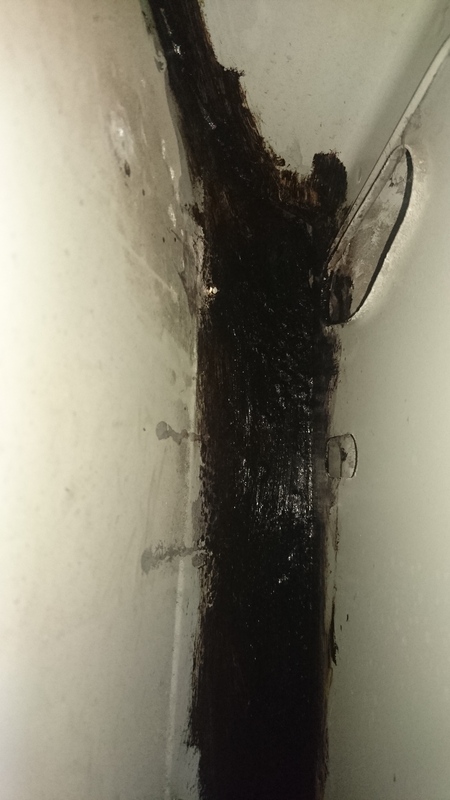

Then I scrubbed back the surface rust in the inner sills and treated with a coat of hammerite kurust. I will repeat the treatment at the weekend and then coat the lot in waxoyl underseal before refitting the doorcards

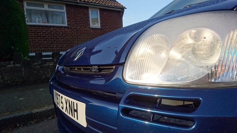

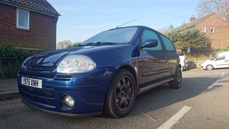

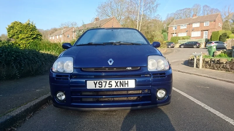

and then the fun job, fitted my new R.S badge. Was very happy with how this went as after talking to @Phase1sr he informed me he had to chop the badge down to fit in the grill and then use a small self tapping screw to hold it in place. After a bit of head scratching and not wanting to put a hole in the grill (even if couldn't really see if the badge was removed etc, but still..) I just trimmed a small amount off the sides of the badge (still a harrowing thing to do to a fairly expensive item!) and low and behold it clicked into the grill like it was made to fit!!! quelle surprise!!
I know its a bit of a marmite mod, but I love it! and I will get some decent pics of the car as it stands now with the badge once I get another layer of wax onto it!

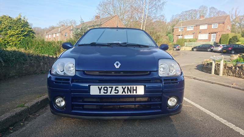

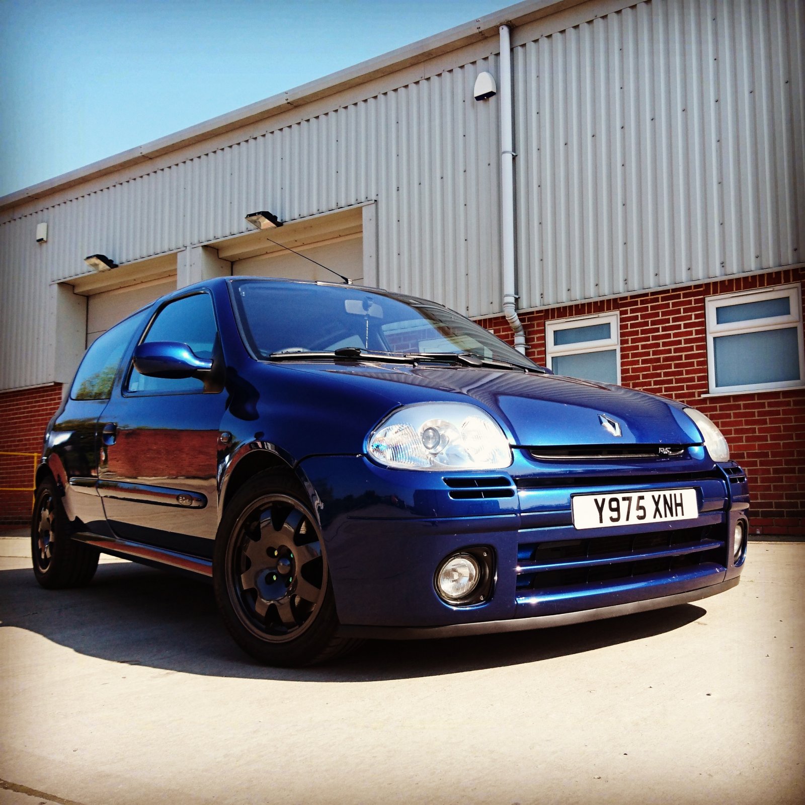

Quick pic in the sun with the badge fitted. Crying out for coilovers!!
Cleaned and sorted the interior now too ready to fit once I drill out and sort the snapped bolt :)
View attachment 183338 View attachment 183339

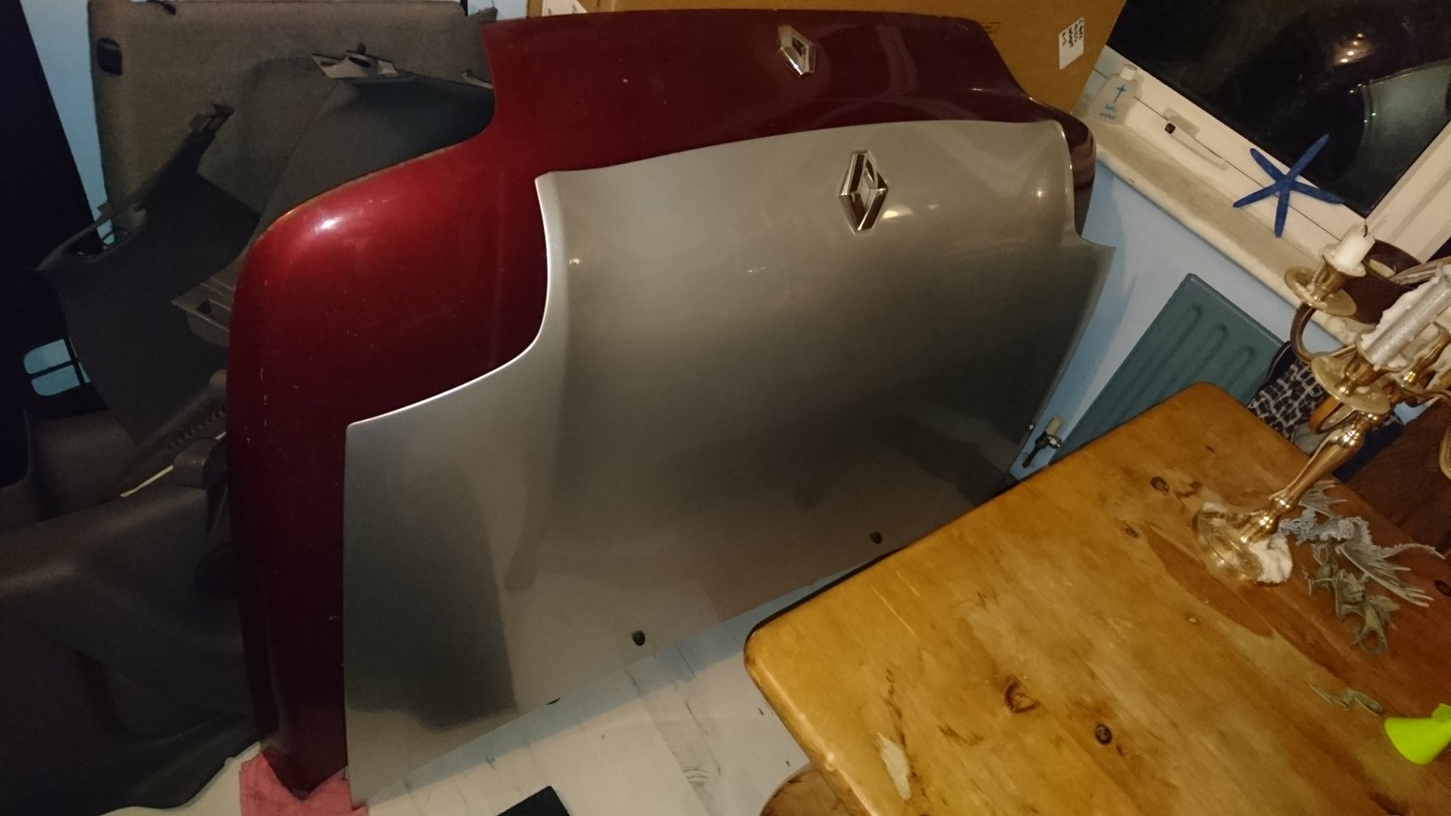

And also picked up an aluminium bonnet and couple of other bits from @mintno1 steering wheel to get snappy'd included :)

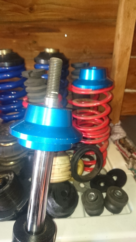

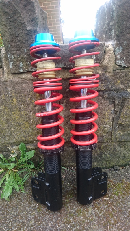

Top caps for da coilovaz haz arrived, in a very fetching blue colour........least they'll be hidden!

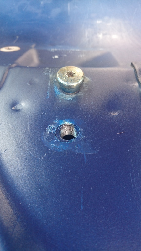

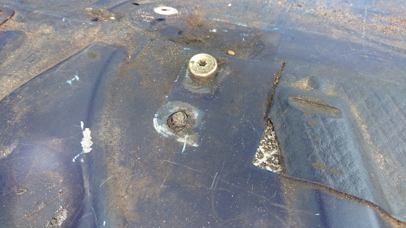

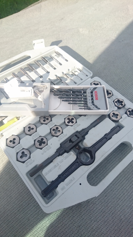

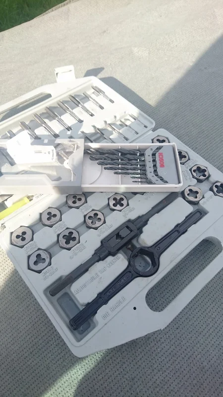

also finally managed to drill out and retap the bolt for the rear seats, what a nightmare that was, I swore, a lot, in fact i'm swearing in my inner monologue still.

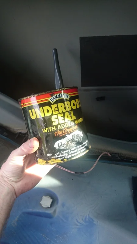

and then smashed some underseal down the inner sills now the two coats of kurust have set
Top Caps here
Drill and retap complete
underseal smashed

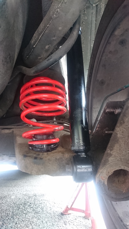

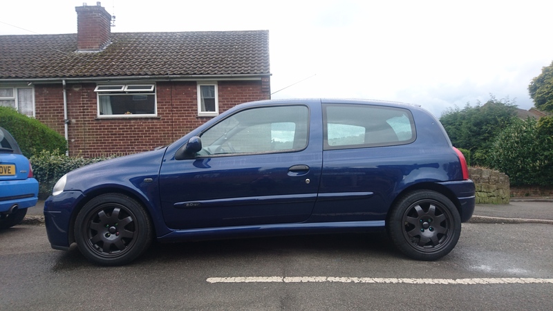

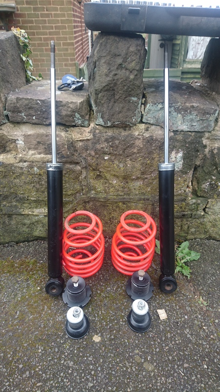

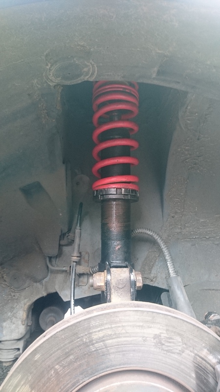

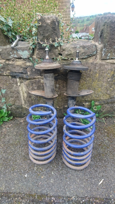

Coilover fitting today!! yeeeeeeeey lol!

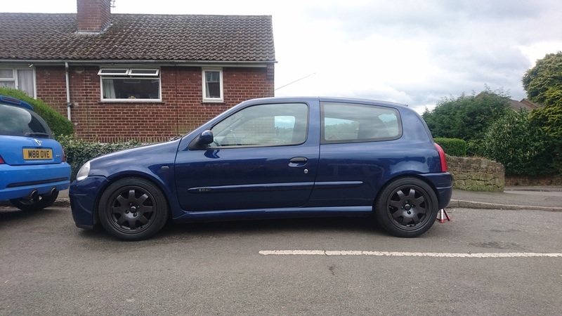

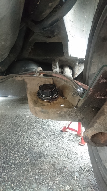

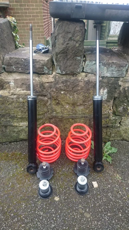

simple job really, just unblolt old, set new and fit. Went for as low as they'll go with the rear adjustment platforms still in and front left as they were when I got them.

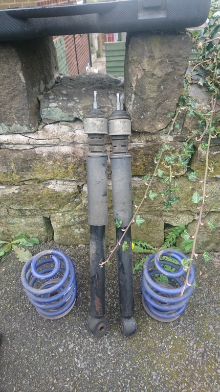

so out with the old
in with the new
rear platform lower section bolted in to rear beam
spring and shocker fitted
front strut assembly fitted

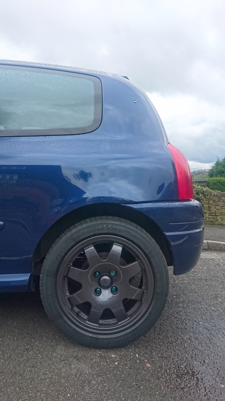

and before, with arch gap:
after, less gappage!

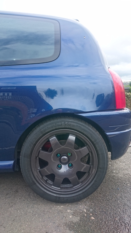

happy with how its sitting currently and once the rear interior and spare etc are all refitted the rear will sit a bit lower, at that point I will then lower the front to match, like to keep a small amount of front rake on the car :)
couple of close ups of arch gaps before and after:
front
rear
cheers

The before pics it was on h&r's which sit about same as sportlines but the rear interior is out so looked high! Tractor spec! Lol!

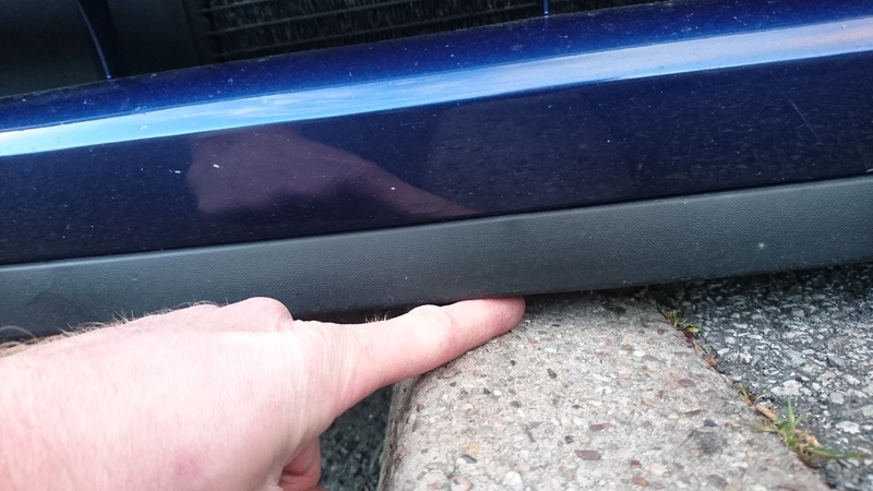

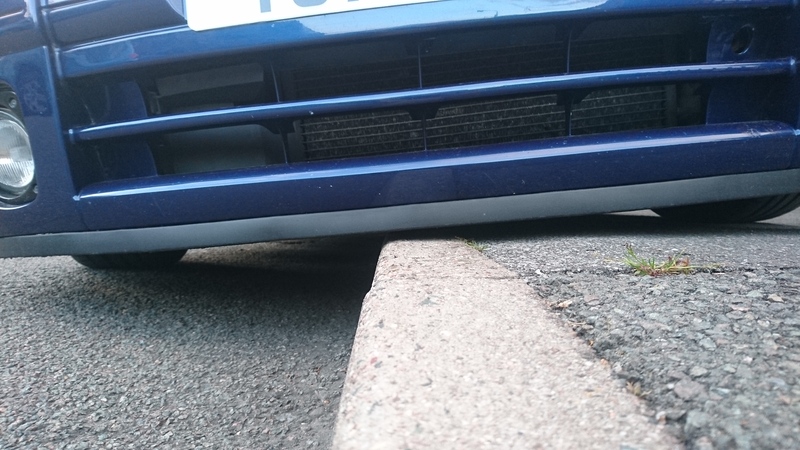

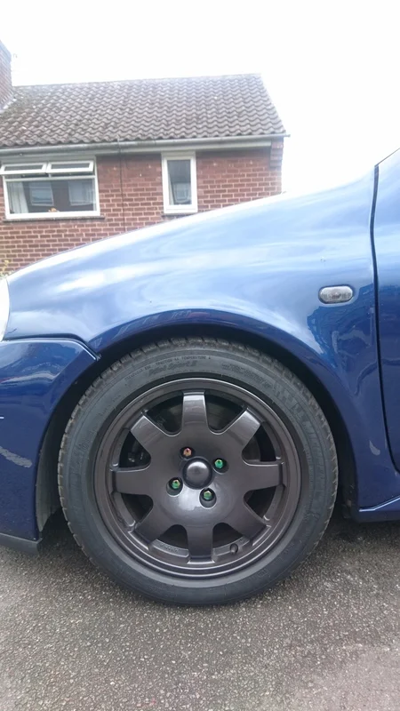

Small update, I put the interior back in a wound the fronts down another 10mm to match, but didn't get any pics

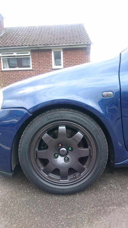

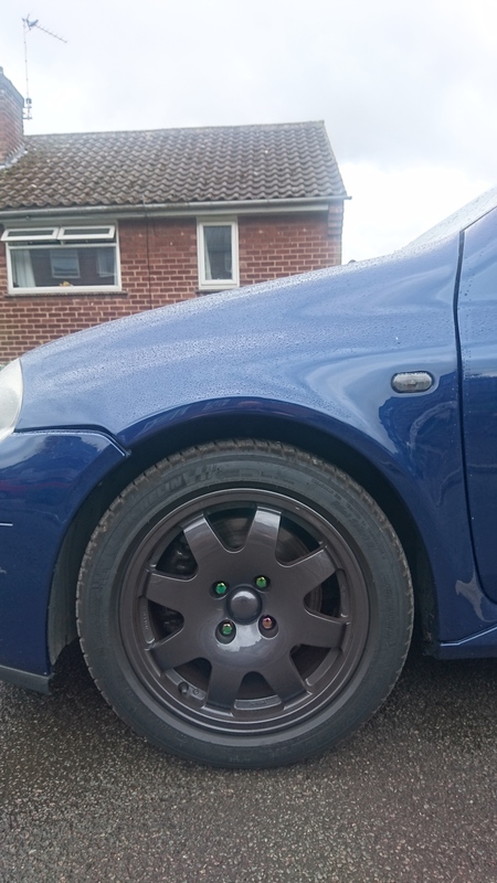

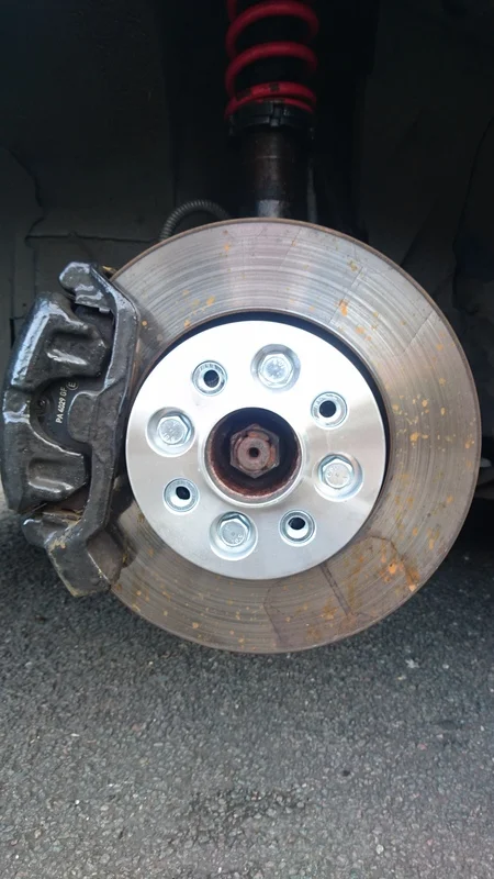

I have some 20mm front spacers coming to get the front wheels sat right on the lip of the arches

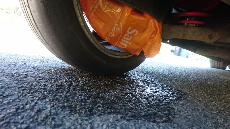

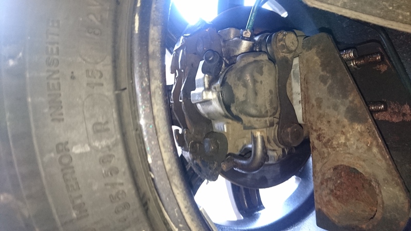

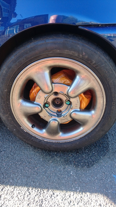

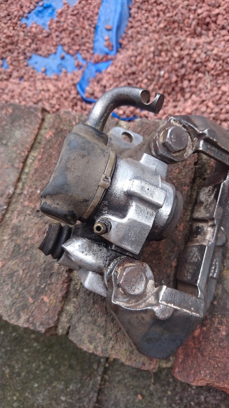

and then this happened.......so new caliper on order!lol!

Well
new caliper fitted and bled up, so got my brakes back and car is useable again!
then stuck the 20mm spacers on the front too, so its stitting tight to the arch now. will get some decent pics after she's had a bath!
