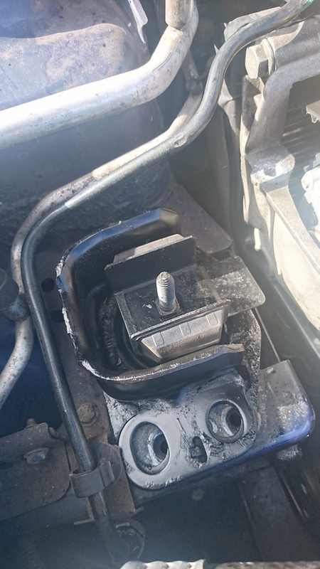

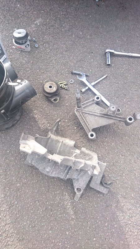

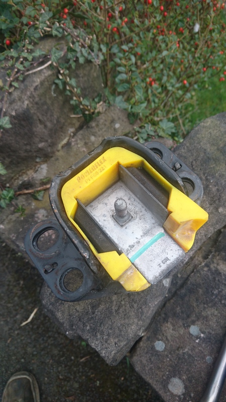

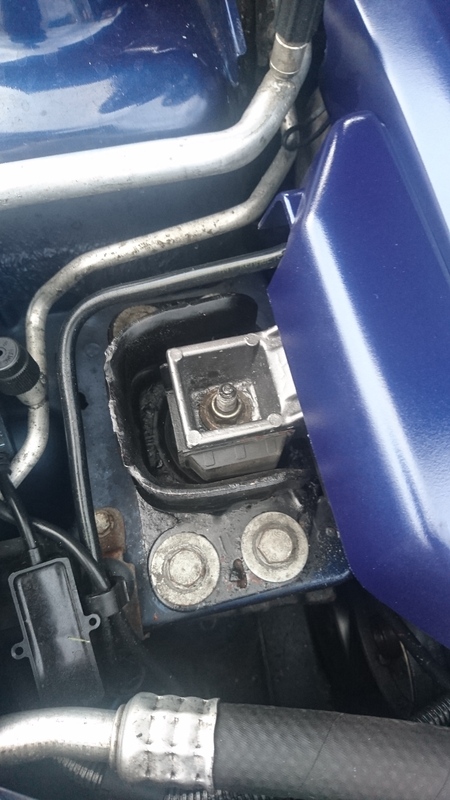

First job was to remove the solid engine mounts, engine side, gearbox side and dogbone
in bits:

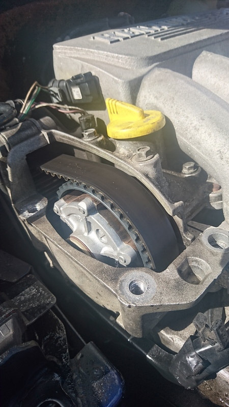

Dephaser looking pretty new
Standard mount going on
Didn't get any more pics at this point but back together again! Refitted a few missing bolts from loom and power steering pipes so all secure again too :smile:

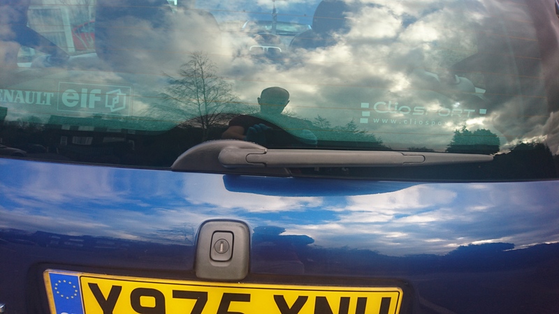

Then took an easy job on and fitted the painted (satin black) rear wiper trim and popped the wiper back on, much better!

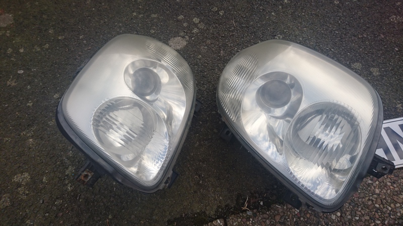

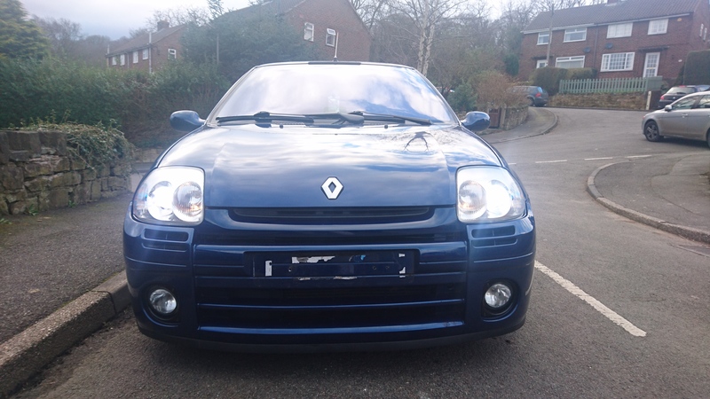

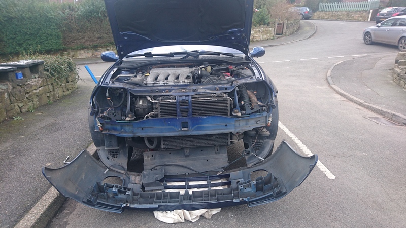

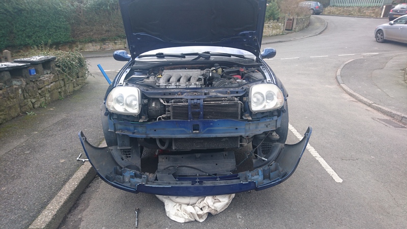

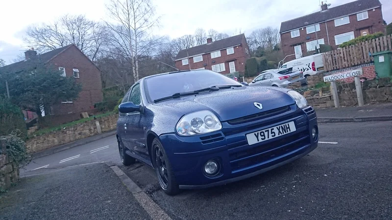

Next was headlight swap for ones I bought other day from @Akay which are in much better condition, believe they may of been on @Phase1sr 's old phase 1 back in the day before he fitted new.
So bumper off first
old hazy lights off
front end in bits

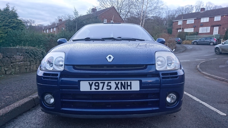

then once again no pics as I was progressing, just cracked on and also refitted the fogs after painting the surrounds in satin black also. The new lights came with low beam HID's as well so kept them and the silvertec is it indicator bulbs? either way just boshed the lot in!

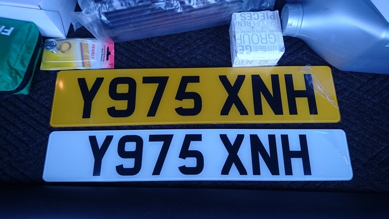

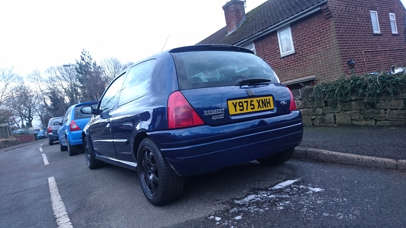

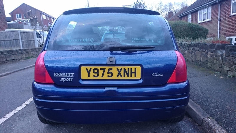

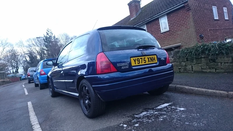

Next job was to finish the freshen up with new plates, decided to go for the 3/4 front plate as well, although i will get a plain standard size front plate at some point also
Fitted front and rear

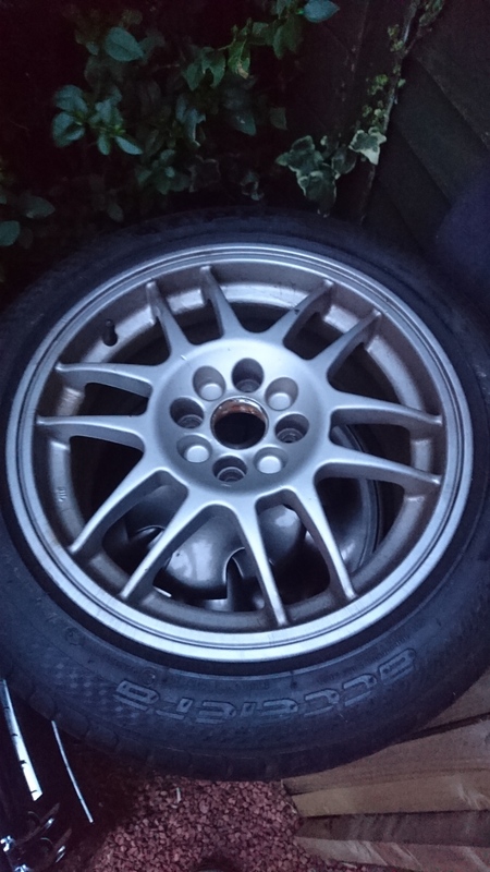

What happened to the OZ F1 wheels? Am I the only person that thinks Williams wheels should stay on a Williams Clio..
Yes yes you are ;-)
They're not going anywhere I just hate them so they'll go back on be car when I sell it. I hate them nearly as much as 2118's

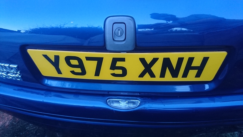

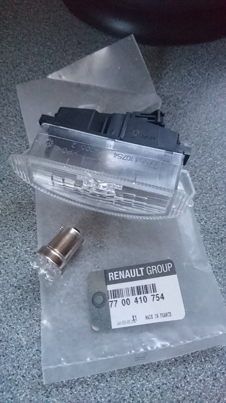

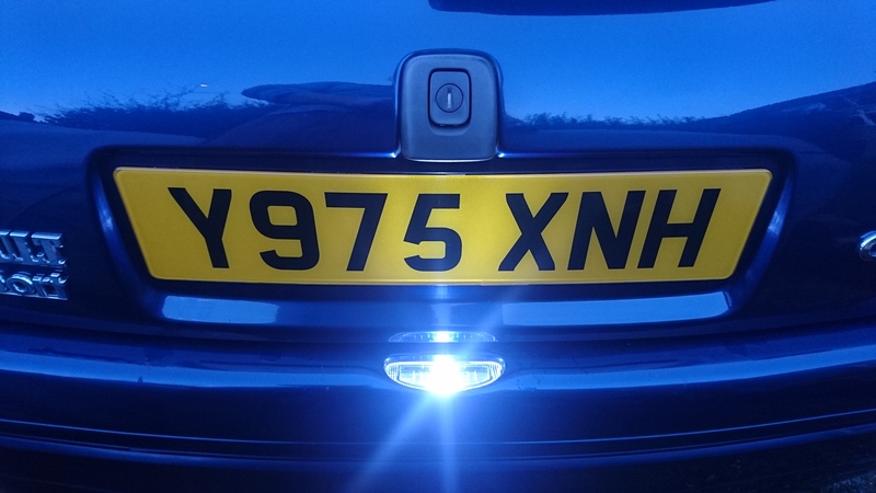

First job, bought a new number plate light and LED bulb, so fitted that:

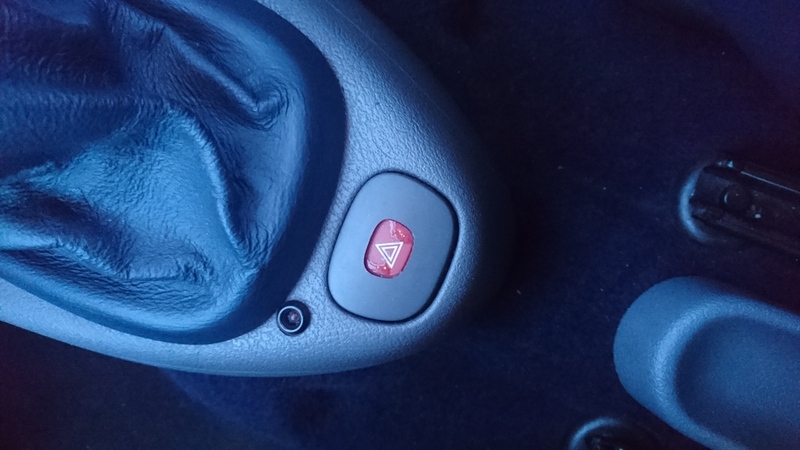

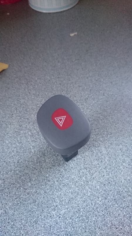

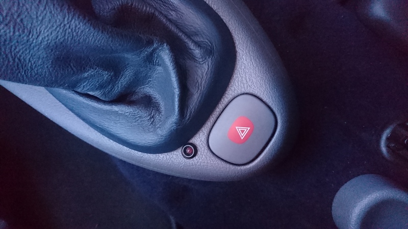

Then got a new hazard switch as the old one looked off, recessed indicator and all covered in glue or something, so had to go

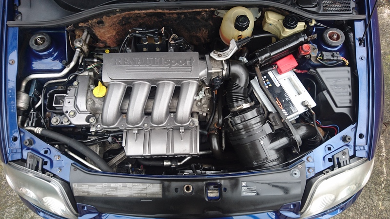

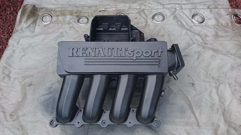

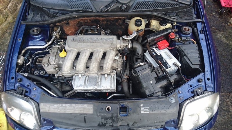

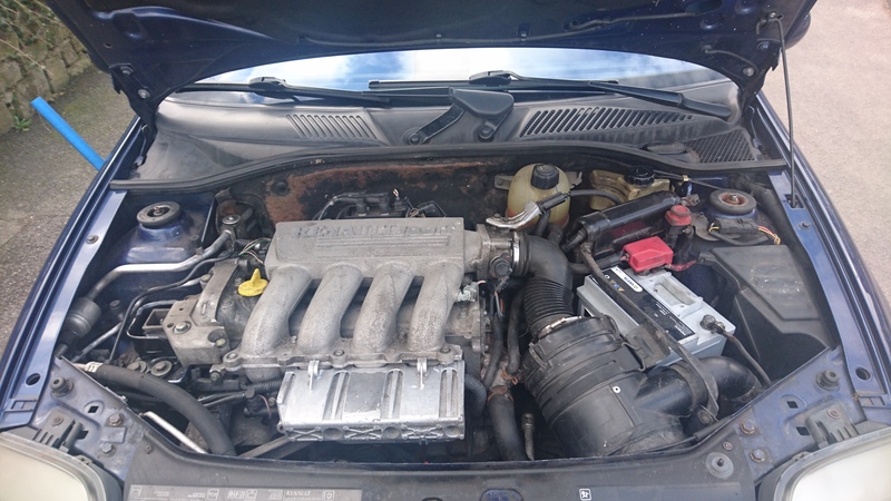

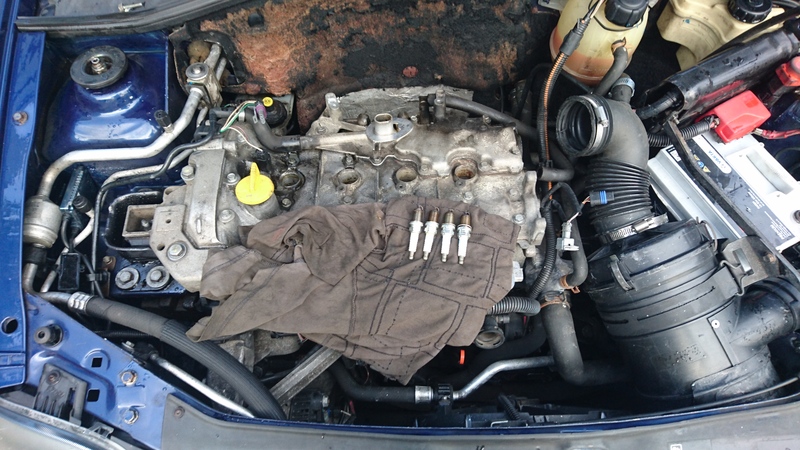

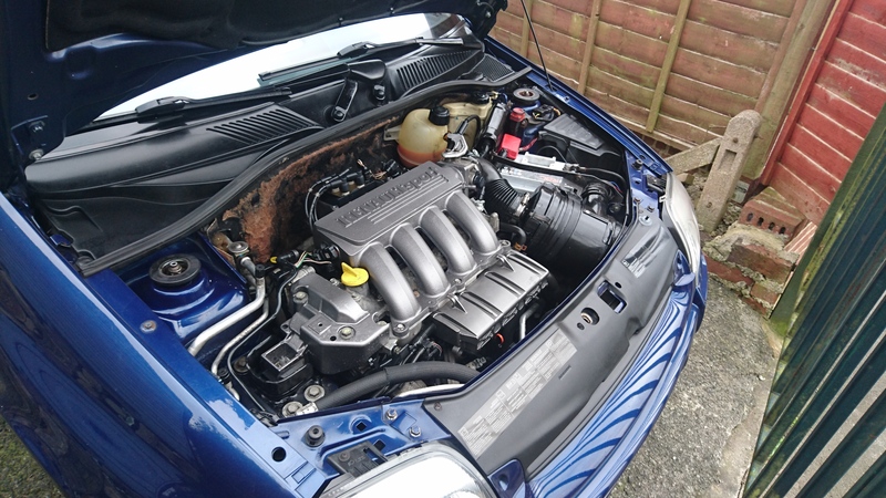

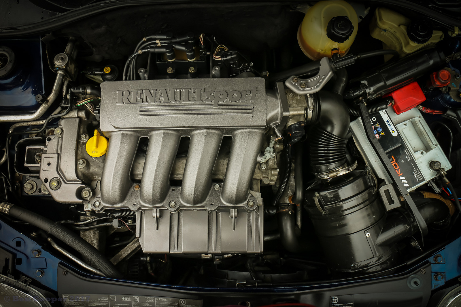

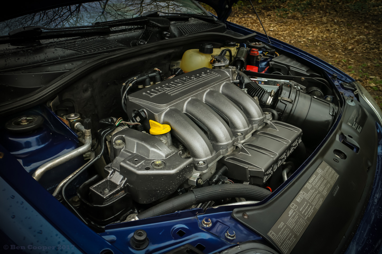

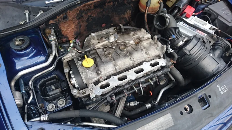

Next dug some grey alloy wheel paint out the shed and removed the top inlet, fuel guard and cam belt cover from the car, I have another set of phase 1 stuff in the shed I will send off for vapour blasting back to original but for now fancied some colour (kind of) under the bonnet.

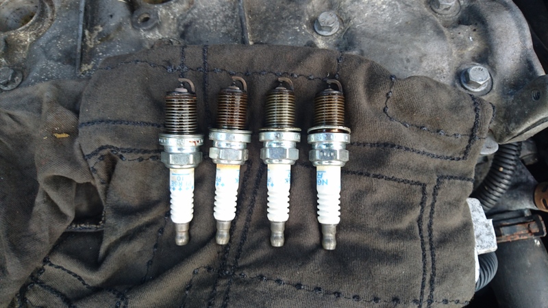

whilst the inlet was off I checked the ignition system over too, plugs, leads and coil pack all in spot on nick so no concerns there at all, happy! Fuelling looks good to from the deposits on the plugs, nice light brown and equal across all four. No.4 pot had the usual oil on threads from the over exuberant top ups but cleaned off and sorted
off and plug check
painted
and fitted, much fresher
the rear heat wadding had gone all brown as well like they do, so I just grabbed a can of VHT black paint I had in the shed from doing the exhaust manifold for the track car and sprayed it black again, looks good enough for me tbh and miles better than all worn, as you can see here looks much better!

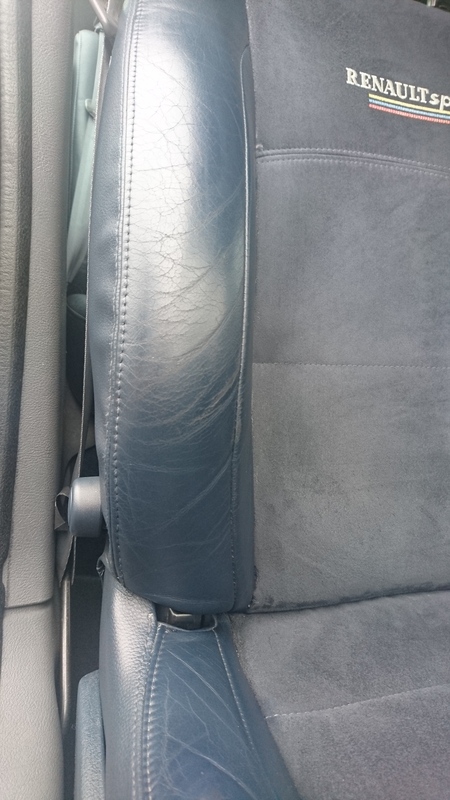

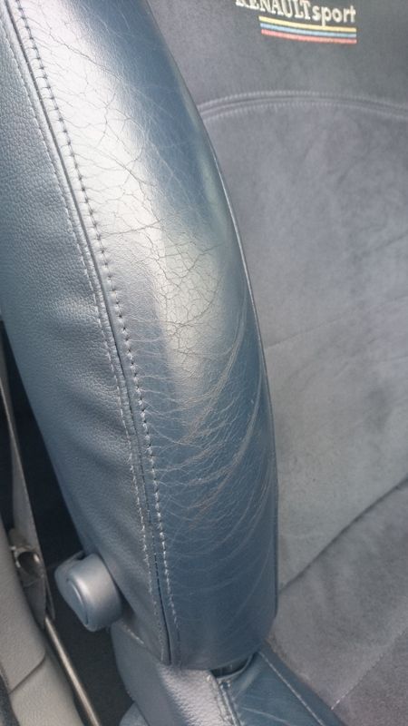

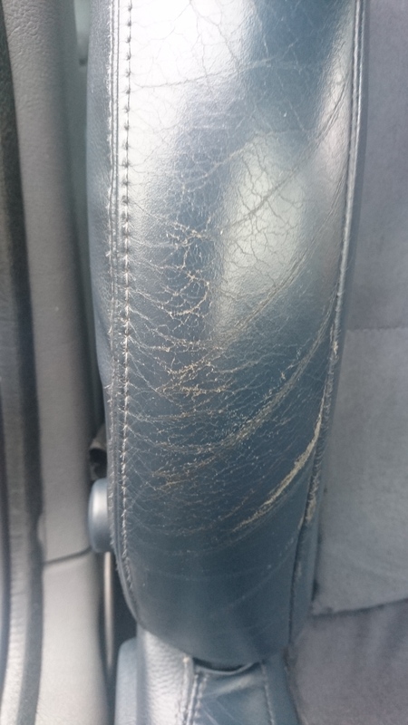

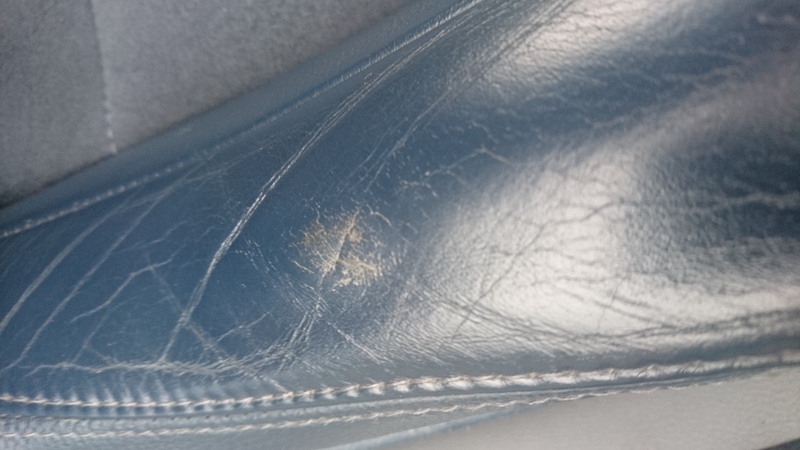

Then used some blue leather dye to bring the seat bolsters back up, needs a few more coats but looking decent imo!
Before:
After:

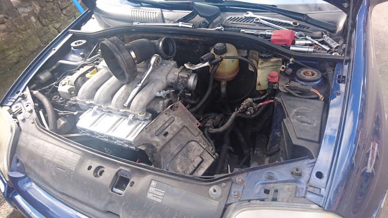

I'm currently doing a few bits on my engine bay, its very time consuming, mine is currently in pieces!
I just need to pain the cam cover & the rocker cover and then I'm done......for now!

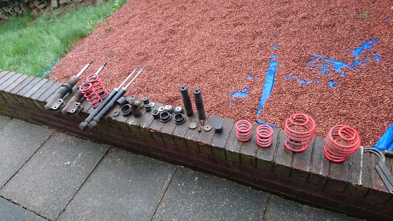

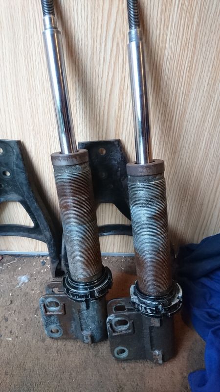

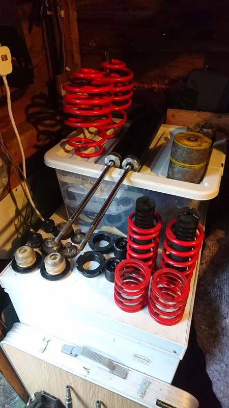

decided as its not a daily car currently, I would add some more bolt on mods for a giggle, so acquired some vmaxx coilovers for next to nothing. Not exactly great suspension but aim here is just to 'go low' for a bit as imo phase 1's look mega on their arses!
dismantled them when I got them and gave them a good clean up. will also give them a lick of paint before fitting!
in bits:
and cleaned up, ran the threads on the front as well top to bottom to clean them off. I will then set to the right height, grease under the platforms at that height and paint the rest to keep it looking neater.

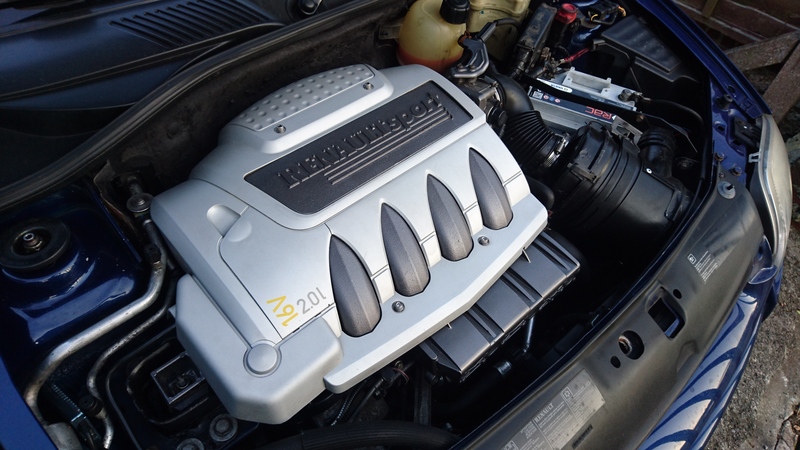

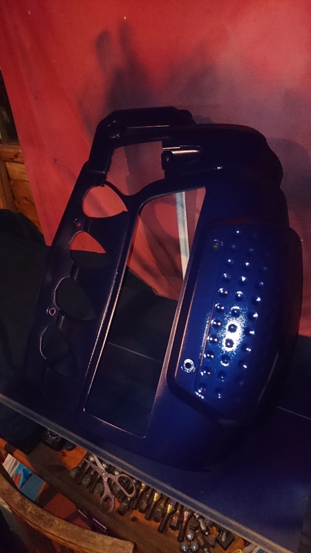

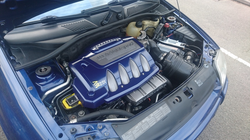

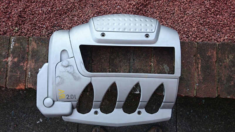

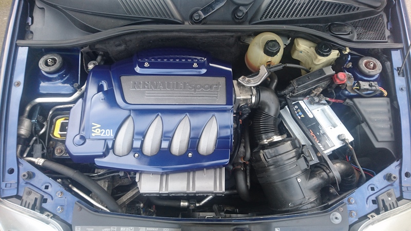

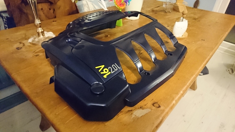

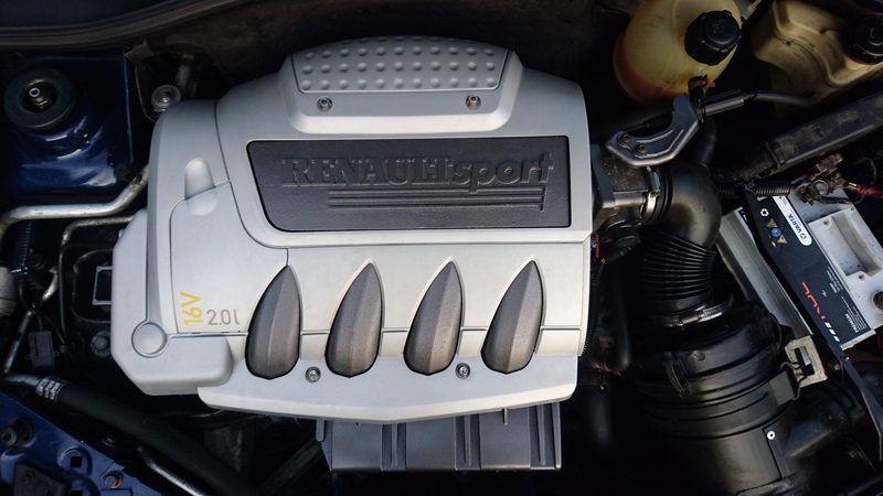

Got hold of an engine cover in decent nick, so fitted that with stainless bolt kit
fitted, excuse the lack of ECU brackets, off to be painted after the ecu swap other week!

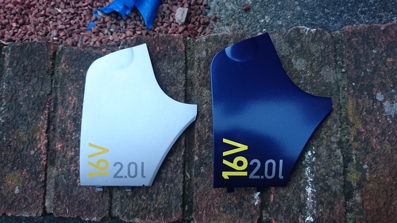

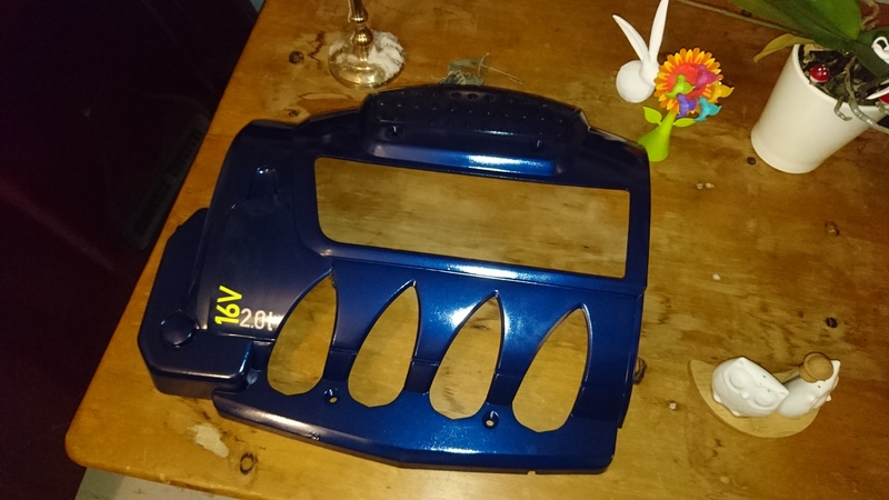

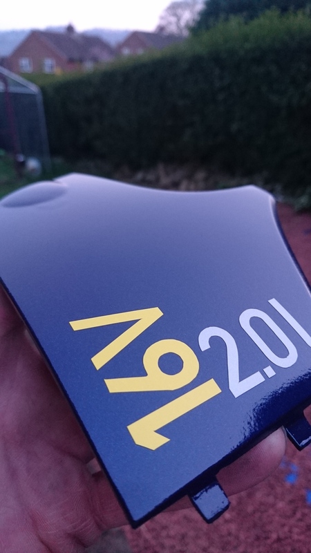

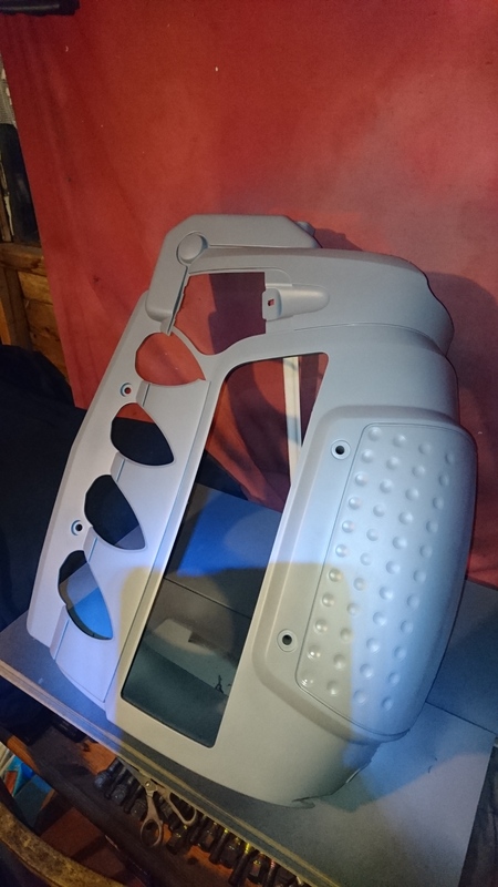

Then decided I reckon a colour coded cover would look better, so whipped the ropey one off the RB, swapped the oil cover flaps as one on the cover off the RB was better than new one, so made a 'good' cover and then painted up the ropey one in Odyssey. not the best job but cheap and cheerful and looks okay. Had the 2.0 sticker ready as well so easy enough to crack on and sort. It's now sat inside the house, curing to fit at the weekend more than likely.
Cap painted with sticker
and cover done

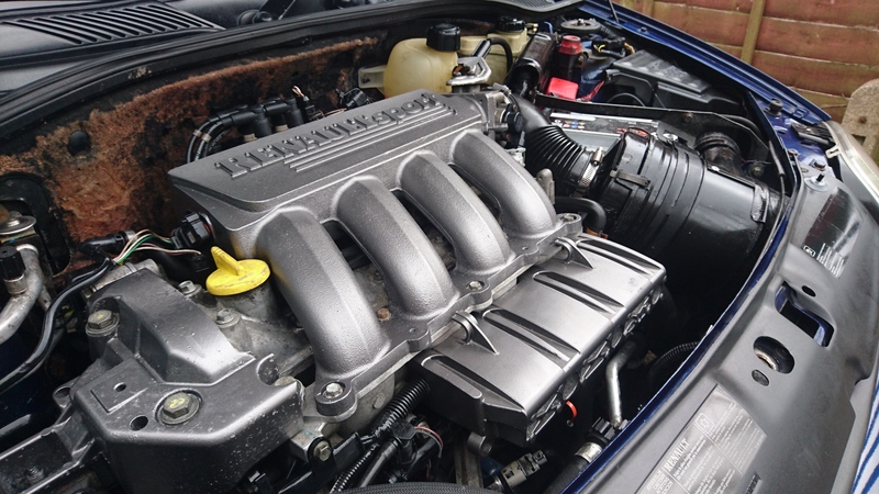

More progress today now the nights are longer!
I want to clean the arches etc when I fit the coilovers so decided against fitting them today but did the rear axle spacers and top engine mount insert though so that's done!

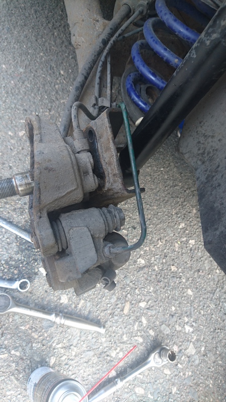

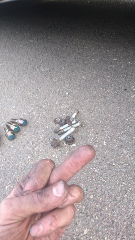

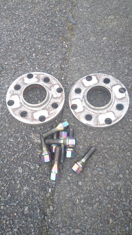

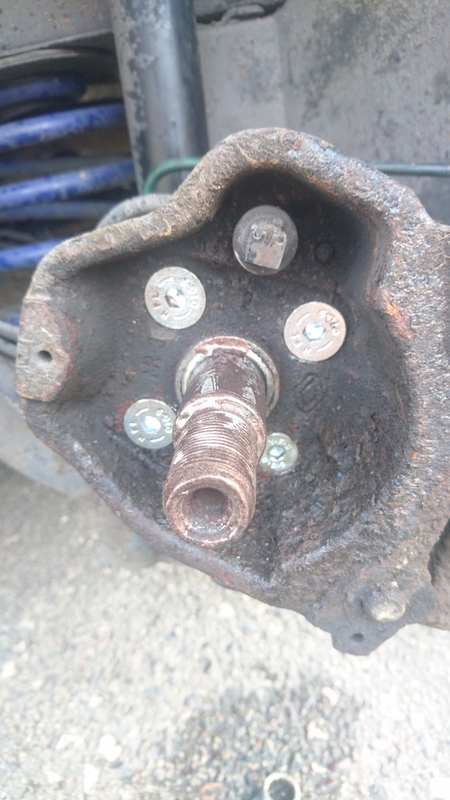

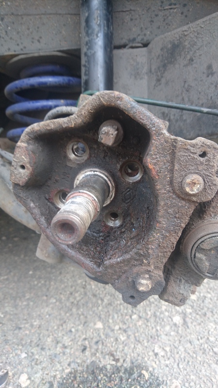

so today, horrible job of rear axle spacers as the torx bolts holding the hubs to the axle are a bugger to get out without rounding them, sensibly took my time though and they came out okay on both sides, no angle grinder needed!!
Bolts out and hub loose
New stuff to fit, 10mm stub spacers
Fitted

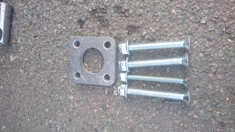

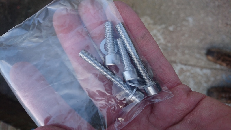

15mm eibach hubcentric fronts and longer tpi bolts, from stock in the shed ;-)
Then no mount insert
Mount with insert
Fitted with new engine cover as well
And how it sits now, so that's 15mm front spacers and 10mm rears and wheels are ET36, should look spot on once loose the arch gap with the coilies...woop woop!!

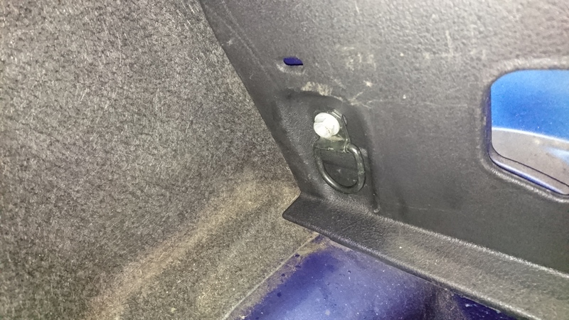

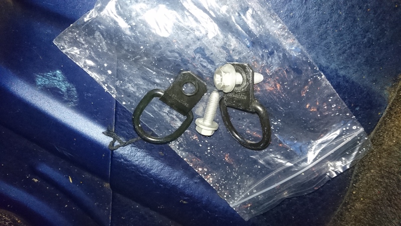

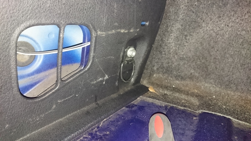

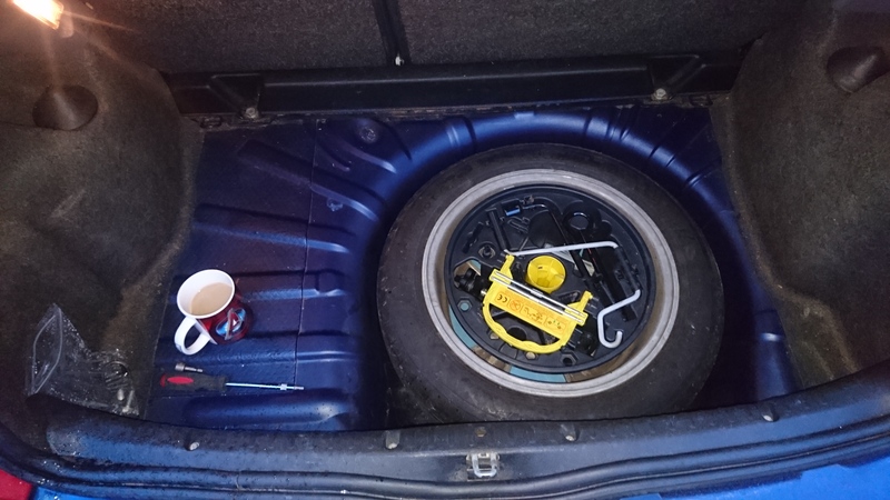

Also received and fitted the boot net loops that were missing, removed the spare to add to the 4 other F1's from the car to be Powdercoated at some point

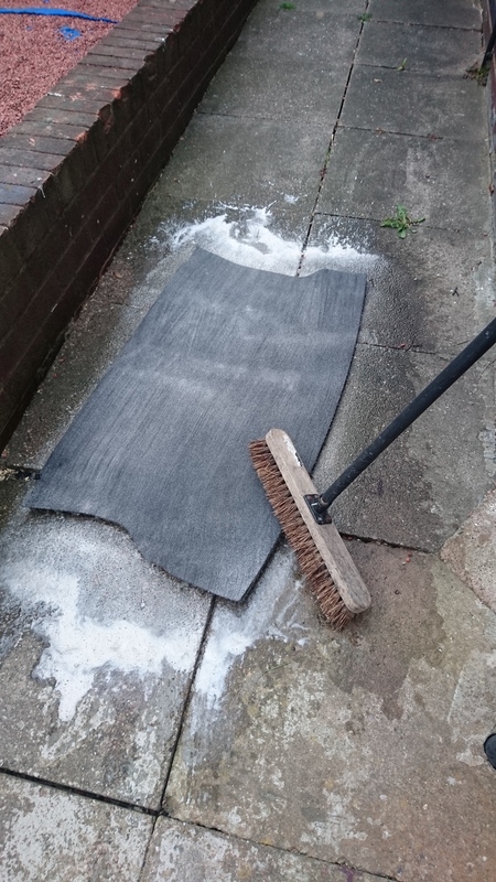

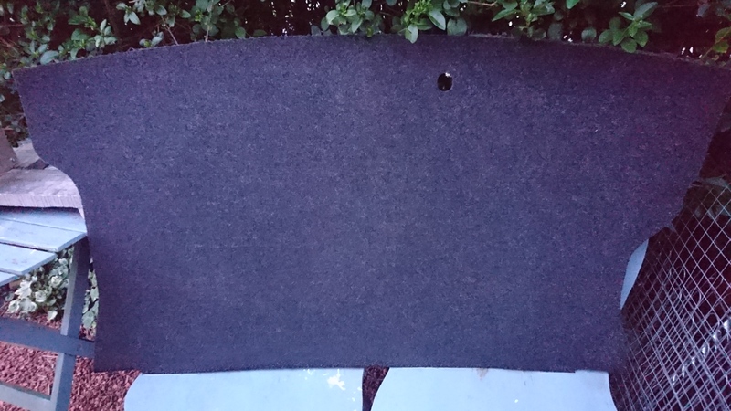

and I then removed and cleaned the boot carpet as previous owner has had a dog in the car and the boot is covered in hair and smell......interesting shall we say!!lol! nothing a stiff brush, few litres of H2O and some fabric softener can't sort :)
anyway, more pics!!
wheel out
carpet out
scrubbed
and clean!
and boot loops recived and fitted
