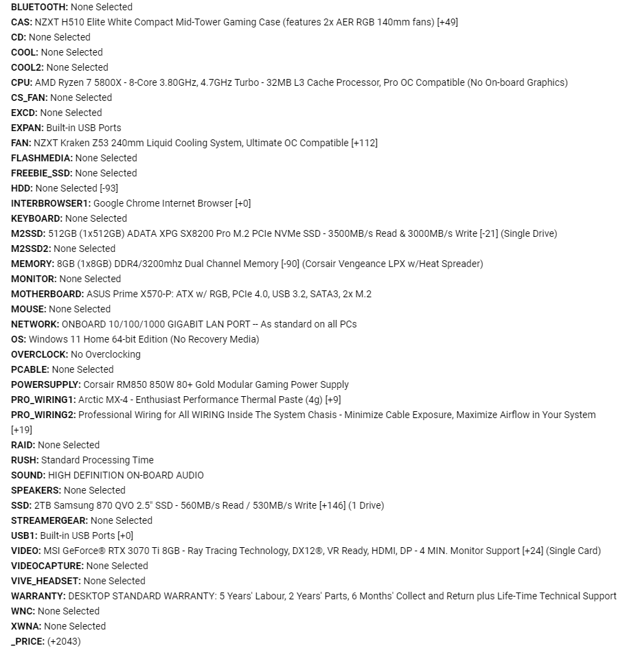

Guys would appreciate your opinions on the below spec, £2300, its for my lad, only sticking points are the case, he wants that one, needs to be 3070, and Ryzen 7 5800x, everything else i am open to suggestions, case has 2 x 140mm front fans, and the cooler has 2 x 140mm so cooling shouldn't be an issue i don't think, he isn't graphics heavy really, it's all about the FPS and speeds for him, he is buying himself a new monitor which will be at least 1440p and 165hz.
Ignore the Ram, he has 32gb 3600mz in his current pc i will swap over.

I'll leave more knowledgeable types to comment on the rest of the spec, but that memory doesn't look right to me. Is that saying 1x8GB stick of memory? So it wouldn't even run in dual channel mode?
For the processor and GPU, just 8GB of memory in single channel mode seems like a massive bottleneck. I'd be going with at least 2x8GB. (I've just gone 4x8GB with the same processor myself, but that's probably overkill)

If you are not going to overclock it then why bother with a X570 motherboard? Also, why get the 5800X instead of the 5600X? Also. The specs are baller yet you've not selected an m.2 NVME drive? You should bin the old HDD and replace it with a sata SSD (Big volumes can be had cheaply now) and replace the sata SSd (Which will have the OS on) for an NVME one.

He may well overclock it at some point, and he currently has a 5800x so didn't want to go backwards really, i am not 100% on how the drives work, i thought you normally has SSD for windows to run etc then a hard drive for game storage?

I am a little stuck, as i am buying through Cyberpower, a 1TB SSD is £150, and a 4TB is £300?

@N0ddie , is this better?

The memory still hasn't changed though ; still 1x8GB stick by the looks of it.
Isn't it cheaper to get one large M2 SSD rather than an M2 and a SATA SSD as well?
I am using the ram from his current PC mate, and it won't let me spec with no ram, so just done with the cheapest, i thought it was best to keep the drives separate for the operating system and games?

Fair enough on the RAM. So long as you've got at least two matched sticks you should be fine.
As for the drives, I don't think separating content provides any benefit and you want both the OS and the games on the fastest possible device.
Only time I'd want a separate drive is for huge content where storage costs become stupid on SSD (e.g. 10TB of films and TV is better on a spinning platter than it is on an SSD for cost, and probably better outside the PC on a NAS of some kind).
I'm just running a single SN850 1TB for my OS and games and it flies.

Yes he has 32gb 3600mhz now, so they will go in the new one, maybe something to consider then, ditch the SSD and just get a 2TB M2...
