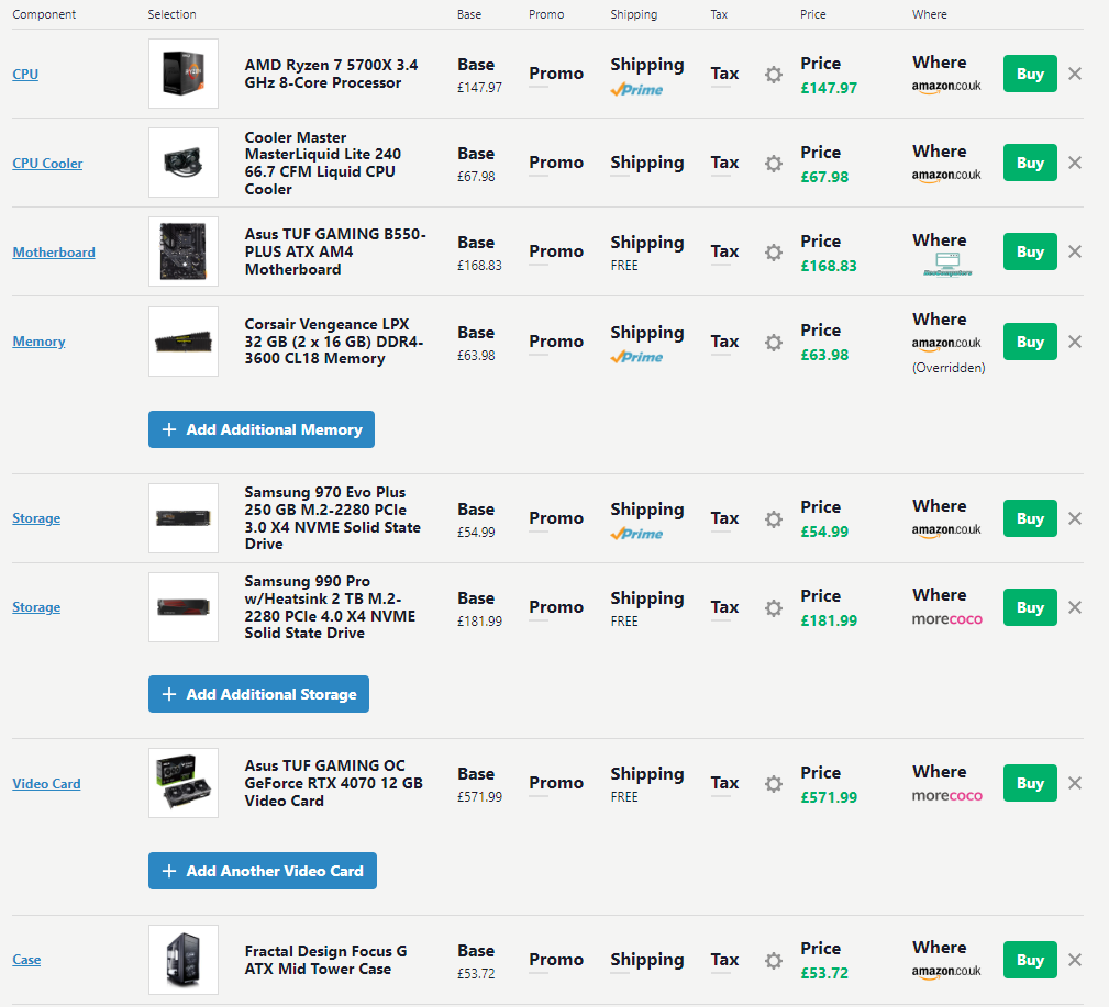

Thank you, so just added it to my part picker, says its OK. Will do the 990 pro.
One other thing I know everyone said wasn't necessary but still not sure on another 250gb separate storage just for the OS.... in my head it makes sense that if I ever have OS issues and have to reinstall, to have it separate to my apps makes it a no brainer.
What am I missing?
What am I missing?

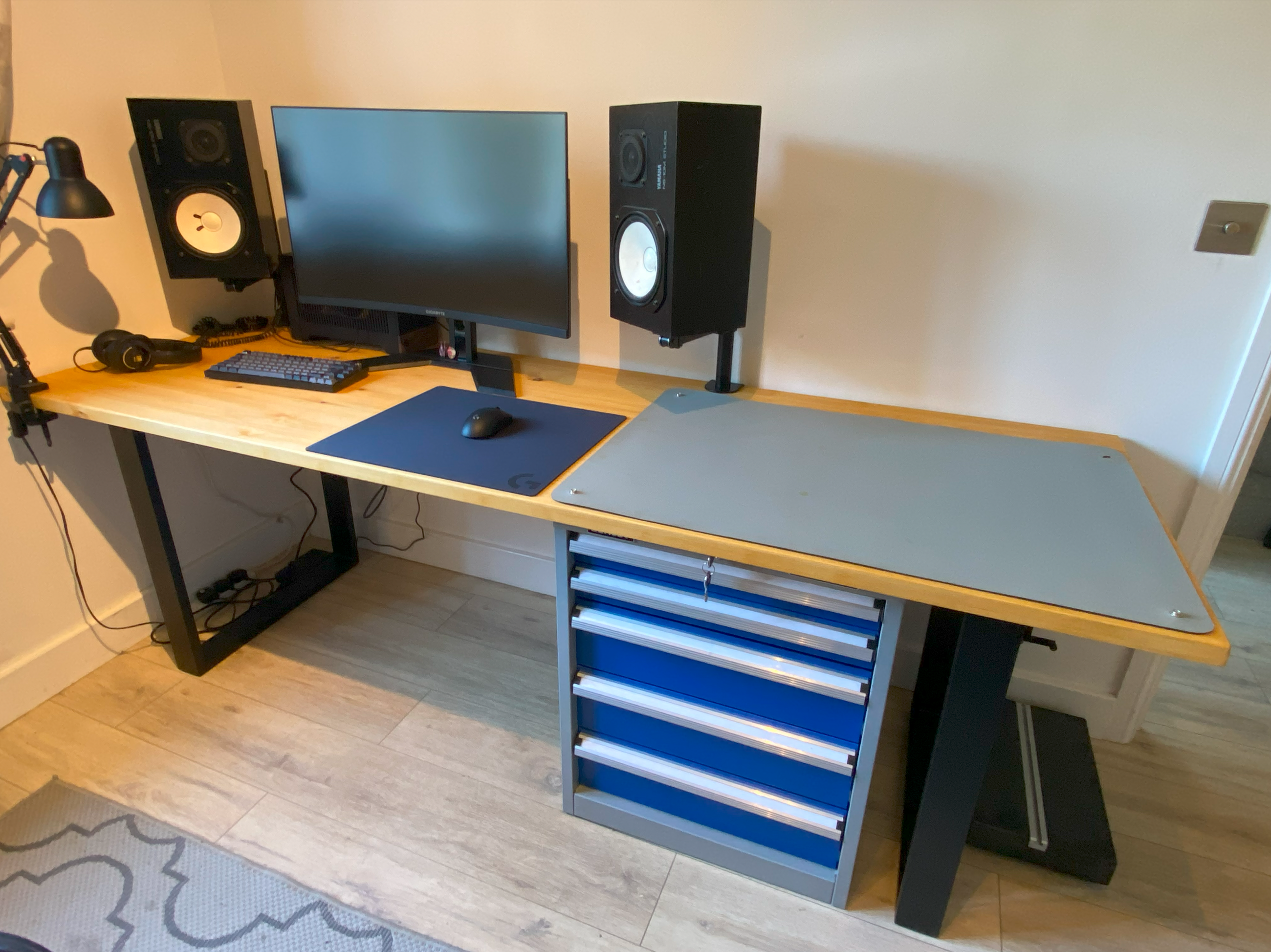

Setup almost done. Bought some monitor arms for the speakers, need to buy some steel sheet to bolt to the arms as they are just resting at the minute! Problem is I have a 2u amp for the speakers that I want to keep tucked away so I'm thinking of fixing to the leg with a rack mount.

So that was the 990 pro? (don't fully understand all this)
That is what I have on my list. Just waiting for pay day to roll round and I'm going to pick the RTX4070 and storage. Then I'll get it built. Quite looking forward to it, especially as in the past I would have just credit card the lot in one go and got it done, buying it in bits and have it all sat there in boxes has been hard for the last few months.
This is what I went with in the end (still not sure on the separate 970 Evo for the OS. I think its just me being old and having it drummed into me that you always keep the OS separate from your apps.
Quite the opposite really.
Just get the biggest and best NVMe drive you can and chuck the lot on. The established commercial benefits of having a smallish server OS drive and then having a large drive for apps or log files makes sense. But in a home environment - not so much. Unless you're @SharkyUK ... ;)
With the drives above, personally I would sack the 970 off unless you like to store files or photos away from your main drive. Otherwise, I'd just stick with the single 990 Pro. And certainly don't be installing your OS onto a PCIe 3.0 drive and then have your games on a PCIe 4.0 storage device.
If you want to save about £30 also - Scan have the Asus ROG B550 mobo in at £139. It's the one I have and it's great.....
However.... there's now the whole argument of going to AMD's AM5 platform as that's the new standard from them - and not really a great deal more expensive. The Ryzen 5700X you have listed above uses the older AM4 platform. Still good - still capable - but I'd argue that if you're buying new from today - I'd personally make the step up.
That also gives you the headroom into the new Ryzen CPUs, and DDR5 memory support, instead of the AM4's DDR4 standard. As you can see - there's sod all difference really in price between this mobo and the one you selected.
The financial hit will be that the newer Ryzen's will be a bit more costly as will DDR5 memory. But it is future-proofing you better.
