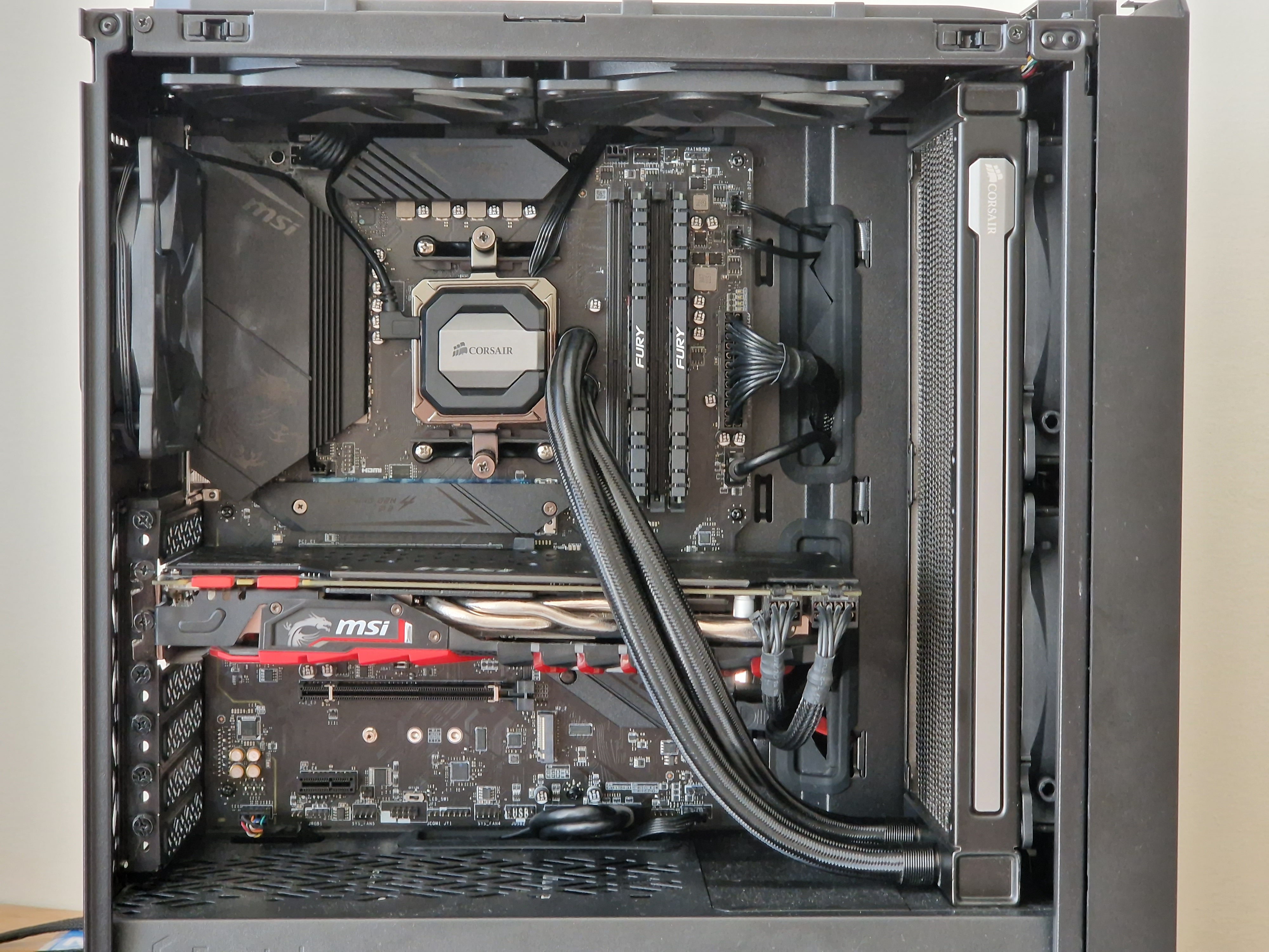

You running a 240mm rad right? Usually it will come with 8 long screws and 8 short screws. The long ones can either just attach fans, or go through the case and fan as well to mount the radiator (sandwiching the fans between the radiator and case). The short ones are just to mount the radiator to the case if you have your fans on the other side.
If it's fouling on the heatsink you can try putting the fans on the bottom of the radiator instead of on top, that might give you more clearance. Or mount the radiator at the front of your case and use it as an intake, like this.
Anyway, take a photo of your rig and post it so it's clearer what the issue is 👍🏻
mace¬
  Clio
Will get a picture tomorrow but I have it mounted like that picture, case->Rad->Fans.
I'm starting to think I might have used the screws for the Rad to screw the motherboard down hmmmm. I can clearly remember two lots and I couldn't figure out why so just picked one lot.
