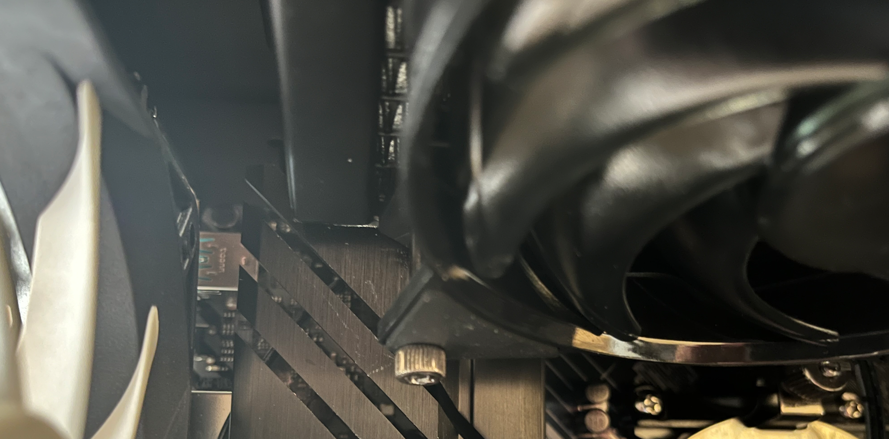

You running a 240mm rad right? Usually it will come with 8 long screws and 8 short screws. The long ones can either just attach fans, or go through the case and fan as well to mount the radiator (sandwiching the fans between the radiator and case). The short ones are just to mount the radiator to the case if you have your fans on the other side.
If it's fouling on the heatsink you can try putting the fans on the bottom of the radiator instead of on top, that might give you more clearance. Or mount the radiator at the front of your case and use it as an intake, like this.
Anyway, take a photo of your rig and post it so it's clearer what the issue is 👍🏻

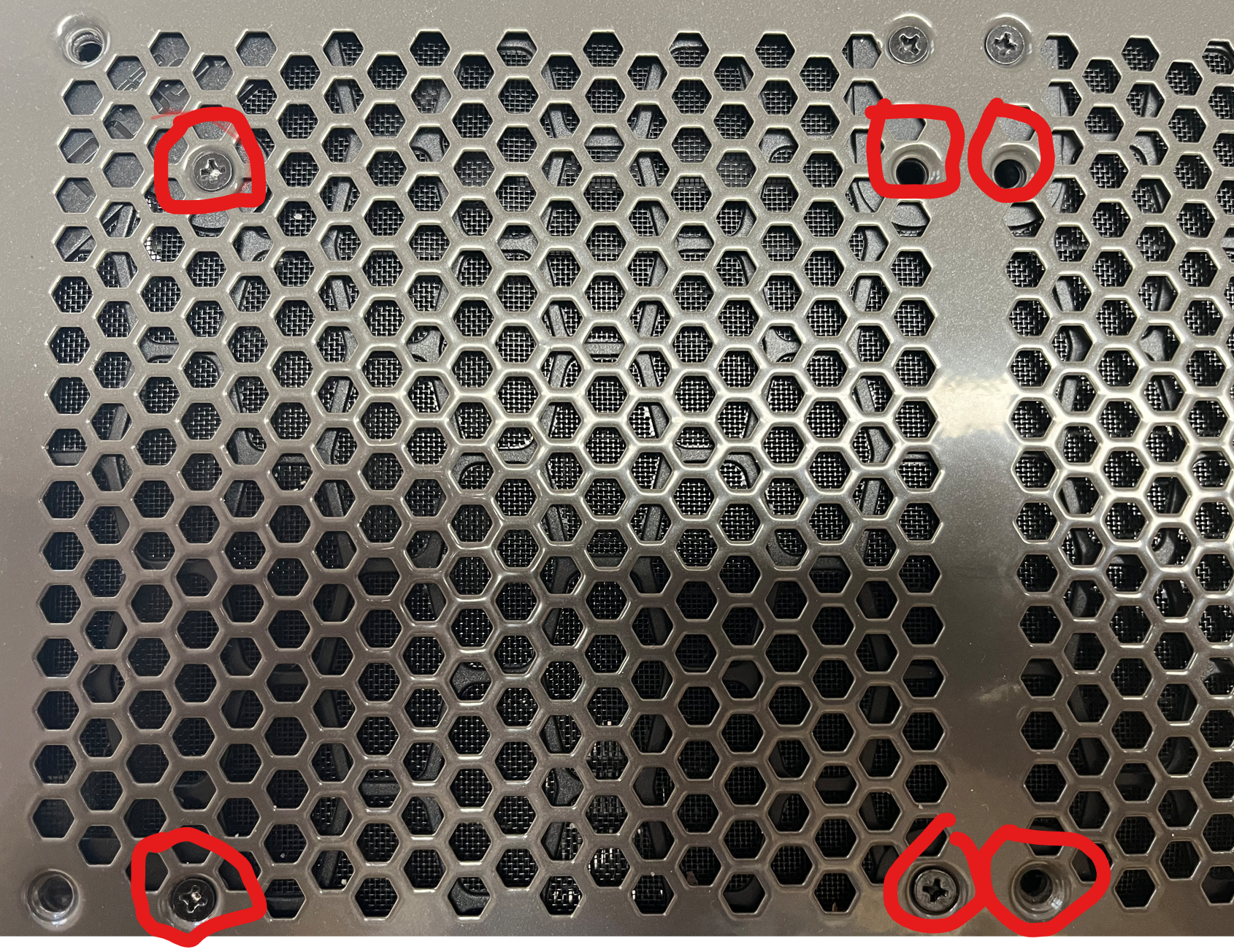

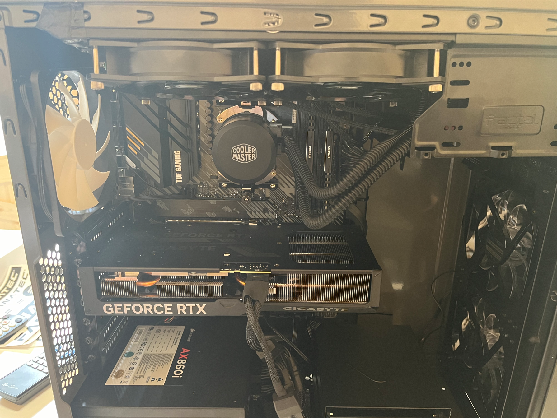

This is how it is currently configured. You can see my tape bodge fix in the top left corner to stop the rad sagging. Stuplid
I've tried moving the screws that hold the filter from the outside places to inside to match the Rad but they aren't long enough.
and you can sort of see it fouling the mother board here. (and yeah I might of scratched it a little but it only shows under the camera).
Shouldn't you have the top of the rad above the CPU? I would say flip it 180 degrees.
It can cause noise with the tubes at the top, there's always a little bit of air in the system so putting the tubes at the bottom reduces the risk of gurgling sounds. Neither are going to impact performance though, and both are better than having the pump at the top of the loop because that kills pumps.

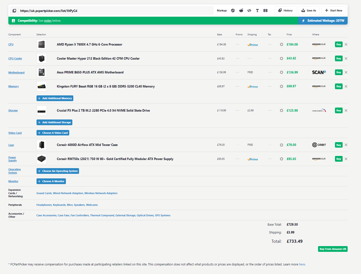

I always said to my nephew when he turns 12 I'll build him a PC and pay for it. Time bloody flies because that is now only a few weeks away! I did my build last year so just getting up to speed with the latest etc. I've always been team blue however there's no denying the fact how good team red are bang for buck, so I'm thinking of going down that route.
Budget is £1k all in for the PC. The peripherals and monitor other family members are getting for him.
Any suggestions/recommendations on the below? I'm not that familiar with AMD stuff. Monitor will likely be 1440p.
Looks decent... although I would probably just get a single NVME solid state drive. No real need to have one separate for the OS unless you have a very specific work need. I'm assuming it will be for gaming and entertainment, of course!
I would say try to go AM5 but I don’t know how achievable that is within your budget.
A normal 7600 will outperform the 5600X though.
Okay cool, will take a look thanks chaps. Any experiance on CEX for GPU's? They offer 24 month warranty and I can get a 6800 XT for £400

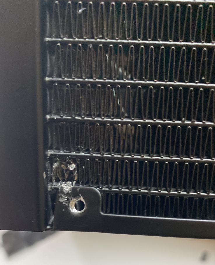

Well that didn't go to plan.
Nothing leaking. Be alright won't it until I get something that actually fits in the case?
Problem is, the rad is fouling a heat sink on the motherboard so I was trying a bit of brute force to get the screw to fit in the hole, moved the other way and went straight in the rad. There is no way it will align with the holes on the case
If I were you I'd give up top mounting it and stick it in the front of the case instead, while you've still got some fins left 🤣
I got a few screws in but the angle puts the last ones way off as can be seen. So it is fixed solid at the top.
It is powered on, not leaking so will that be OK now and just ignore the few missing fins? Not likely to fail?
Not sure how I would go about front mounting it. There is no obvious way I can see to fix it to the case? Needs to be screwed from the outside but no way to do that?
Just buy an air cooled one?
It'll be reet, you've only bent some fins.
Mounting in the front is the same as mounting at the top of the case, you'd attach it from the outside. Screws should go through the case, through the fans, and into the rad. You'd use the same holes that the current intake fans are using, obviously you'd remove them first.
What model cooler and what model case do you have again? You aren't doing something daft like trying to fit a 280mm rad in a space designed for a 240mm are you?
Yeah I can't see any reason why it wouldn't fit. f**k it, as long as it hasn't fallen off so far I'd say just leave it as is. It's not like you're going to be bouncing the case around 🤷‍♂️

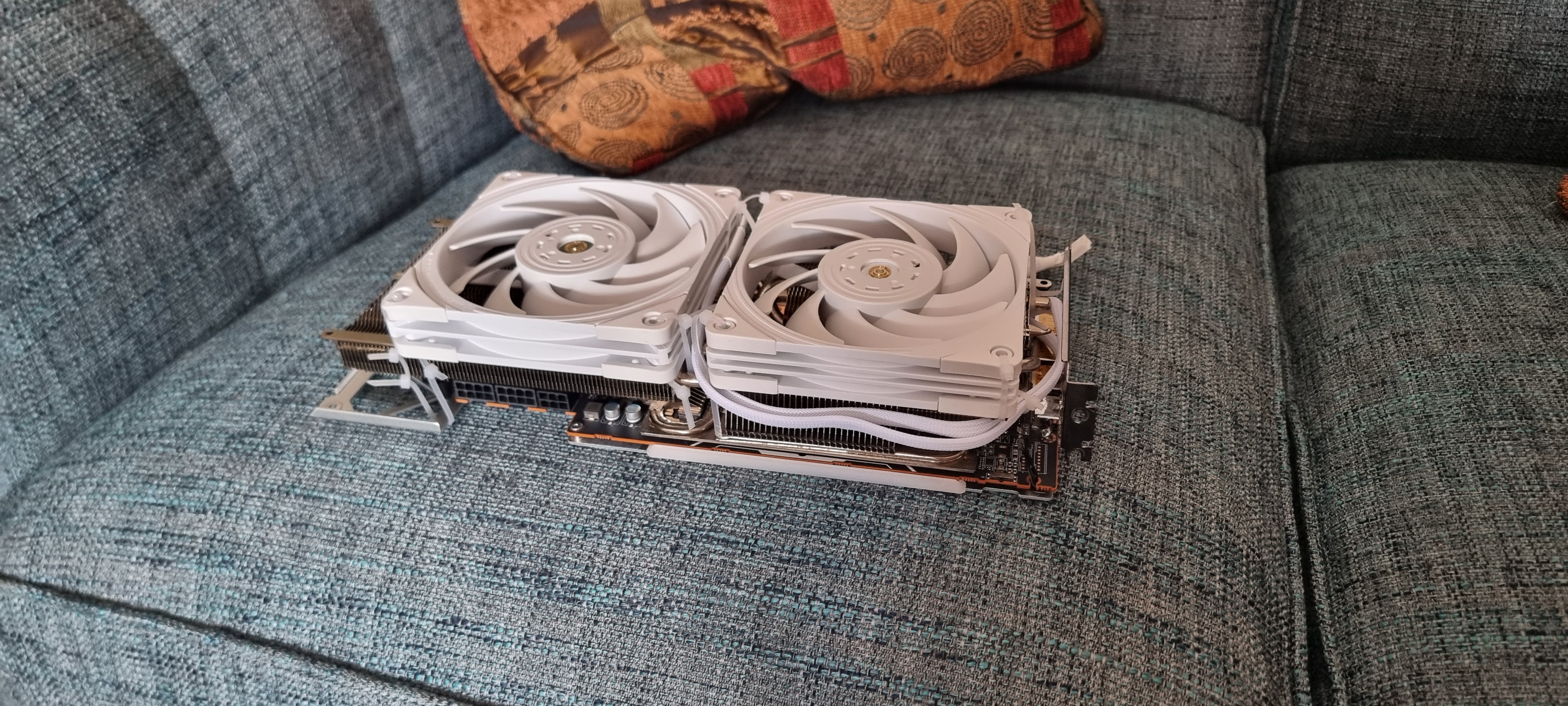

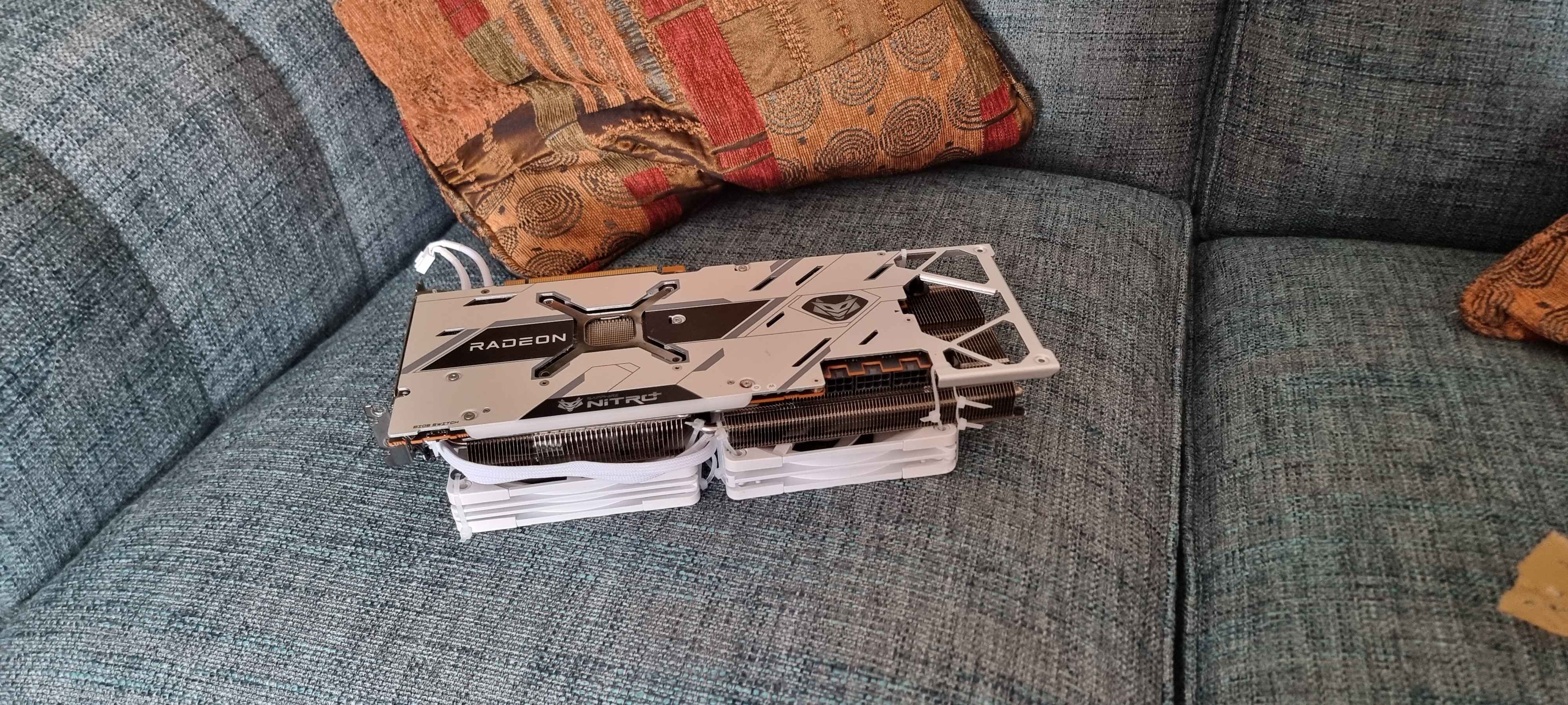

Huge shoutout to @Ph1 Tom for the 6900 XT (with custom cooling) at an absolute bargain price of £250. With the money saved we have improved the CPU and the nephew is absolutely delighted! Thanks again Tom for such a swift transaction mate :) (y)

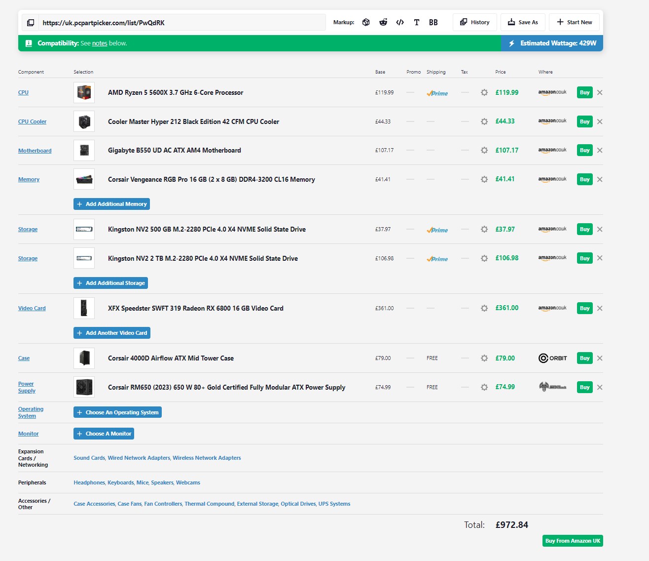

Feedback taken onboard and amendments made. Not a bad PC for under £1k all in I reckon :)
Any other suggestions before I pull the trigger?
