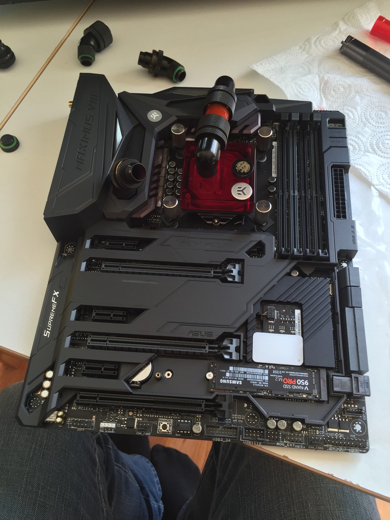

The Formula Maximus does, but its worth bearing in mind there is a fair speed difference between the 256GB and 512GB model (albeit it is more expensive ofcourse!) but that's why I went for the 512GB.
256GB Read 2200MB/s Write 900MB/s
512GB Read 2500MB/s Write 1500MB/s

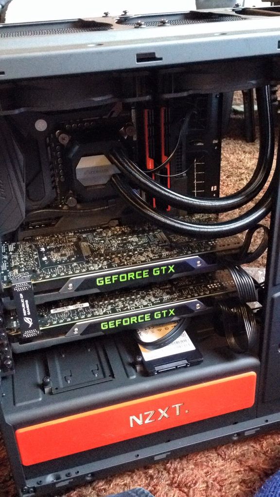

First round of the PC build done. No cable management or tidying done yet, but the biggest single issue I've had is with one of the G-Skill sticks appearing to be DOA. I've tried different combinations within the slots and the PC hangs with Q-Code 55 whenever this one stick is inserted. If I leave it with just one stick of 8GB, it boots fine.
So far - well happy. The BIOS screen represents the cockpit of the Space Shuttle compared to the Wright Brothers ASCII flyer that I'm used to. It's SO quiet too - a couple of times I've actually thought it had powered itself down. I might hold off on the full-blow tidy-up until getting a 1080 - but we'll see.

Nice. 55 can also be DRAM instability rather than DOA. How is the XMP switch toggled, or does the memory work ok when ran at 2133?

It did it right out of the box, m8. Everything set to standard and without XMP activated. It wouldn't even get to BIOS with that stick inserted. Without, it was fine.
It came with BIOS 0403 and I even updated that to the latest one - it behaved exactly the same. Code 55 regardless of where that stick was inserted.
