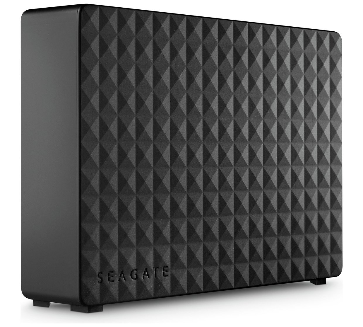

Thought someone may find this useful
Seagate Expansion 4TB USB 3.0 £99.99
http://www.argos.co.uk/product/2388421
