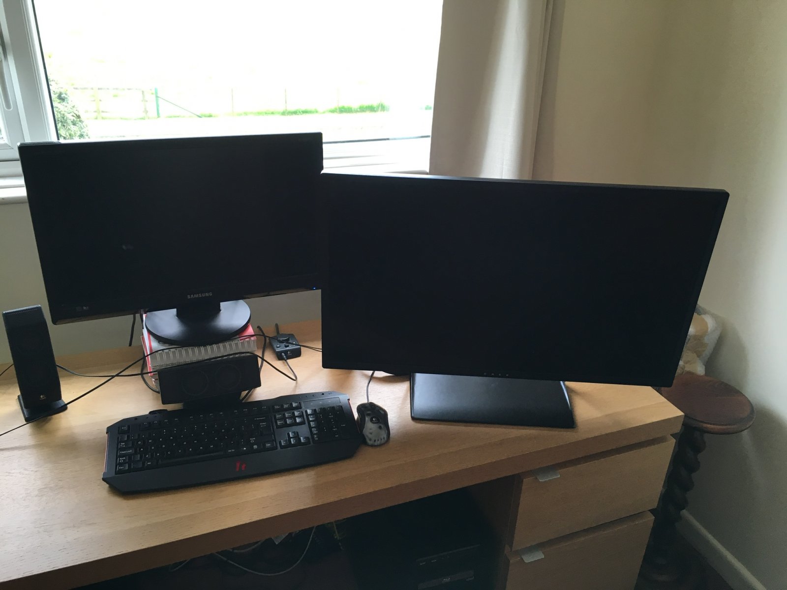

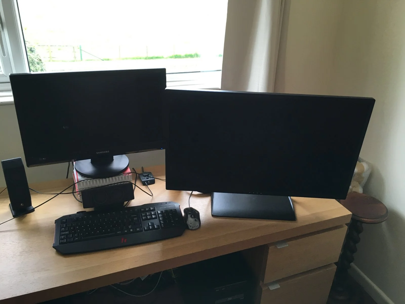

Just upgraded my monitor to a 32" 16:9 job, really pleased with it. Not the most high end display by any means but properly immersive for shooters and racing games. I got a Dell 34" ultrawide at work a few months back and coming home to a poxy 24" 16:9 monitor was doing my head in!
If you're looking for a good sized screen without spending a fortune HP Omen 32" is well worth a look IMO. 2560x1440 works really well on that size without completely murdering older graphics cards - I'm running an ASUS Strix GTX 970 and it's holding up absolutely fine.

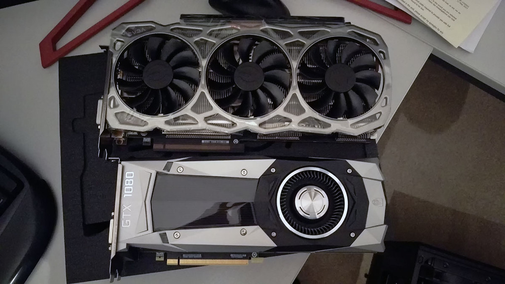

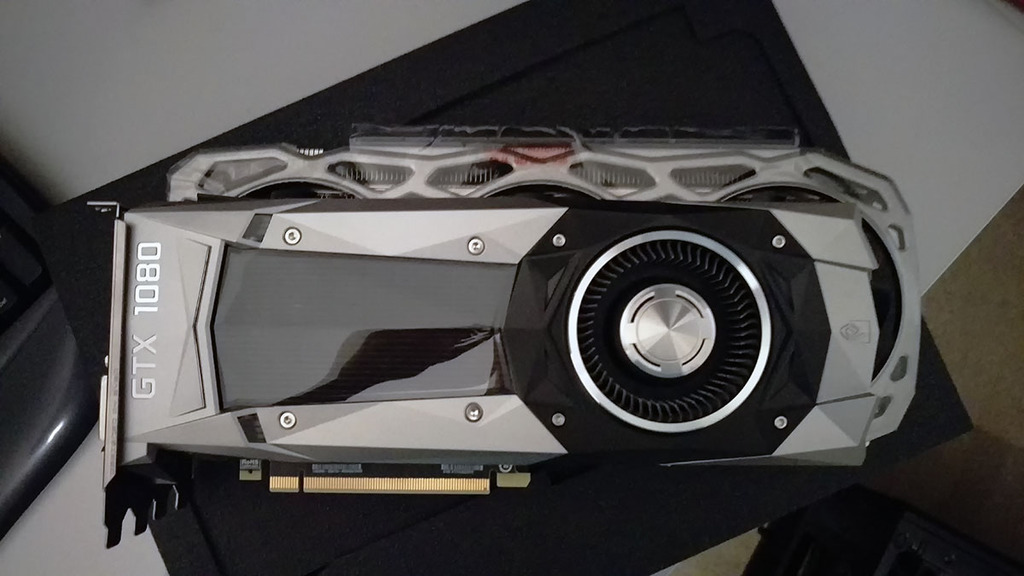

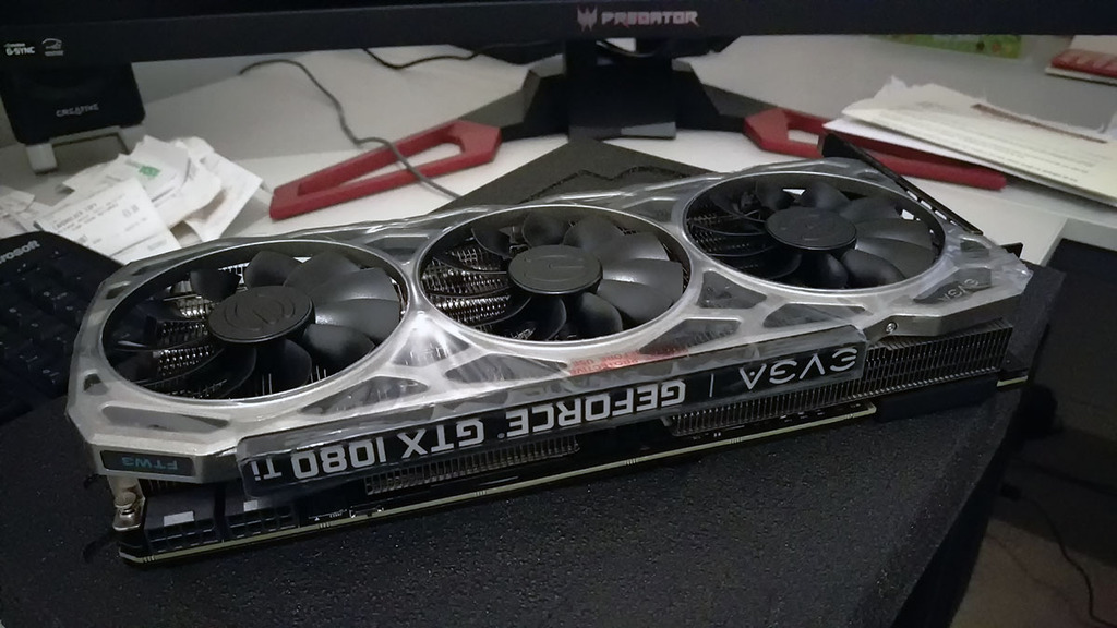

Lol - looks similar in dimensions to the Zotac 1080 I installed in my nephew's PC. That thing actually started to bend under its own weight on the overhang. Managed to cable-tie it straight - looks awful, but does the job.
I have to admit I'm a little concerned due to the weight! I might have to look into knocking-up some sort of scaffolding in there :tonguewink:

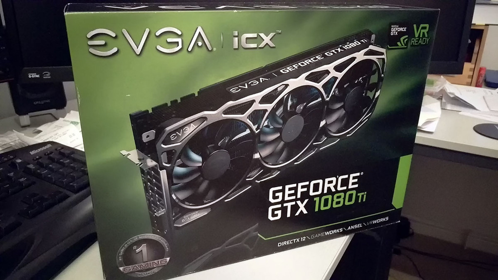

Neither in the end mate... EVGA are awesome. I received the new GPU yesterday, ran a quick couple of 'tests' with both cards in SLI, and then sent the faulty one back this morning :smile: Job done. The PC was running nice and cool (during SLI 'testing') but, f**k me, the heat in the office after only half an hour was unbearable!!! FLOL!

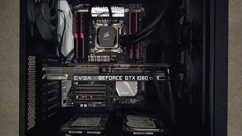

So... the faulty GPU has been returned and the new GPU is happily up and running... but...
Andy - it's not the spec of your GSync cable is it? I had black screens aplenty when using DisplayPort initially on my PC. Swapped the cable for another and it's been flawless since.
Well, all the DisplayPorts seem to work just fine without issue with both of my 'certified' cables. Likewise, the HDMI connection seems just fine too. However, the DVI-D connection has the same (or very similar) flickering issue to the faulty card I've just returned! However, in this case, I do think it's down to a dodgy cable and I don't actually use the DVI-D connector so... happy days.
