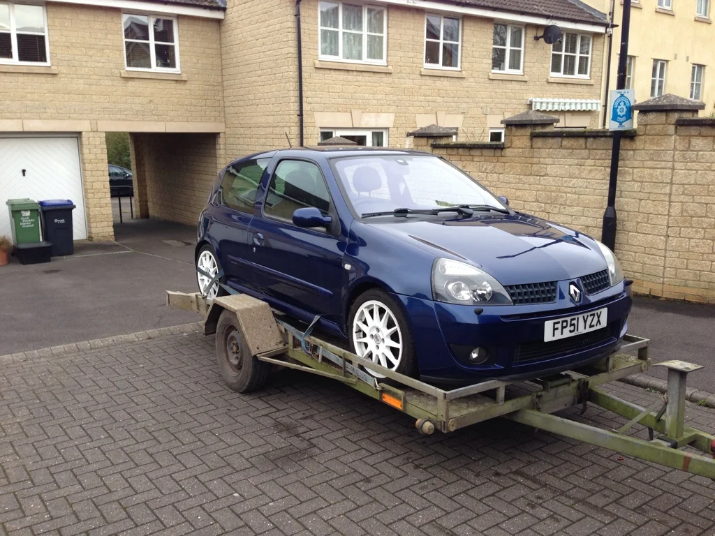

So, Took this in Part ex for my old silver one. Plan was to sell asap, to give me the last few ££ for the M3 I'm lusting for.
I Did the belts on it for the previous owner, then it was parked up and not used.
So I had it back, part of the deal was I kept the Cruise control and my Recaro's.
So with the silver one going within 2 days, I went with Emma to go and collect it:
Quickly off loaded, Taxed and then driven to work that evening.

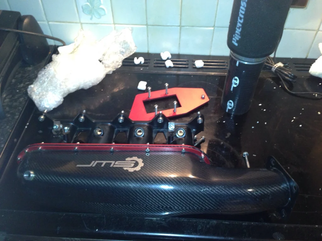

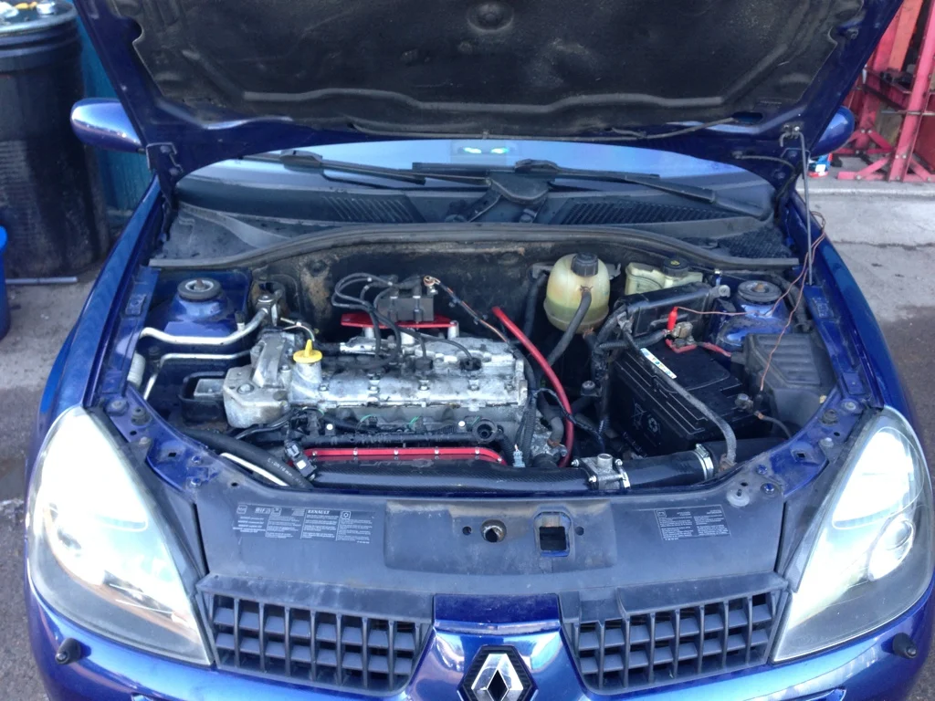

Next day I saw an RS2 come up for sale. And I already had some 197 cams lying around that I hadnt fitted. Slowly spending my M3 budget here!! couple of days later I had this arrive...

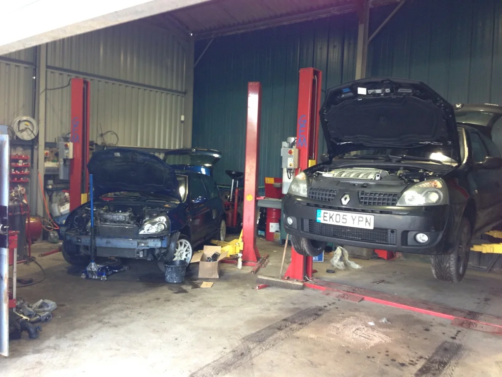

That weekend I had a few jobs in (182 belt and a LCR in for a belt and water pump, and a Cup in for Recaro fitment) so My car was on one ramp whilst I was doing the others. I timed up the cams With Help from Mike Woodford MST.
Finished saturday night about 830 and Chip offered to have It mapped that evening (I still owe Lesley a favour after stealing her other half for an evening!) So on I cracked over, New map uploaded and it became a different car. Unfortunatly it wasnt without its issues.. The wideband decided to play funny buggars and we had to abort that evening. Either way is still Pulled very nicely, Rev limit is set very high(at My request, Id sooner not use them than get caught out and clip the limiter.)

I then purchased a Yozza off here as the power flow system was about 2" bore, so not enough for the engine now.

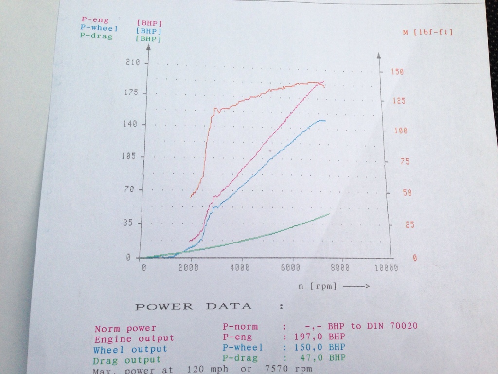

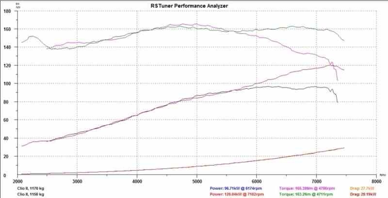

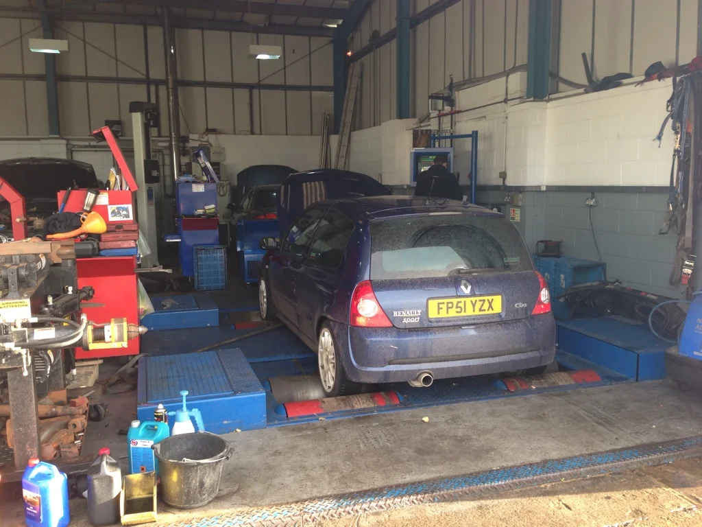

I had it rolling roaded on the monday, just as a baseline figure. I personally trust these rollers, having used them MANY times before and have always come up circa 168 for a standard 172, 155 on a williams, 150 on an F7r megane..

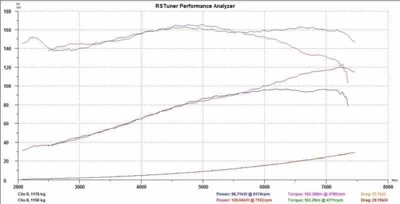

It came out at 192bhp, with a torque figure of 143lb-ft. Yes, on the low side, but this was on an un-finished map we checked it this weekend to find its running slightly lean and is being adjusted to suit..
A before and after run on the RSTuner is here, literally as a guide line to show the difference. The weights are different due to one being 3/4 of a tank, the other being nearly empty.
The idle is rather lumpy with the 197 cams.
The Yozza turned up and went on yesterday, and this has also free'd up how it pulls. Its certainly more keen than before now.

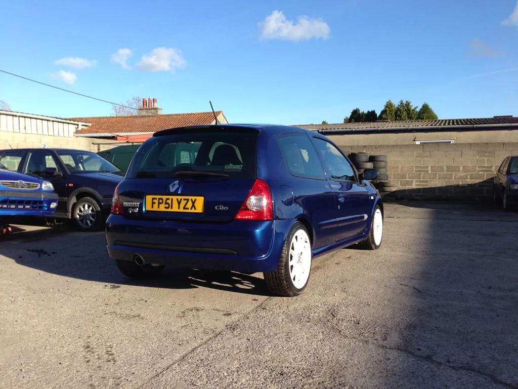

And a quick clean:
Thats It up to date now.. although I am on the lookout for a set of H+R's or Bilsteins. And there could be MASSIVE changes coming over winter...

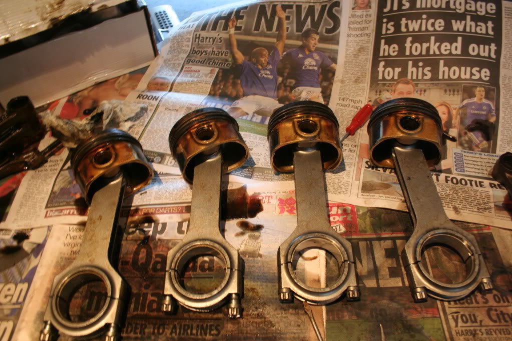

At the garage I have my cupra R that I'm breaking, I had sold the engine for a substantial amount, however, the guy who bought it was due to bring it down to be fitted and was promptly sideswiped by an HGV. So With the potential of loosing this sale, this leaves me with:

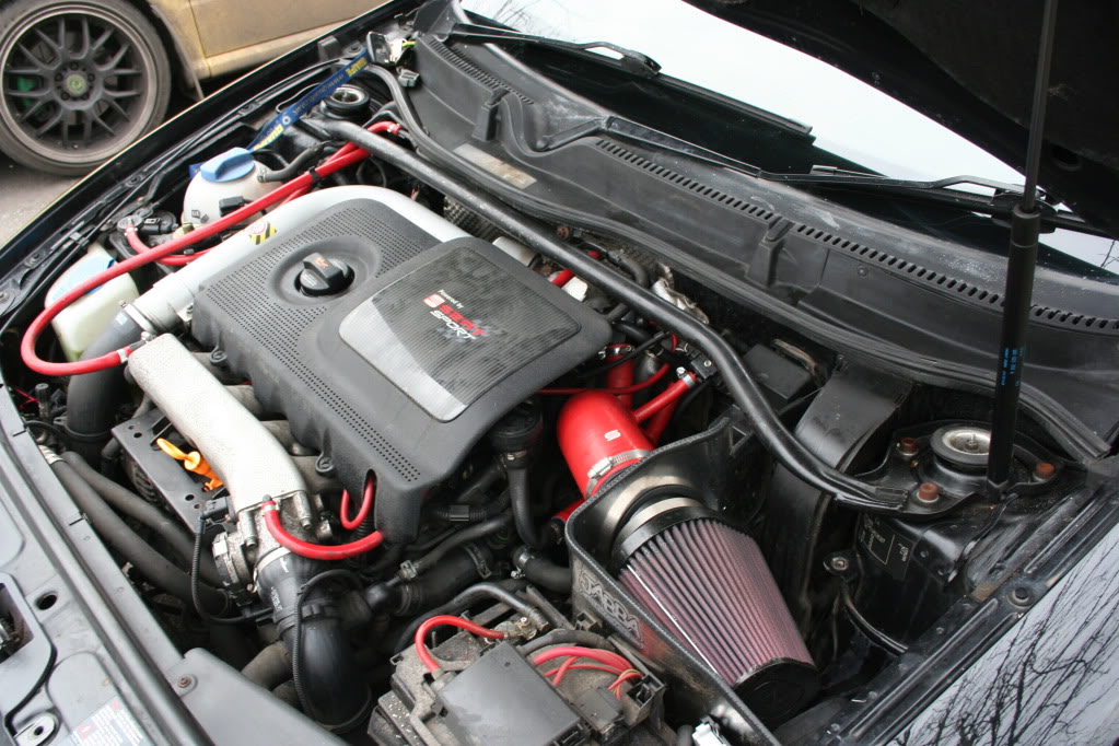

1x 20vt engine. Already fitted with forged rods/pistons.

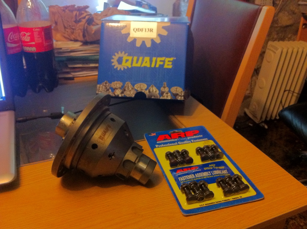

1x02m gearbox with:

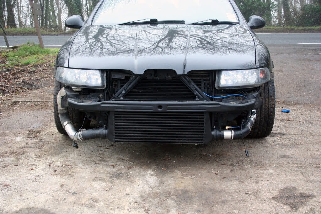

And one massive FMIC:

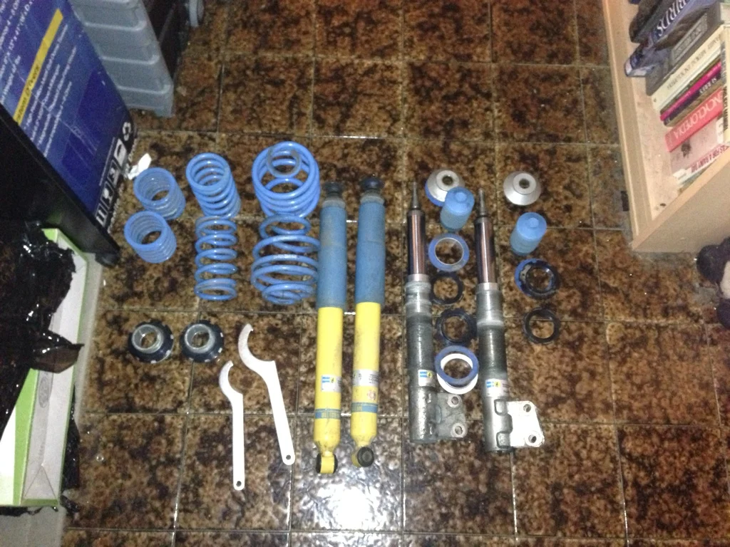

Oh And I have Just Paid for some Bilsteins.

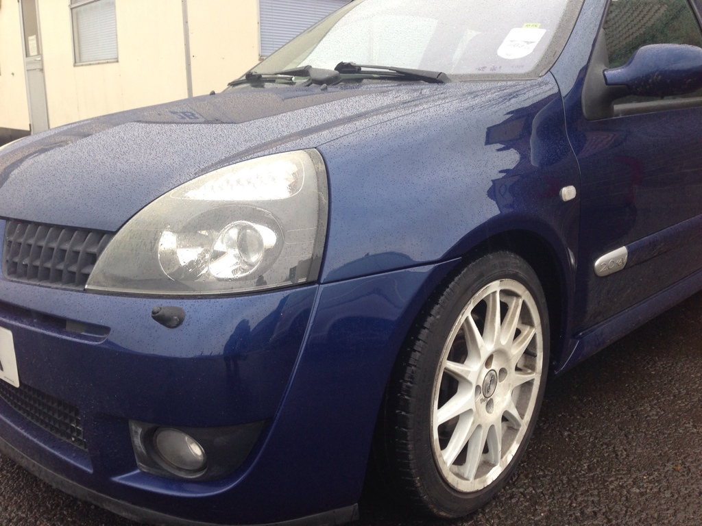

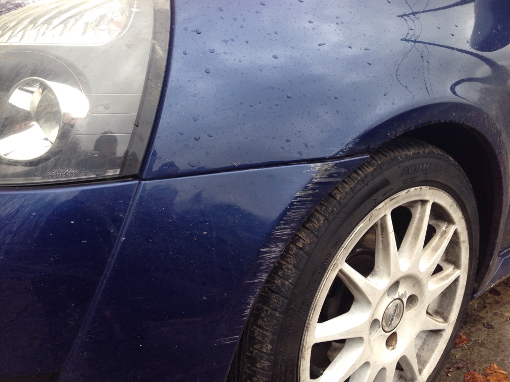

Got the car back today from M+D Auto refinishers in Walton, from having the front corner repaired.
Before:
After
Its not the blend line you can see on the bumper, but where its been cleaned off to do the paint and the rest is still dirty. All in all its a Very good job, and was turned around in under 24 hours.
Just the wheel refurb to go and a couple of dings to get removed and shes mint again :)

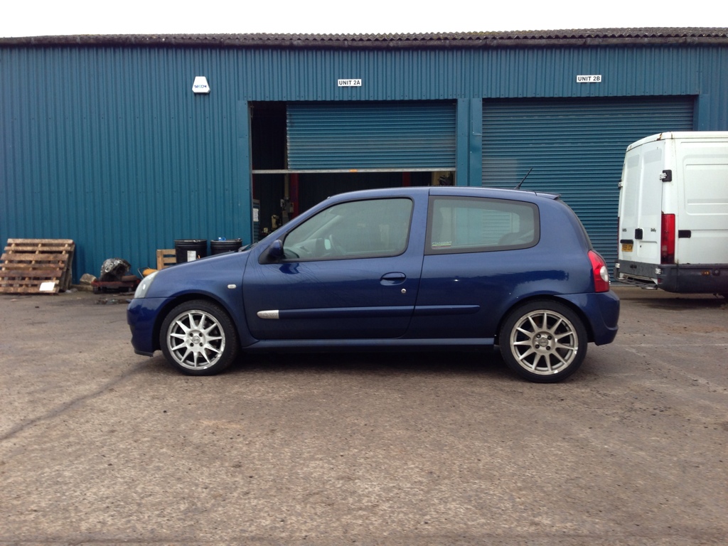

Bilsteins being fitted and set to this height at the moment:

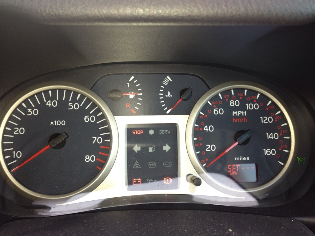

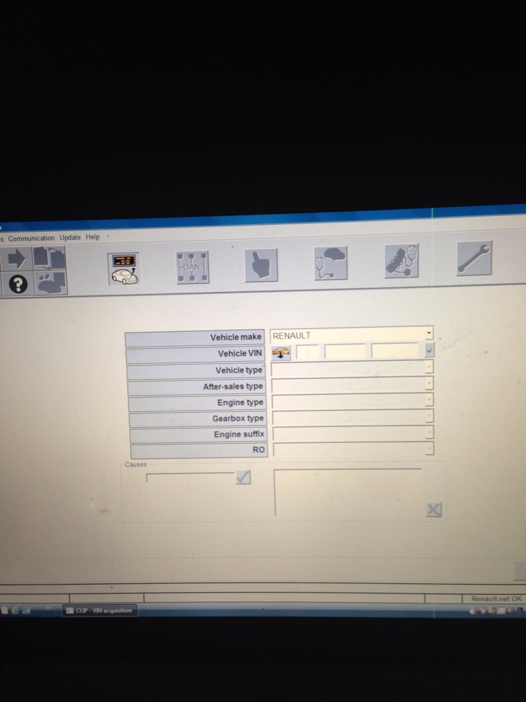

Then, Today I went in and turned off all the airbags that have been removed via CLiP
No more lights :)

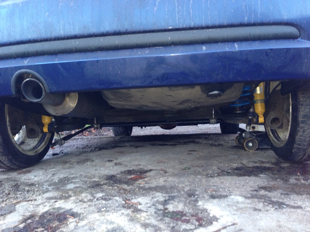

Still waiting for the Rear ARB to turn up, and then it'll be going to bridgwater college for corner weighting.

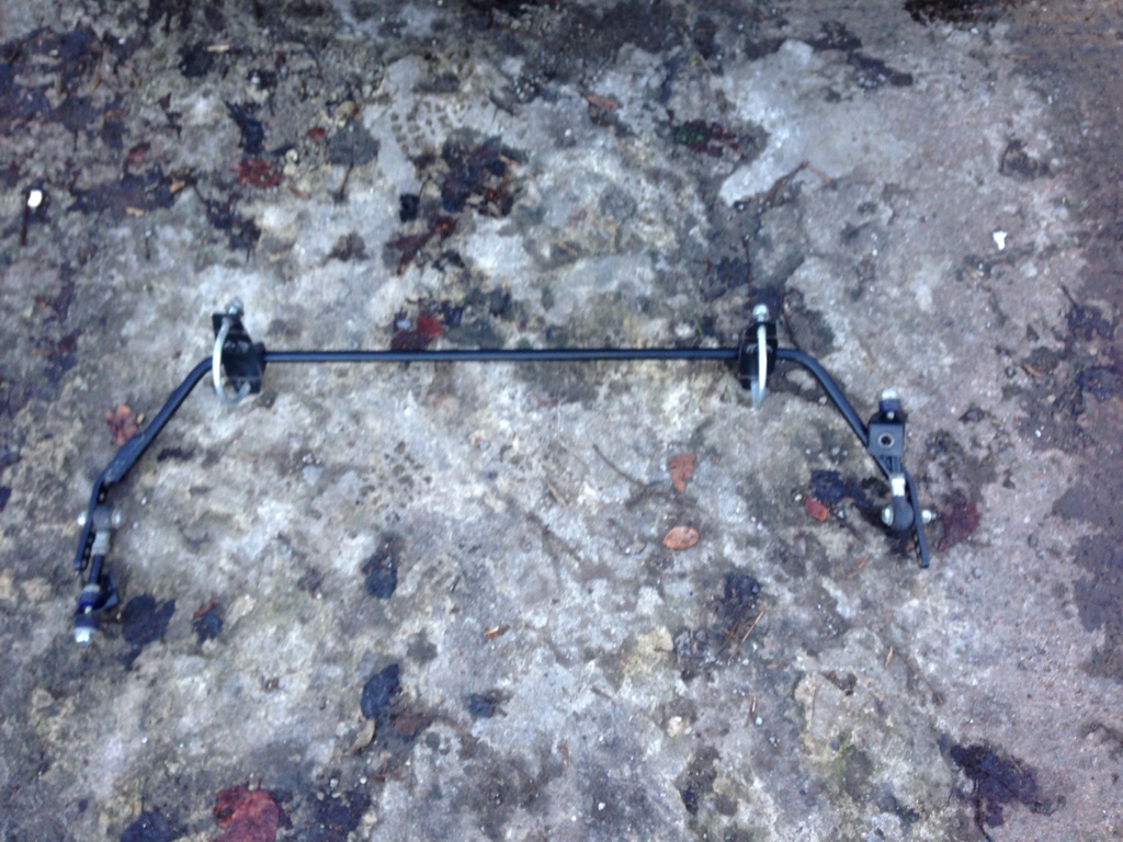

Well, Rear ARB has arrived.
Fitted:
Certainly helps with the initial turn in, its a bit too wet/cold/busy to go arsing around the industrial estate, so I'll wait until Im on my way home from work when its dry before exploring it.
Sorry it's a really bad angle, I see what your saying. Vertically they are dead straight.. They are at an angle toward the front of the car as I moved it to the hardest possible setting.
It doesn't get to catch anything as they are within the wheel circumference. I will try and get a better angle demonstrating the angles of the links. IMO I would like shorter drop links, to raise it towards the shocks.
yeh, the fuelling is slightly out mid range, it made peak torque at a little under 7000rpm! Back over to chip this weekend to do some more data logging and see what we can gain. Made the power at the limiter too.
You can see even on the RS tuner graph that there is that pointless little hump either side of 5k where the standard inlet outperforms the rs2 to give a better peak figure briefly.
Personally I would happily sacrifice half a dozen lbft for a few hundred rpm in the middle like that for the frankly ridiculous gains at the top end!
So while Im sure we can get a little bit more out of yours torque wise, and possibly even squeeze those last few BHP to hit the magical 200 as well, I still think with the torque arriving so late its never going to be as high a peak figure as the one you get on the standard inlet manifold and cams where they have that little narrow sweetspot at just over 5k where they work great briefly and then give up. There is no point comparing the peak torque figure alone when the delivery is so different. Especially against Emma's freaky cup which probably had you beat by 10lbft before you even started, lol
