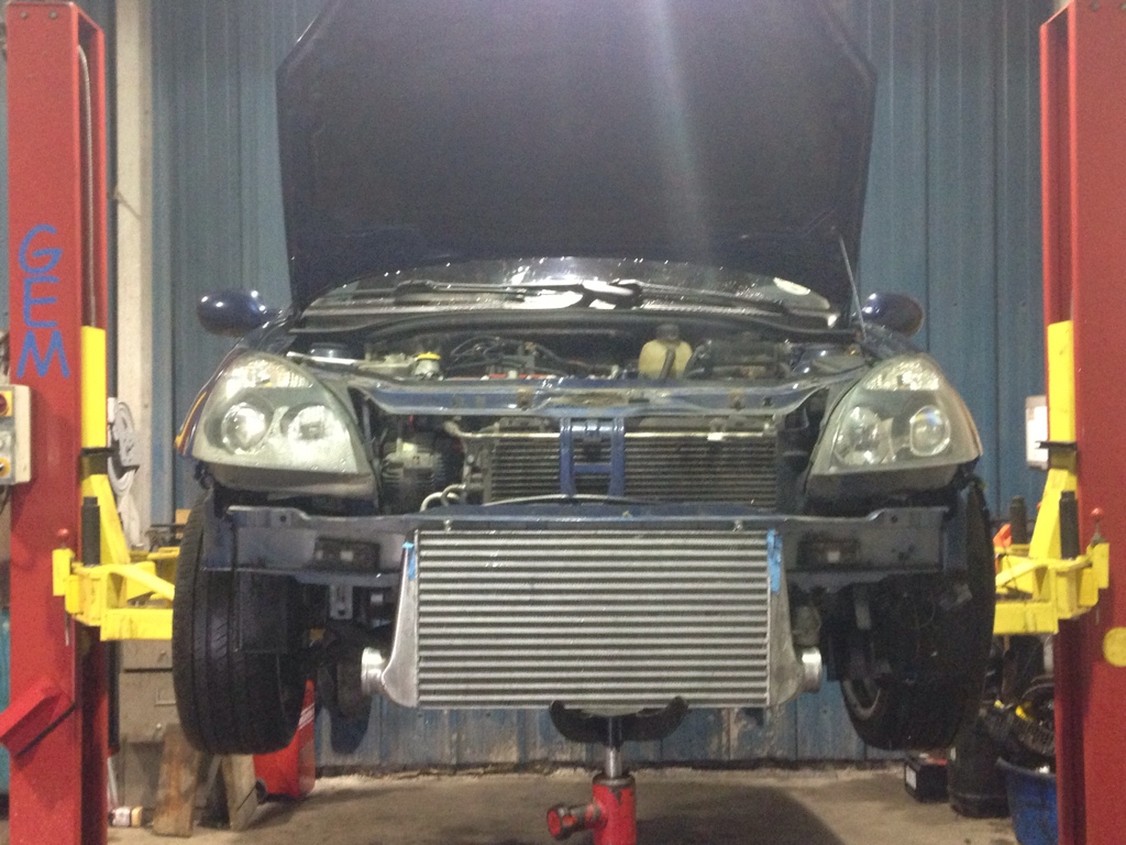

So. While waiting for an engine to turn up down the garage i thought I'd get mine on the ramp and start doing some measuring. I'm going to have roughly 5mm each side of the engine and box to the chassis fails, so it'll be a tight fit! Problem I have is the 02m is alot taller than the 02j which just sits below the chassis rails from experience.
Then decided to see how well/badly the intercooler fits. It's certainly going to need some trimming of the cross member.

If you can get that to mount there that looks like it will be ideal, as the top of the rad will still have some fresh air to the top of it as well.

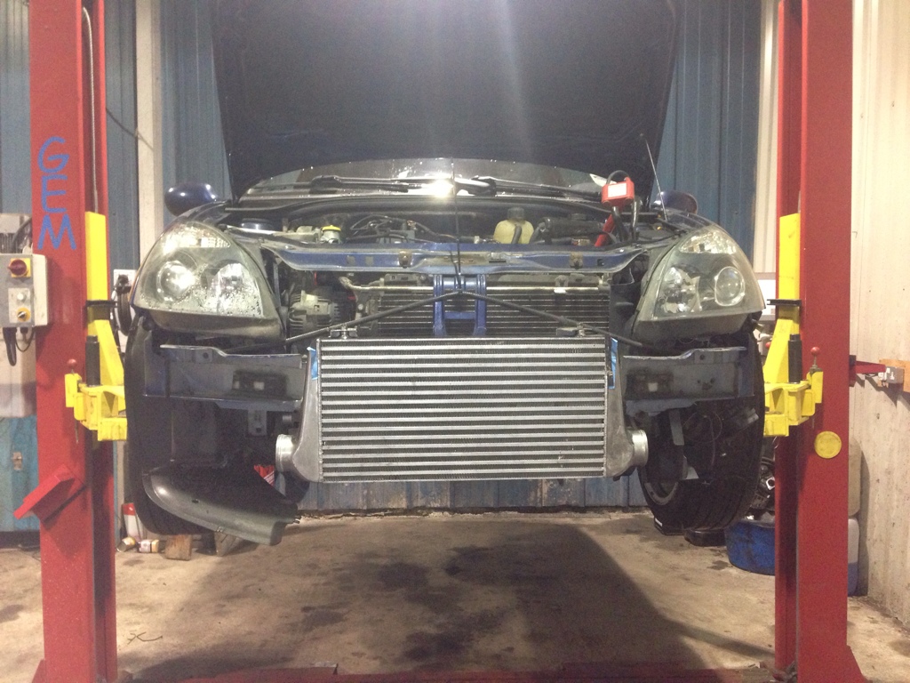

I've got it mounted. Had to go higher otherwise it'll be hanging out the bottom of the bumper.
Some very temporary brackets made for positioning purposes, I can make a bit more fancy ones when I do the engine change.

How does a MASSIVE intercooler like that effect the Rad? Noticeable?
