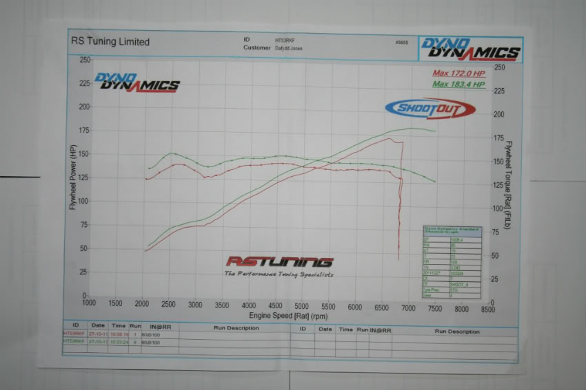

So about £750 all in, would be nice to get it close to the 200 bhp mark. This is the car's power at the moment -

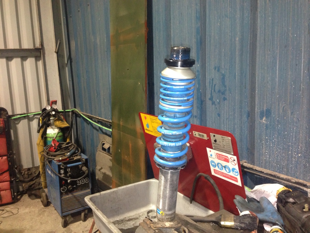

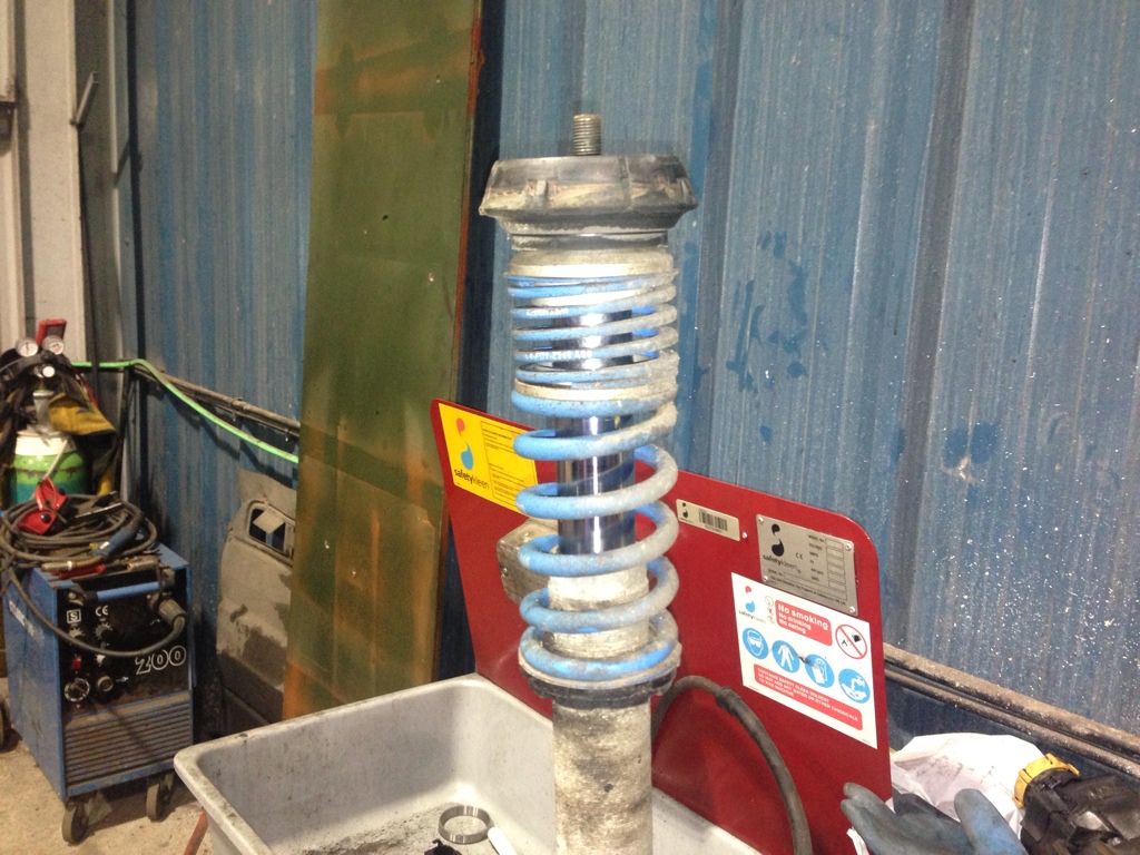

Small update, solid top mounts fitted last night. They are the compbrake ones, which according to here will make my rear wheel fall off and give my mum the flu. TBH I've had compbrake ones on my LCR with no issues of them loosening off, so I'm not that worried.
Old setup:
Cleaned, fitted, and ready to go on..
Must admit, the drive home was alot harder than it used to be, and the turn in has certainly improved. Just waiting for my camber bolts to arrive to be able to set it up properly.

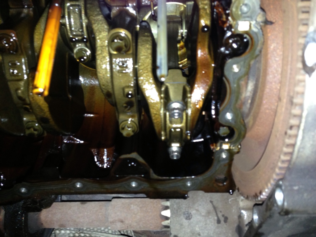

Little present for the F4R, mainly so it doesn't go bang when on the rollers.
Being fitted this afternoon as we have no work in(onless some parts have arrived for a customers car)

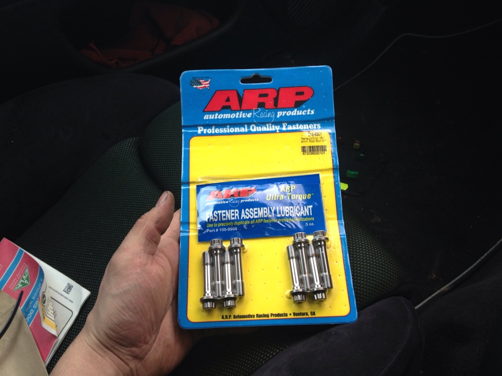

Well, While waiting for a customer to turn up to collect her car, I got mine in to do the ARP's.
All others done, Got some camber bolts to fit and fitted a new ballast today aswell as the passenger one started playing up.

I must thank you chip for putting up with my moaning about little flat spots, but after server all tweaks and its finally perfect. It's back on the rollers tomorrow with a higher rev limit, so hope to crack the 200 mark. Or die trying ;)
  182/RS2/ Turbo/Mk1
Will be interesting to see if the extra rpm yield a few more BHP or not, it certainly looks like it should given the amount of fuel its still taking at those rpm with a sensible AFR etc, but things dont always work exactly as expected!

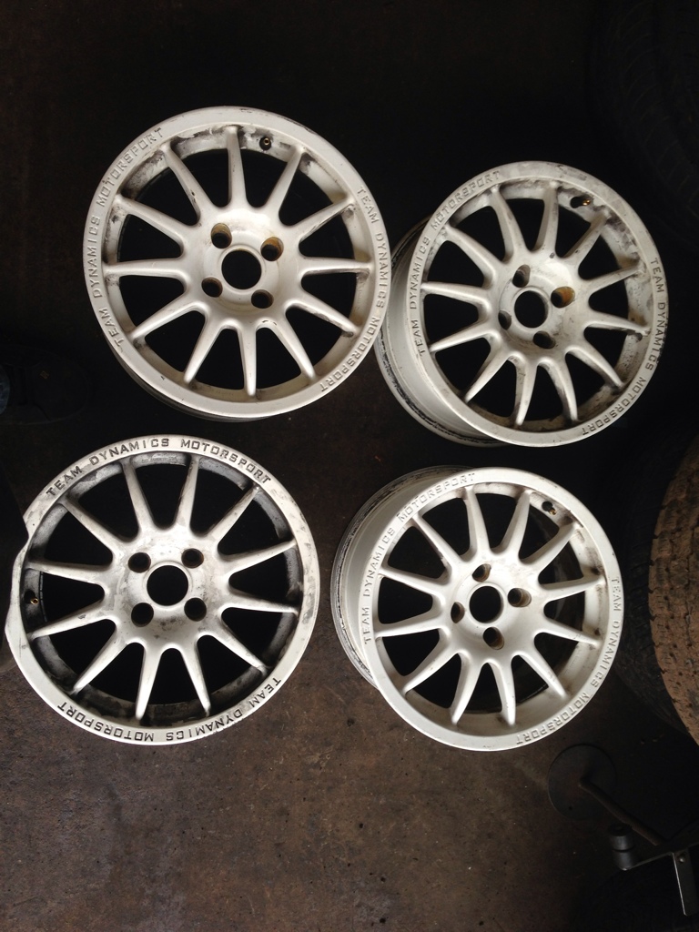

Im gutted to have sold them TBH, really suited my car, but we've decided to go over to just OZ F1s for everything as it makes it so much easier with swapping between sets etc so have been selling off all the other different wheels we had like these 1.2s and some TD 1s and some Monzas etc.

£80 for ARP's after seeing nearly 200bhp. Needs extra rev's.
