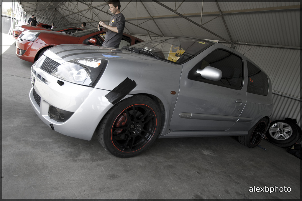

Hey everyone. I've had my 182 since Nov '06 and have been slowly modding it for track days/fast road. It was also my daily driver. A cheap 172 came up for sale nearby back @ the end of May and my Dad (who's got a Meggy R26) and I went to check it out. Paint was mint, drove pretty well, had recent 60k mile service (both belts changed). We could tell it needed new engine mounts, something was making noises in the exhaust & the front left shock was a bit off.
We decided to go halves and share it as a track special (still road registered) and save our respective Renaultsports from track abuse! So we paid cash & took it home then & there. It's a December '01 build and one of the early 172s to come to Australia. Mileage when we picked it up was 98 500 km (58 000 miles?).

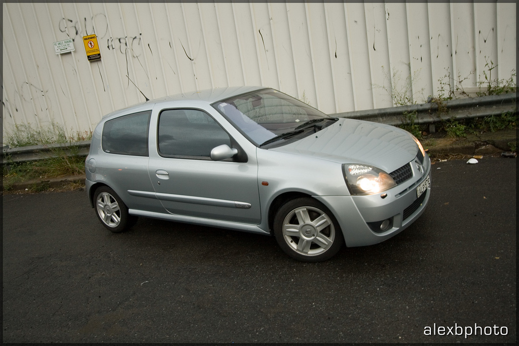

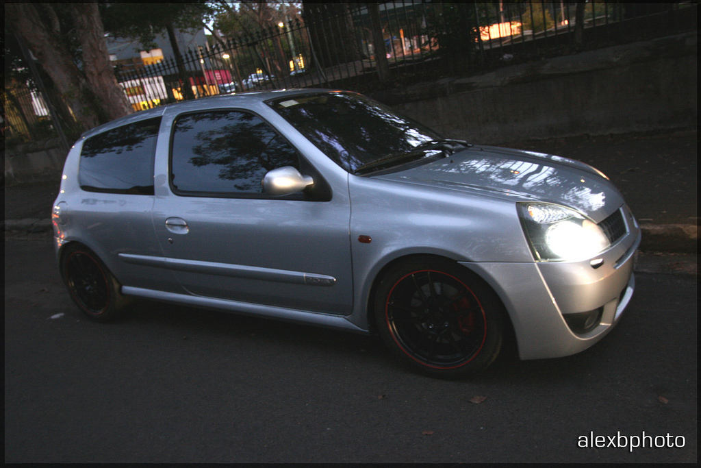

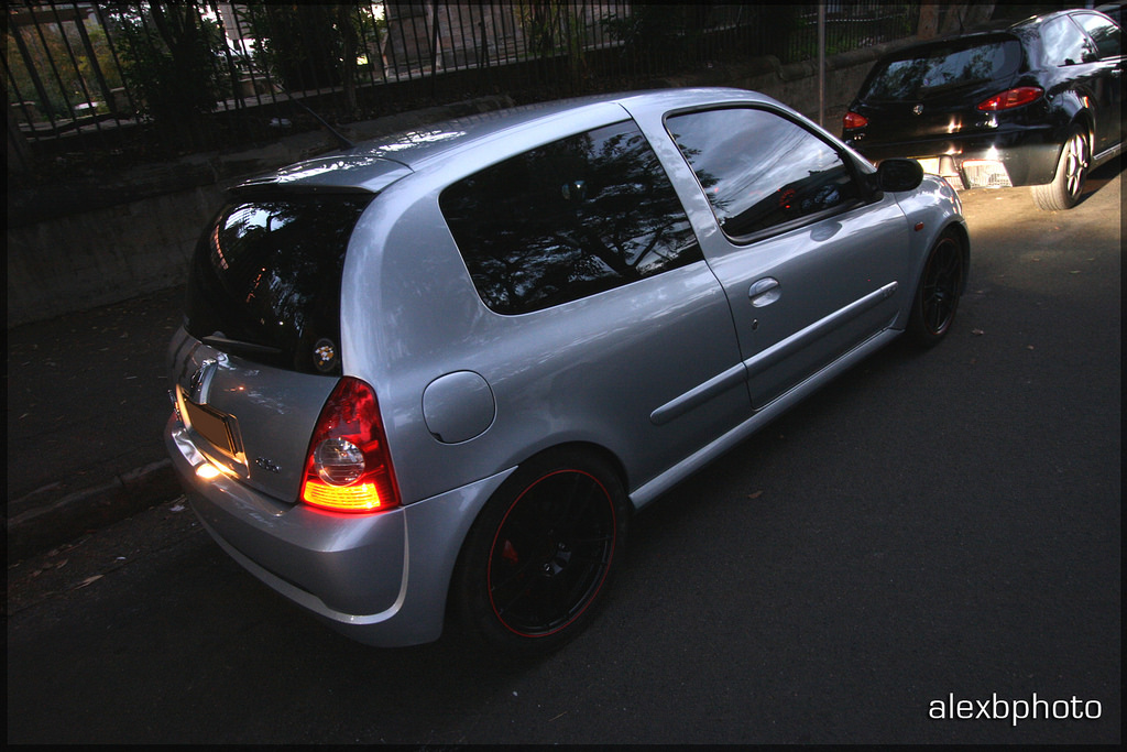

A few pics from after we picked it up:

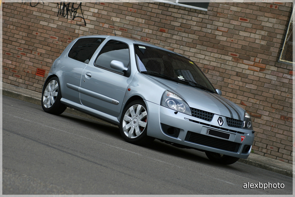

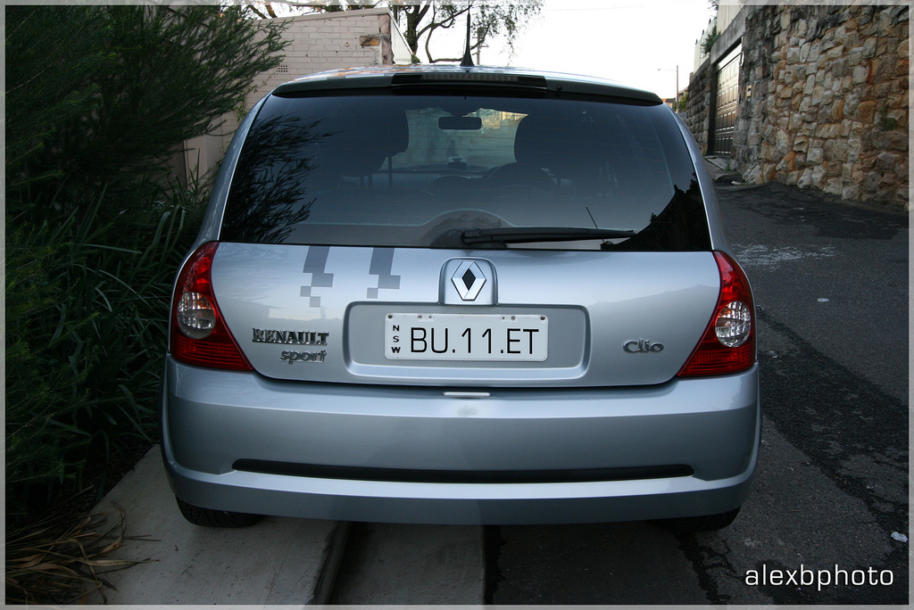

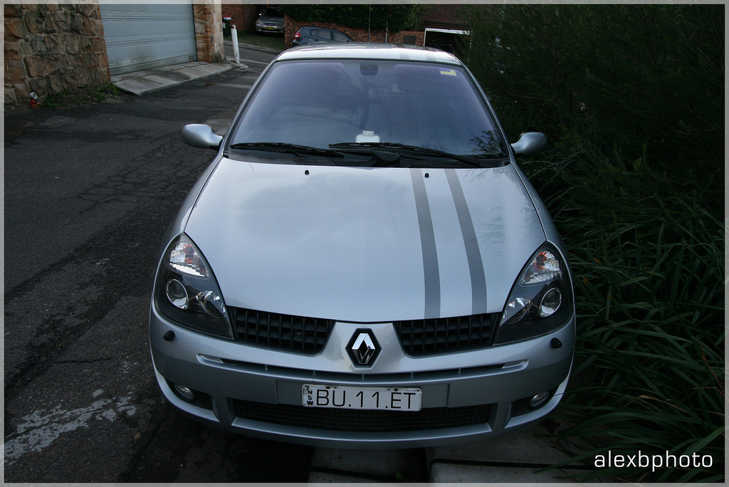

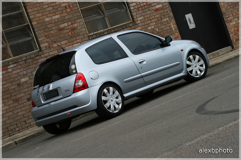

First mod was a wash/clay/wax & a set of Anthracite stripes (I know you lot don't like striped Clios but we love them over here :rasp: ). Mind the photoshopped n'plates too:

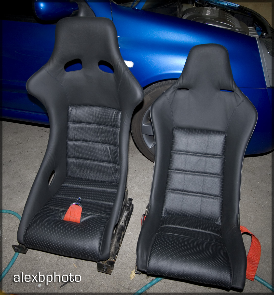

We had a spare set of Corbeau buckets out of a Lotus lying around, so decided to get them retrimmed in black leather to maintain the classy hatcback feel lol :cool: now we just need to figure out how to fit them...

Ps those seats looked well mint in the flesh!

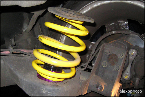

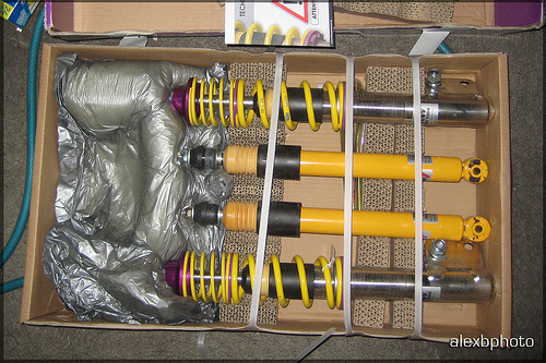

These arrived in the post today. KW v2s. Took exactly 1 week from Demon Tweeks!

20th June: Washed, clayed & waxed. Removed centre caps. Added anthracite stripes

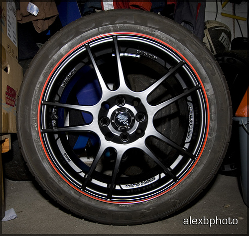

25th June: Bought new SSW S093 16" rims + fitted to left-over Kumho v700 205/45/16

11th July: Ordered KW Variant 2 coilovers from Demon Tweeks

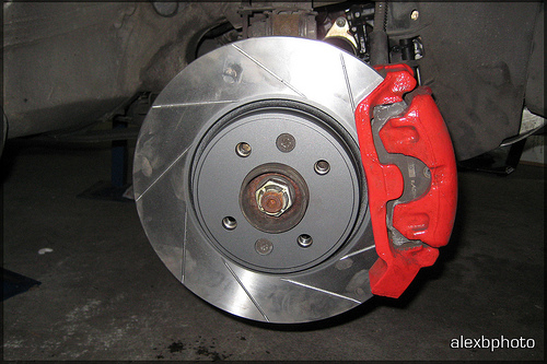

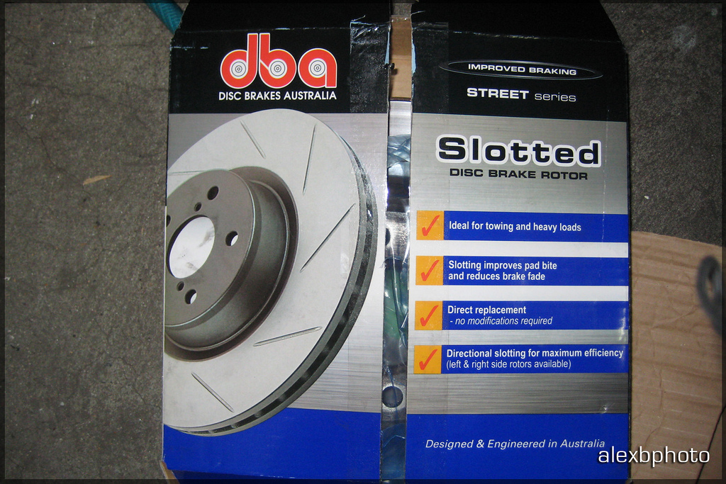

24th July: Picked up new DBA slotted rotors
27th July: Fitted DS2500s (from my 182) and slotted rotors. Fitted new rear springs & shocks.

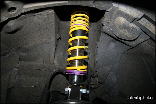

28th July: Fitted front coilovers

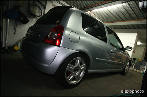

29th July: Fitted SSW 16s :cool:

I use the KW v2 coilovers, you will not be disappointed.. They are brilliant!
Kw are an excellent make and never had any problems when running them 110mm down on my megane
Clio 172's only got 15 in wheels here in Aus.
the 16in are a trial, ill wait for alex to explain but the available semis from the lotus meant it was worth a shot. Im sure in the future both 15 / 16 in will be tired.
There is already some 15in and Semis that can used if need be.

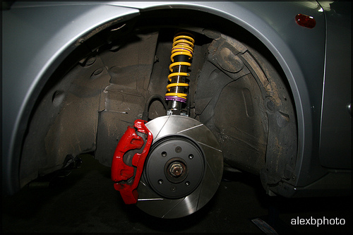

UPDATE: 27/28 July

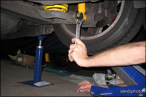

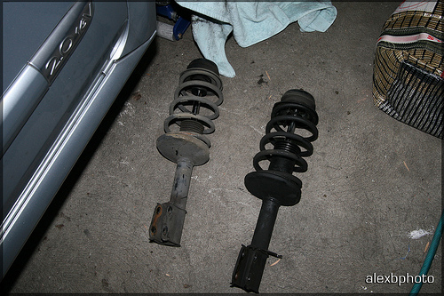

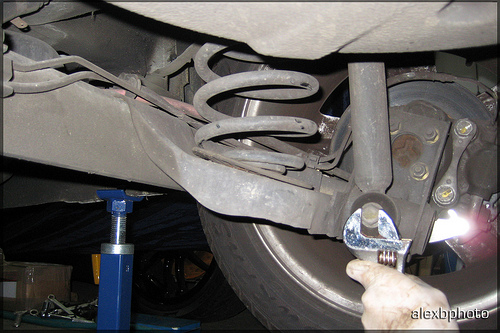

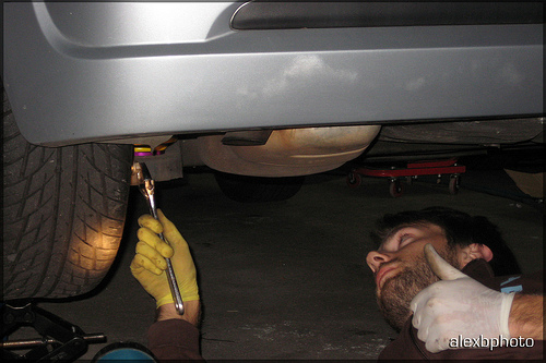

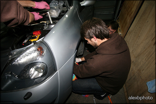

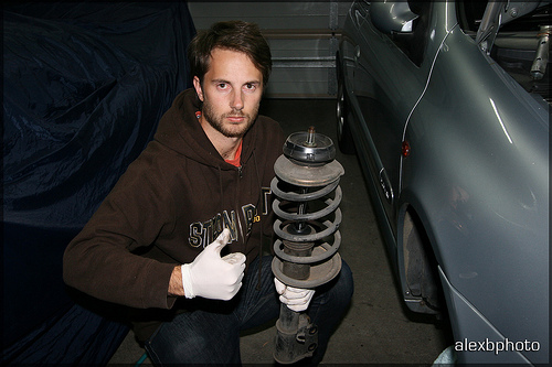

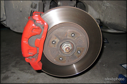

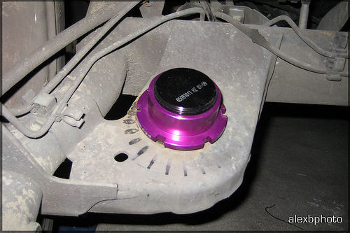

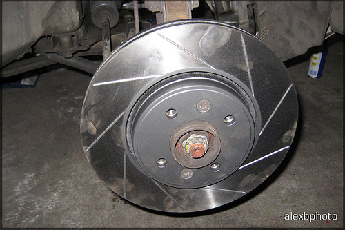

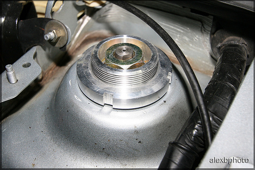

Over the course of this week Chris & I worked on the Silver Bullet. We fitted the KW v2 coilovers, Compbrake solid top mounts, DBA slotted rotors & DS2500 pads on Monday/Tuesday night & I fitted the new wheels on Wednesday afternoon.
I'll let the pics do the talking 8)
Rear shocks & springs

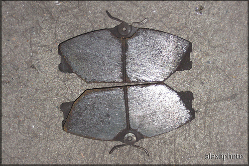

Stock Brakes
New slotted rotors

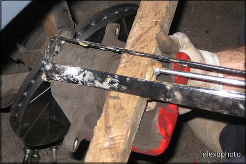

Chris' patented "corking-gun caliper pusher"
DS2500s from my 182

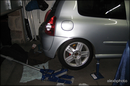

All back together
Tuesday night!
Old standard bits
Many hands make light work (thanks fellas!)

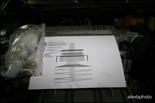

Compbrake top mount fitting guide from CS.net (thanks 172Ben!)
Out with the old (right one had spewed fluid everywhere)
In with the new

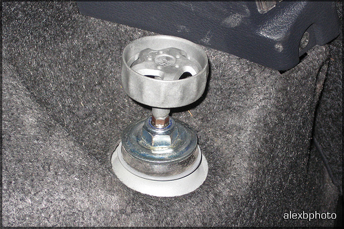

On its guts
Next step is to get it set up properly! (corner weighted & camber adjusted)

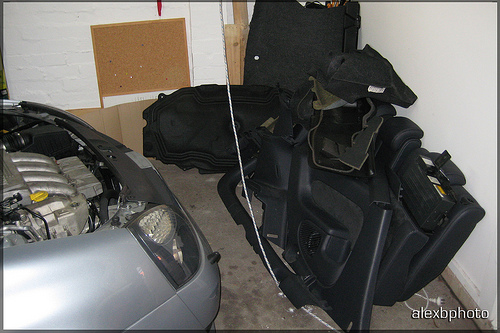

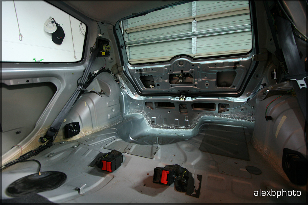

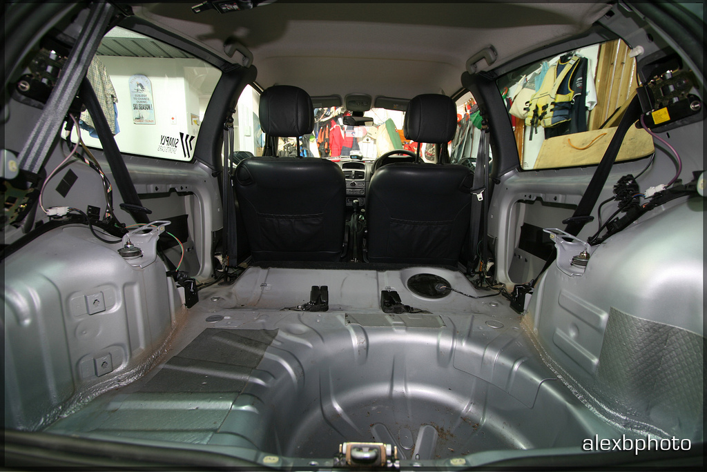

Started stripping today. Removed everything except tar & seatbelts (I know, I know) from the front seats back, plus the lower front door trims. Better pics to come but here's some of it:
Also de-wipered the rear. Couldn't believe how much the mechanism weighs!
Next is the carpet & lower front trim. Door cards are staying for the moment.
Battery re-location is happening soon, then cup-racer induction setup and alignment and corner weighting :cool:
First track day should be within the next few weeks... can't wait! :race:

Some more photos for you! I can't believe how much the rear raised up - I reckon about 3-4cm with all the stuff out!
Seat belts are staying in for the moment for 'legal reasons' :nono: lol

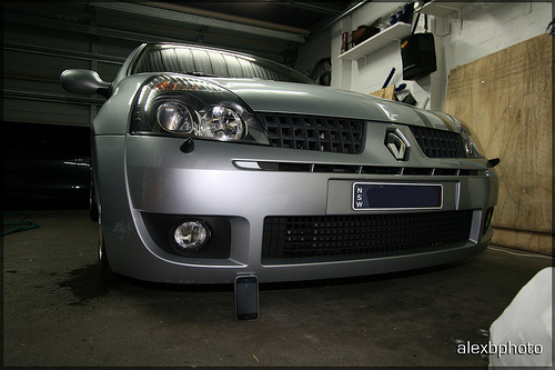

Thanks mate. We got lucky & didn't get hit with customs tax! Plus we got the 10% members Cliosport Members discounts from Demon Tweeks :cool:

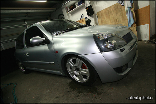

More detailed updates to come (more stripping + corner-weighting + first track day write up) but here's a teaser pic!

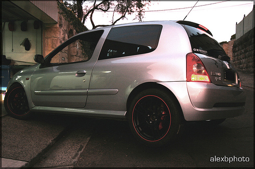

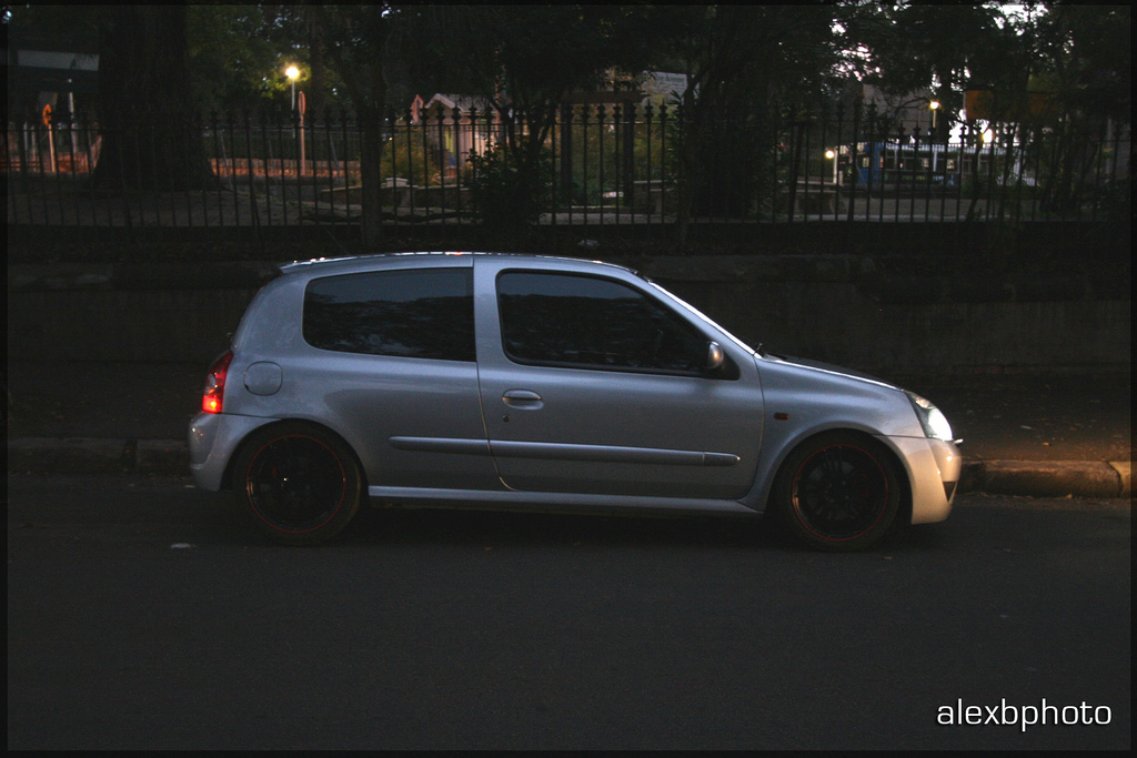

Jeez - been a while since I updated this!! :( A fair bit has happened in the last little while (not to CS standards yet lol) but have fitted a Quaife LSD, clutch, exhaust, intake etc etc. Will be doing a big update in a week or so once I'm done with uni for the assessment! But here's a pic on current road wheels:
Cheers fellas!
PS. Not sure why it looks like a 4x4 in those pics lol
Looks hot alex. Good to show what the Aussie's are doing with the little animals.;)
We don't all drive V8 Shaggen wagons, most drive B&S specials.

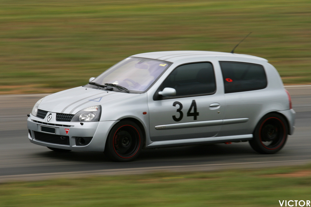

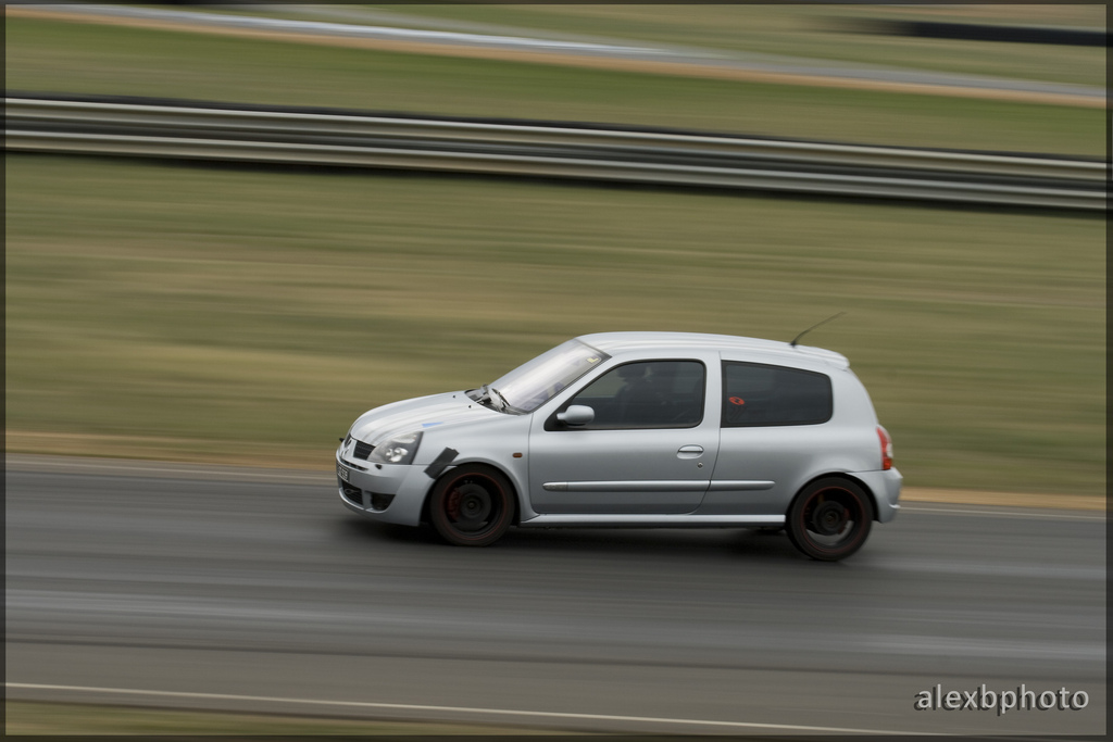

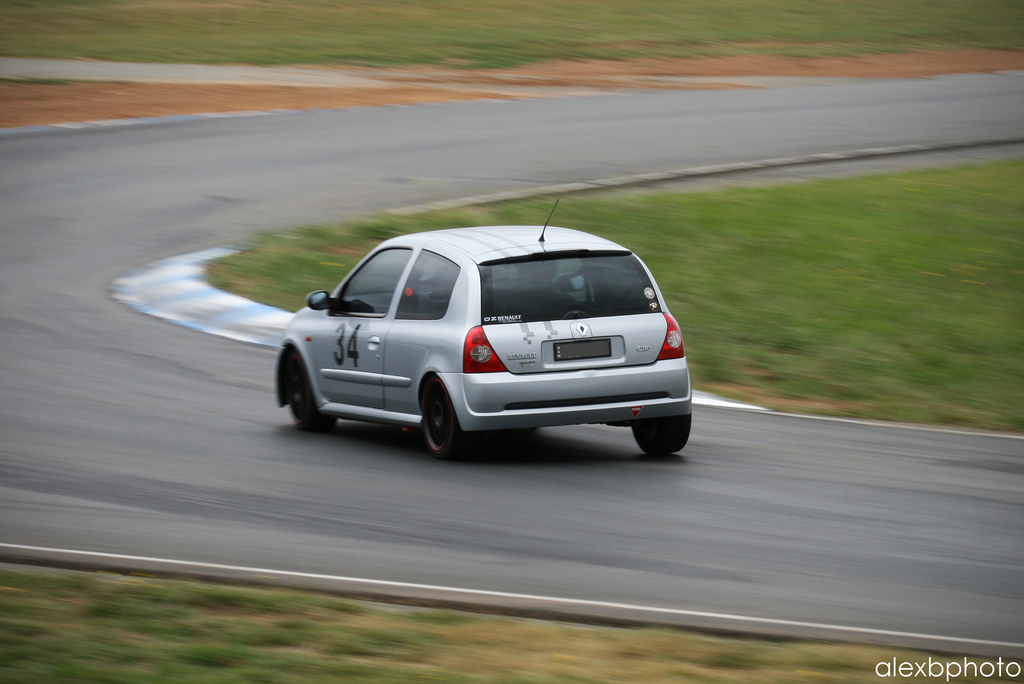

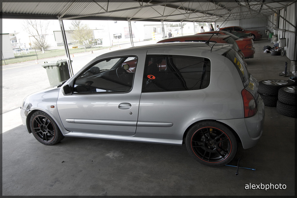

Track day at Wakefield Park on August 16 coming up :cool:
