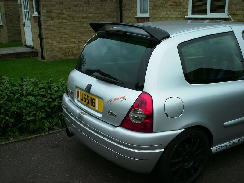

Coming along nicely, i'm not keen on that rear spoiler, but the rest of it is looking spot on:)

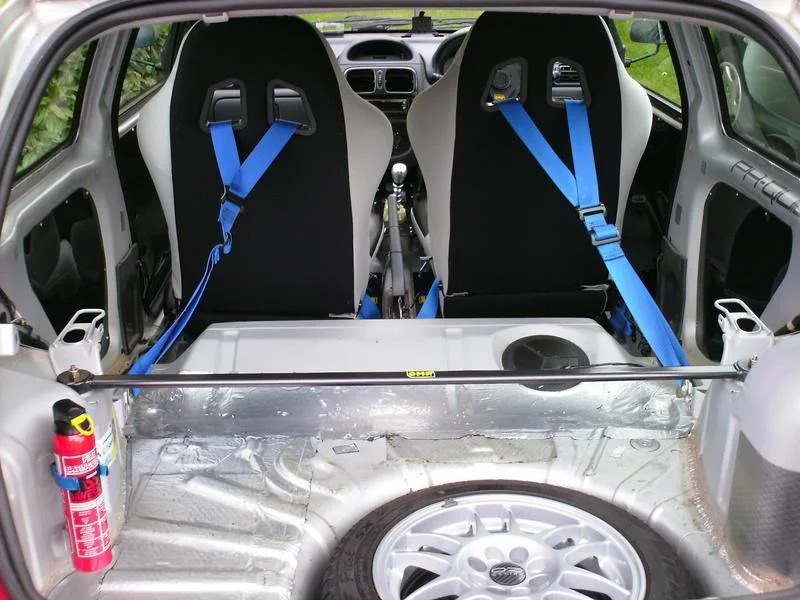

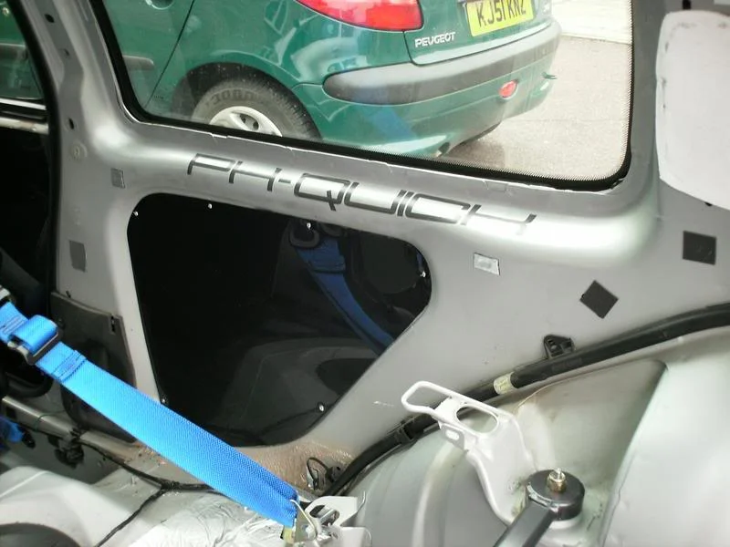

Would the harnesses be better strapped to the rear brace?
If you have a smash, the harness bar would rip right out. In fact, if you were strong enough, you could probably rip it out yourself!

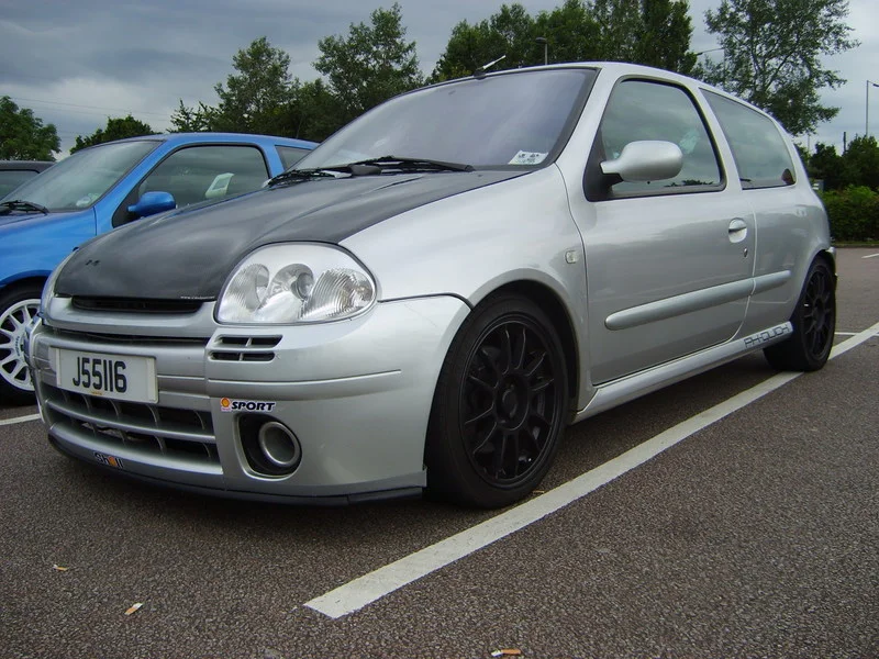

Just out of interest Artur69, why did you go for bigger wheels? surely for hillclimbs, smaller wheels would be better for acceleration?
Just out of interest Artur69, why did you go for bigger wheels? surely for hillclimbs, smaller wheels would be better for acceleration?[/quote]
I have a set of 15" F1's with R888's for that lol
Right gotcha Dan, to me it looks like the part they are bolted to atm looks like it would be a little flimsy under some force, unless theres a few bits reinforcing it i can't see?
Where they're bolted to atm is where the rear seatbelts mount to, they can take a s**t load of force. (its what they're designed to do after all!)
I have been told that it woudnt be safe?!
my car passed its MOT with the harness's wrapped round the strutbrace...its safe :)
Not keen on the mirrors or spoiler but the rest rocks.
Also your yozza sticker is on a bit wonky? ;)

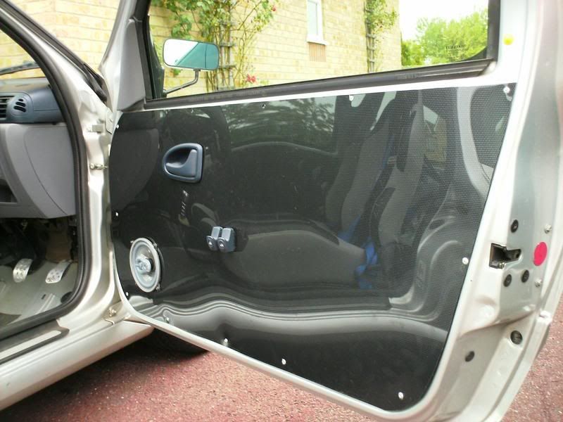

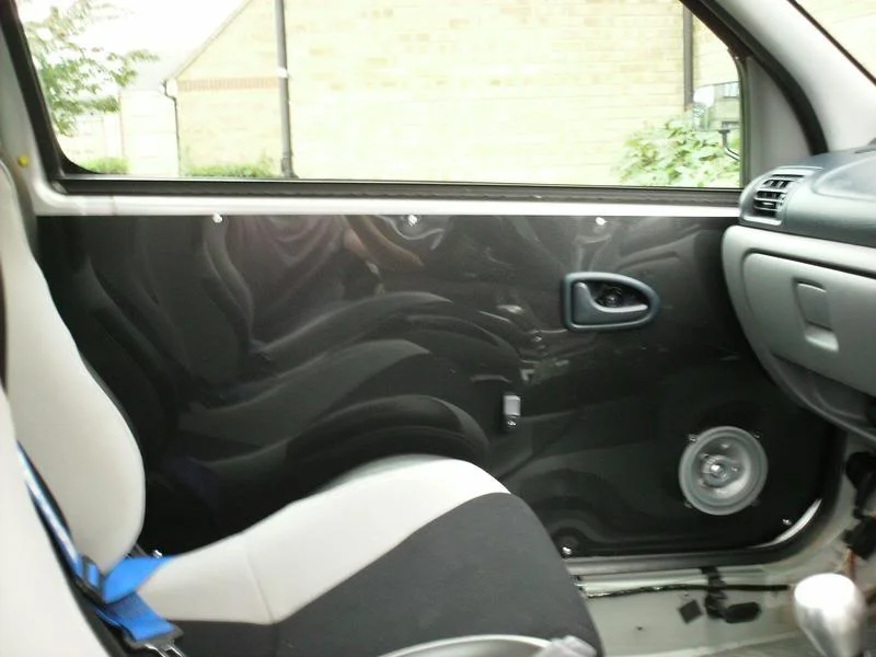

I know I love them too they only took 30 minutes to make (each)
How?
With what?
I made a template with cardboard off the door and and where all the holes for the speakers/door handles etc needed to be them traced it to the carbon fibre cheet and cut it! then did the same for the rear quarter panels. Straight forward really! Just make sure that you get the template spot on before cutting the CF. :)

iirc the angle of the harnesses will do a lot of damage to you if you have a crash, you need the harness mounting point to be higher up.
attaching them to rear strut braces isnt safe as the brace will just come off if its only attached to the strut tops
russ@gasperformance does some mint braces (available in different tube sizes iirc) which you weld/bolt into the strut turrets. these would be the best option imo for the harness attachments :D
russ's is a larger size brace

dude get those harnesess of the seat mount.. there made out of cheese and they WILL come off.
(i managed to pull mine off with pliers)

a good place to mount them is the rear of the car where the belt reel is bolted in (at the top of the C piller). putting them to the floor will cause damage to you in a crash
Will sort it out today I was told that they are solid!?!?
