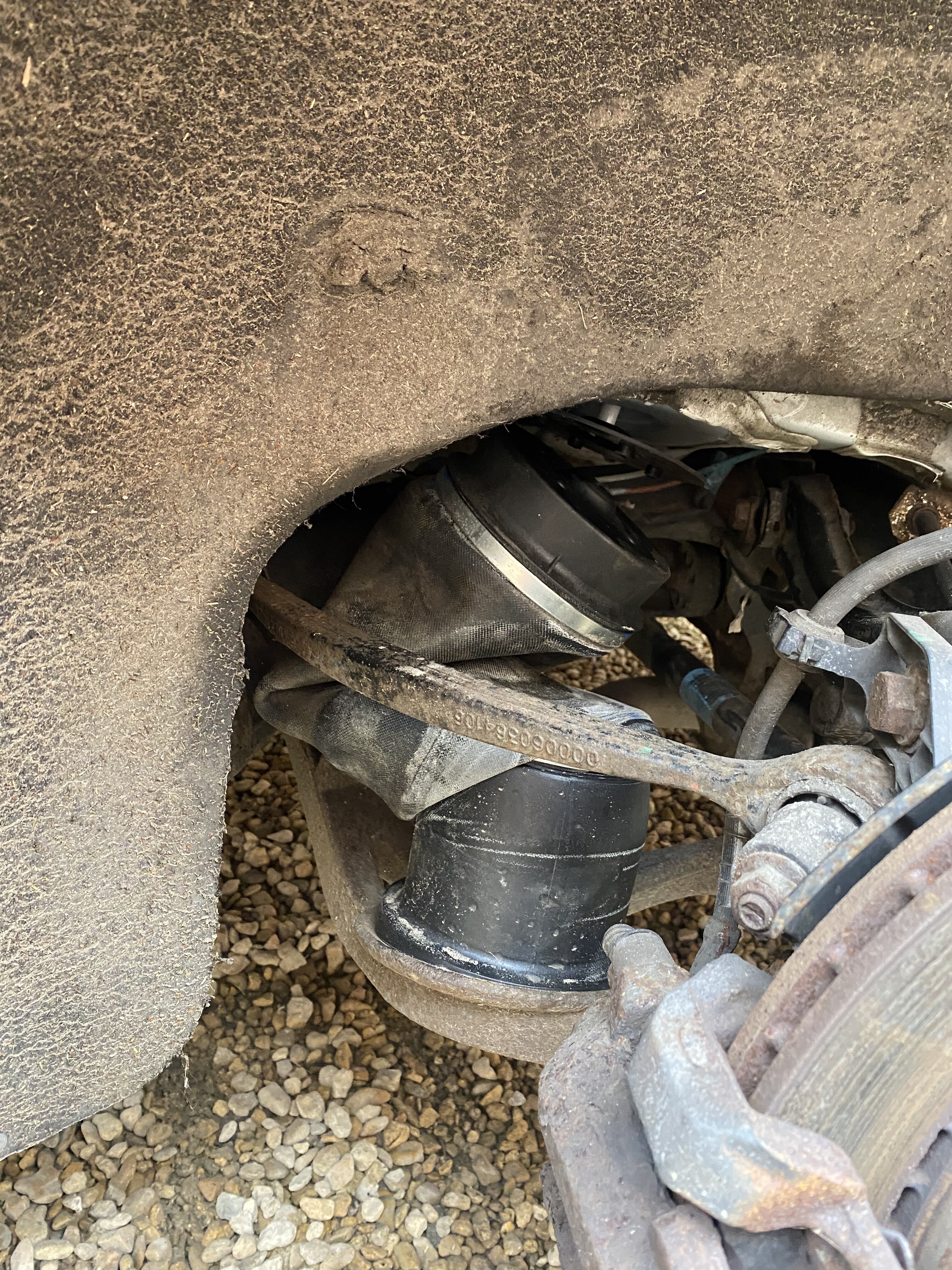

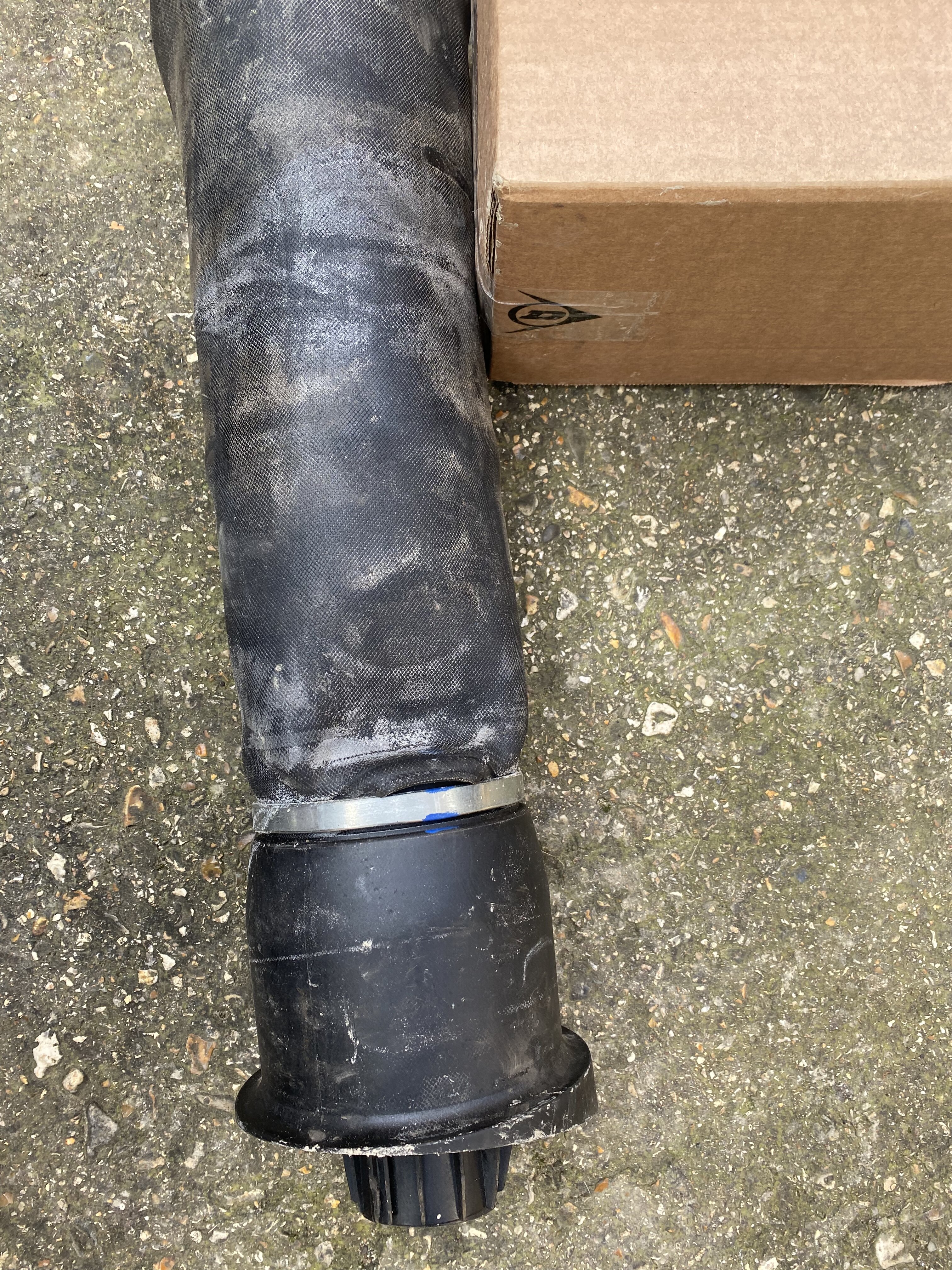

Fitted a Dunlop rear suspension airbag to the nsr last week as it was sagging when left a few days.
Well f**k me it went down overnight (fitted a week ago) and when I started the car I could hear a loud hissing noise coming from the air spring.
Whilst swearing and getting the tools ready to disassemble there was a f**k off great bang, drivers side had s**t itself.
So this was the cause of hissing from the new air spring.

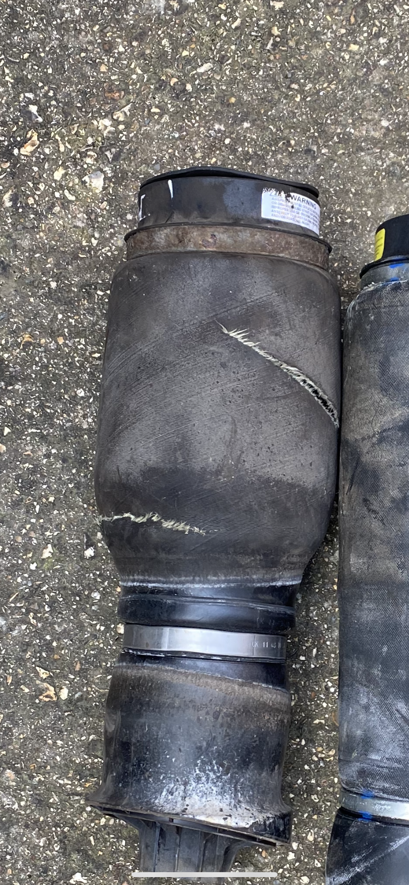

Here is the original drivers side that s**t itself.
Not quiet sure what’s happened here.
So ordered a cheap set of eBay bags to get me going as engine swap next week.
Ill get the garage to check airlines before ordering a Arnott set.

Something like that. Not quiet sure what’s happened. I’m assuming the new airbag just randomly failed whilst parked up and the drivers side decided to part ways.

No it's defo a issue with airbags plus the relay from what I could see.
Fitted the Chinese £60 bags today and a new relay from Mercedes.
Problem solved! Can't tell the difference between the £100 Dunlop bag vs the two Chinese specials for £66 delivered.
