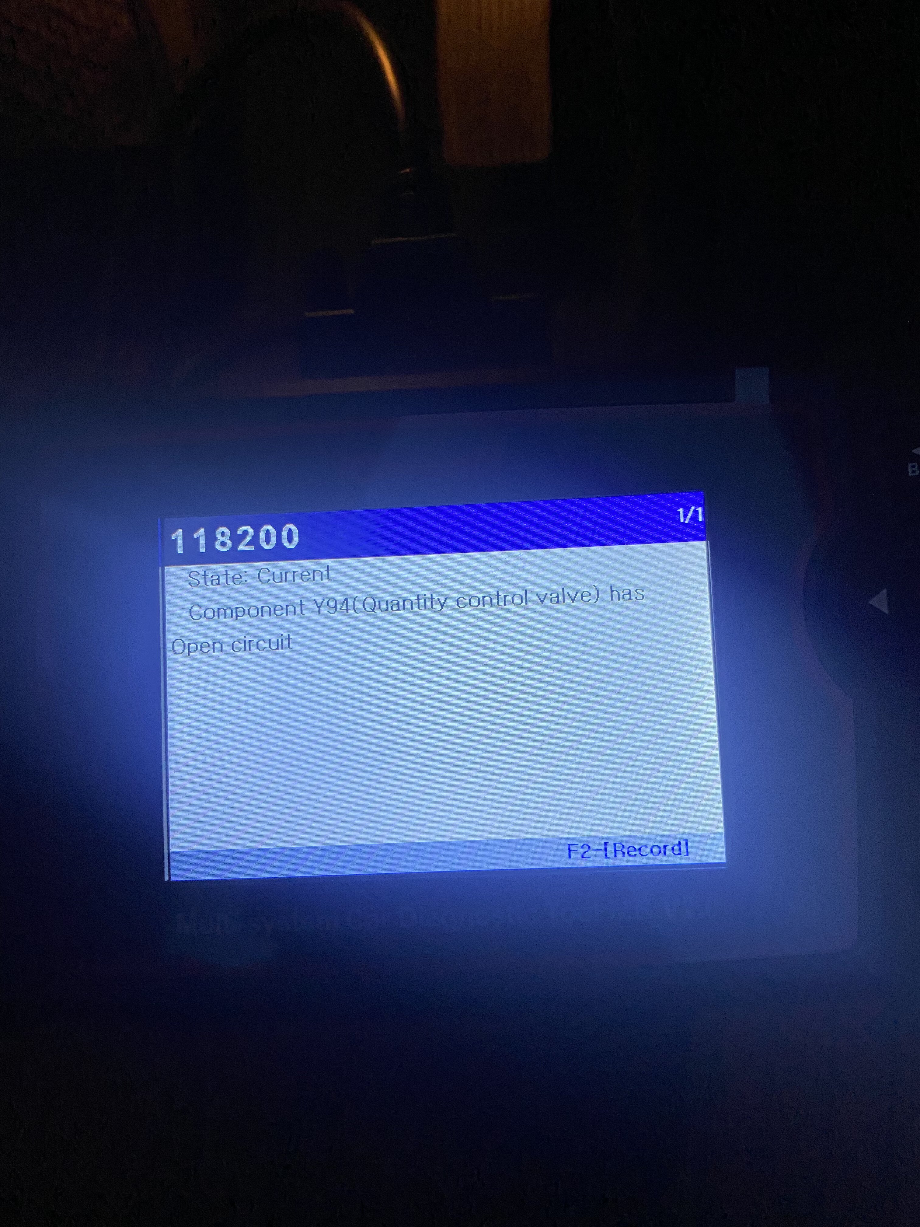

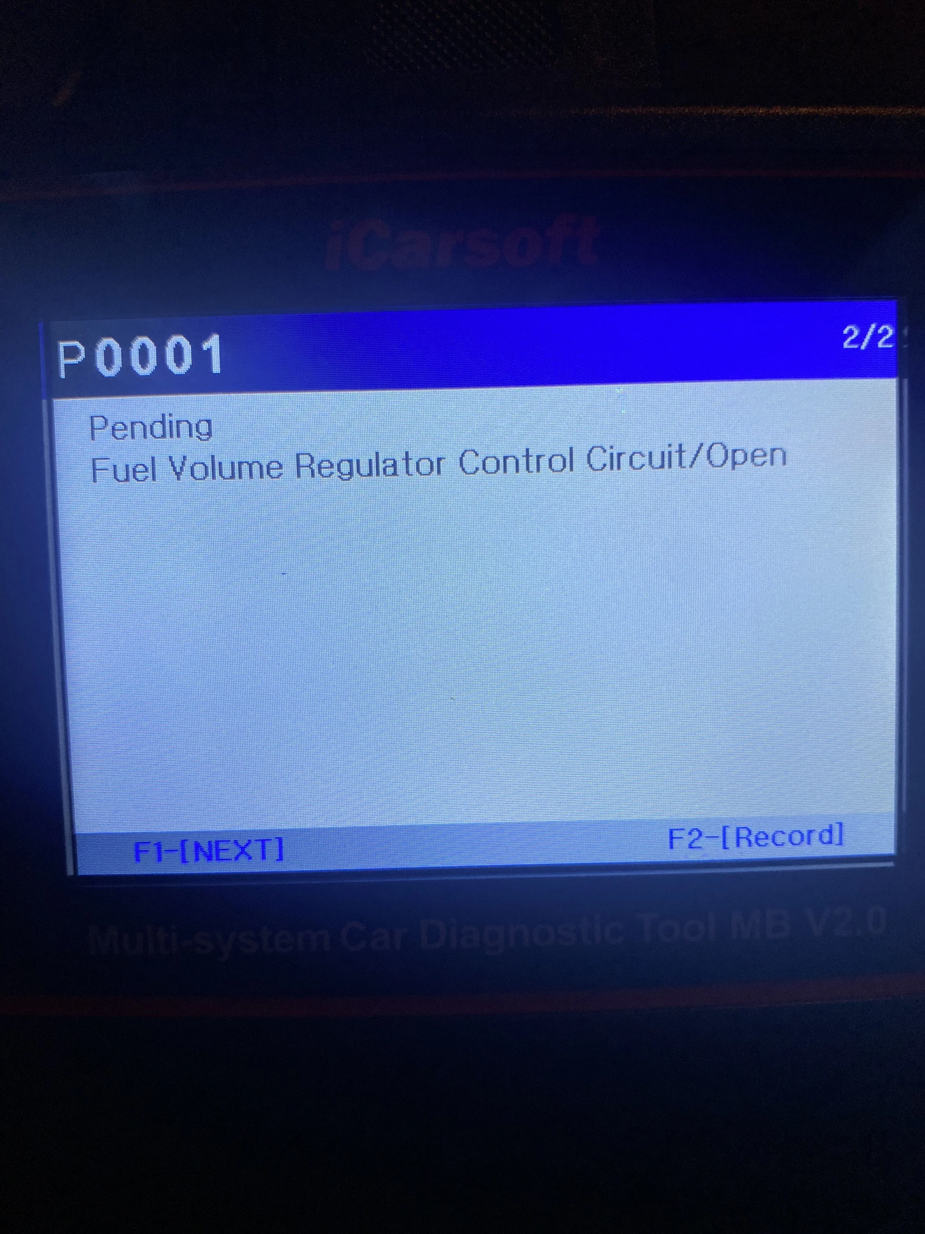

These are the codes I pulled when I got home.

If a circuit is open, surely that just means they’ve left something unplugged or worst case they’ve damaged a plug?
Either way, if that’s the only fault I think you’ll have that sorted by the weekend. 👍
I’m hoping it’s a damaged connector and not the high pressure pump itself that’s been damaged.
I’m going to push the garage who fitted the engine tomorrow (local) to have a look as they never actually got to road test the vehicle for fault to occur.

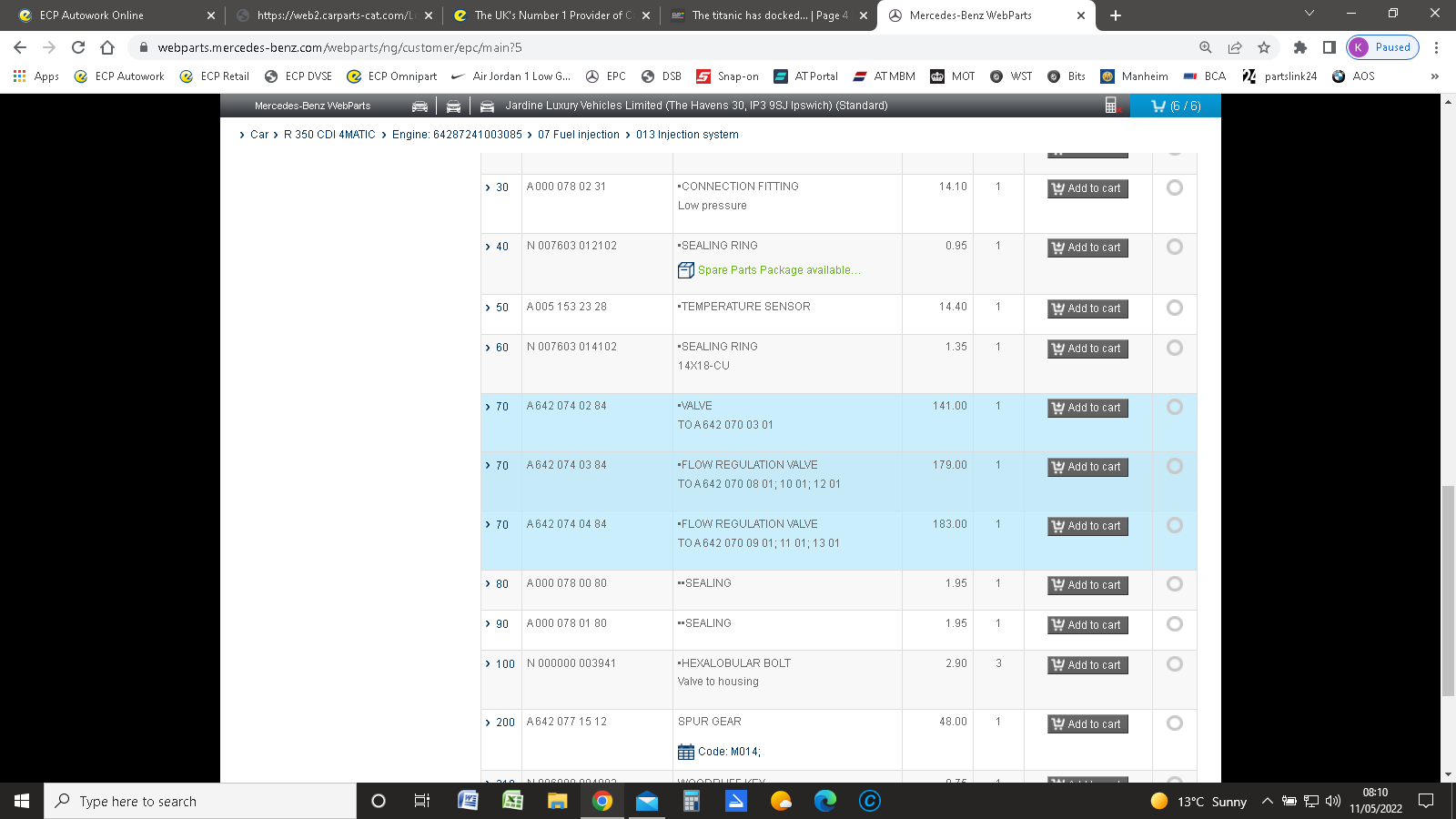

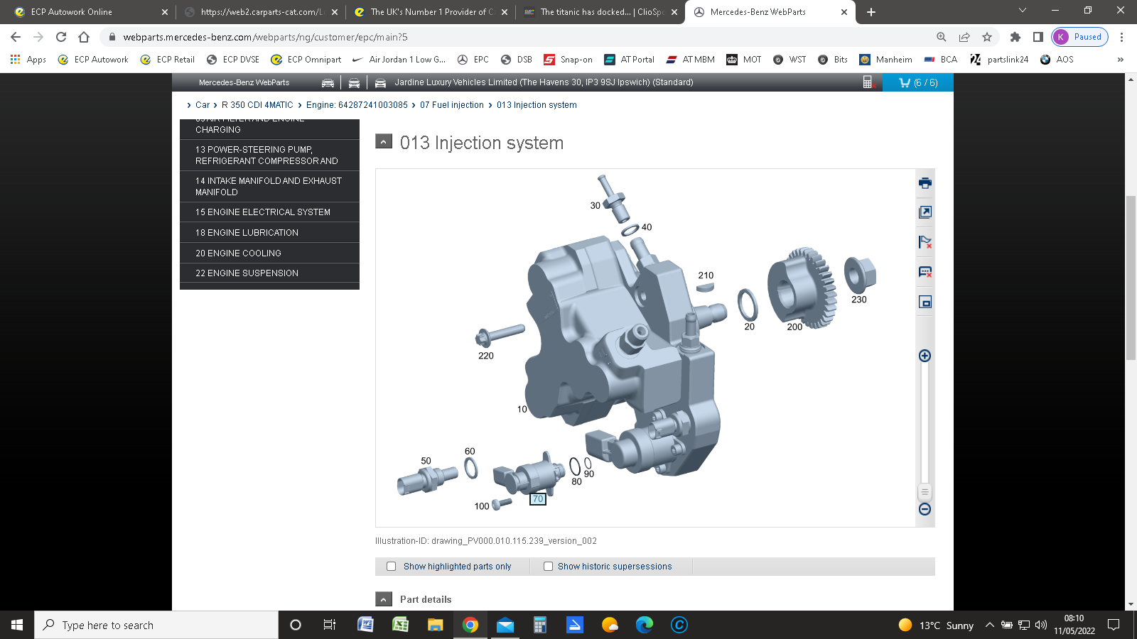

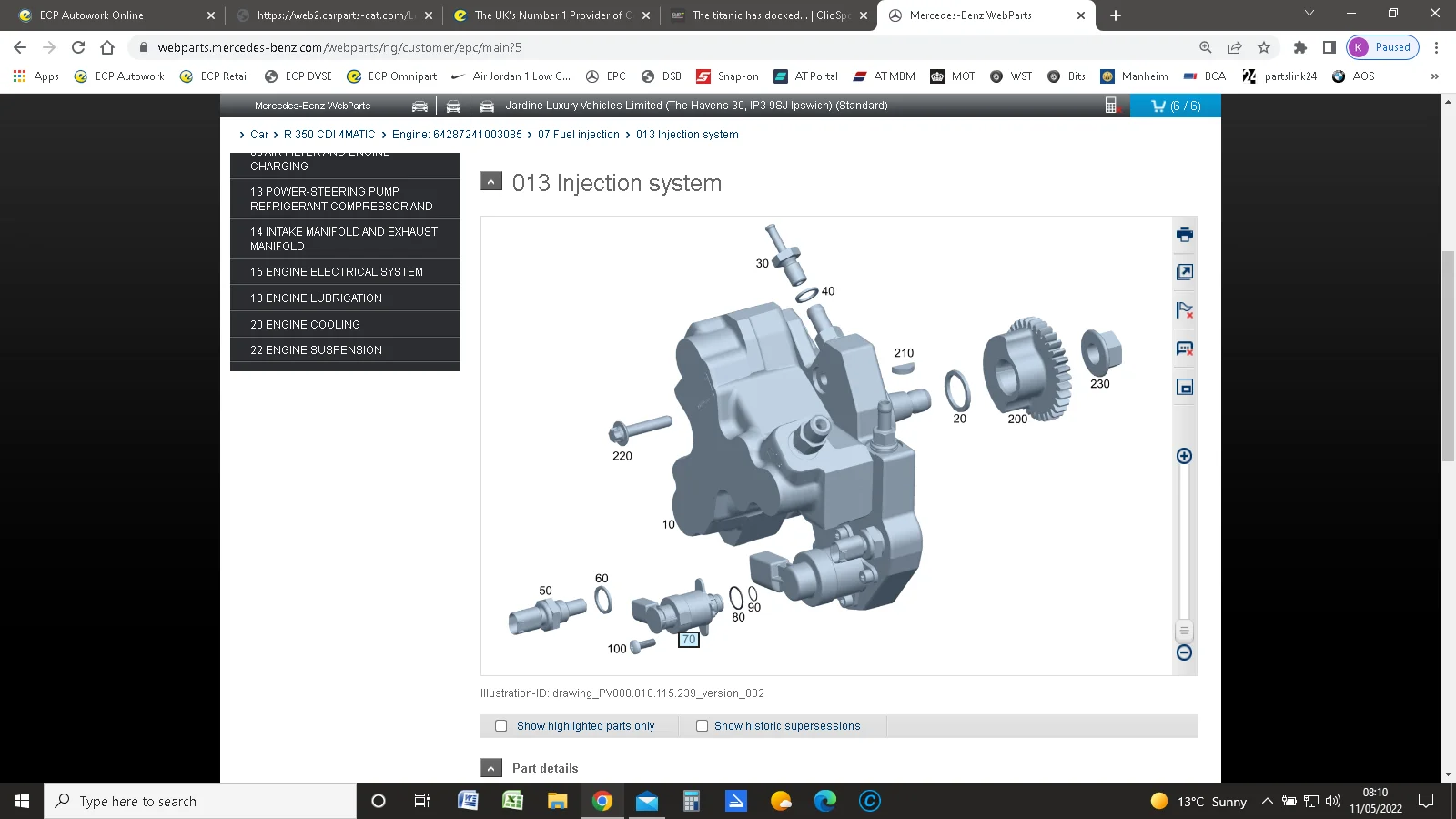

Thats normally the screw on valve on the pump.
Weirdly its giving me a few options for the part number but see below with RRP's.
Shouldn't be a huge job to change it out if needs be as you don't need to remoe the pump.
Right so I checked the connection on the valve in fuel pump and it wasn’t pushed in so that’s sorted the codes above.

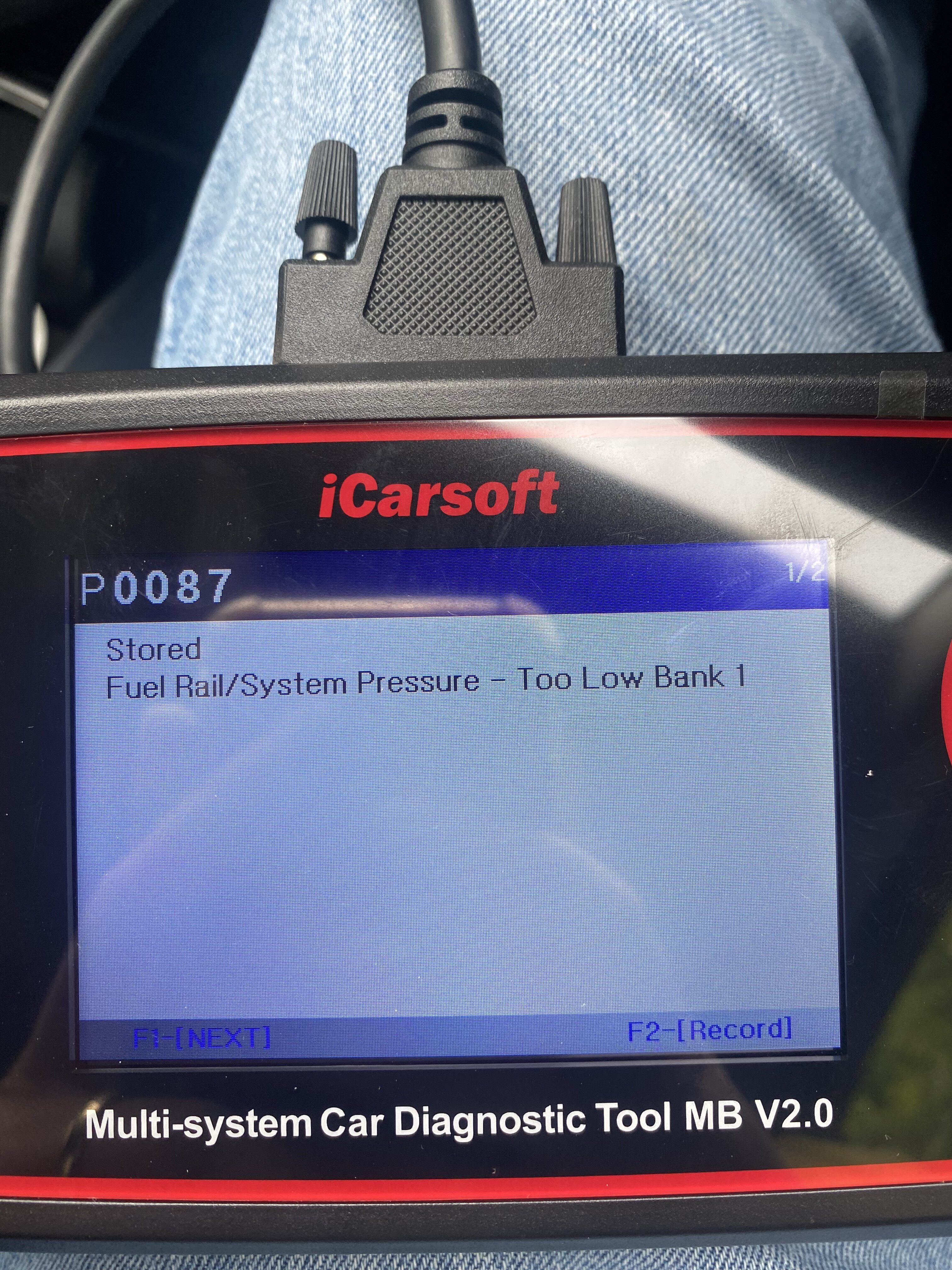

This is the code that the has now come back when driving past 3000 rpm.
same as RAC man pulled.

So should be LH bank if I remember correctly. You have another regulator on the end of the fuel rail. Check the connection on that and that the all the fuel pipes have been secured properly.
If all of that checks out, get a leak off test done on the injectors. Simple enough test or if you have someone local with a STAR machine they can test the injectors via that.

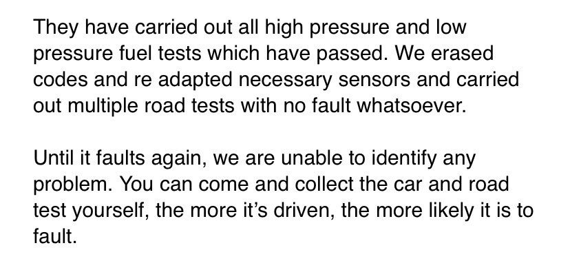

Car kept cutting out abs wouldn’t restart at a junction this morning which almost caused a accident. Went eventually, I met resistance from the garage in Portsmouth today saying they were too busy and it would be a month Atleast before they could look at it.
Wife stepped in as she could see I was about to lose it. They did the work, it was fine before they did the work and I gave them 4.5k.

My guess is either the wiring / plug or the fuel regualtor on the rail is faulty. Simple enough test to check voltages / signal to the plug. And they could try another regulator off another V6 just to test it, before buying a new one.
Because thinking about it, if it was an injector issue it would fault to a particular cylinder and not the complete bank. unless they have coded the LH bank injectors in as new ones but thats a reach..

Fuel lines to the pump surely can't be an issue as the OM642 are single HP fuel pump (pretty sure), so it will be associated to that bank/rail if you're seeing something on one side. Plus there would be derv pissing out everywhere
I would say like @KielT mentioned, injectors on that bank haven't been coded right or the pressure sensor is wankered. These aren't like VAG stuff where each bank has it's own ECU?
Edit, get it plugged in and read the live date from the pressure sensor, it should be like 15,000PSI+ iirc
