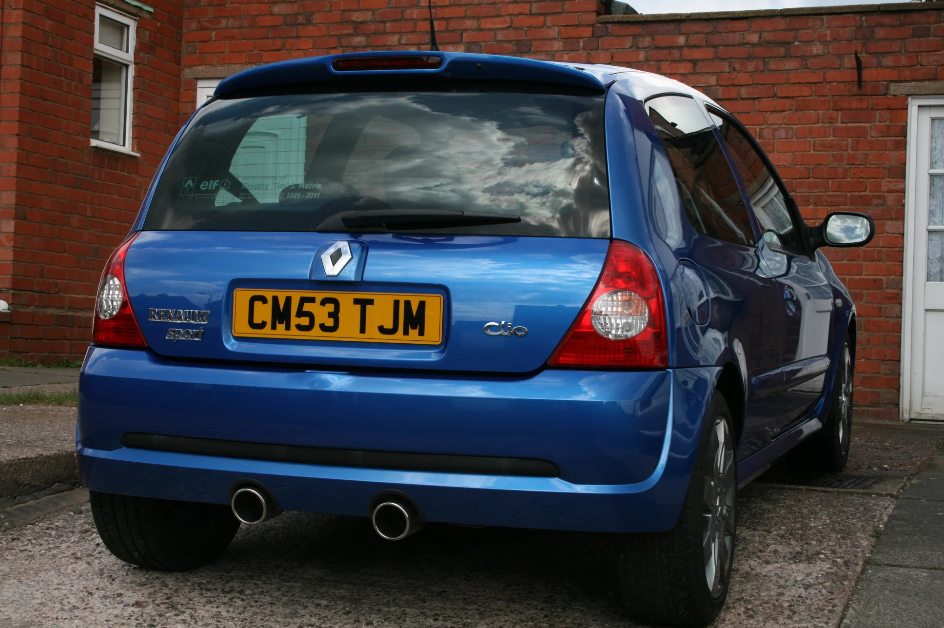

What exhaust is on there? Looks a snug fitment.
A Scorpian RS192 was fitted earllier this year & new mounts, does not fit quite as I would want it - it's a few mm off centre, real sod to get 100% and I'm real fussy, OCD?
The original Renault boxes were welded/repaired and missing the centre section, and holding a gallon of water when removed!!
It is louder than the standard boxes (minus centre box) the low rumble sounds impressive but I was hoping it would be a bit quieter - may or may not go back to original spec one day, but probably will be deaf by then...ha.

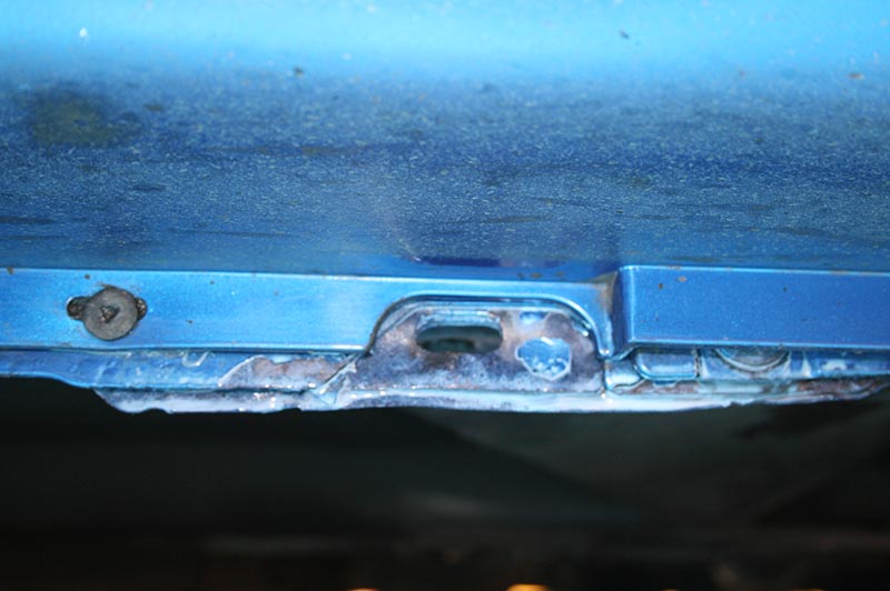

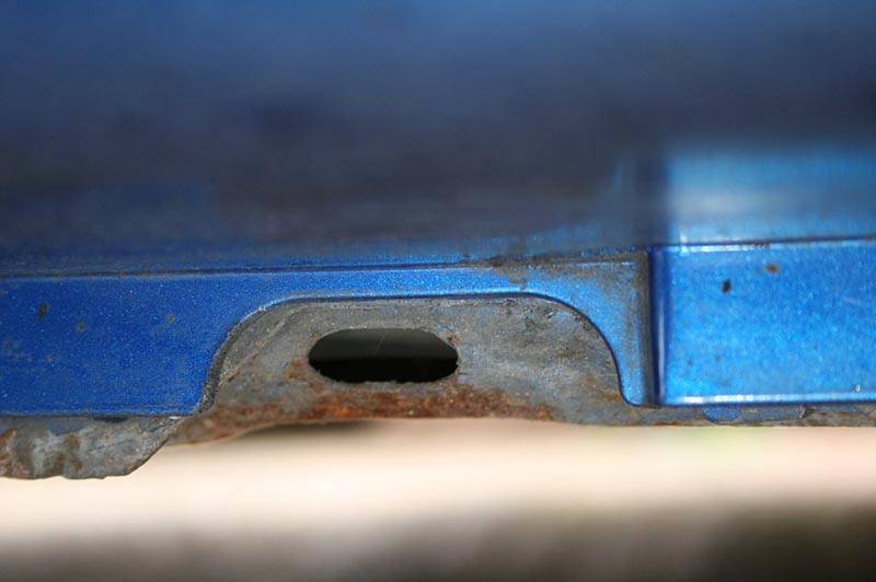

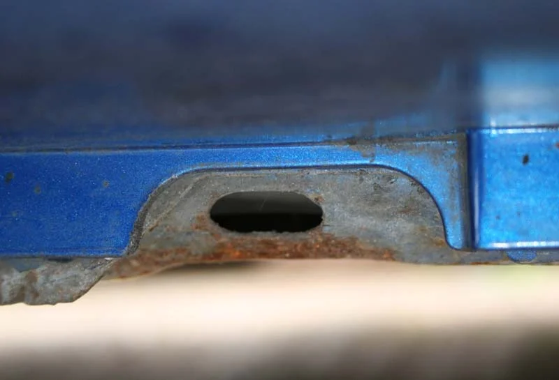

However I have finally managed to sort out the front jacking points which had at some time been abused and had started to corrode, one being nearly flat against the underside, this really has been bugging me.
Both sides were badly bent and oxide, I managed to straighten them up by applying pressure with a trolley jack laying on it's side against a wall with a length of wood as a prop, a bit 'Heath Robinson' and it took ages but a bit more controllable than bashing, then treated them with Kurerust, etch primer, J41 and a topcoat of clear Waxoyl, the whole undersill area was treated with the wax before replacing the skirts, job done me thinks.
Hopefully these jacking points will NOT be used again!

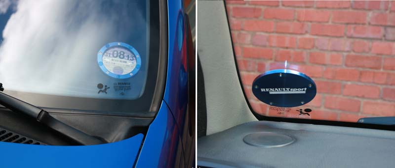

I also made what I think is a pleasing addition very recently.
It's an engraved Richbrook holder, (as if you didn't know), I was quite pleased that the blue anodised colour turned out similar to J46.
Cost: £270 including a years road rent!

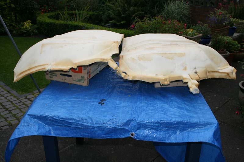

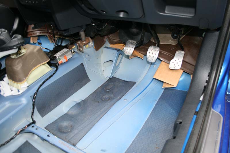

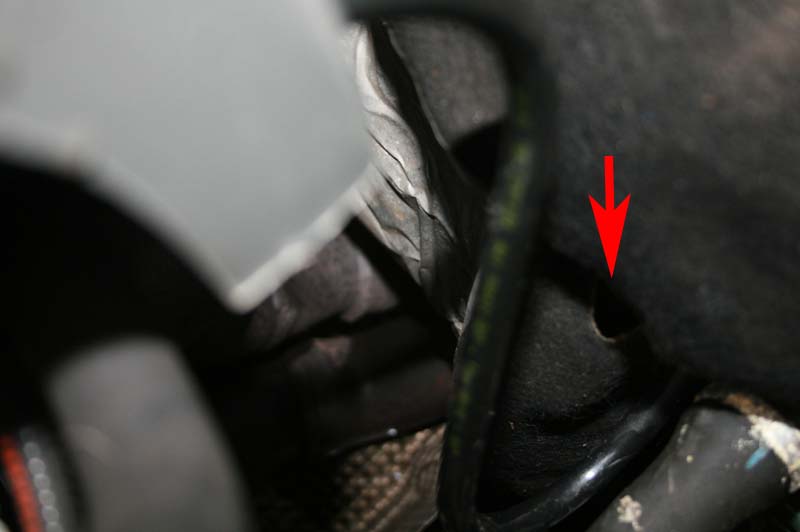

A serious problem I had in the summer? was very soggy carpets, I set about removing the seats, and various bits of trim to get the carpet and the undelay foam out, and finding out where the leak was coming in. It was obvious that the scuttle was the first place to look and sure enough, after filling the scuttle with water using a hose pipe, could see that the center drain was blocked, water accumulating and gradually leaked in aroud about where the a/c fitments are - cluch/brake/centre console area, the scuttle center drain was completely blocked at the pipe outlet at the bulhead behind the center of the engine, it was an easy cure.
With this sorted and another hosepipe test everything looked OK - it did take five days hot sunny to dry out the foam completely but it gave an opportunity to give the floor pan a good clean and tidy, now with everything back together, after plenty or rain and washing - the carpets have remained dry so job done.

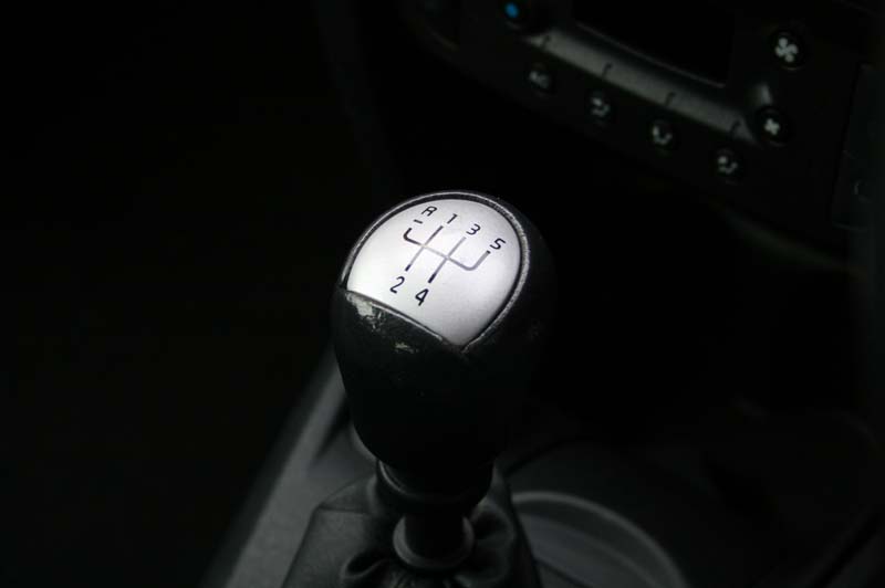

Another thing has bugged me for a while was a worn gear knob insert - the lettering had dissappeared and was rather ugly looking, I found and fitted a new gear knob replacement which looks like the original, not easy to find, this was not OEM (expensive option) but looks OK and is how it should look so I'm fairly but not completely contented with the replacement.

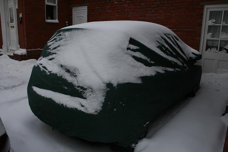

One of my outlays has been a car cover, an expensive fitted 'clio' multi-layer one - this is going on the car over the winter months, the Clio will be used even less if at all then.

Nearly naked.
The Poky Bit.
About halfway down the centre of the bulhead behind the engine, this hole in the sound deadening, stick you finger in there and find the little rubbery flappy bit, it's this that gets clogged, some say to pull the flap off altogether.
Drying.
The carpets are easy to dry out, but NOT SO for the foam sponge whch funnily enough soaks up water like a sponge.
The Nob End!

Covered up for the winter, got this cover last year, tailored for a MkII, it fits nice and snug.
An then some snow........
