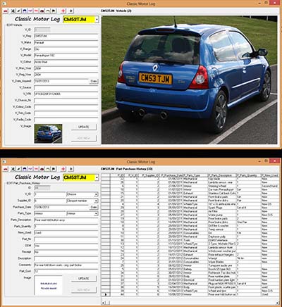

During the winter, I was playing with the idea of a database driven application to store all my car related info, jobs, parts, service history and so on, I used to do this many years ago in written form in what now seems like another lifetime - back in the 1960s and 70s I was a diehard car enthusiast like you guys.
I had not found anything like it that was specifically written for cars, so developed my own application as I am not new to software development, I came up with "Classic Motor Log" (CML), this can record parts, jobs, service, repairs, MOT, suppliers, journeys with associated costs and general car details as well as pictures, it's possible to deal with multiple cars too.
It's working pretty well and have only made use of it myself so far, but may get around to a public release of this software at some stage as other car enthusiasts may find a use for it too particularly those engaged in restoration? - it works on PC/windows platforms only - it's NOT an 'app' for pads and iPhone.
Ohh, it will be free of course.

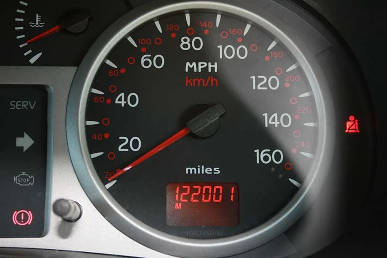

On a lighter note, I noticed the mileage when I got back yesterday.....

I love the software idea. Is it on a free source website and it will or similar?

Stu & Simon, re: The software, well, I have not built an installer for it yet, but if there is any interest from you guys, I will get on with this in the next cupla weeks and can let interested parties have a beta if they want, strictly speaking it needs more input from other users to develop it further as I have just set it up to my needs and no more, which may not meet everybody else's requirements or expectations.
When something's ready for beta testing, I may make a post elsewhere, if not you can PM me, incidentally this will not be an 'app' for iPhone etc., only for a PC running windows.
Simon_16v
Sounds like a good plan, I'd be more than welcome to be a beta tester for the software. Just nice to have a proper software based invoice register :)

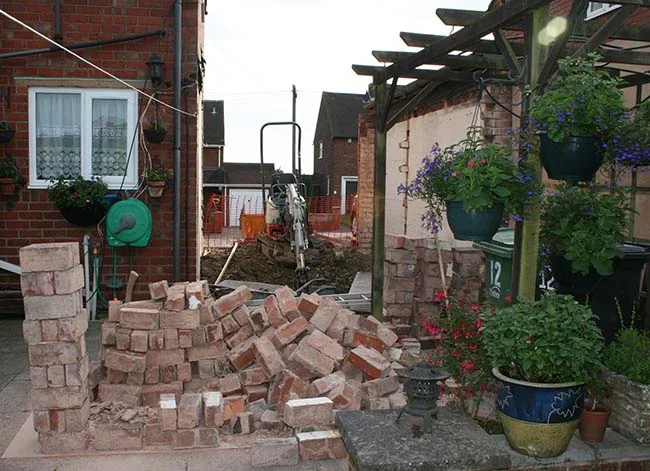

Well 2014 was a bit hectic and a serious drain on resources, the addition of a new garage extension and some considerable mess during the summer months, and together with getting our other RS finished for the shows, I have not had much time for the Clio other than some maintenance and repairs.
The demolition/building site in our back yard, this was back in June, below the finished projects.

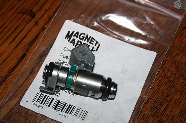

In November, the EML occasionally started flashing, the OBD2 code reader shows a misfire on cyl. #3, figure this was a faulty injector, so set about replacing that, ordered and fitted a new injector....
This little job as easier than though at first, and with the car back together and fault code deleted, all seemed to be back to normal, and certainly fixed the flashing EML.

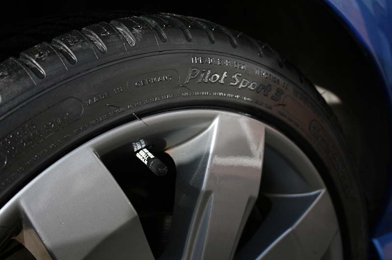

The old Exaltos on the rear had plenty of tread but were old and somewhat perished with a small amount of cracking around the sidewalls, I had already planned to replace with new PS3's this year to match those fitted on the front.
Got a pair of 205/45/16's from Black Circles and had them fitted locally, these PS3 are good tyres.

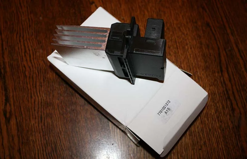

Next - the a/c heater motor had suddenly stopped working and I traced this to faulty resistor, the headlight washers had stopped washing, so decided to do both jobs together and replace the washer jets too.
Started collected the parts ready for the next job....
The offending resistor, these are a very common failure apparently, this is an aftermarket one though.

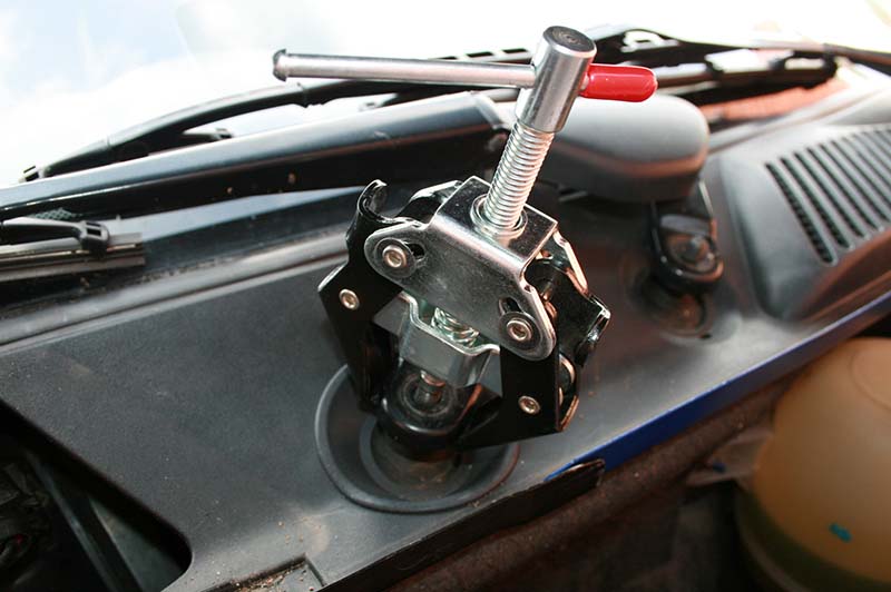

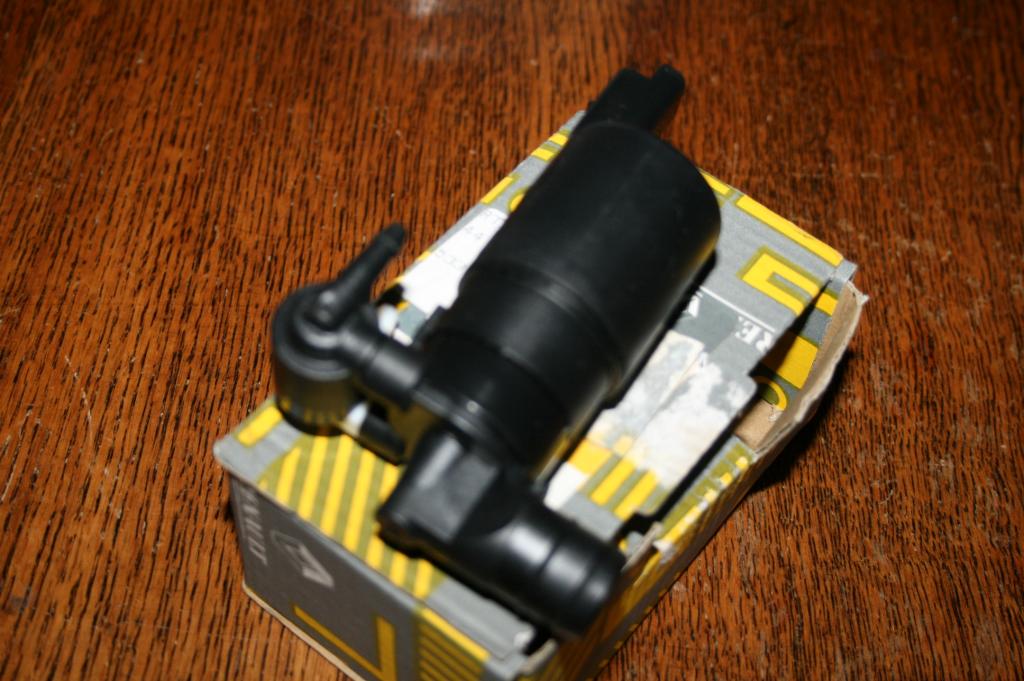

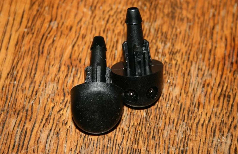

Had already replaced a couple of washer pumps in the past with the cheap and cheerful ones @£7, but don't seem to last long, so this time decided on a an OEM pump.
One of the most useful tools for a Clio!
This puller has had a lot of use, as the wipers have been on and off pretty regular.

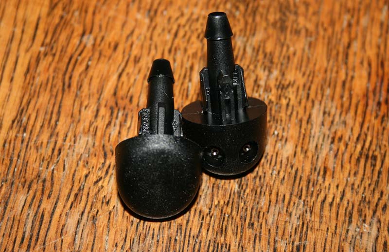

Even after considerable poking - the jets were never 100%, so decided to replace them both.
These were not a great expense - I think they were about £8 a pair but the screen is washing very nicely now.

Set of Injectors, going to replace these.

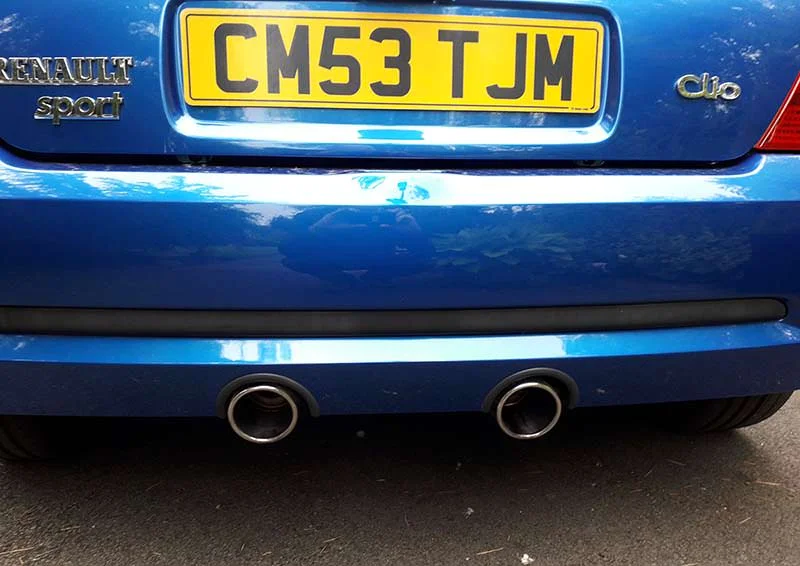

One thing been bugging me for a some time is the tailpipes don't sit central on the cutouts.
So now with some adjustment, they sit better, a little high maybe but I'm sure they will sag a bit soon.
