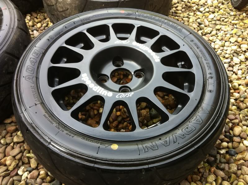

- Buy some 15" rims and fit my spare Parada spec 2 tyres, as we discovered today, my front camber is killing my front A048's, where as the rears are still like new.

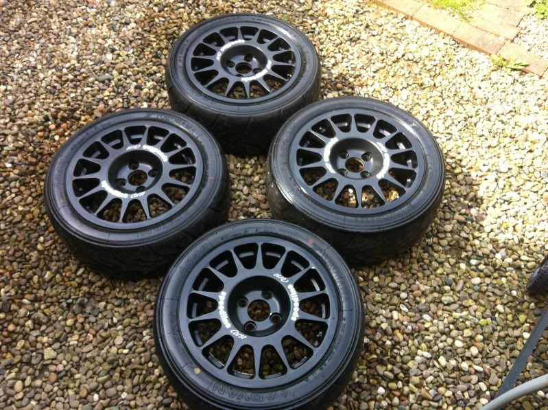

Little bit of an update! Just had a spend a bought:
- 4x OZ f1's with Hankook V12's (for road use now, save my A048's, what do people think of those tyres?)

- i'm going to have my A048's swapped round on the front as the camber has killed one edge, these will now be my rears.

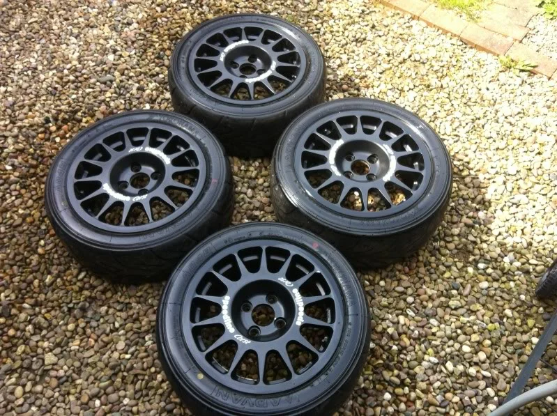

Wheels came today, so spared no time in swapping them over :) Although it did enlighten me to a problem on my passenger side. It would appear either my wheel bearing has gone, or track rod ends :( major wheel wobble 12-6 & 3-9 gutted is an under statement, spent so much money recently just getting ready for the Ring in 2 weeks :( Then again i'd rather it happened now than once i'm there, also would explain the major uneven wear on that tyre...

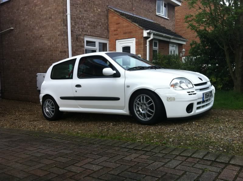

Anyway this is how the car sits now (Road spec) F1's will eventually go satin black, with white stickers, need to sort a set of centre caps too, have OZ ones and they look sh*te if you ask me, plus one is missing.
Looks good on the silver Lewis! Glad the wheels are ok :)
The centre caps are a bit rubbish lol... Set of Renault ones will really tidy them up though.
thanks mate, I think I'll get the Renault centre caps and refurb them
Satin black :)

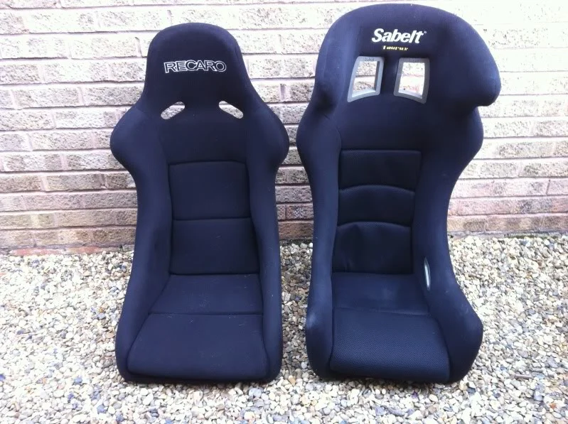

Is it pole position your fitting mate? If so, excellent choice sir!! I have 2 in my track car and the journey to the 'ring is sublime!! Got to be one of the most comfortable bucket seats I've ever sat in.
It is indeed, wish I'd got one in the first place so comfortable!
Time for an update with some pictures :)

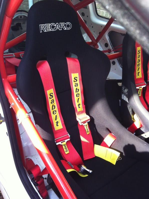

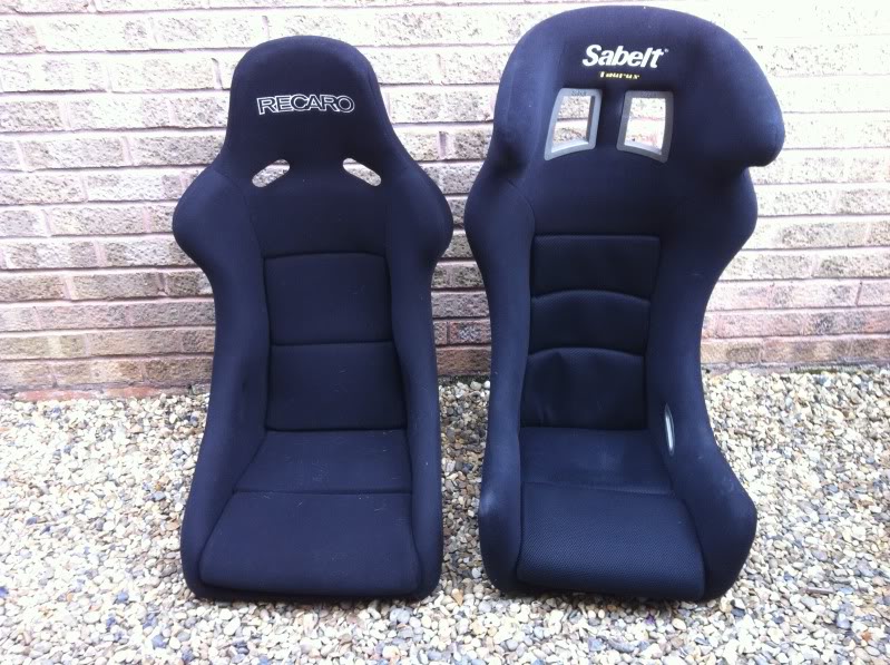

New seat vs Old seat... The Sabelt looks so cool, but was just to small for me :(
Recaro Fitted:

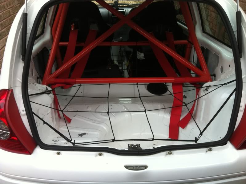

Boot net fitted:
