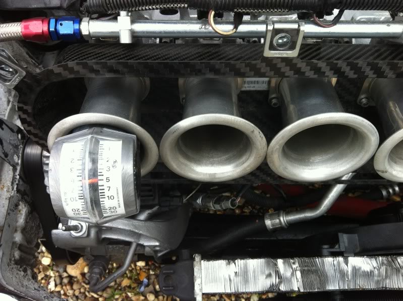

Final preperation today :) So started by taking all the wheels off, having a nose behind, then making sure they are all done up tight, followed that by raising the rear suspension a little bit. I then moved onto the engine bay, first job was to fit new Jubilee clips to the coolant hoses, never trusted the standard Renault things. After this i checked all the fluids and topped up the coolant. No photo's of this as it's all pretty pointless to get photo's of!
I did notice though the O-ring on my m8 temp sensor had gone and was weeping coolant, so just done it up tight and it seems ok at the moment, also one of the bolts on the upper gearbox mount had rattled loose so done that up.
Once this was done got the car running and warm and balanced the ITB's, cheeky little picture of perfect balance :)
They are all reading the same btw ;) Then reset my throttle position sensor so that was bang on.

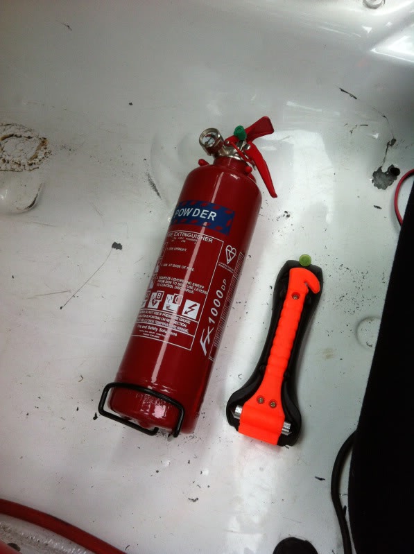

After that i took the car for a quick spin to make sure i'm happy with everything and i was, so once i came home had a few safety things to fit, nothing to challenging really.

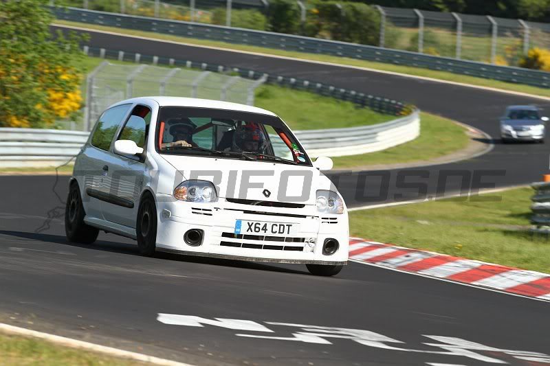

Just after the drive there:
My ring card:
And finally my 2 favorites.

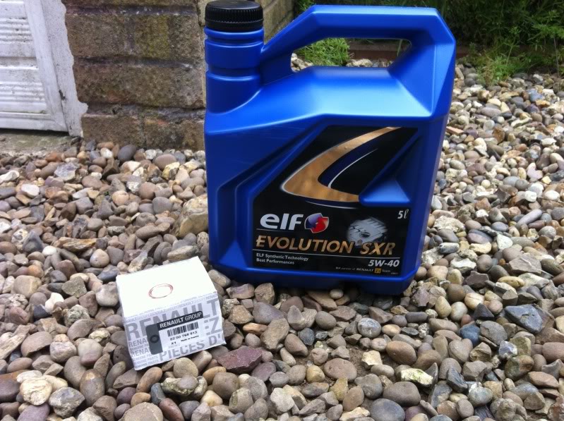

Also been to my local Renault Dealership to pick up some service bits, will be doing this later today, waiting for car to cool down a bit first.
