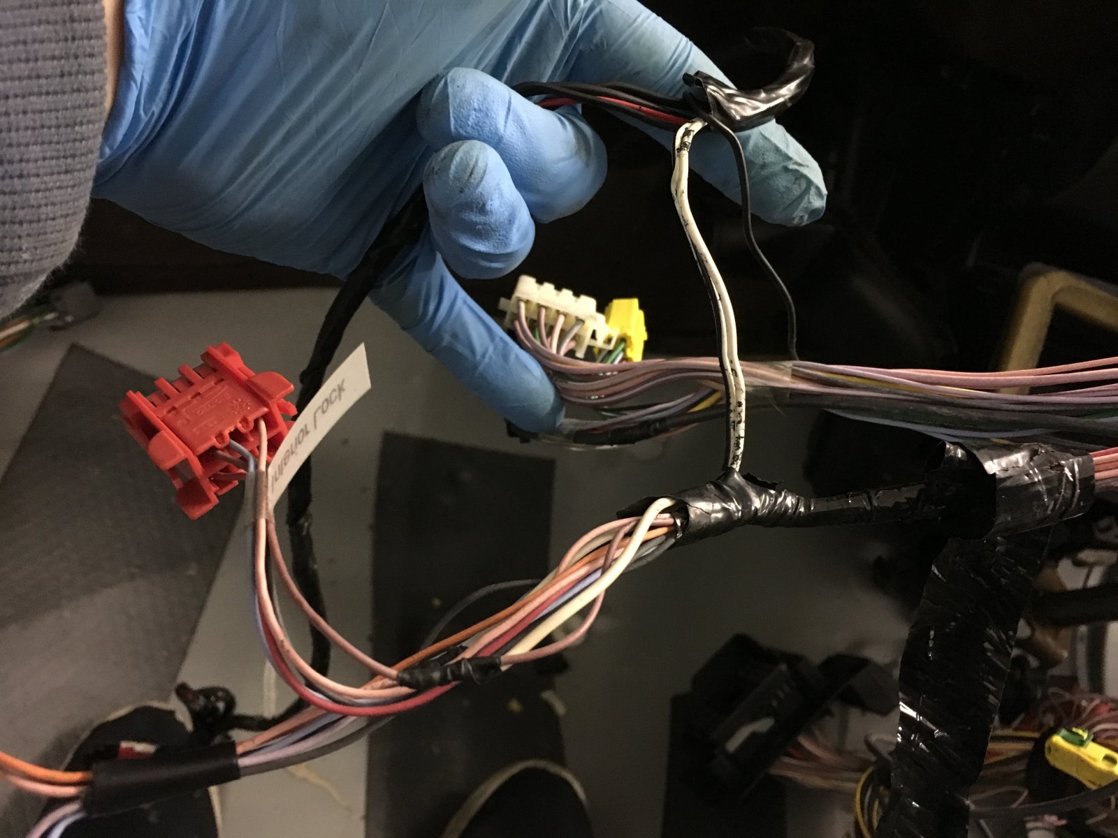

These two wires??
Gents
Quick one
1st White wire - comes in from Alarm and is spliced into my interior lock loom
2nd white wire - comes in from alarm and connects to hazards.
Black wire - comes in from alarm and connects to Earth.
If I cut 1st & 2nd white cables out will that play up with my central locking or will my alarm go crazy?
If I cut the alarm out, will this start UCH issues again?
I'd like to keep the alarm but I'm going to cut the sterio wiring out
Any help would be great.
P.S. I dont want to relocate cables.
Sorry, here's the picture
I removed my alarm totally with no issues.
Strip all the tape back that holds the loom together, and just shorten/tidy up anything you want to keep.
If you want the alarm, you will need to keep the wiring to both the hazards and central locking.
