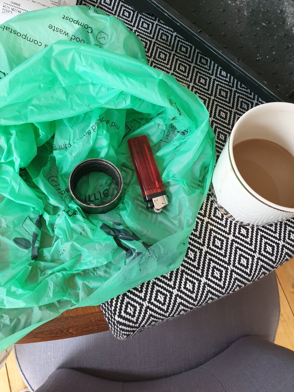

This just fell off my 182? Any ideas?

I'd say it was off a pulley.
hmm, Ok should I be worried about driving it? Drove fine afterwards for a couple of miles? Getting booked in to a renault specialist but they are an hour away now I am worried I should be getting it towed there?

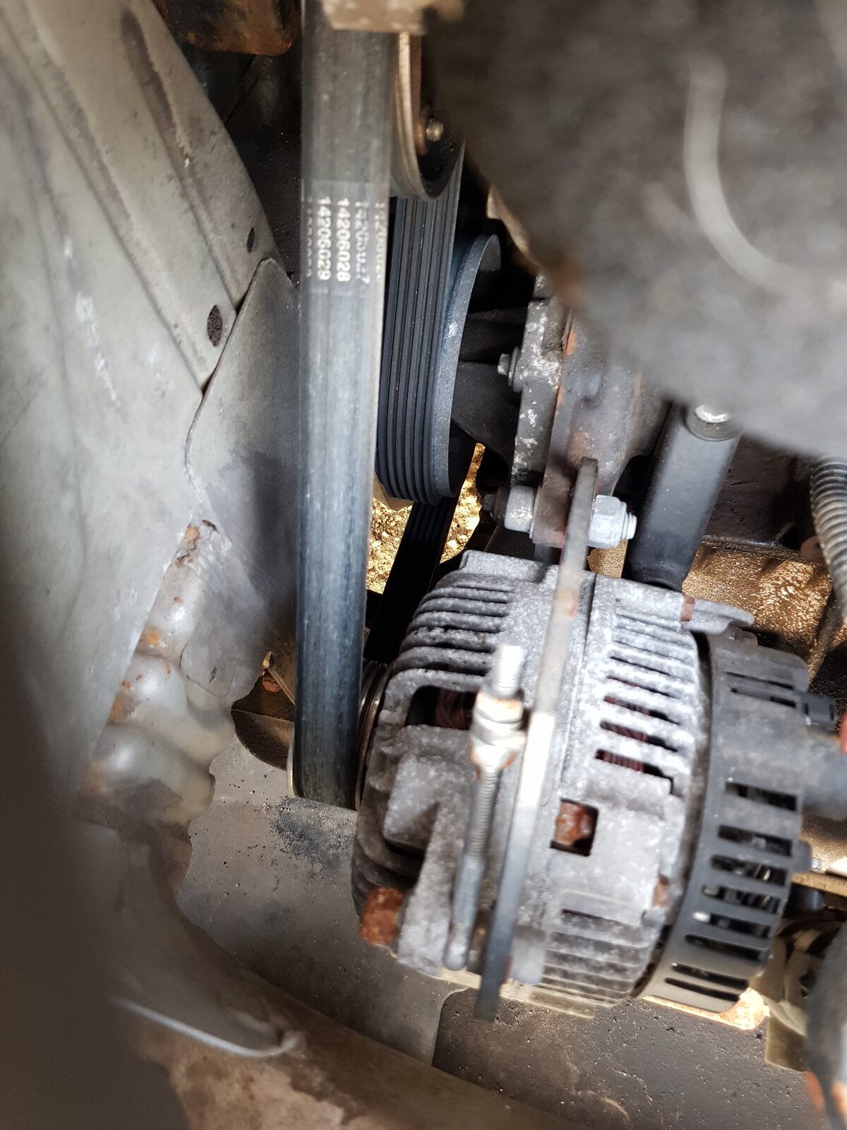

If you are unsure where it came from, I would advise not to drive it, as if from the aux pulley the aux belt could come off and take out the cam belt

there were some slightly funny noises in the run up to it coming off, then hit a bump and it came off. car then drove fine. Havent been able to get underneath but had my fingers crossed it was an exhaust related piece but cant see how it would be.
could it be gearbox related? Thinking about it, it had just jumped out of first into neutral after some over eager driving? (still getting to know the car).

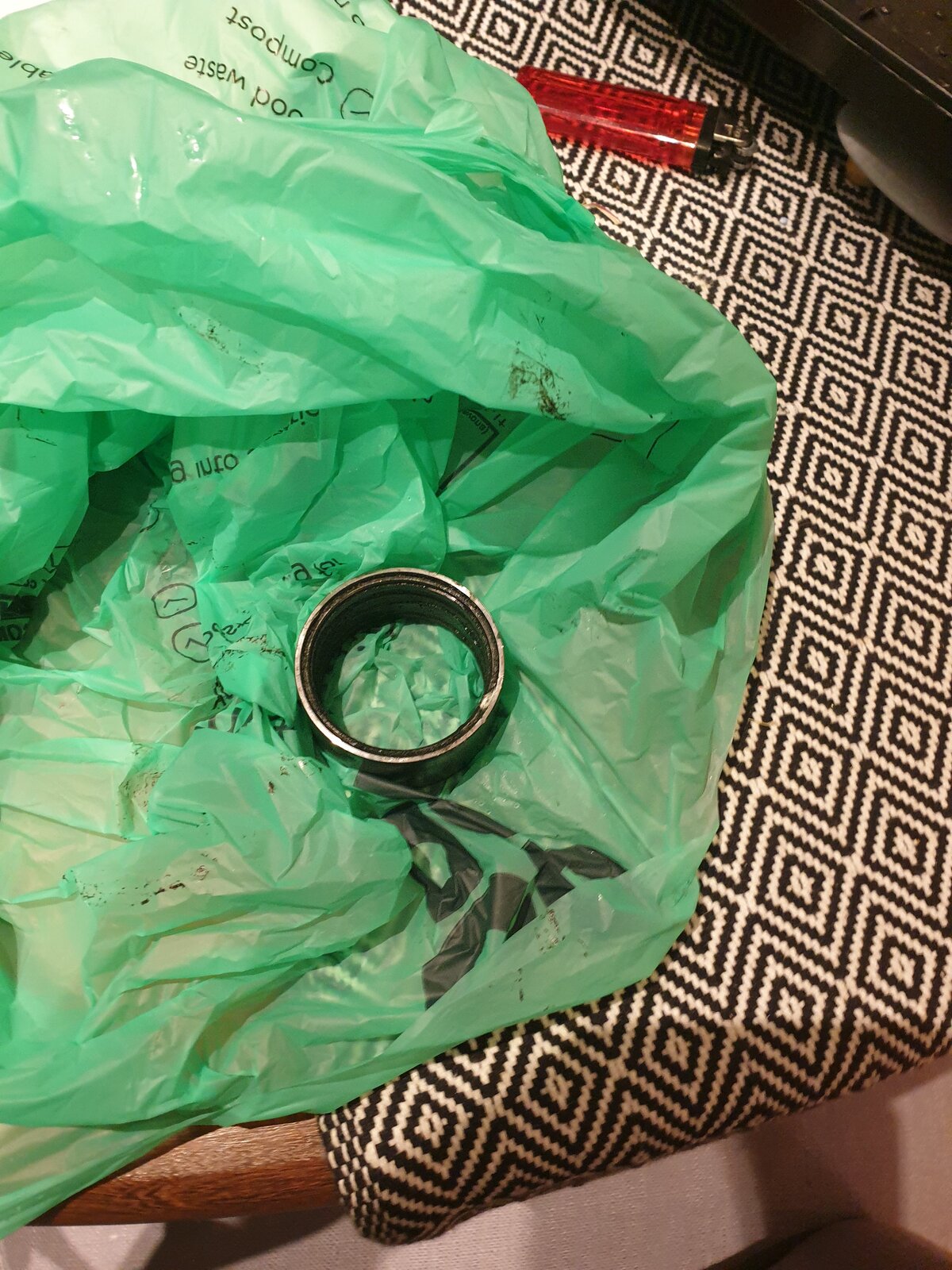

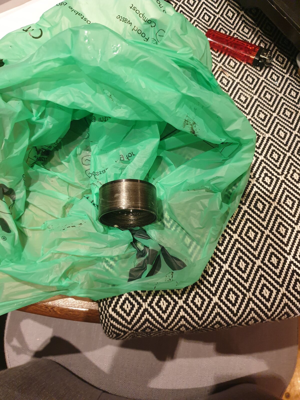

I think these guys are right. If you look at your very 1st post of the 3 pictures.
The 3rd picture where you stood the item up you can clearly see most of the outer surface is worn except that top edge like 4mm of it is still untouched
